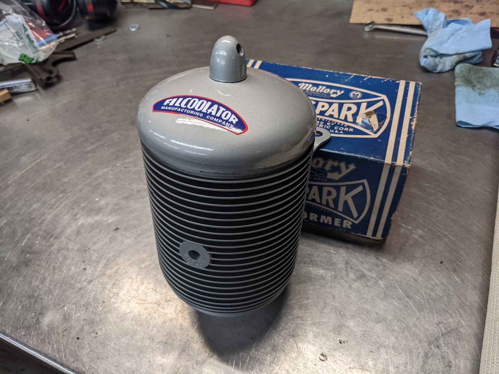

    Started cleaning up the engine bay to get ready to drop the hemi in. It's filthy with oil spray from that leaking 318. Still have some welding to finish on the frame. One thing that's been real handy working on this truck is the hood opening to ninety degrees so I didn't have to take it off.
    I don't know a lot about where all the work was done on this truck. There was a sticker in the back window for a shop in Oregon if I remember correctly. While I guess they get points for at least using a period correct 318 Poly and some other cool old parts it mostly strikes me as something that was thrown together quickly to turn a profit. They had a good way for the leaking front main seal to not mark its territory wherever it was parked. Run the driver's side exhaust pipe in front of the engine right under the seal. I'm sure this was because of space constrictions but it worked twofold. 318Exhaust.jpg
    One cool thing that was on it was the Filcoolator on the firewall. Almost all the original decals were gone so I cleaned it up and repainted it. Filcoolator.jpg Filcoolator1.jpg
    They were running it with no filter. I bought a couple of Baldwin P67 filters for it. The questions I have about these units are do they flow and filter good enough for my hemi and also is the P67 the correct filter? It seemed to fit in the canister good but from what I've read there seems to be a little debate over the right filter.

    That filter is a byp*** filter and is not designed to take the full volume of oil from the engine. You can use that filter in conjunction with the spin on filter, but not in place of it.

    For many years heavy truck diesels ran both a full flow and a byp*** filter. Your Filcoolator is a byp*** filter.

    I do really like the look of the Filcoolator on the firewall and if it's on there I would rather it actually be functional. Plus where the spin on adapter is on the block oil would be dripping right on the exhaust every time I change the filter. I already have the remote oil filter adapter plate for the block where I was planning on running it to the Filcoolator. Would you run first to a remote spin on filter then through the byp*** filter and back to the engine?

    After reading some more about how full flow and byp*** filters are supposed to be used in conjunction and some helpful advice from gimpyshotrods, I think I'll probably end up using just a spin on filter by itself. I see now that my earlier post asking if the oil needed to go through the full flow filter first then the byp*** filter and back to the engine isn't how that setup should work and that on engines that have both the oil that is being pumped to the bearings is straight from the full flow filter with just a little bit being diverted to the byp*** filter for finer filtration before going back to the sump.

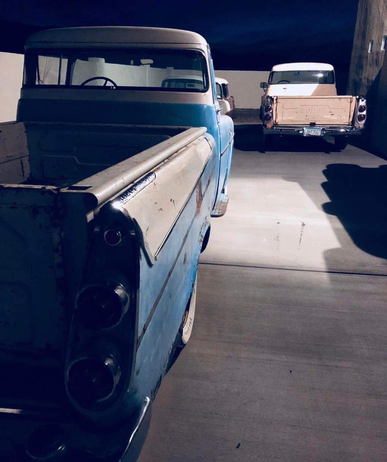

    I sent you a message. Cool trucks man. We have a 57/58 also. Very hard to find. Starting to do metal work on my 57. We’re gonna make some sheetmetal parts and sell them . Check us out on insta @madmooks_trifive
