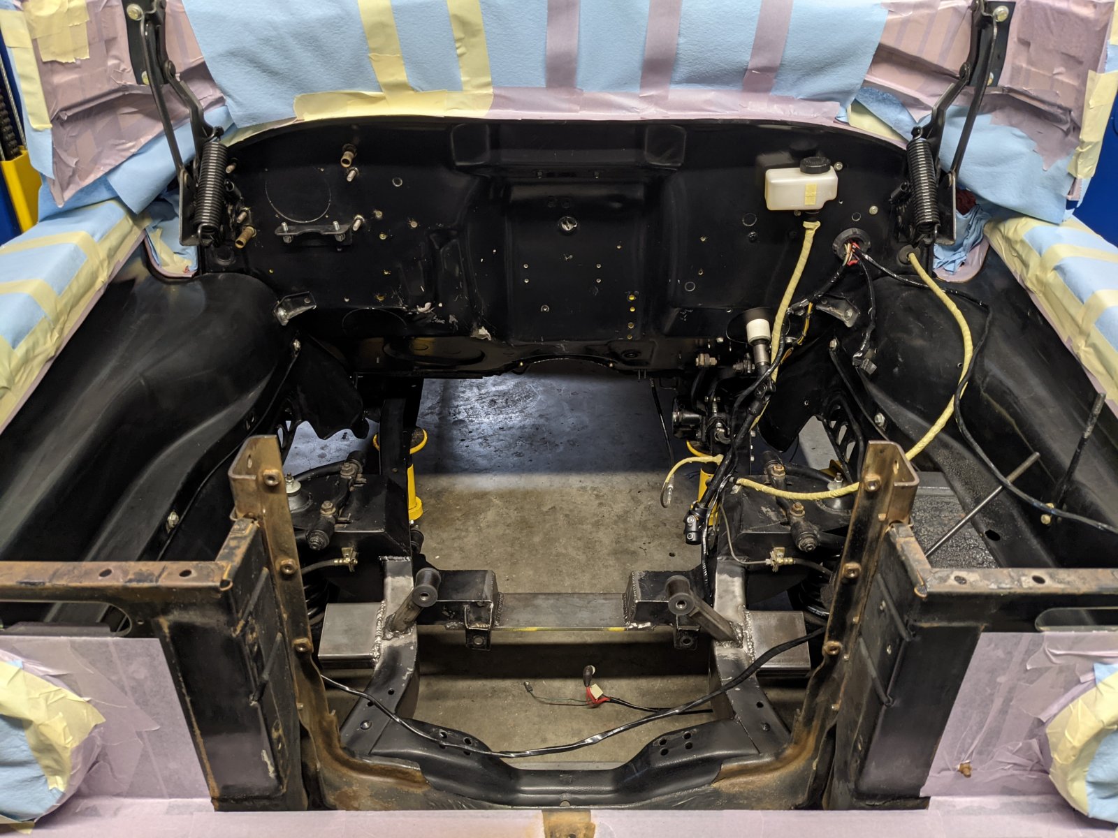

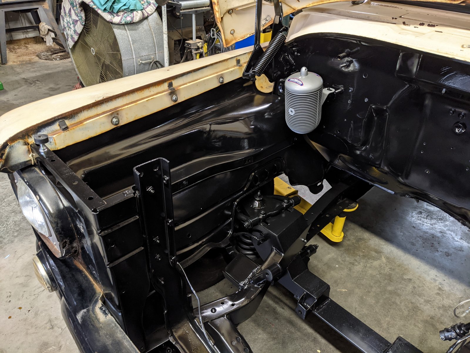

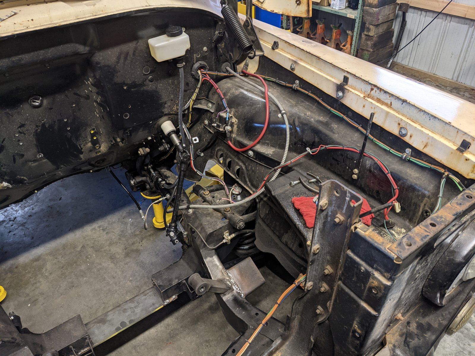

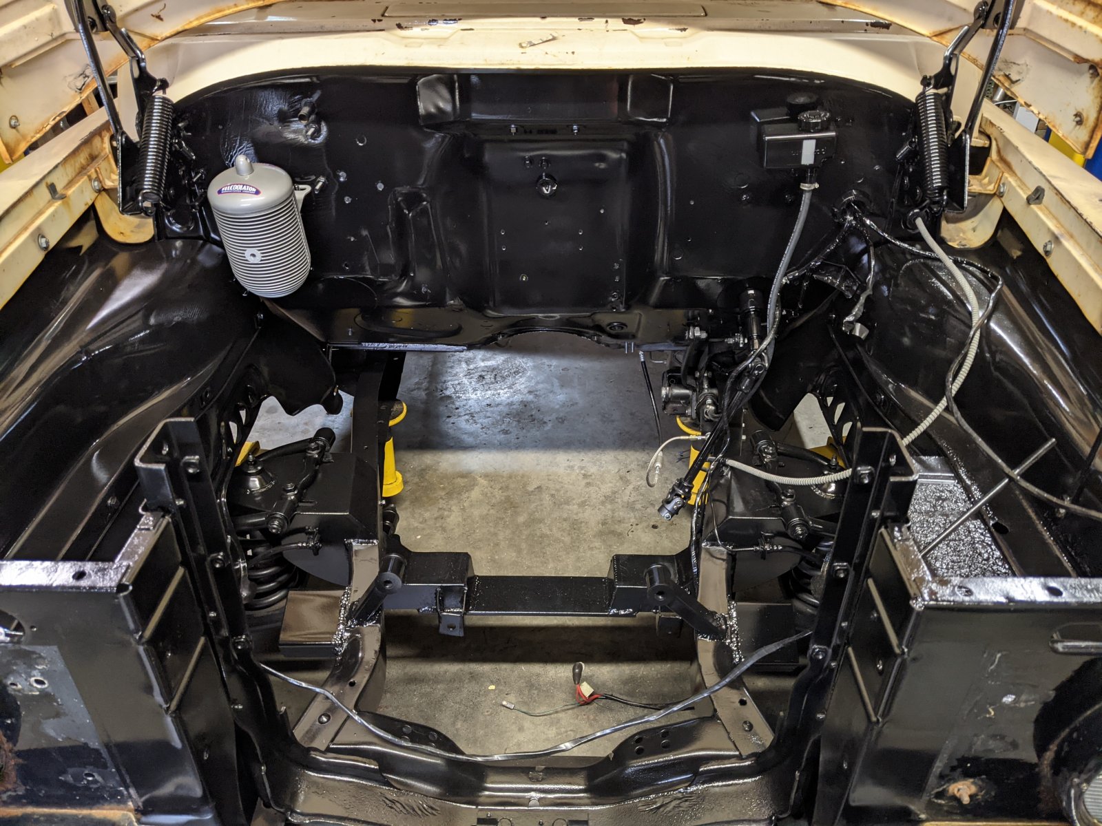

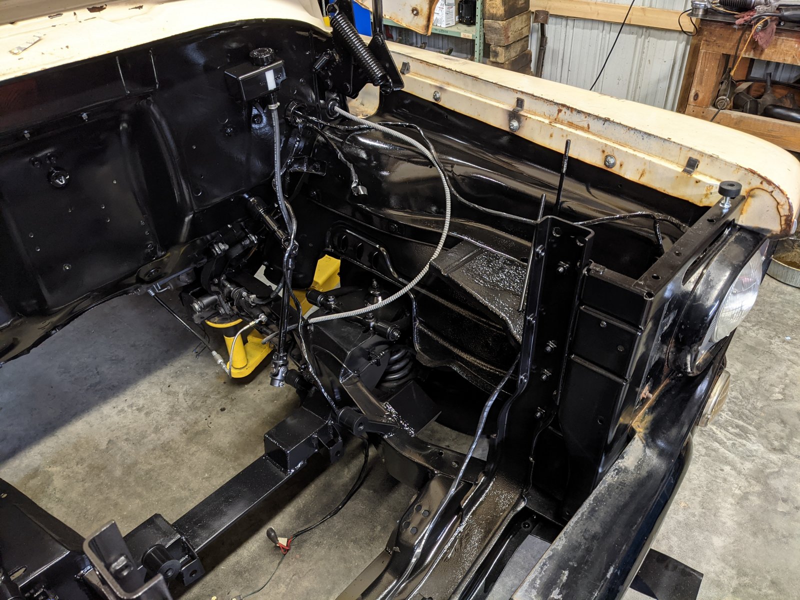

    Took advantage of the warm day yesterday before the rain and cold came in to get the engine bay painted. At first I had planned to just paint the parts of the frame I had to rework to get the hemi in there since the black wasn't too bad, but after the work I've put in to the engine I decided I'd be better off the spruce up the whole engine bay. I wish the truck had still had the original steering and suspension when I got it as it was the main hindrance to getting the engine in. I taped up all the wiring harness and got rid of all the zip ties that have cut me on more than one occasion, taped everything off and got to painting. Hope to get the engine and transmission in tomorrow or Friday. EngineBay2.jpg EngineBay.jpg EngineBay4.jpg EngineBay6.jpg EngineBay7.jpg EngineBay5.jpg
  4. Zuffen
    Joined: May 3, 2013
    Posts: 270
    Zuffen
    from Sydney

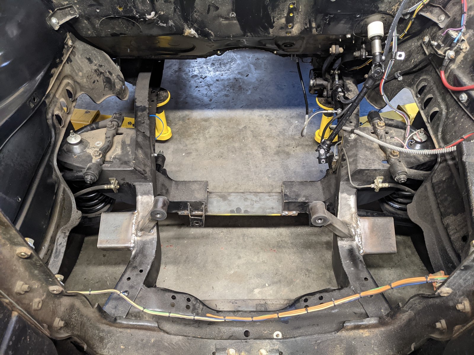

    The angle the steering universals go through is a bit scary!
    alanp561, Wanderlust and MRW1994 like this.

    Looks bad in the picture but it takes a lot straighter path when everything's hooked up!
    Thanks for the tip @loudbang I'll definitely be using that as there's still at least a thousand more throughout the truck!

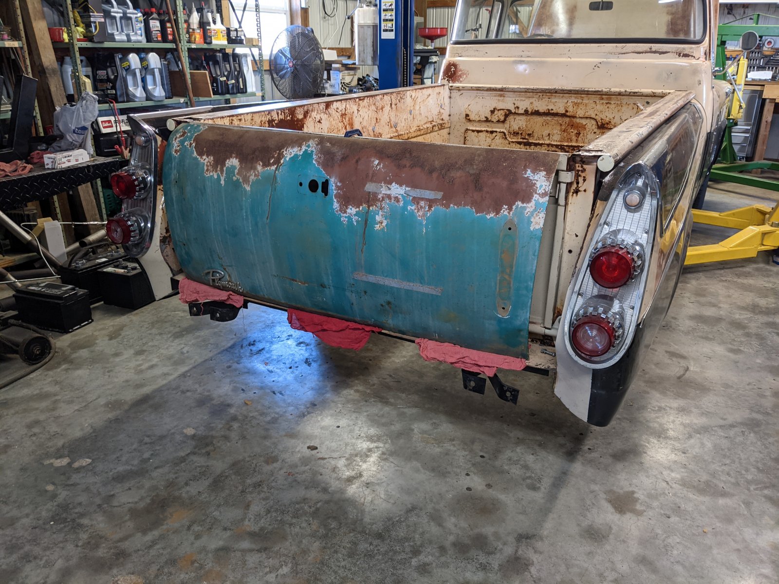

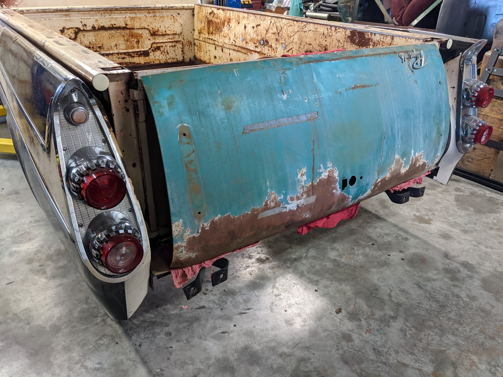

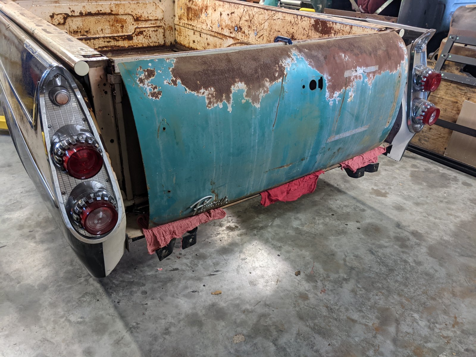

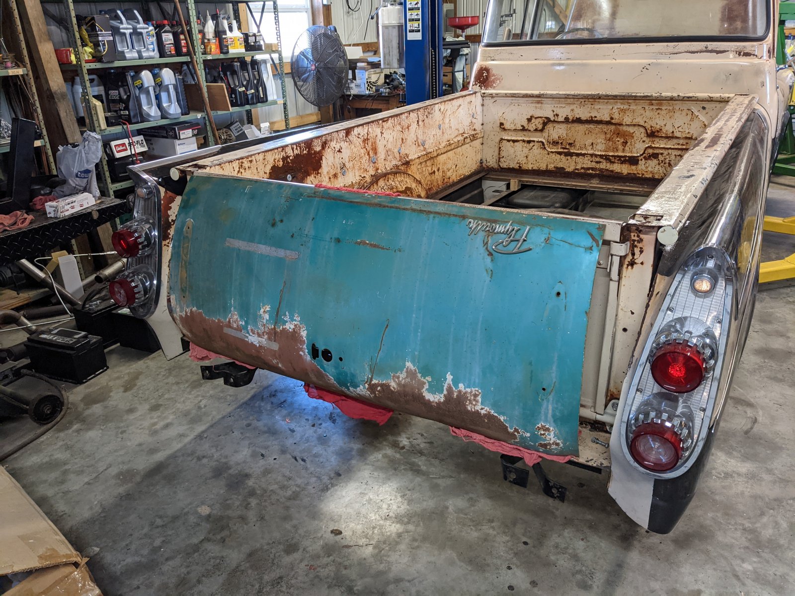

    Thanks @bobbytnm! My '59 Plymouth wagon tailgate showed up today as well. I took some pictures with it just leaning on the regular tailgate. Here's a couple with it right side up. Tailgate2.jpg Tailgate3.jpg
    I also took a few of it upside down because the curve at the top of the tailgate matched the side panels a little better just sitting there. Tailgate.jpg Tailgate1.jpg
    The width of the wagon tailgate is the same as the truck tailgate so I'm going to take off the flat tailgate tomorrow so the top can go into the bed to better see what it will look like. This also makes me think it might end up being easier to extend the side panels to the tailgate instead of widening the tailgate as @Crazy Steve mentioned in an earlier post.

    I looks like its going to take some doing to get that wagon tailgate to work. I think you might be onto something with turning it upside down. It really seems to match up better that way. I'll definitely be keeping an eye on your progress as we'll probably try to do something similar on my buddy's truck.

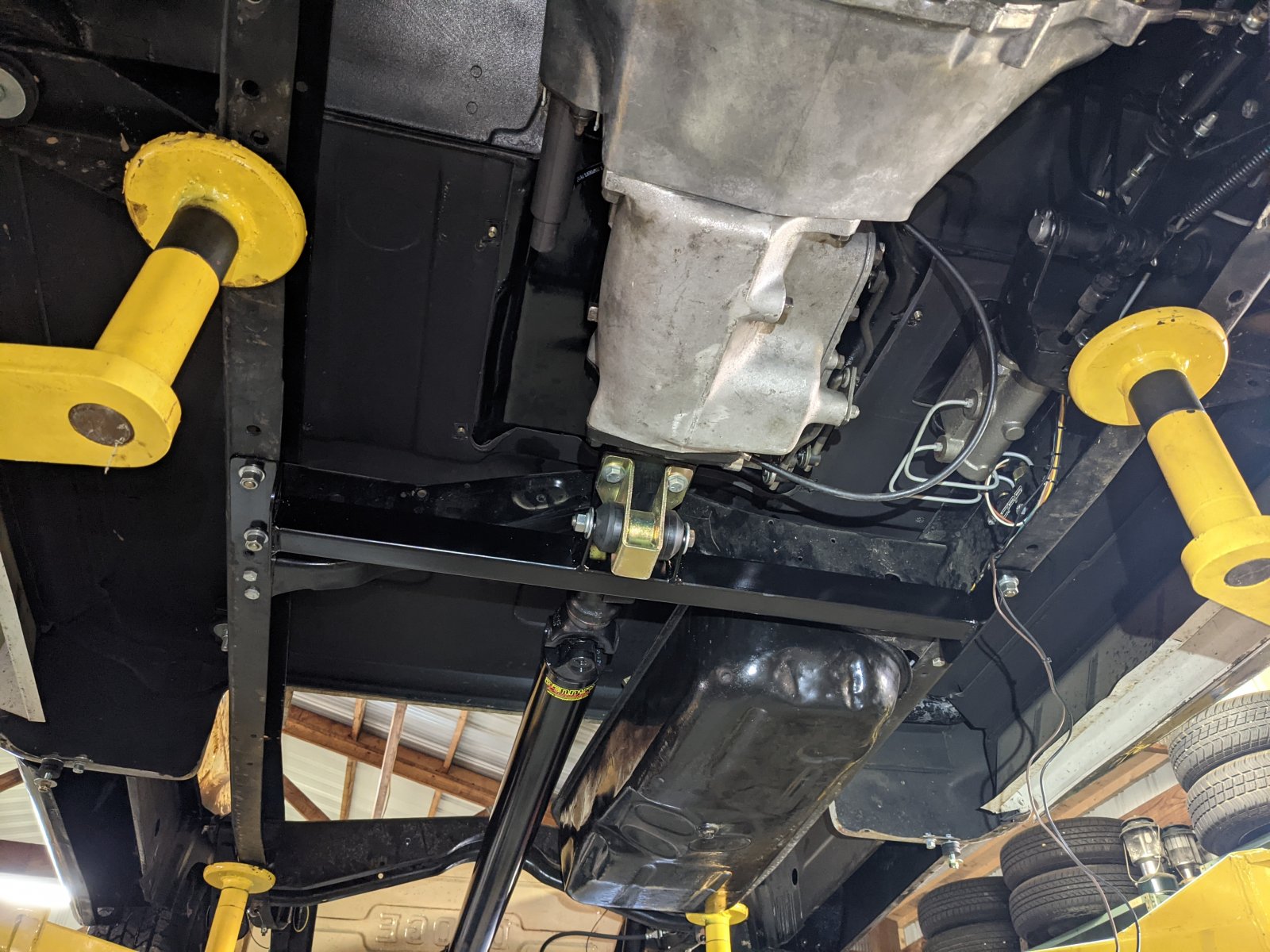

    I didn't work on the tailgate today like I planned but I did get my new driveshaft hooked up. Here's some shots from underneath. Drivetrain.jpg Drivetrain1.jpg
    The driveshaft that was on it when I got it was marked as being out of a 90's Chevrolet and was too long so that when the truck was in the air the slip yoke bottomed out against the output shaft. I also had to mock up the carb and cleaner to see it all together. EngineTruck2.jpg EngineTruck3.jpg
