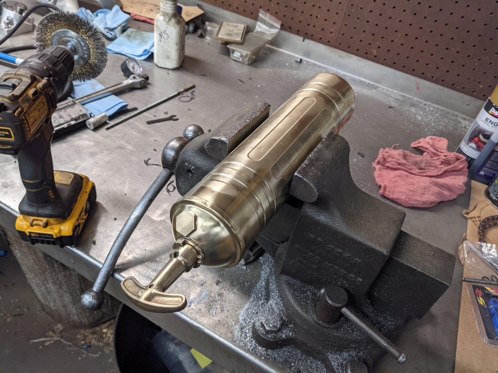

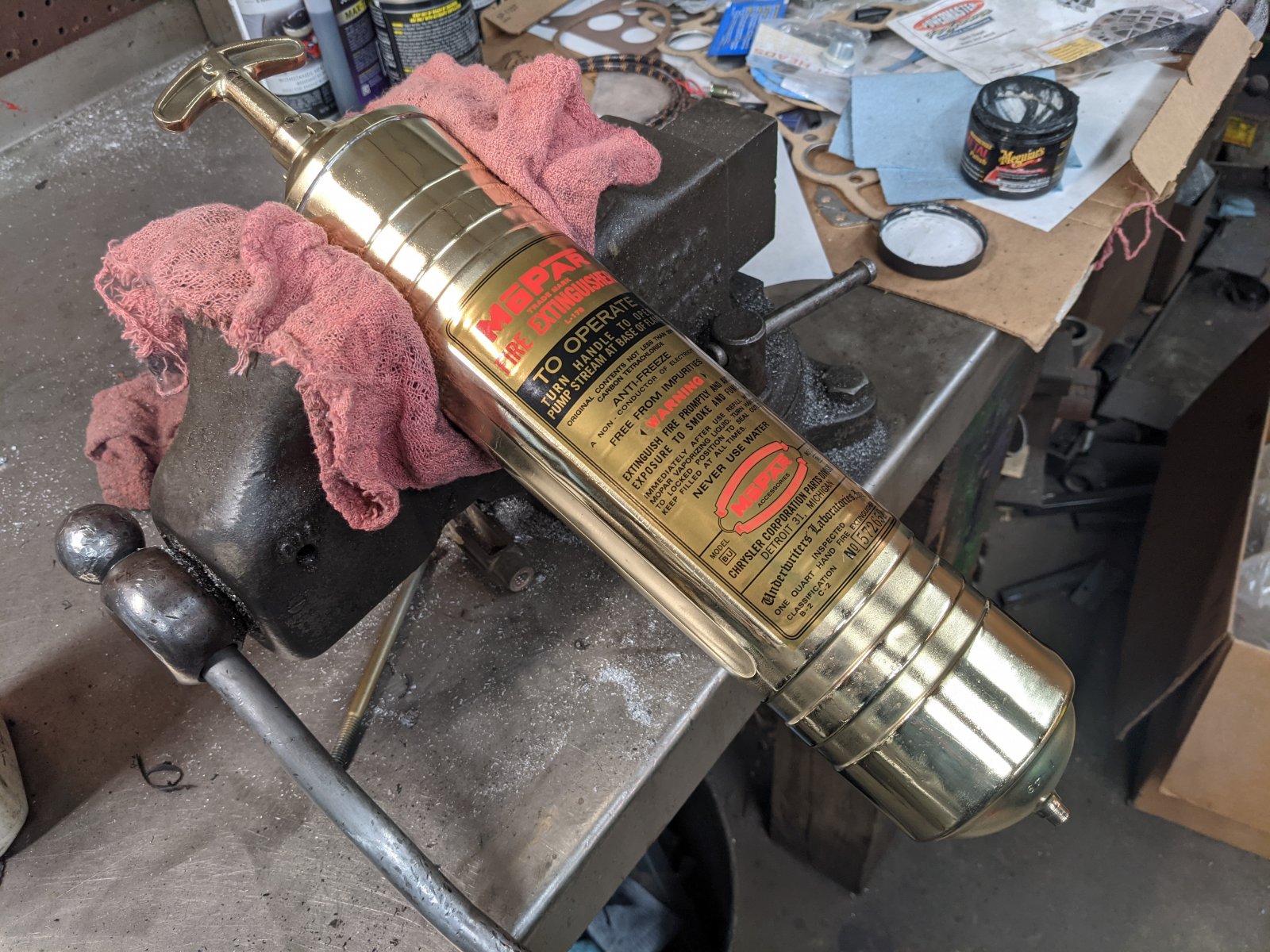

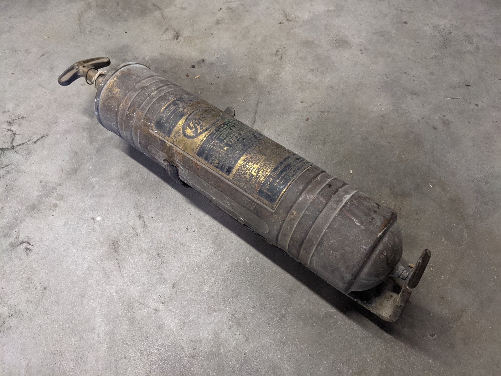

    I spent most of the day working on this old fire extinguisher. Extinguisher1.jpg
    I'm really like all the old Mopar accessories and always thought the fire extinguishers like this one... MoparExtinguisher.jpg ...were cool but they don't show up often and always go for more than I am willing to give. I ran across a guy that makes a decal like this and I thought I'd try to make my own out of the easy to find Pyrene extinguishers. I wired wheeled it off and polished it up a little. Extinguisher2.jpg Extinguisher3.jpg
    Not the real thing but I've got about $40 dollars in the whole thing and that's a little bit more my speed! I am thinking about maybe mounting it on the flat spot on the inner fender in the engine bay. Extinguisher5.jpg
    I'm not sure what time period the Mopar extinguishers were available as an accessory, probably not the 50's, but I do like the look of them.

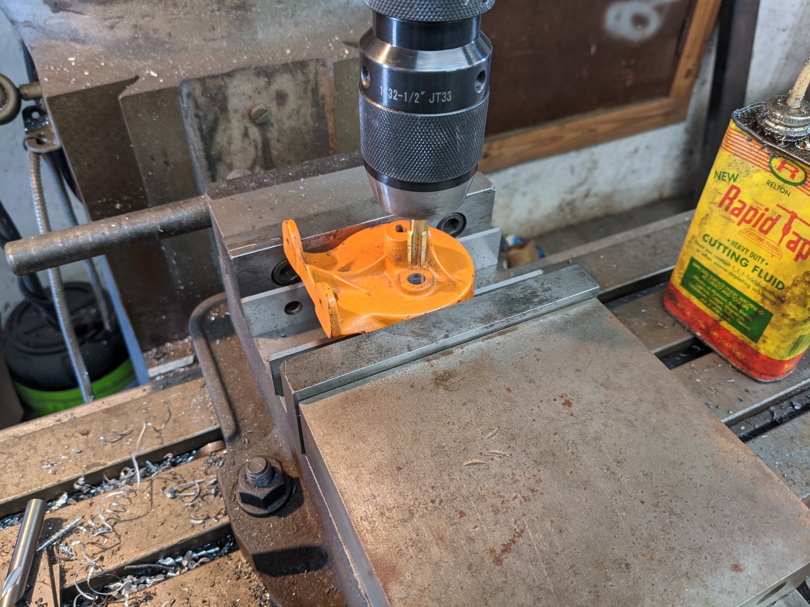

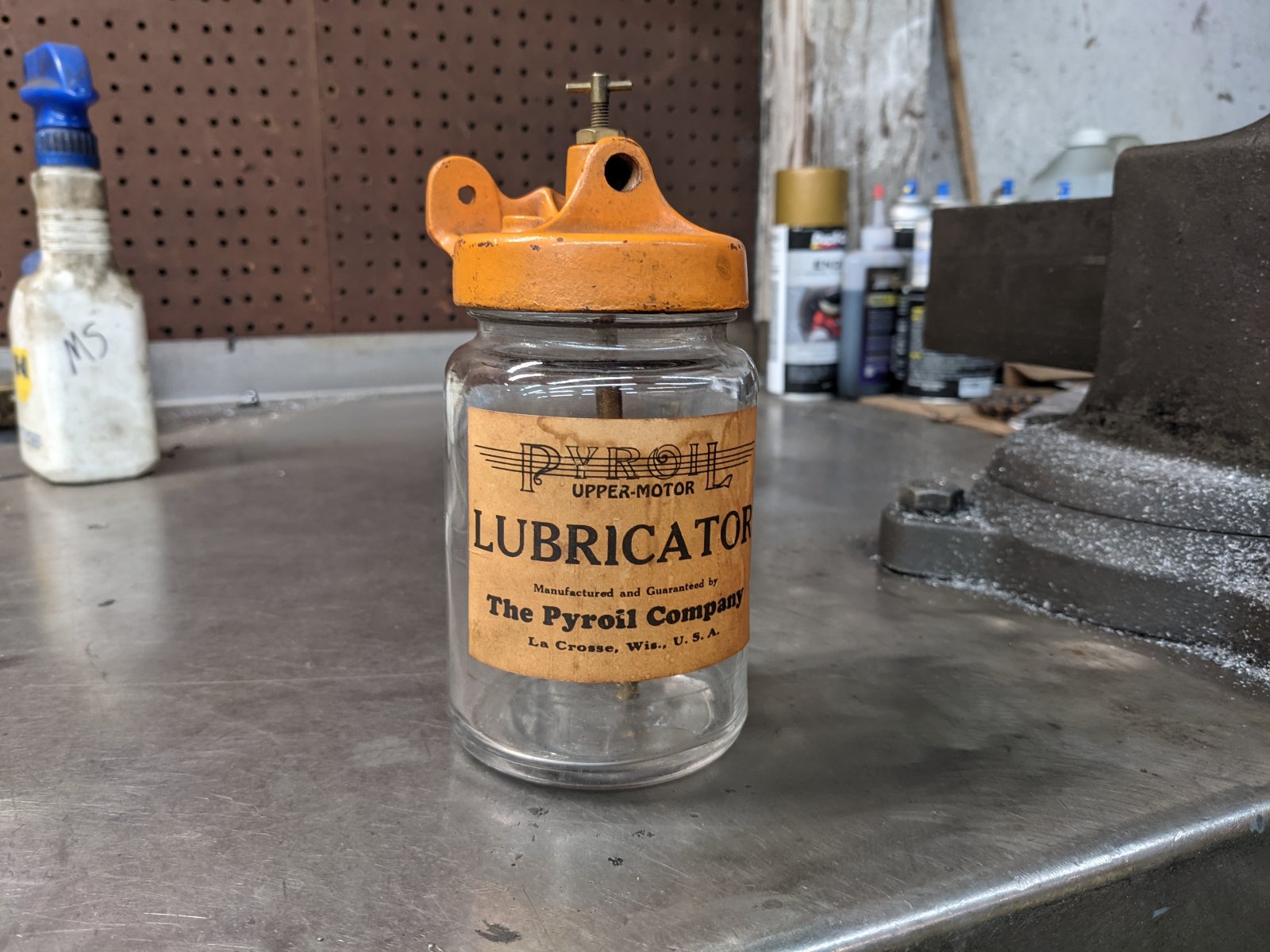

    I got this old Pyroil Upper Motor Lubricator a few days ago not knowing what I would do with it but just thought it was interesting. Catchcan.jpg I got to thinking with a little modification that it would be a pretty neat oil catch can for my PCV system instead of the cheap one I was using on the stand. Catchcan1.jpg
    I removed all the oil metering internals. From what I've read on here about these old top end oilers they don't serve any purpose. I don't see how this particular unit would've drawn any oil into the engine because the pickup tube is full of cotton packing that air wont even p*** through and there's a hole in the top of the tube, where the red paint is, right were it was drove into the housing. Looks to me like it would've just been drawing air with little to no oil. Catchcan2.jpg
    Then I added another hole for a pipe fitting in the raised boss on top for an outlet. Catchcan4.jpg Got it painted and mounted on the firewall. Now all I need are some fittings so I can hook it up. I think it should work pretty good. Now that it's got some distance from the valley pan it might not draw that much oil vapor up to it but I still like the looks of it.

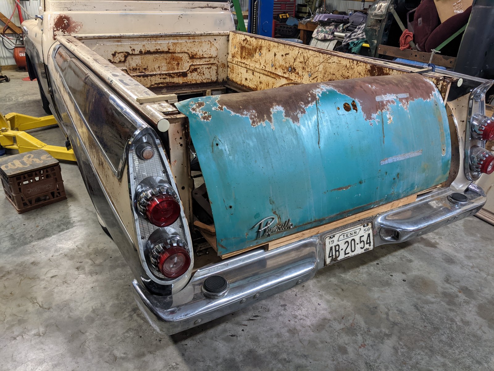

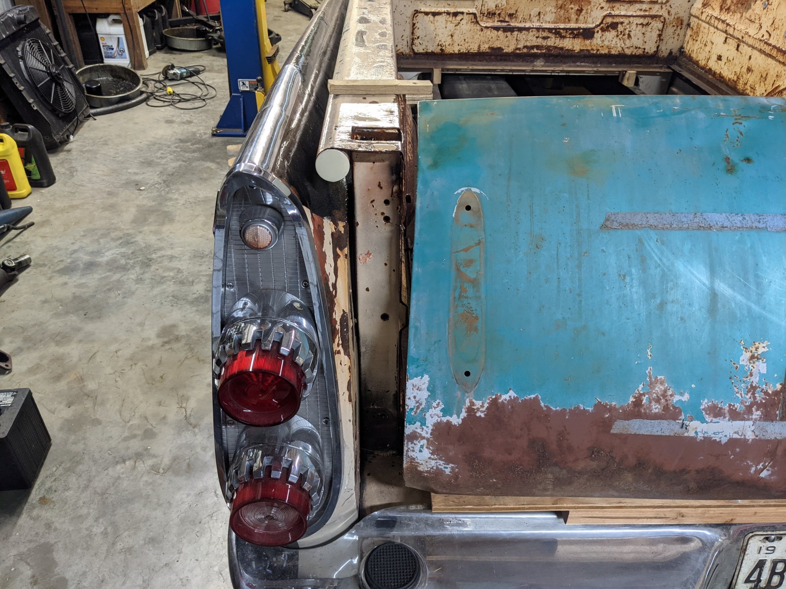

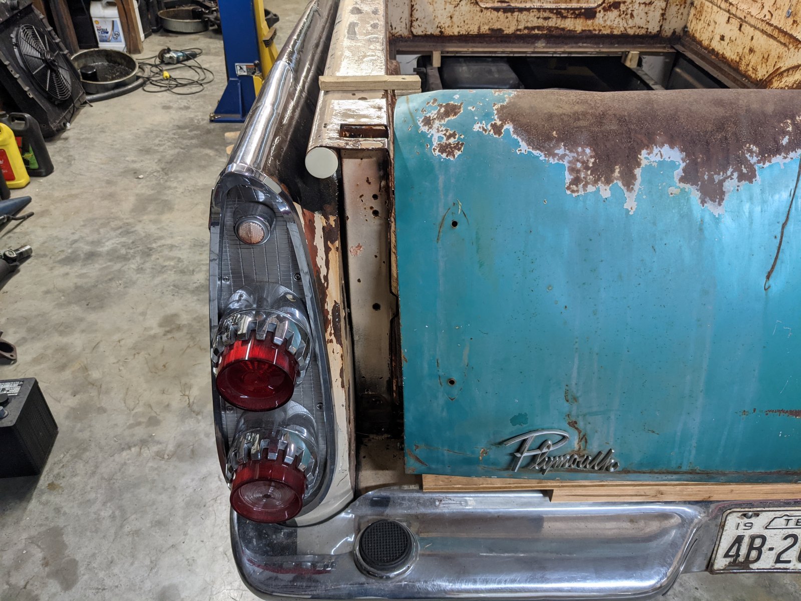

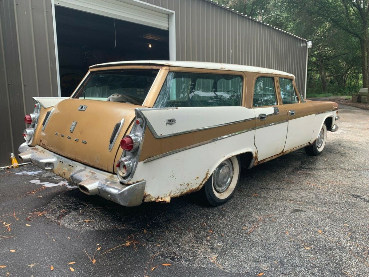

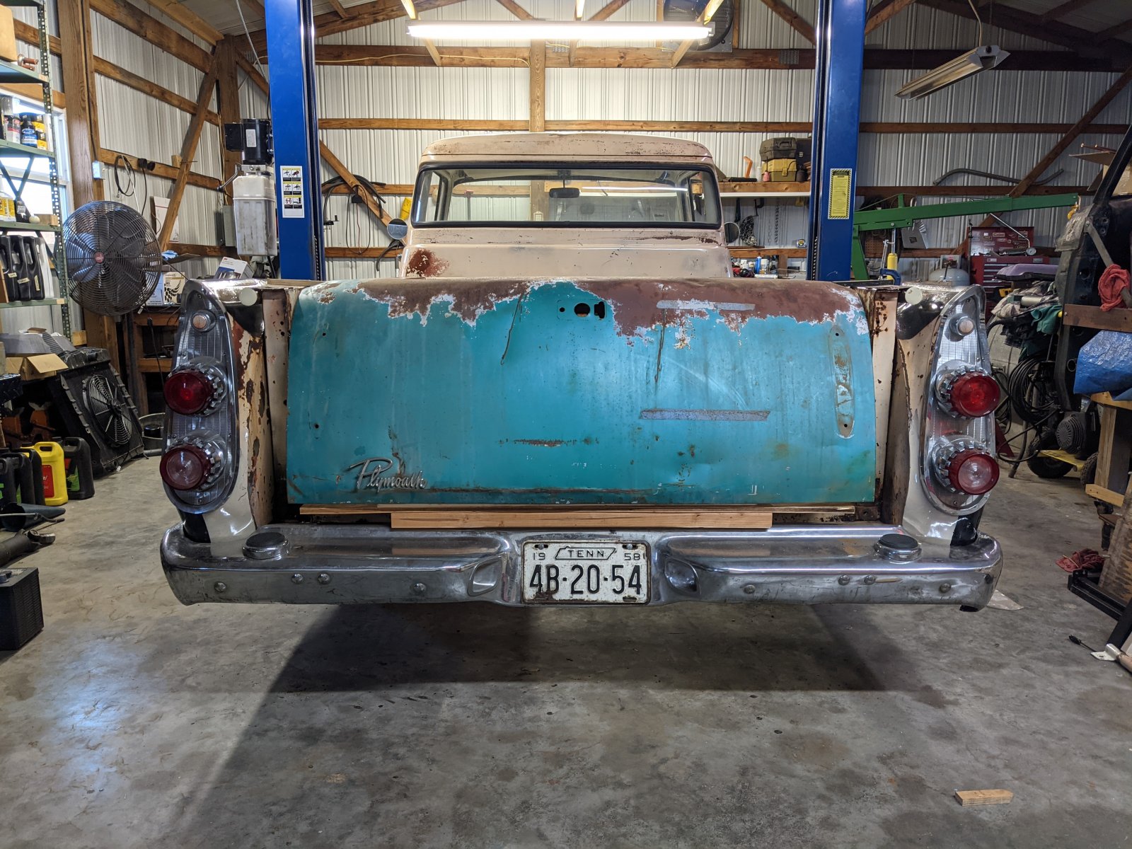

    Got the tailgate off today and messed around with the wagon tailgate a little bit. I also mounted the bumper so I could see where everything should be. While it looked like it might have worked better upside down when I first leaned it up against the regular tailgate, it looks like it would work a lot better right side up. The tailgate tapers towards the bottom and when upside down doesn't match up vertically with the side panels and leaves a large gap at the bedside. Tailgate6.jpg Tailgate7.jpg
    This looks a lot better and shouldn't be hard to make a sheet metal piece to bridge the gap. Tailgate5.jpg
    To get it to start matching the curve of the side panel it has to be raised above the bumper. Here it's still not matched up perfectly with the side panel curve but I was having a hard time keeping everything balanced. I'll have to make some kind of temporary hinge or something to help hold it in place. Tailgate4.jpg
    This is with it raised 2-1/4" above the top of the bumper. The bumper pads could be easily moved inward since they're kind of set pretty far out. Tailgate8.jpg

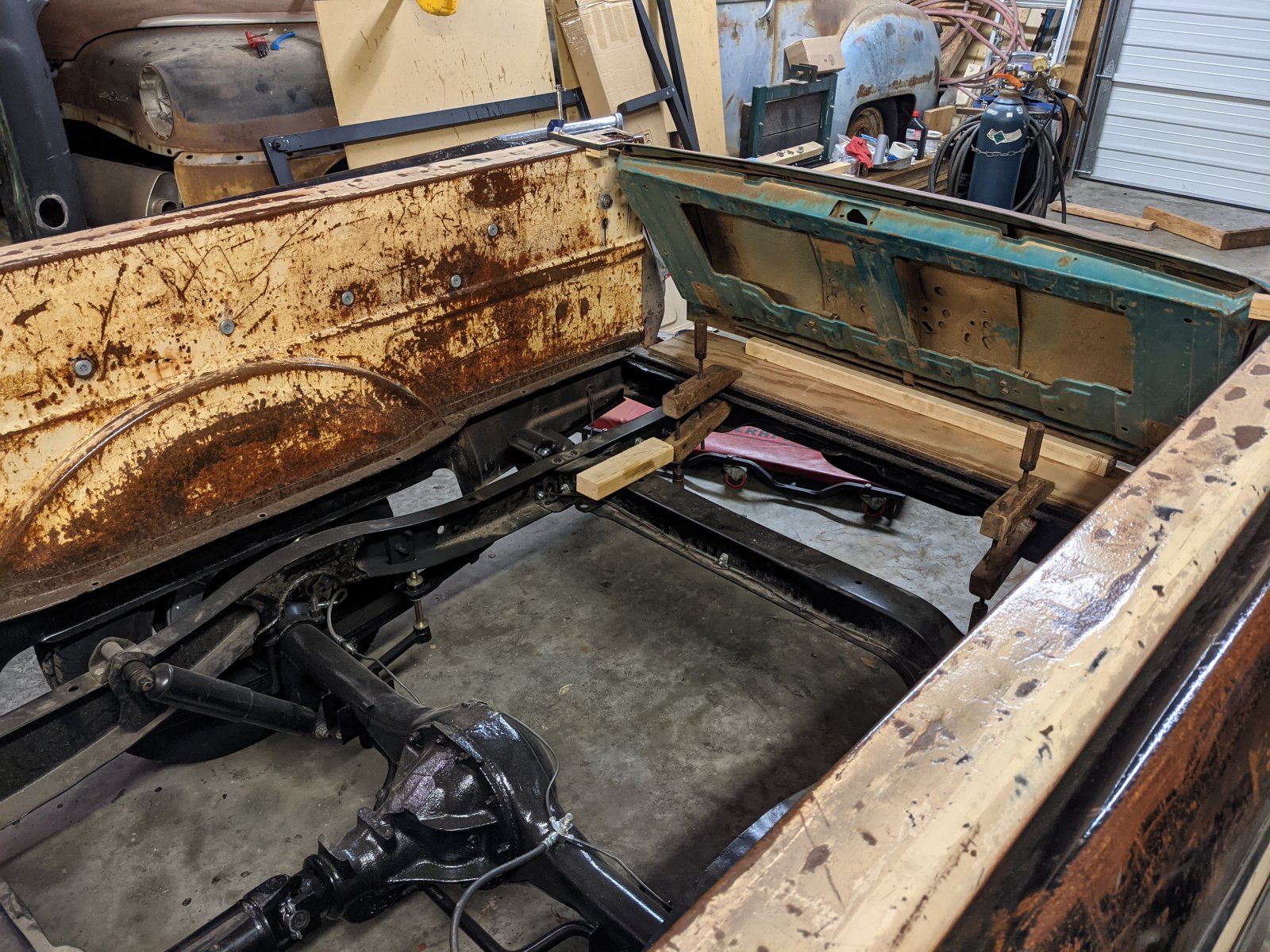

    Here's a picture from the inside of the bed. Right now I'm wondering if maybe something like a large diameter barrel style hinge could work on the bottom of the tailgate that would also help take up the gap at the bottom between it and the bumper. What do y'all think?

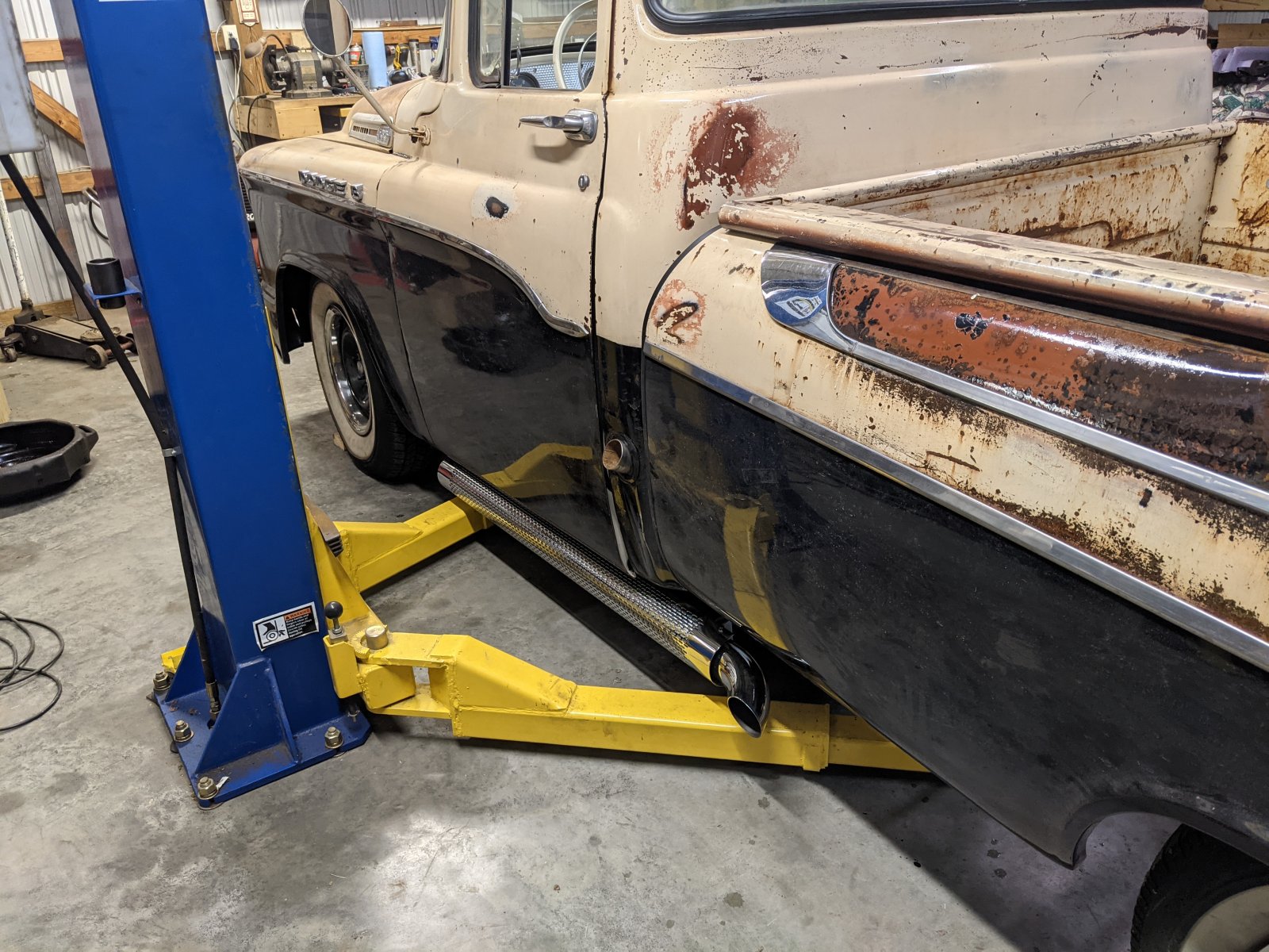

    I got all the exhaust ****oned up today. I'm not sure what the general feeling towards side pipes are around here but from a search of some older threads it looks like they might not be too popular so here's just a few pictures from underneath. Exhaust1.jpg Exhaust.jpg
    I like the look of them a lot. They are what I was using on the run stand and I really like the sound of them too.
