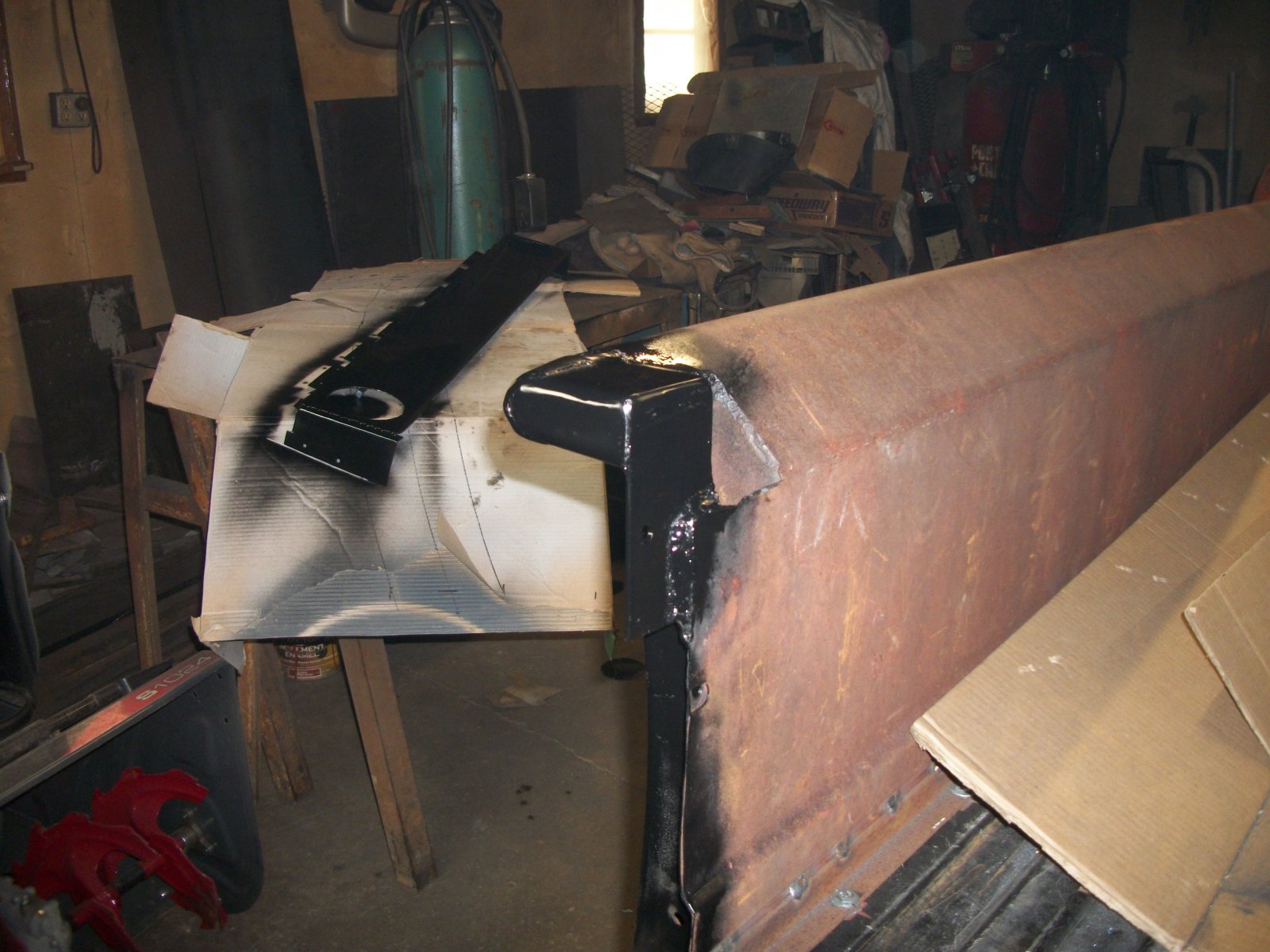

    One other variable is the bed sides on the Dodge step side beds that are older then a 56 model year (I believe) have the top of the bed rails angled at 45 degrees rather then at 90 degrees like the bed rails on your truck. On those, the front panel, and the tail gate only come up as high as the lower vertical part before the 45 degree bend. I've raised the tailgate on my truck, and raised up and squared off the front of the bed to match the highest point on the side rails, but the rails themselves are still 45 degree bends.
    My truck came without a tailgate. I bought a mid 70s beat to death tailgate to cut down and modify for my truck. The 1st pic shows the original bed side angle at the top of the pic along with the tailgate clamped into position. All 4 corners of the bed sides have the same gap.

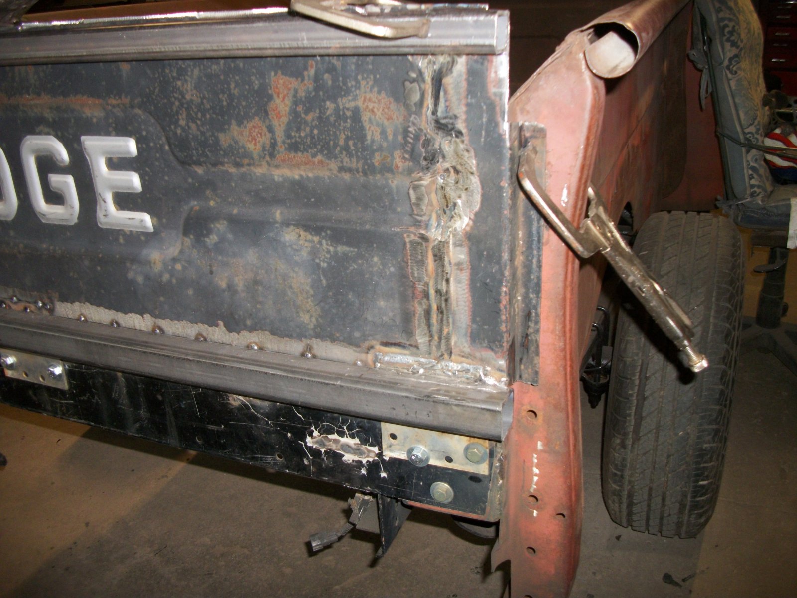

    Pic 2 shows how I filled the difference between the original bed side and the raised tailgate. The tailgate was more robust because the gate opens and closes. The front was much less elaborate, it is always closed.
    Pic 3 is with the tailgate closed.

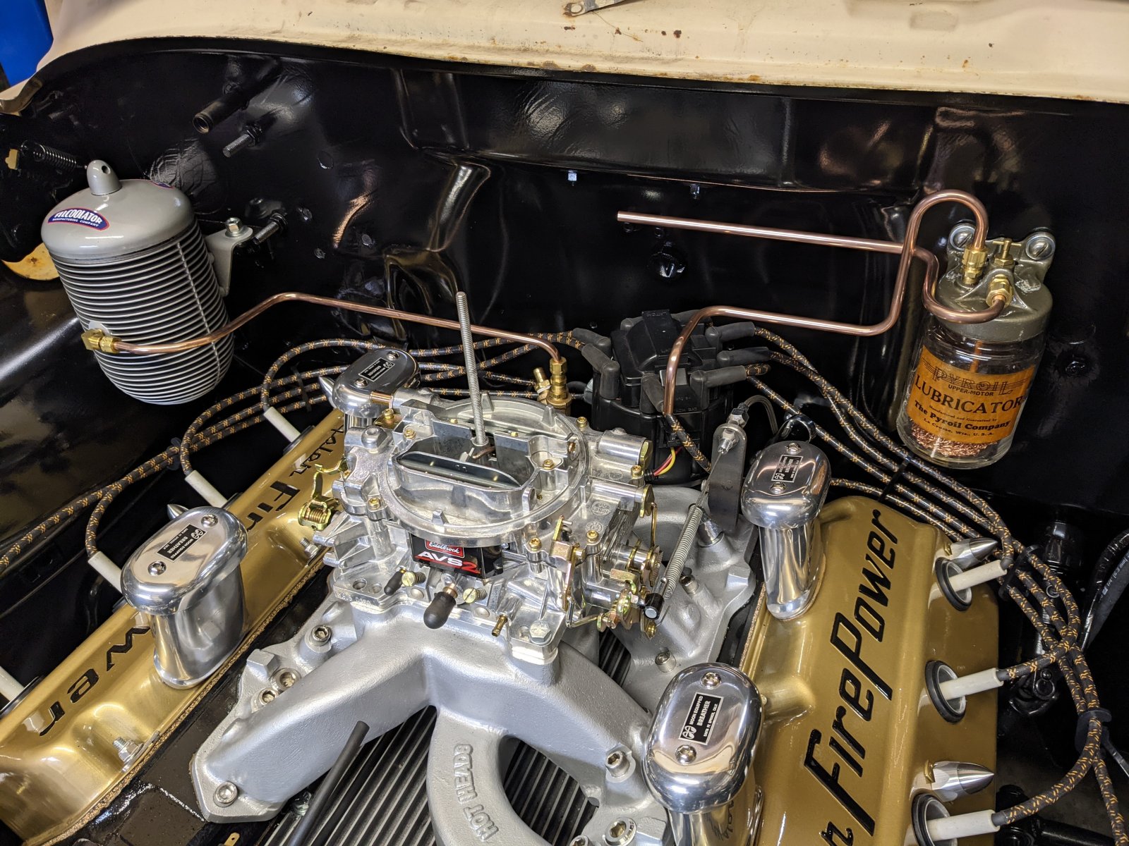

    Decided I would put the tailgate and bed stuff on the back burner for just a minute. Going to try to get it moving under its own power so I can free up my rack when I need to. Got the hoses and fittings for my remote filter headed this way. OilLines.jpg
    Got my bracket made for the throttle cable and the pedal all set up. ThrottlePedal.jpg
    Don't like the aluminum look so I'm going to paint that all black tomorrow before all the rain gets here. Probably wont last too long on the on the pad itself. OilLines1.jpg
    Also got the line made up from the Filcoolator to the valley pan and the lines for my oil catch can. Going to run clear hoses from the PCV valve and valley pan to the copper lines so I can see how it's pulling. I've got the old top end oiler unit sealed up good with a new rubber gasket from McMaster Carr to replace the cork gasket that seals the jar. My only concern is if it might be too restrictive to be able to efficiently pull the crankcase vapors. I'll just have to see how it does once it's running. I put a copper scrub pad in the bottom below the copper tube to help capture any oil vapor that might make it that far.
    Have a few more things to do like running the choke cable and mounting my gauge panel under the dash before I get started wiring. Saving that for last because electricity and I don't get along too well!
