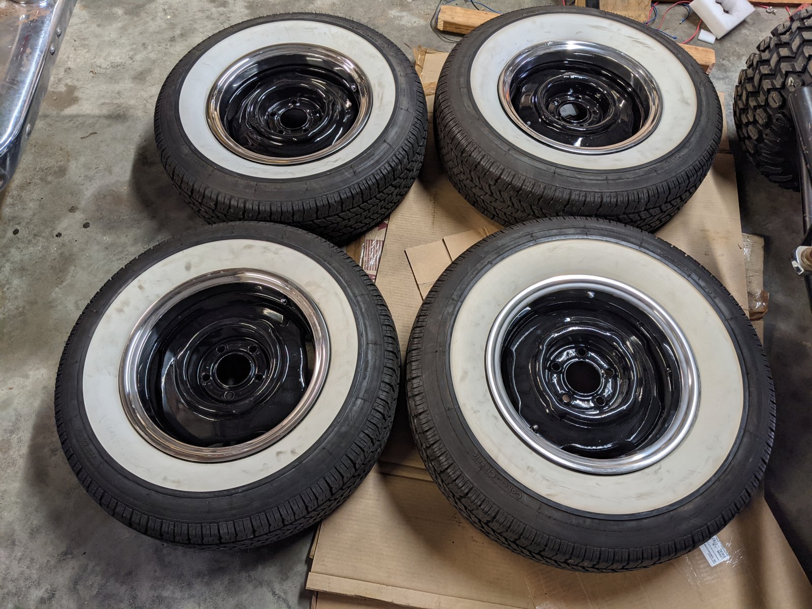

    Took the wheels off today to have the tires switched to another set of steel wheels I repainted. Wheels.jpg
    I figured I'll run these Cokers for a while since they're pretty much brand new. I looked up the Diamond Back tires after seeing some folks talking about them on here and I really like the looks of those. Probably won't take me long to wear these down so maybe that'll be what I get next! Wheels1.jpg
    After a pretty good bit of scrubbing with a br*** brush and Bleche Wite they came out looking fairly well. Did this on the old wheels so I didn't have to worry about messing up the paint on my new ones. The wheels that were on the truck when I got it are a completely mixed set except for the two with the smooth tapered centers that I think might be Ford wheels? I had the wheels on the right that came off the Plymouth I traded for the truck. That's also where the beauty rings came from. They're still a mixed set with two of them with three hubcap nubs and two with four of them. They had the same offset though so I repainted them for the truck. I'm not familiar with the different styles of steel wheels so I'm not sure what style would have been original for the time. Wheels2.jpg
    Didn't lose as much paint to the tire store as I figured but will have to clean up the tires again. At least the heavy scrubbing is out of the way. Polished up the beauty rings and put them on after I got the wheels back. I'm figuring I'll try bleeding the brakes tomorrow while the wheels are off.

    I use Mr. Clean Magic Eraser on the wide whites. Works great!

    I've used the Magic Eraser too, works quite well. I've been told that Bleche White is not healthy for tires... can anyone verify that?

    @pprather and @Jacksmith I'll use a Magic Eraser next time as I bet that does work good. I'm not sure about how the Bleche Wite affects the tire but from some of the reviews it looks like the new version isn't near as strong as what it used to be. I think most of what cleaned up for me was from the br*** brush. The spray didn't seem to really pull the dirt out that much.

    In the 80s I used either regular old Comet Cleanser or what was originally Westley's Bleche-Wite with a scrub brush.
    The Bleche-Wite is no longer Westley's and you're right it doesn't seem to work as well. You can find people that have new/unopened bottles of it online for crazy amount of money, so there's something to that.
    As far as hurting the tires I never experienced any negative effects from using it on several sets of tires.

    I can... I started using purple power after watching a set of whitewalls turn to powder using bleech white for years.

    You just must not be smoking the tires enough :) My tires didn't last long enough to notice:D
    Seriously though, I never had any issues. I'm guessing that the climate of the Seattle area in much different than Texas and probably not as harsh on rubber.

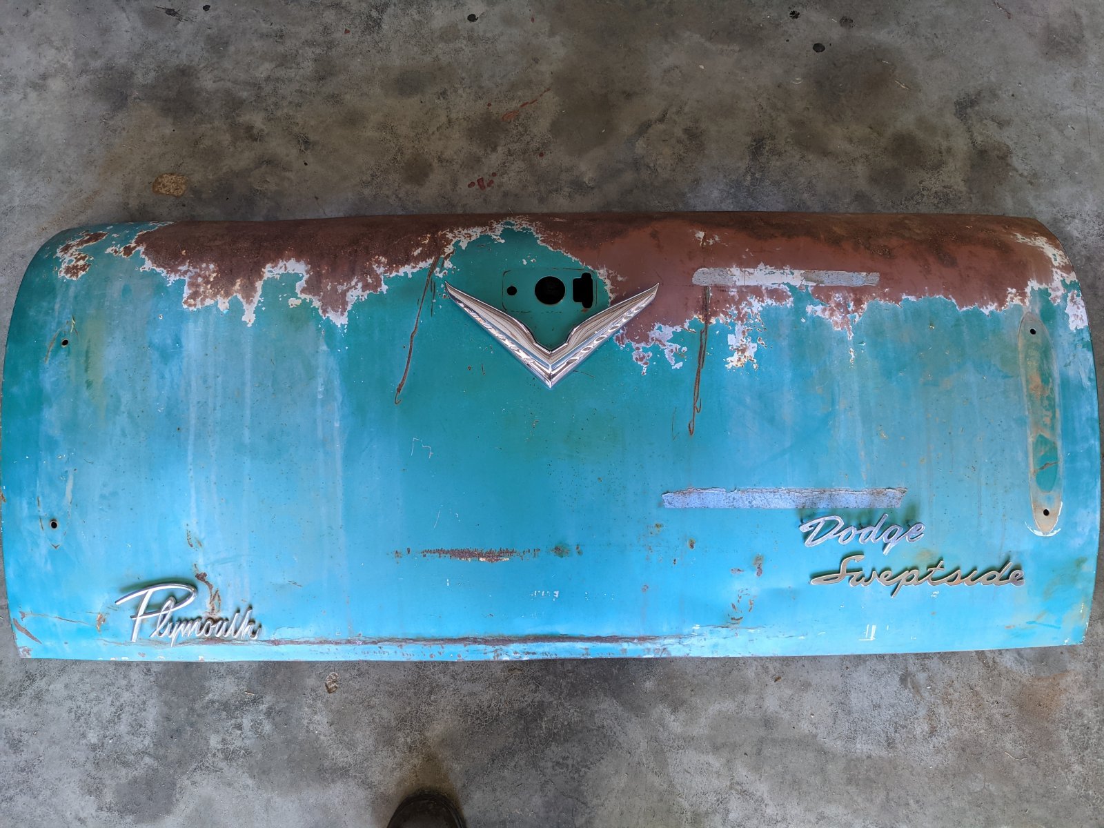

    I'm anxious to see how the tailgate turns out!

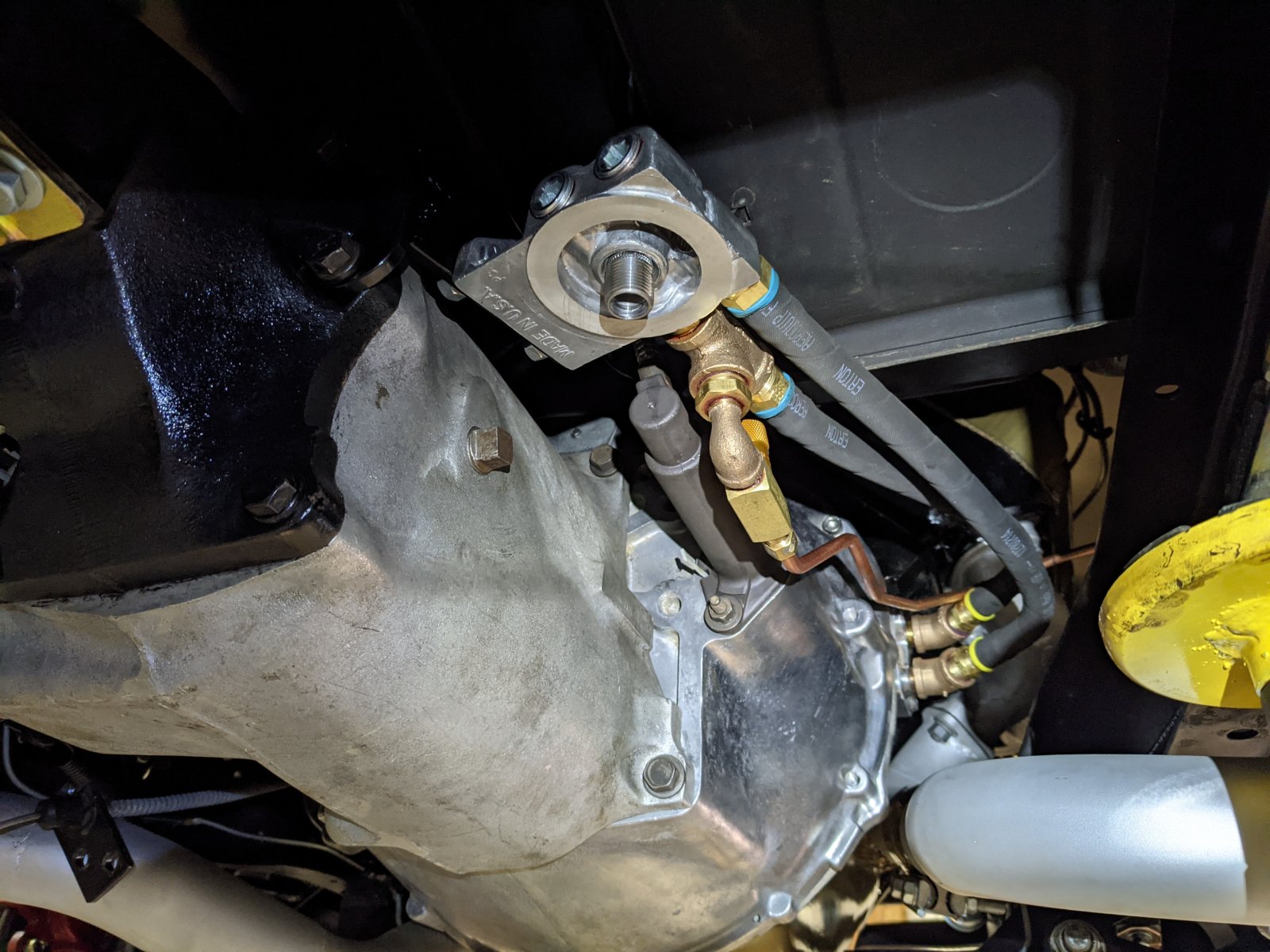

    After an initial mess up installing the hoses for my remote filter I think I've finally got it all hooked up. OilFiltration8.jpg
    I should have done more research on the correct way to install the hoses beforehand as I messed up the end of one of the hoses the first time around. To make up for the length I lost I ended up using a couple of 45 degree fittings at the block with a push on fitting that swivels until tight. As long as it's leak free I'll be happy!
    I took a shot at bleeding the brakes today. First time I've tried it without another person. I've got one of the Mityvac hand pumps but have never had any luck with it. I tried the hose submerged in a jar method and got a good bit of air out of the system. I ended up with a little bit of pedal and also found a leak at a tee fitting that I think I got fixed. I'm going to go all around it again tomorrow and see if I can't get a better pedal.

    I pretty much use a helper to bleed the brakes. My wife has become good at pumping the pedal and holding it until I say to release.

    That's to make the byp*** filter on the firewall functional. Even though unnecessary I figure worst case if it doesn't work like I think it will I can just shut it off and at least all the lines are run for looks. With the engine being fresh and the high volume oil pump the oil pressure is in the 70-80 range when it first starts up running 10W-30 oil so I don't think it'll hurt nothing to send a little bit up top. I'm not going to open it up a whole lot though.

    Comin' right along! I've had one of those Mityvac bleeders forever. Worked on everything... except my Dodge ha. I tried back feeding the from the calipers to the master. Didn't work. Even tried the ol open the bleeders and walk away gravity method. Nope. All that worked was the hose in a jar while I pushed/held the pedal. Got great pressure now. Congrats on getting featured @MRW1994 !

    Thanks @60Pioneer! I went back around it today after fixing the leak and bled all four of them again. Feels like a pretty good pedal now and no leaks. I forgot to mention when I was lifting up the carpet to get to the master cylinder I found a shorty 7/16" Snap-on wrench under there. Made me think of the Where are my tools? thread. Probably someone out there still hunting their wrench.
    @'28phonebooth I'm also going to make sure to have a piece of rubber hose connecting the copper lines from the valve to the byp*** filter so it's not a rigid connection as you pointed out on the line I had made up from the byp*** filter back to the valley pan. I also appreciate the tip about using swivel fittings on the remote filter hoses. That made things easier.

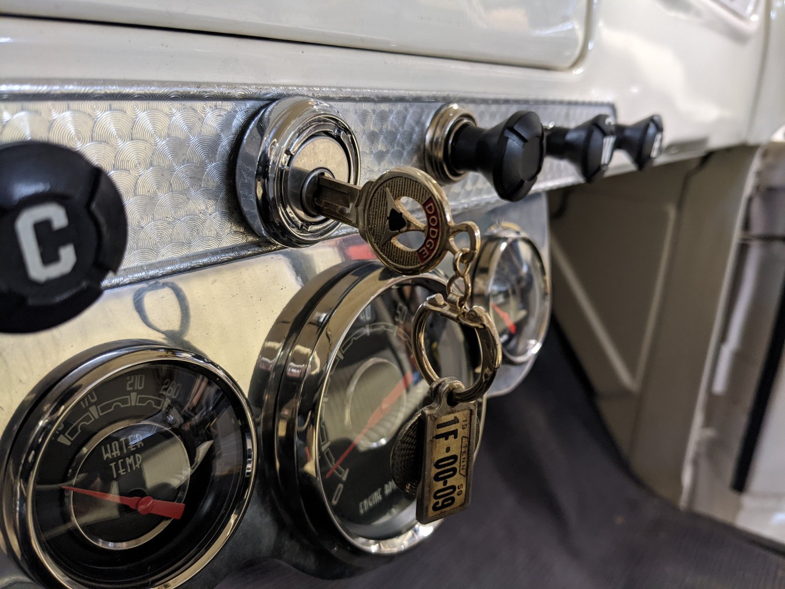

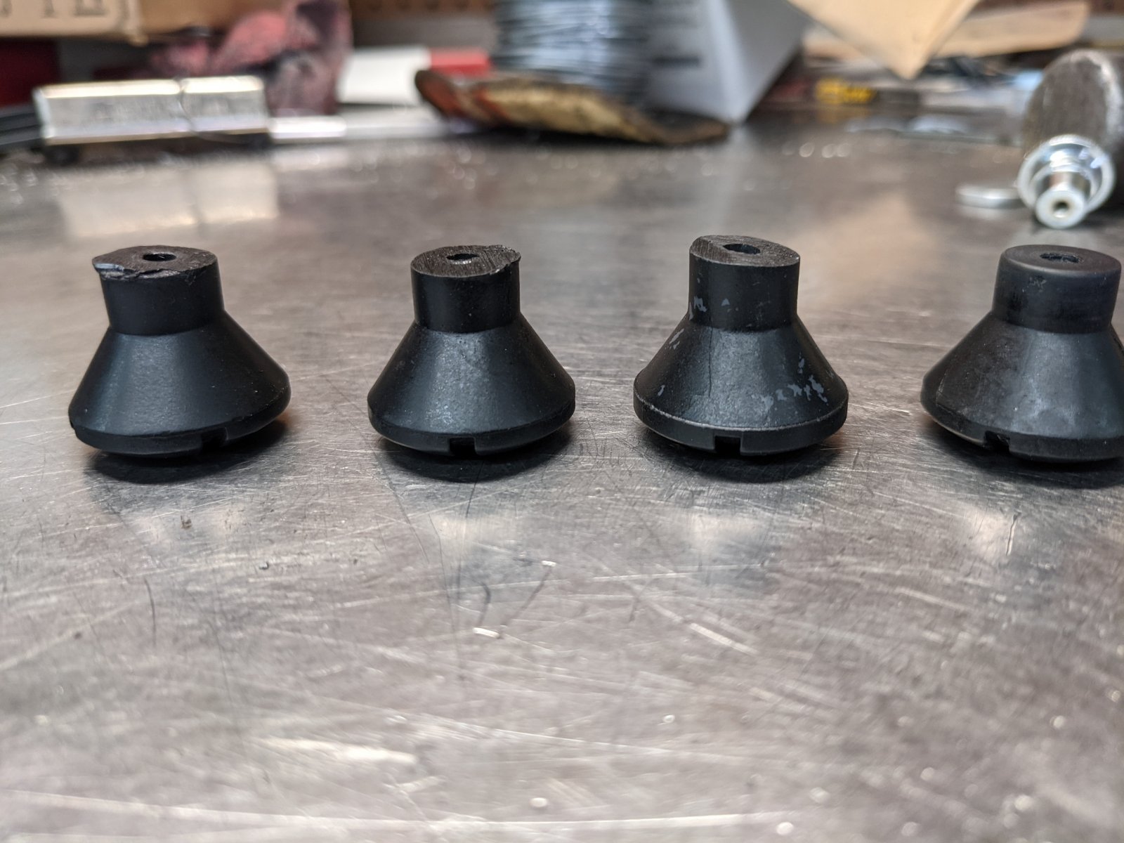

    Not long after I got it the headlight switch had something finally break internally and the shaft pulled out so the only original knobs left were for the wipers and heater control. I also wanted to get rid of the column mounted tach and also the little light that is in between the headlight switch and ignition switch in this picture. It was wired to be a signal for the high beams but it's extremely bright and would light the whole cab up blue. DashKnobs.jpg
    The only reproduction knobs I could find were black. They look pretty good but they were pretty rough on the back and the starter hole on most of them was off center. I put them in the lathe and cleaned them up like the one on the far right and drilled for set screws on the switches that needed it. Dash1.jpg
    Looks a lot better with a matched set. Also got my under dash gauge cluster mounted which did away with the column tach. I got the choke cable run and used the spot that light was in. Dash2.jpg
    Got my new ignition switch wired that I had this old Dodge key blank cut for. Dash3.jpg
    The gauges are right in the way of the cowl vent handle so I'm going to try to fabricate a new one that kicks over to the side and use this one that's supposed to be out of some kind of old Mopar.

    I ran across this '51 Chrysler V emblem that was really clean that I think would look really good on the tailgate. I think I like the '51 Chrysler emblems so much from the different Firepower adverti*****ts and brochures I've collected. Oil.jpg
