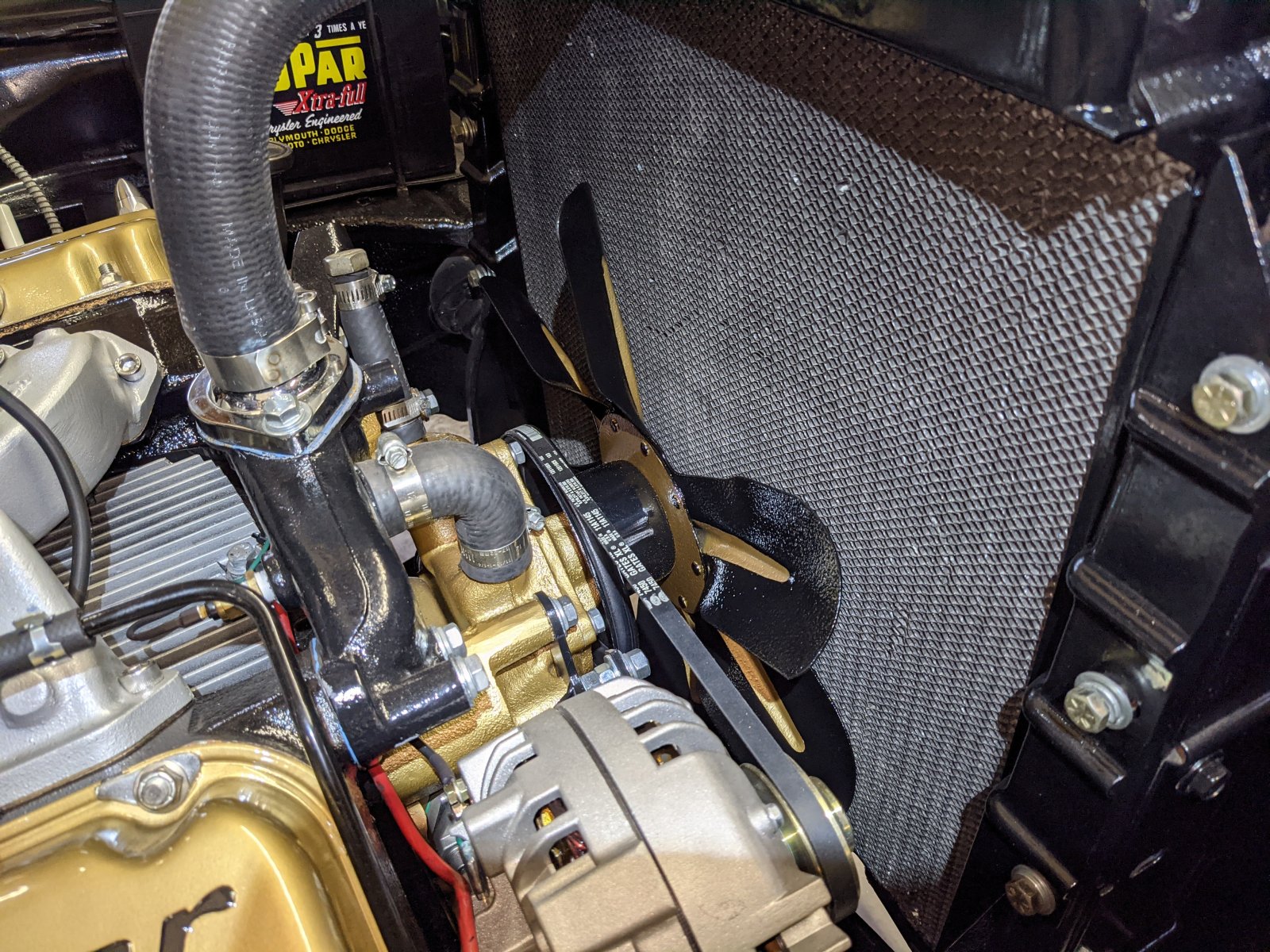

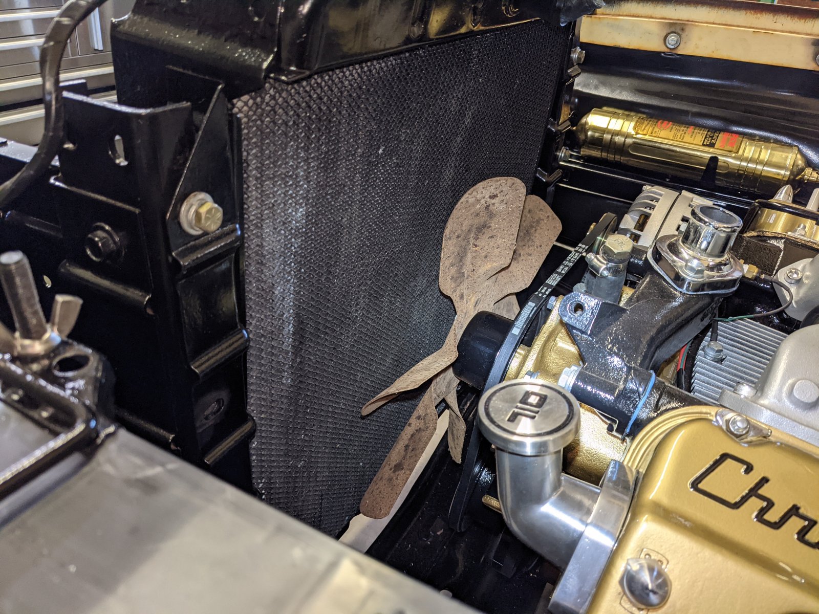

    So after looking through my stuff neither of the 331s had a fan on them when I bought them but I did have a six blade fan off of a Desoto 330 I got that had a busted block. Fan.jpg Fan1.jpg
    It's got plenty of clearance but it's kind of offset more towards the bottom of the radiator. Should this still probably draw enough air to keep things cool?

    There will be those that tell you it wont work down there but my flathead (notorious for running hot) has the fan in the lower radiator and runs cool all day even sitting in traffic. I say your fine but I would suggest adding a fan shroud to direct all the air through that core.

    I would try it this spring without a shroud. It might be ok.
    I ran a low mechanical fan in my Model A SBC with no shroud, full hood, for about 100k miles. No problem.

    A shroud would definitely improve the cooling efficiency if it turns out you need it. Run it without one and then fabricate a shroud to fit if it runs hotter than you want.

    The fan setup.In my Fargo looks the same as yours, keeps the mild 360 cool no matter what, Fan near the bottom and no shroud

    I'm glad to hear that y'all have pretty good luck with a lower placed fan and no shroud. I'll try it like that first and see how it does. I didn't run it for long periods on the stand but it didn't seem to get really hot very quickly. It's got around 6+ gallons of coolant in the whole system so that probably helps.

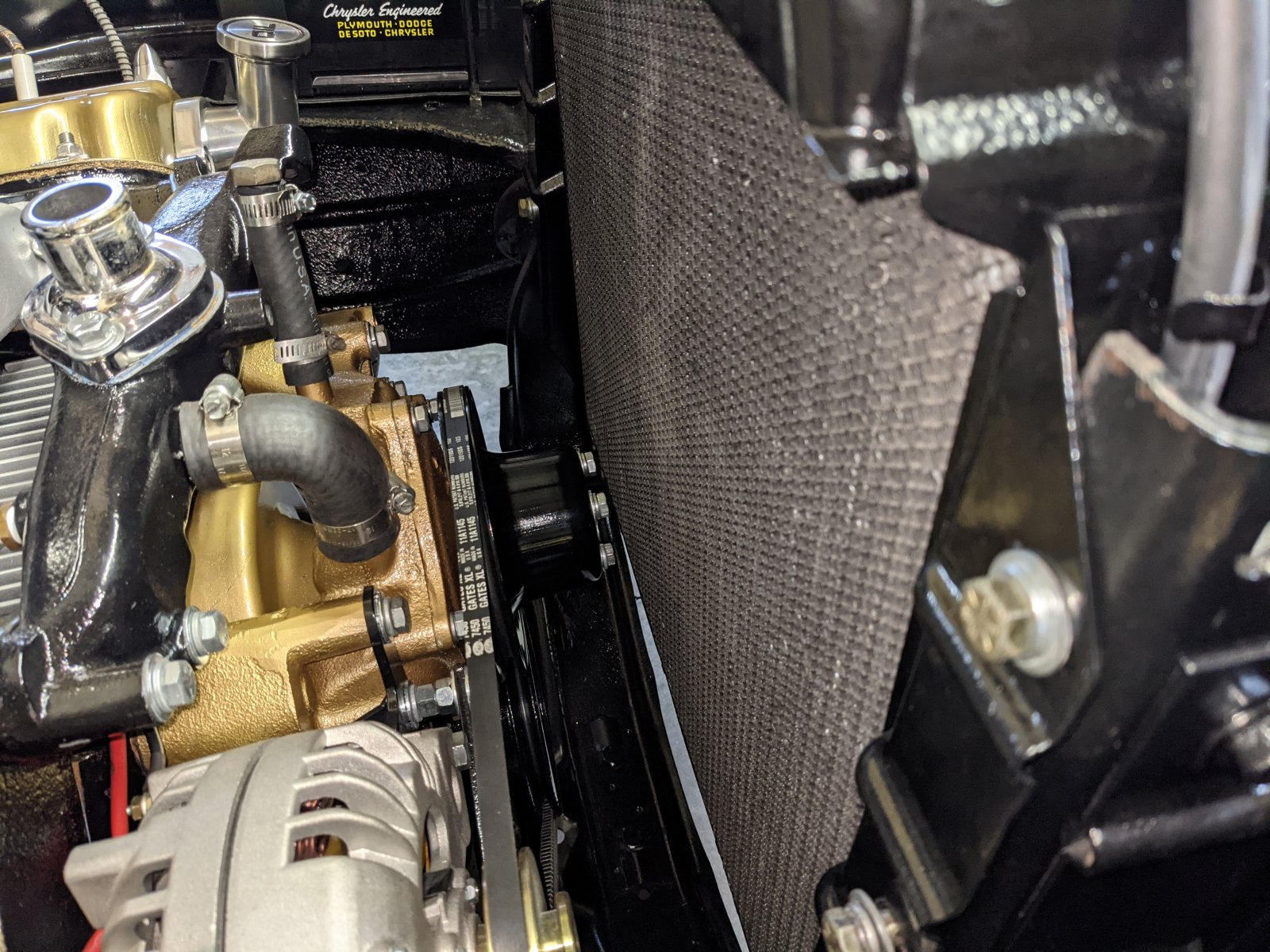

    I'm actually glad there wasn't room for the electric fan and @pwschuh suggested running a regular fan. Like I said I always just ***umed the electric fan would take up less space but I really like the way the fan looks on the front of the water pump.
    I found out the radiator hose I'm using for the top would also work perfect for the bottom. It's a Gate 20603 that I trimmed to fit. The application seems to be for late 60's GM vehicles but doesn't specify if it's a upper or lower hose. There's no spring in it but supposedly the newer materials are resistant to collapsing. I've was looking at some past threads about people sometimes having trouble with lower hoses collapsing so I thought before I put it on and fill the radiator up that I would see if anybody advises against a lower hose with no spring.

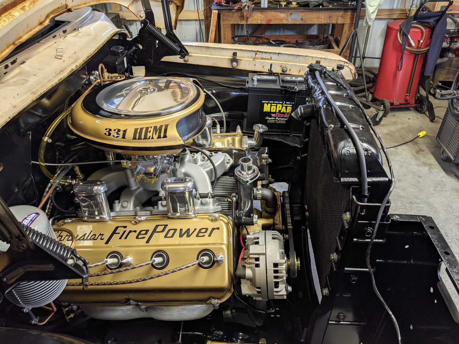

    I was able to get that spring to work inside the lower hose. I filled up the coolant system and finished up my wiring today. At first I thought I had some kind of wiring problem but it turned out to be bad grounding. I ran a ground strap from the battery to the core support and another under a starter bolt to the frame. It was all fresh cleaned metal with dielectric grease. I figured it would've been grounded good but while trying to get the bugs out I found out after cranking on the starter for a minute the choke cable was red hot. That had me stumped until I researched it and found out it's a symptom of bad grounds. I didn't have another cable to run to the block so I'll have to get one. That's why the clamped cable is on the battery in the video.
    It sure did feel good to have it running in the truck. I tested my PCV system with a vacuum gauge before I hooked it up to make sure I didn't have any leaks. It all tested good and you can see in the video it pulling the vapor into my catch can. I haven't tried running any oil up to the byp*** filter yet. There were no leaks so far on any fittings.

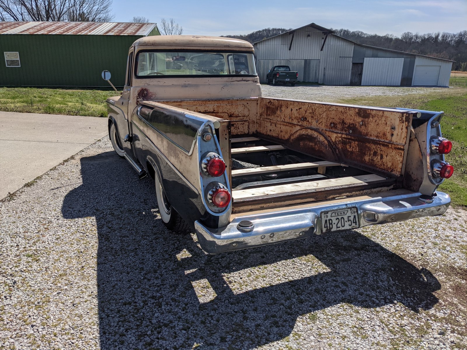

    I took the wheel spacers out and went riding around a little more. Here's a few pictures of it outside. I'll try and get a video of it later. 1958DodgeSweptside4.jpg 1958DodgeSweptside5.jpg
