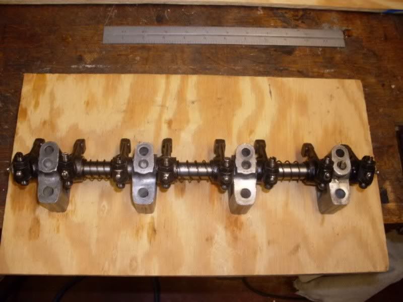

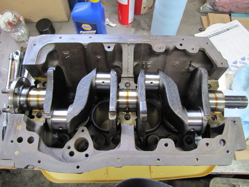

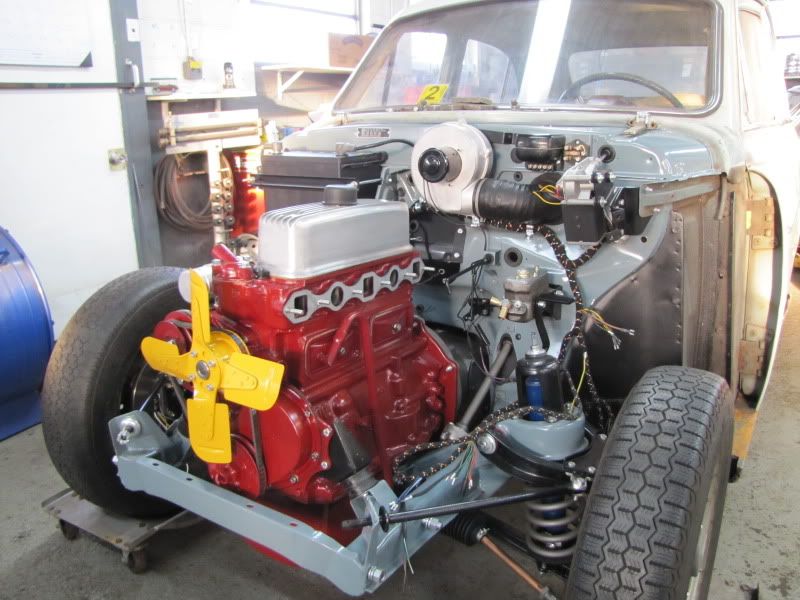

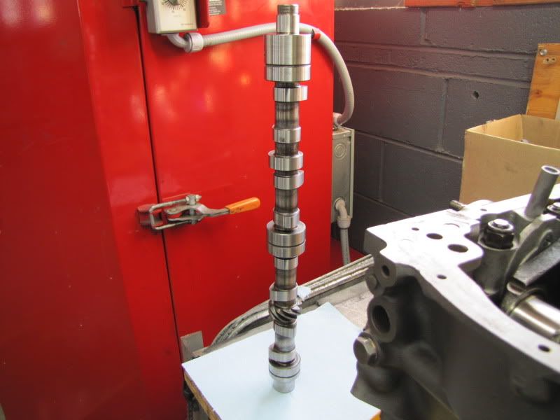

  1. I wanted a break from the re-***embly, so the engine was torn down for rebuild. The crank only needed a polish, .020 pistons, rebuilt the head with stellite valves and manganese guides, new stock cam and lifters, refurbished or replaced all the wear items, etc. The valvegear was especially bad, so they got new bushings and a surfacing.

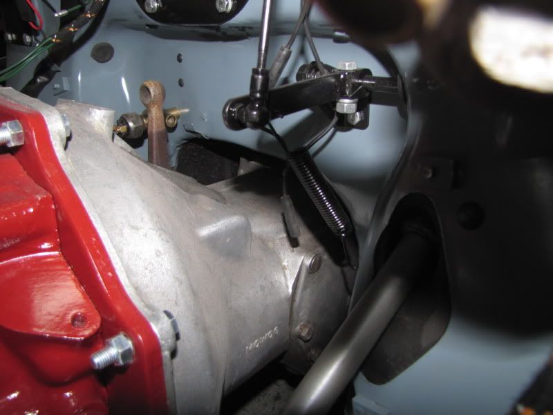

  2. Dropped it back in the car. Time to measure for the Ford T5 installation! The Magnette gearbox will be cut in half, the front half turning into the custom bellhousing.

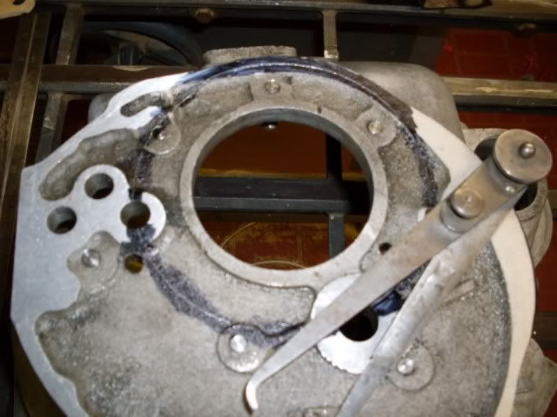

    Andy

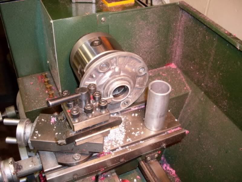

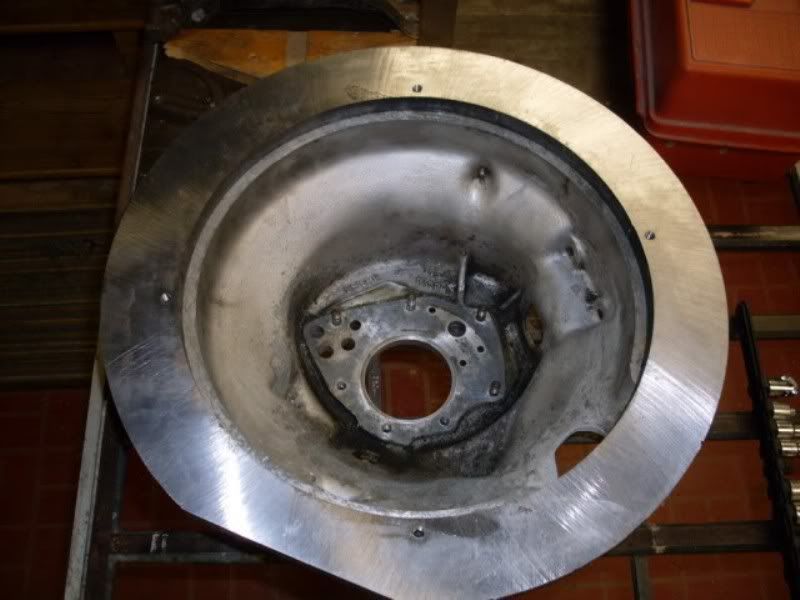

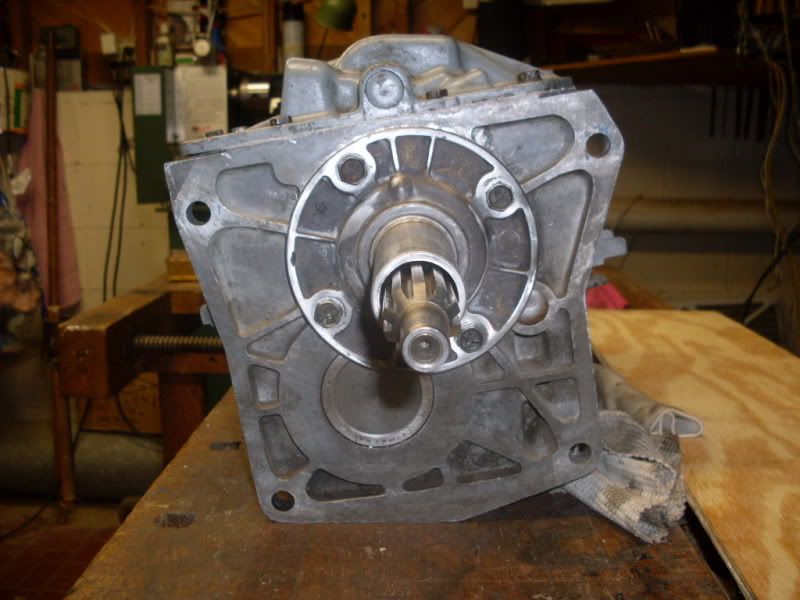

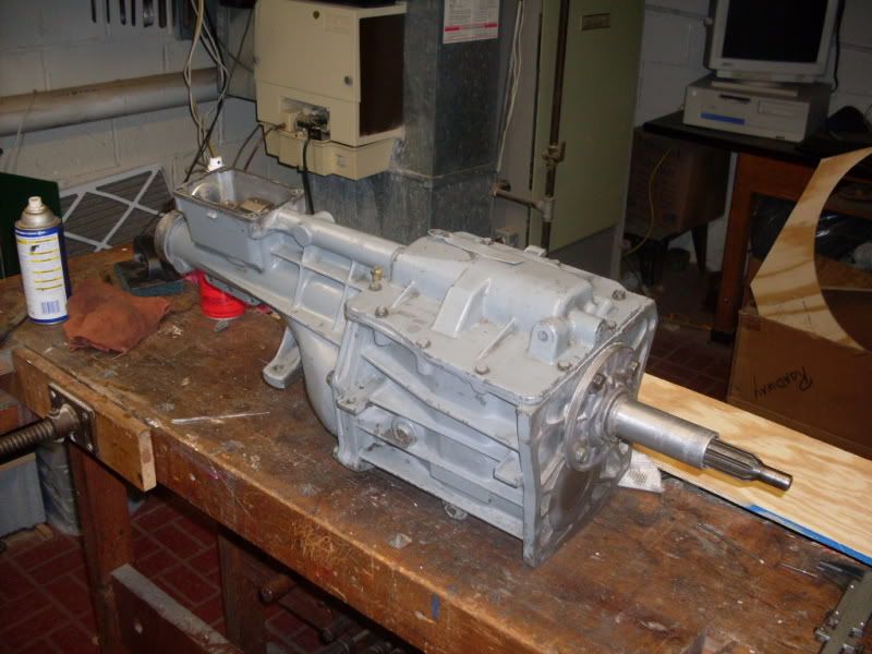

  7. Ford T5 from a Thunderbird TurboCoupe has ratios that will match up nice with the 4.30 rear and the 165R15 tires. The beginning stages of the bellhousing fabrication.
    Thanks again for welcoming me here. More tomorrow!

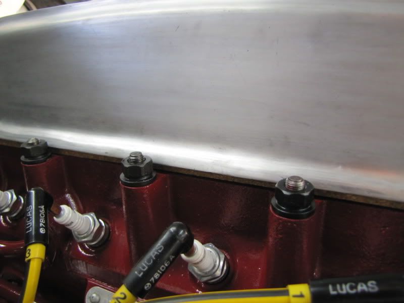

    where did you find the lucas wires, and are the center caps on the wheels original?

    lostforawhile, the battery is a single unit, mounted on the firewall. The MGA and MGB had twin 6-volts straddling the driveshaft behind the seats. The ignition wire is solid core copper, from Moss Motors. The wire ends are NOS from eBay. The hubcaps and beauty rings are original, the blue wheels are not!

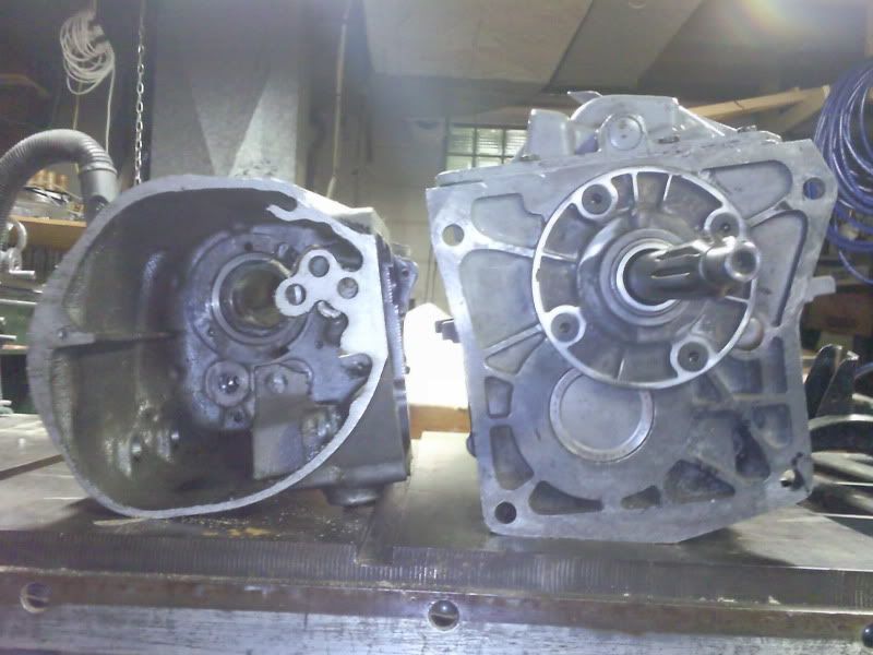

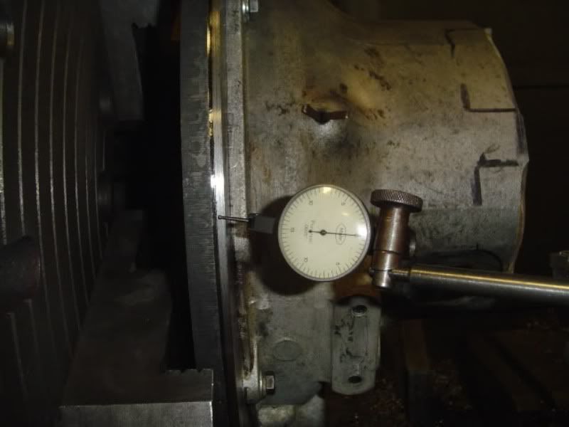

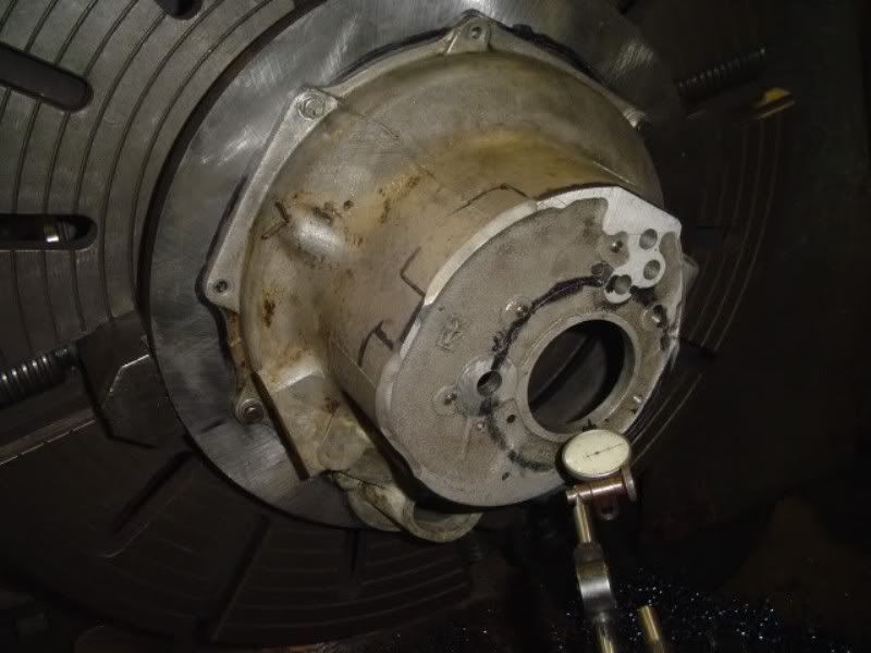

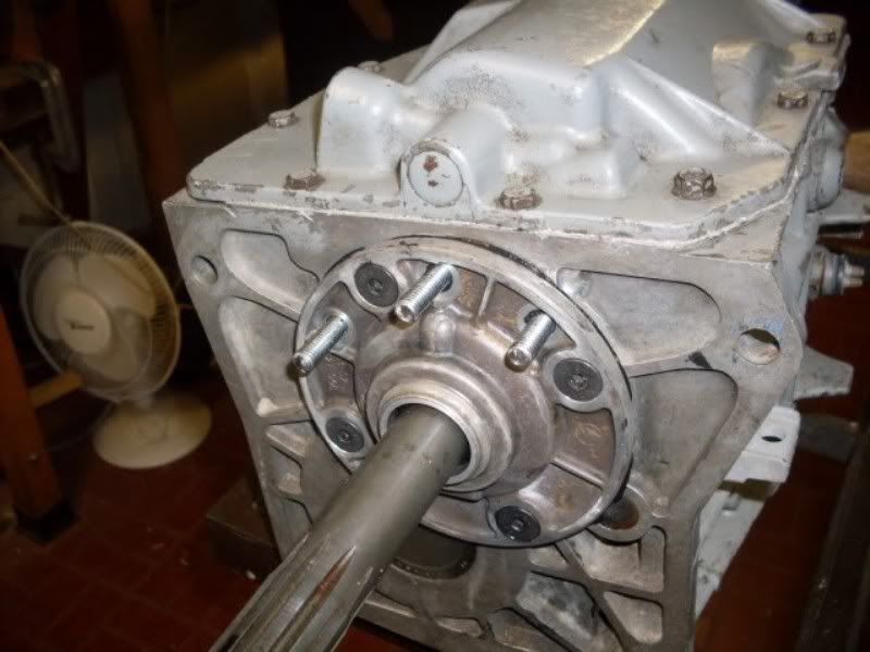

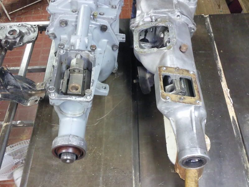

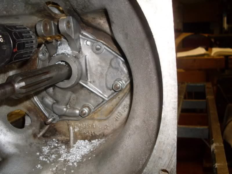

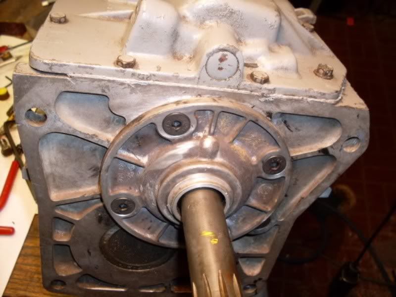

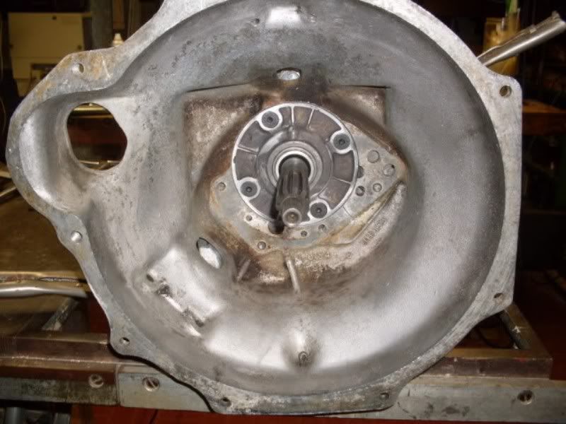

  14. One more thread, preparing a template for the rear face of the bellhousing, cutting off the throwout bearing shaft and changing to different hardware for clearance, and finally comparing the old case to the new T5 to show the dimensional similarities.
    The T5 is the most blatant custom touch, many more small mods will come later on.

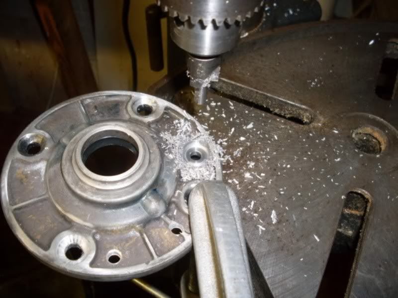

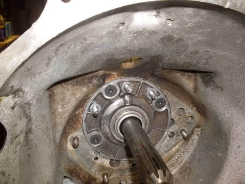

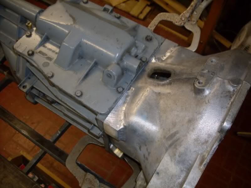

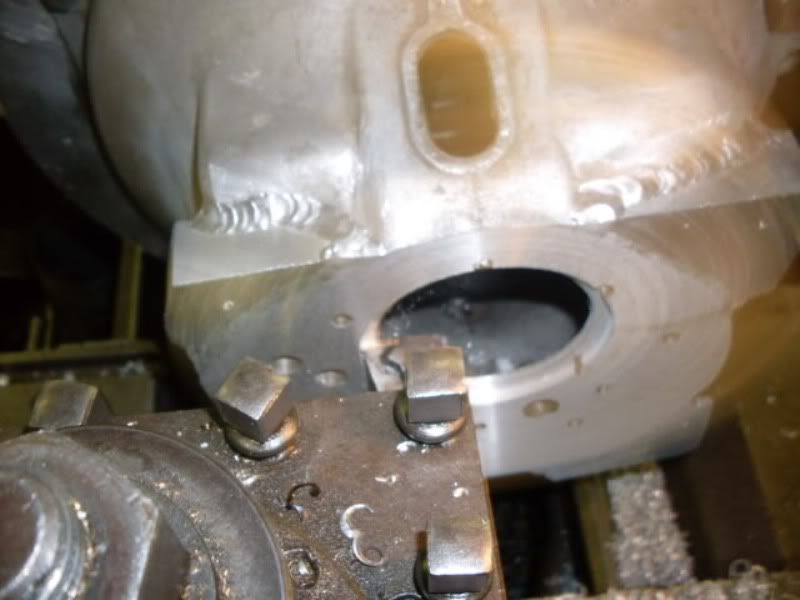

  27. Some tabs had to be welded to the bellhousing to mount to the T5. We made up a large steel ring to mount the whole ***embly to to prevent warpage when welding the aluminum. After welding the tabs on the front face was cleaned up and the hole opened up for the front bearing retainer.
  28. The gearbox will be running the stock MG front cover/throwout bearing ***embly, so we had to make a bunch of mods to make it work. The inside of the MG front cover was opened up, and three different mounting studs were added to the T5 to properly secure the front cover. The Throwout arm is bolted to this so it needed to be strong.
  29. This T5 is from a 4-cylinder Ford product, so it has a ge****t that matches up well to the MG power levels with a 1st gear of 4.03. This gearbox also has a .86 5th gear which I think the 1500 will be able to pull OK. I changed the differential to a 4.3 from the 4.55, which should keep my revs in a very usable range. For example, The original setup gave 37mph at 3000RPM in 3rd gear with the 4.55. The T5 setup will give 36mph at 3000RPM in 3rd gear with the 4.3.
