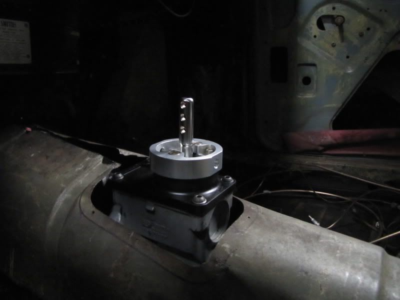

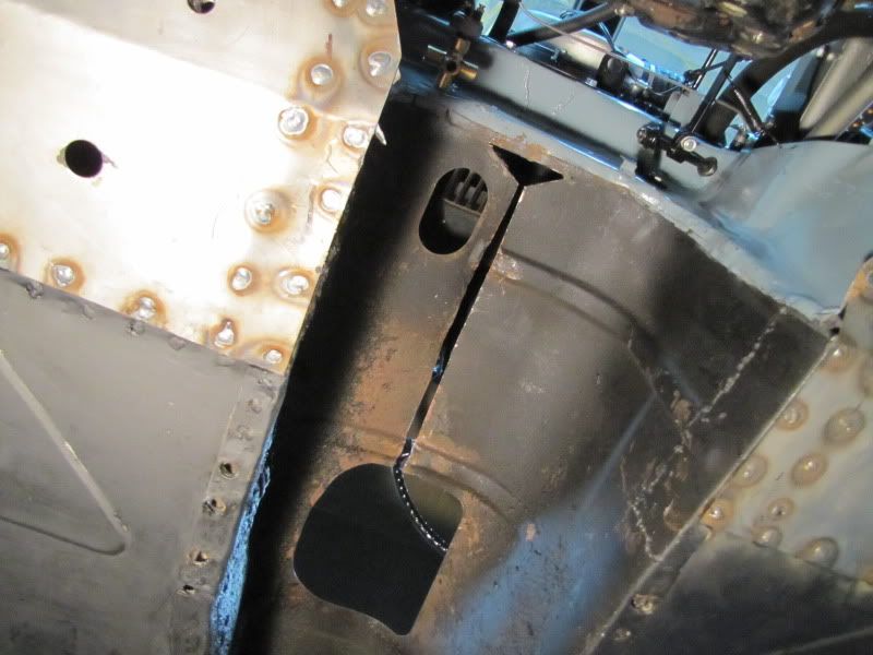

  1. The last step was making a special pilot bushing. After that, we could do the first test-fit. By the way, the goal here was to make it look stock in the engine bay. It became clear that the tunnel would need to be relieved, so it was split down the middle and a 2" strip laid in. The shifter position is spot-on.

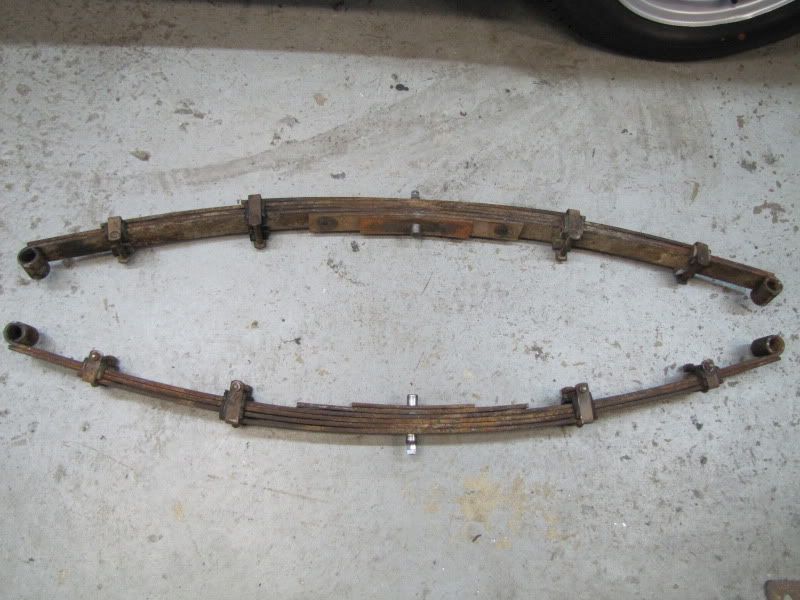

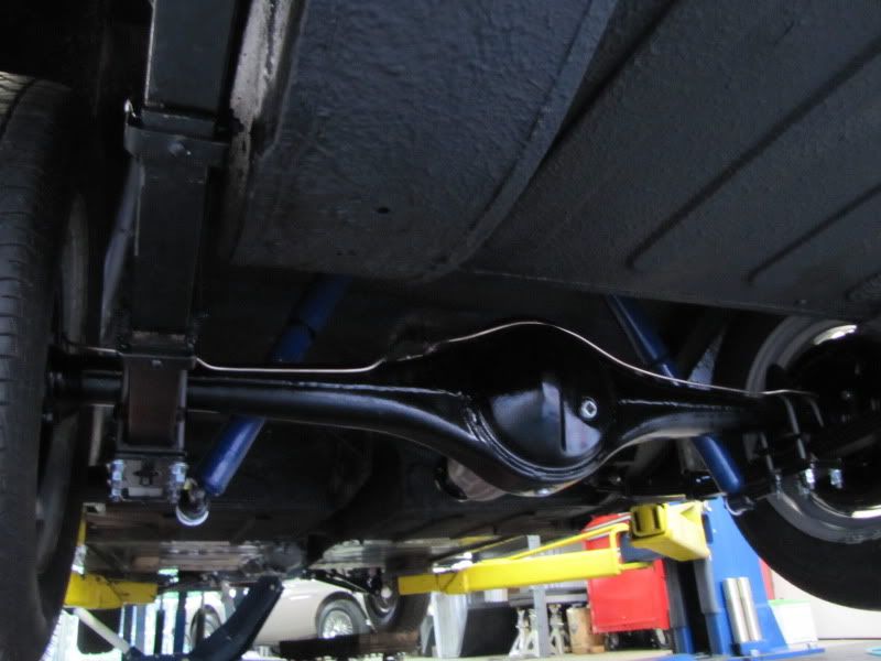

    The exterior is essentially stock, but lowered as much as possible with cut coils and re-stacked leafs in the back. Here is the rear suspension being removed, and cleaning up the rear axle and brake components. On the leafs I pulled the 2nd longest out, and moved the 2 shortest to the top of the stack. This gives a 2-3" drop when all done.
  21. The donor 4.30 ended up being a mess inside and needing a full rebuild. We ended up swapping the gears into the 4.55 case because tolerances were better. We also ended up needing to clean the mounting face of the ring because it was showing too much runout. The factory had a special jig for setting preload but a bar and weight gave us good results, it just took a few different shim configurations before getting it right.

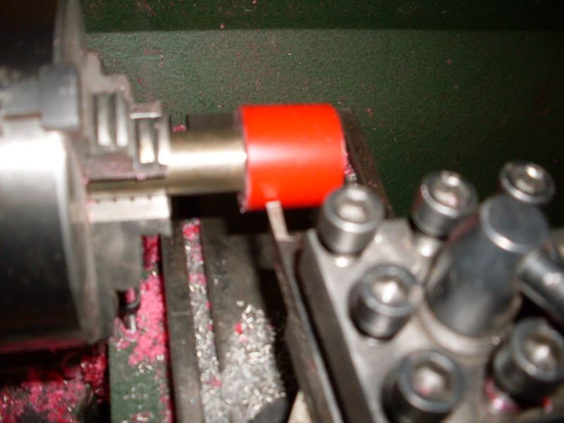

  22. I was concerned about the axle swaying in the back with one of the longest leafs pulled out, so we used some hard poly (95A) to really tighten up the rear shackles.

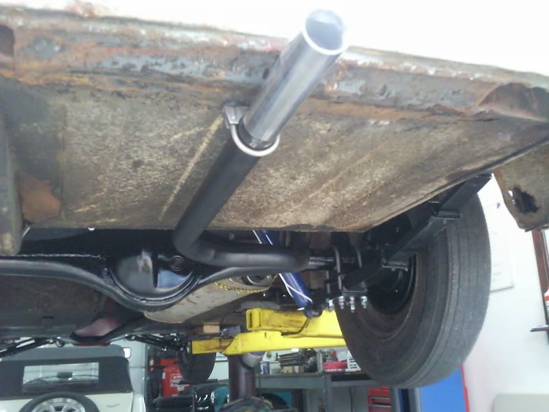

  27. I mocked up and made the rear exhaust. It runs over the rear axle, then swings back over to exit center. After that it came back down, I undercoated the rear floor area, and the rear suspension was put back in permanently.

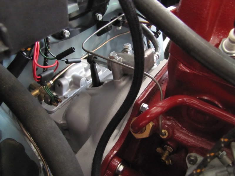

  28. Until I can scratch together the cash for the Judson, the original twin SU carbs will have to suffice. I was originally going to run this alloy valve cover, but it fouls on the air cleaner so it will have to run the stock steel cover.
