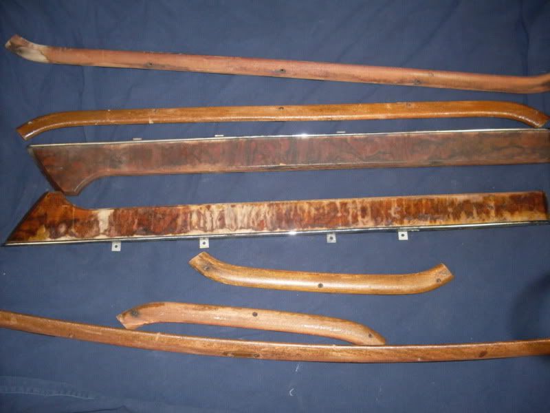

  17. Sorry guys! All fixed now. The next batch of photos will be of the interior coming together. Typical of a British saloon, there was a lot of woodwork to repair.
    It started here, faded, cracked, and water-stained:

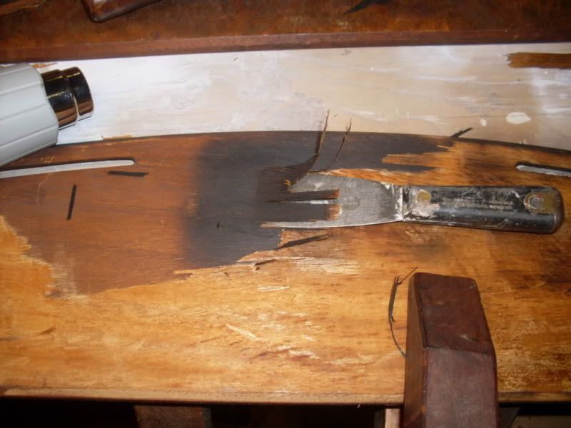

    We realized that some of the veneer was too damaged to save, so all of the mahogany sections were taken off with a heat gun. 2 of the walnut door rails were bad too so they got recovered as well.
    Making patterns of all the new sections:

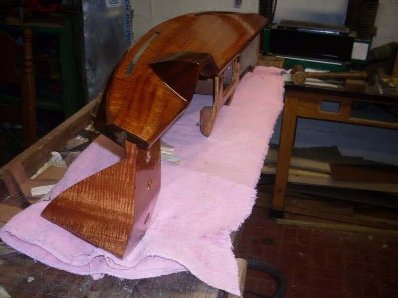

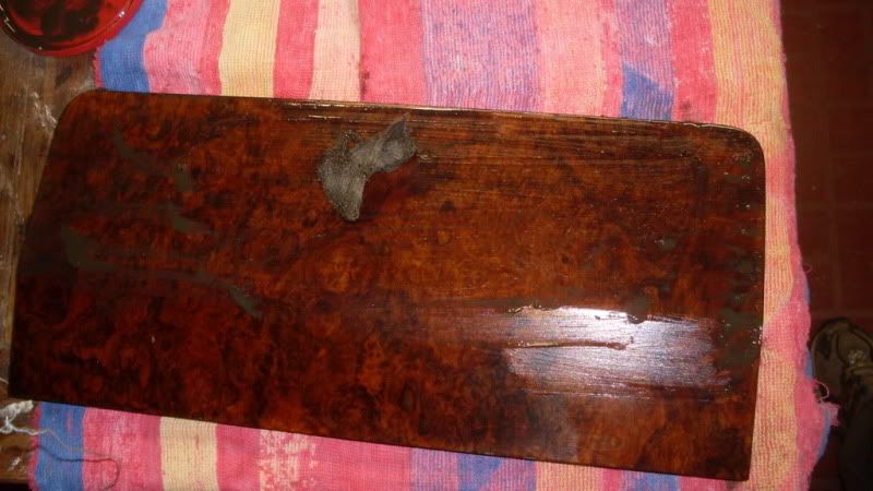

  18. After all the mahogany sections are glued to the plywood backing, final sanding can occur before moving onto the stain and polyurethane.
  19. After a few coats, it will be sanded and re-coated 8-10 times before it is done.
  20. The final rub was done with rottenstone and linseed oil. We're very happy with the results.
  21. And woodworking too! wooden boat guys, look out. Beautiful.
