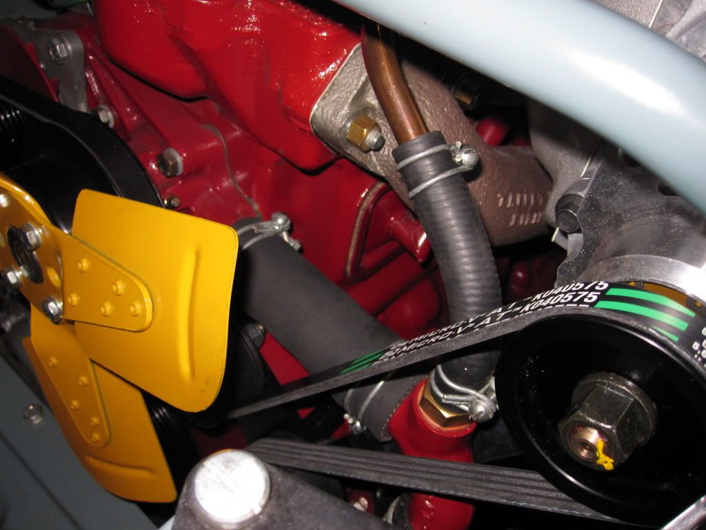

  4. Job changes, marriage, a daughter, and a house renovation have kept me from frequenting my favorite forums like the HAMB. I've received a few e-mails recently about the Magnette so I figured I'd stop by to post an update. I've been driving the car a lot, and I did go ahead with the supercharger project. I could not find a usable Judson in my budget, so I bought the Moss Motors M45 blower and made some changes to it didn't look too "new" in there.
    Here is the car in action on a grocery run:
    The blower project. I had to modify a kit for an MGA, so this involved fabricating a mechanical linkage, different radiator hoses, and many different brackets. It has dramatically boosted the power, but I'm already thinking about phase II with a ported head and a header.

    Don't know if I'd gone the supercharger route. A MGA twin-cam motor would bolt right in there.

  9. Twin-Cam MGA engines do fit, but they start at $10K for a rebuildable core. I like the blower, especially at a 5th of the cost!
