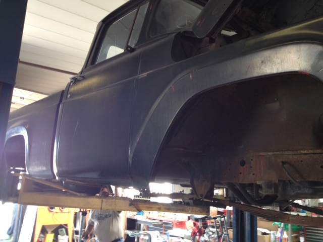

    Here's a few shots of the lowering process on the black 60.
    This truck is very solid. As we got it on the lift, I became more and more excited about the structure of this one.

    This is the truck on the lift. Gonna do red steelies and wide whites just like the green one. Think I'll paint the grill and the bumper white, also cutting about 2.5 inches off the from frame horns to tuck in the front bumper.
    Any other ideas ??
