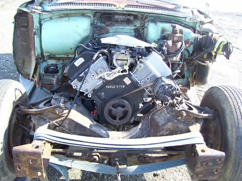

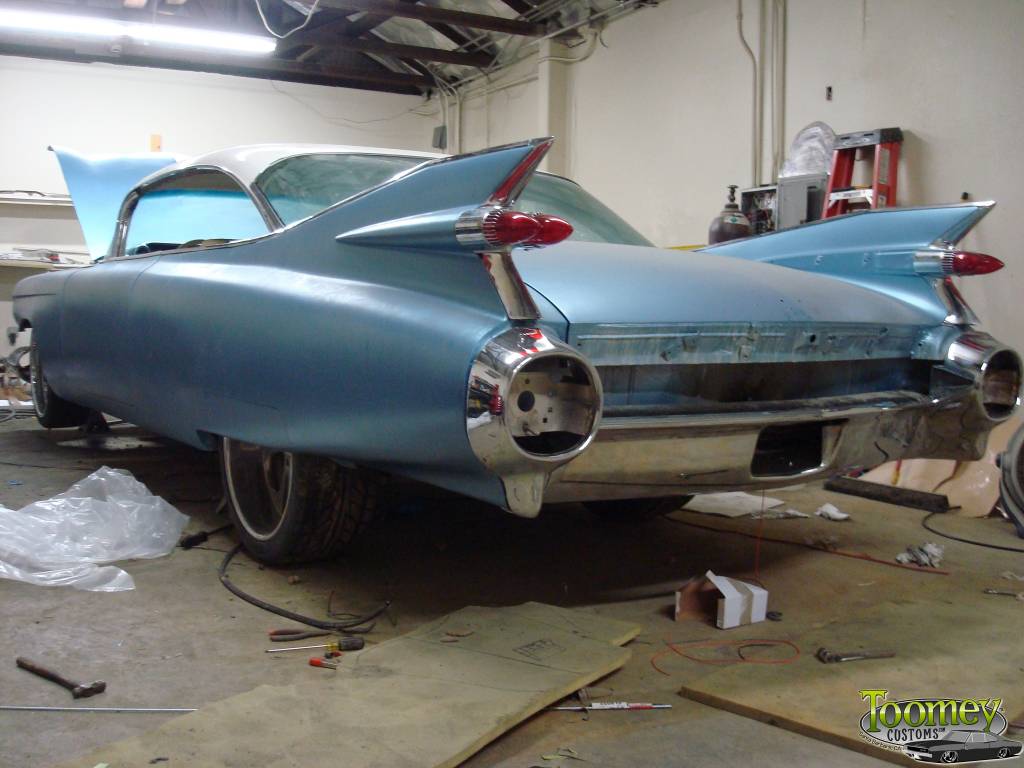

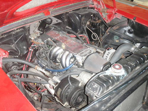

    sorry for the late reply man, been travelling all over the world!! here are some pics of a 6.0 swap done a few years back. he did a frame off and its way easier to do it like that, but there s so much space when thefront end is off you shouldbe fine!! this is a 6.0lq4 i think he used

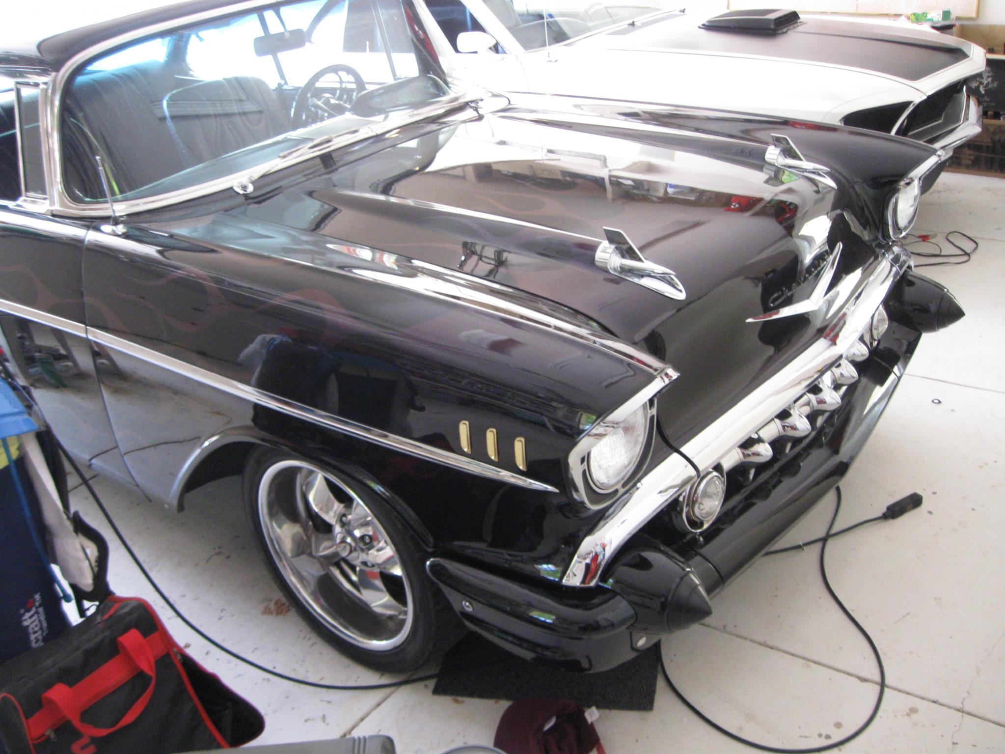

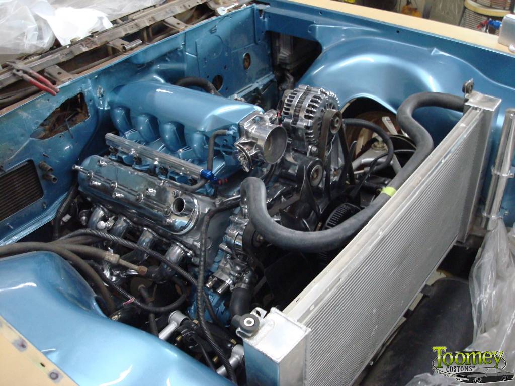

    here are some more examples, the 57 in veige was done also with a 6.0, but he added a blower! the blue 58 coupe is a northstar design...i highly reccomnded staying away from...eeeek....the red 58 sedan had a early 80s tune port setup if i a not mistaken. i did a topic a coupel years ago and it is ***led "5.7 vs cadillac 500".....readr that topic all the way through and you will get even more information on thsi swap from otehr hambers who have done it also. and get their opionions as well.......lastly are teh pictures of the 57 that my fried put together. it has a lq9 and 4l65e...and it hausl ***!

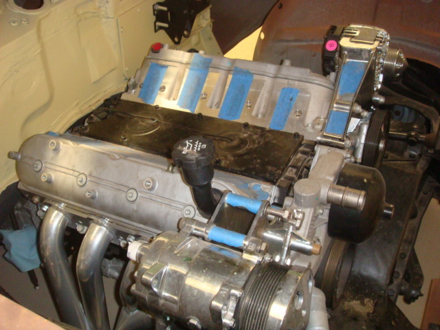

    Update: I got an LQ4 and 4L80E trans from an 03 Silverado. Actually I got the whole truck but thats irrelavant! :) Pulled the drivetrain out of the Caddy, and working the drivetrain out of the truck currently. Did some prelimnary measurements and looks like the 4L80E Transmission is 30" long and the LQ4 engine is 26" long. That puts the pulleys and maybe the front edge of the block over the Cadillac crossmember in order to clear the firewall. The front of the LS engine is too tall at this point to clear the Cadillac hood. Will need to mod the crossmember by notching it down with similar guage steel and stick welding. The rear of the trans may line up perfect with driveshaft yoke and I may avoid fabbing the driveshaft! Exact mount boltholes were not checked yet. It appears the Cadillac trans braces may fit fine. There is no apparent clearence issue in the tunnel as the 4L80E transmission is shaped a lot like the hydramatic that came out... it just a newer rendition of the TH400 anyway. The engine mounts have plenty of space but will need lots of custom fabrication to attach to the frame. Thats the biggest issue, so no surprise really! :D Can't wait to get the drivetrain in there and get this vehicle drive-able.

    I count 5 people that I have found that have completed ls swaps in these cars. All have made their own mounts and have m***aged the ****** tunnel. 3 have done it without modifying the cradle. I suggest a lower intake for hood clearance. The truck one is super tall.

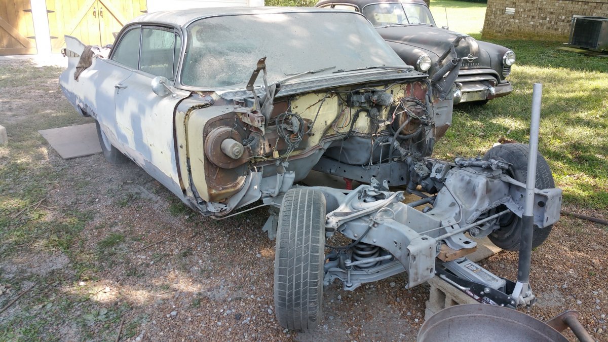

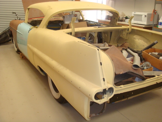

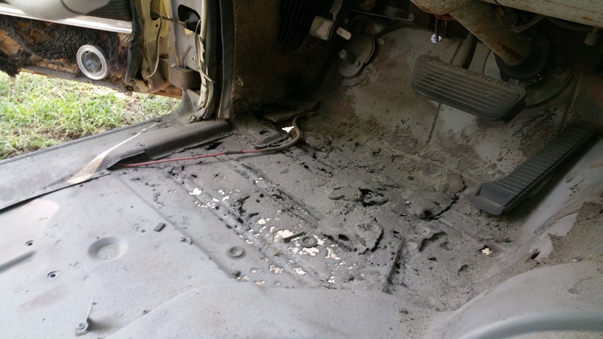

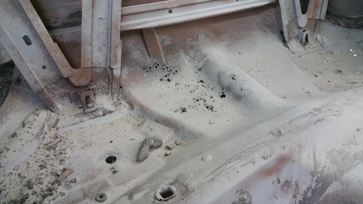

    Update: Here she is getting sandblasted. Of course, and as expected it was a lot rustier than I thought. I took a few weekends earlier this year to dismantle it and I came just short of going frame off.. I still might after the rust repair is done. I have it with a guy who is doing the metal patch work simply because if I do it myself it will take years to get done. I found fairly close floor pans and trunk pans online, I can look up the source if anyone needs it. Pictures of that progress to follow.. its about half done and at this point I'm shooting for early spring to get it back and decide how I'm going to approach painting the underside and frame as well as the outer body. I'd like to get right into the mechanical's as soon as possible so I may just shoot the bare metal on the outer body in primer sealer for the time being and go to dropping the LS drivetrain in. 20150823_152957.jpg 20150823_150350.jpg 20150823_144020.jpg 20150823_143729.jpg 20150823_152957.jpg 20150823_150350.jpg

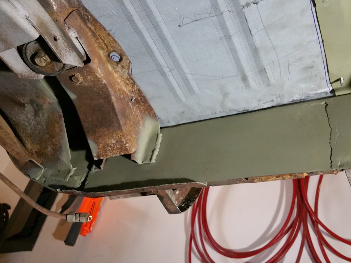

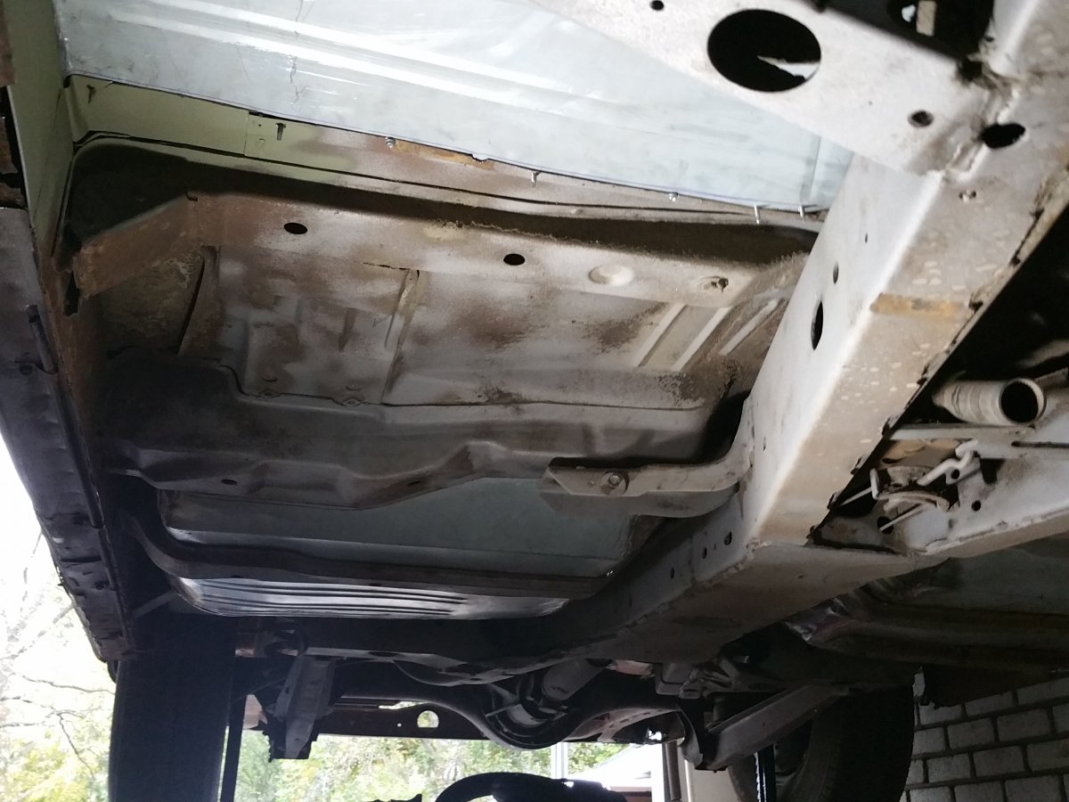

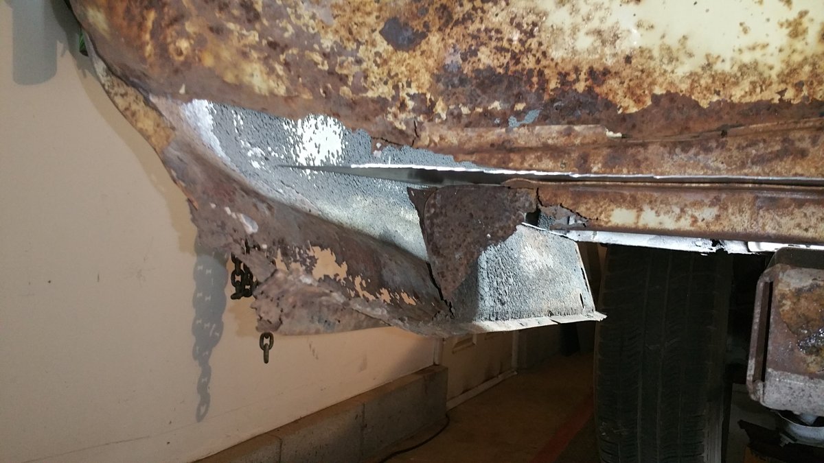

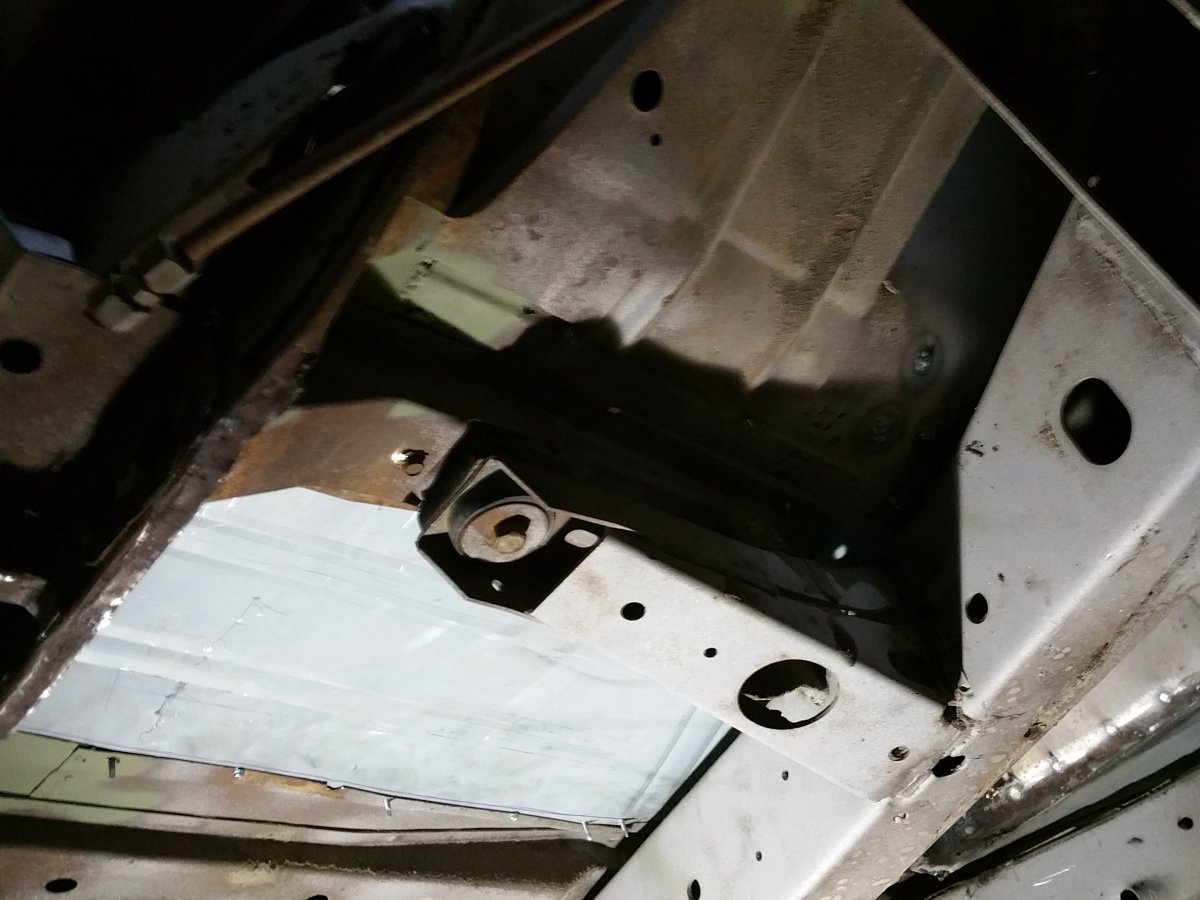

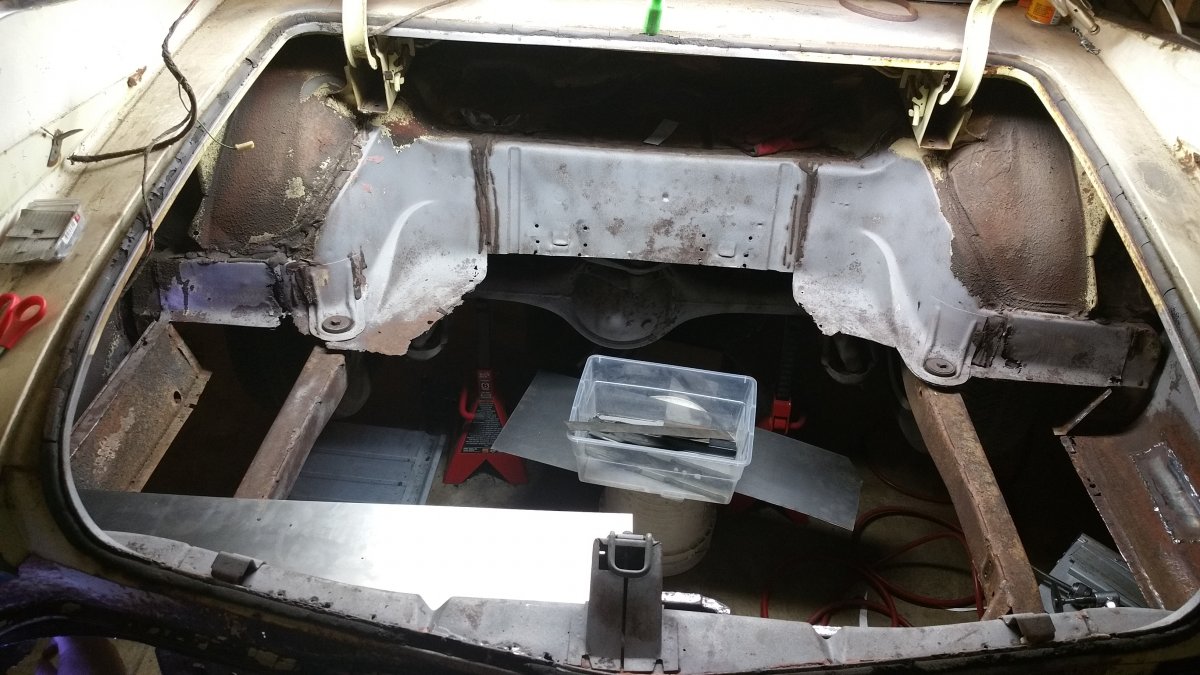

    Working through the extensive rust issues that I found after it was sandblasted.. of course. I should have seen that coming. I have help on this by an experienced welder whose doing this work for me on the side. It was just more than I could find the time to do. As soon as I have it back I'll be dropping the 6.0 LS engine and transmission in that I snagged from a salvage Chevy truck and priming and sealing the underbody and interior areas.
