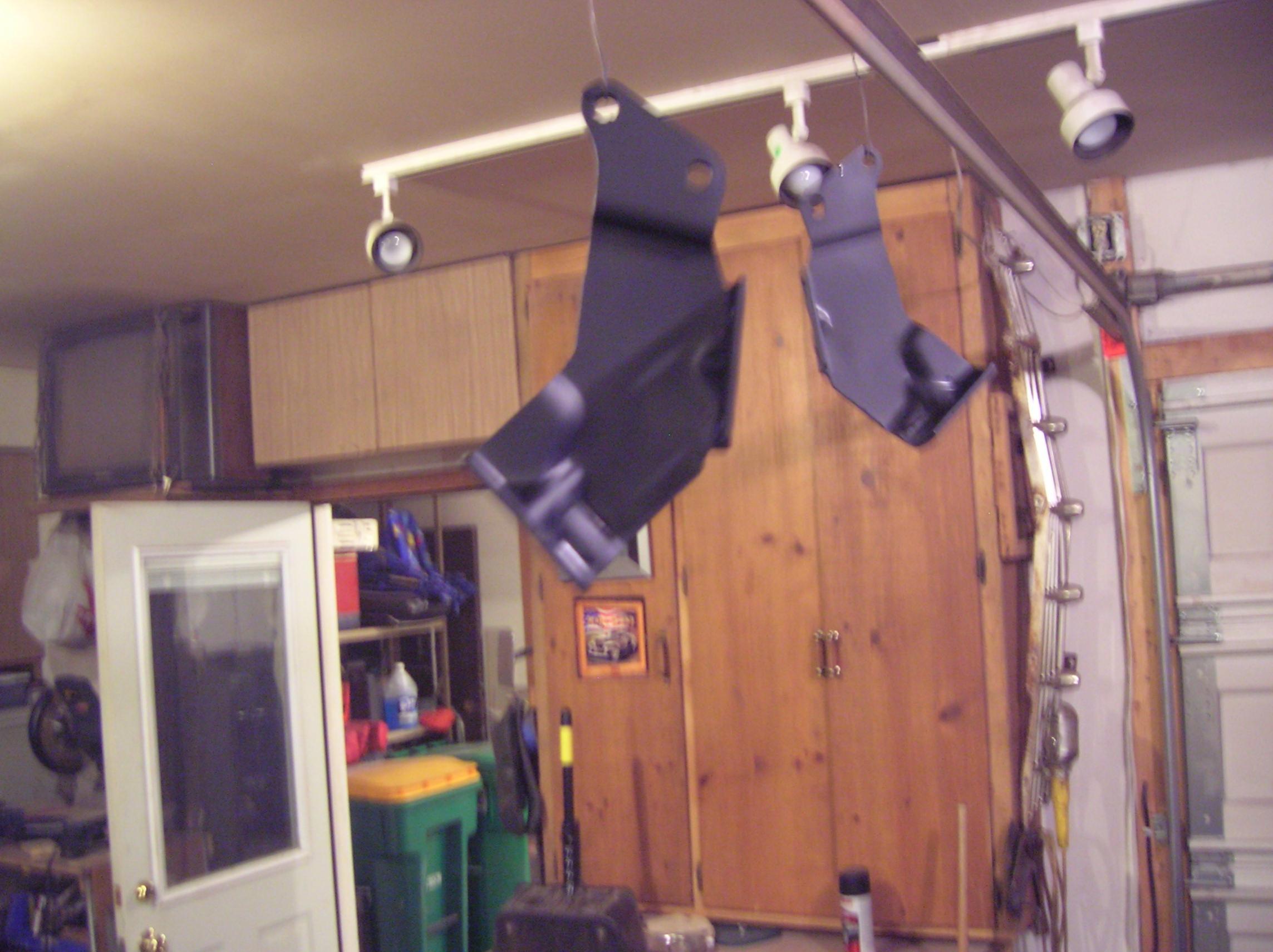

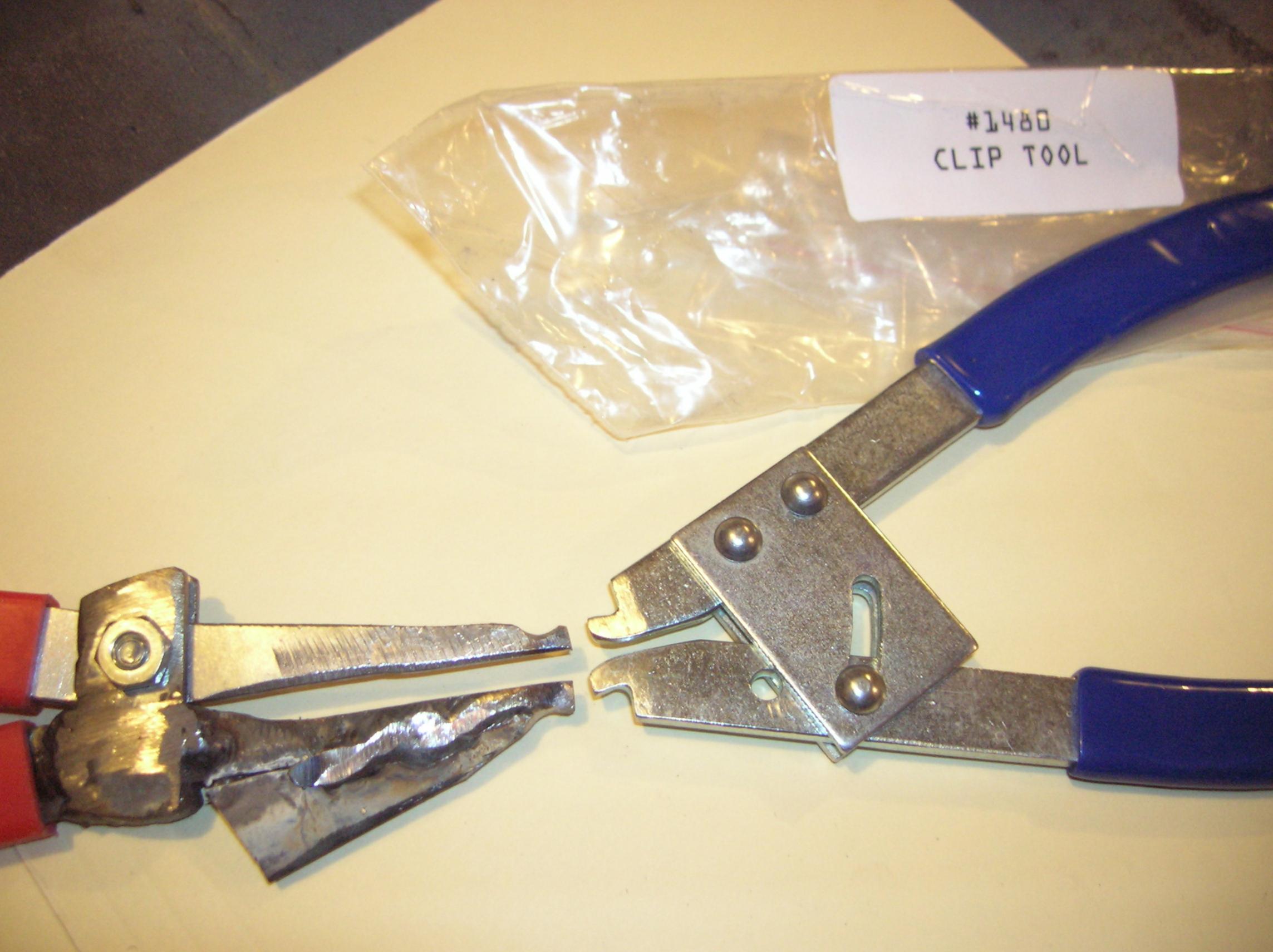

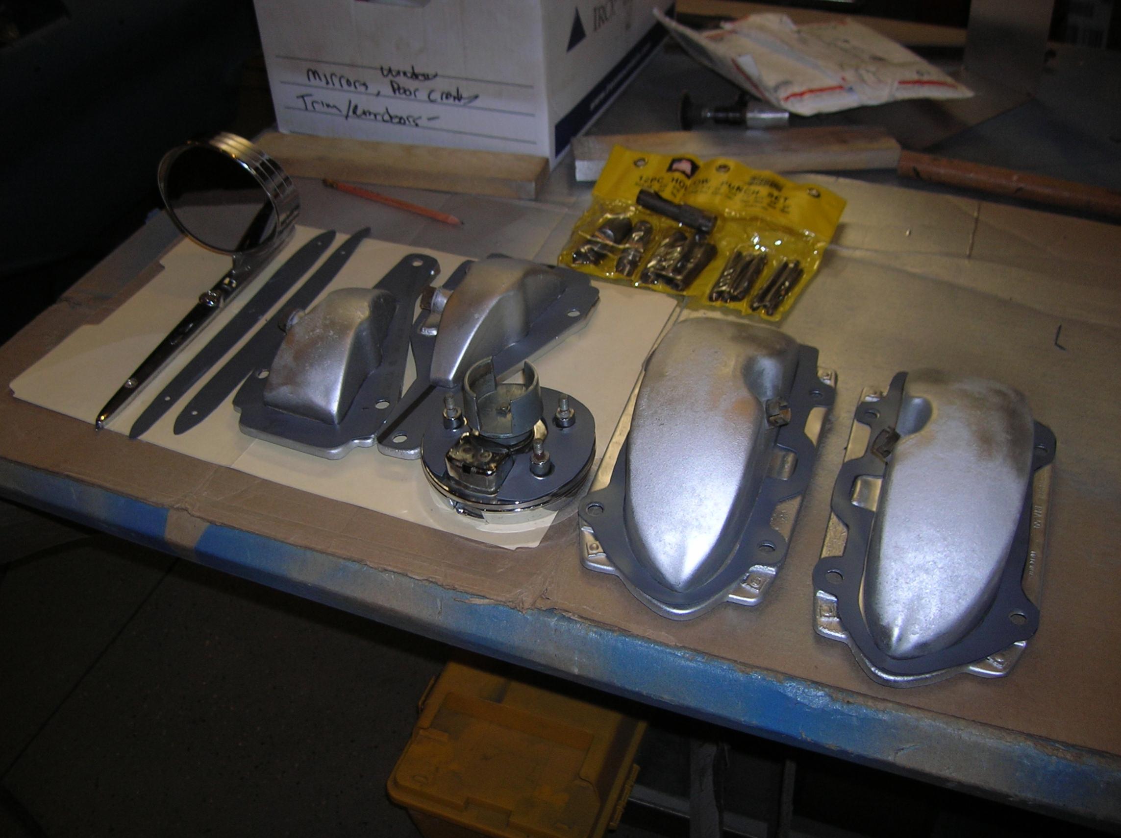

    The bathtub clip tool arrived and i tested it out tonight, works great. Cleaned up some rear bumper mounting brackets that were picked up last summer at a swap meet. Tried out my $50 C/L sandblast cabinet after doing a little fix up on it.

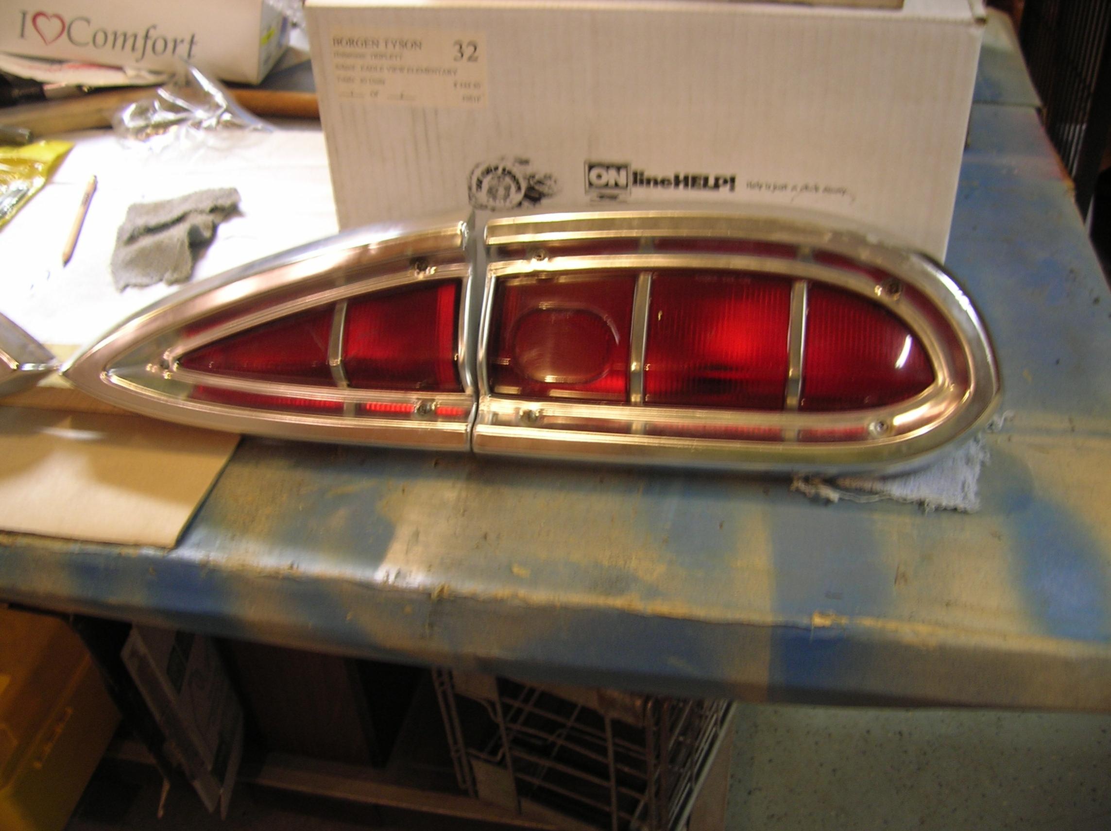

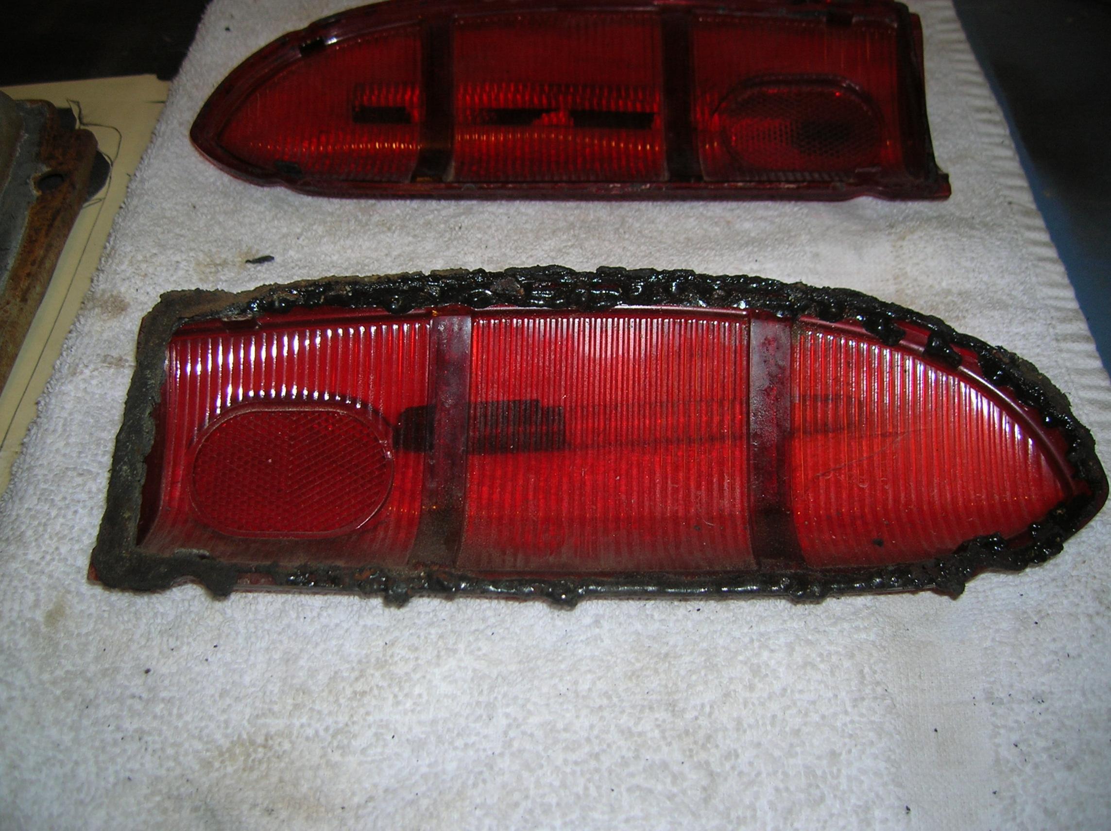

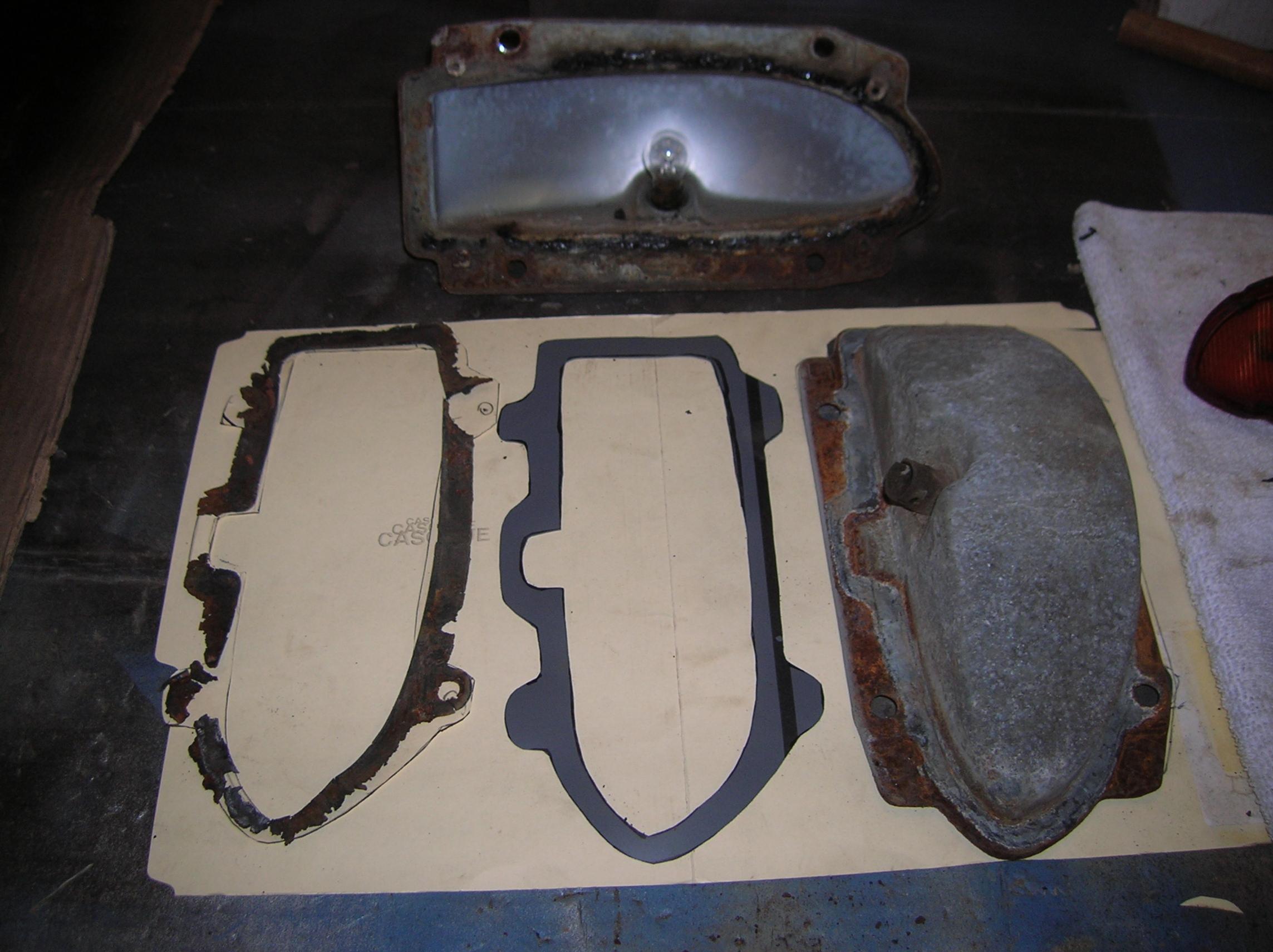

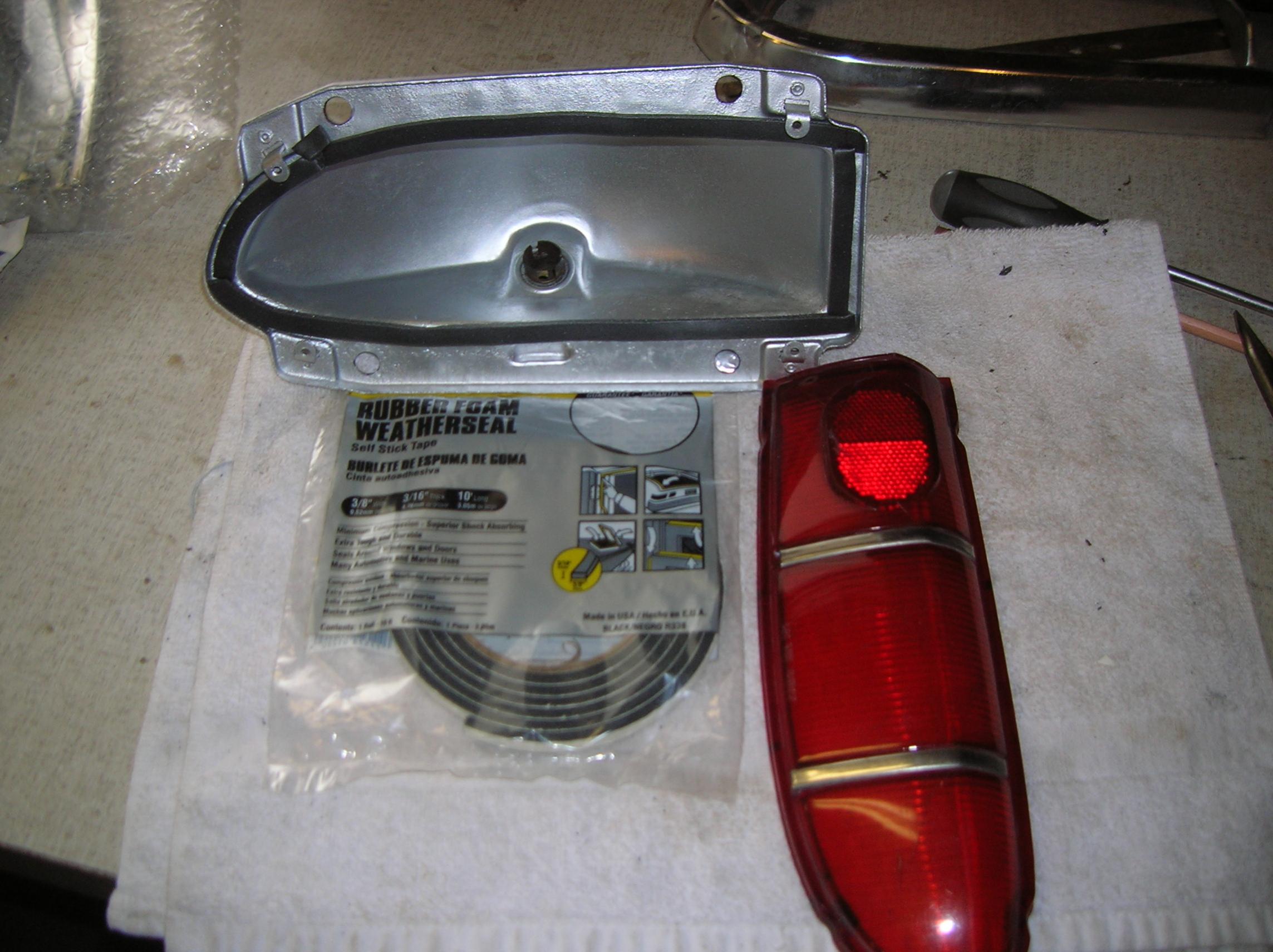

    went after the tail lights, they had some "very low budget seals" from the PO.
    should clean up fairly well, new seal came out good
  3. If you know any commercial roofing guys hit them up for rubber roof membrane drops or roll ends. It works great for tail and marker light seals and even as gaskets between metal parts like the head light bucket to fender gaskets you already did earlier.

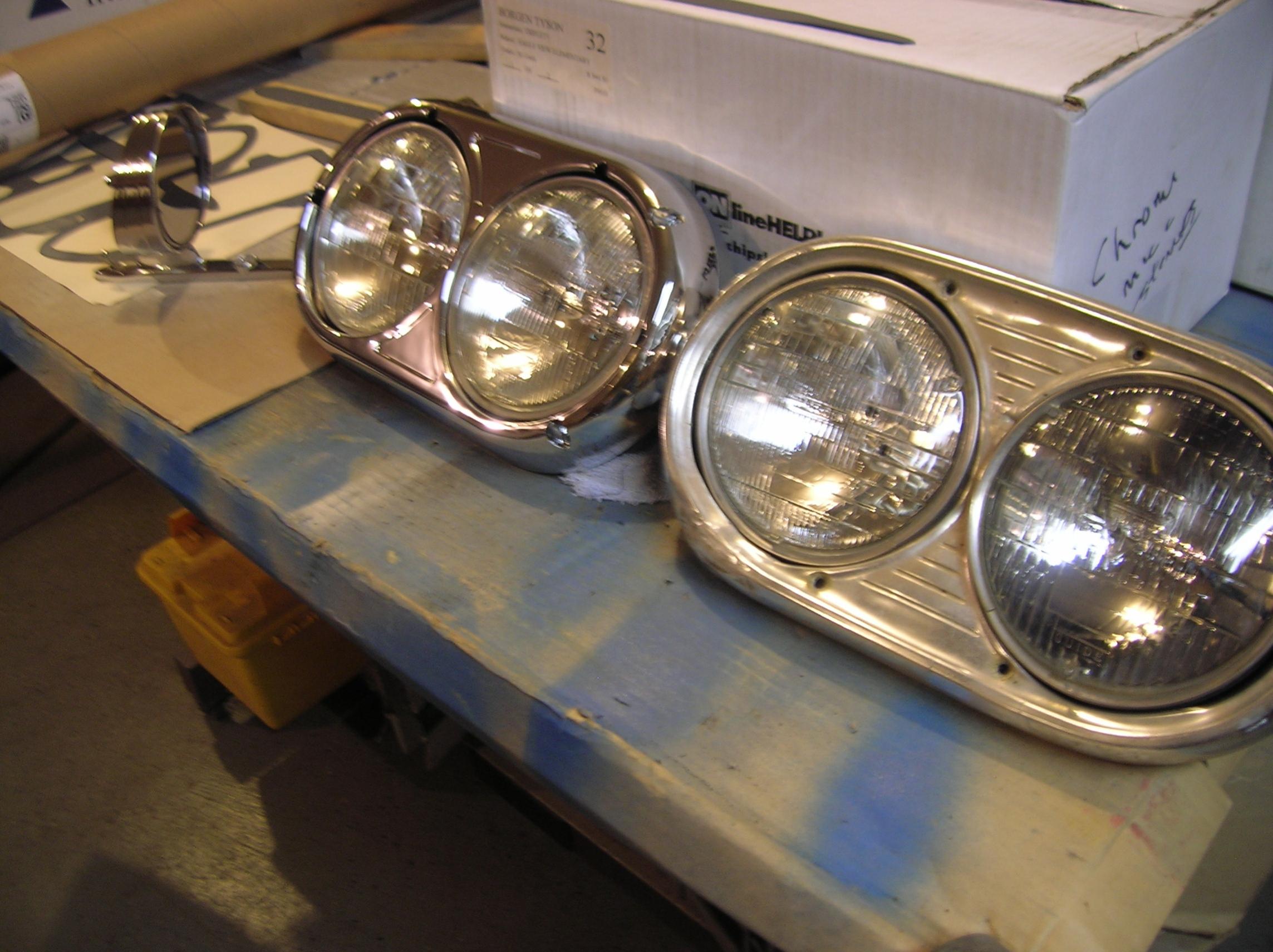

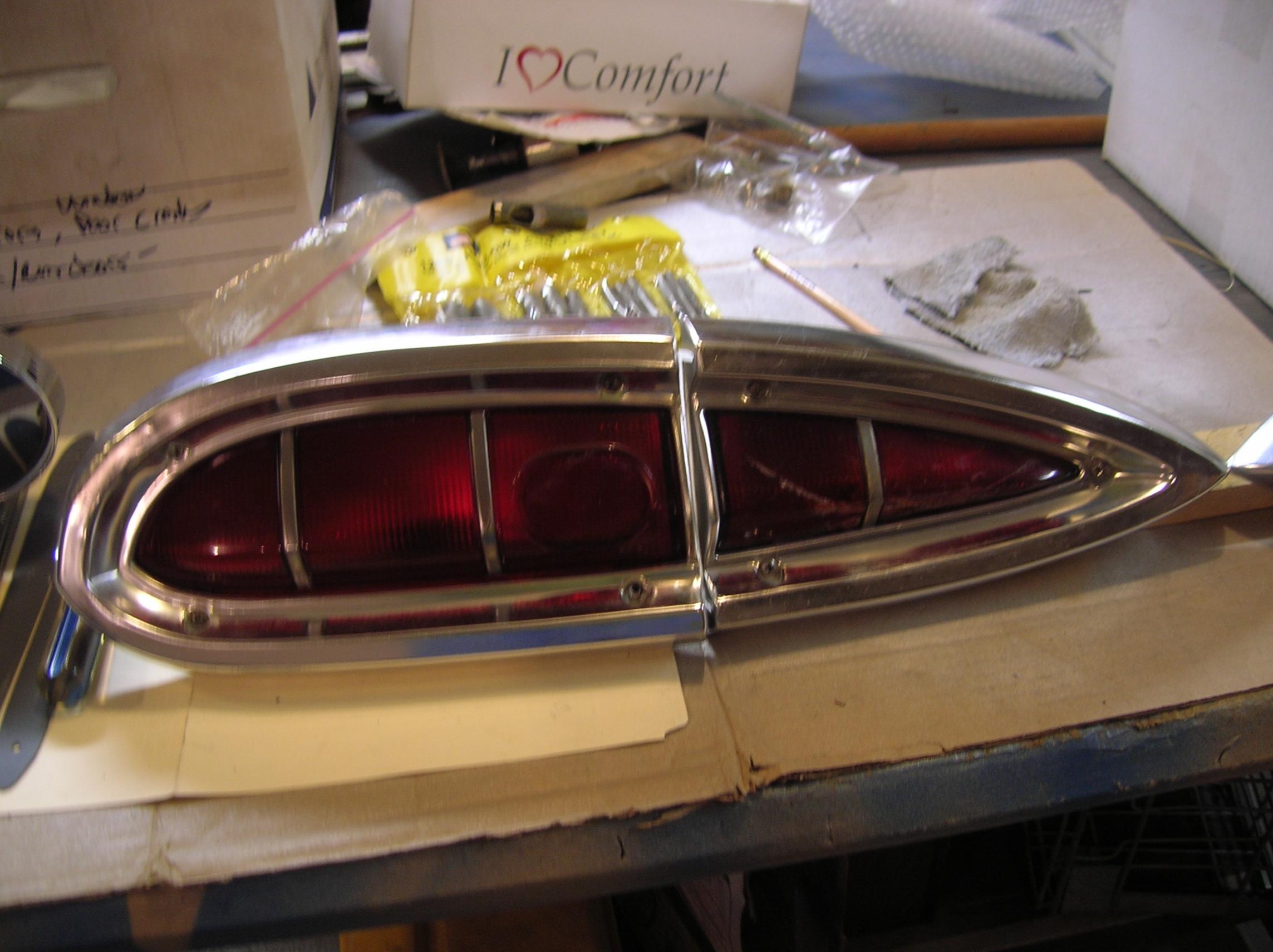

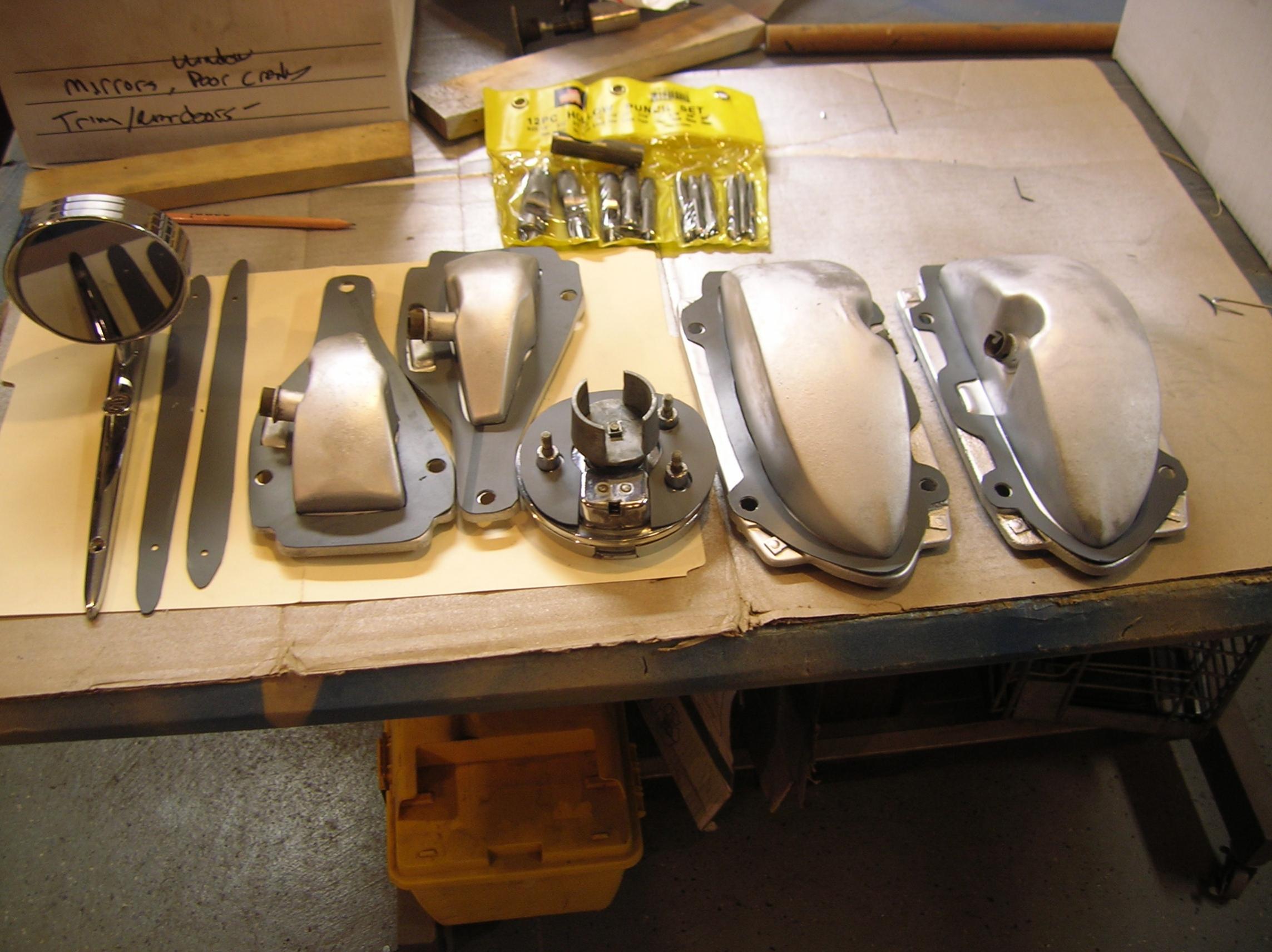

    Keeping up on the trim and detailing as we weather a fairly large spring snow storm. Got my headlamp bezels, window seals and plug punch set delivered today.
    One of these days it will warm up and i can finish the paint, meantime I will keep getting things ready to bold on after in done.
    Was able to make all the seals needed for under $25 and still have ~70 % of the material left and now own a set of punches so I will be all set for the next project
    After straitening out the rear bezels, painting the buckets and cleaning everything up i an fairly happy with the look. Was able to get all of the goop of the lenses.
    Also like the way the head lamps will look with the Peterbuilt truck headlamp bezels.

    Looking good. Is the Peterbuilt headlamp bezels same size than original?

    The Peterbilt bezels are a very good fit, i will take some measurements but are basically the same. The mounting screws are in a different location so i plan to add a second set of brackets. Plan is to replace all the hardware so the adjusters will function. The new bezels allow for adjustment with out removal.
    here is a link to where i got them, lots of others carry them
    http://www.bigrigchromeshop.com/Merchant2/merchant.mvc?page=BRCS/PROD/HDLITA/UP40982

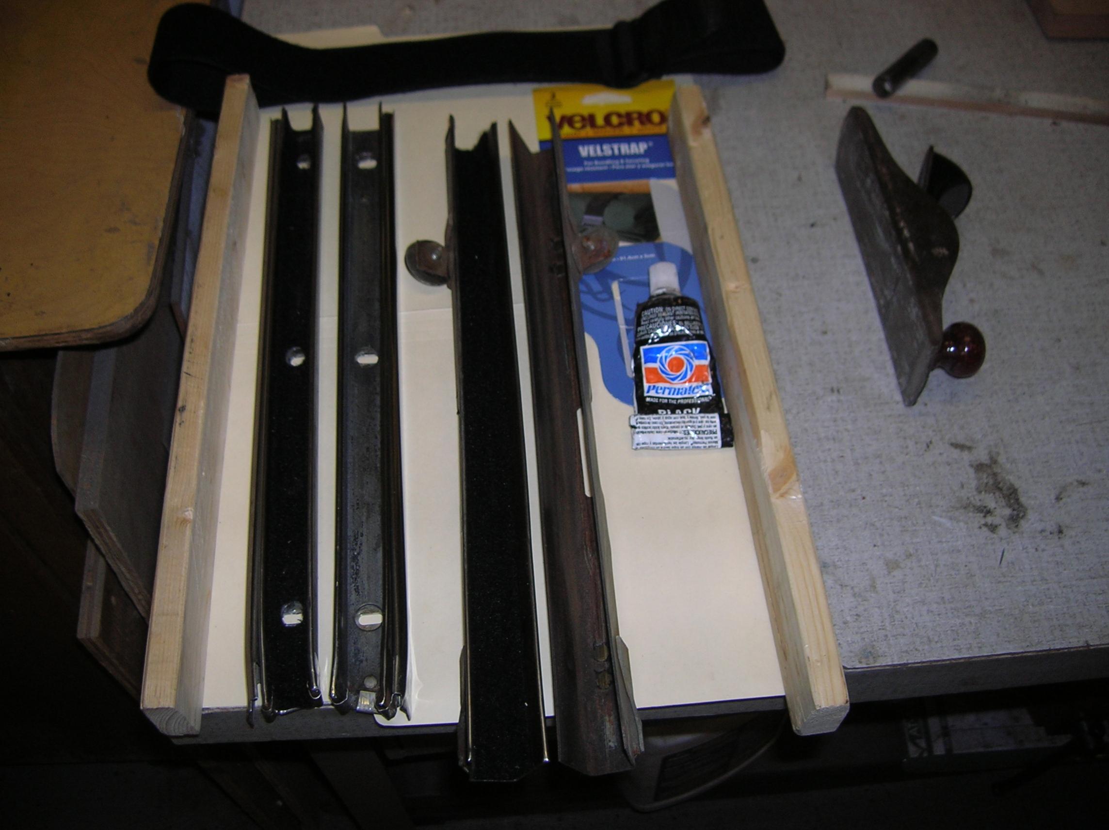

    Made some progress on the wagon, specifically on making some seals.
    From a tip made by WD040 (http://www.jalopyjournal.com/forum/showthread.php?p=8740437#post8740437) and used Velcro to line the vertical channels on the rear window.
    The source was a strap, which yielded 6 feet for under $4 after trying to find just the soft part.
    Used some boards planed down to hold the material in place with clamps while the sealant cured.
    The seal for the tail lights was even less (looks like i could by some but for now resources are focused on "Musts")

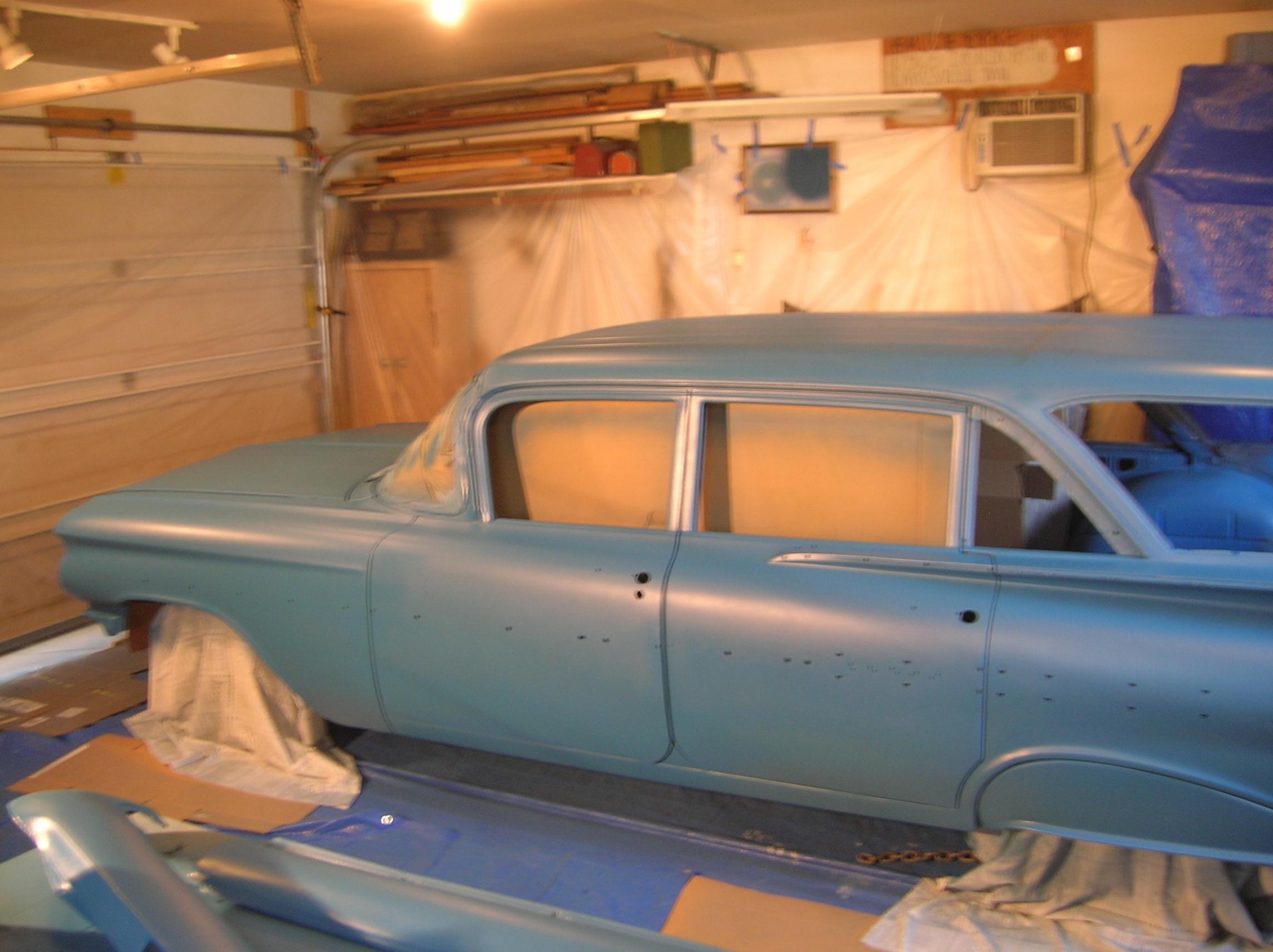

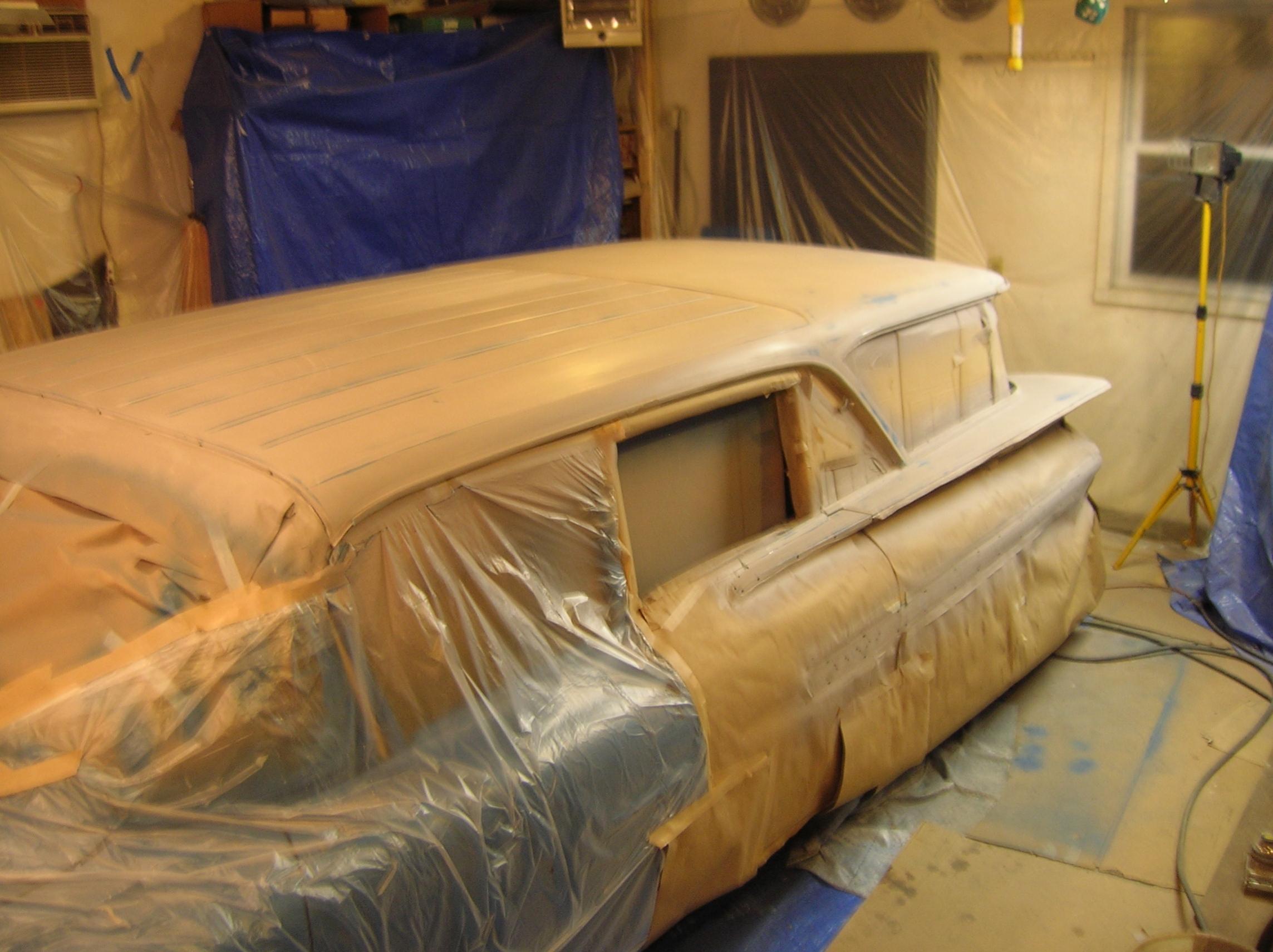

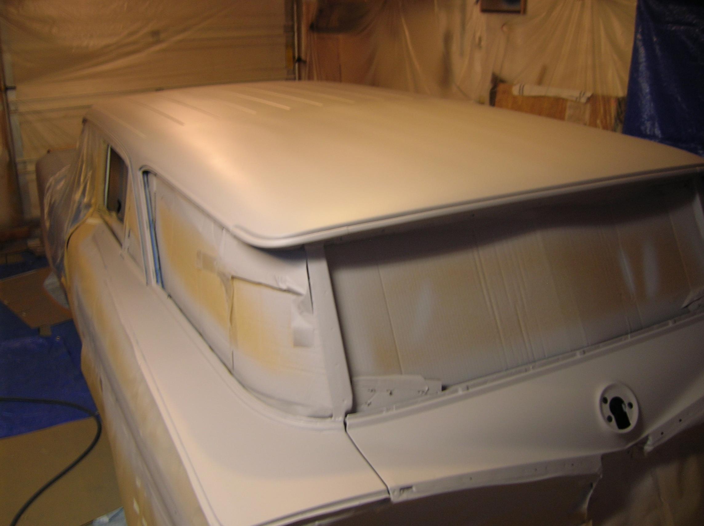

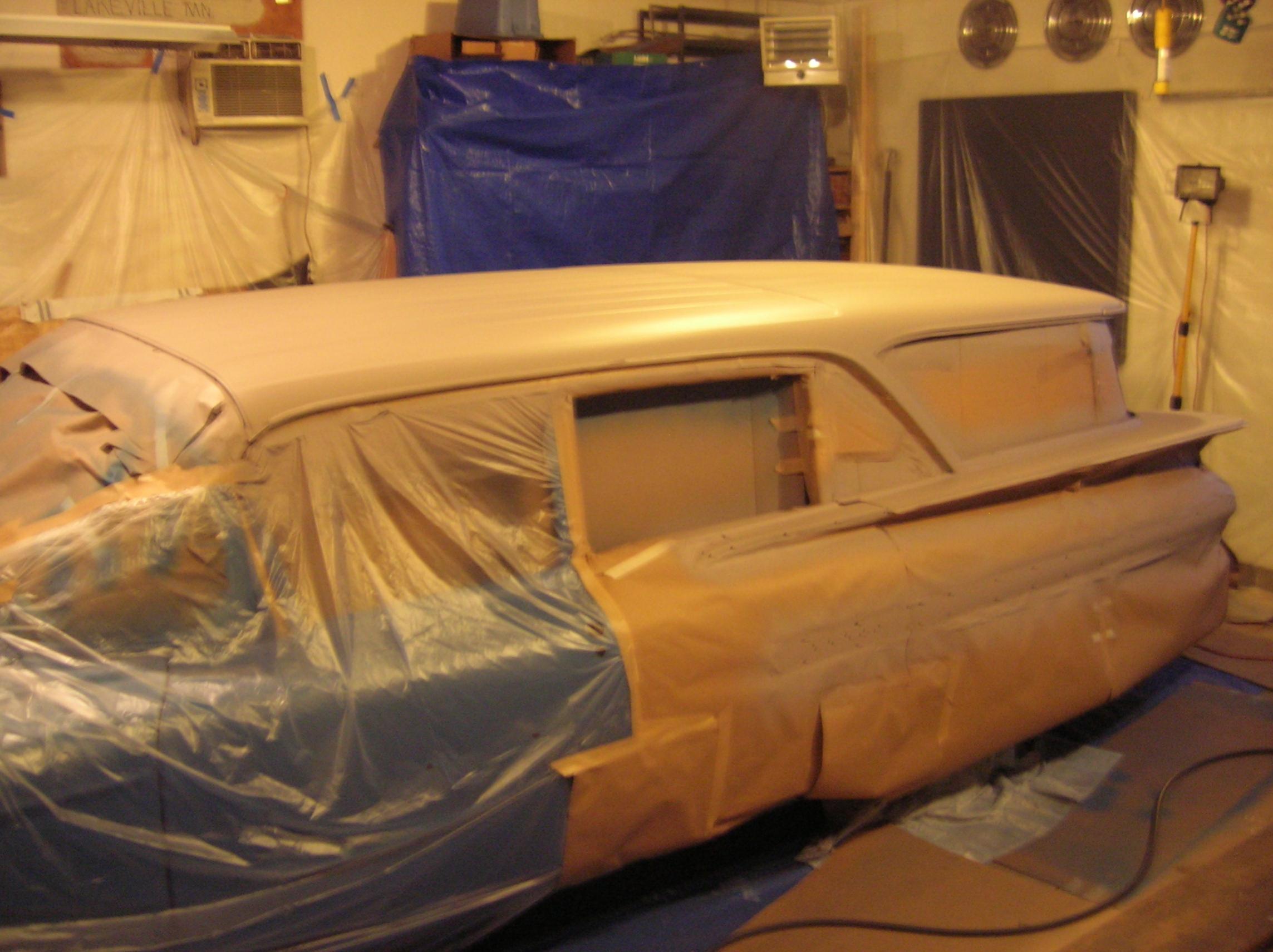

    Primed all the remaining loose parts last night and the wagon is new ready for the final coats of DP-60LF
    Then it will be a few coats of sand-able on the top two tone areas, followed by a finish coat of Snow-crest white.
    The bottom will stay in primer until i get some better sheet metal in several areas.
    I'll post some progress pictures later.

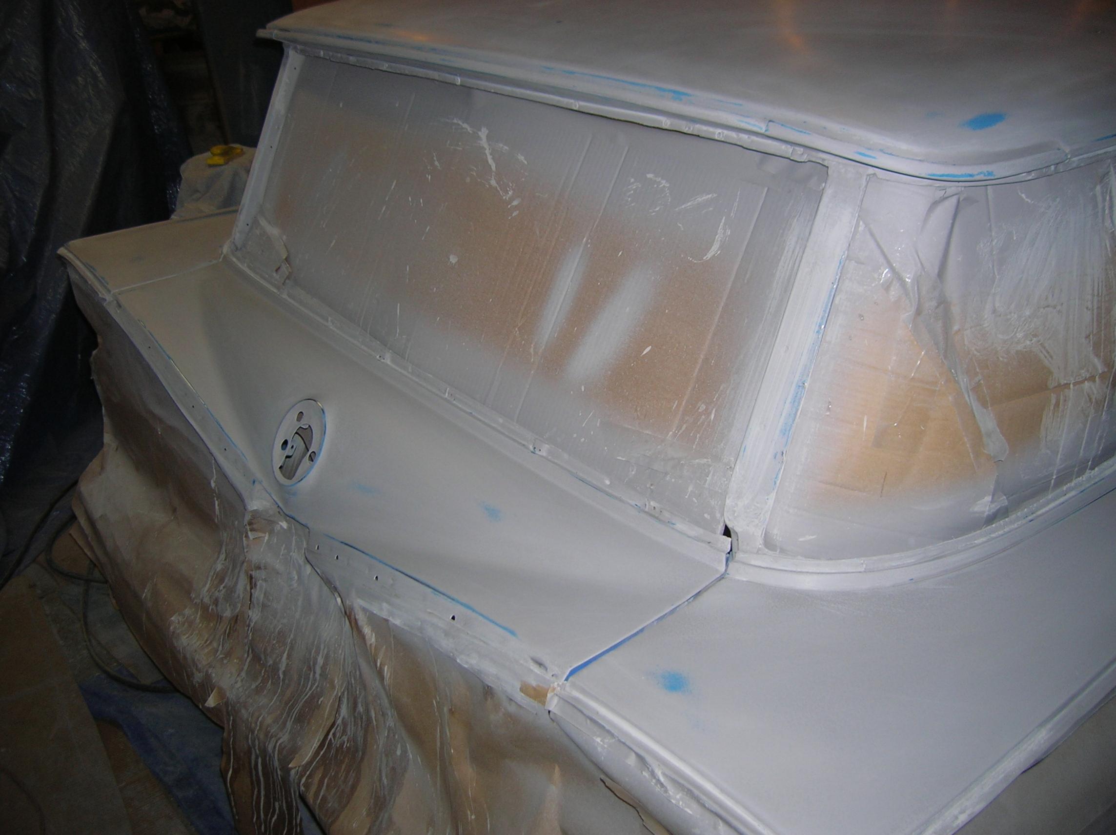

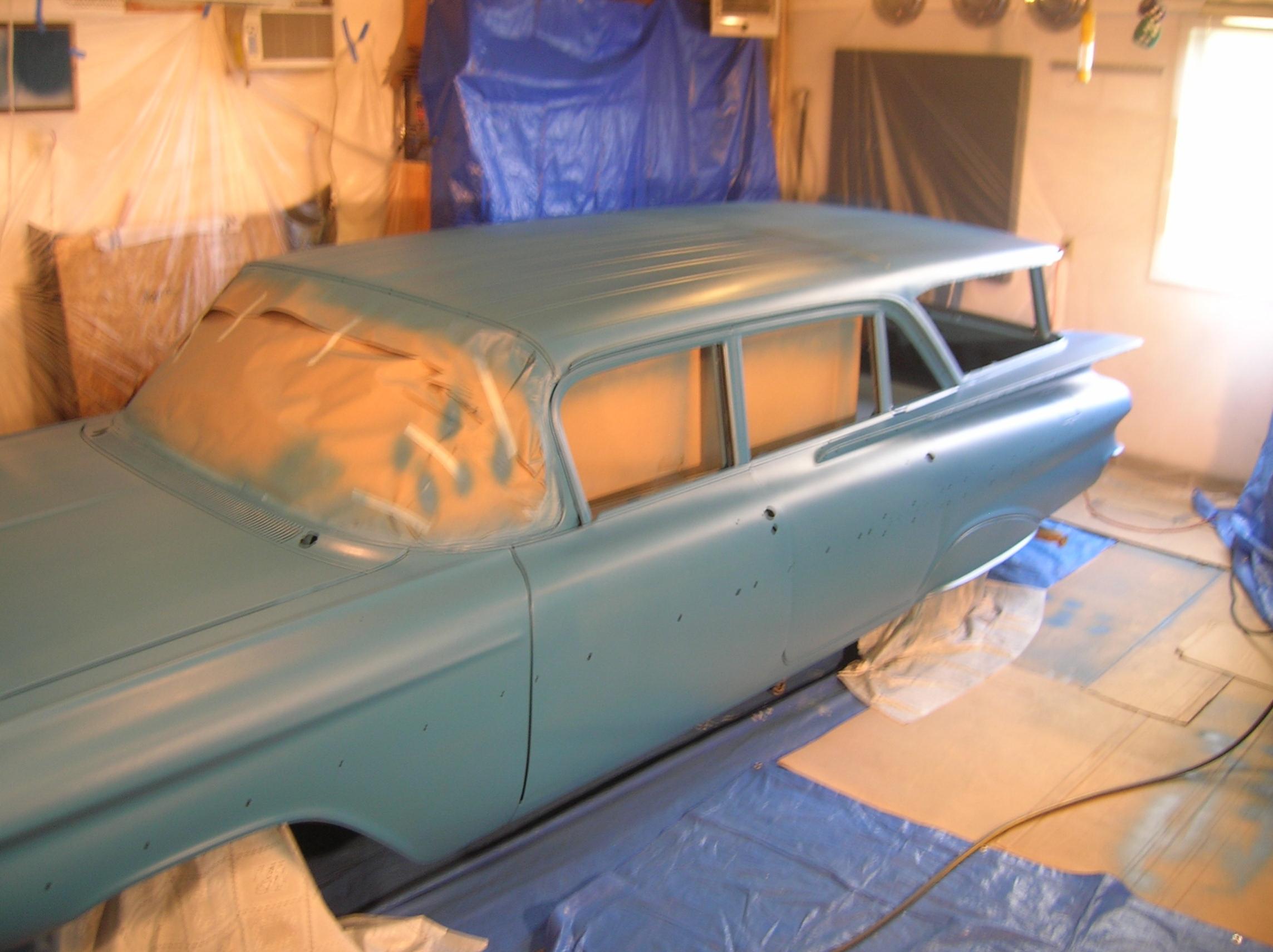

    Here is where the weekend ended, will sand the filler primer tonight if the plan holds.
