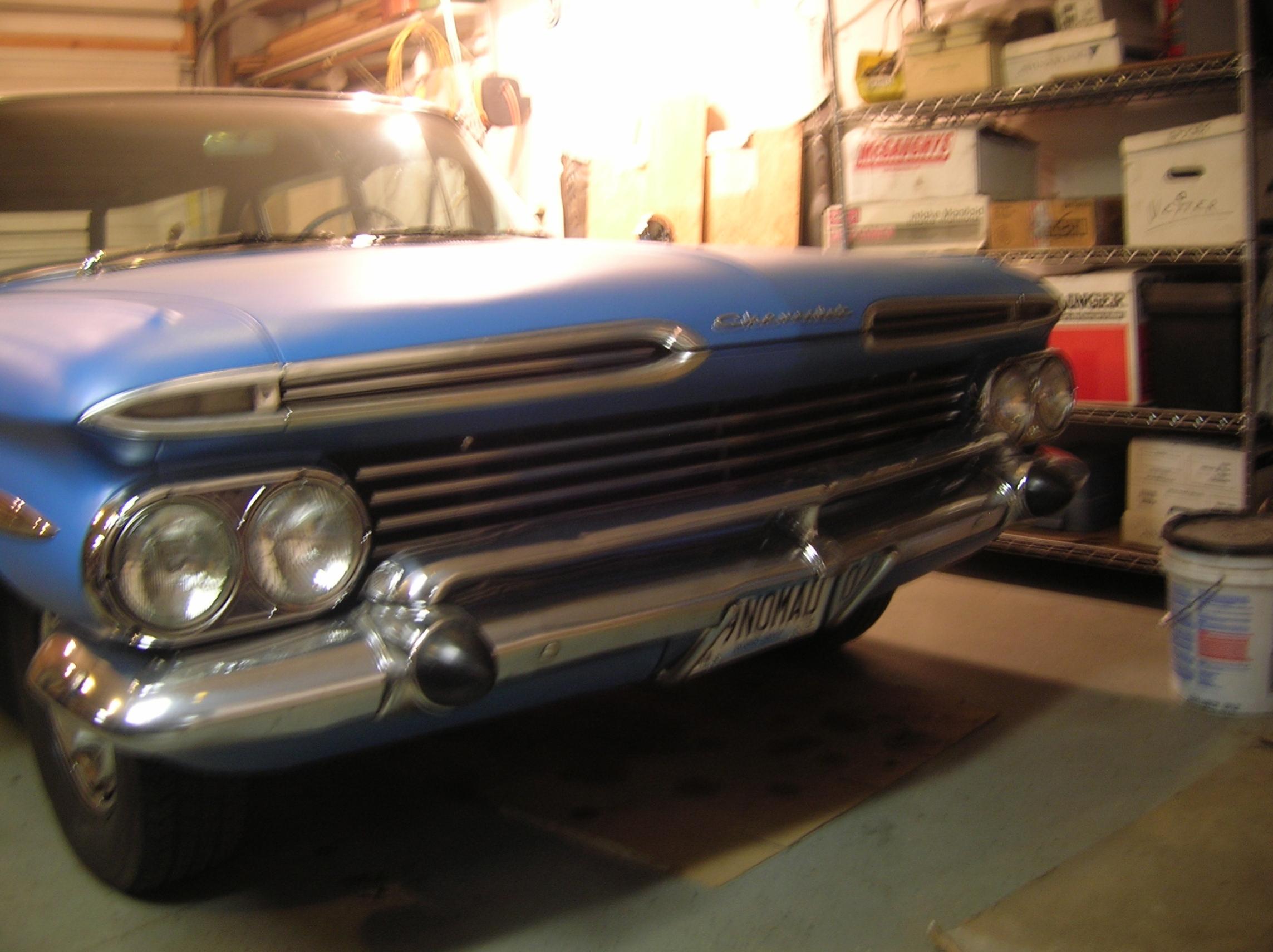

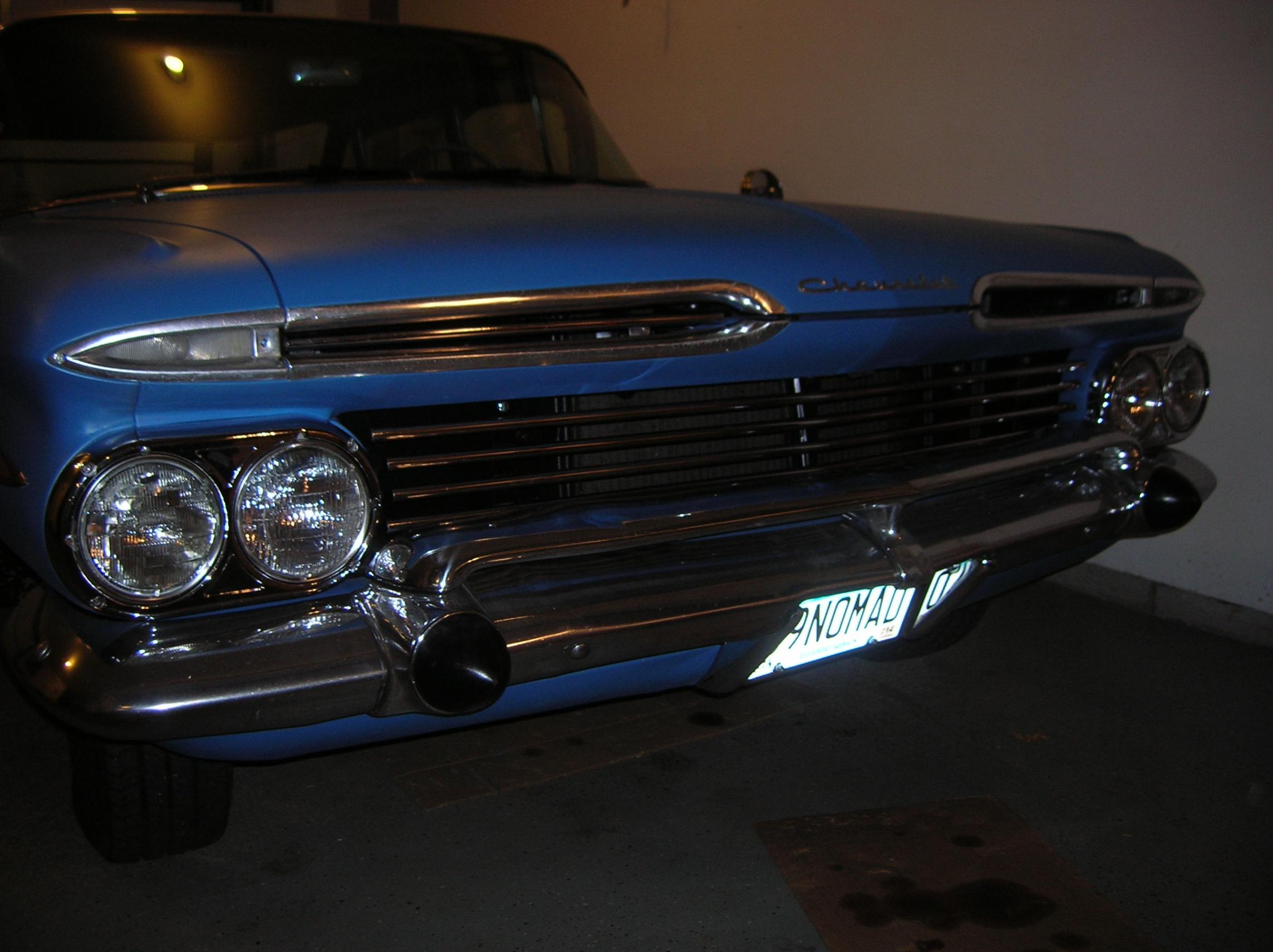

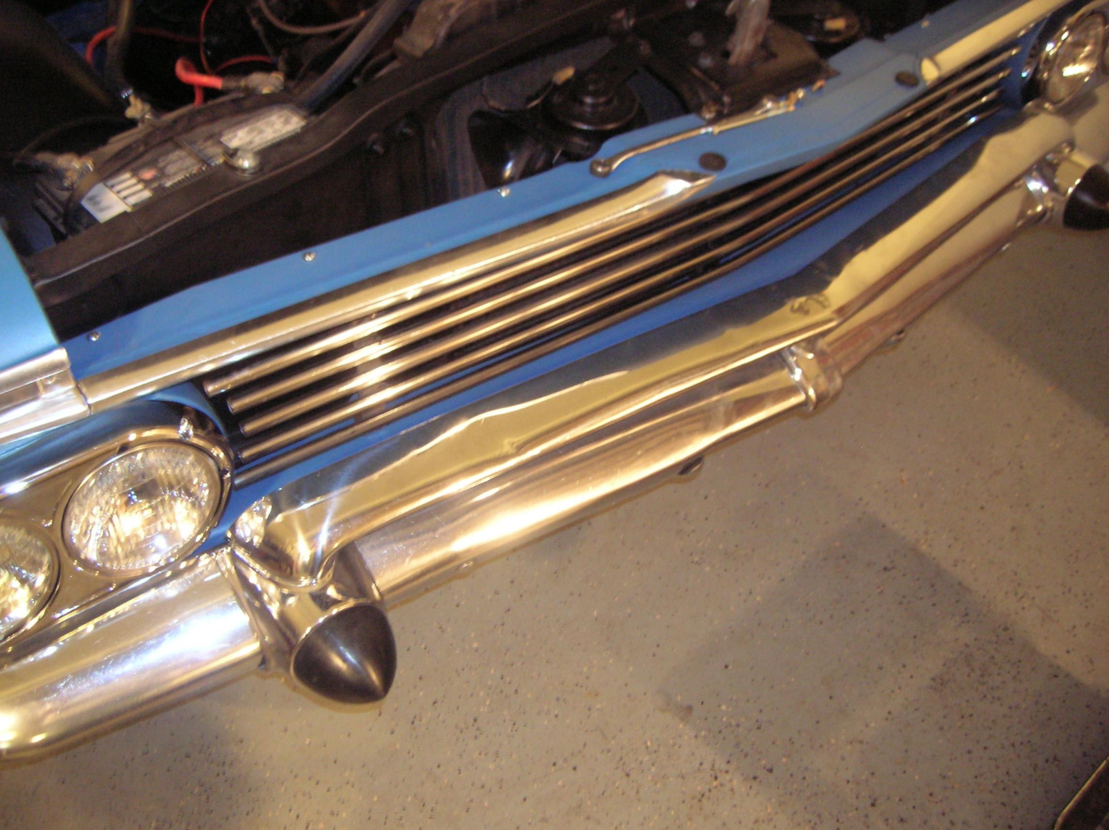

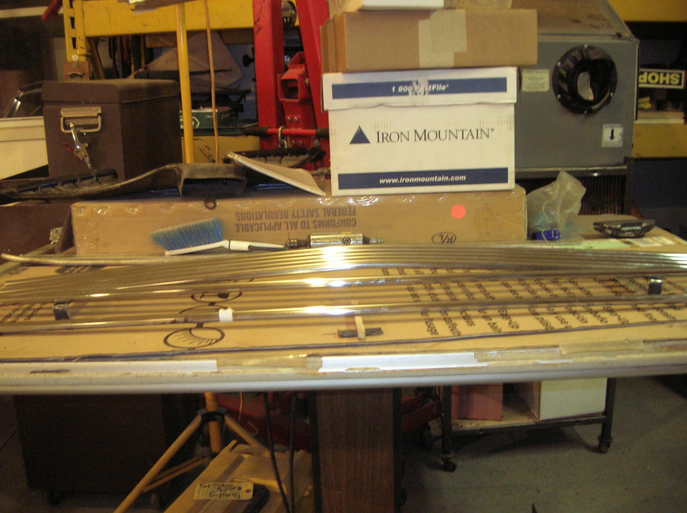

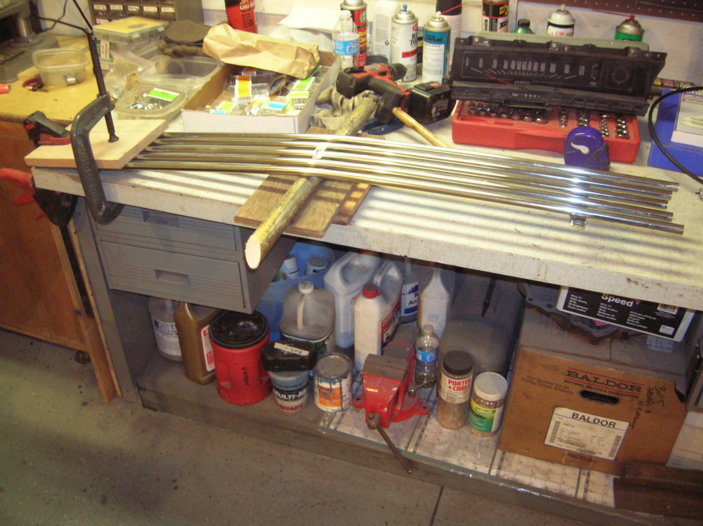

    Life has been hectic but good the past month but i do have a little progress to report.
    Picked up a tube grill from a swap meet this summer and took out two rows, cut 3 of them down on both ends and redid the spacing (some were +/- 1/8", now ~.015")
    It took a little time to figure out how to get the proper curve but got it to work.
    Still need to complete the repainting of the spacer brackets, install the end plugs and polish the chrome.
    Other than that I have been able to put some miles on it and have had it out of the shop while attending to my OT car
    With fall here (and what is sure to follow), it is time to start planning the next steps.
  9. That looks pretty good in there, nice work! Gives it sort of a Buick look, I like it.

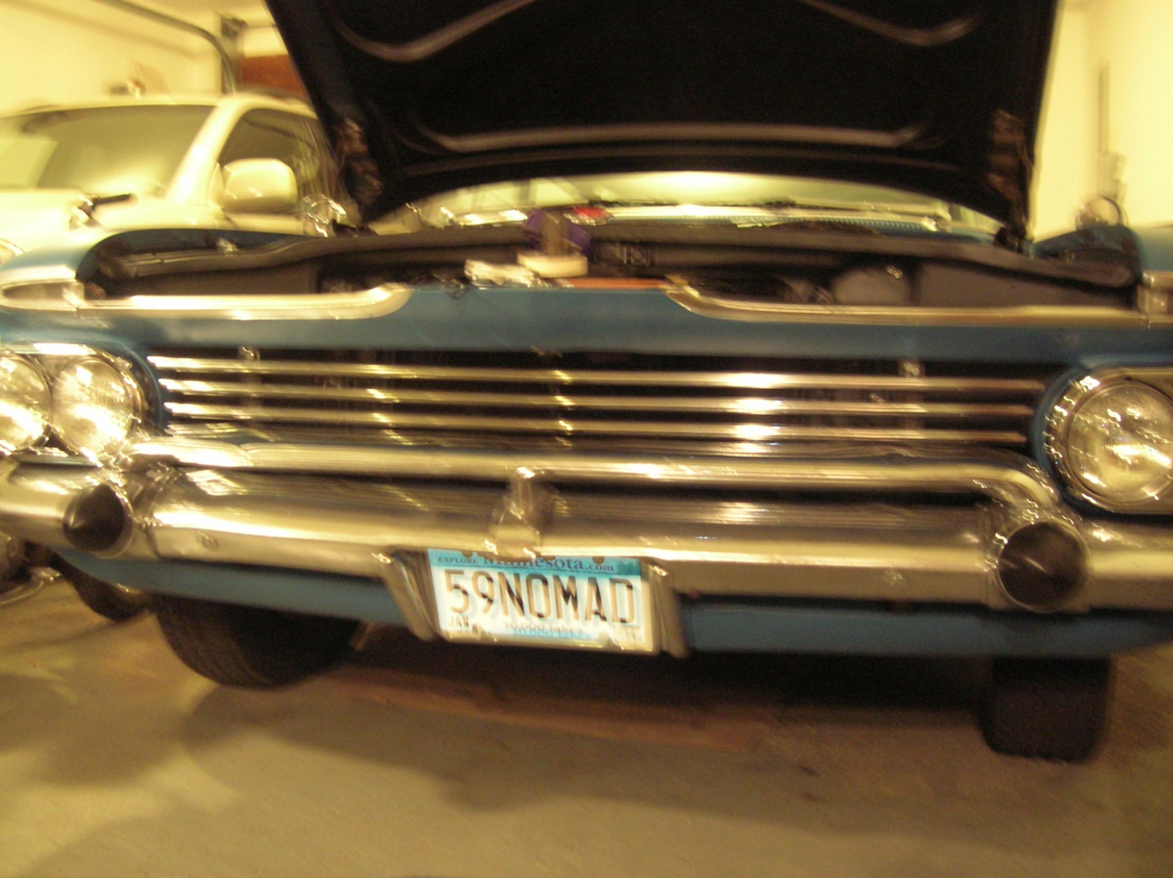

    Thank Fan Attic,
    Got the brackets all painted and it is installed. Still have the original grill (2 actually) but like this and think it will stay.
    The plan is to also make a single one to go on each side in the area between the hood and valance. i will post a picture once done.

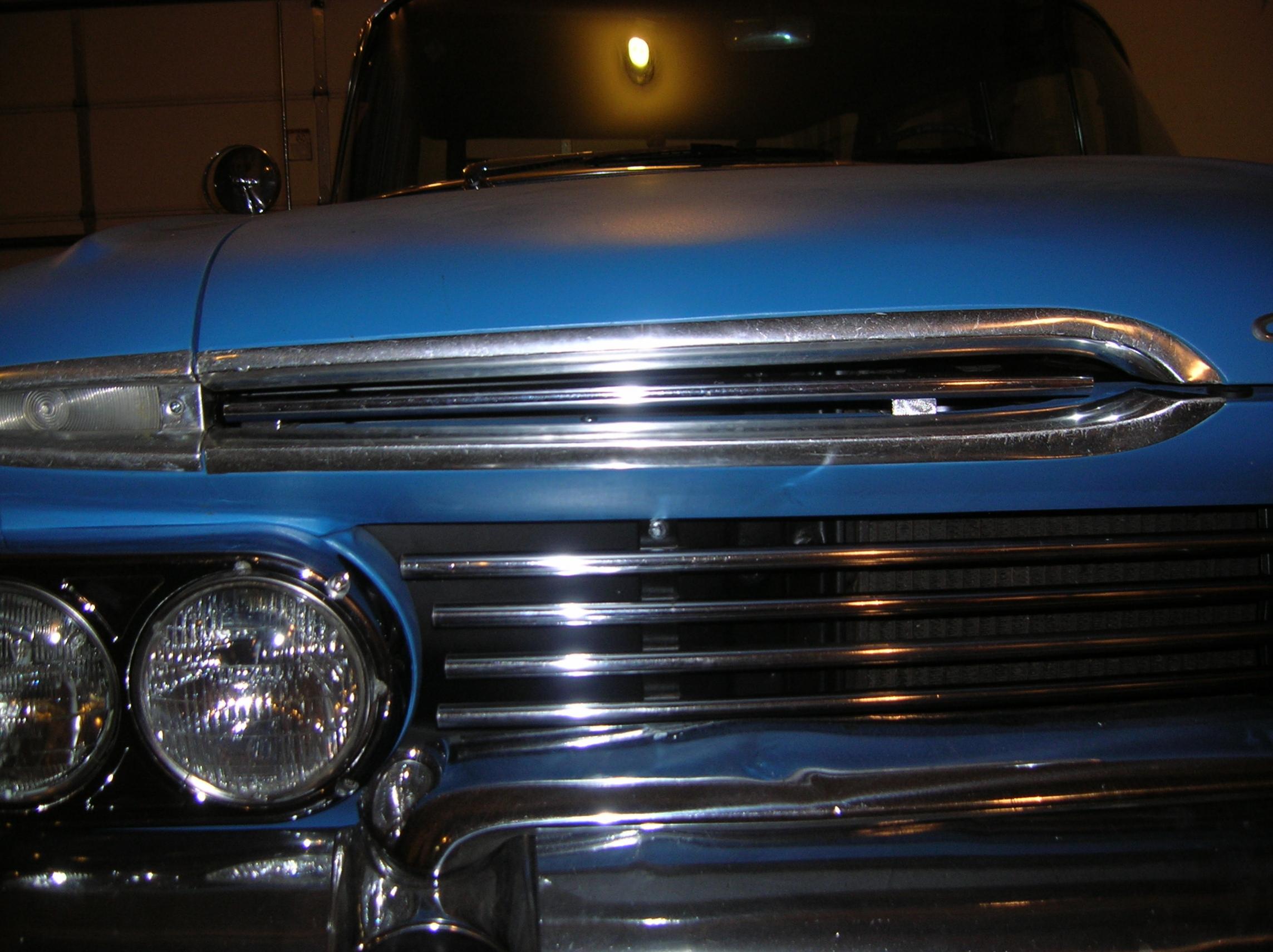

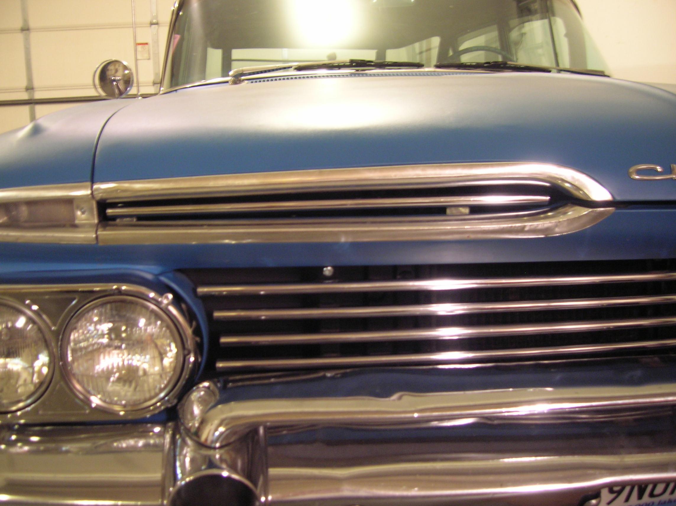

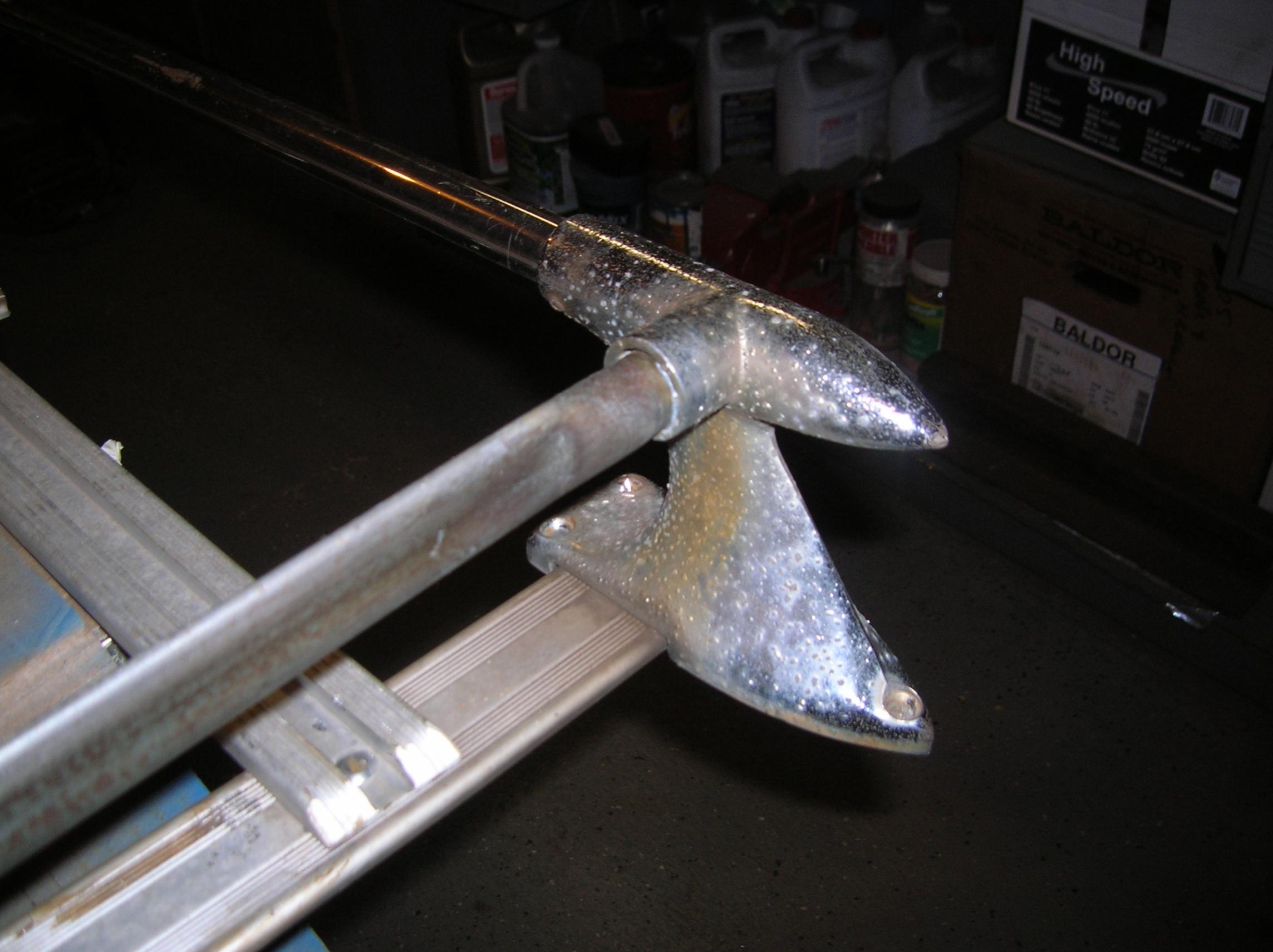

    Mocked up one of the chrome tubes to fill the "eyebrow" slots.
    It needs a little adjustment, end caps and paint in the mounting brackets but the custom look seems to go with the grill.
    With tubing to spare why now make a set but will need to find some of the "bullet shaped" end caps. Anyone know where to get them?

    Thanks Guys, i finished fabricating the mounting brackets that use existing holes, got them painted, polished and mounted.
    here is the look from as far back as i could get.

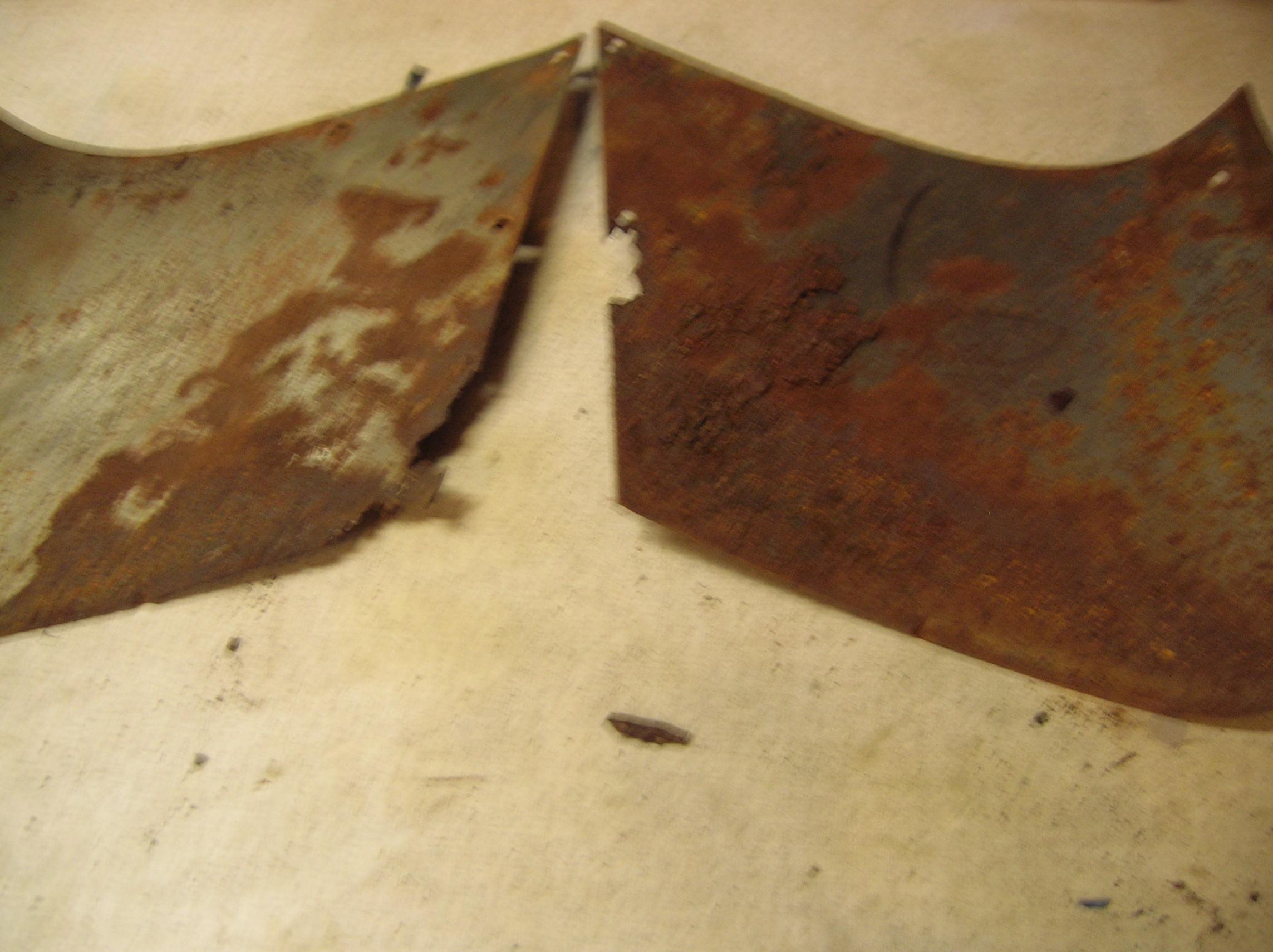

    And now it is on to more rusty part repairs, interior version. plan is got one last round of DPLF-60 on a dozen or so remaining items
    more sand blasting in store

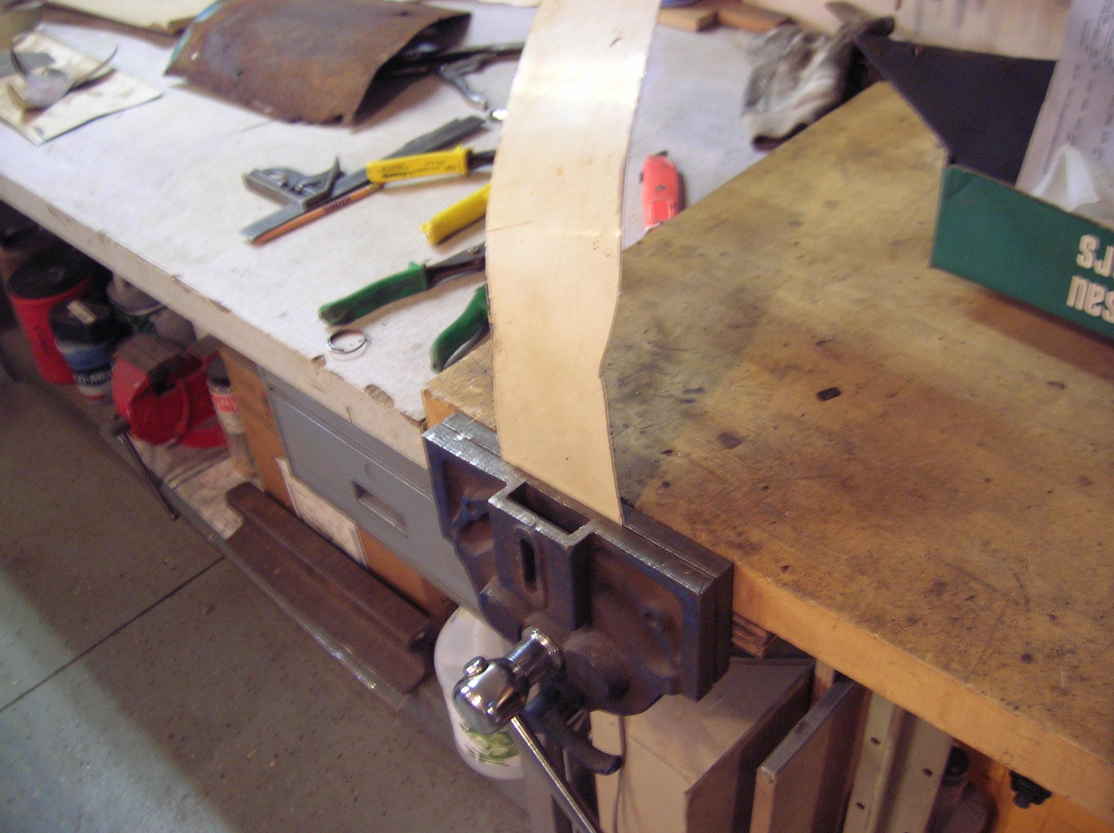

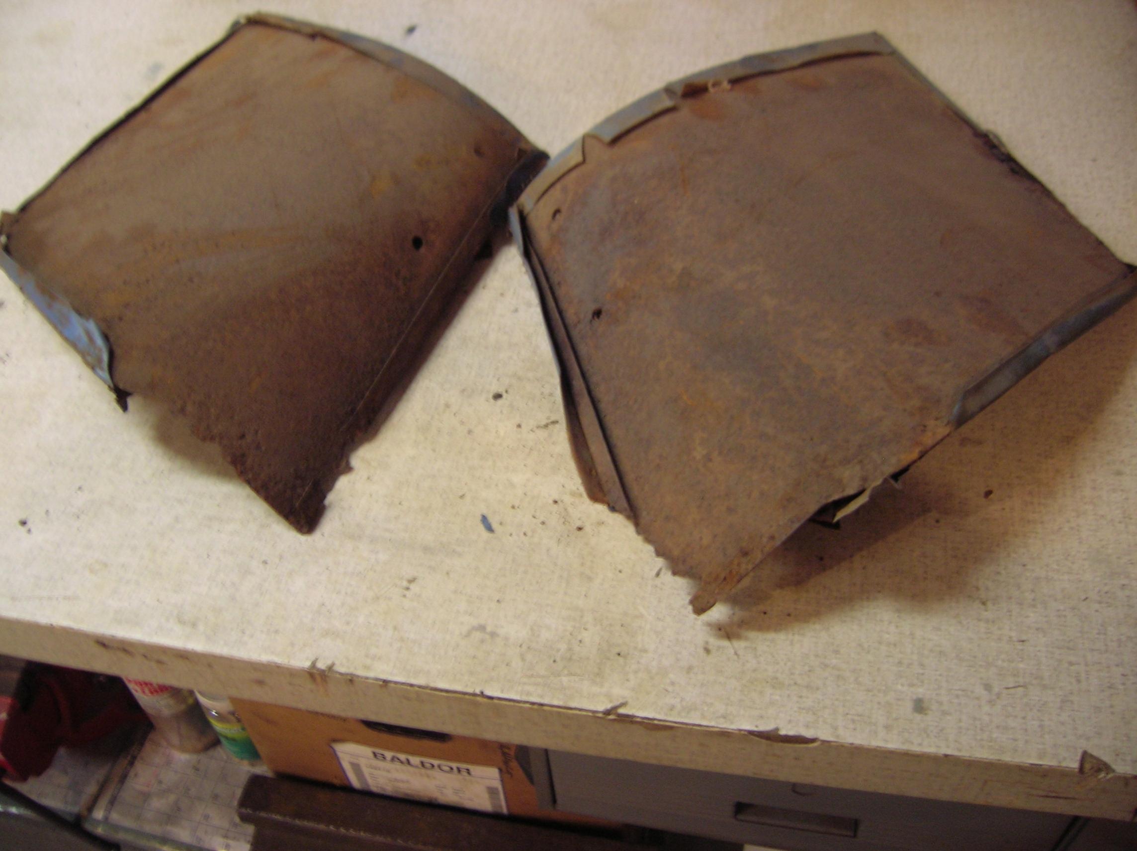

    Bruce A Lyke

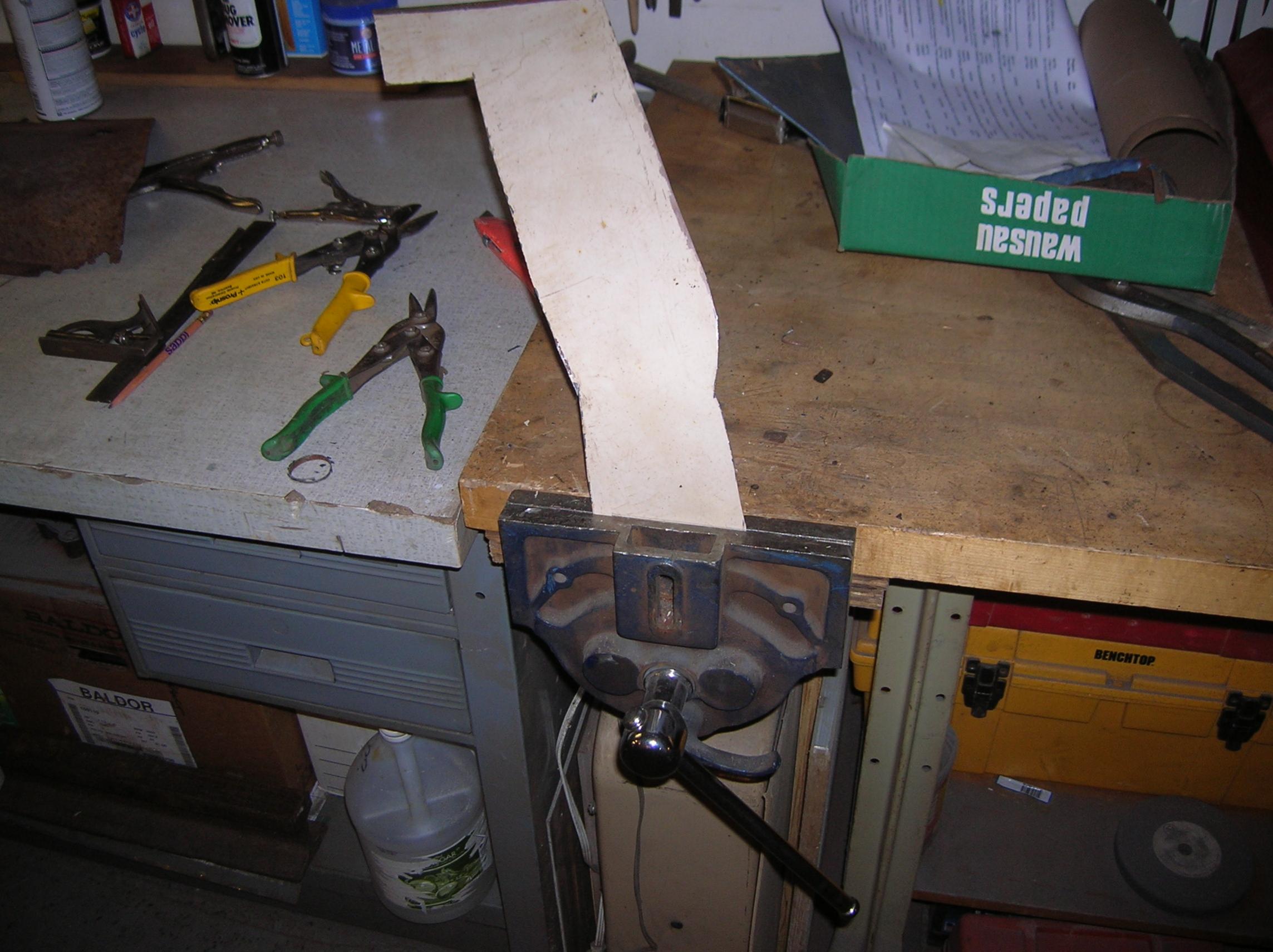

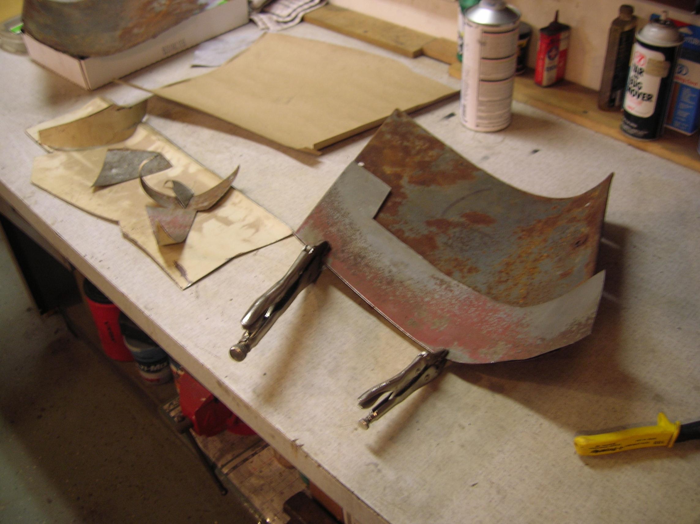

    Well one would think that working on the inside would reduce the rust repairs, but looking a the next wave, the welder and left over steel fro the 61 Belair will still be needed.
    Here is the start of the work to remake the inside rear side covers. They will be covers with vinyl so it may not have to be too fussy, TBD
    one more chance to learn how to make parts and if it is a disaster, replacements can be found.

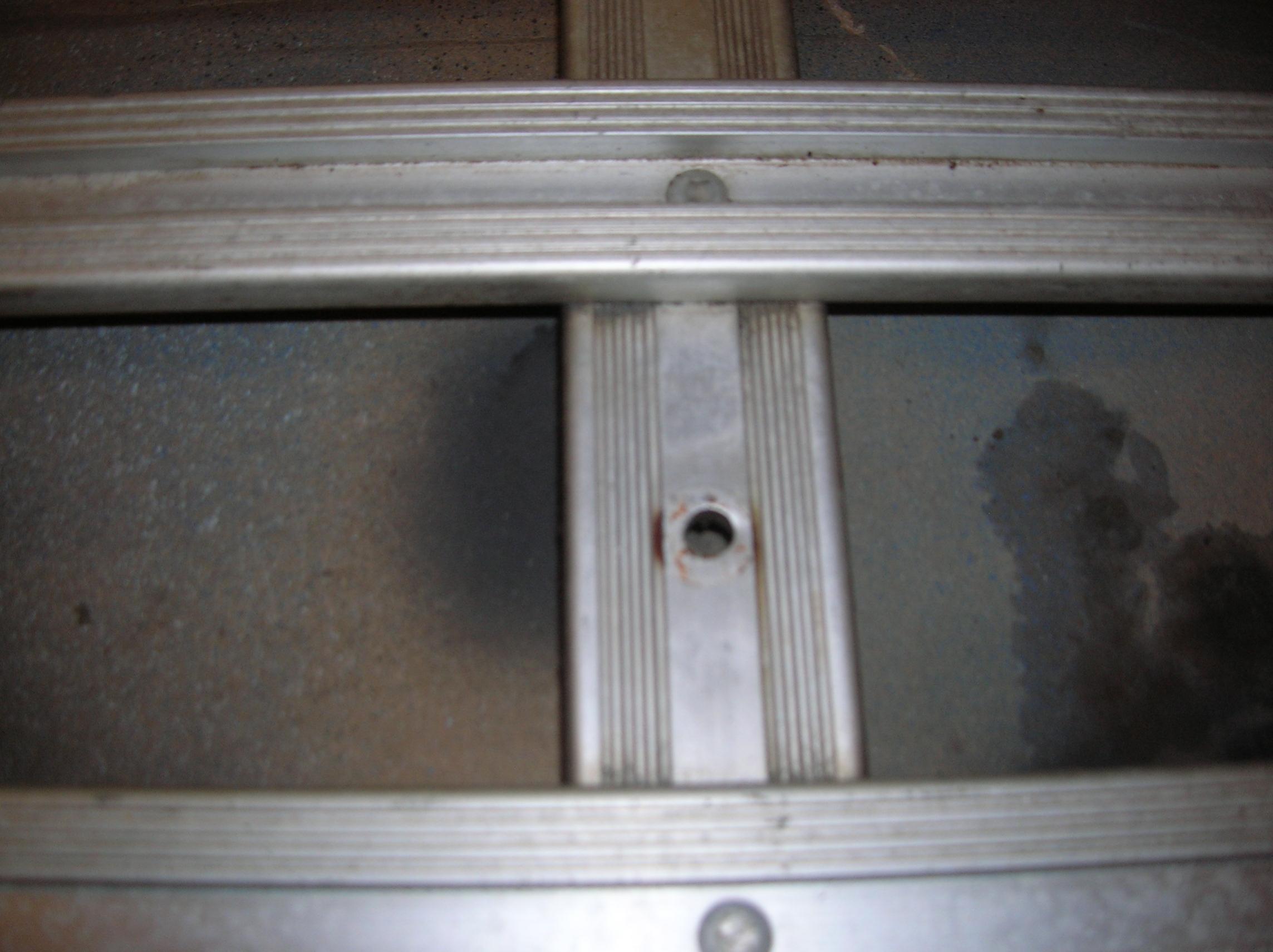

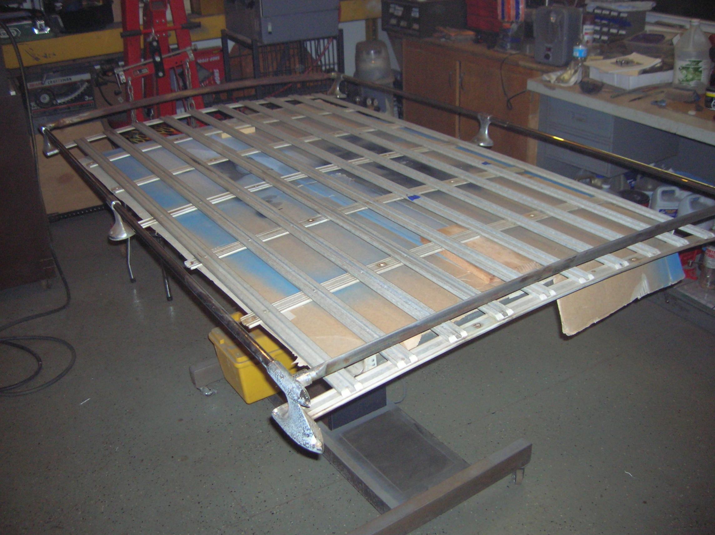

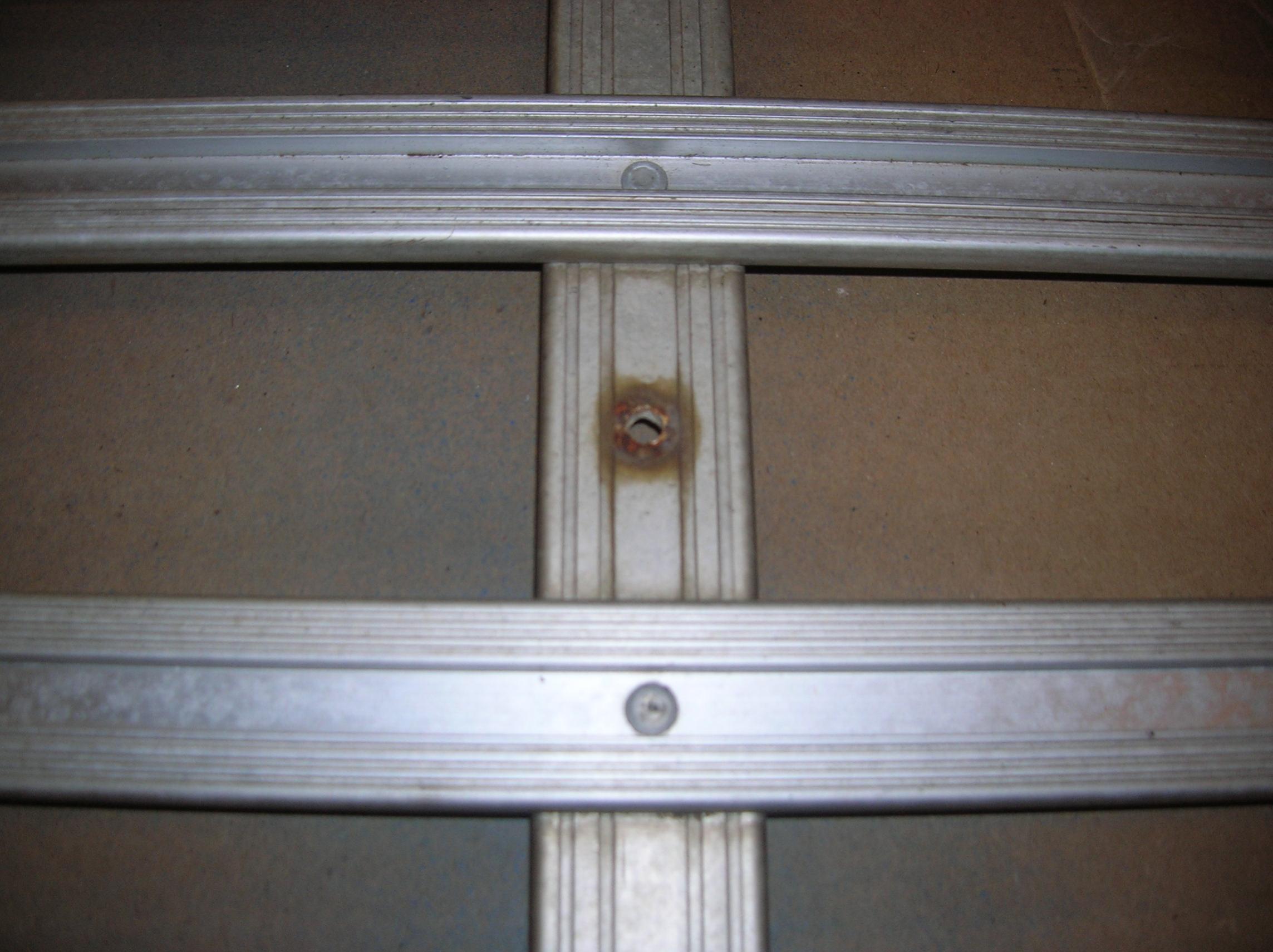

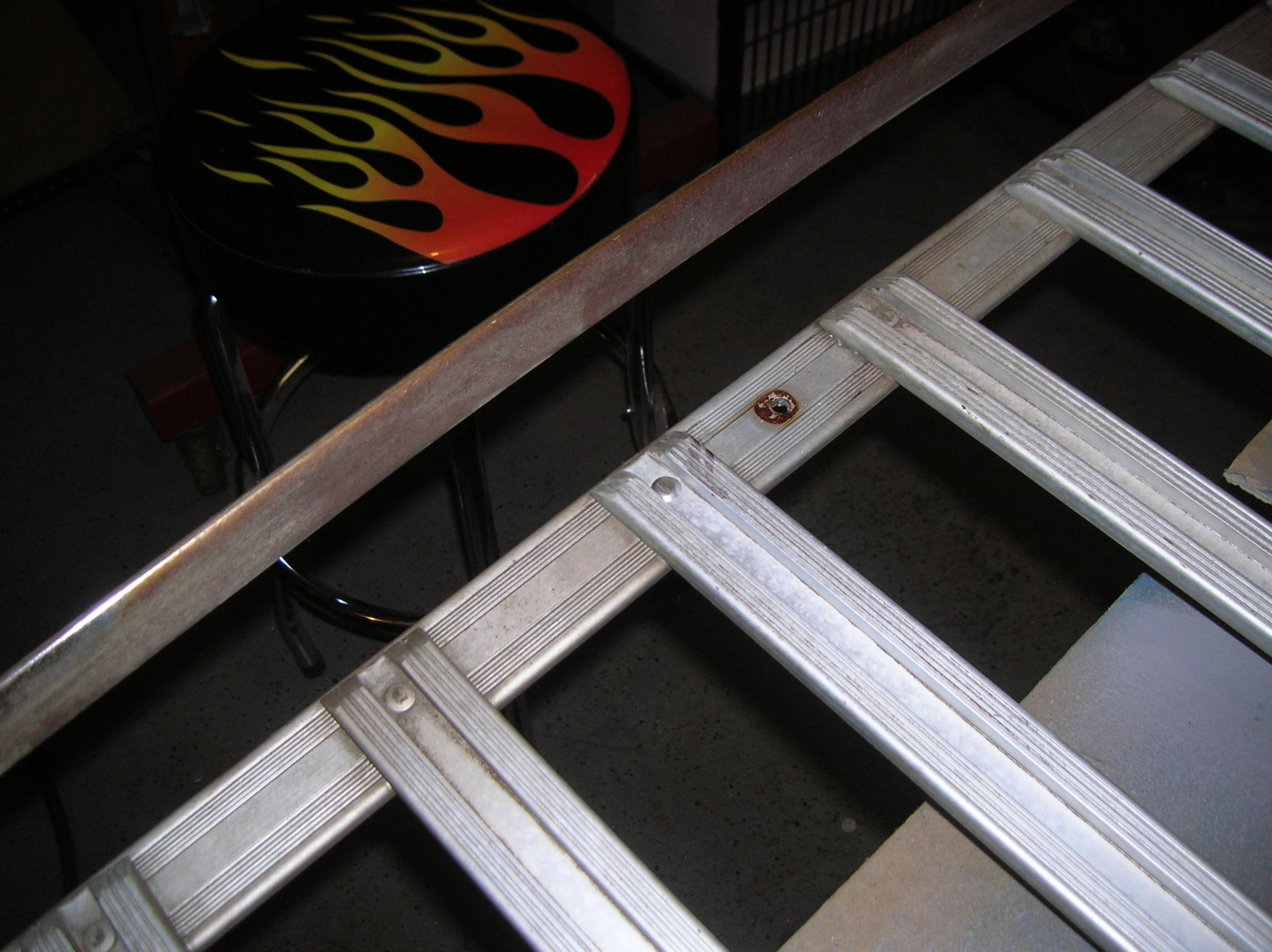

    Started in on the rook rack
    Re-Platting is out of the budget so a good clean and polish is the plan.
    Also replacing 6 broken rivets.
