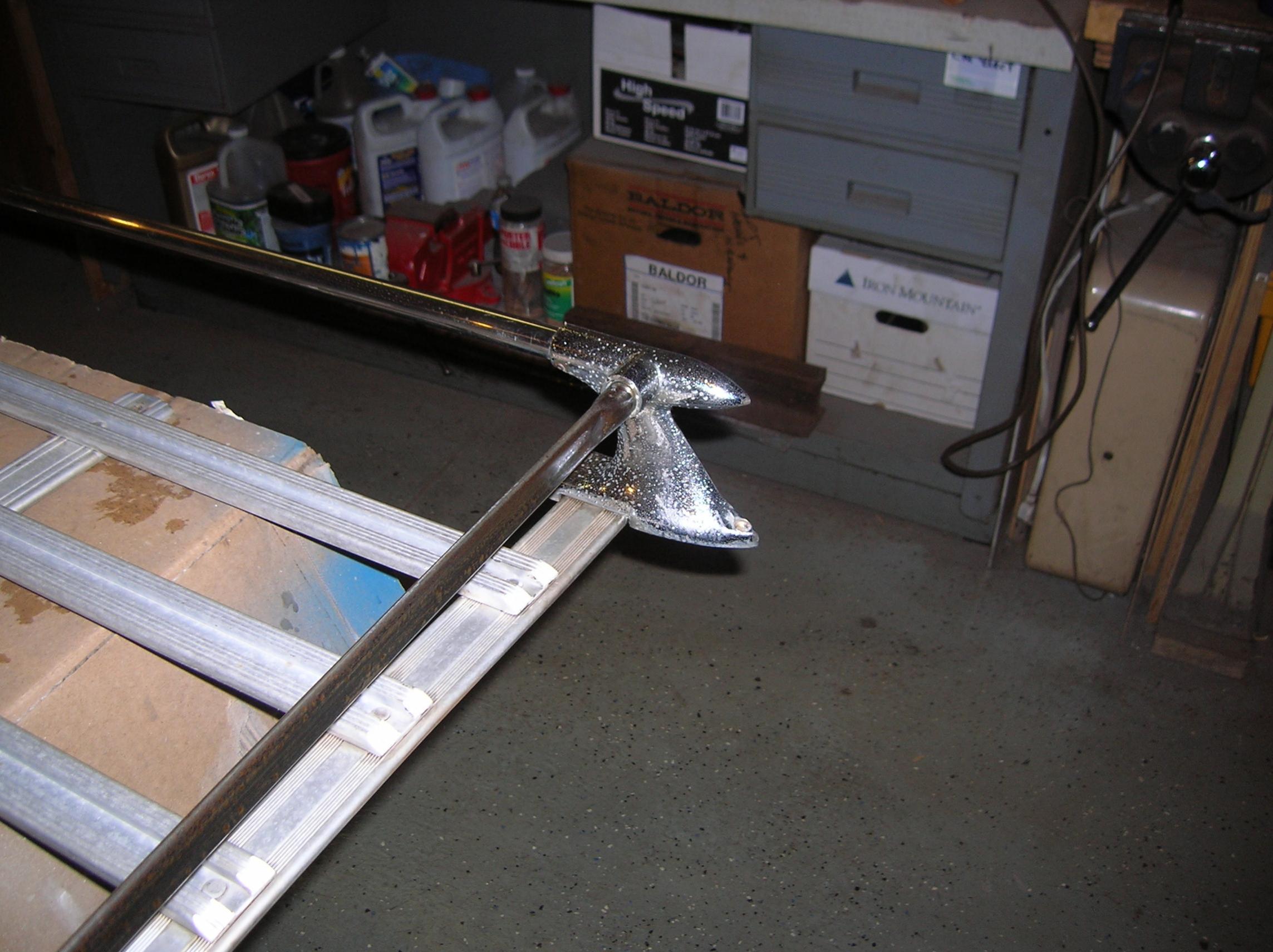

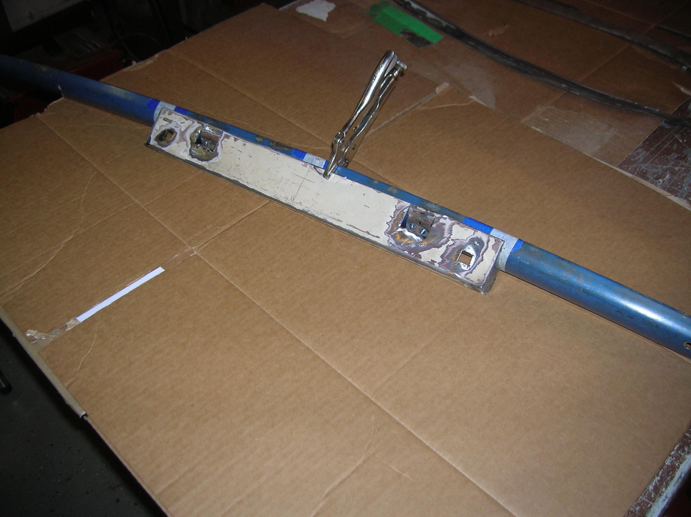

    Here is a look at the cleaned up rack. All of the broken rivets have been replaced. The two cross pieces are proving to have dome very suborn rust spots but overall it looks a lot better.
  5. That rack looks a lot better. The donor for the rack I moved was an '81 Suburban and it had 1/4"x20 RivNuts and machine screws from the factory. If your rack has smaller mount holes you could consider opening the screw holes up to fit a #10 X 24 or 1/4"x 20 when you're ready to pull the supports for plating.

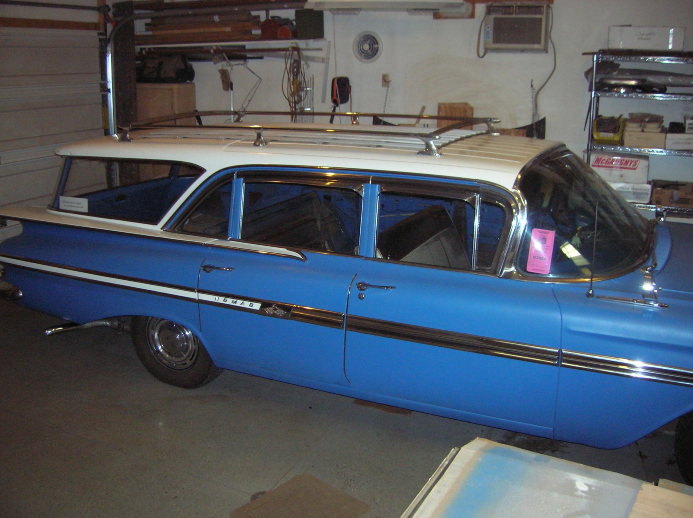

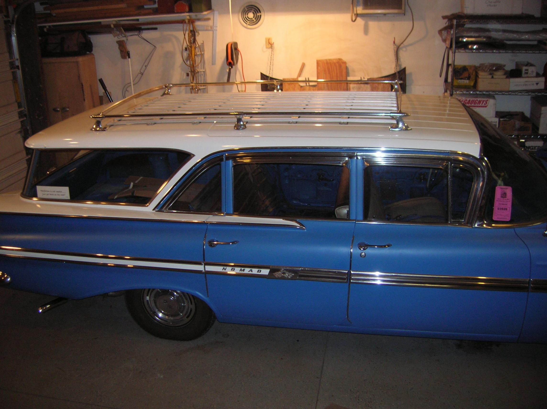

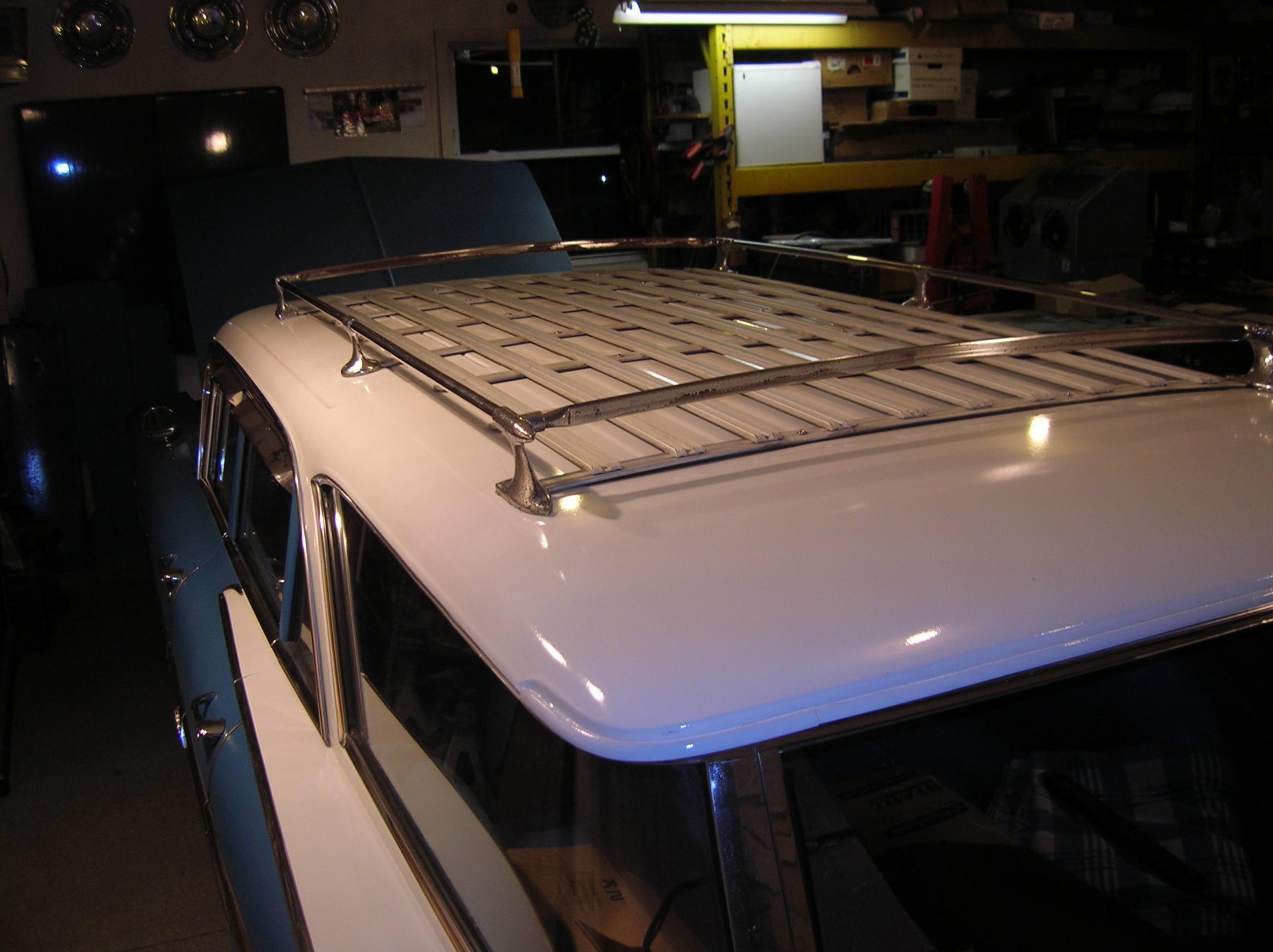

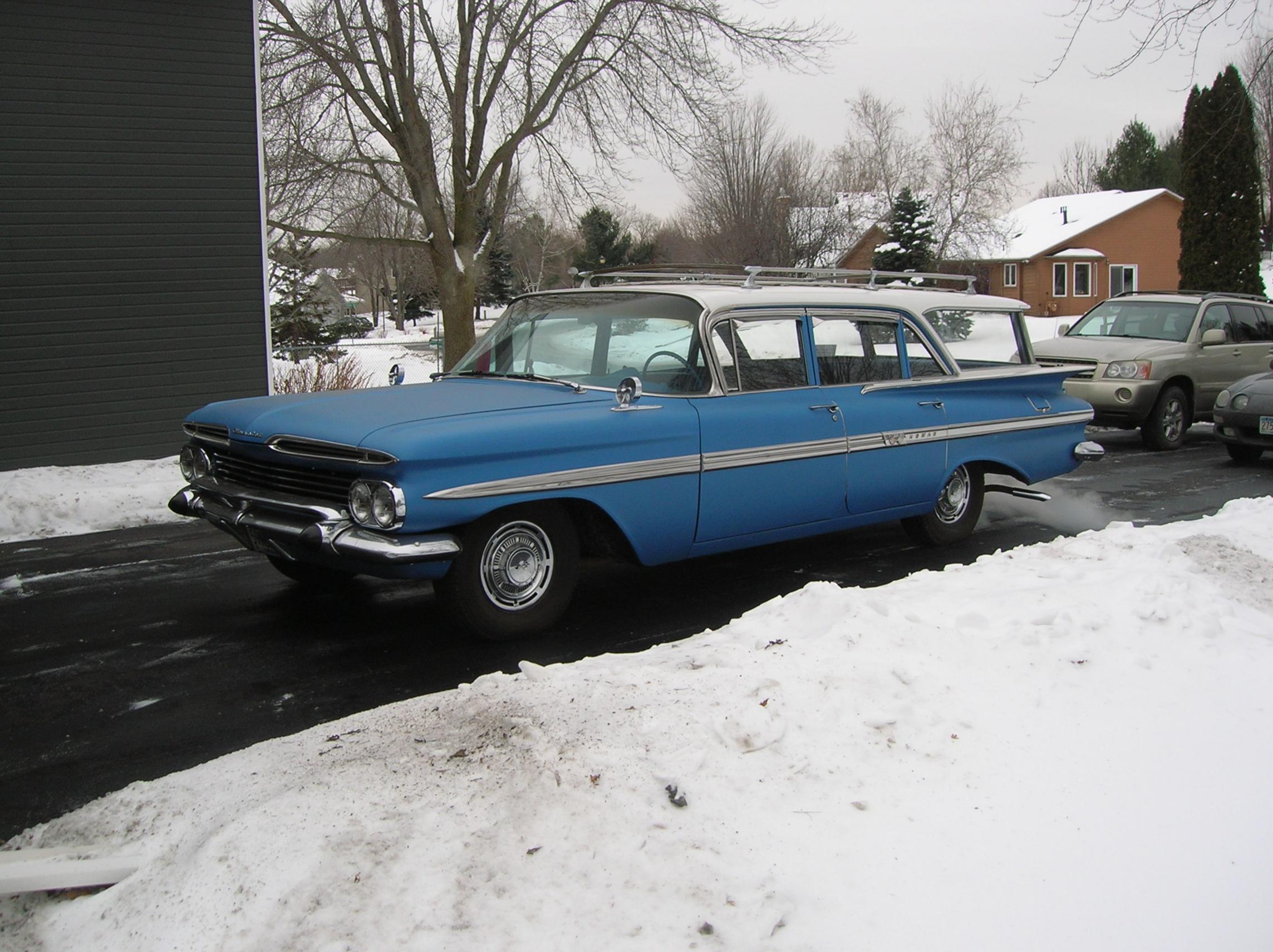

    Put the roof rack back on the wagon tonight, yes a re-chrome would be nice, but it is much better and it will do for now.
  12. That looks great! I got the pics of the one I did but haven't been up to the house early enough to get them downloaded and posted. Your wagon looks like a new one, from '59. You've done a great job getting here from where it started!

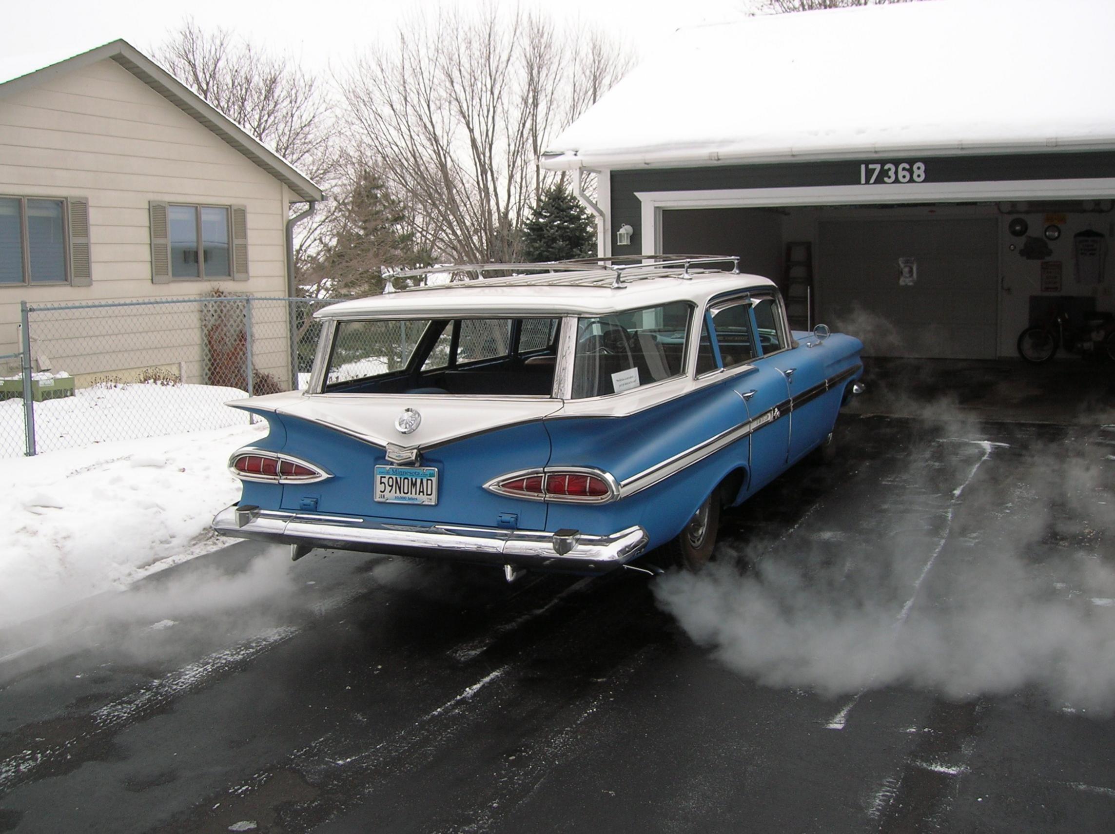

    took a very short drive today (~80 feet), but it was still nice to fire it up and see the light of day (on the shortest day)

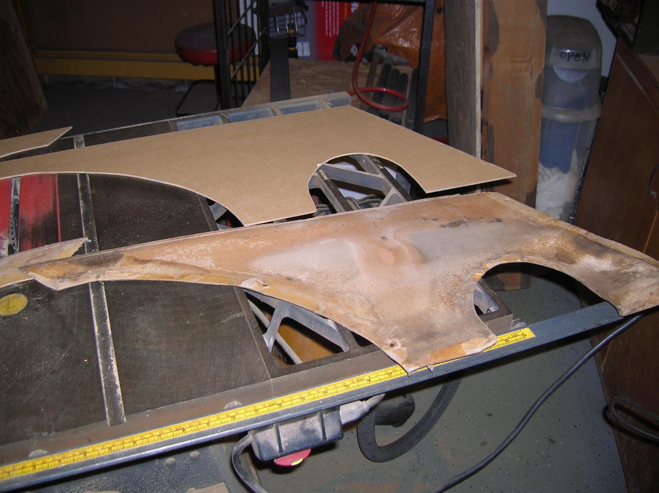

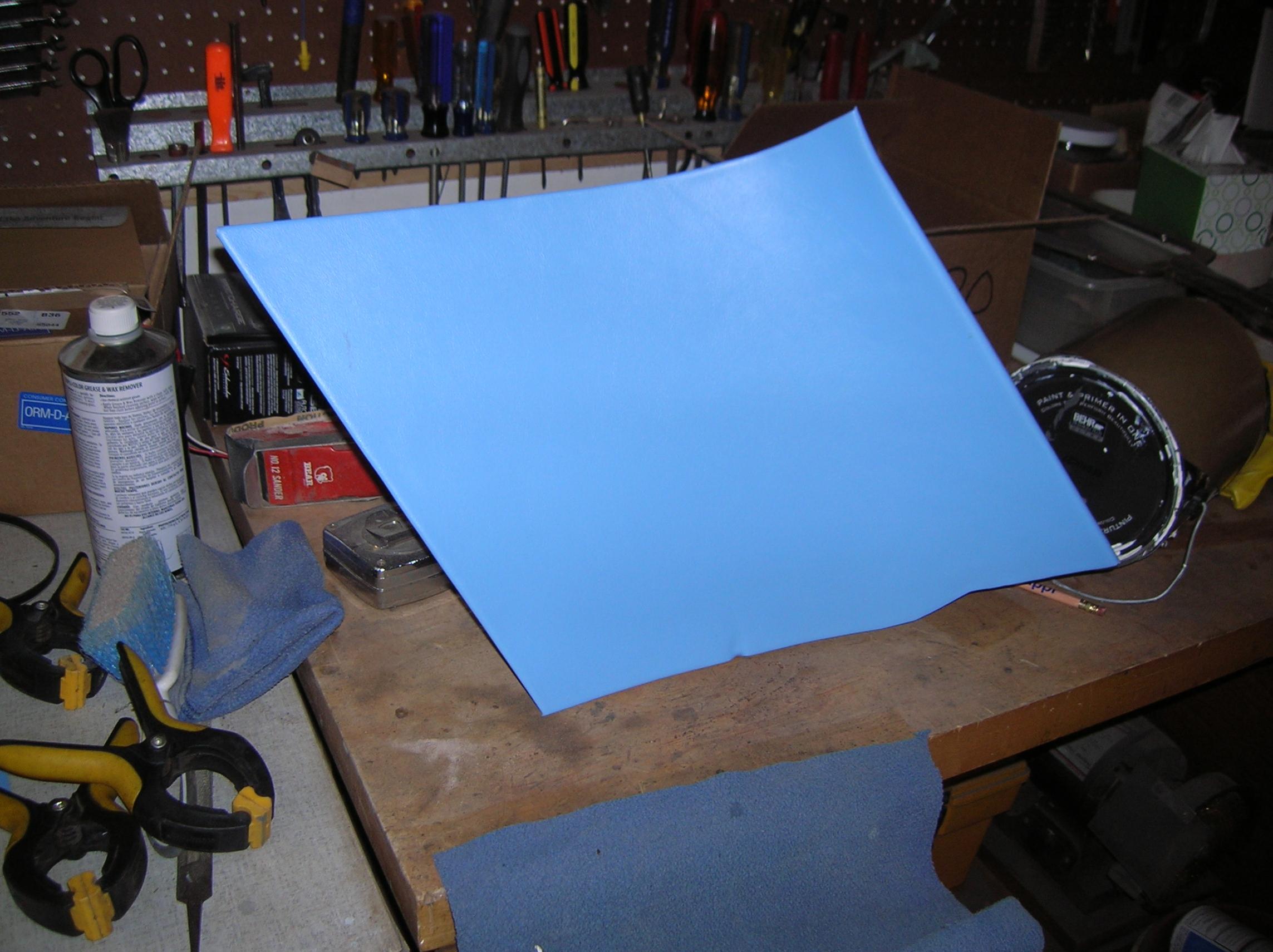

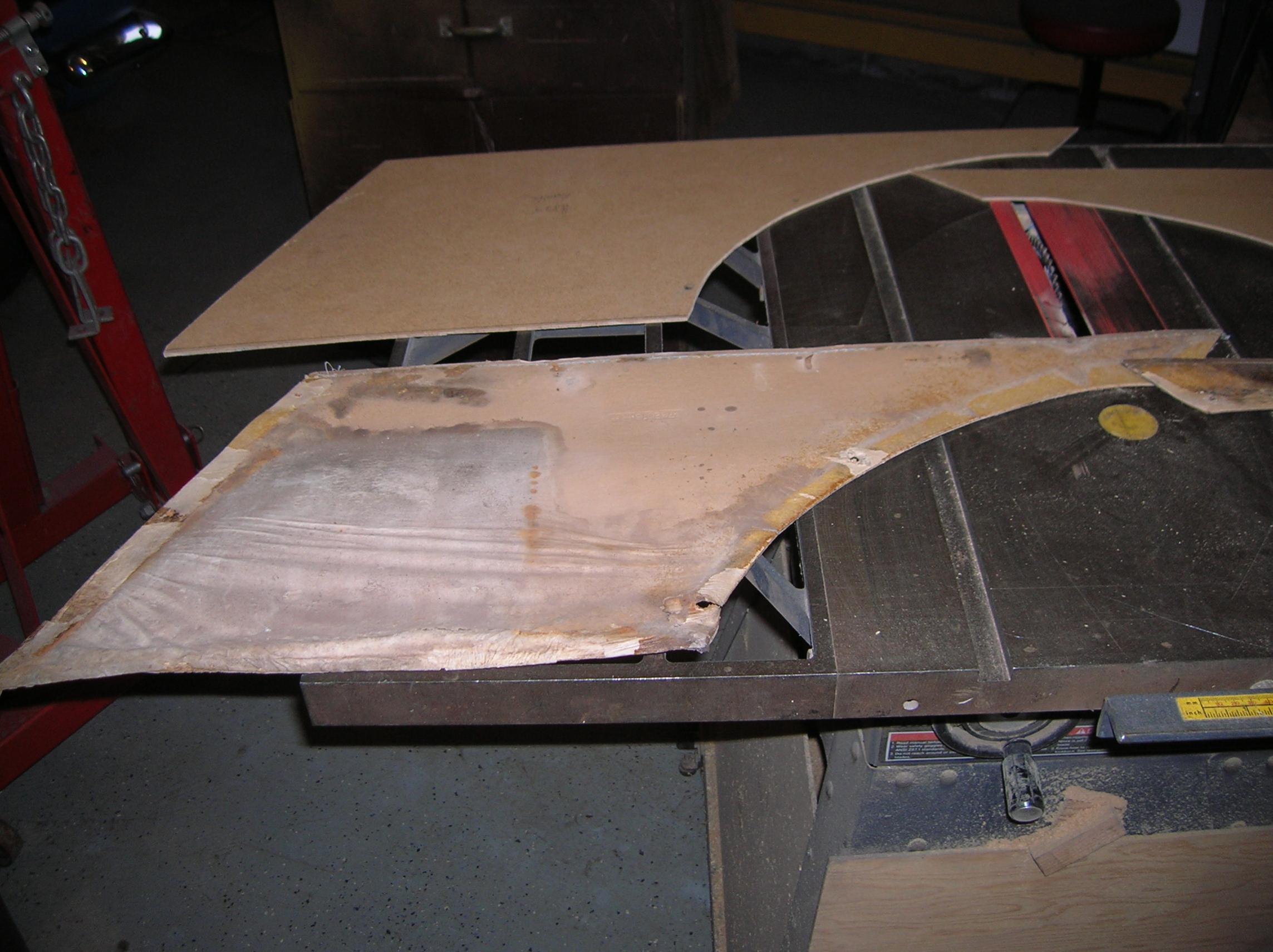

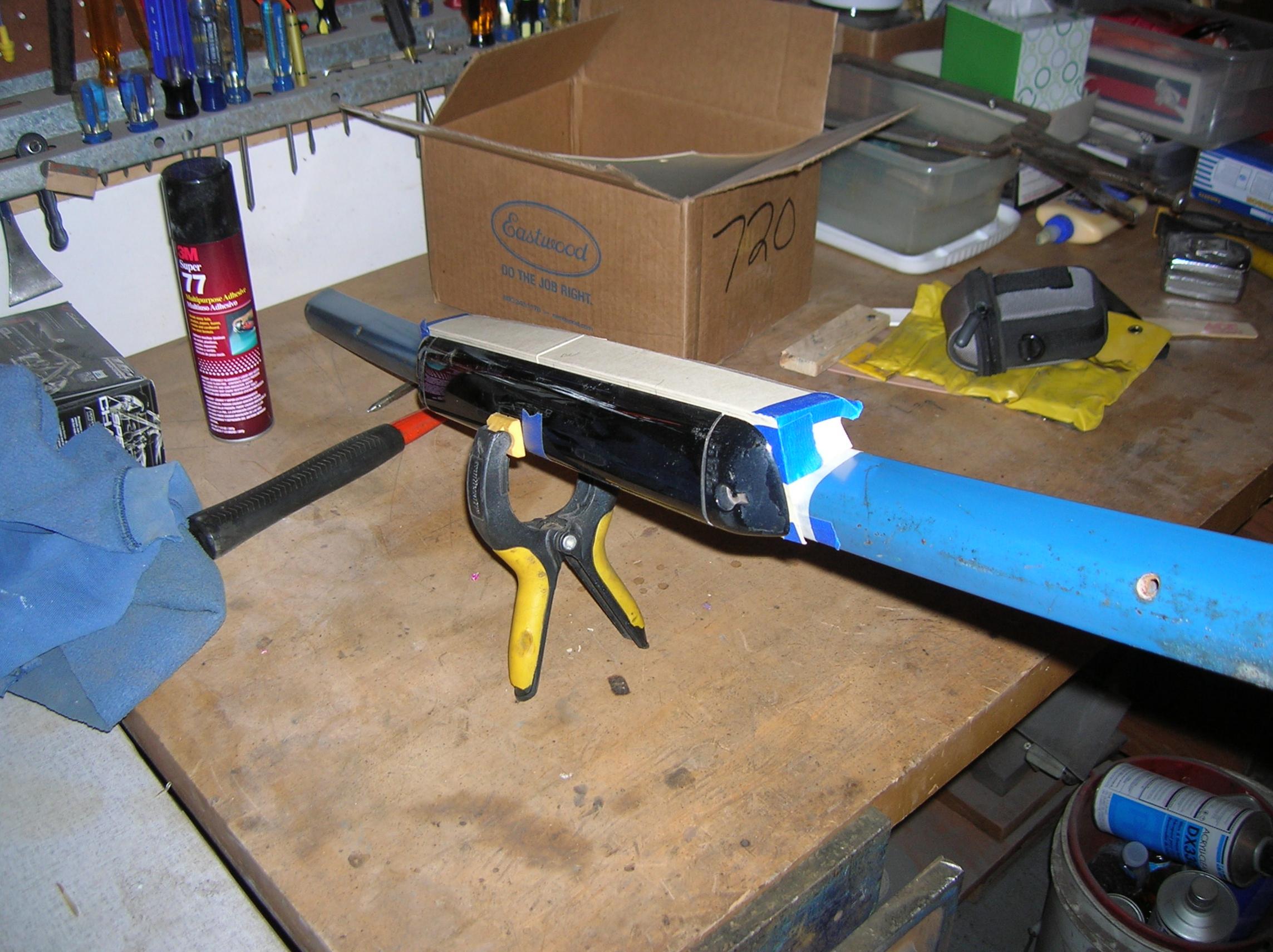

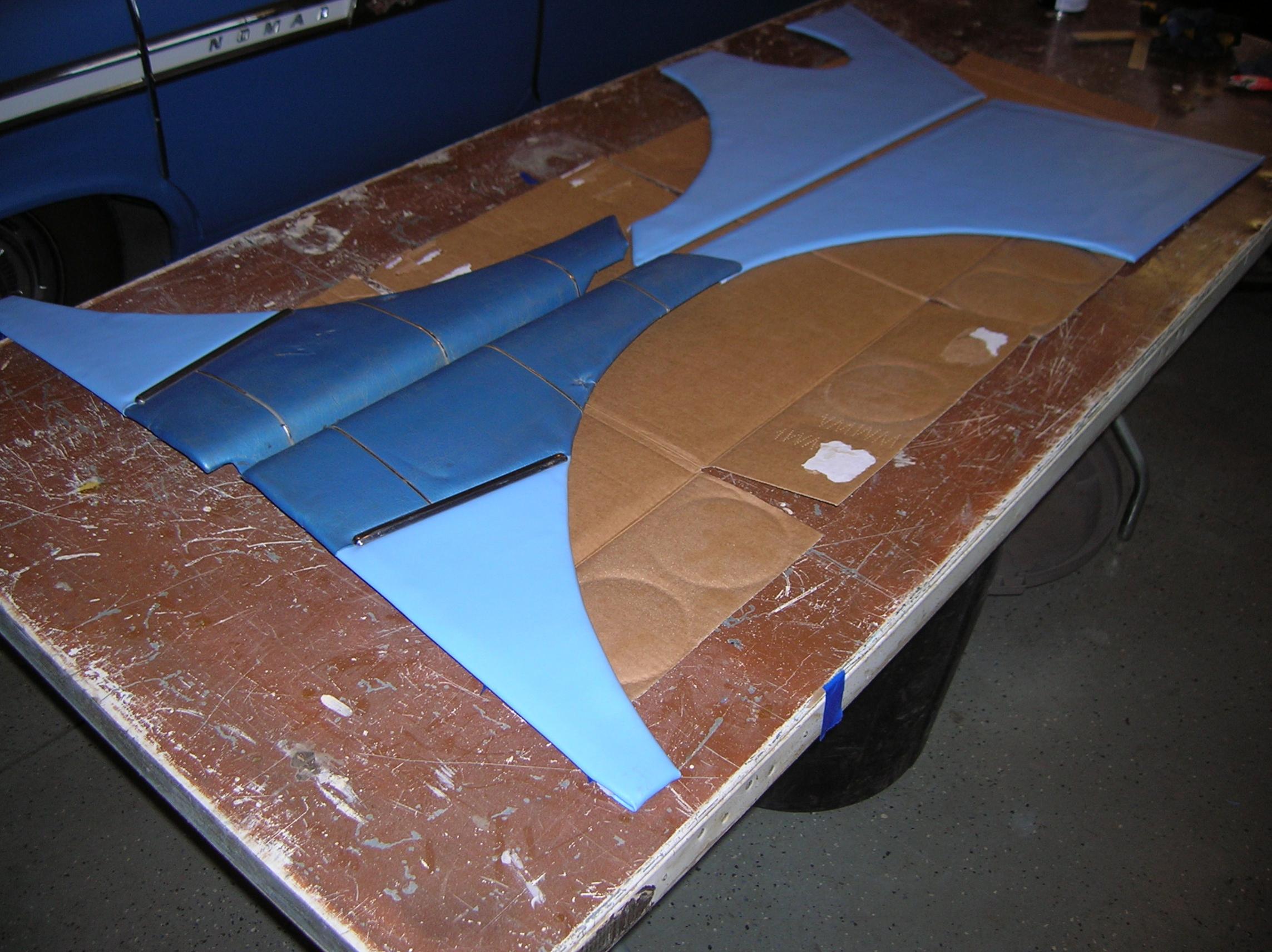

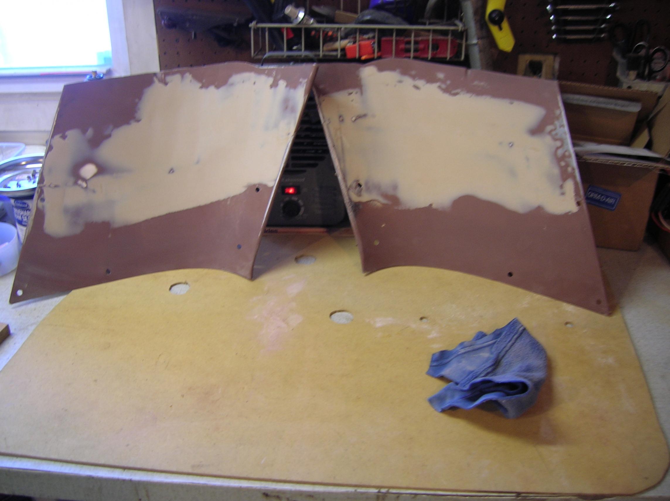

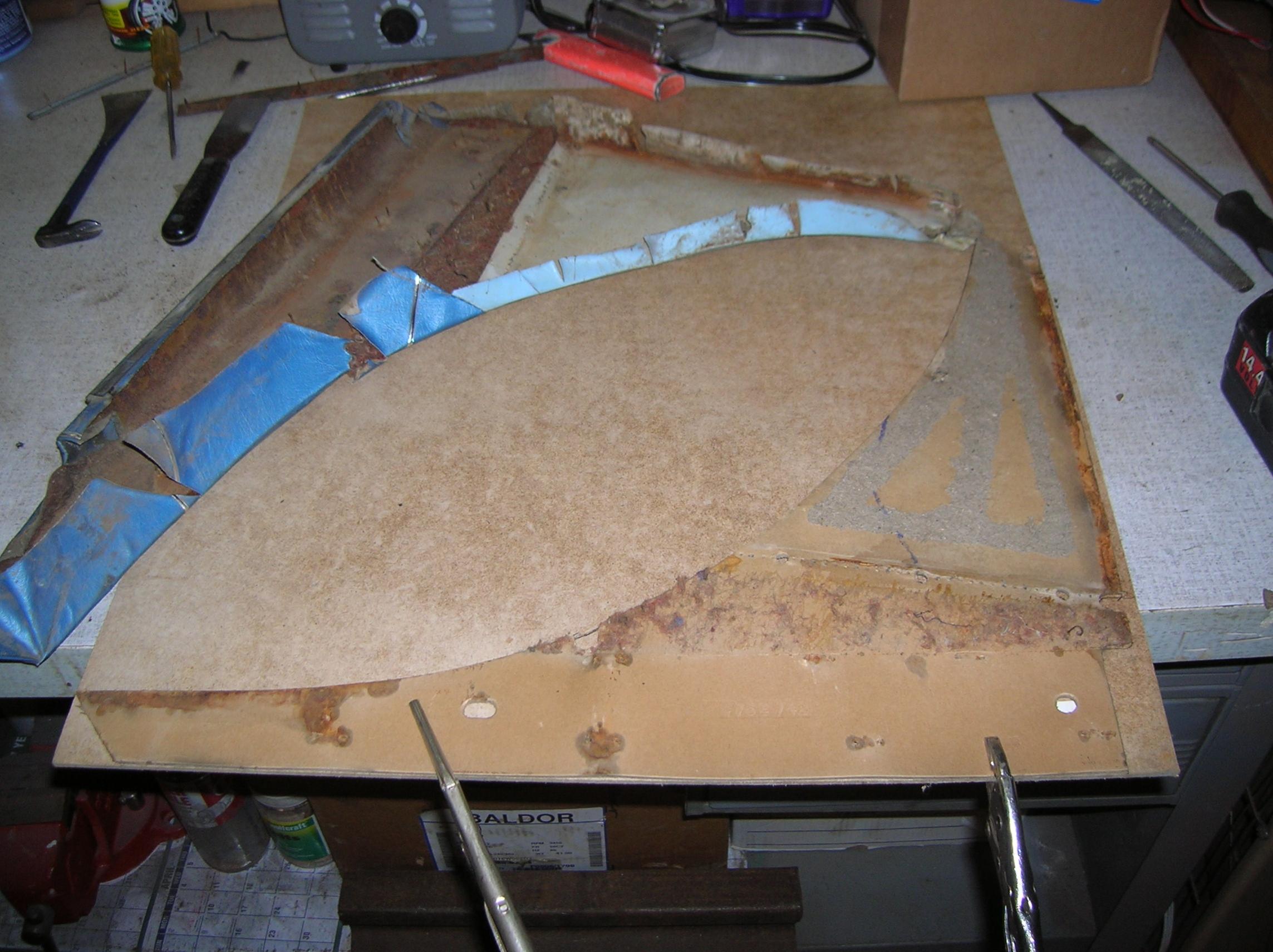

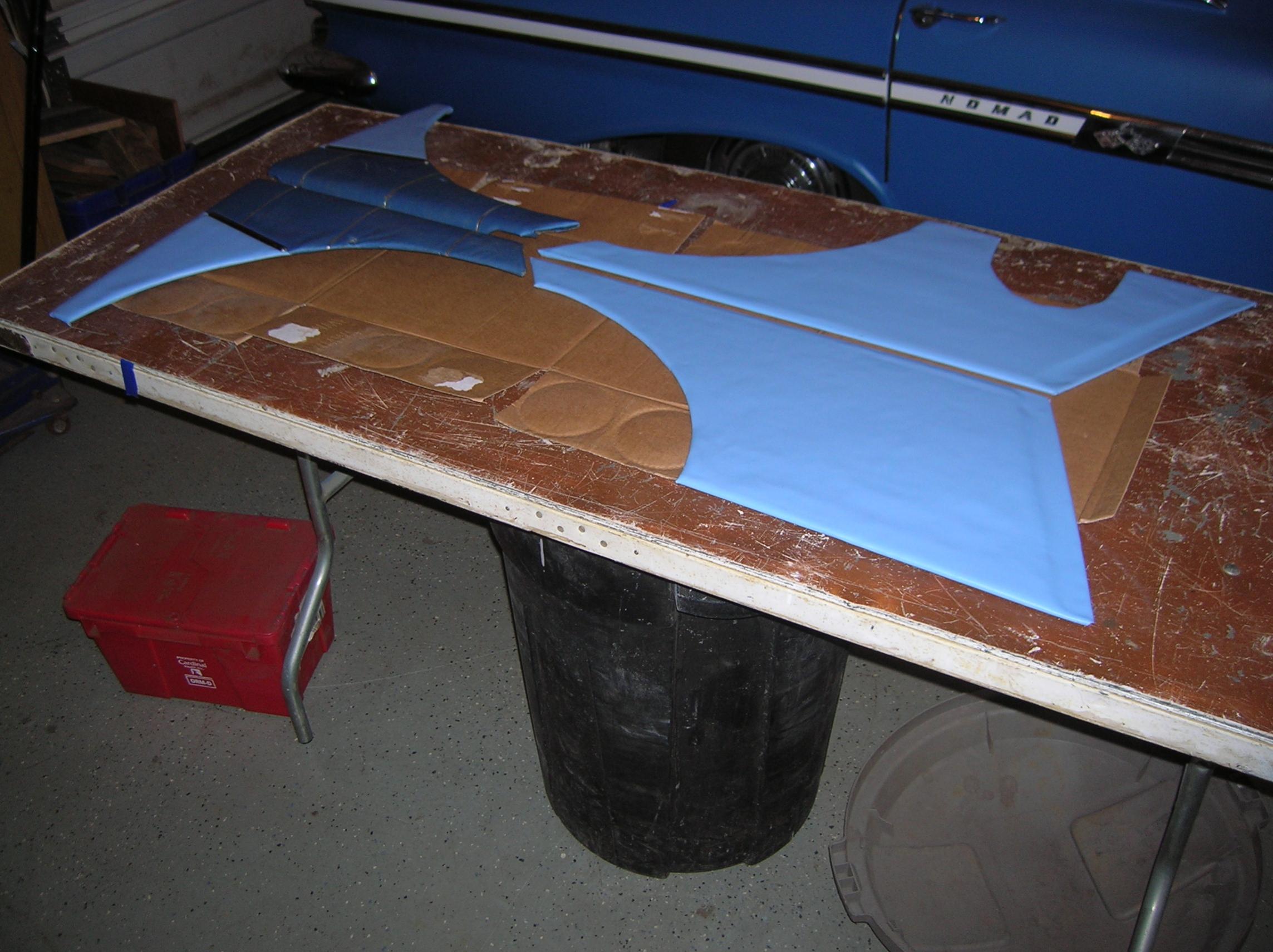

    Made some progress on the interior, turning out fairly good and as always, learning a lot.
    The sides are nice and straight and the dark blue tops will carry on from the doors.
    Finally decided to do a little filler over the repaired corners, glad is it is very smooth now and may not have been without.

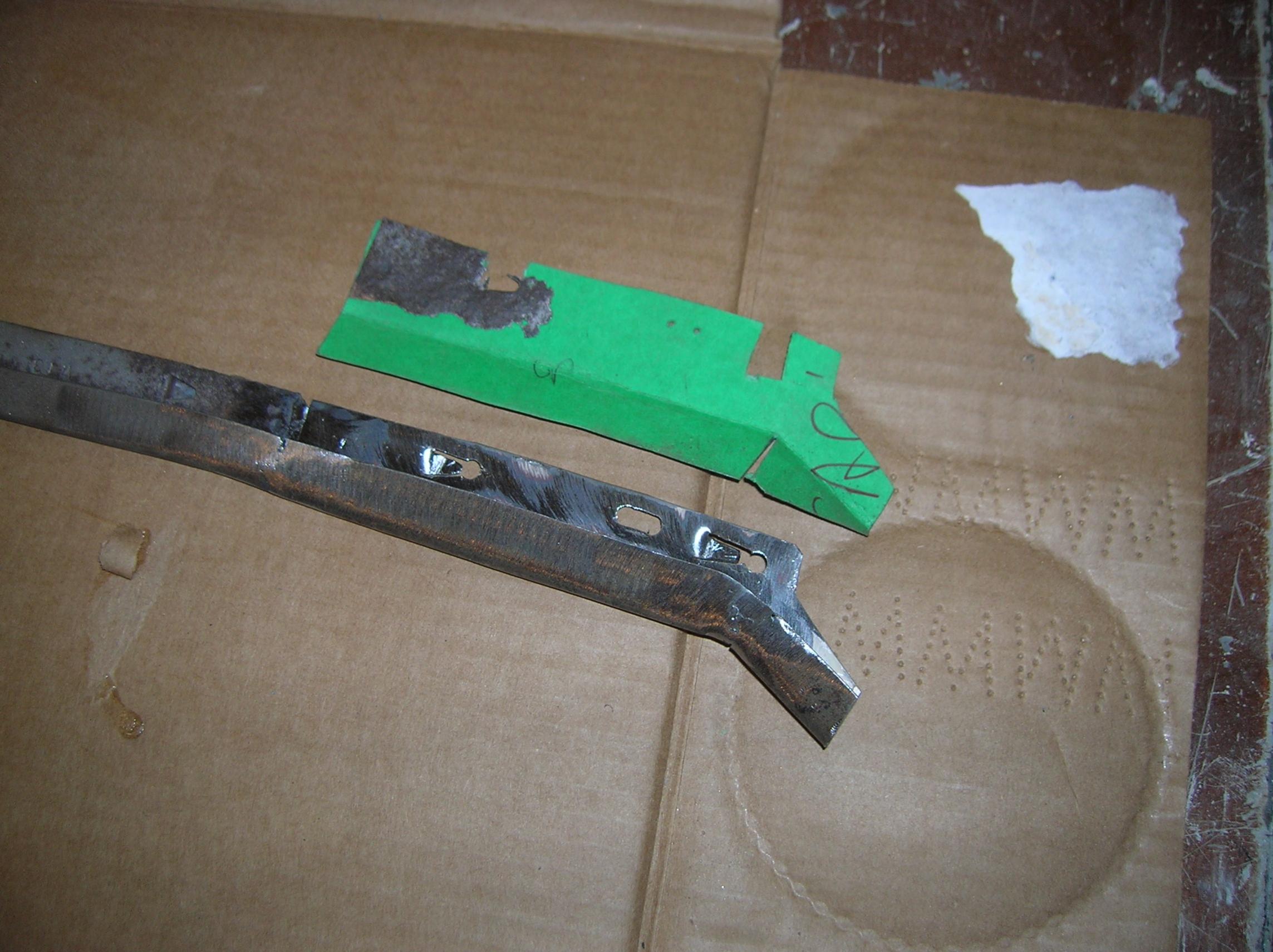

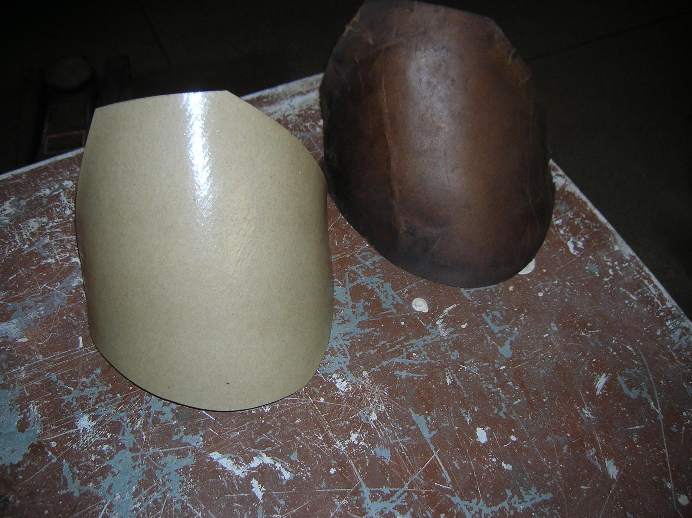

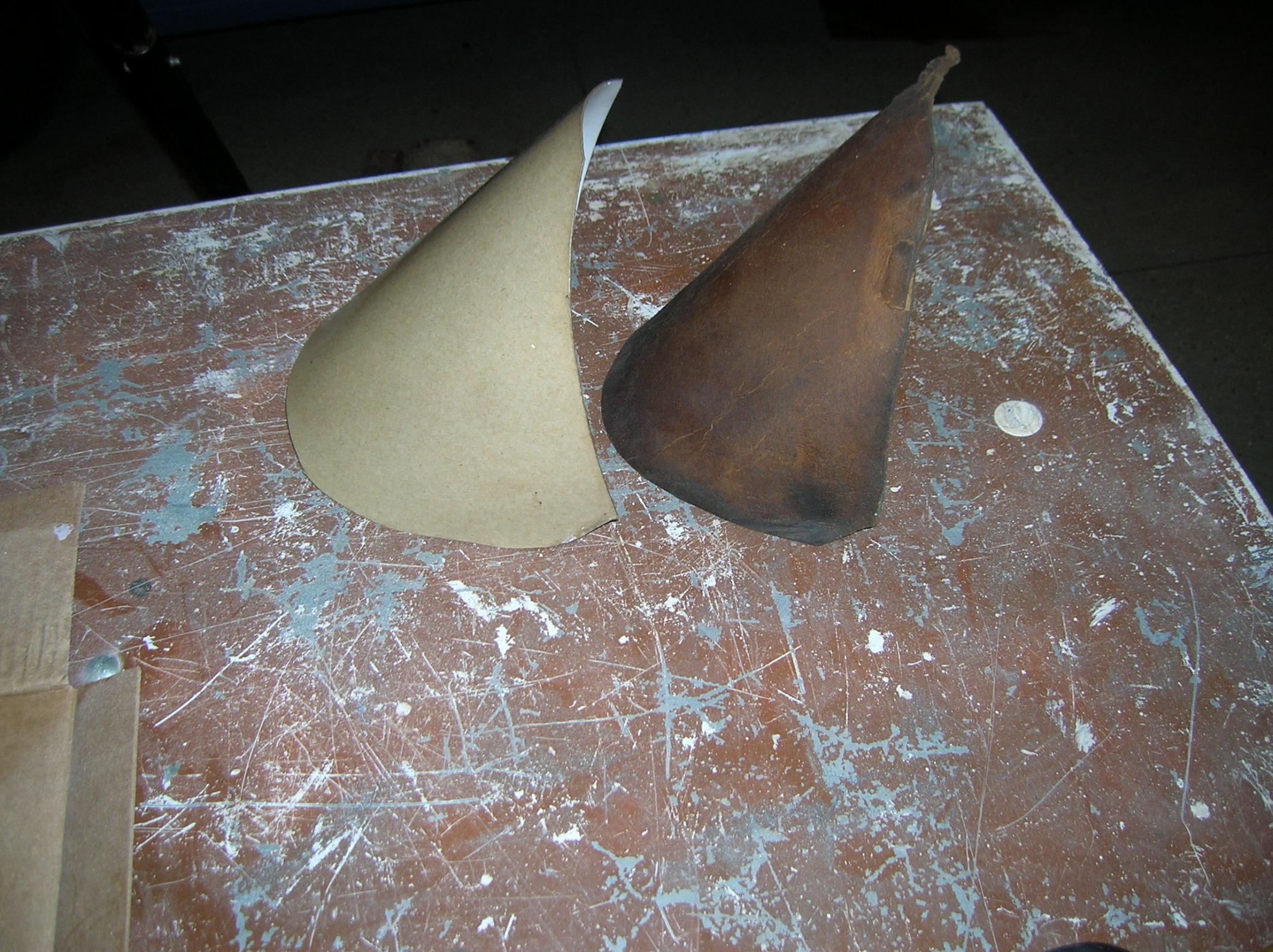

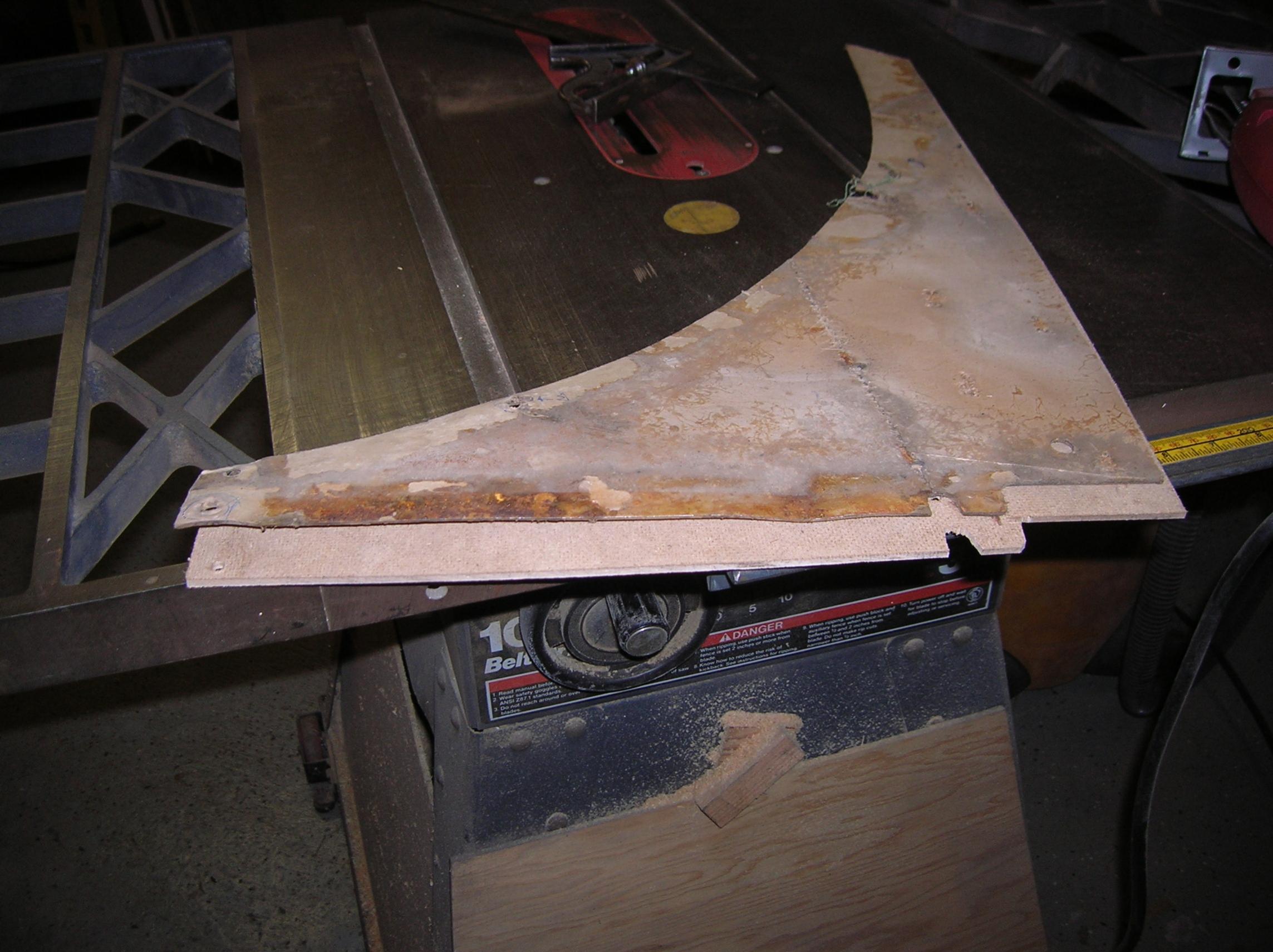

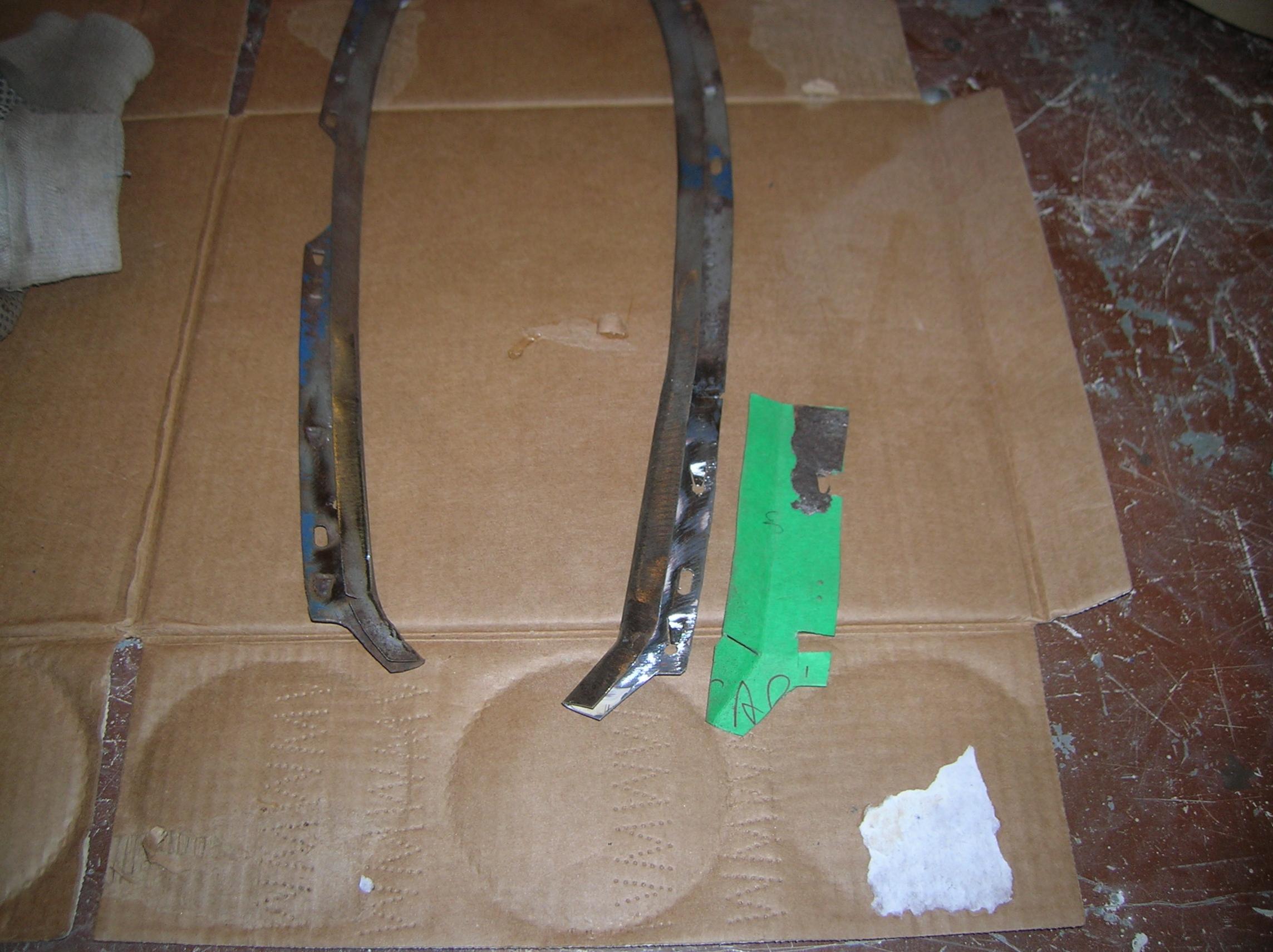

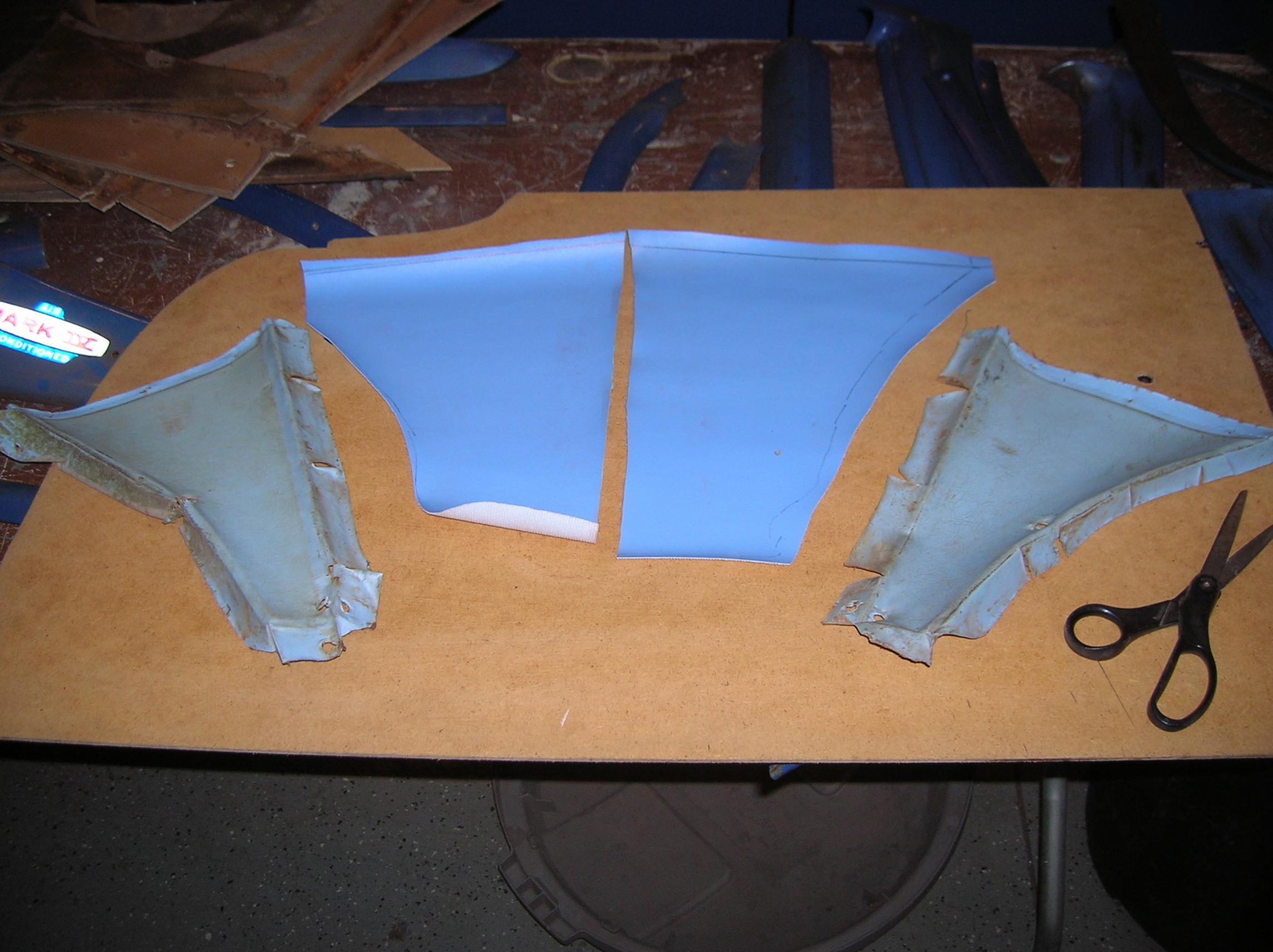

    A few updates. finally decided to just remake the kick panel retainer, see the part on the right sitting on the pattern, that's all that was left of the lower.
    making the little retaining clips may not have been ideal but they should work fine and the extra hole on the point should not be an issue
    The other shots is the new backing for the gas filler cover. The old one was oil soaked and disintegrating

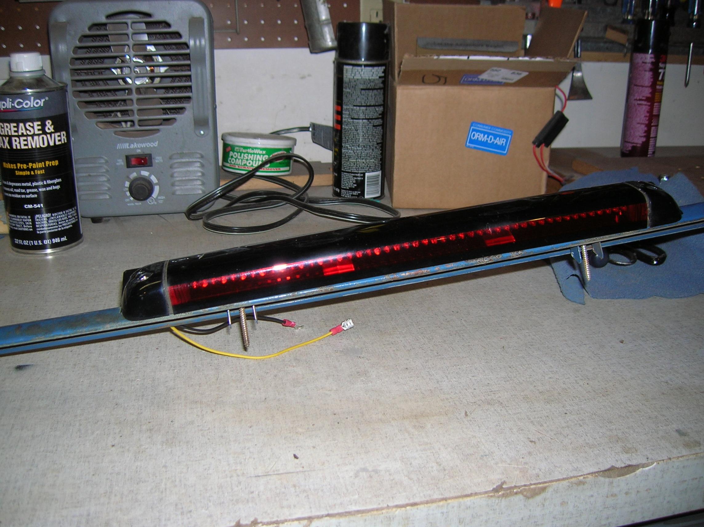

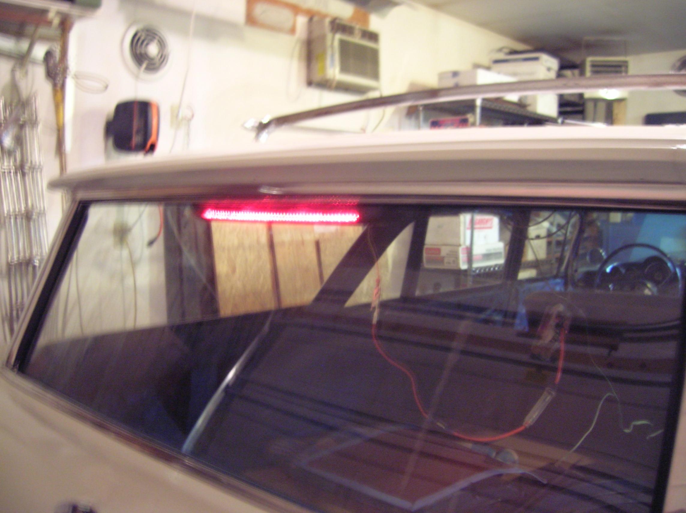

    Made up a mounting plate to add a 3rd brake light. Considered placing it on the tailgate or the roof, but it just did not seem right. This way i can easily remove it but it will provide a little extra notice when stopping.
  24. Nice idea and very clean install. What was the donor for the light?
  25. Bruce A Lyke
    Joined: Jun 21, 2009
    Posts: 2,587
    Bruce A Lyke
    Thanks Fan Attic
    As I recall it was from a ~13/14 year old Suburban or Blazer.
    I got 3 different lights at a U-Pull yard for 5.00 each, this one worked out best. It has a few scratches but i can swap it out in a few minutes some other time.
    The whole thing was a prototype, done with remaking it later in mind. between driving with the grand-kids in the back seat and seeing a few guys getting run into, it seemed like the thing to do. like most of the custom items I've added, it can be easily undone if return to stock is desired.
