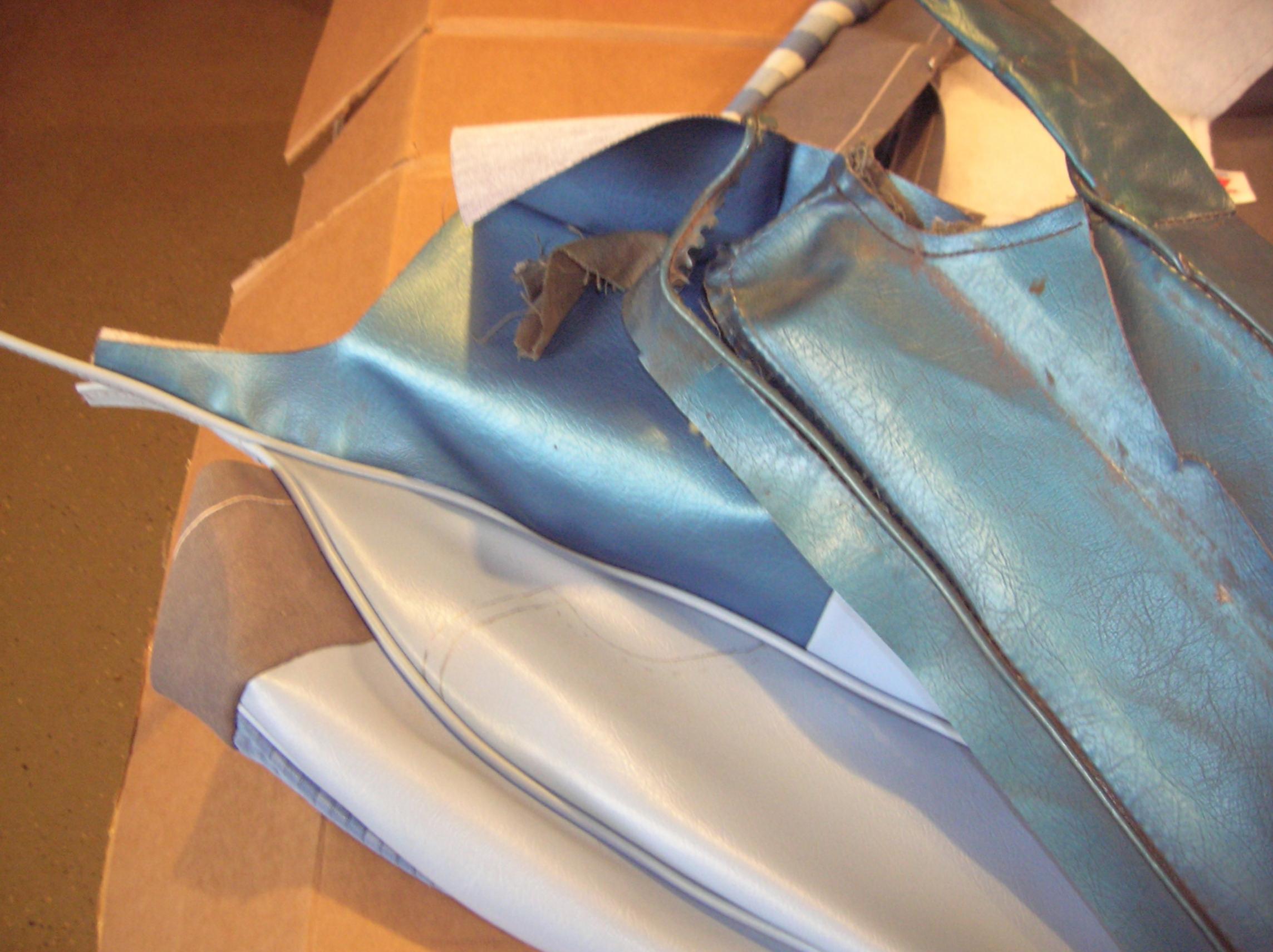

    Got my (reordered) seat covers, and the color is close to the old. Time to start reading up in earnest on the installation process.
    Also starting to prep the remaining seat parts and floor pieces that need to get painted.

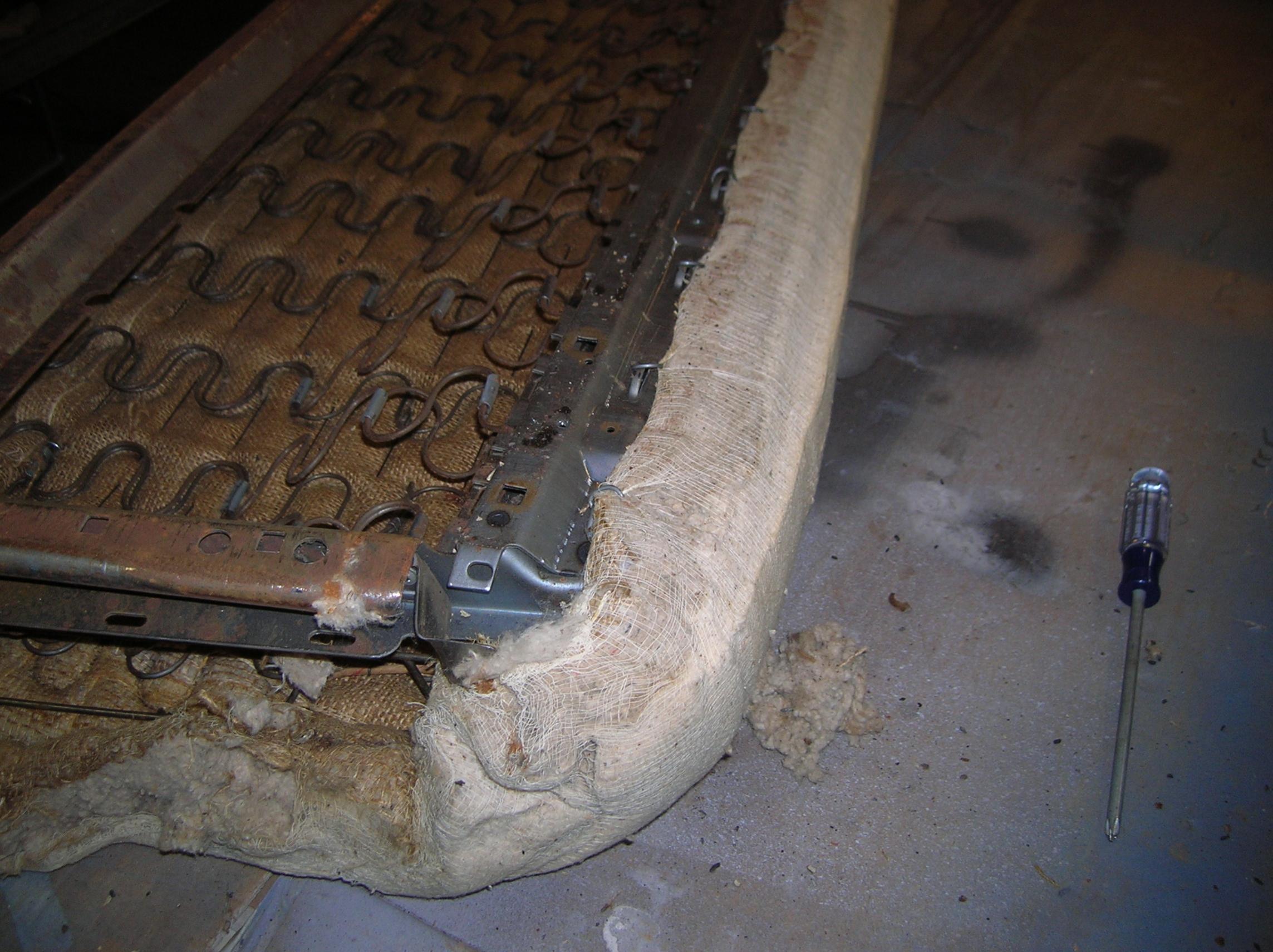

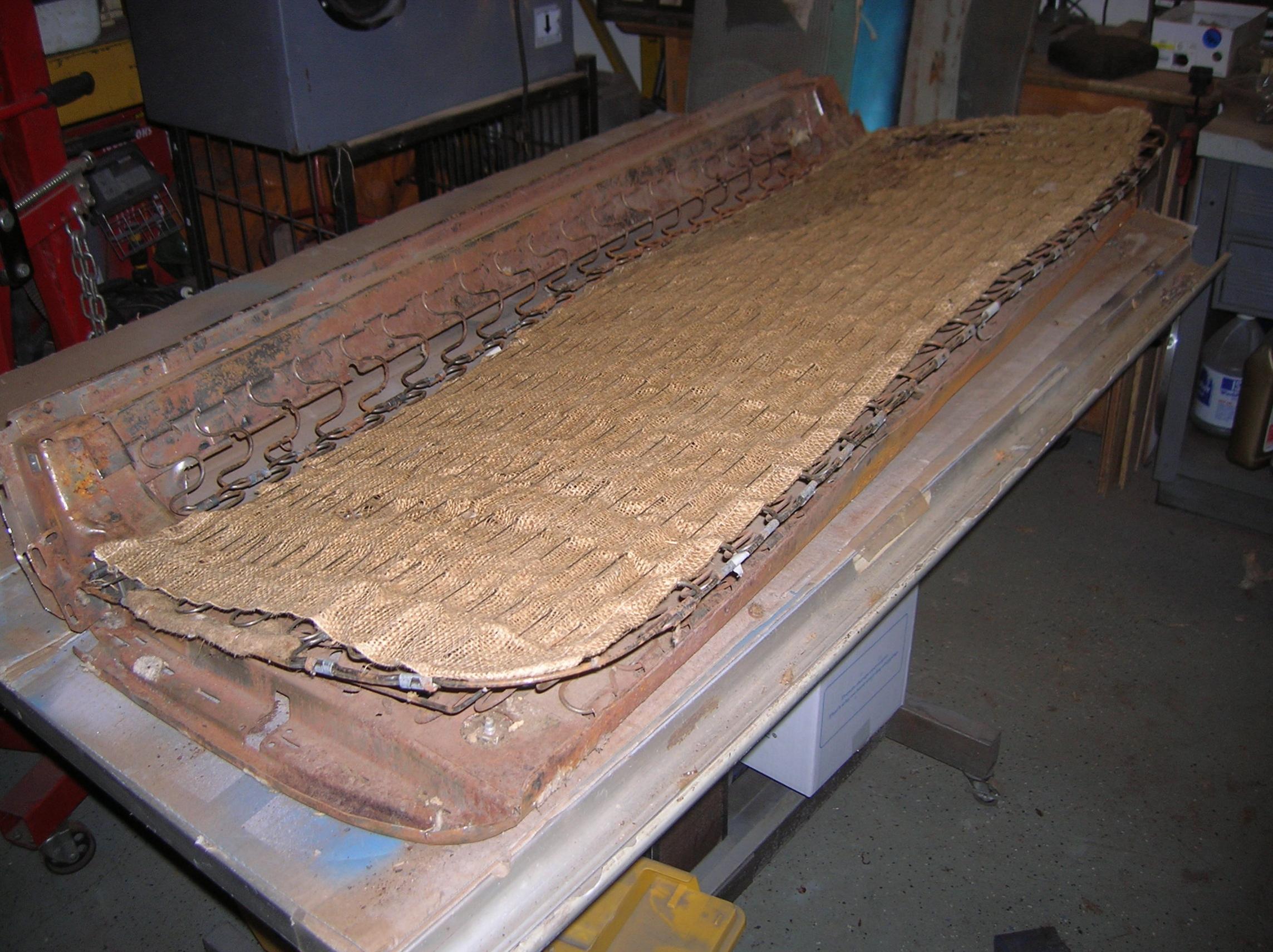

    Continuing to prepare for new seat covers. Lots of rust to clean up and springs to remount or weld. Looking forward to putting the rear covers on next. It looks like they will be easier and am less concerned if there are issues with them. The front seat was pretty tough shape bit has the Impala trim and is coming along fairly well. if the seats go well it will be on to a headliner next.

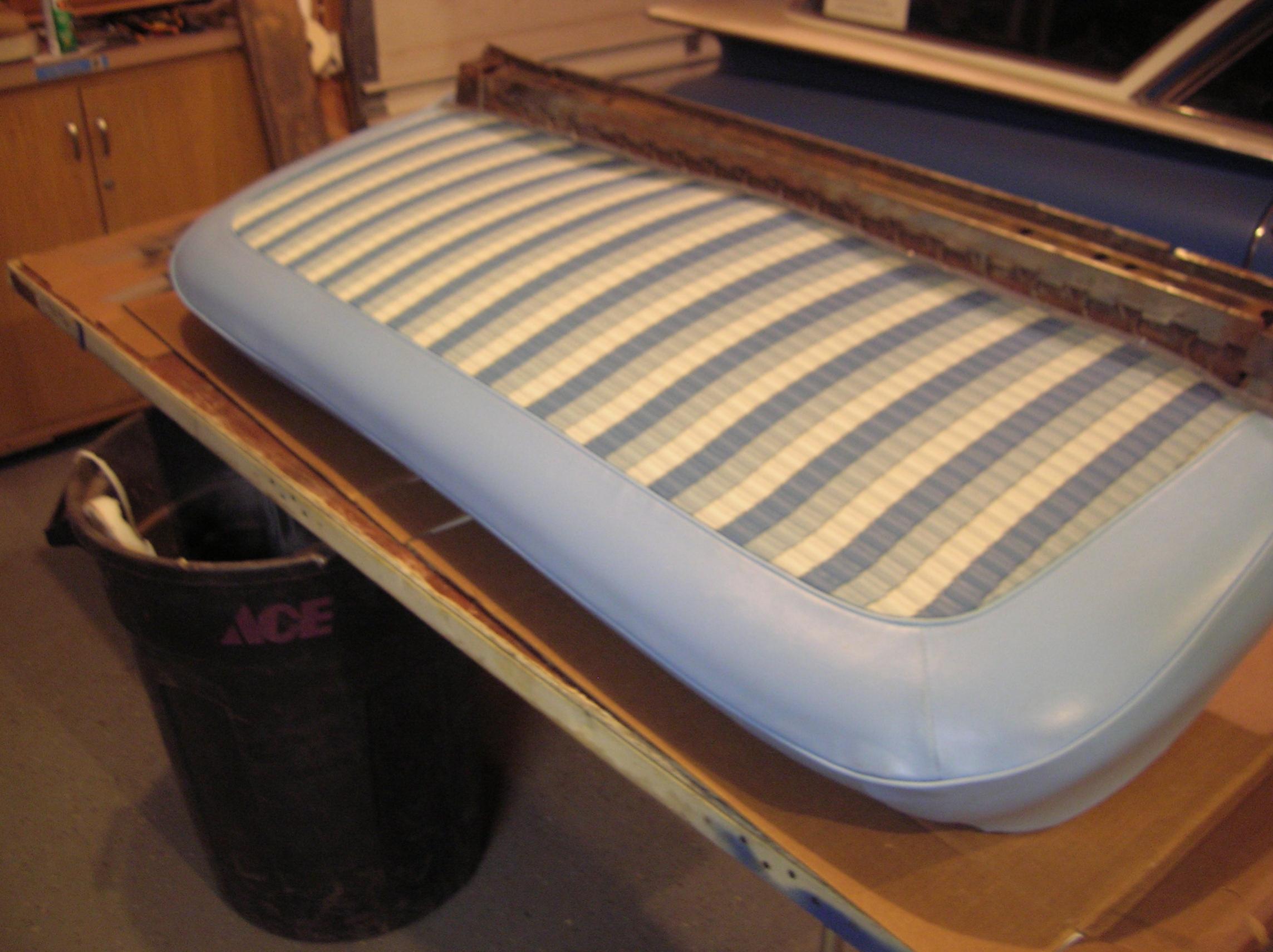

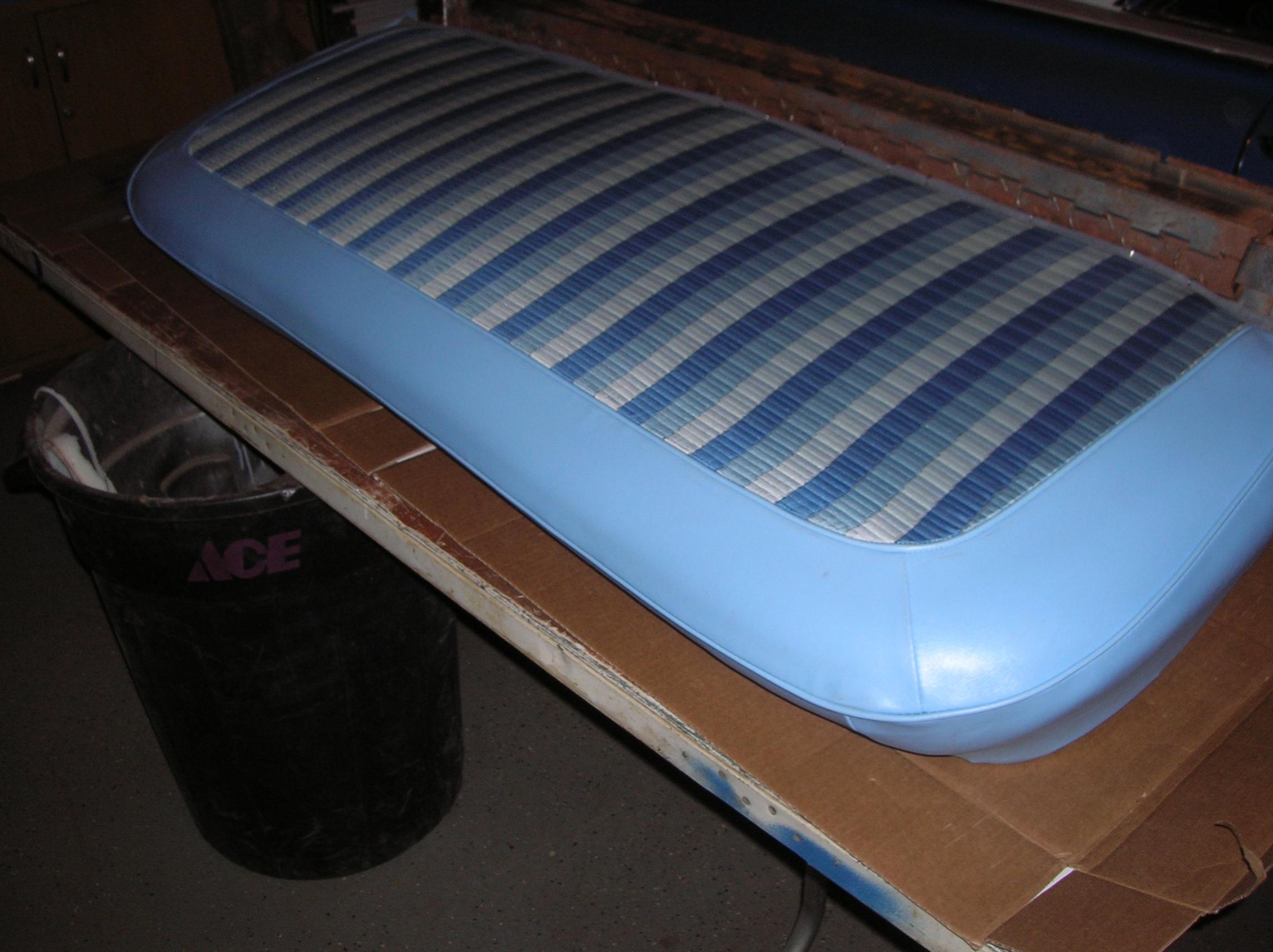

  3. Bruce A Lyke
    Joined: Jun 21, 2009
    Posts: 2,575
    Bruce A Lyke

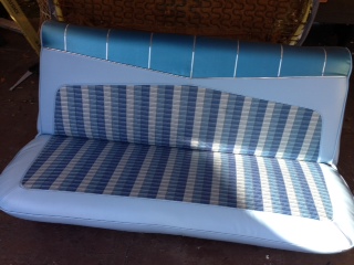

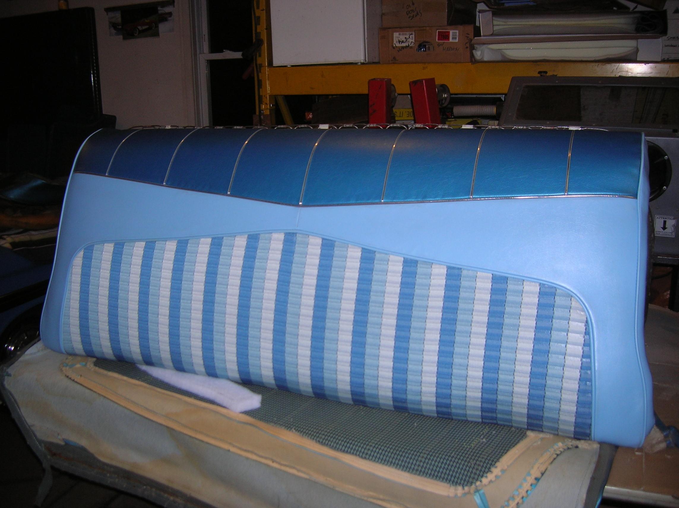

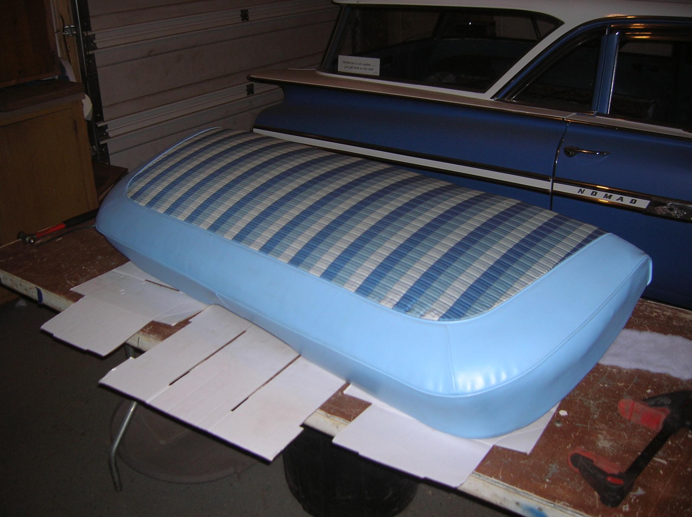

    first cover on, seems to be good for first try. Doing the rear first for practice,
    the Bottom went faster, adding its pic's to this post, one flash on non

    Seat looks good.
    Nice Job!

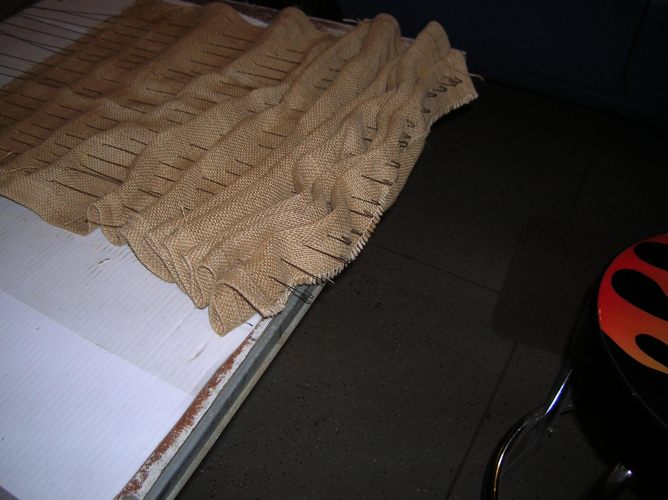

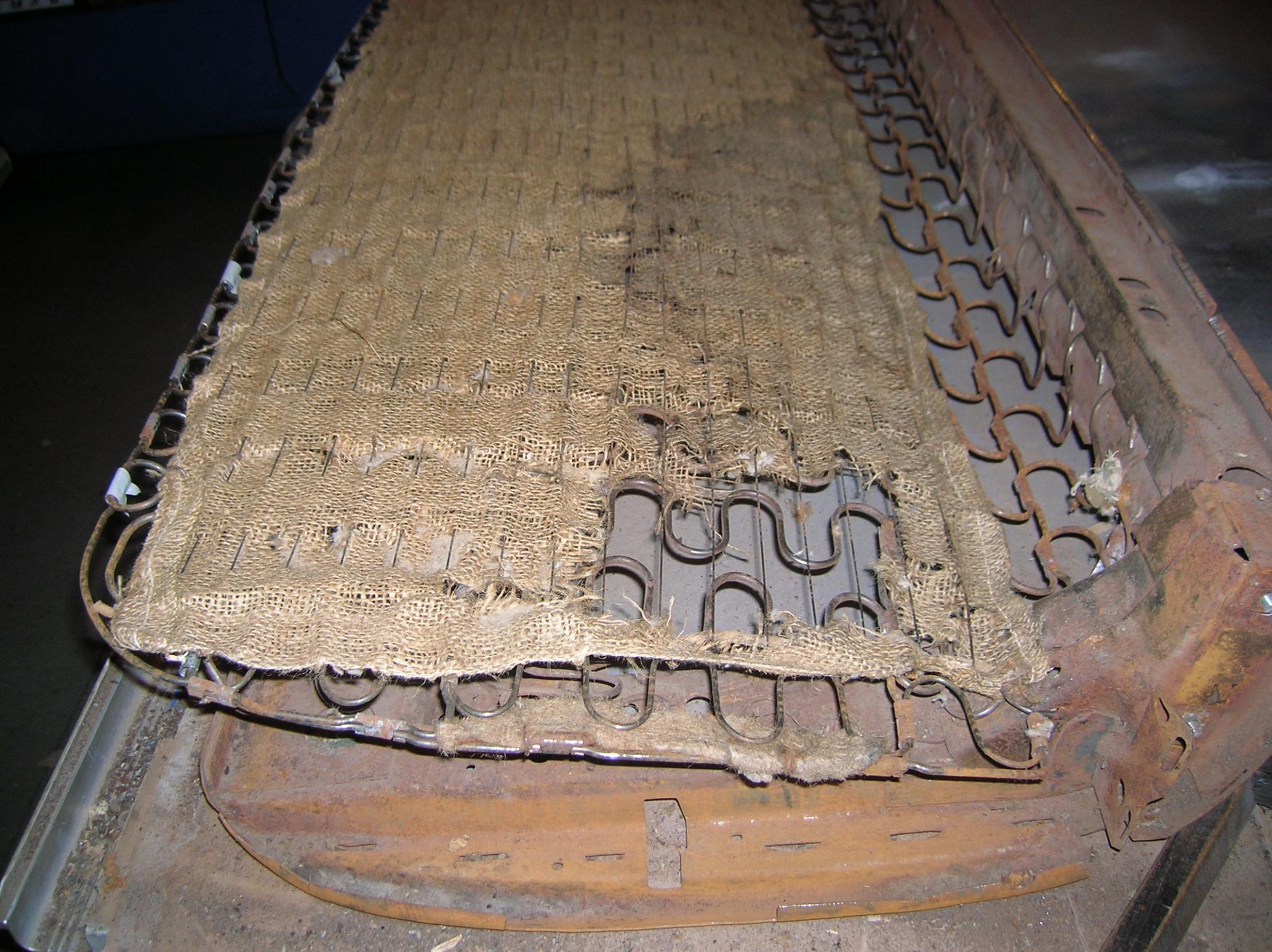

  21. Bruce A Lyke
    Posts: 2,575
    Bruce A Lyke

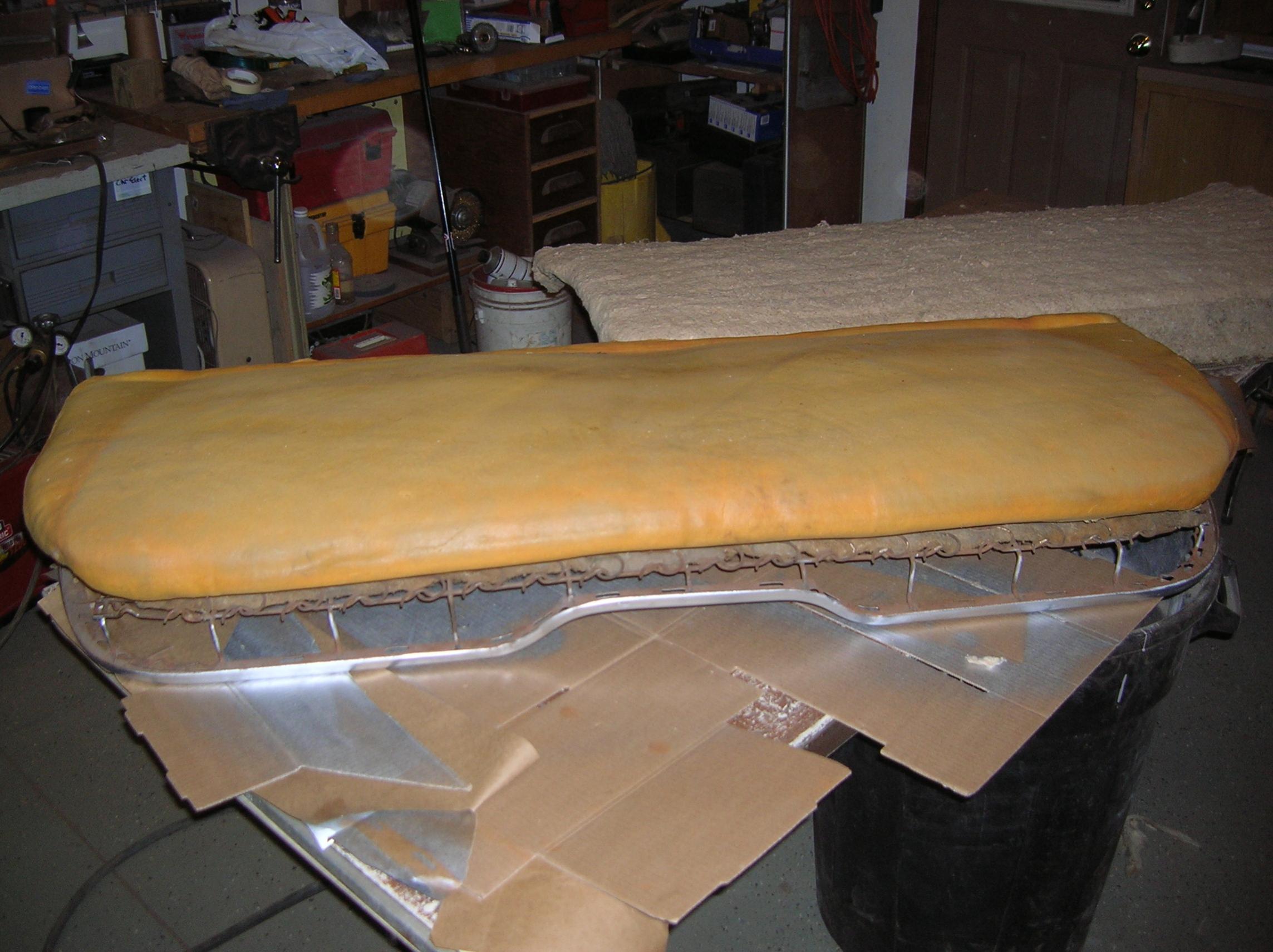

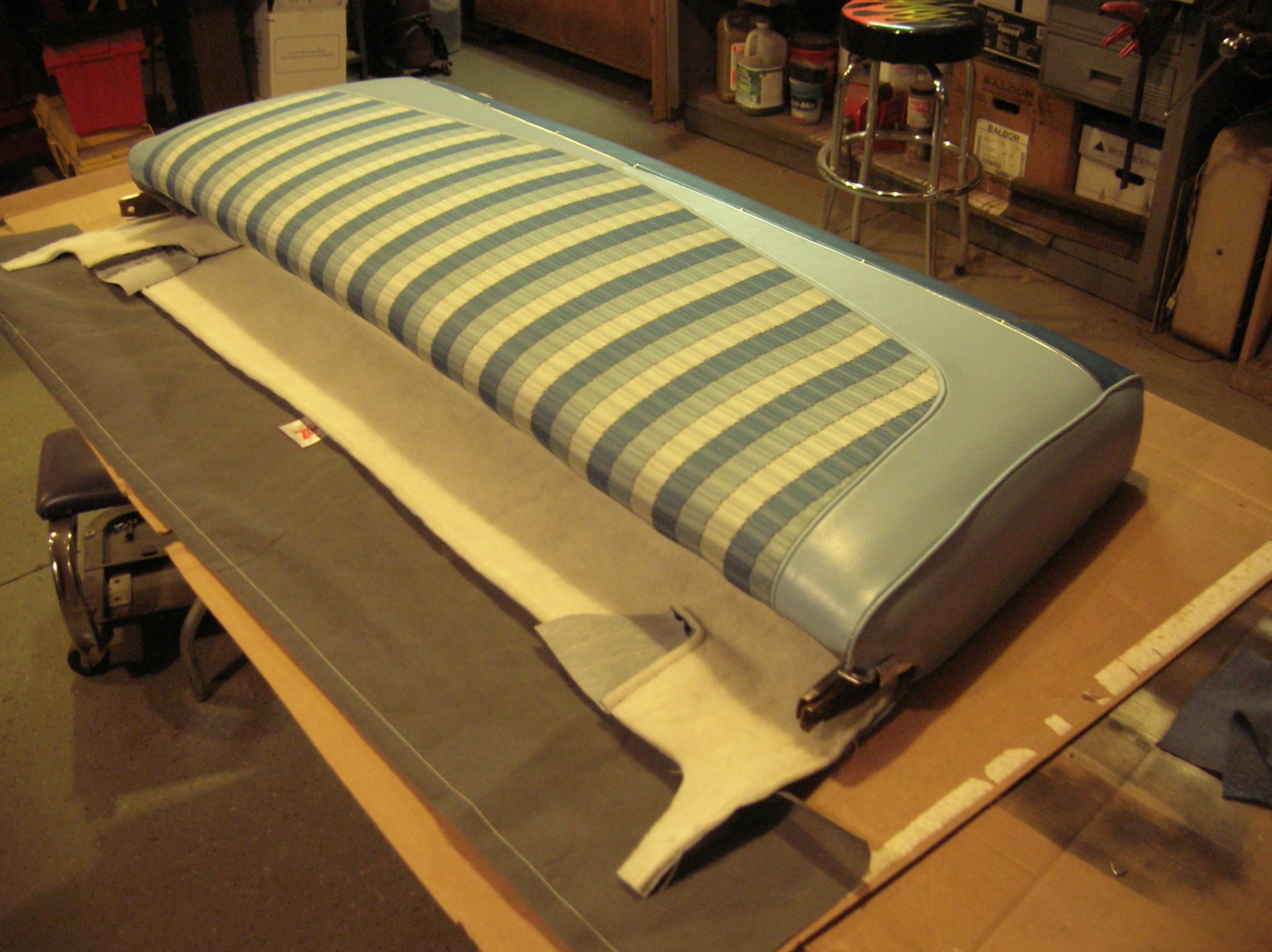

    One more down, the toughest still to go.

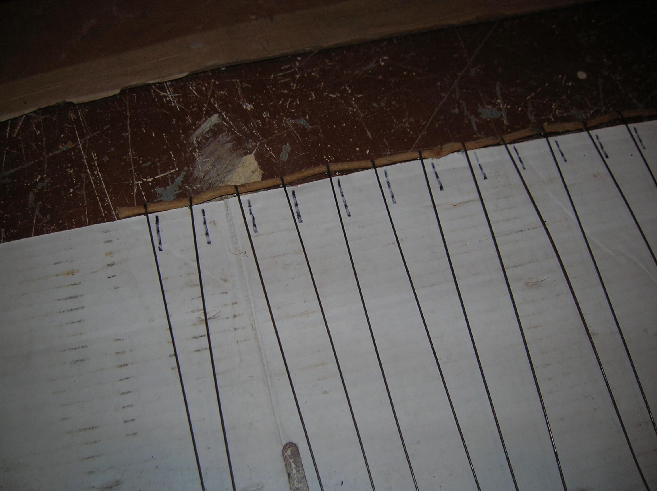

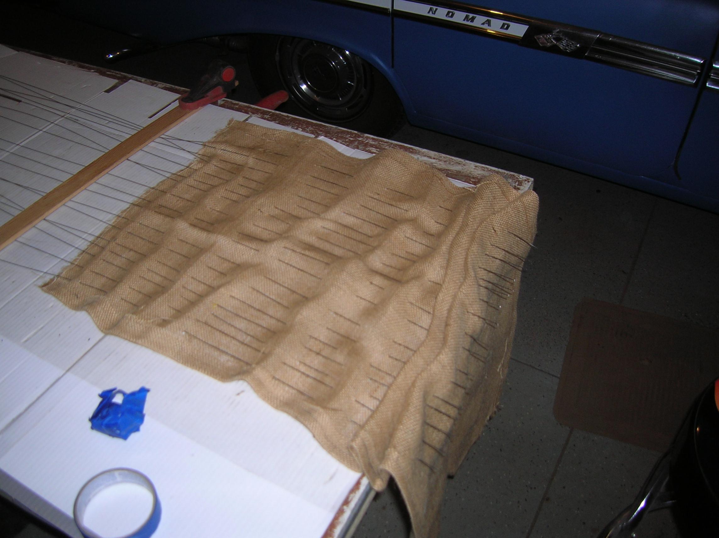

    I had to redo the burlap with wires and it came out okay, the pictures capture the process of reusing the wires. Cut off one end (the cord was broken) and re-wove them through some new material by folding back and forth., then re-crimped a new cord The old piece had a hole and was a lot nastier than the picture looks, but i suppose the mice liked it back in the day.
    Also found that by making a relief cut in the foam pad along the bend line it allowed the seat cover to go on without over stretching. the electric knife from Goodwill worked out great to make a V-Notch.

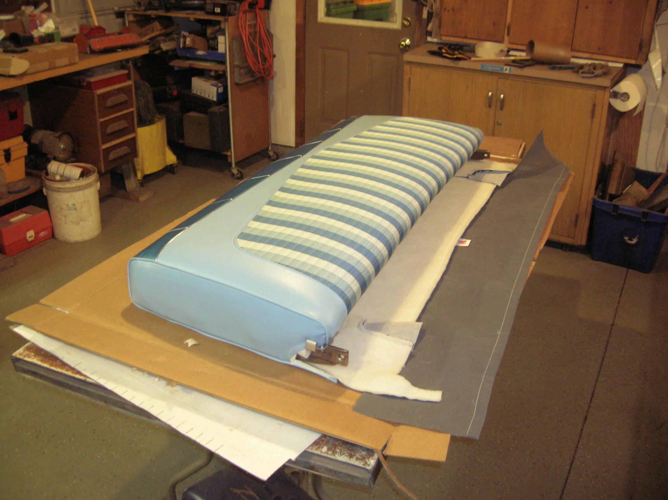

  26. Bruce A Lyke
    Posts: 2,575
    Bruce A Lyke

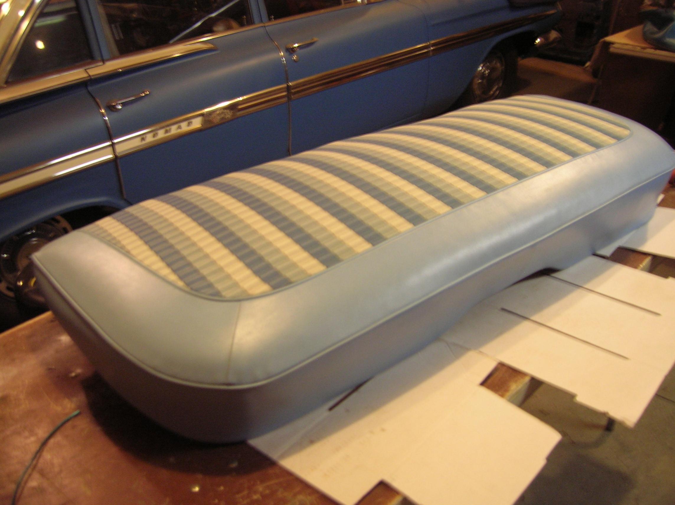

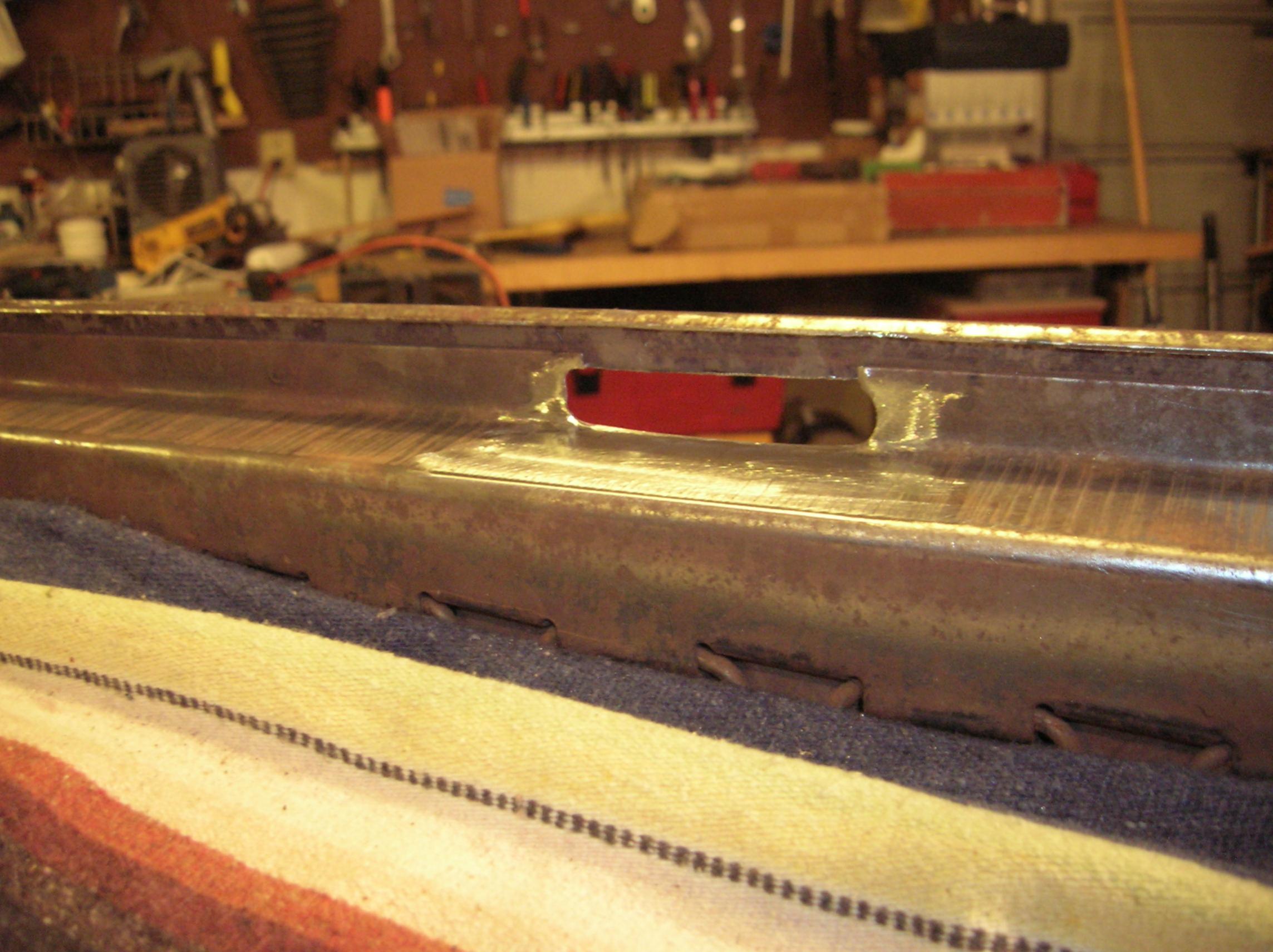

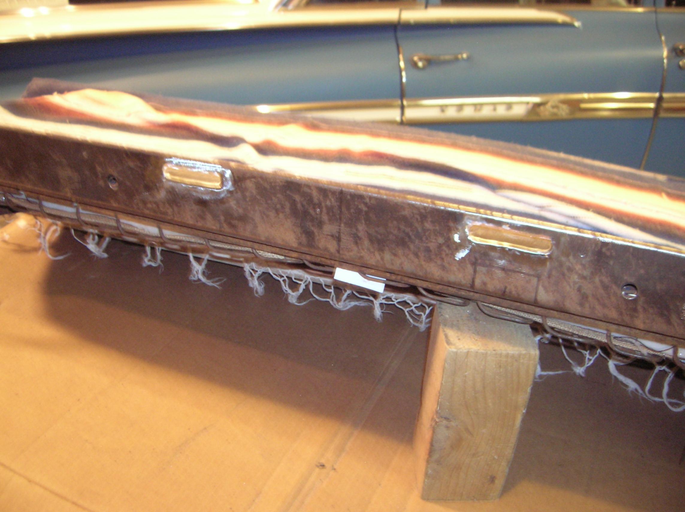

    Getting close on the front seat. Will be using the Impala trim. Got some help from Mrs. Nomad on re-sewing the top cover. Modified the seat frame to accommodate the seat belts by adding slots for the belts to p*** through.
    Hope to get it done fairly soon
