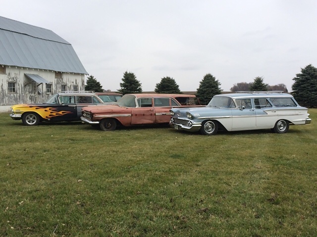

    Hey bruce, thats cool! Should be pretty easy to zero it. Yes this weather ****s, just put mine away for the winter, unless this snow misses us. Btw i will need to park on both sides of you at back to the 50s, my pink nomad just doesnt quite look right between the other 2! ;) ImageUploadedByH.A.M.B.1415583239.597123.jpg
    1956 Pinup likes this.
  10. Wow Carl, are all three of those Nomads?
  11. carlk60
    Joined: Oct 14, 2010
    Posts: 45
    carlk60
    Yeah

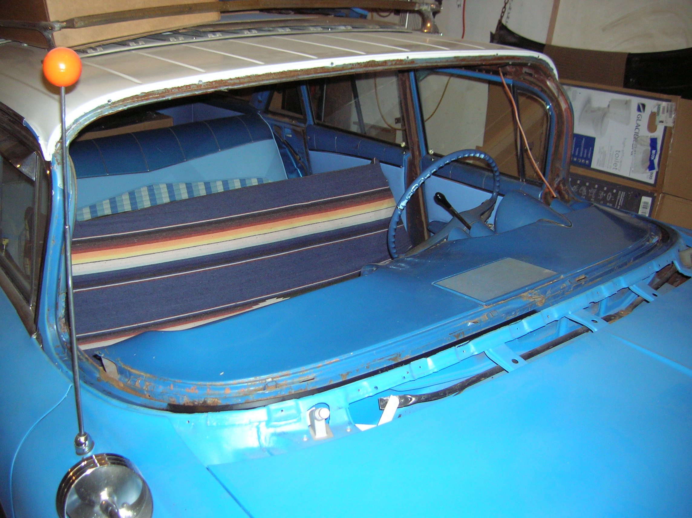

    Well time to start making progress before spring arrives. Picked up a new windshield today and a new power brake dual master cylinder.
    Will post some pictures later on the install, the old windshield is out and the clean up is ~80% done, will need a little paint. Decided it was best to get this done before the headliner.

    The last "20%" is now 90 % done and i plan to put the new wind shield in fairly soon. Been distracted with a 64 Honda CT200 trail bike which will be riding on the rear bumper at some point
    Time get focused on the wagon, just need a little time to install the new gl*** and then on to the headliner. will try to pick my battles so it will be ready once spring comes

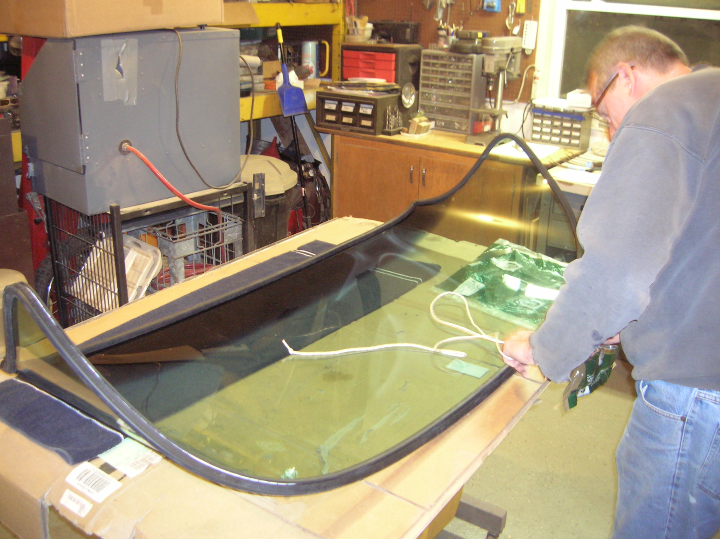

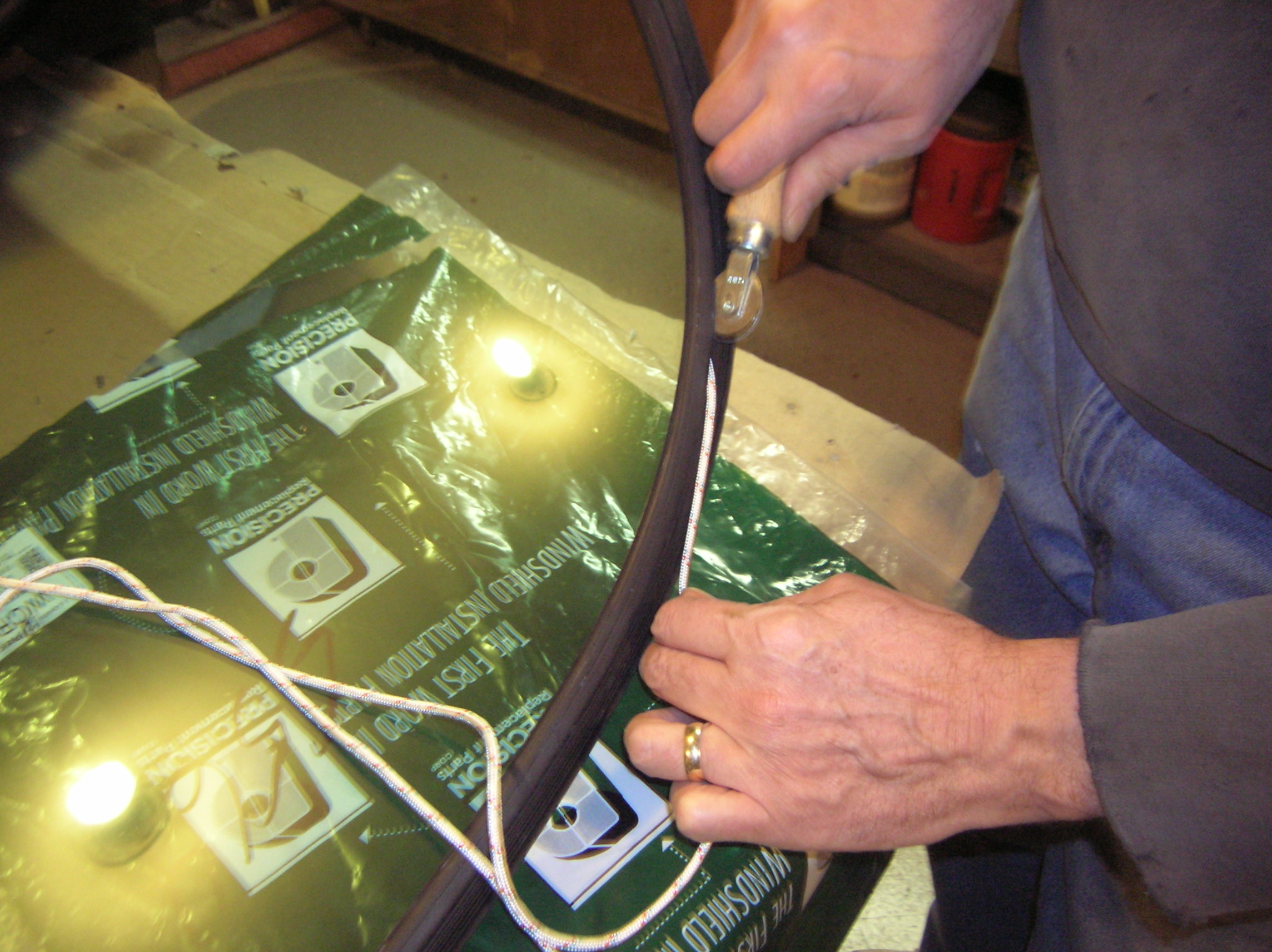

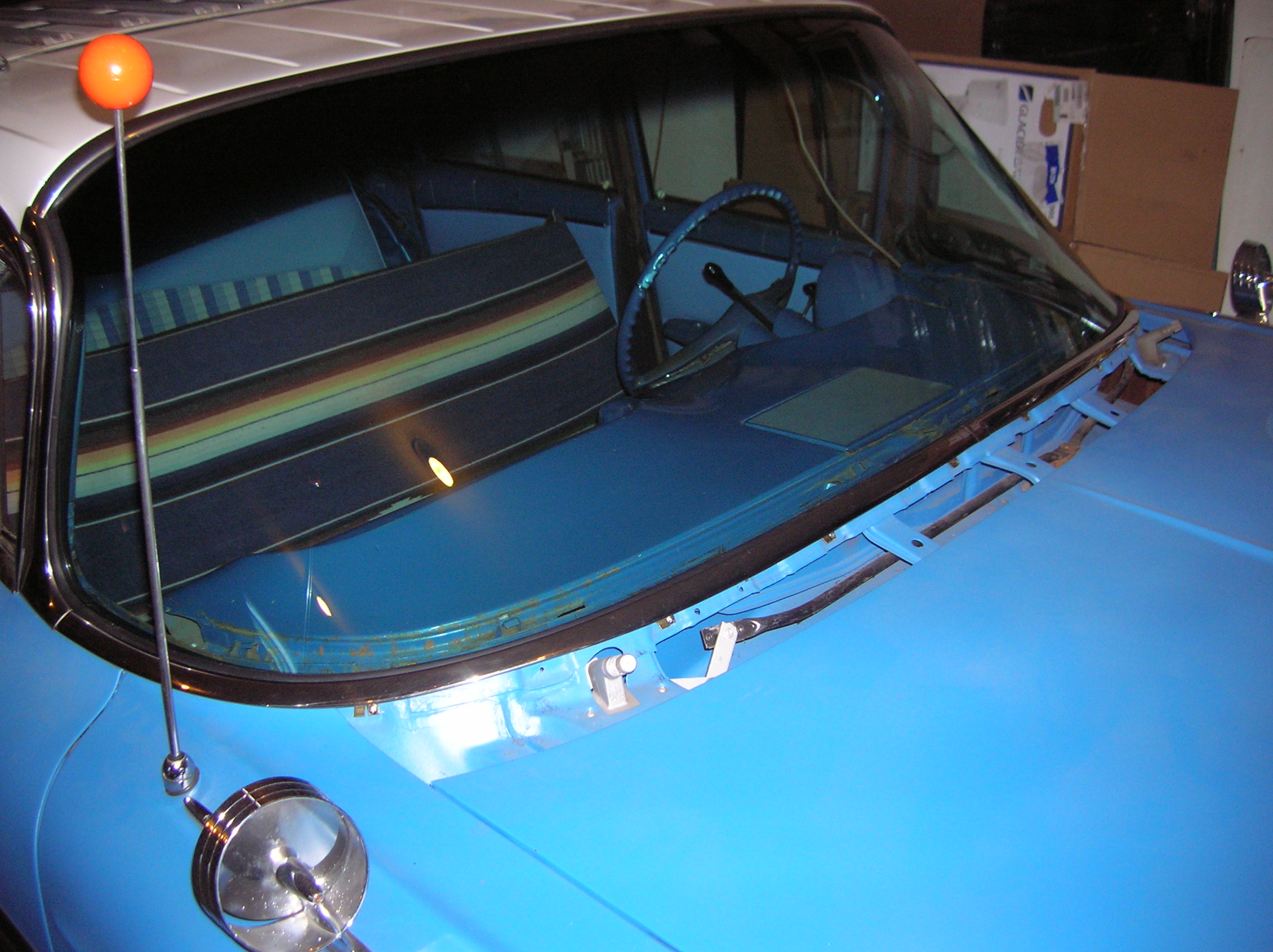

    Well the windshield installation is done, went fairly well and it will provide a better look as we hopefully rack up a lot of miles this year.
    For those contemplating taking this on, watch the Steele Rubber video get some rope and go for it.
    Now back to the build; this was a well I probably should replace the seal before doing the headliner. Which became, as long as the windshield is out, better address the rust and while its out, a new windshield (with out the scratches, rock chip ans lots of little nicks on the inside from how bits while grinding) really should go in.

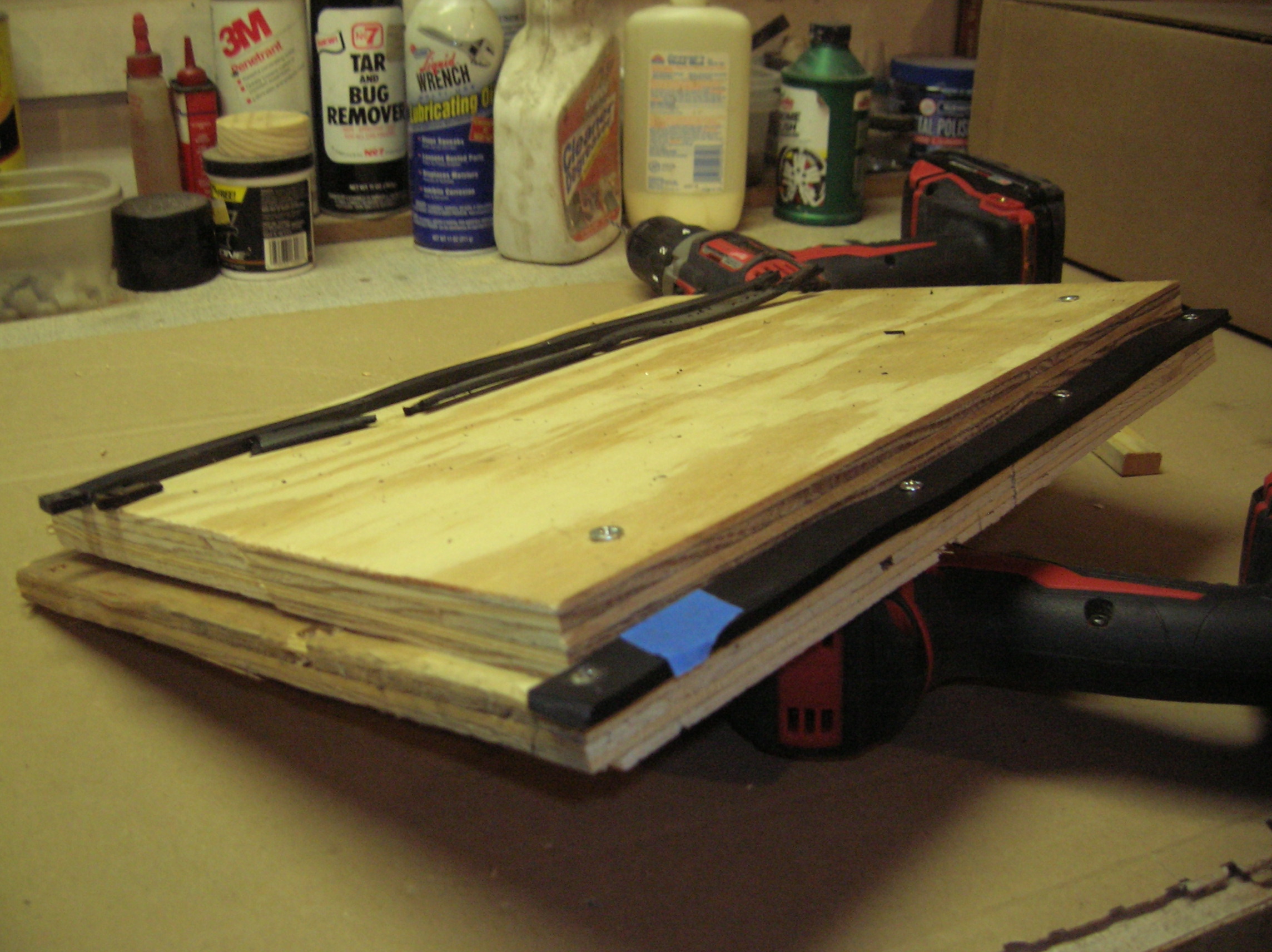

    the tack strips have been replaced (with a little creative t******* to get the right width) and next step it painting the bows, then on to the wind-lace and then the "Big Top" goes up.

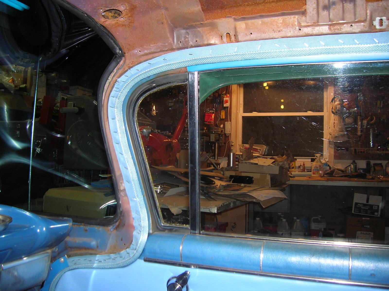

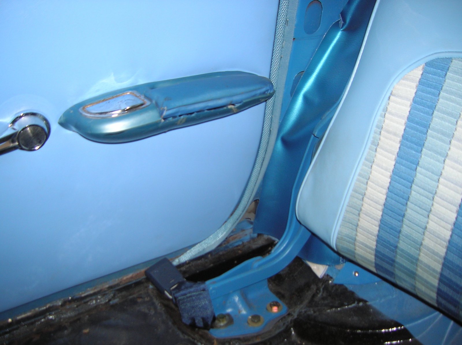

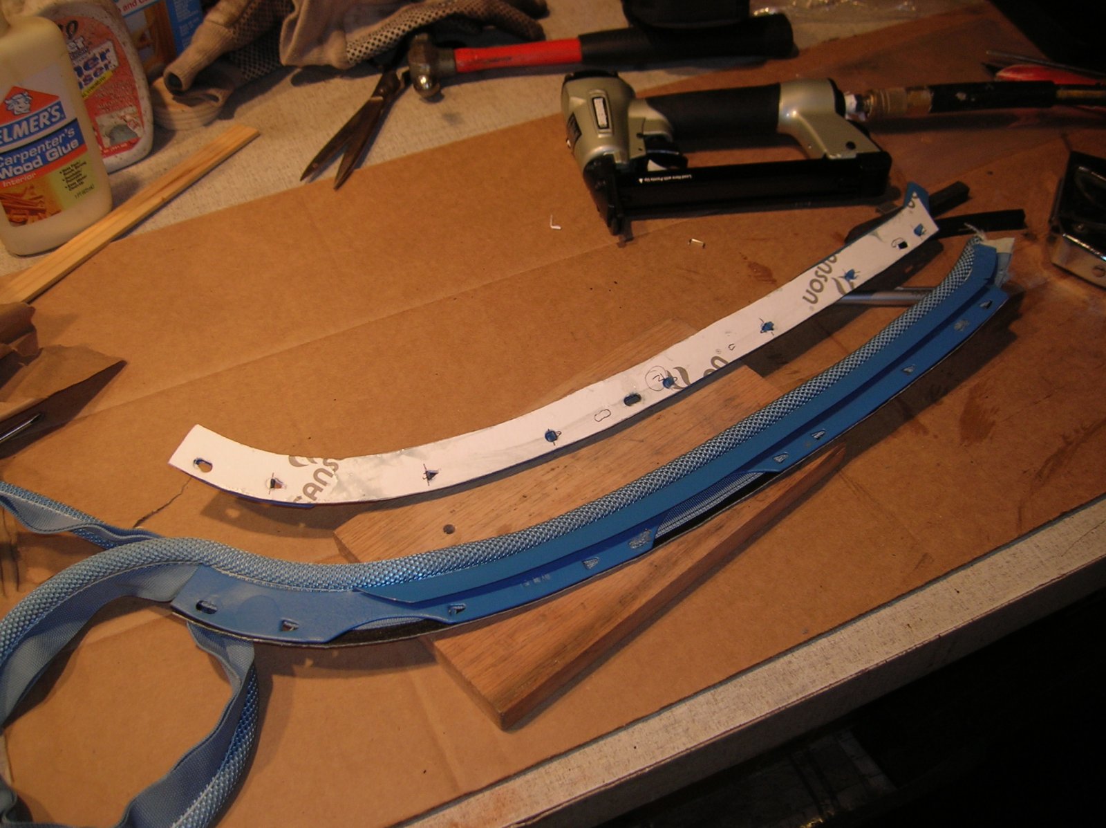

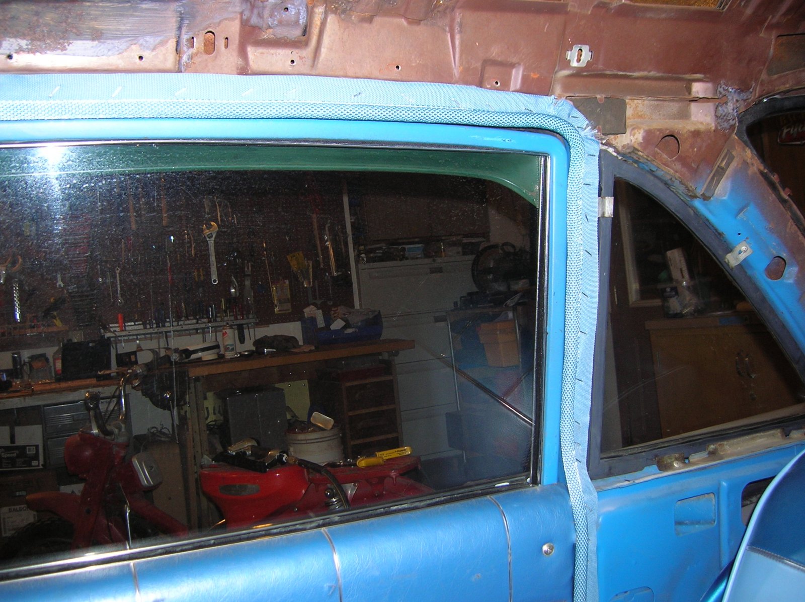

    Looks like i may actually get around to putting in the headliner that was purchased last year.
    the wind-lace went in fairly well. a small pneumatic gun helped get the staples into the hard plastic tack strip

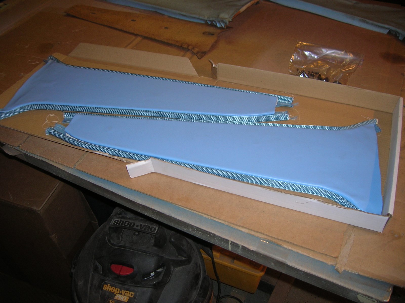

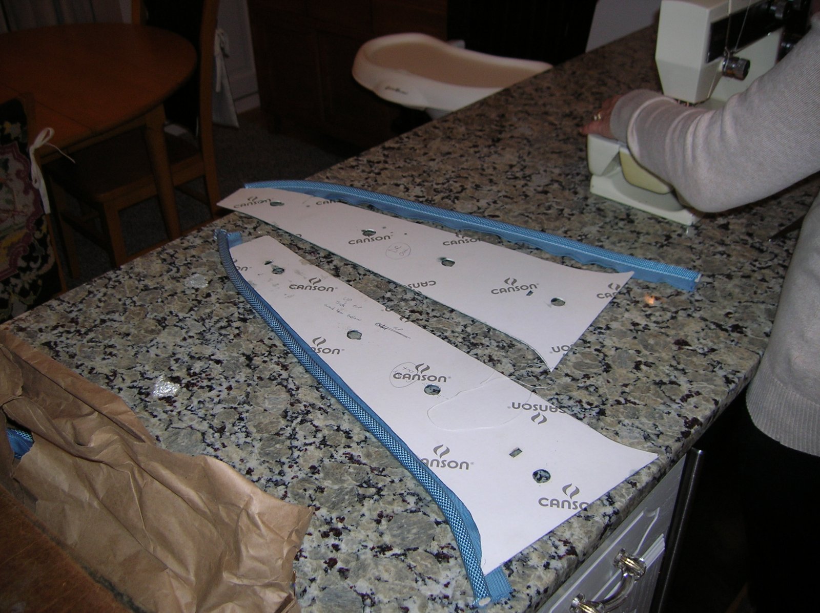

    Less than 8 weeks to Back to the 50's, guess the long winter is over and its time to get moving. Almost ready to start on the Headliner. Need to get back to weekly posts to keep things moving, feel free to bug me until it is done

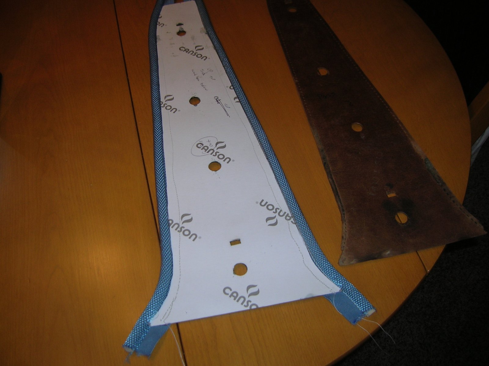

    My wife helped with the last of the sewing for the wind-lace and did a great job. was thinking this would be a night when nothing got done. Very happy to get this checked of the list (item 4B to be specific)

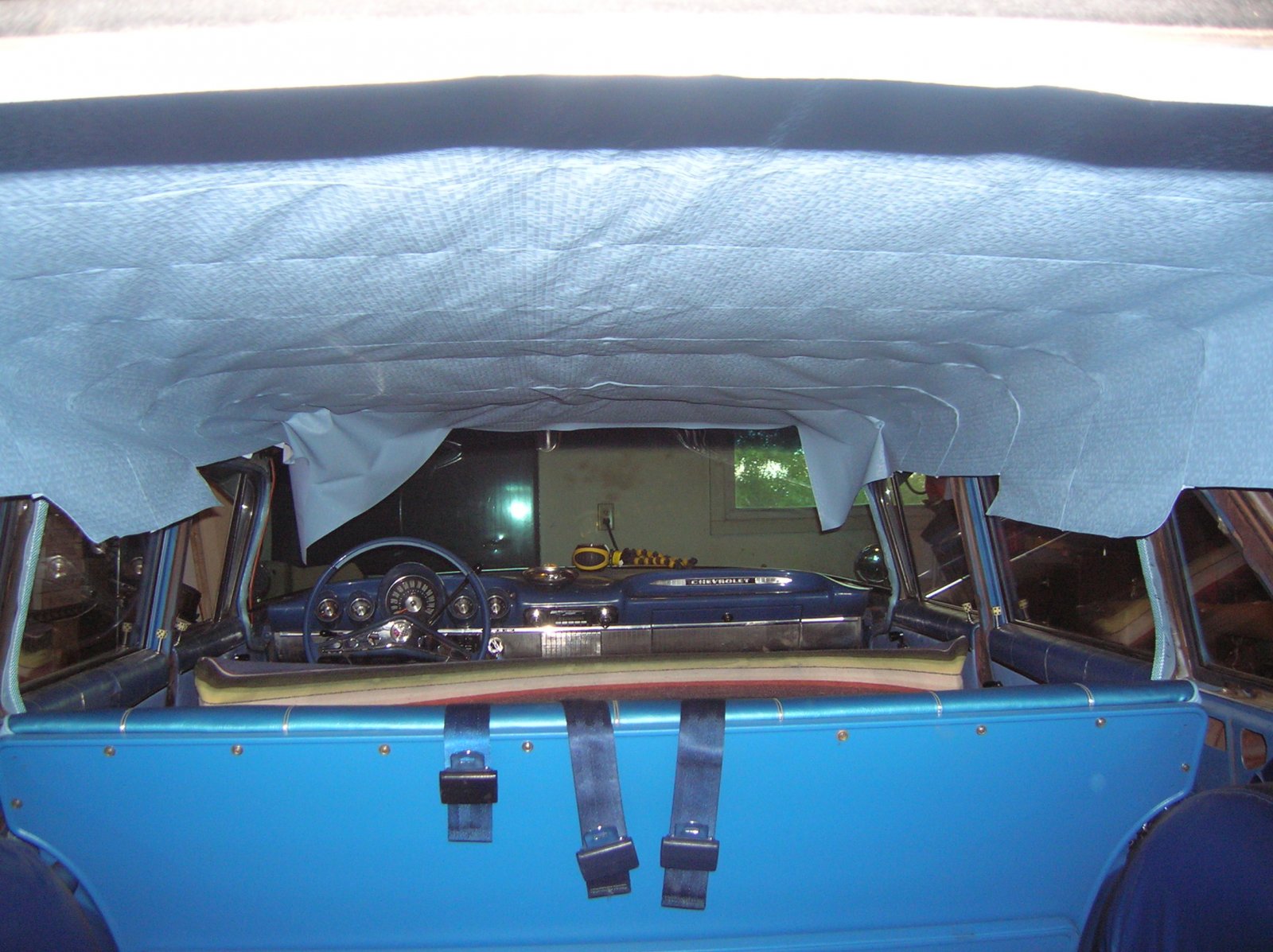

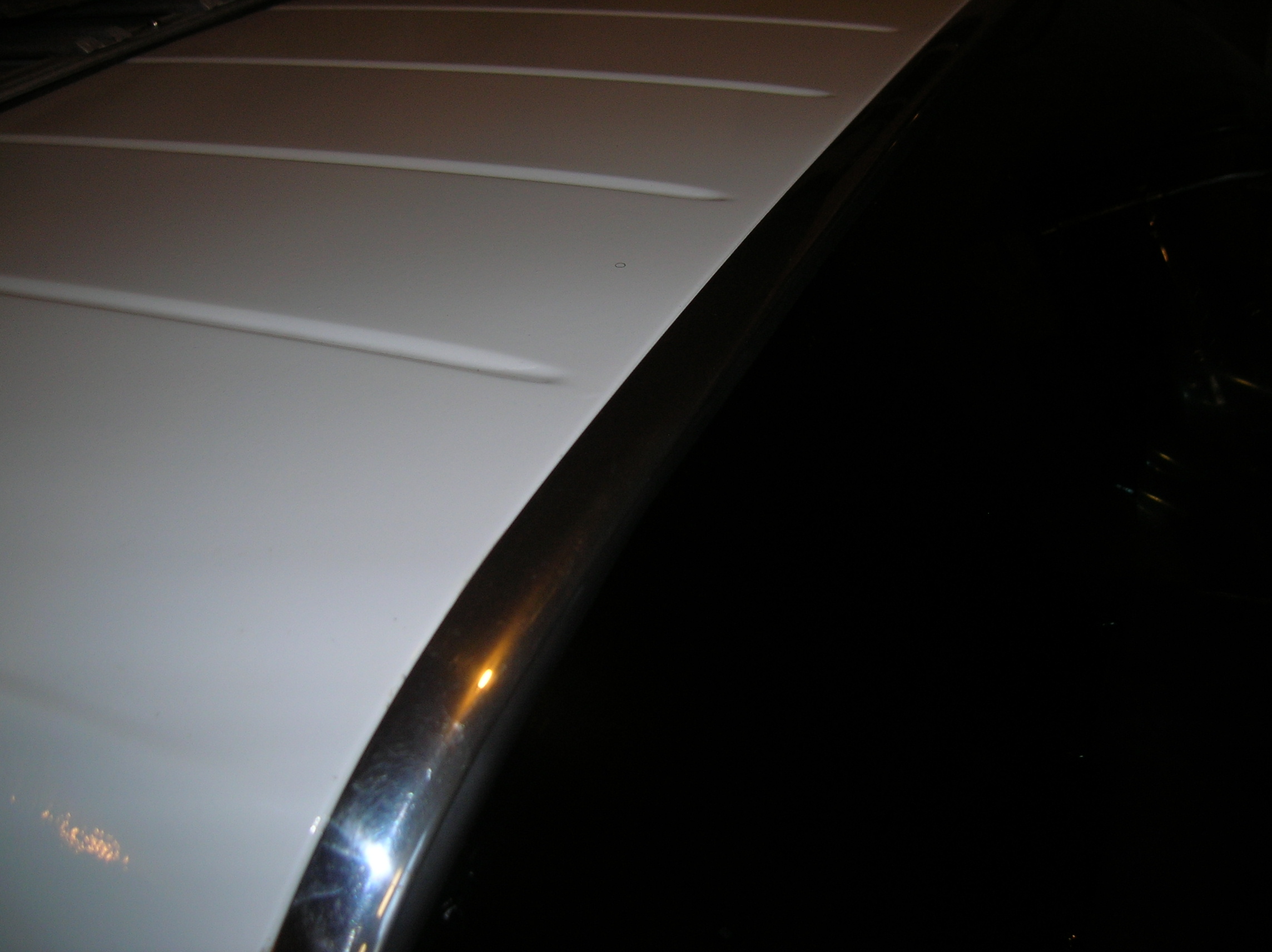

    Well I finally got the headliner out of the box (note for next time. do not let it sit for a year folded up in a box).
    Got the bows in place and started and hit a snag (note to self for next time, no matter how good some of the old tack strips look, replace all of them)
    Some additional new tack strips will be here soon.
    It will need a bit of heat and stretching to smooth this all out
