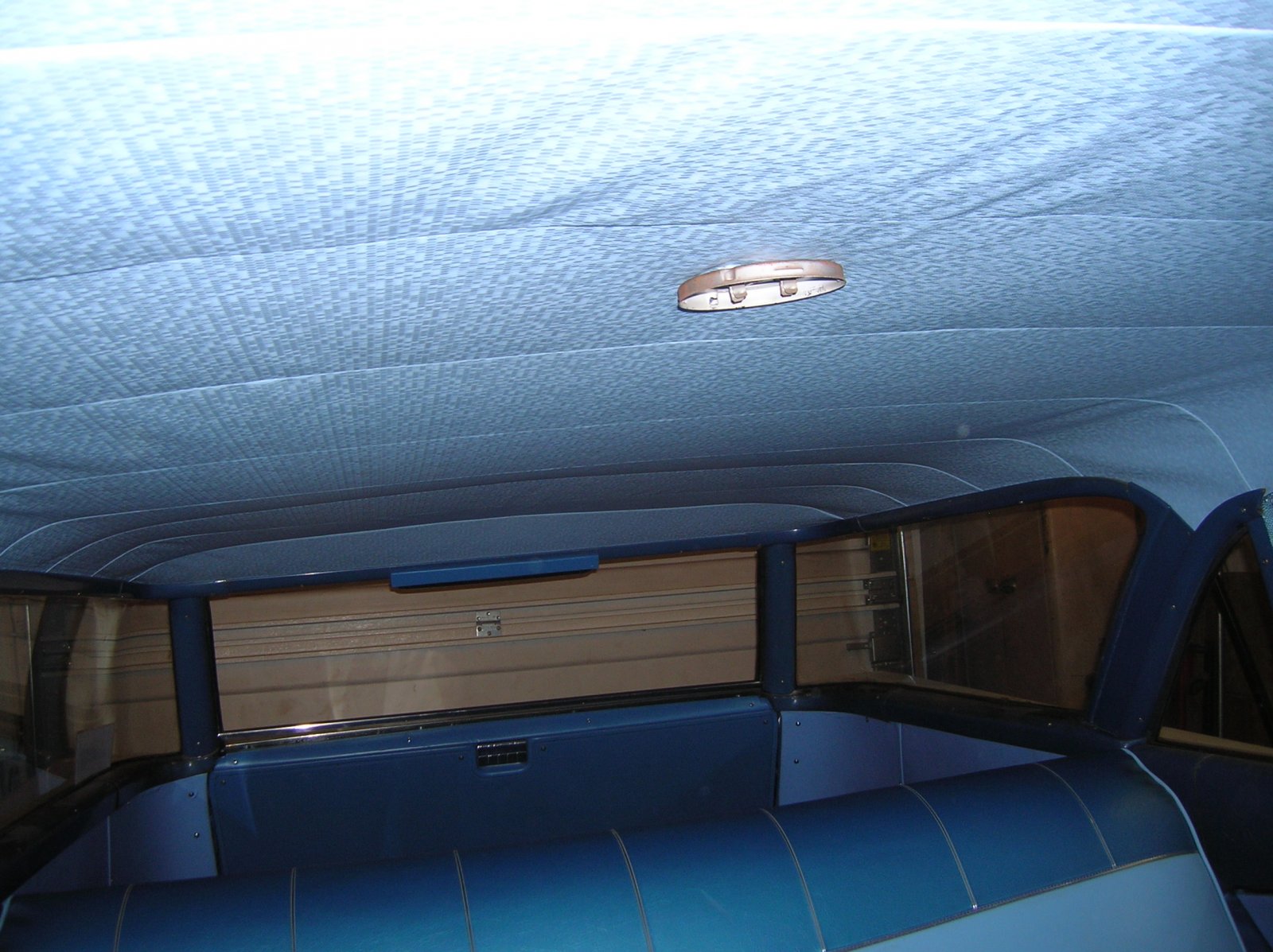

    Well the Ciadella video said to now try to go too fast on the headliner. I'm following that part really well. The first p*** stretching (including taking the front 1/4 down the get a missed tabs) all around is done and hope the forecast for Sat. holds for dry and warm sunny day. It is starting to look like it might turn out okay
    Question; on the metal strips with teeth above the door, how much should they be sticking out?
    When the material is tucked up it seems to stay put, but it can still pulled back out.
    Nothing has been trimmed yet and was thinking the teeth should dig in a little more.

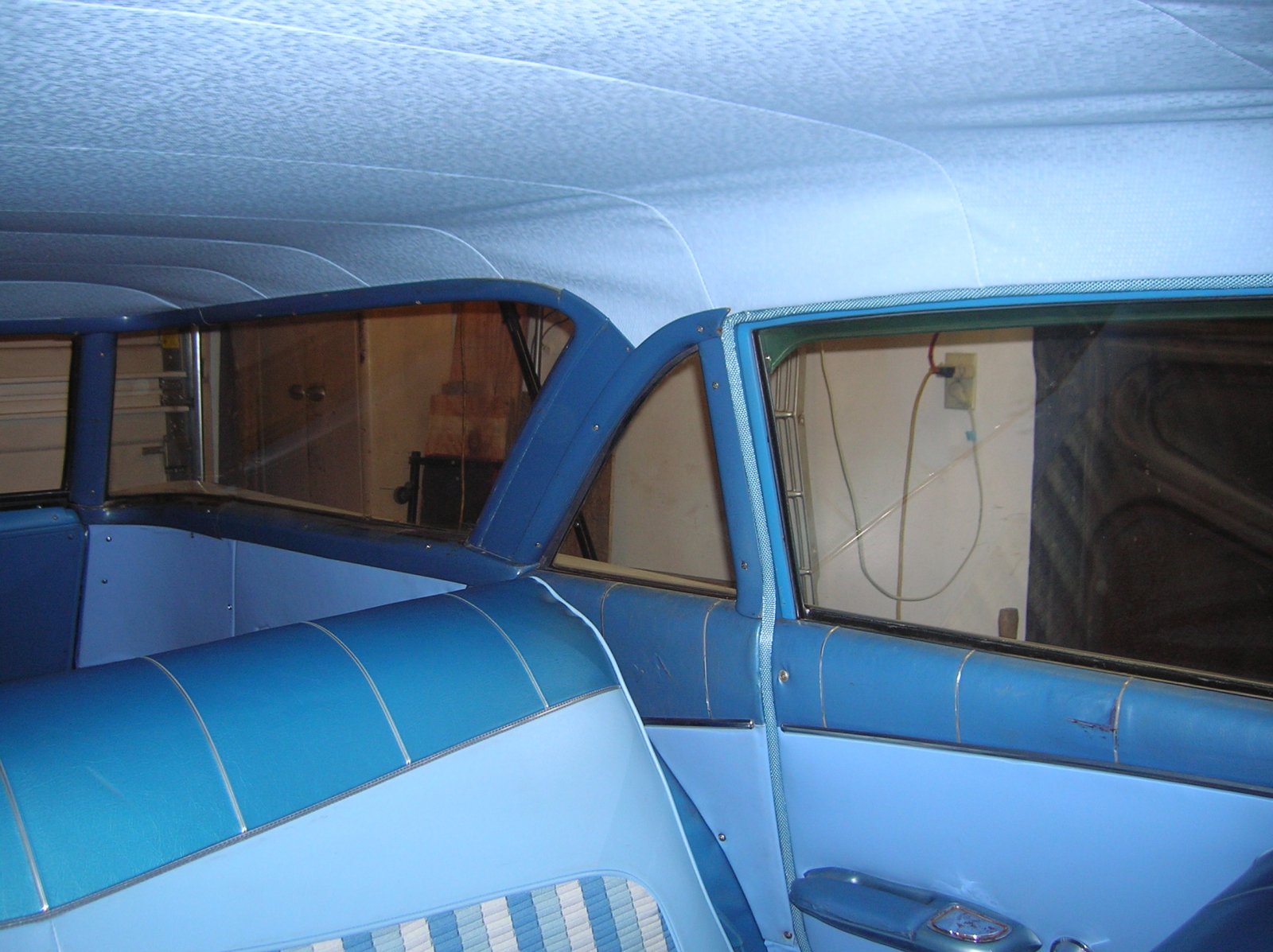

  5. Hey Bruce, it's been over 5 years but as I remember the teeth are punched out at a 30-40 degree angle and were pretty sharp. I think the excess folded head liner material provide the pressure against the grip strips.

    That is my concern, mine seem like they might be a little too flat.
    Hopefully it will hold okay, if not might have to pull it apart

    Not great, but a major improvement and considering it was my first attempt. it will be just fine. I may have to pull the strips over the doors off and reset the points, just could not get that areas tight. WP_20150606_16_39_56_Pro.jpg

    Looks pretty damn good from where I'm sittin'. That's a lot of headliner to be putting up, especially for the first attempt. You're doing fine. I'm enjoying watching your build come together.

  10. A few 90+ degree days in the sun and that should tighten up a bunch.

    Hi Fan,
    looks like I misunderstood, if you are saying that the heat will shrink up the liner after it is all installed, that will be great.
    Was under the impression it was primarily used to install, like with a heat gun. Put the car in the driveway to set for a while before the final stretch and it got was easier to pull.
    Getting all the interior trim back in and then will try the "Solar" approach

    gingerly use a heat gun from a distance. That's what we used at the upholstery shop. It will tighten up from there

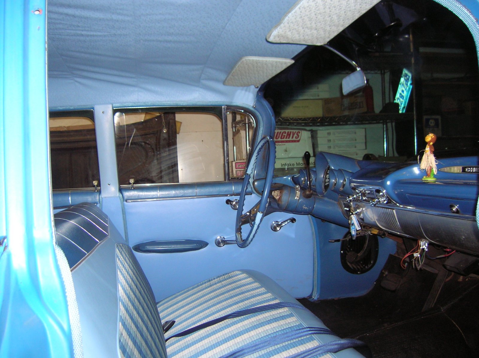

    Update on headliner... it looks like it did tighten up over the summer. (actually 2 summers, ~15 months)
