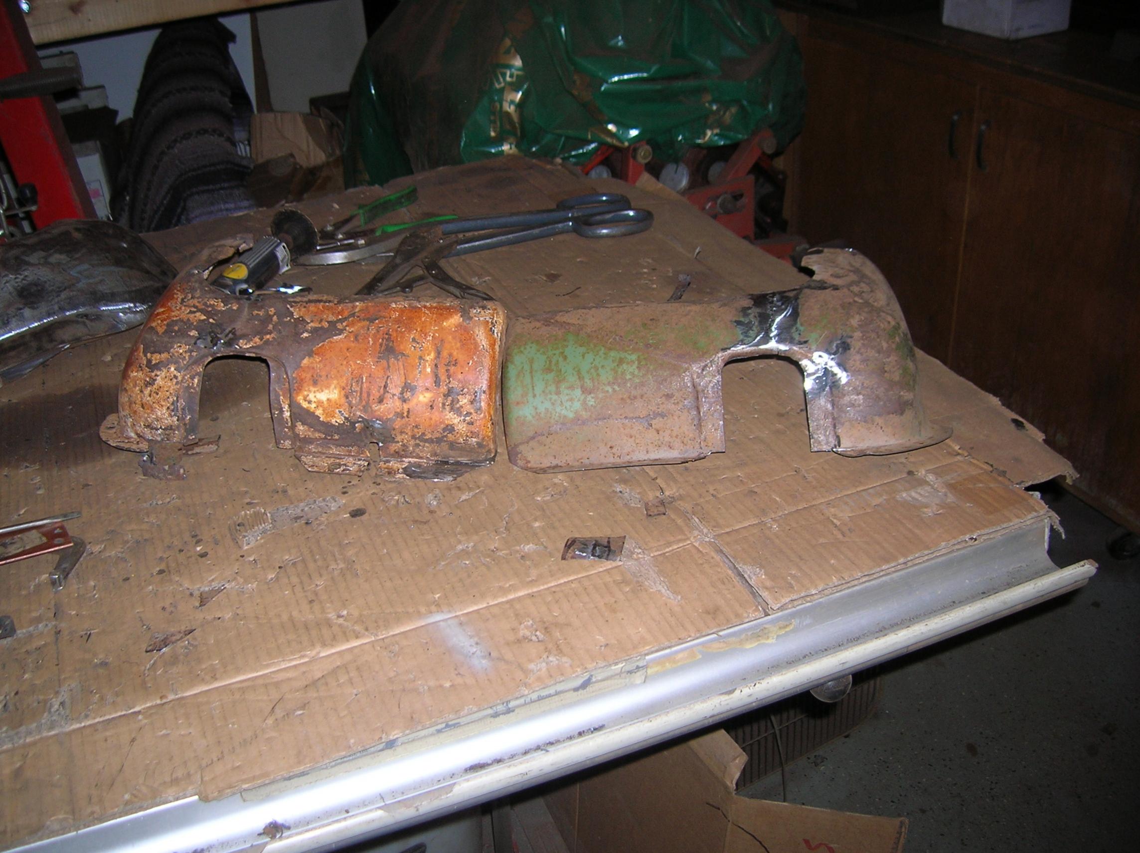

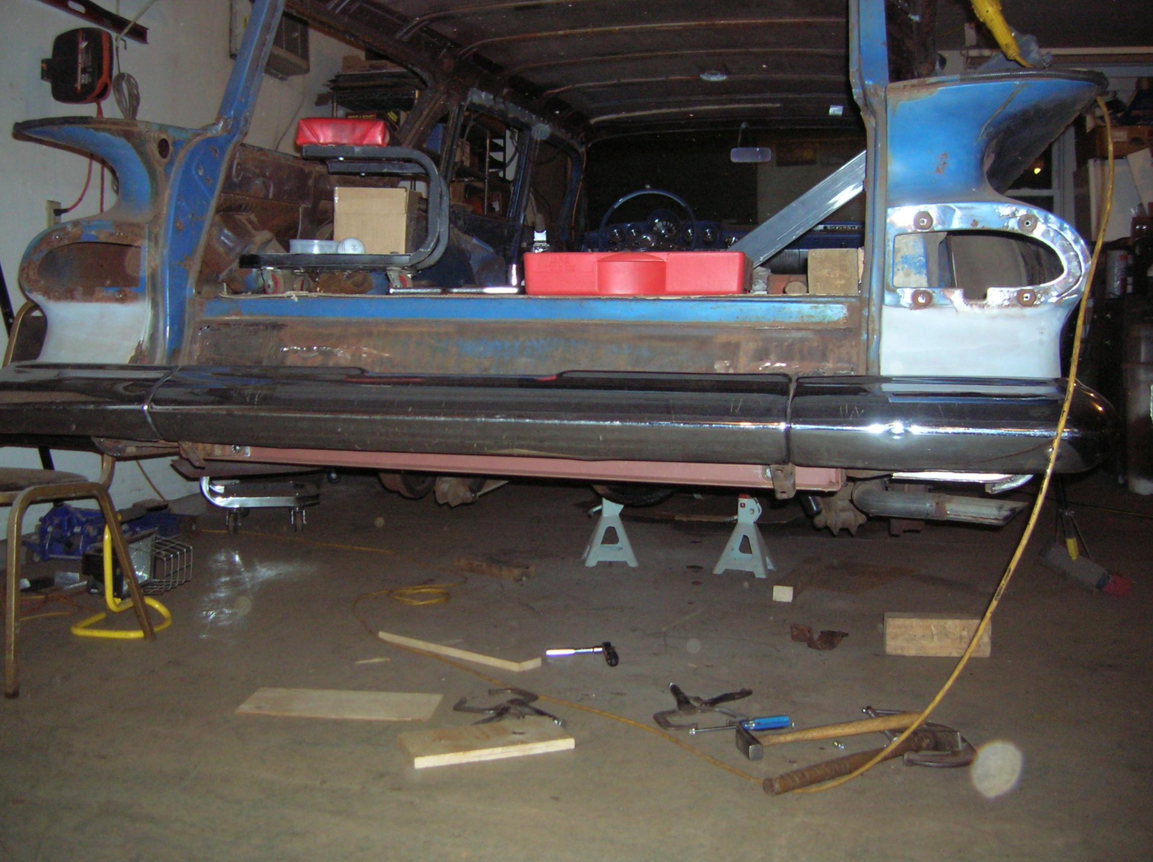

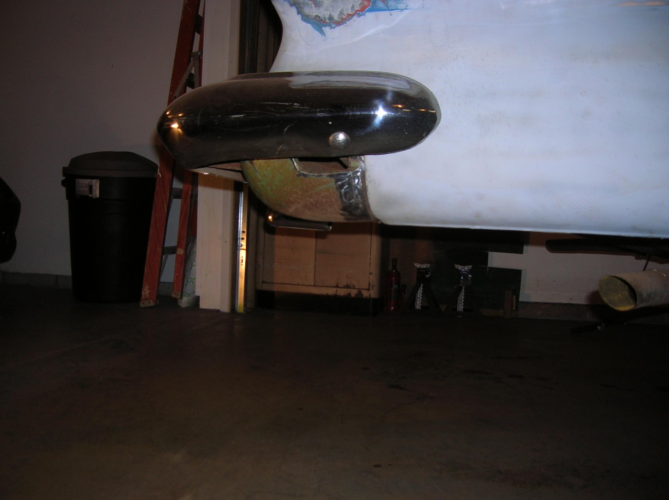

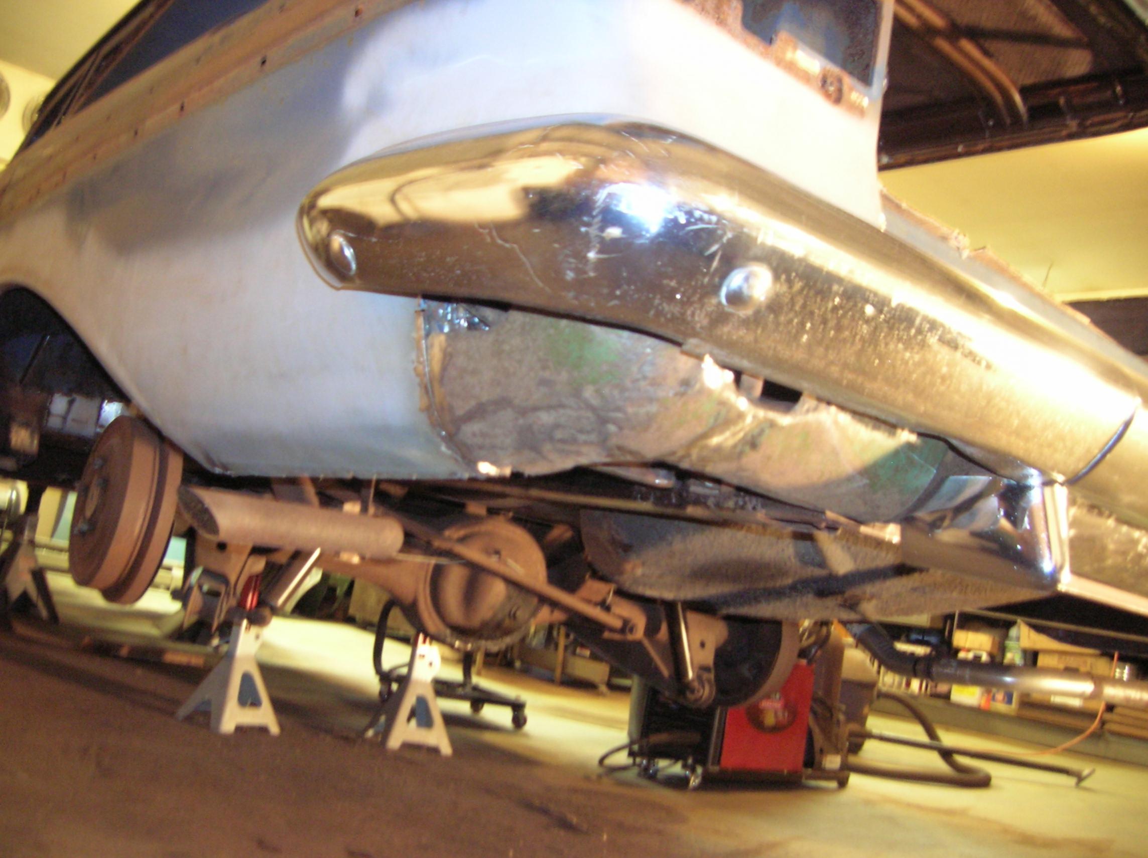

    Time for an update to help keep me moving. Impala rear valances to fit, based on a really banged up wagon one i got cheap. Made some patterns and got after them. The valances will need some filler but should look okay when done. It took a lot of cutting as they truly are unique compared to the car valances
    The bumper is now solid as a rock, I think i could even use a jack on it to lift the car up ;)

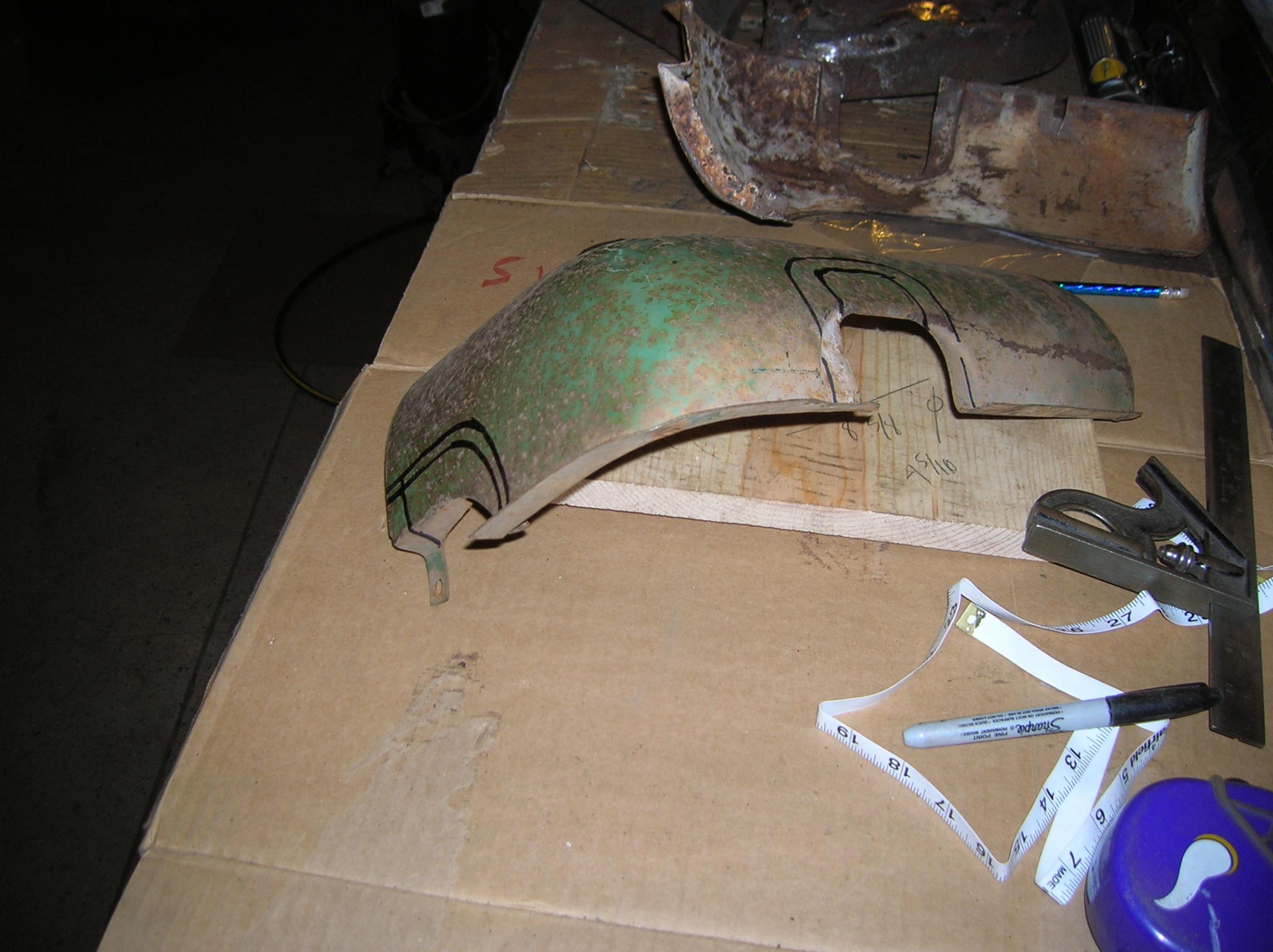

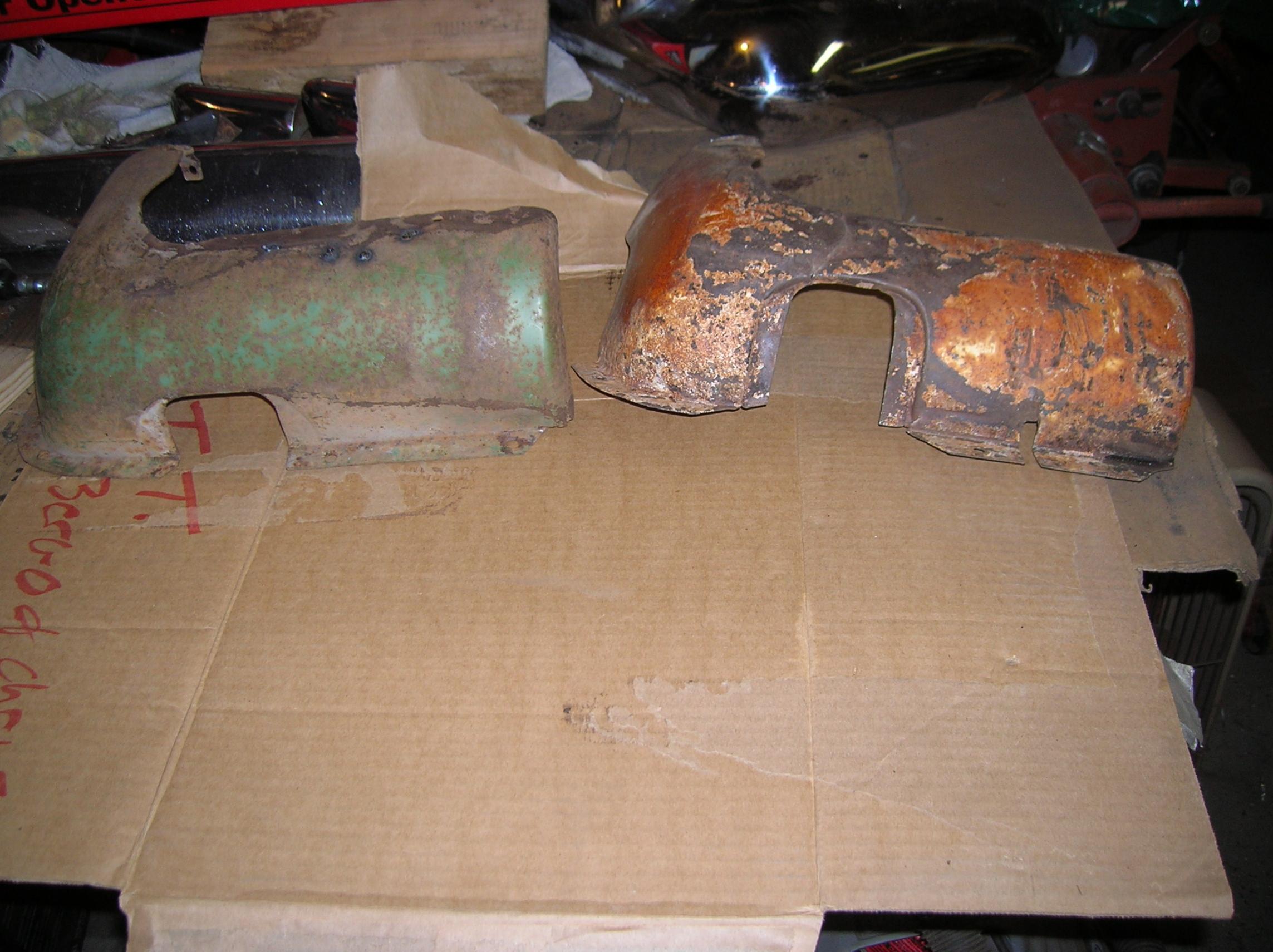

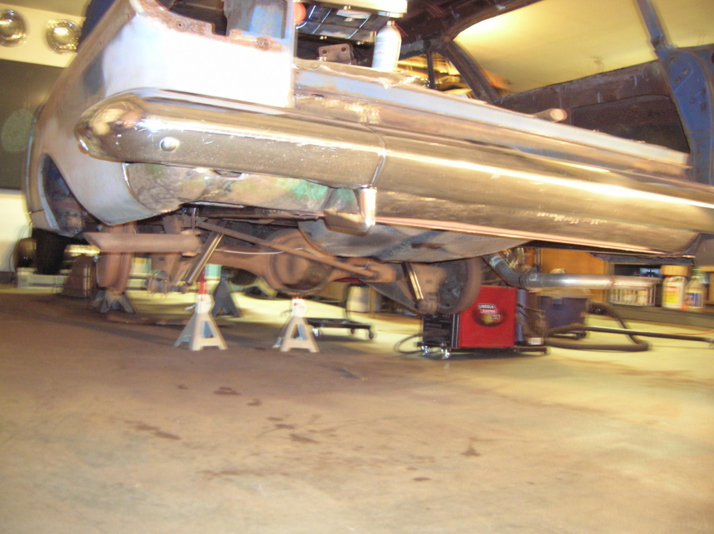

    Did some more work on the rear valances, had to do a pie cut and fill to make it fit up right, kind of like a baby roof chop. Turned out pretty good so i went on to the drivers side, which went a lot faster, since i had patterns and knew where to cut the piece in half to take ~ 1/2" out.

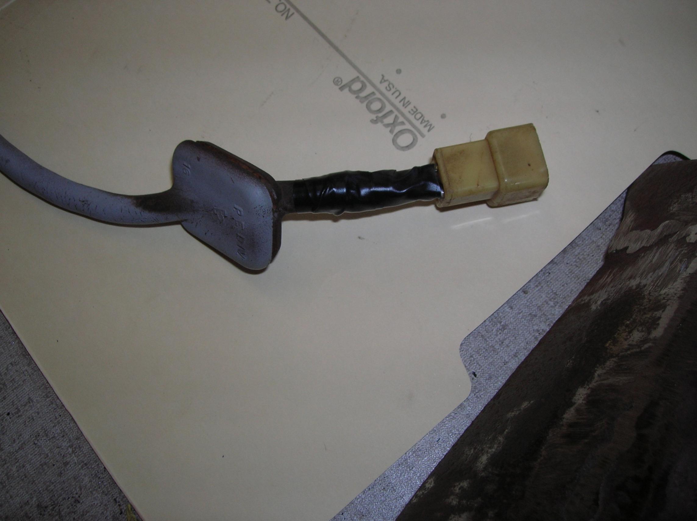

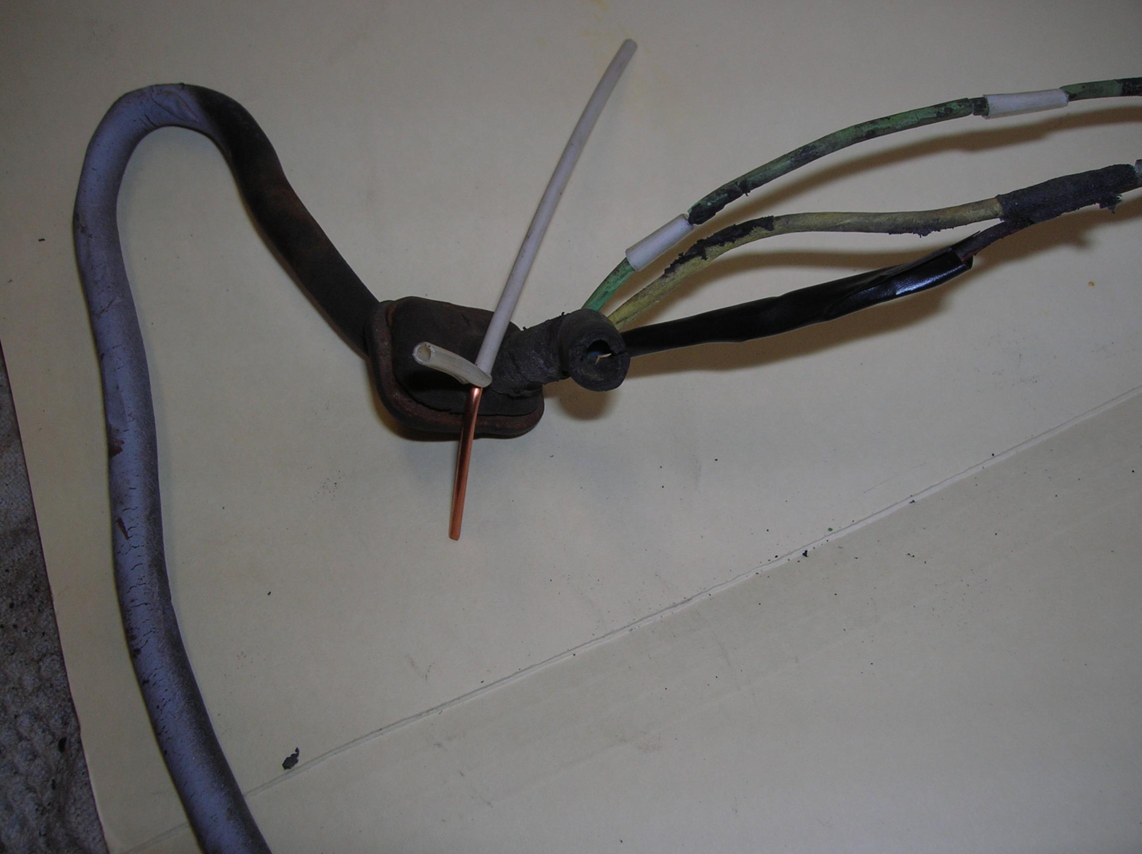

    Also reworked part of the wiring harness where the insulation basically turned to dust when i took the tailgate off. The worst was next to a molded rubber grommet that went to a plug connector. The wire was still sound so i cut some off of some solid 14 Ga wire, wrapped it around the stranded wire, wrapped that with electrical tape and then wrapped the whole works.

    I just did my '57 210 Townsman's wiring a year ago so I feel the pain. I had to CHISEL the firewall grommet out of the firewall because it was so petrified! Your body work looks good keep up the good work. Wagons rock!

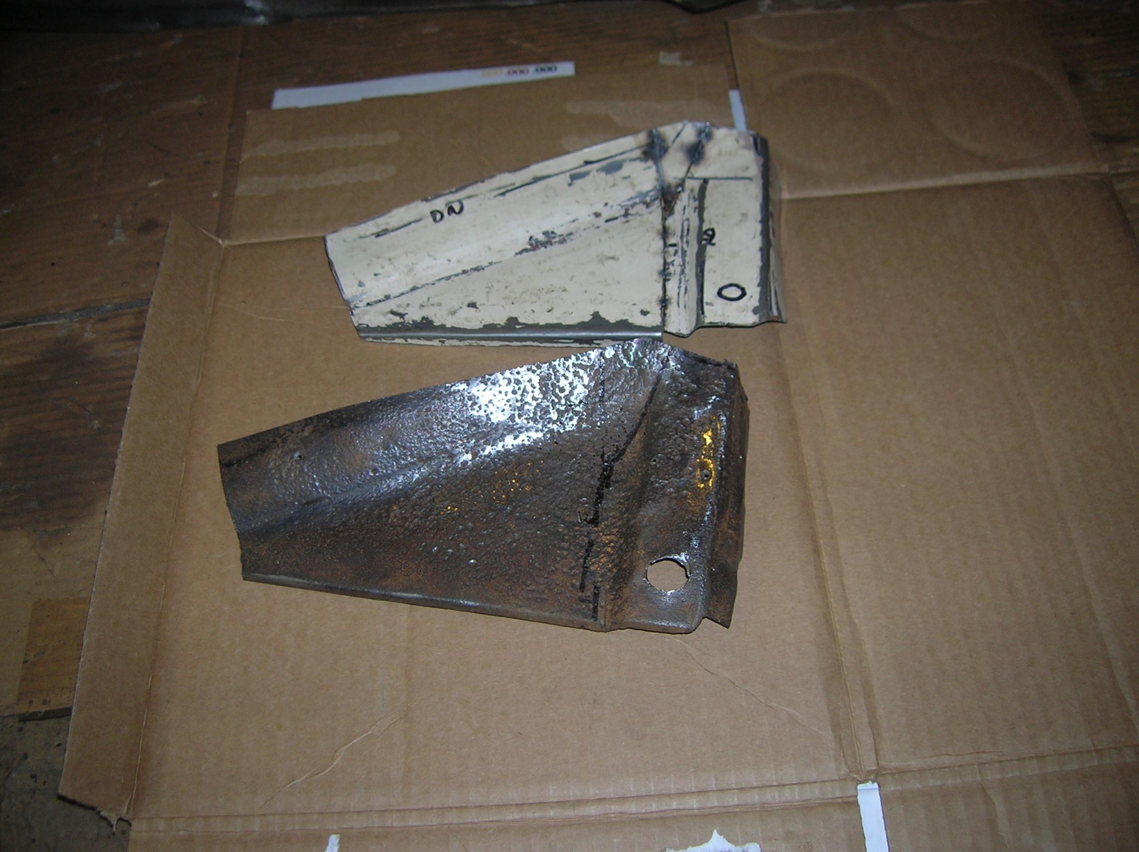

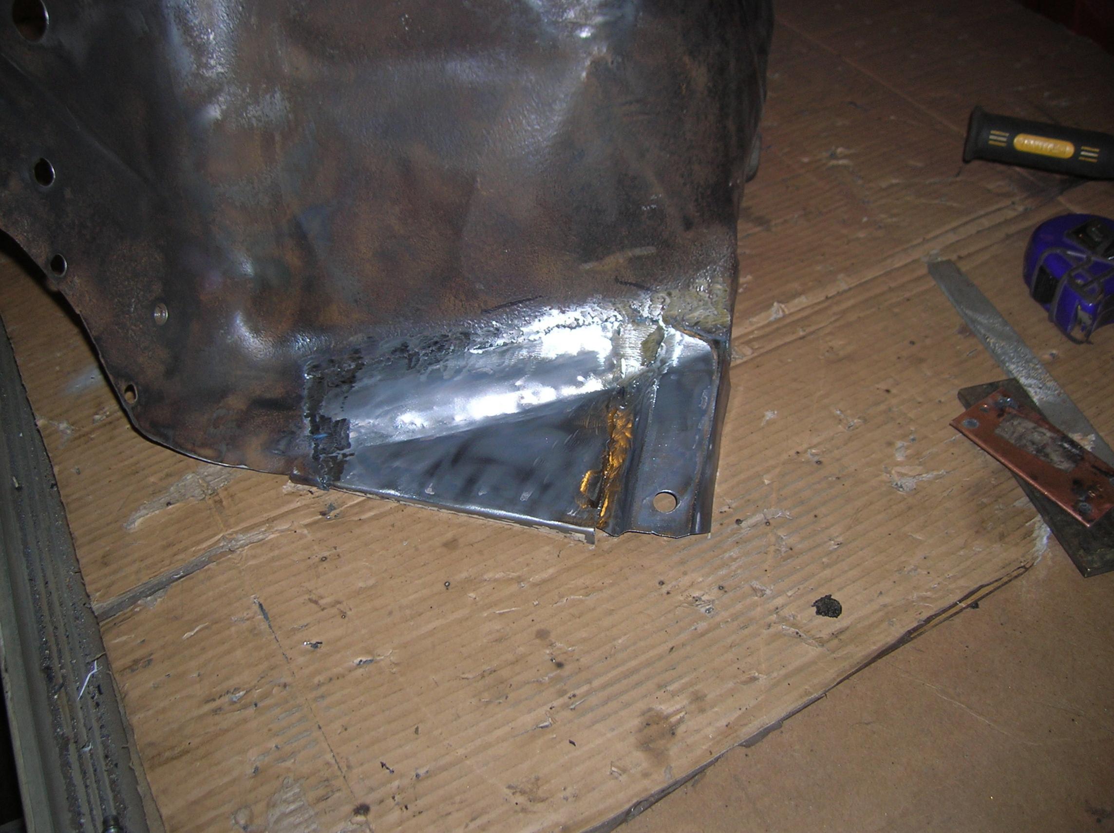

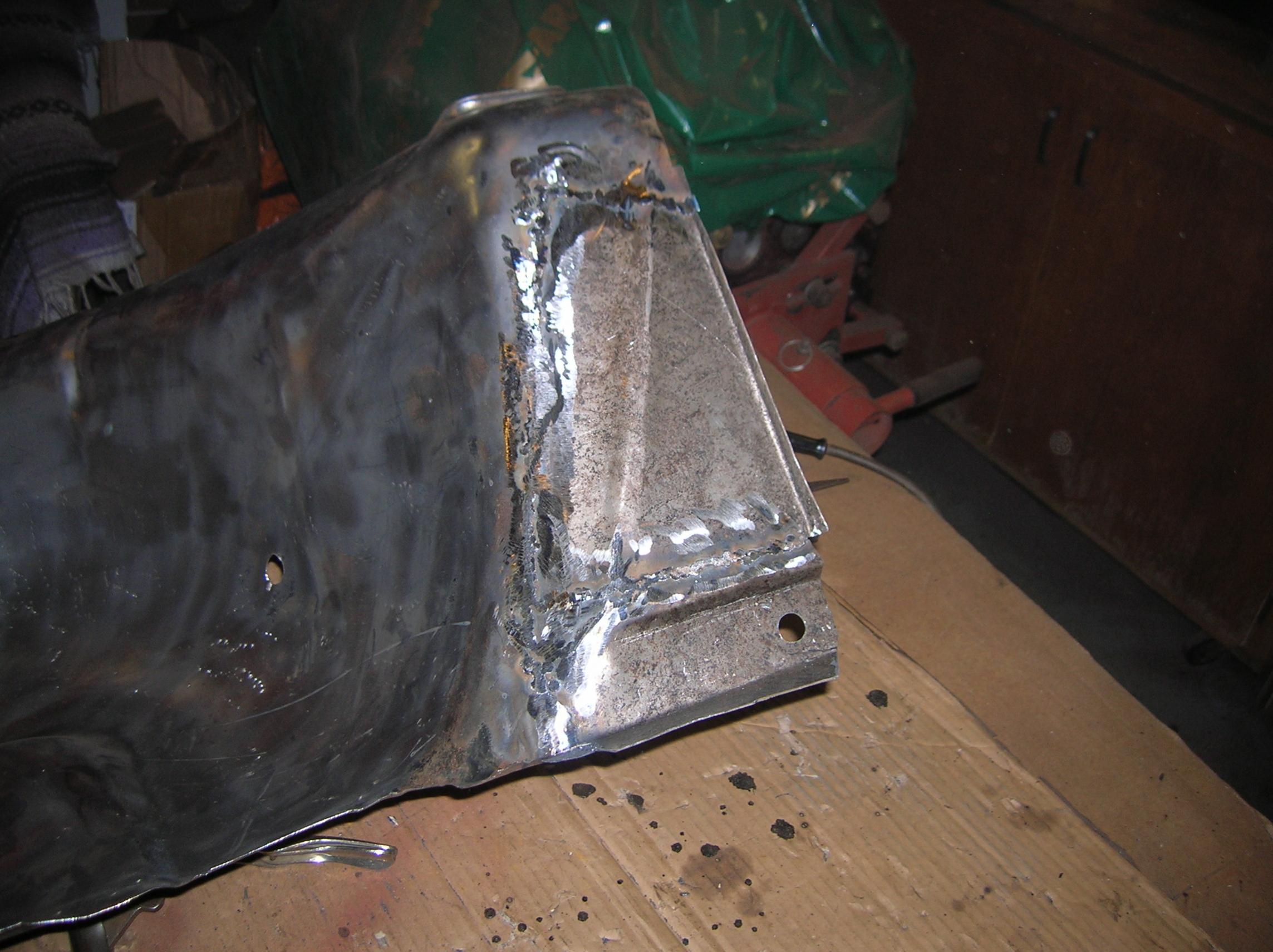

    Here is what i have been working on recently. when i cleaned up the wheel wells, it was clear that the side under the battery was full of holes. The first picture is with a light behind it and the bright spots are all pinholes.
    I decided to try to make a repair panel, first out of a single piece. once that proves to be beyond my current skill level, i made it from 3 pieces
    it will need a little bit of bondo, bit it is solid and make me want to keep finding ways to make parts.

    well it look like i have all the rear bumper and valances fitted up and it should book good when all done.
