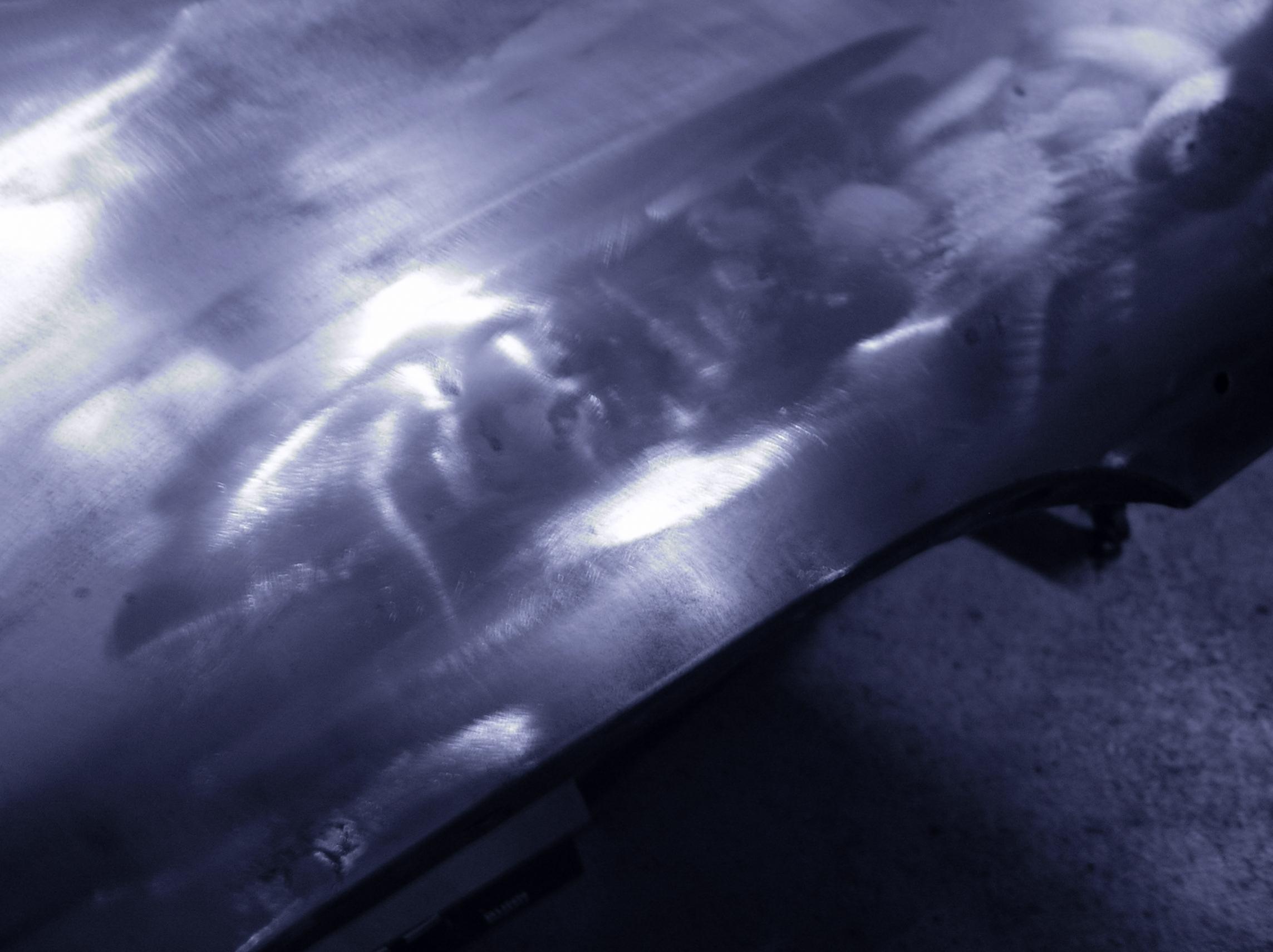

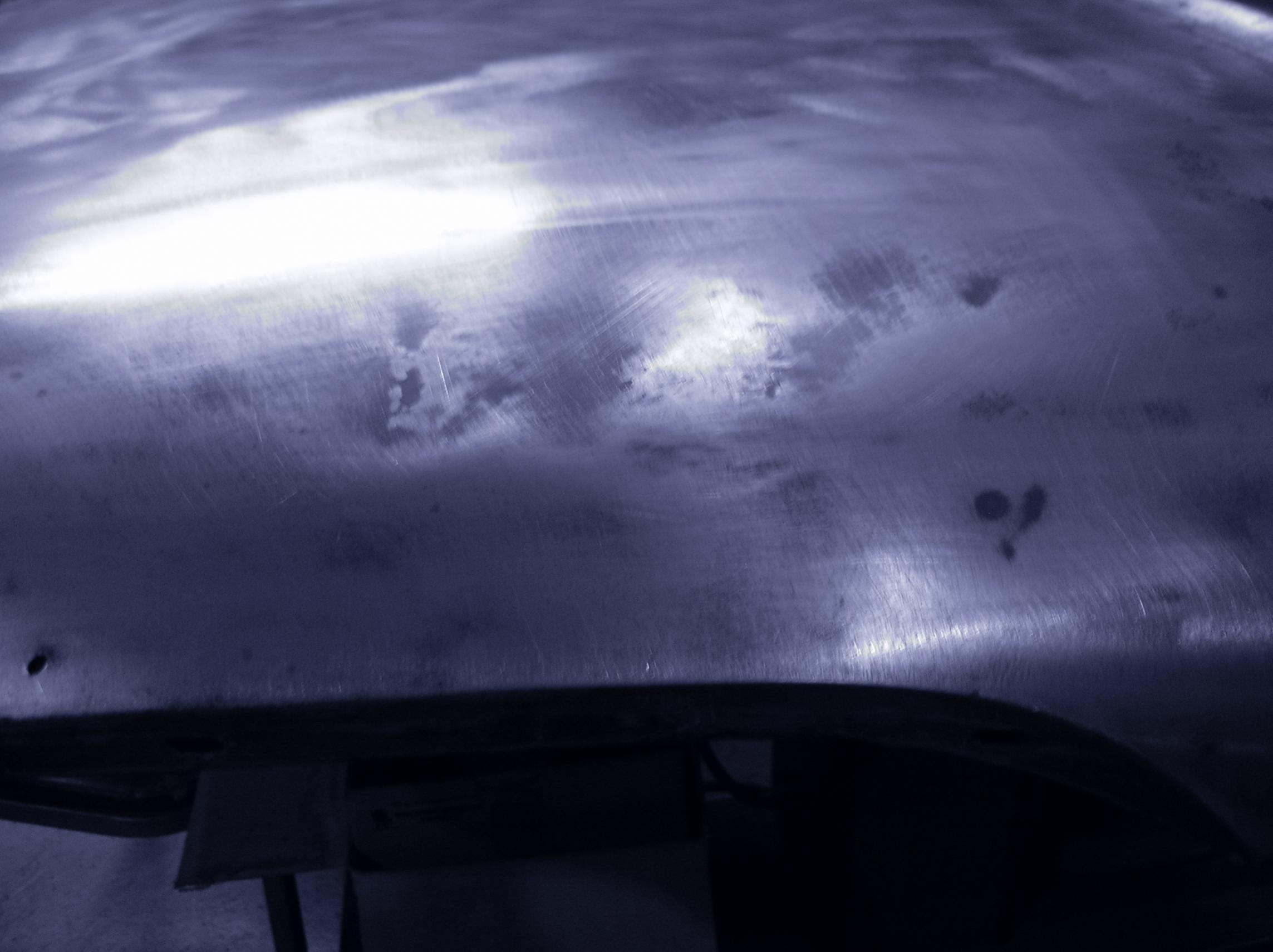

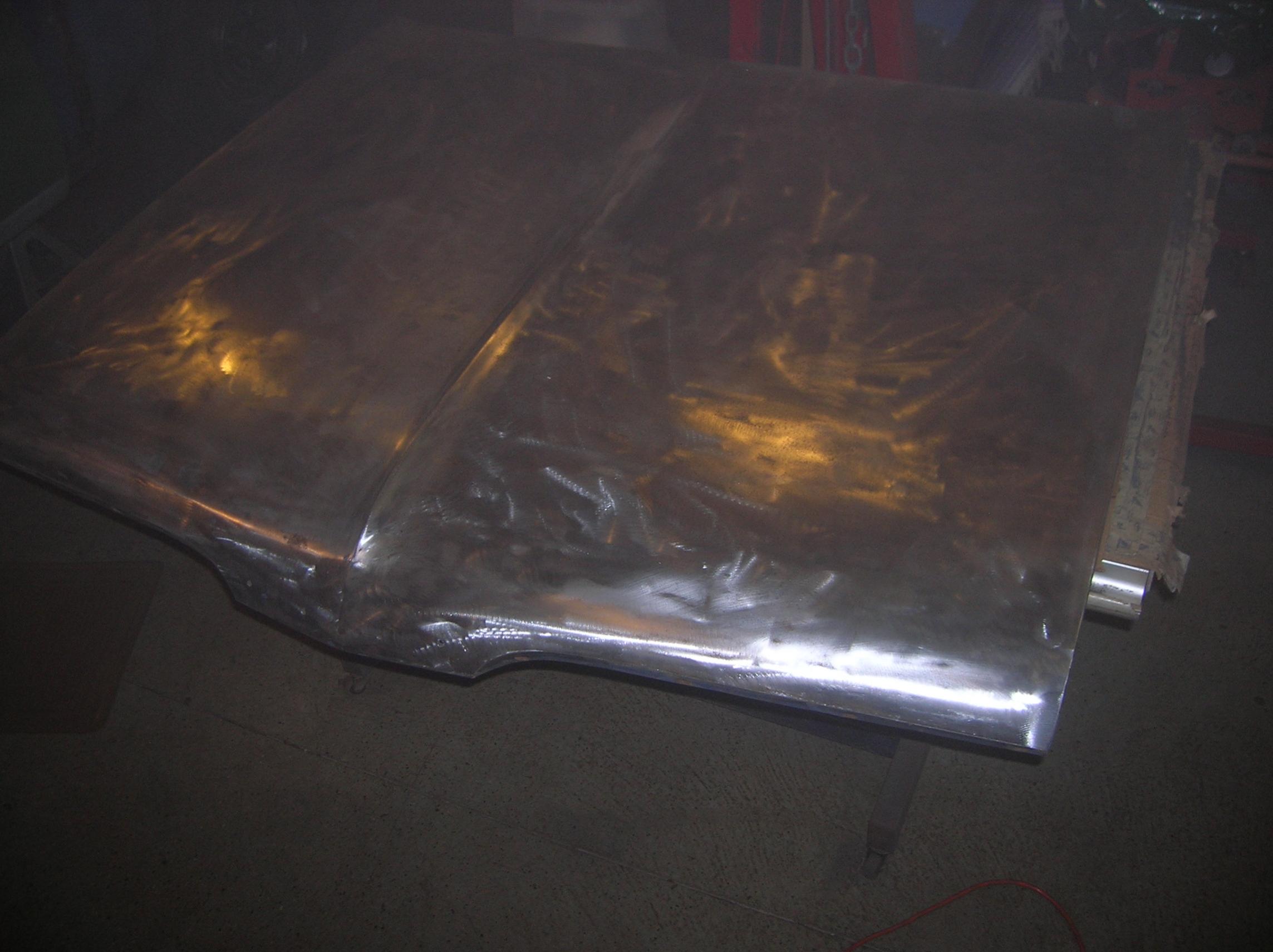

    After reading lots of suggestions on stripping paint I decided to tackle the hood. it is solid but had heavy surface rust with some areas with no paint left. tried the razor blade, 80 grit sand paper, wire brush,, a disk with lots of little paper and finally a 3m purple stripper. the 3M disk worked best for me and i got the top of the hood fairly clean.
    I can see where in a couple of days you could do a car with it. the sand paper did okay if you changed it really often, went through ~7 or 8 with out getting to far. I will probably do the roof the same way, as its condition is similar. The sides may not get taken down to bare metal, as they have fairly solid original paint.
    My next step will be to decide how to stop the remaining oxidation from coming back, again lots of posts and recommendations. there are lits of light traces of rust still showing. may now try some 120 grit, but it looks like it will be hard to remove it 100%.
    It needs a little more work but here are the after pictures. I have been waring a mask and it is a must with the dust in the air. I finally had to turn off the flash because it fogged up the picture, as seen in the last one. The mask was a very dirty too.

    i use 3m prepsol this is acid that will eat the rust.if it is not to bad i just scrub it with a scotch pad till it perfectly clean then you must nuteralize it. this will clean the rust but it will rust again quickly if you dont seal it with epoxy primer. if you have major rust pits i have soaked rags then layed them on the rusty areas used spredersto get air bubbles out then cover with some plastic so it dont dry out let sit overnight this will eat rust away reel good but dont leave on too long and it will eat metal away till theres none left. do not blast hood or roof this will warp forsure and you will need plenty of bondo to fix. good luck

    watch the stripper disks will make alot of heat and possibly warp the hood. i dont know how bad your roof is but i had a kingswood that had holes everywhere on the roof i think it had something laying on it for years outside any way i re skinned that one with a nice roff from a 60 and it really was not bad to do just alot of drilling spot welds and takeing out all gl*** and window trim.

    Thanks for the tips. basically it is not that the rust is so bad, it is that the paint is almost gone and i do not think i can paint over it. there is just some light rust remaining, but like the old saying goes, "the rust never rests".

    if you have enough air a mud hog will strip paint super quick. this is a 8 inch oribtal sander. NOT A DA it is more like a grinder. works great for stripping paint bondo ect. also is the best way to cut plastic quick if you have a large flat area to make flat.

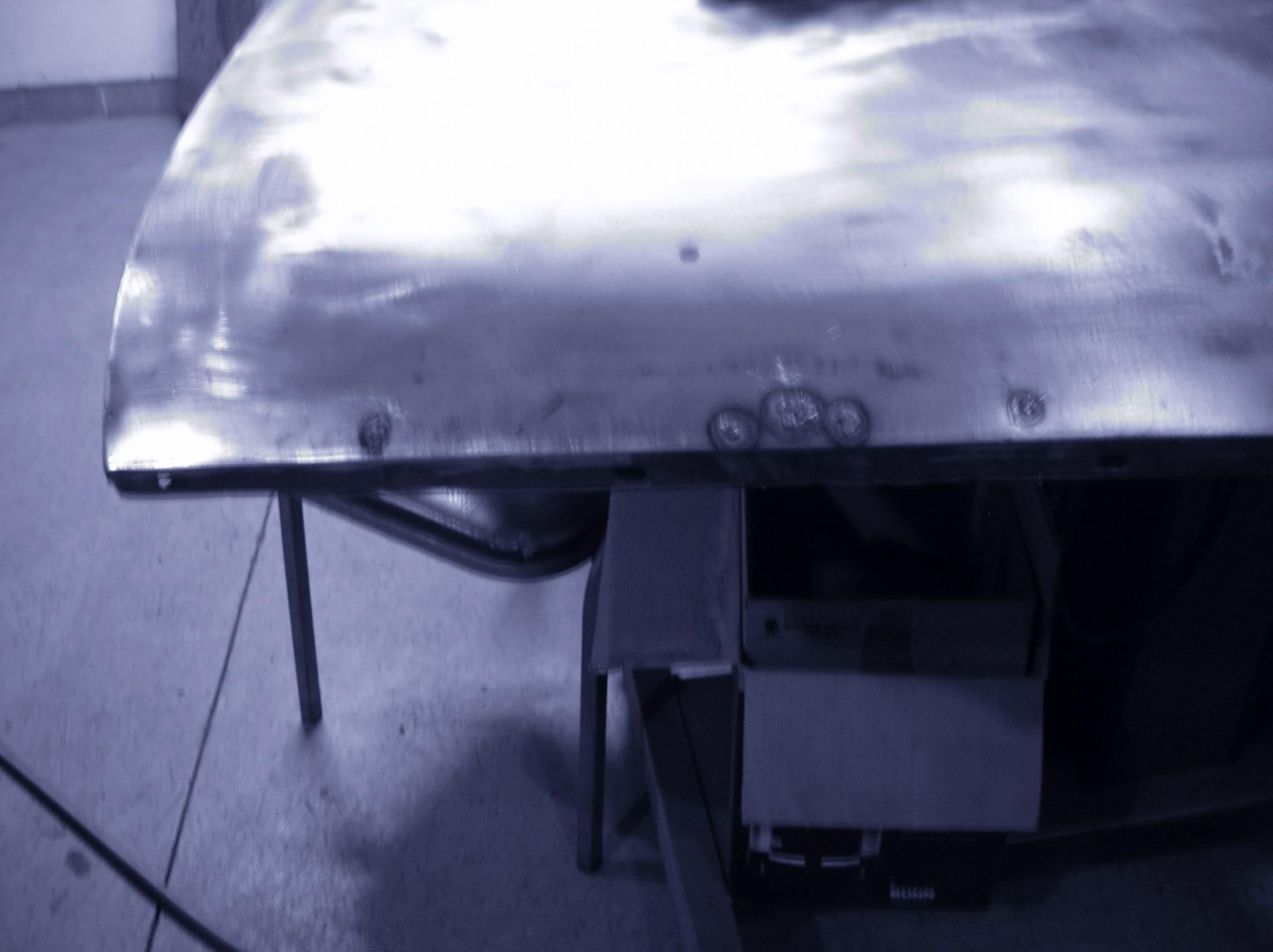

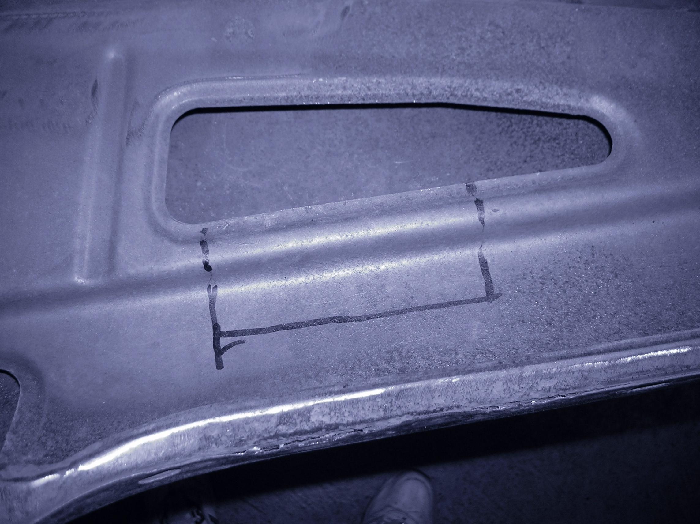

    in keeping with my goal to try as many types of repairs as possible on this build (***uming they are needed), i did some hammer and dolly on the hood and welded some pin holes. the dents were in the front of the hood and the back was covered with the reinforcement backing. i could have went with 1/4" of filler, but now it will be well under 1/16". I'm not to the "no Filler level" yet, but this will be a big improvement.

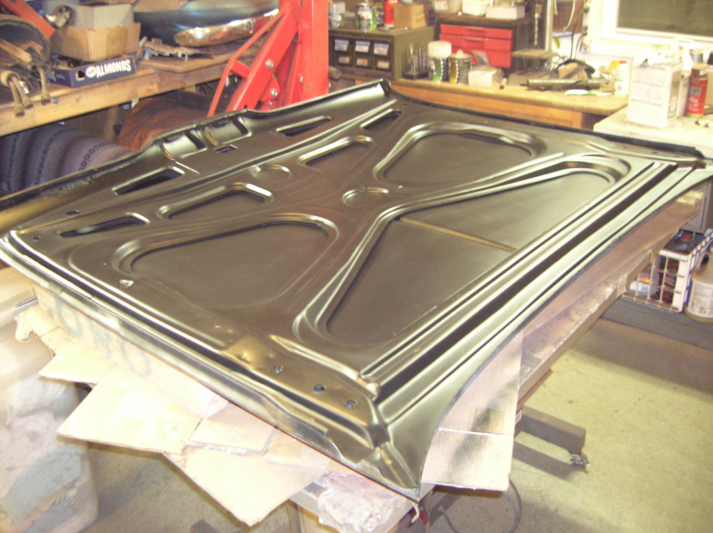

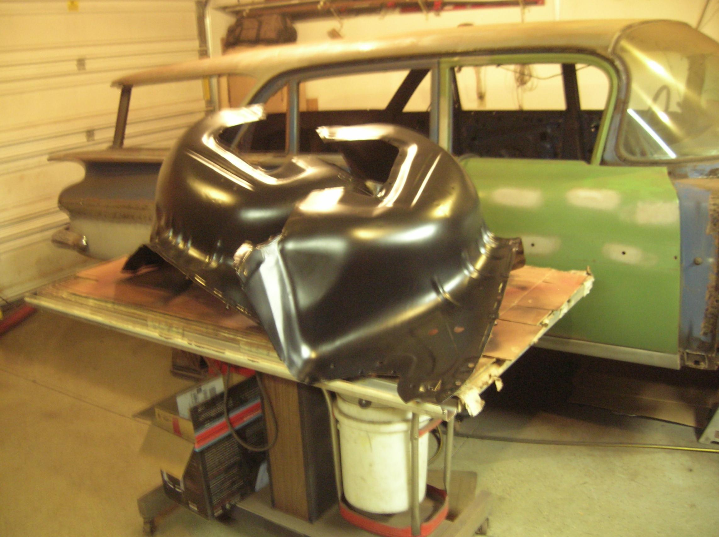

    It's great to see all of these 59's resurrected. After seeing what most of you are going through, I feel very fortunate to have started with an Impala that is in great shape. Here's an example of one of the fender extensions I just cleaned up and painted. Just about perfect. Lucky.
    Travis

    thanks Travis, i at times wonder if it can really be that simple, after having spent some time out west seeing all the rust free old cars around.
    looking at the picture i guess it is all that and and then some, it looks more like a new part.

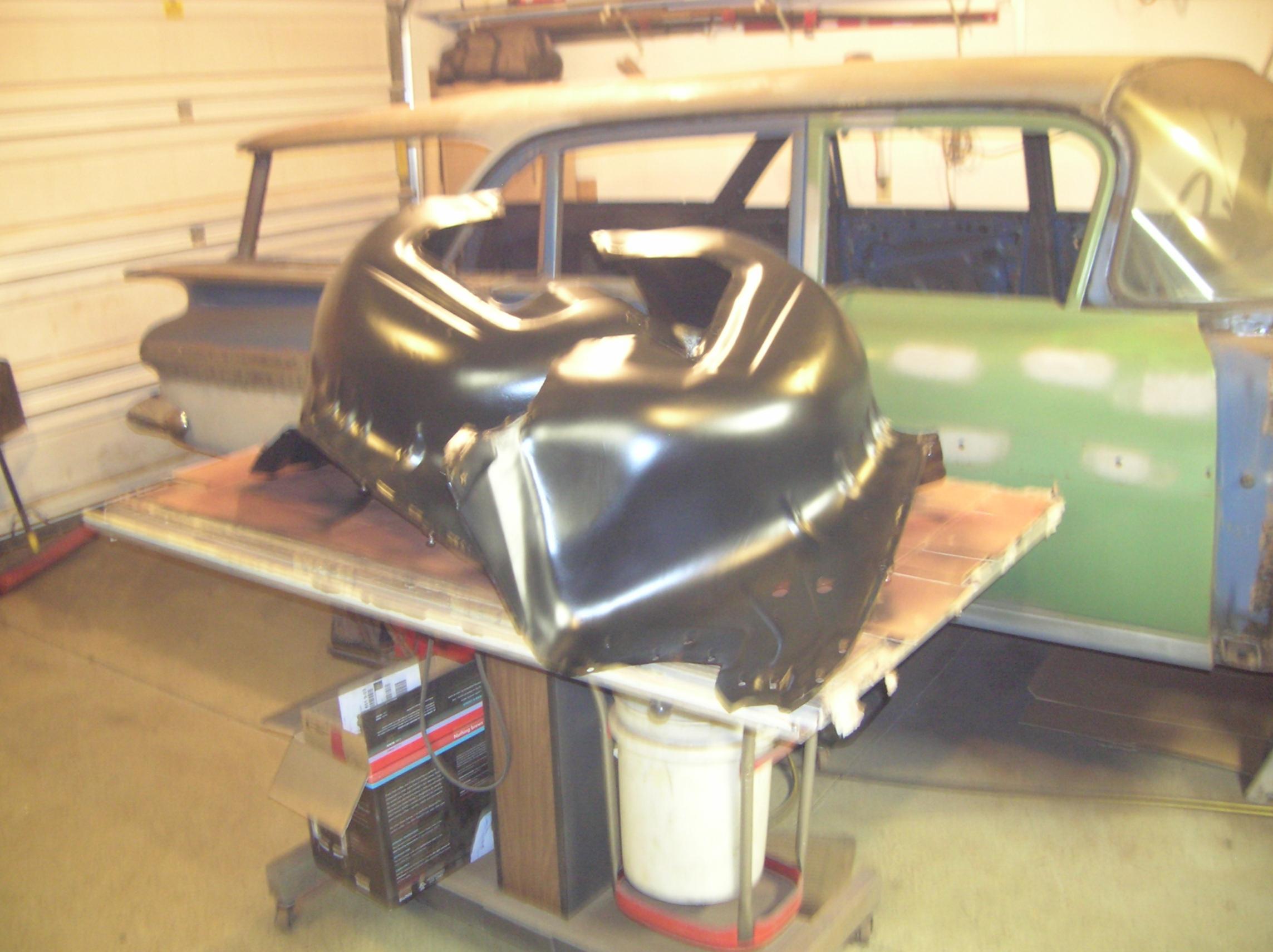

    Well I decided to get something done so I primed the fender wells and painted with a rattle can semigloss paint.
    They look like a ~7? on 1 to 10 and much better that the way they started. If at some point they are the weak link, dragging the whole car down, i can pick up some re-pops

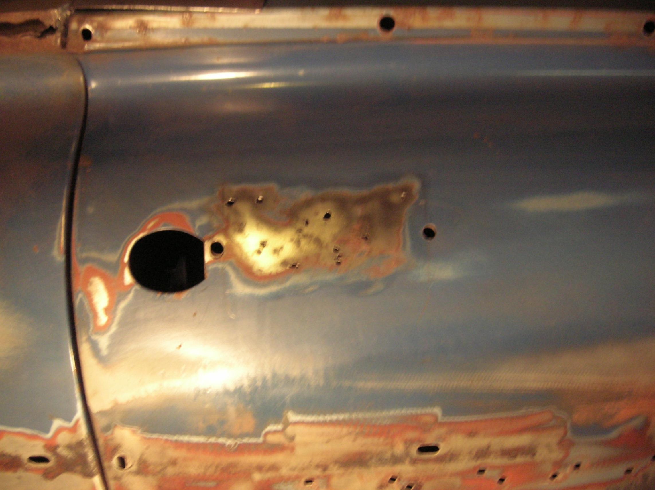

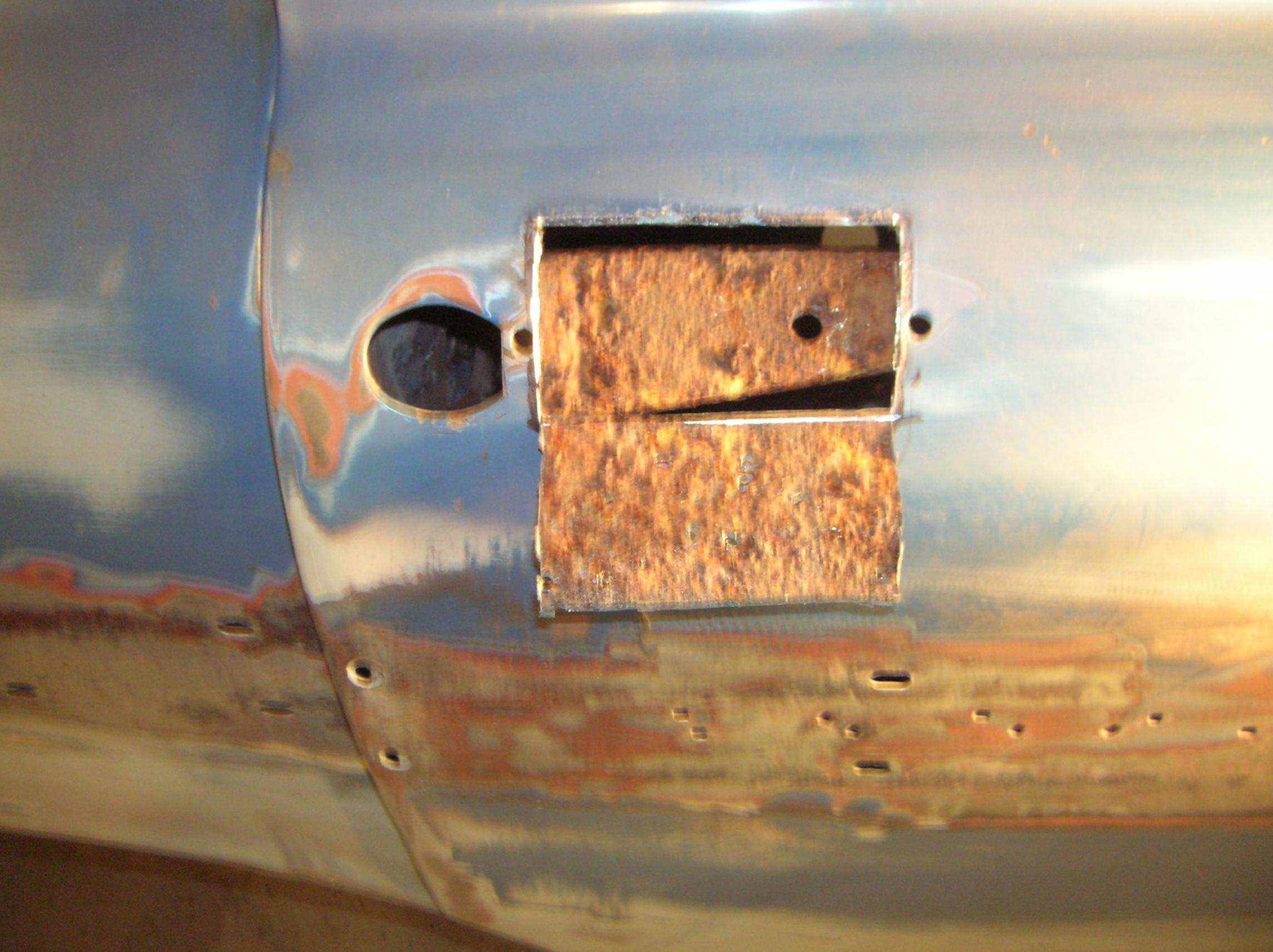

    more fun with rust.... turned out to have some more Swiss-cheese on the rear door. i must need more practice.
  25. Cody Walls
    Joined: Nov 14, 2008
    Posts: 1,575
    Cody Walls
    wow i never seen 59's doors rot out there , there usually always gone at the bottom , aneyways its comming along good, keep up the great work

    Thanks Cody, i was surprised too. At first it looked to be be from the outside going down but when i removed the paint there was one little pin hole. With a little probing it was clear it had to go. Too bad the wagon rear doors in good shape are so hard to find and so expensive if you ever do see a solid set
    I sometimes think the end goal is to find a low rust "carc***" from a salvage yard out west and let my car be a parts car, but that is a plan for years from now. In the meantime, I can just keep working on my patching skills.

    you can use a 4 door door and change the post. its not to bad. i fixed another 59 with the same rust problems at the door handels. it also was getting rusty at the edges where the skin wraps around. after fixing all this i should of found better doors.good luck

    I looked at trying that, did you just drill out the spot welds and then plug weld them back on? I worked on the opposite side tonight and it is getting close.

    just cut off the post and welded it on the car door like chopping a car door only changing the post insted. then changing the gl***. just do this job with the door on the car and all your gaps correct so you can put the post perfectly where you want it . no guessing here good luck sounds like your almost done with them anyway. i fixed two really rough rusty 59s then i got tired of fixing every inch of every panel and got a 59 nomad from new mexico with alot of dents but no rust. i paid alot for a compleate project but it was well worth it.

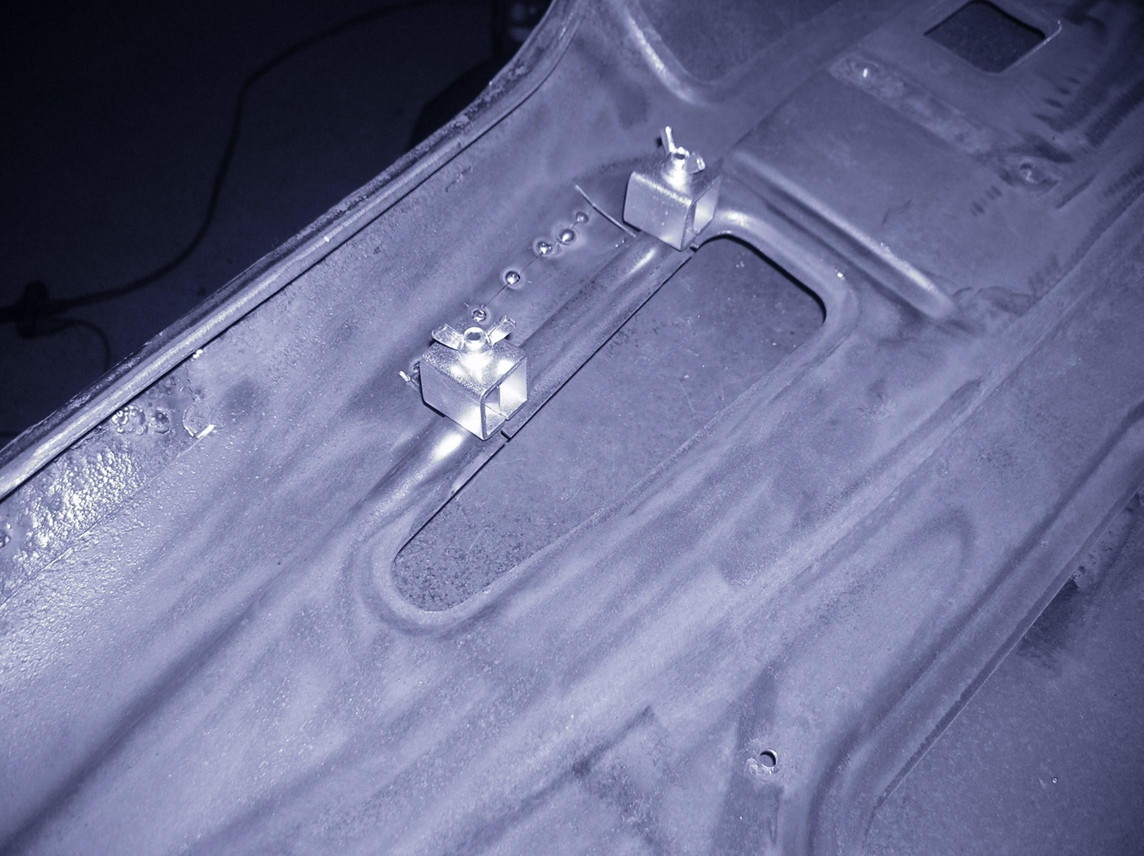

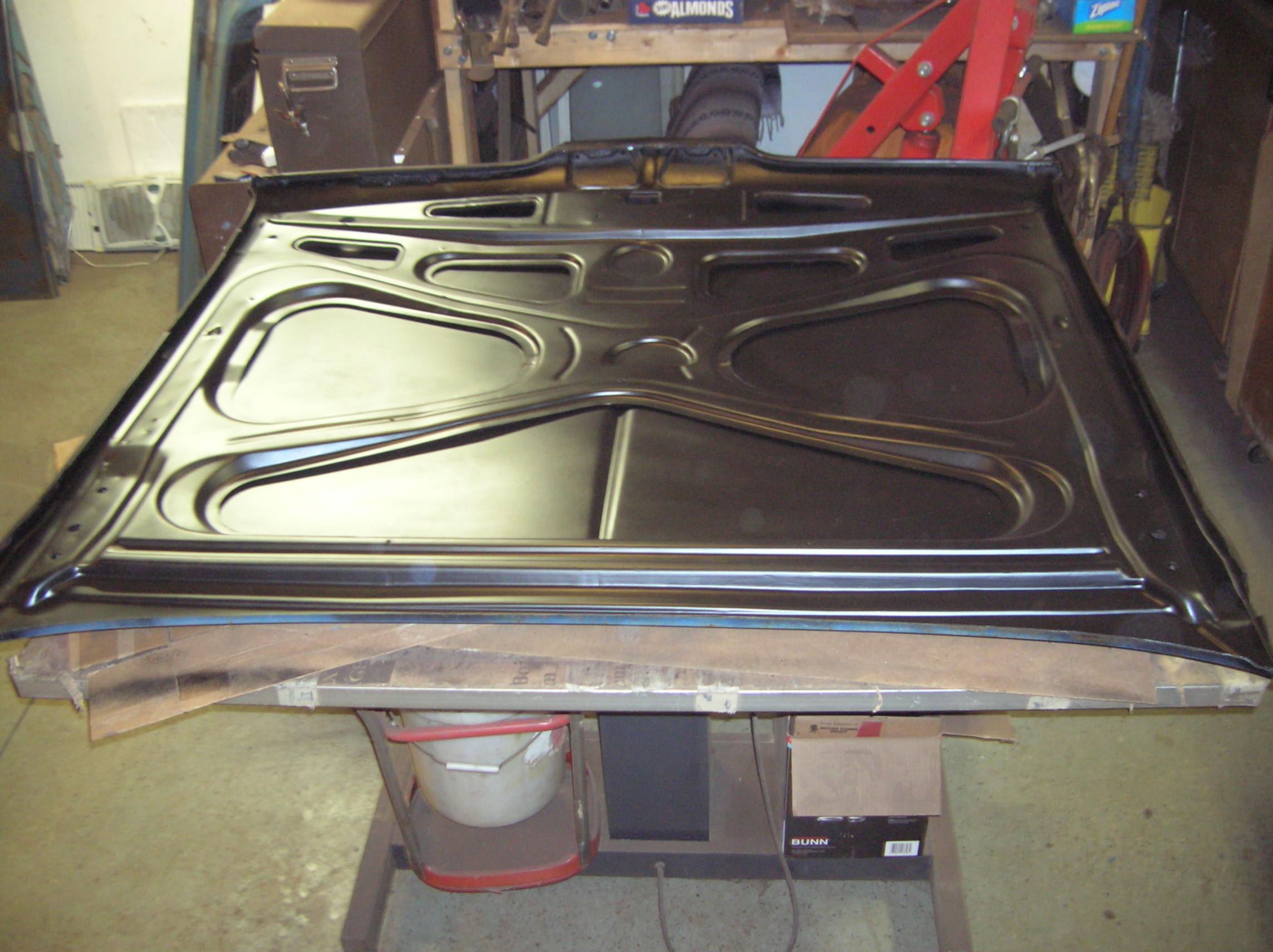

    Here the latest update of the painted underside of my hood.
    There is not a lot more to show since i have been mostly stripping paint and fixing a few more small rust holes.
    I am planning to pick up some DP60LF blue primer to start priming with to see how it works and if i like the looks of it. Long term I really may need some better sheet metal to really get the car 100%. Time will tell.
