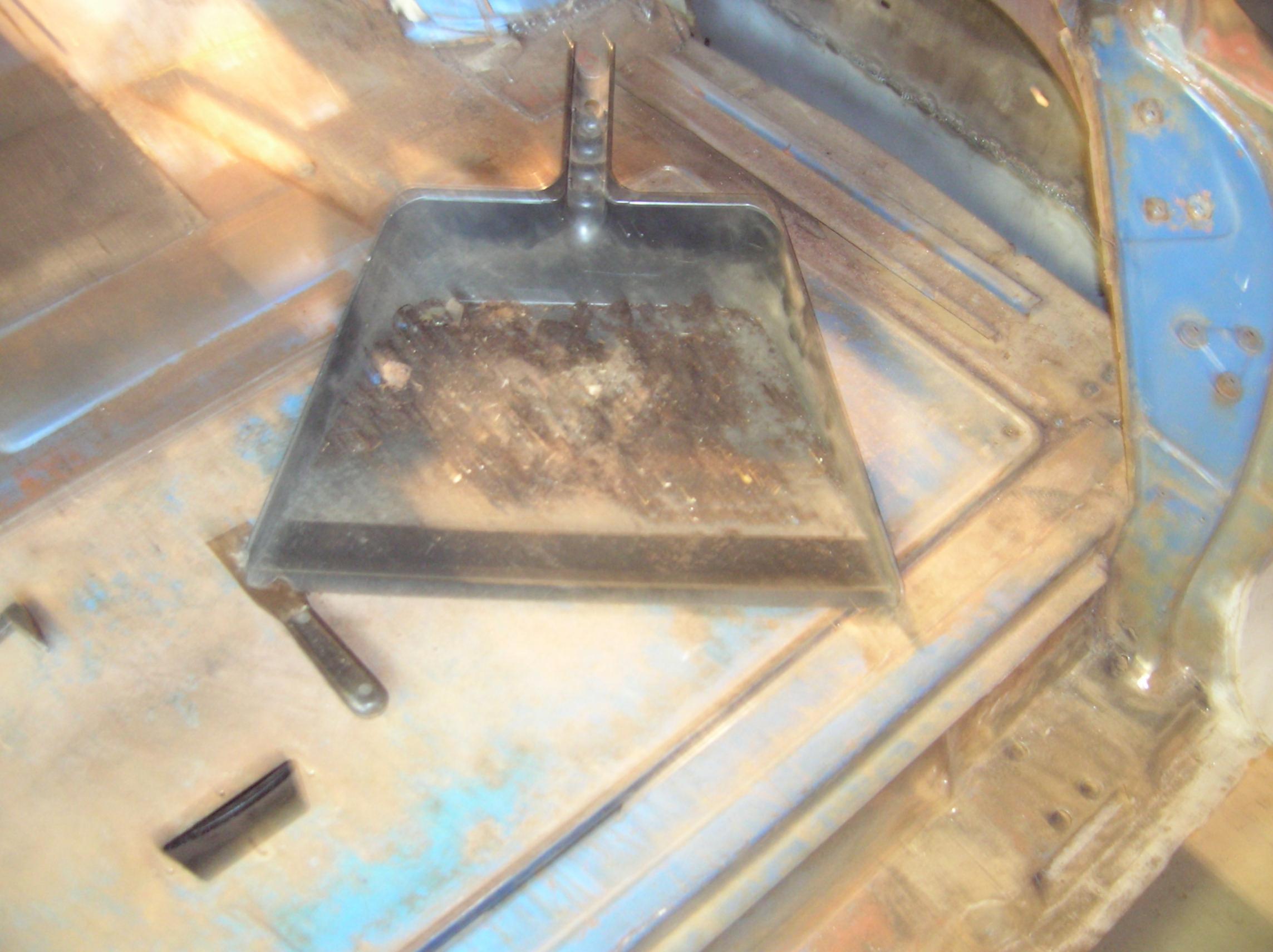

    More slow work on cleaning up areas that will not show much.

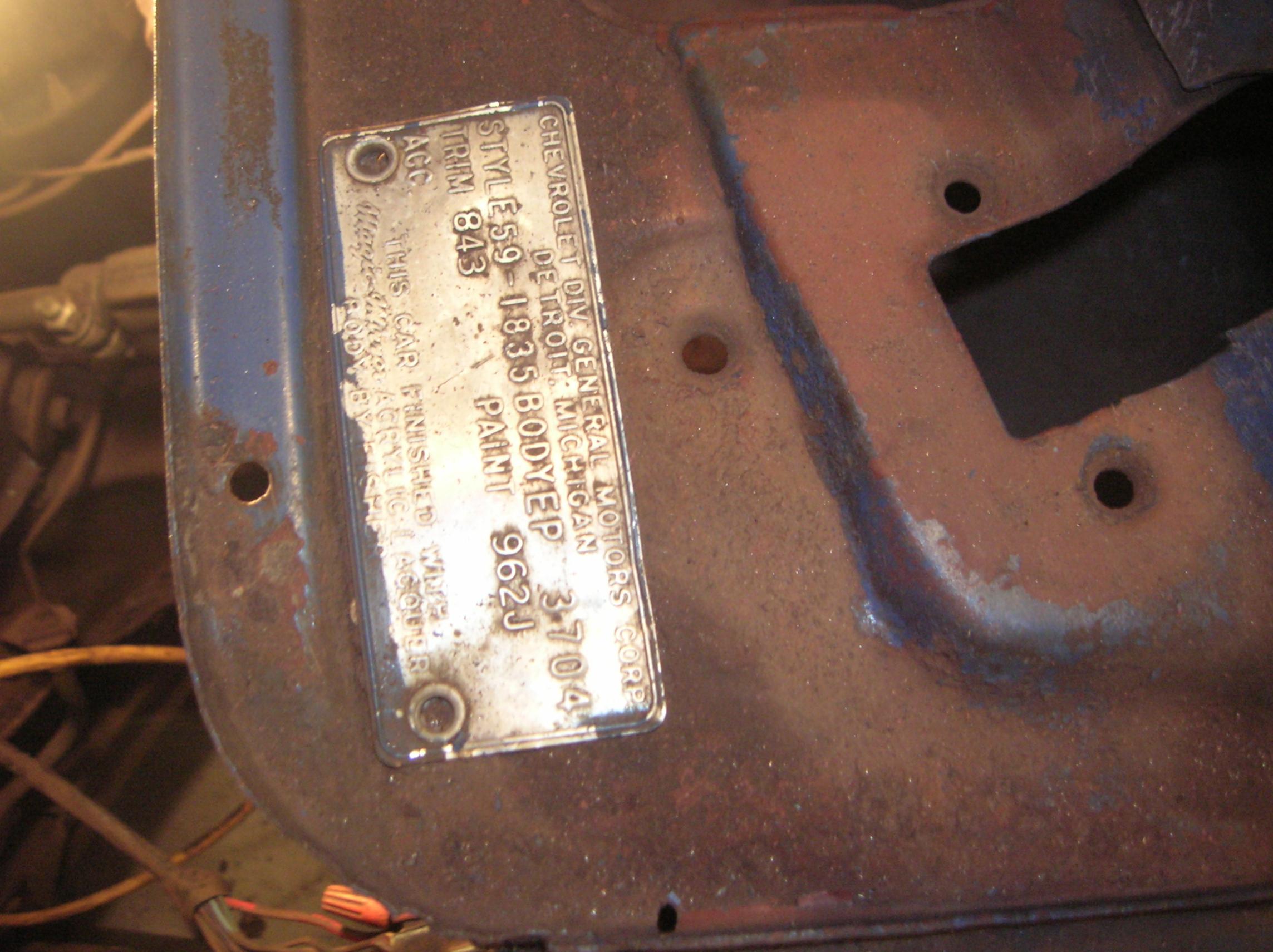

    Finally decided to pull the VIN plate and start removing the bad seam seal and "dum-dum" putty. There is one hole that was filled in with putty below the lower drivers windshield that is ~1/2" deep. The area under the VIN plate was a real mess, glad it is finally off, spent way to much time considering it.

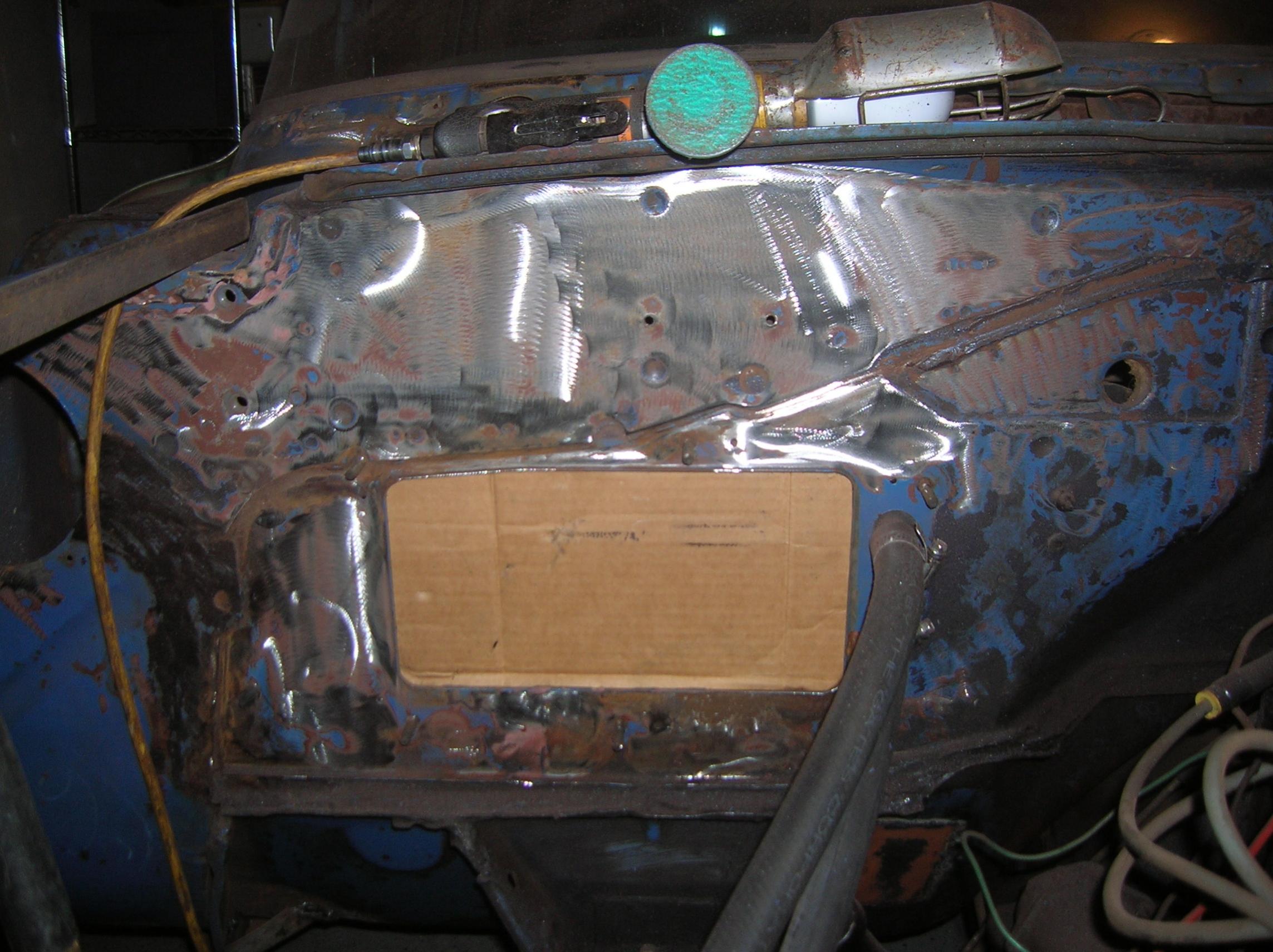

    After a lack of decisiveness i decided i need to prep the firewall too.
    It turns out i had a mini-compost pile at the far end of the box where bits of leaves, dust and who knows what piled up. Removed the nasty paint and repainted, still working on the old seam filler, pink bondo and dumdum.
    as usual, glad i kept after it, but still will have to draw the line somewhere.

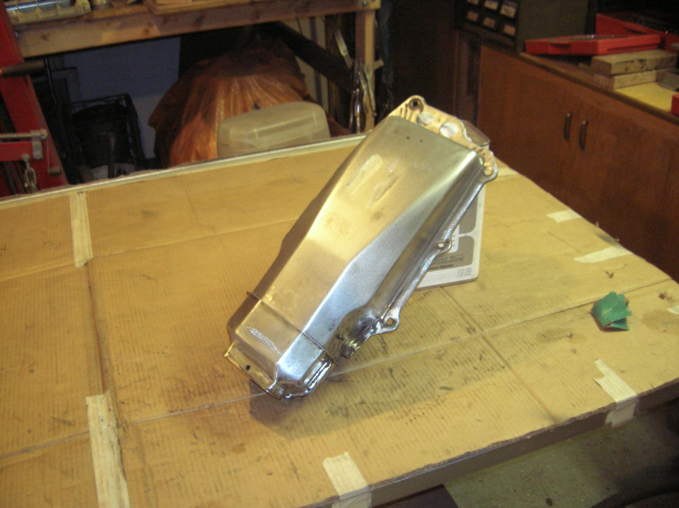

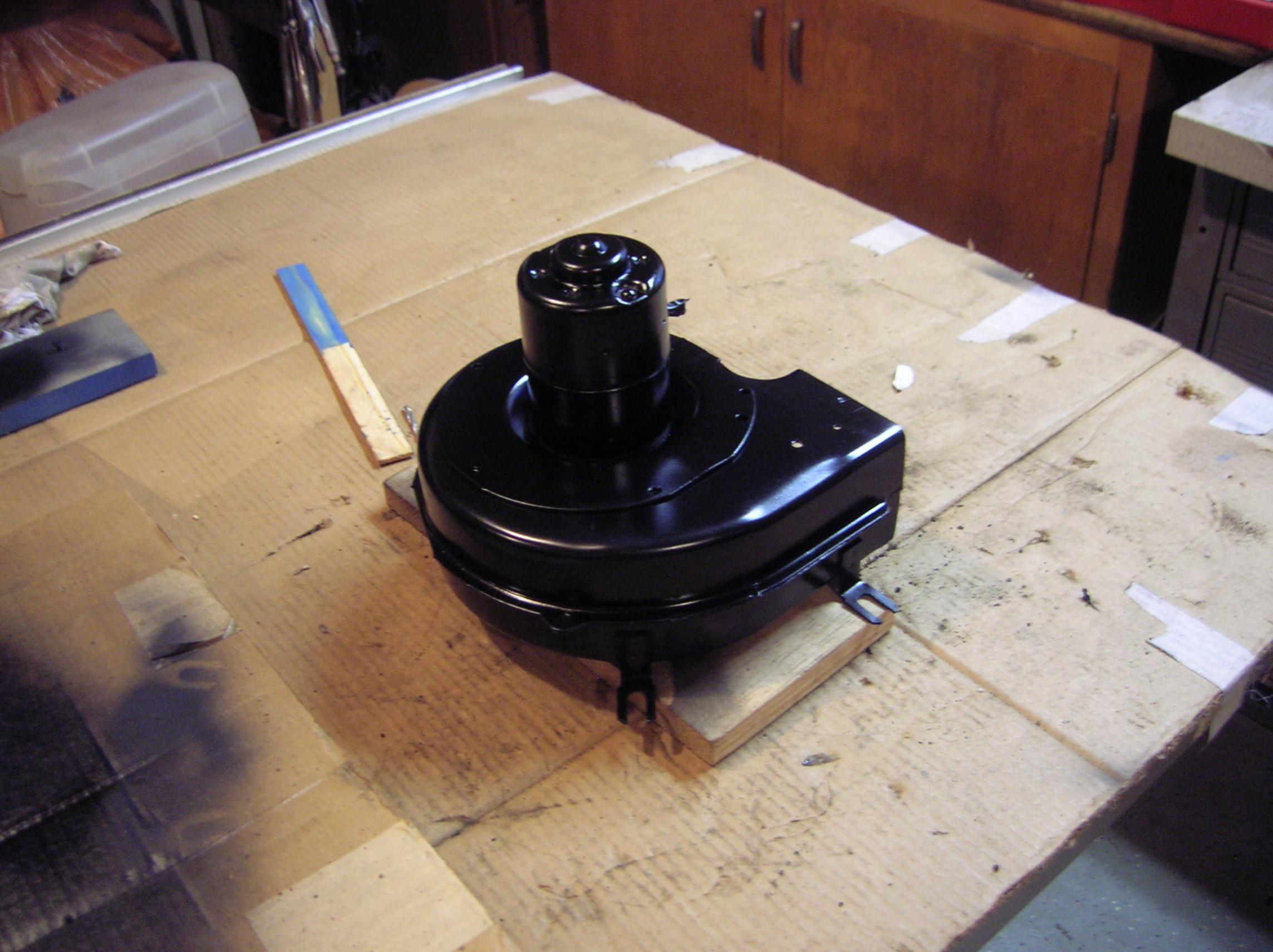

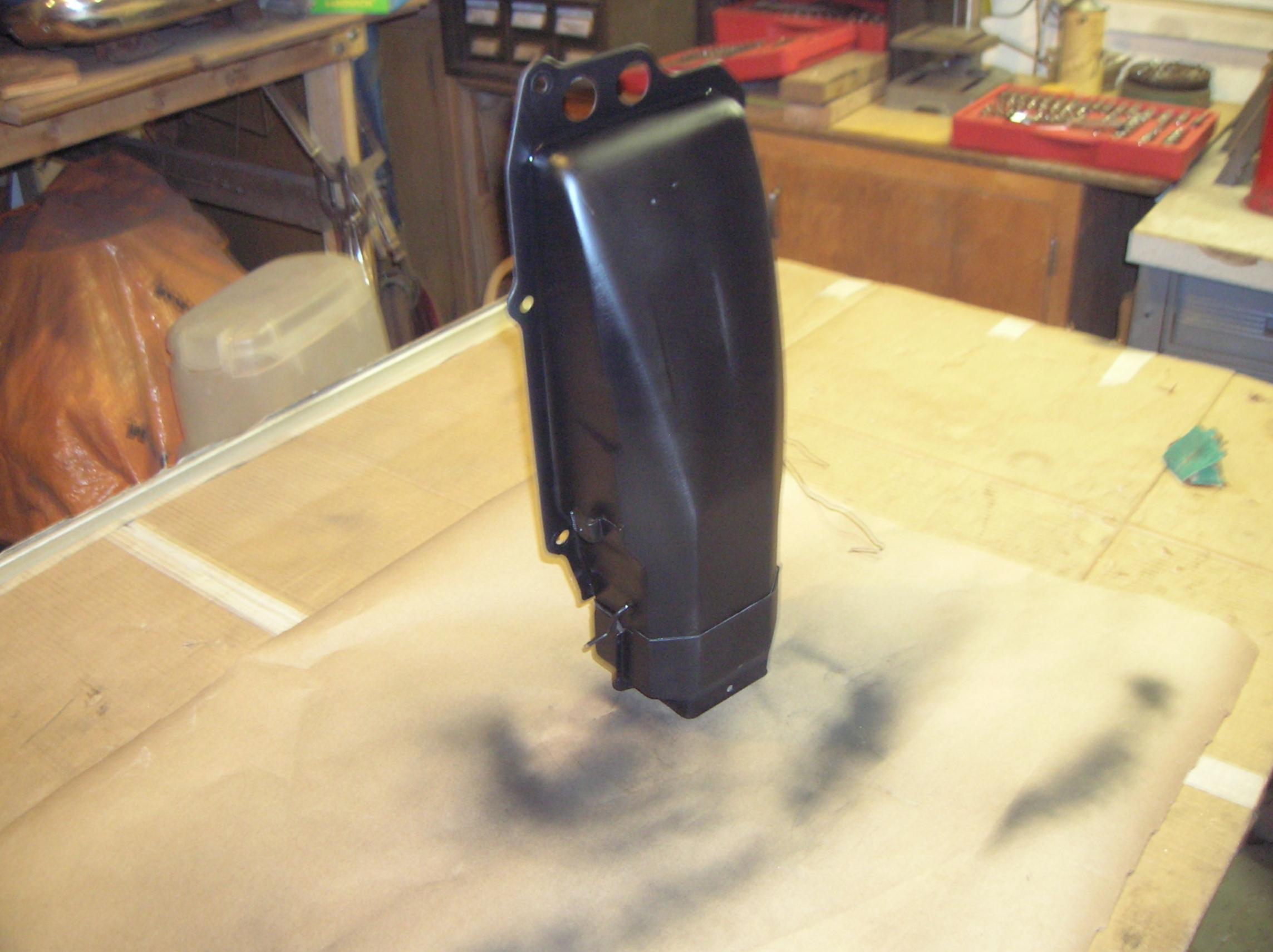

    The fan is not to visible, but i like the after picture a lot better the the before. now i need to get back on the body so it is primed (before it gets cold).

    when the fan was pulled the out of the box it had been in for close to 2 years, i knew something needed to be done . the good one is actually from the 61 parts car, it was not as bad as the original. and it is nearly the same. Just had to remove the damper and a short adapter, then sand and paint. Love it when parts interchange.

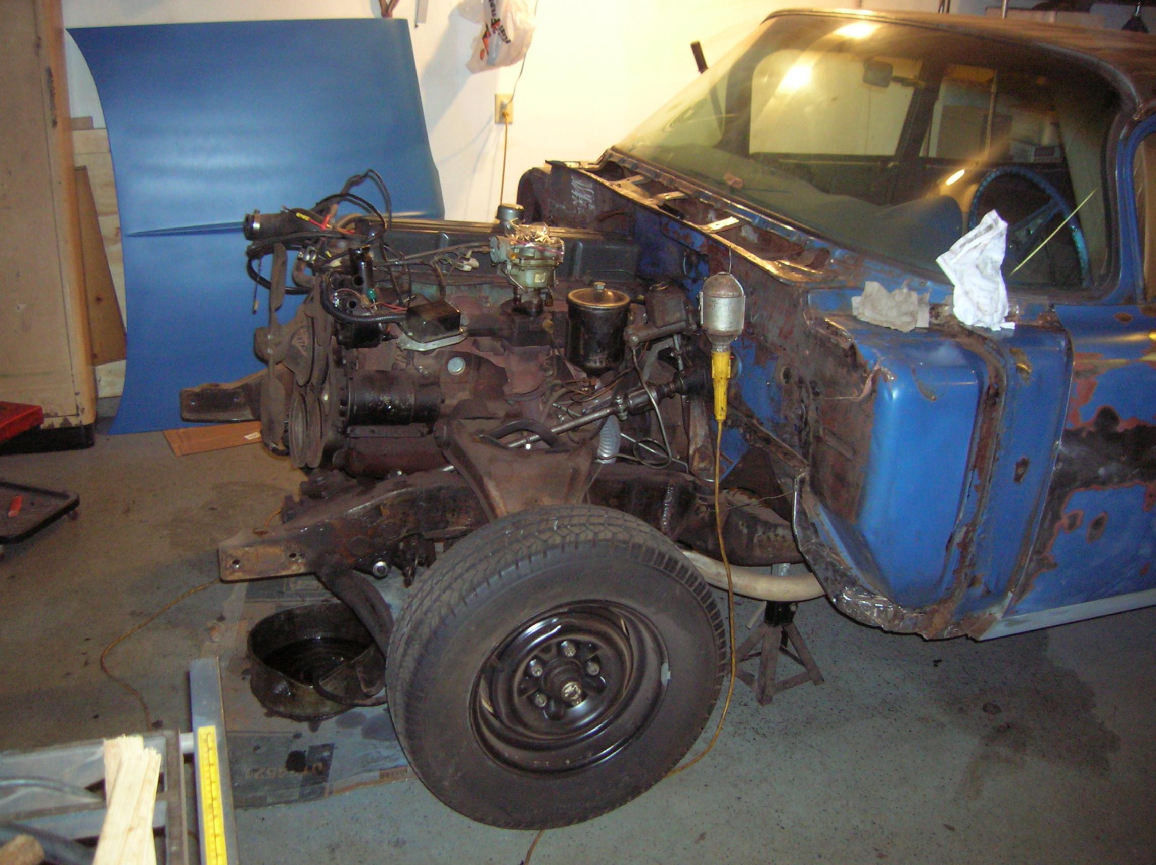

    well the latest is deciding the only way to really do the firewall is to pull the engine and transmission and then that is it.....

    not too much worth taking a picture of since the last post. welded up some holes on the flat area above the firewall and hammered out a small dent that had went unnoticed before.
    reconsidering pulling the engine. After removing everything else from the firewall it is getting cleaned up pretty good.

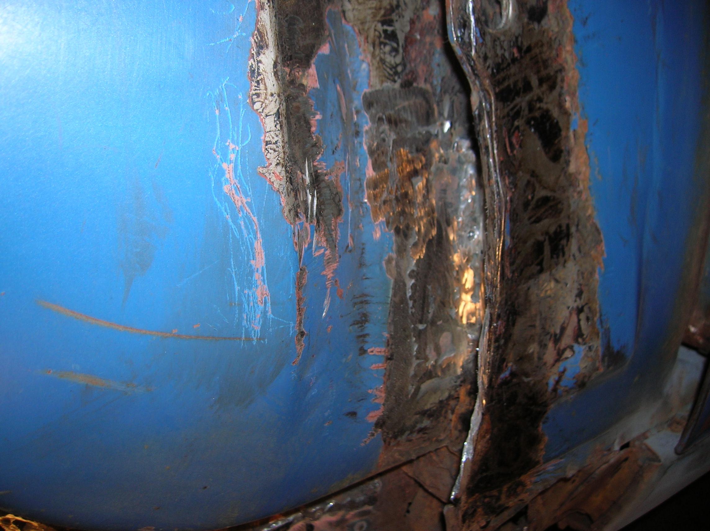

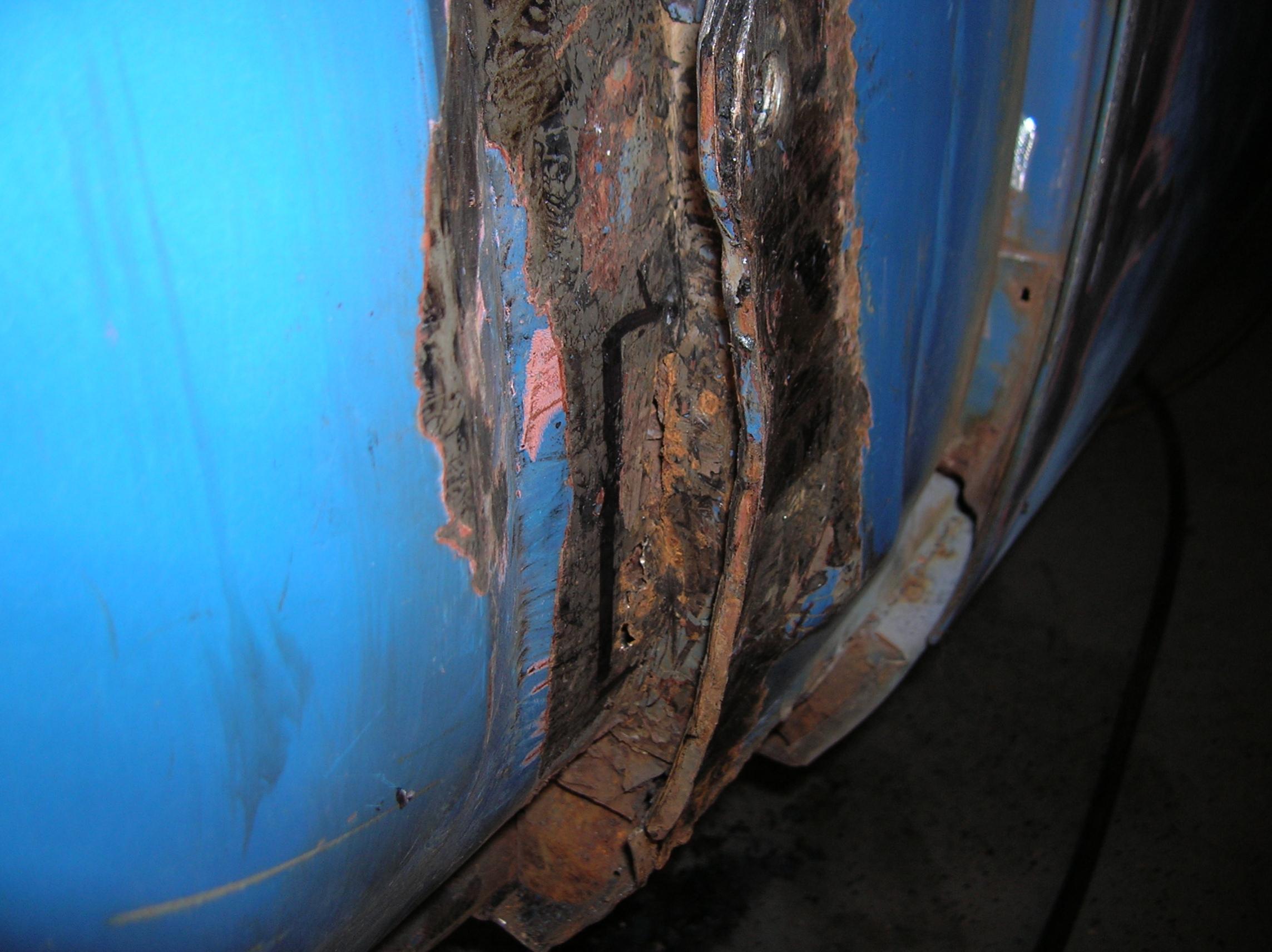

    made some more little progress, found a few more holes under the seam sealer. decided new metal was the way to go, even though it will not show and will be covered with seam seal again. filled in a smaller one on the firewall too. s****ed off the rest of the sealant.

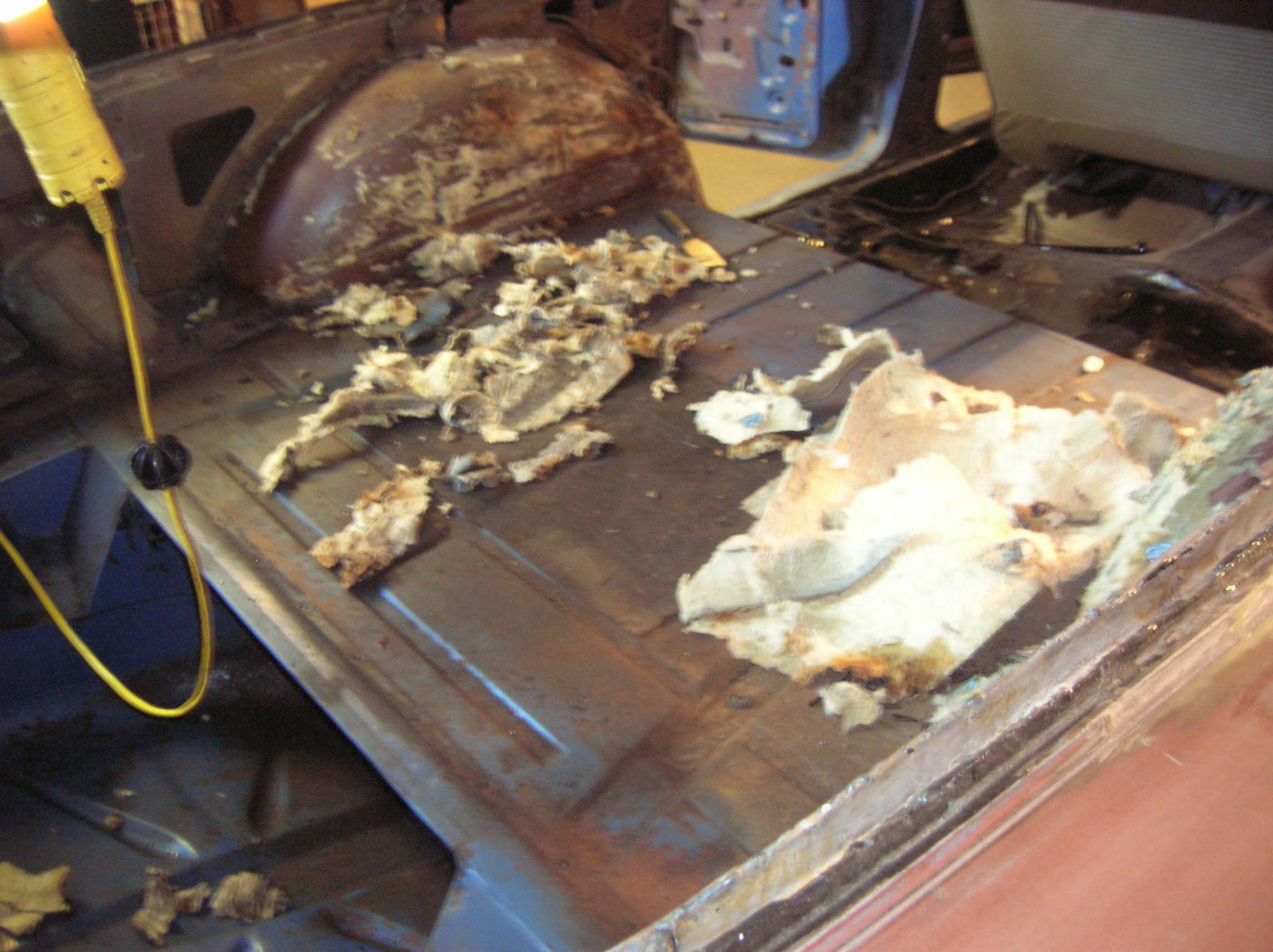

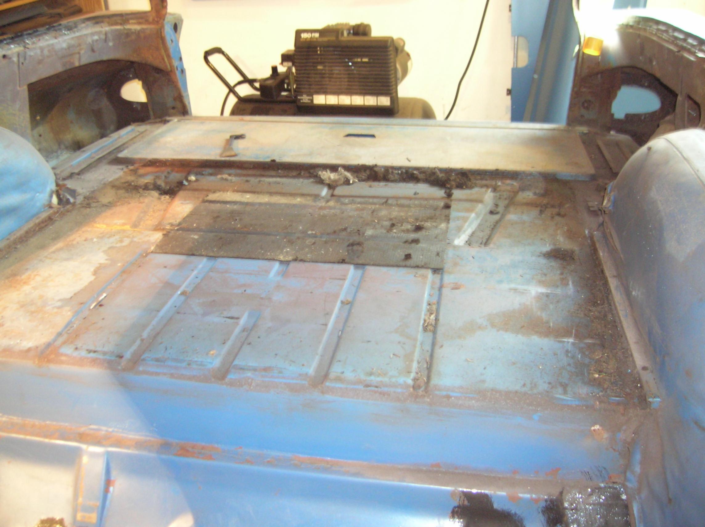

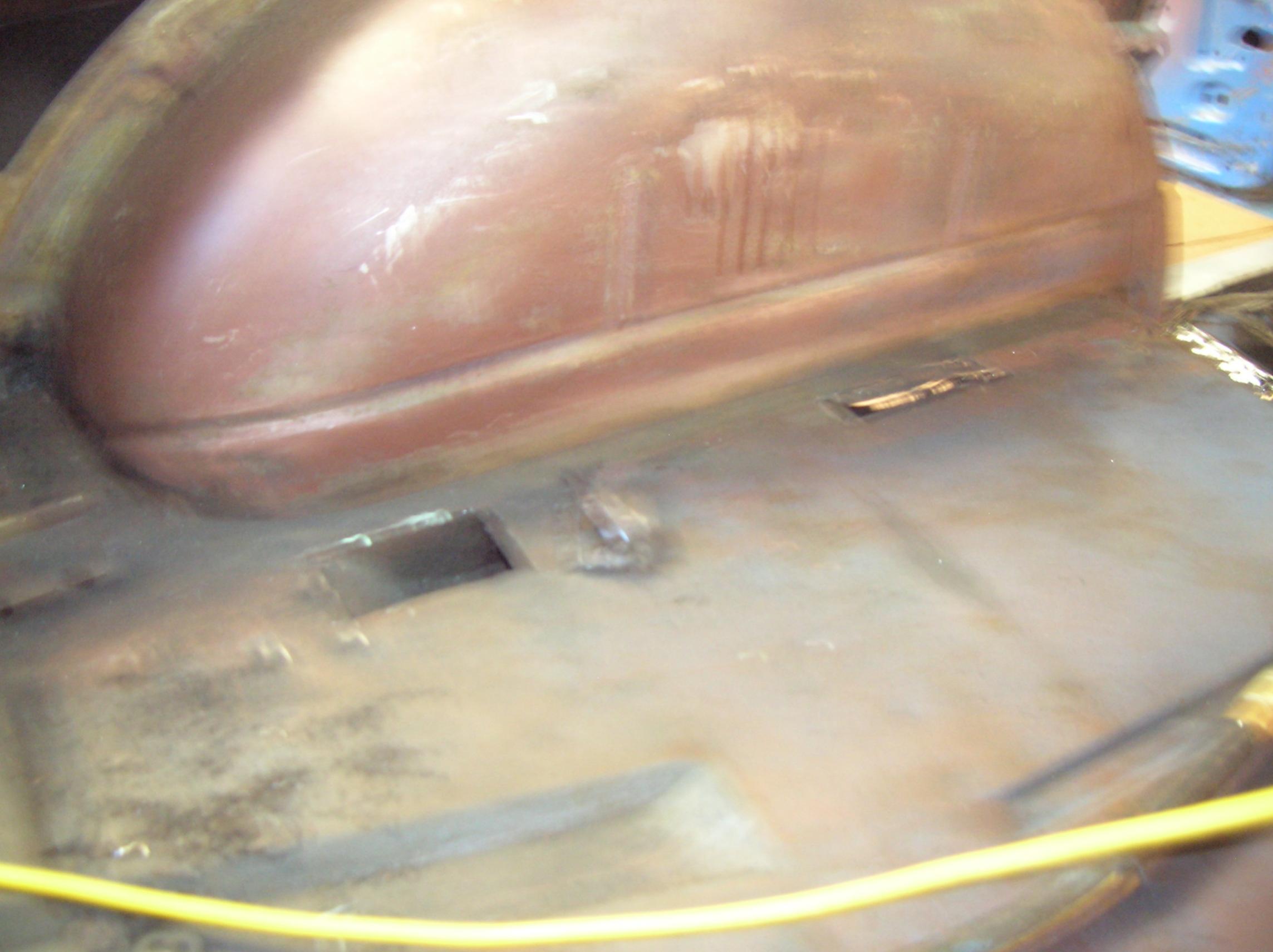

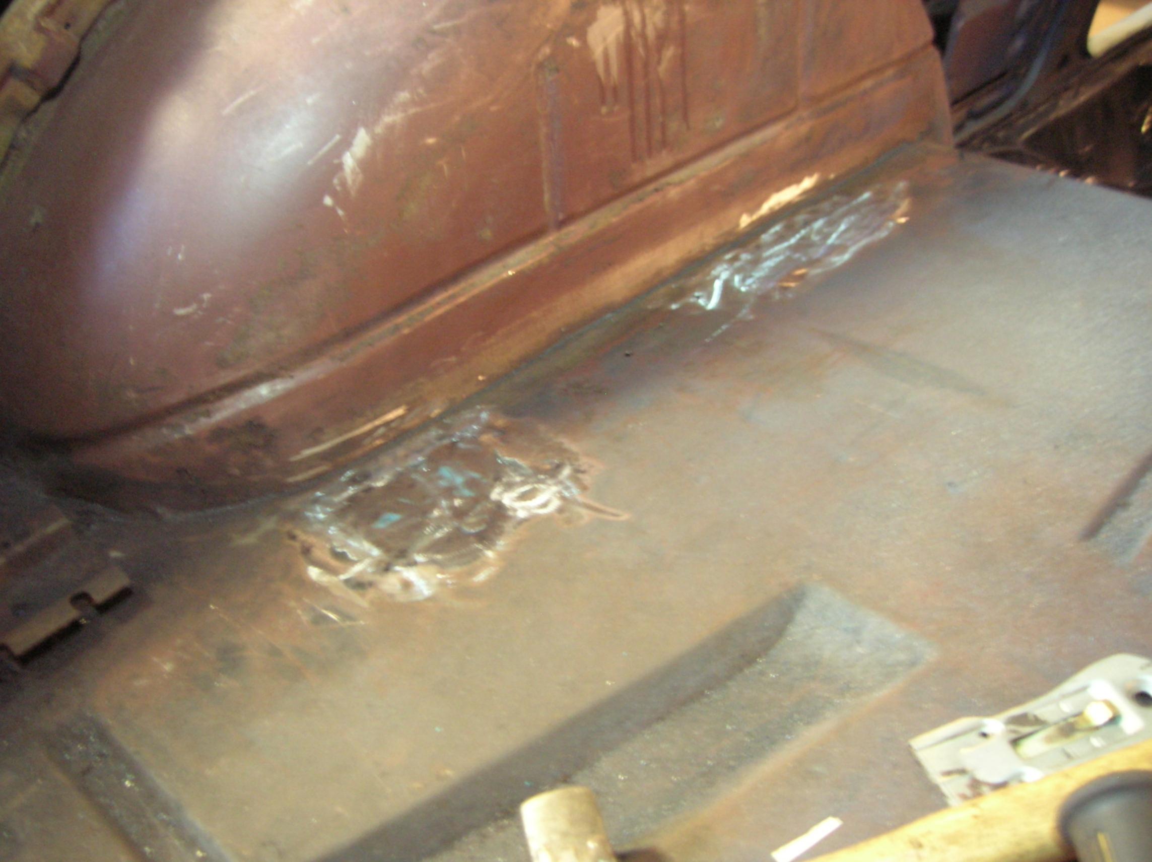

    Got a few hours to do one of the things i have been thinking about;
    Tear into the rear floor and wheel housing covers?
    Answer was yes, and good thing as more crud and rust outs were uncovered.
    Plan will be to prime it all with the outside and figure out how to redo the padding under the wheel housing covers later.

    This is pretty! What type of paint did You use on the blower motor?
  28. Bruce A Lyke
    Joined: Jun 21, 2009
    Posts: 2,587
    Bruce A Lyke
    Hi Sauli, the paint is "PlastiKote Lacqure, T-3 Hot Rod Black" (semigloss) i tried some other black first and it scratched off really easy. this seems to be quite hard

    Well tonight the phosphoric acid, in the form of "Metal-Ready", was used on the rear inside floor, figuring the parts can be easily removed later if for some reason it turns out bad.
    Got a lot done last weekend when the cold weather caused for a change in plans on a fishing trip with my son who was in town from Alaska. He suggested we spend the day working on the car, yep, he's a good son.
