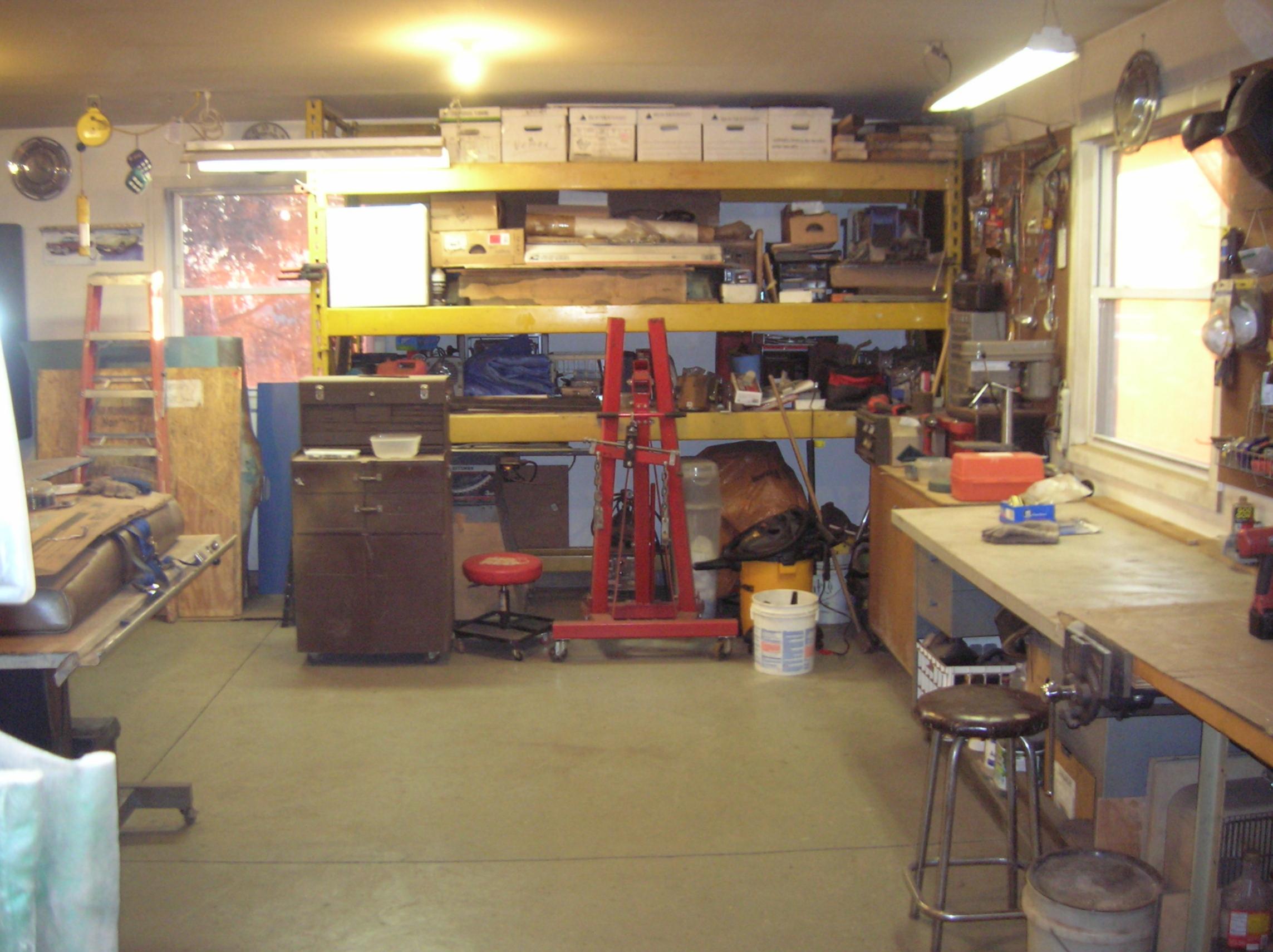

    well i have made some indirect progress since the last update. i was able to get some steel racking cheap and reorganized my shop to add t=some more room to work and to store a car that is in pieces. this will help when i get to priming the whole car, since it will be cold outside.

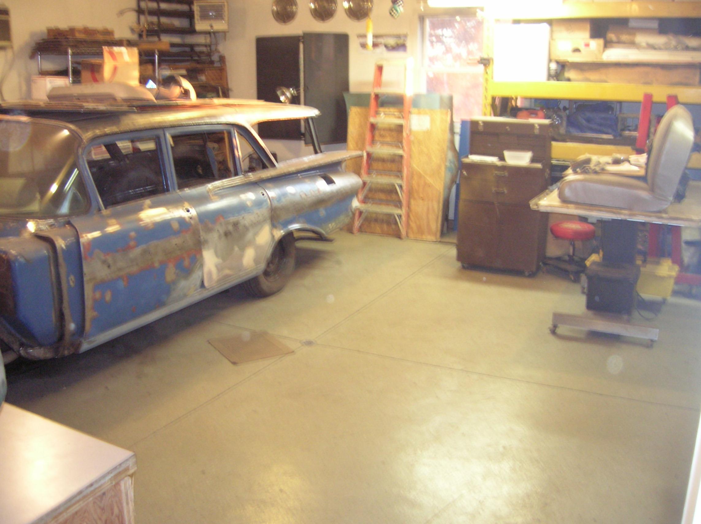

    Now that the shop is rearranged, its back to body prep. Rounded up all of the remaining parts that will need to be painted. Maybe i will get enough done this weekend to make for a photo update.

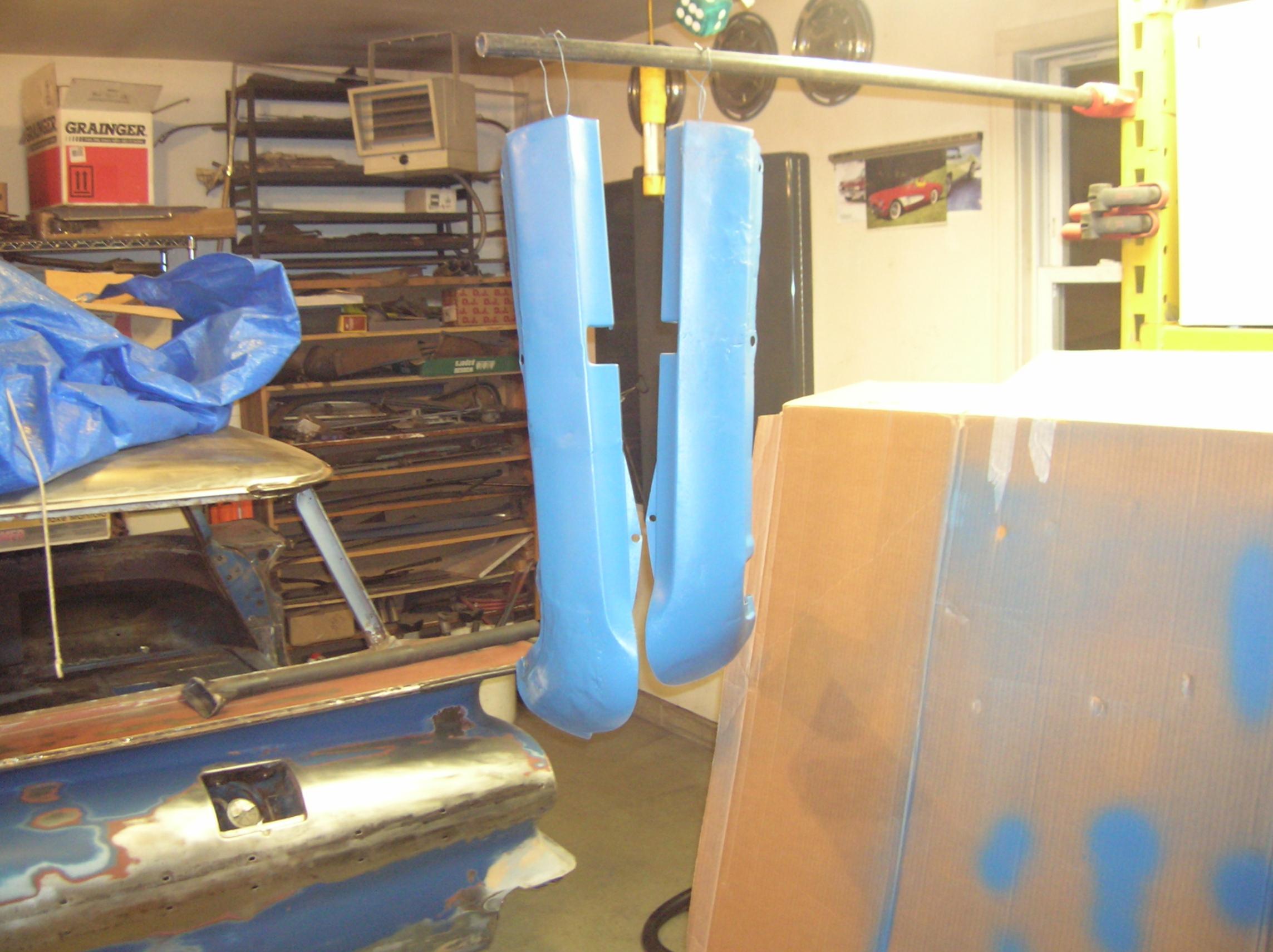

    Still getting ready to prime the car.

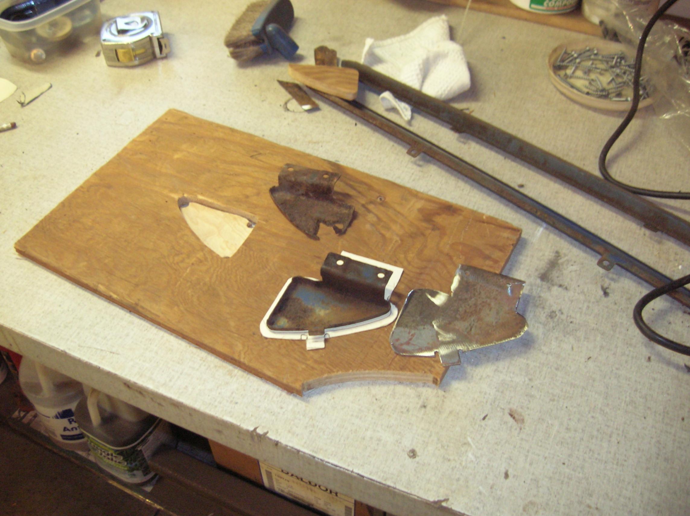

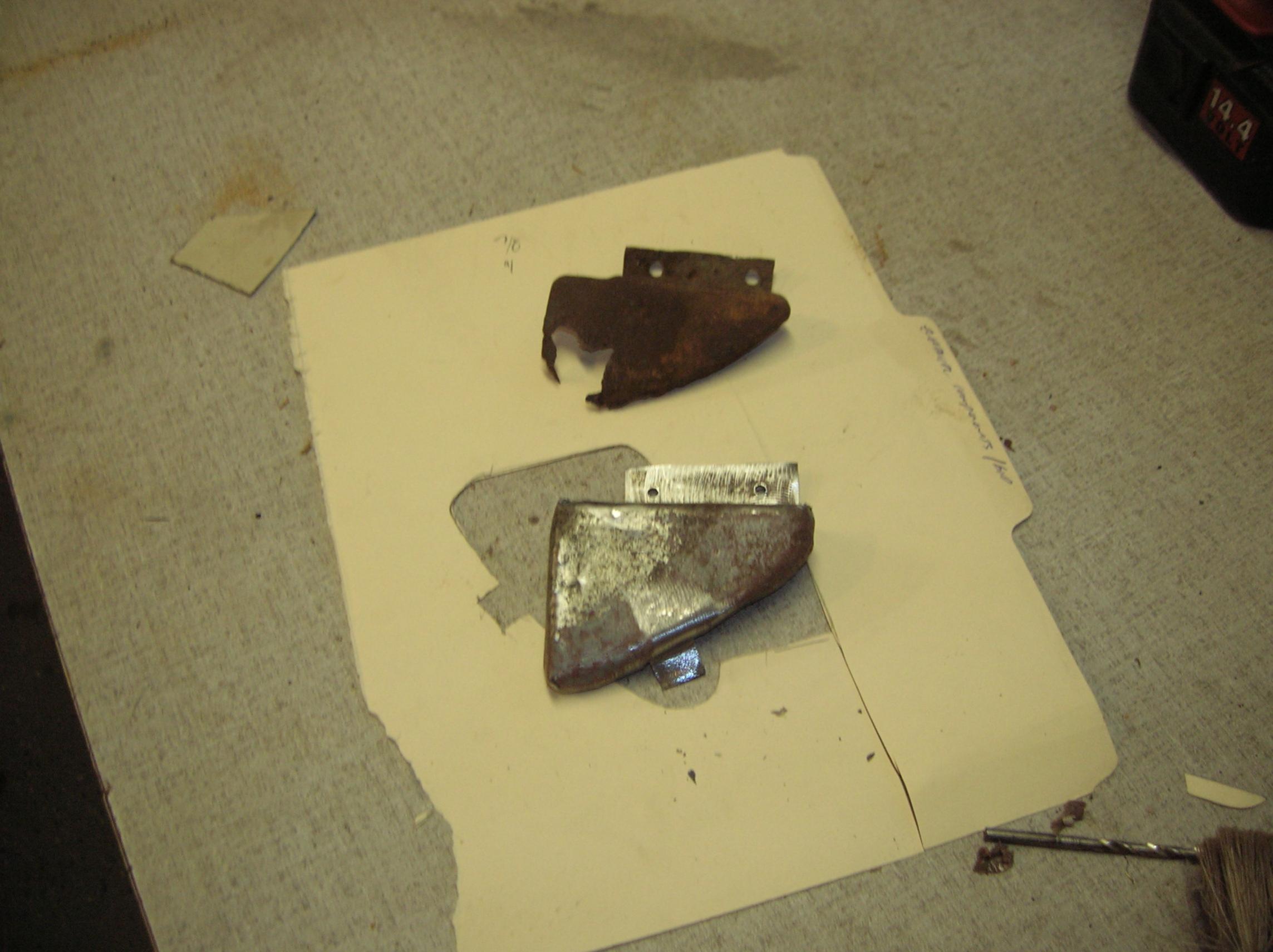

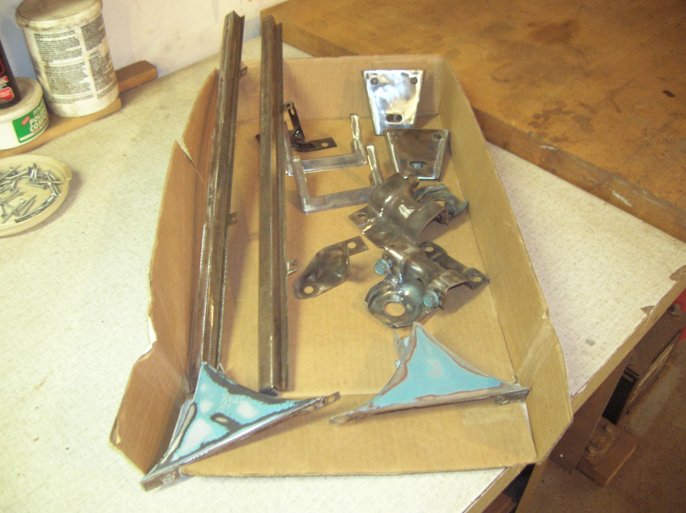

    Here are some small parts that were cleaned up, also a attempt to make a new one that did not quite work out. too tight of corners (Carl, this is one of the parts I need)
    Plan is to try and do it over the long Thanksgiving weekend, odds are still positive at this point.
  19. "Quote:a attempt to make a new one that did not quite work out. too tight of corners".
    More heat. If you can find someone with a shrinker it may help with the long radius too.

    Posts: 2,587
    Bruce A Lyke
    You are right that the heat and shrinker would help.
    Part of my build plan is to try things like this, most have worked out fairly well. When i get to the point were that little interior trim piece is what is left to do, i will be on easy street.

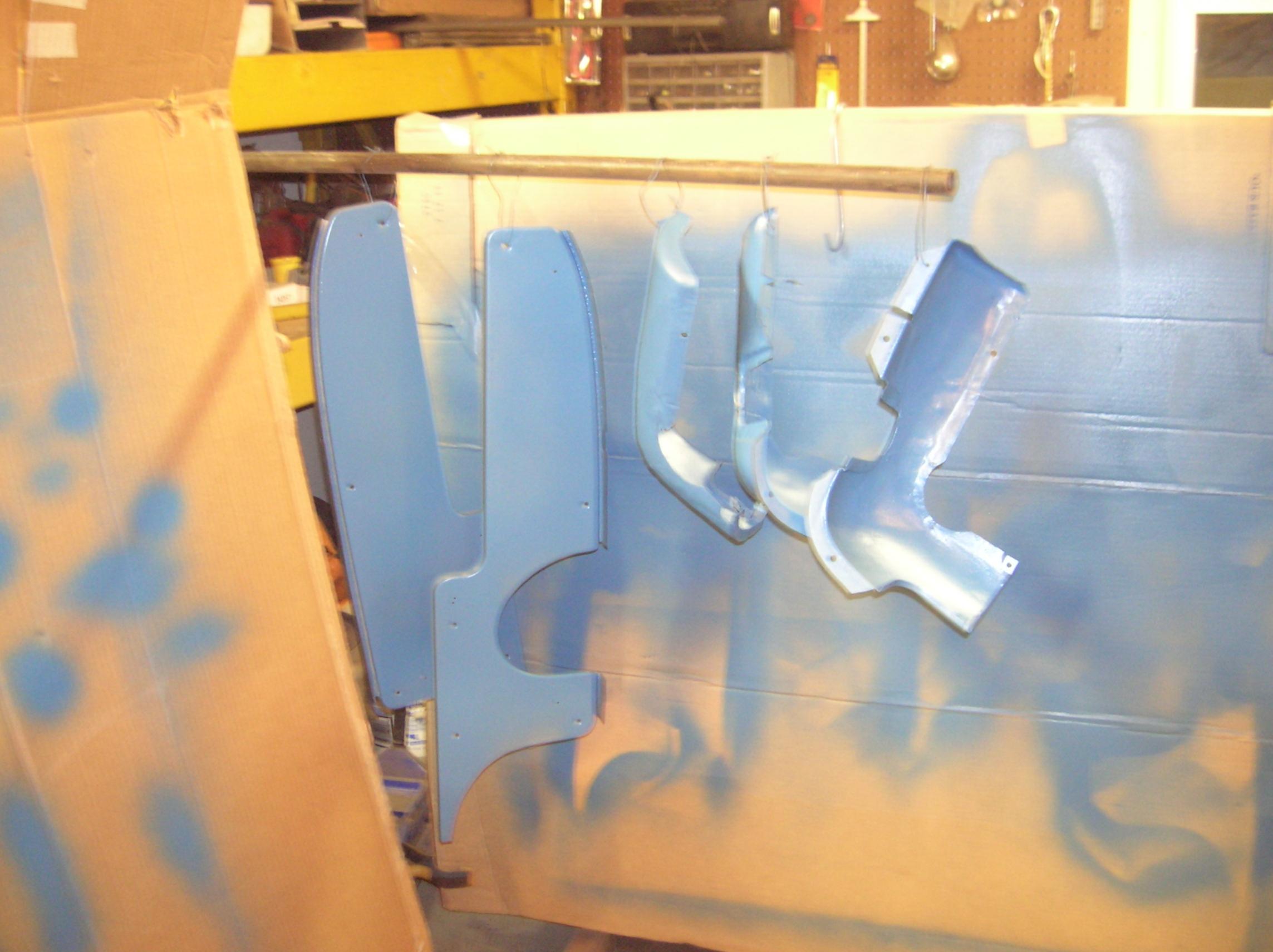

    Have a friend who sold me parts before that may have one.

    I experimented with getting the gun setup better with a little DP60 primer i still had left. Was able to get a better pattern by using the 1.4m tip (funny the paint manufacture recommends it too) than the one that is supposed to be for primer.
    I am a lot more hopeful that it will turn out good now. Hope to be posting pictures of the main car all in blue primer by this time next week. It would be great if it stays somewhat warm all week. It was close to 60 today. If not I have a plan that should allow for sufficient ventilation and keeping the car and the air warm.

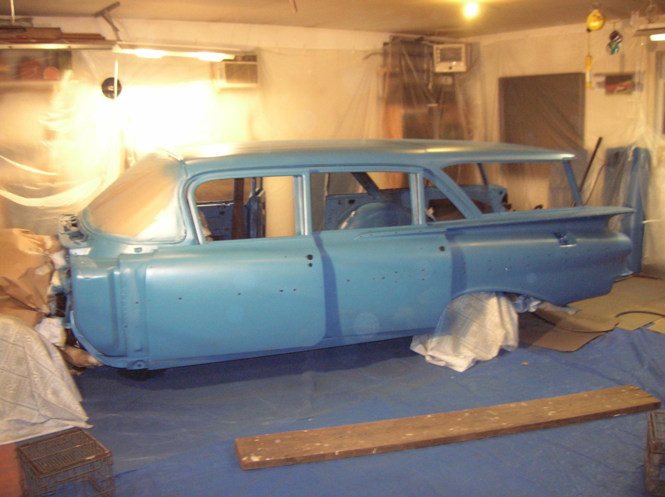

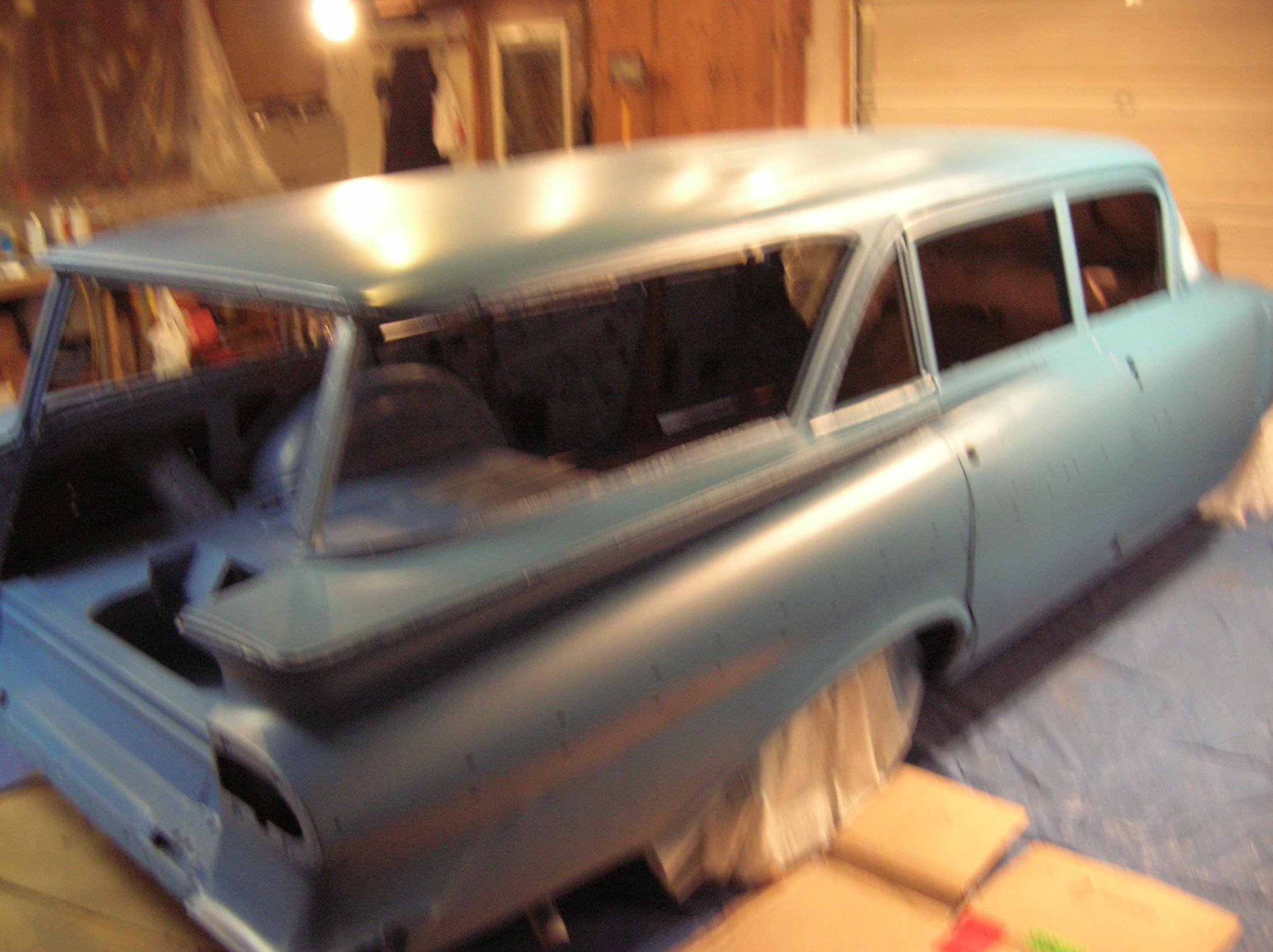

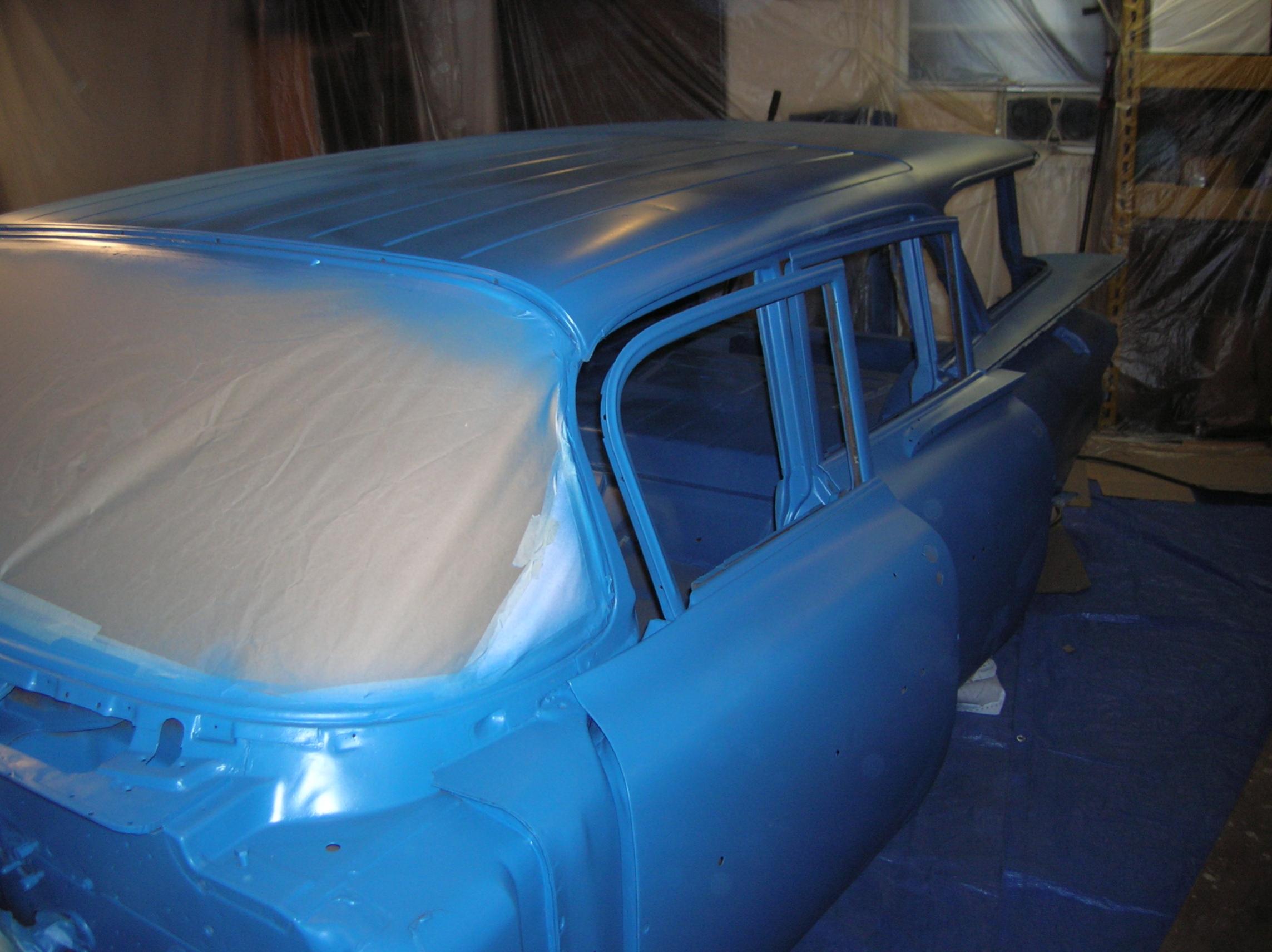

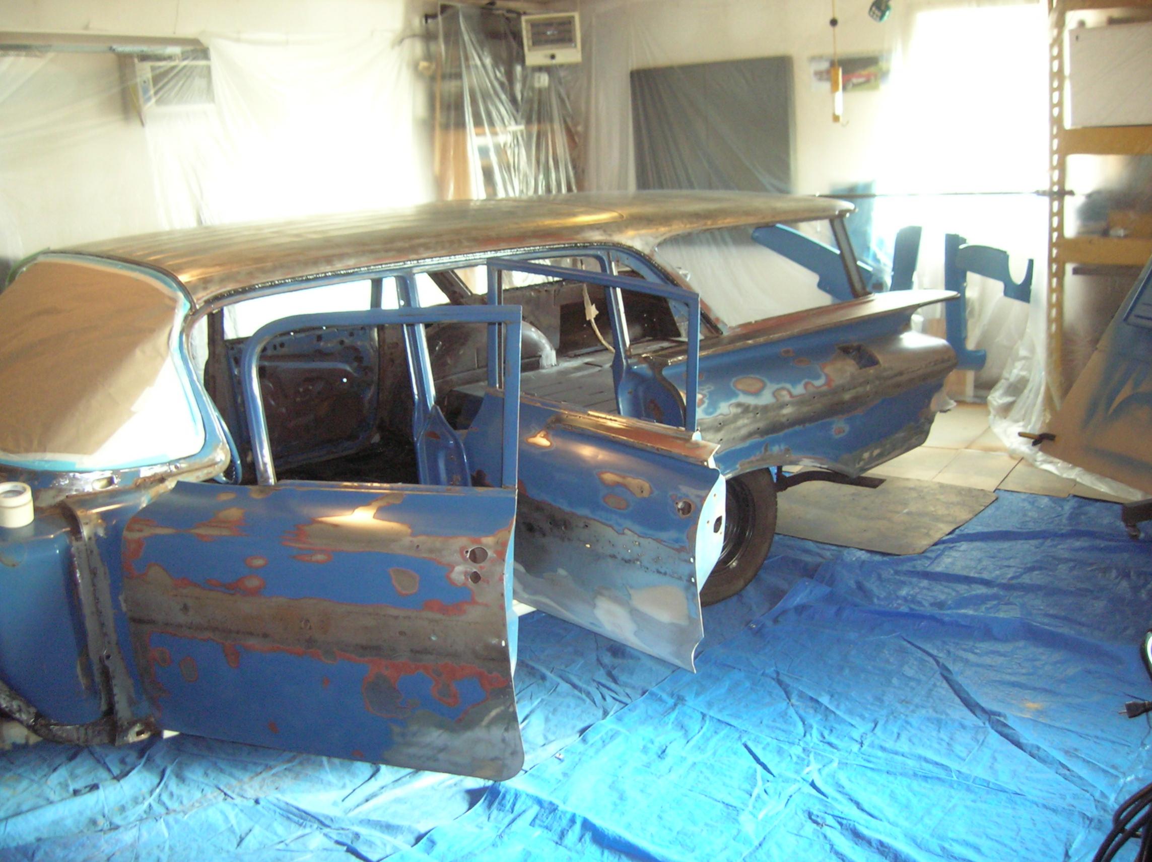

    This long weekend, starting on the 21st, has been primer time.
    The car is looking a lot better with one color. Not sure if this is the beginning of the end or just the end of the beginning. Just glad to his this point in the build.
