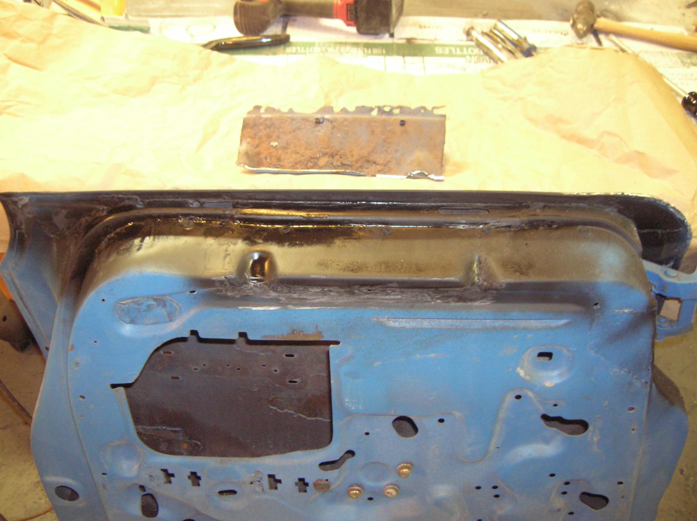

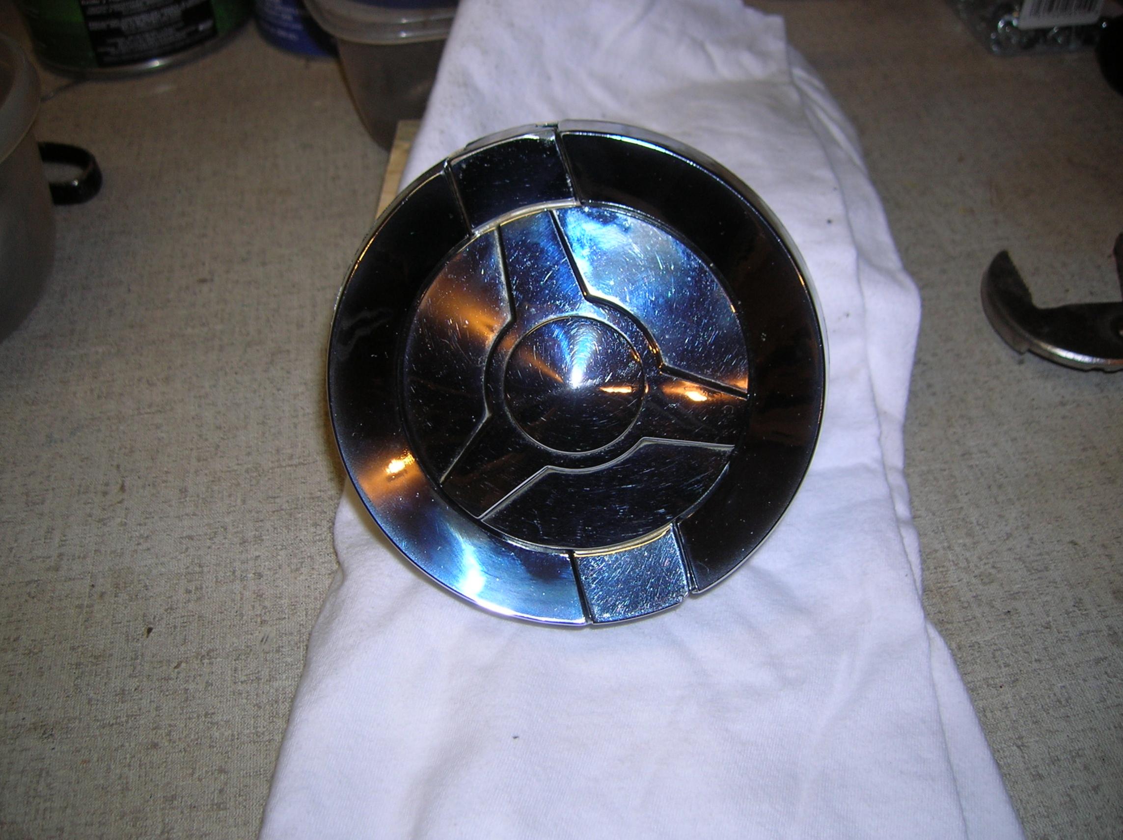

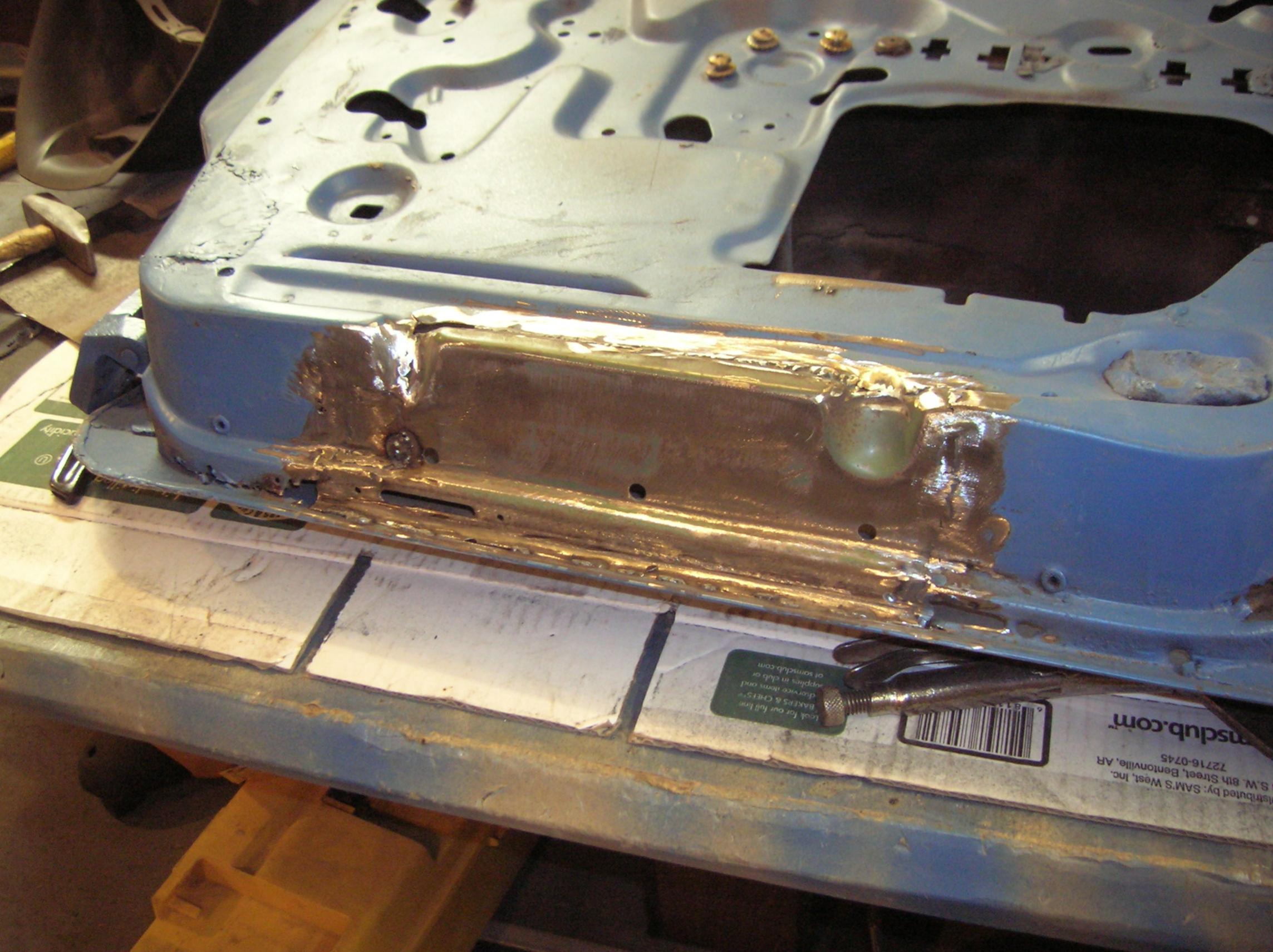

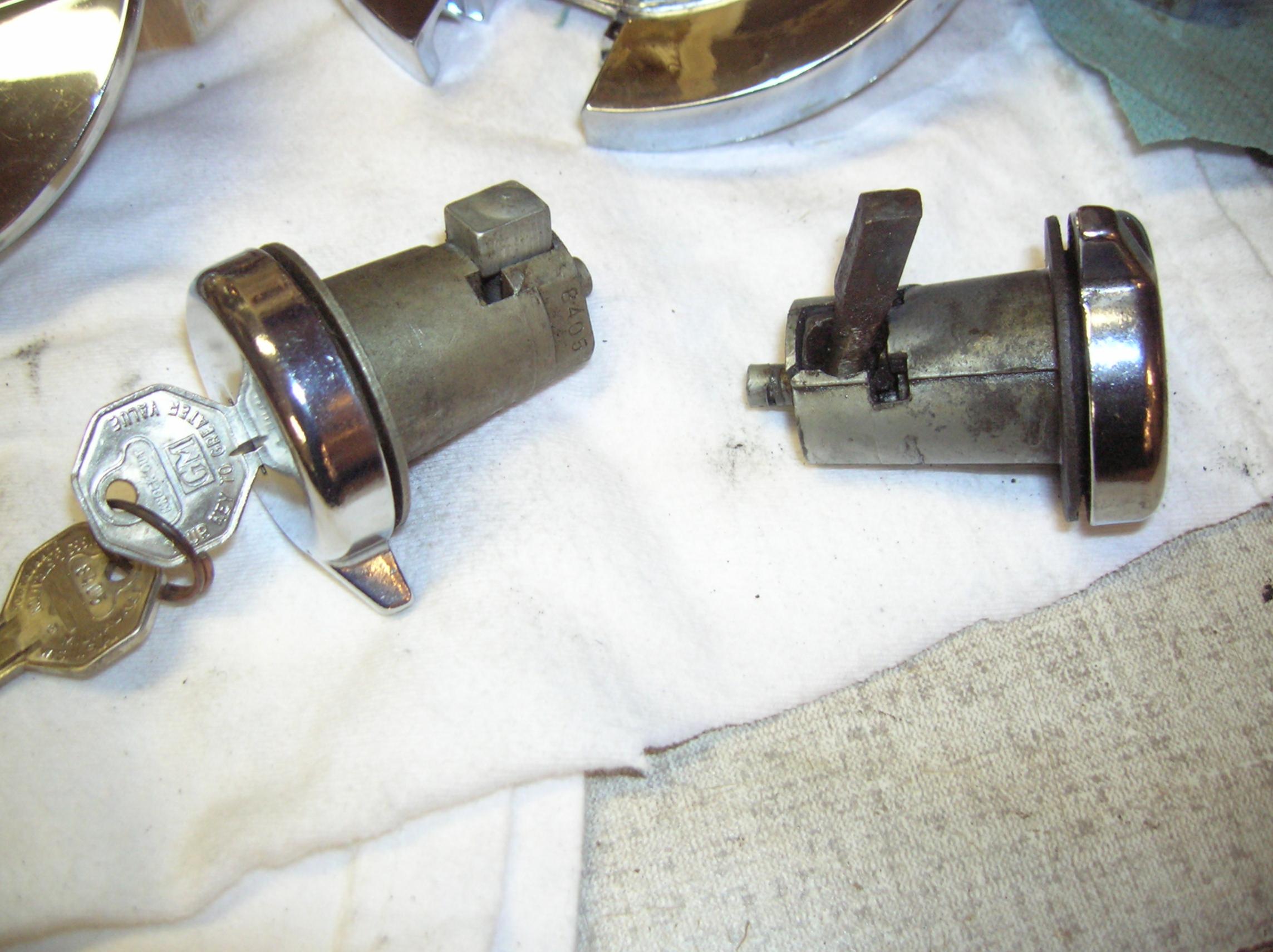

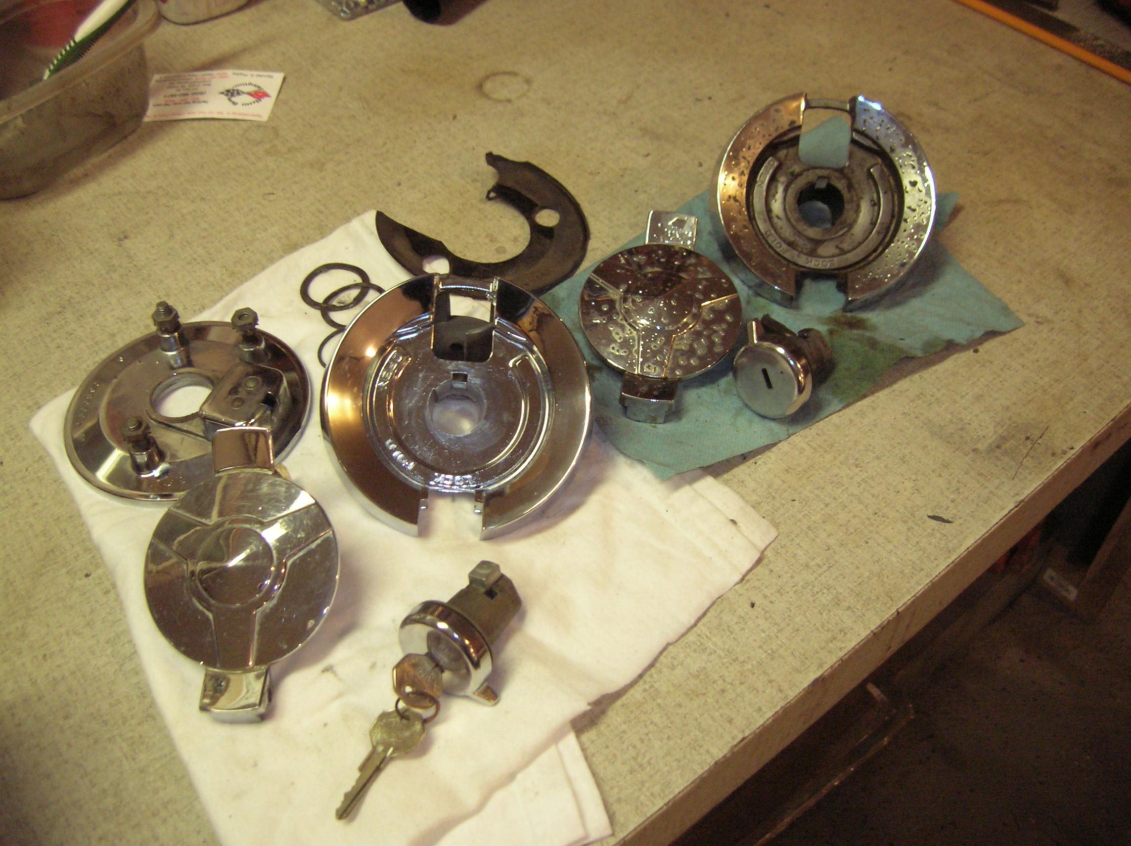

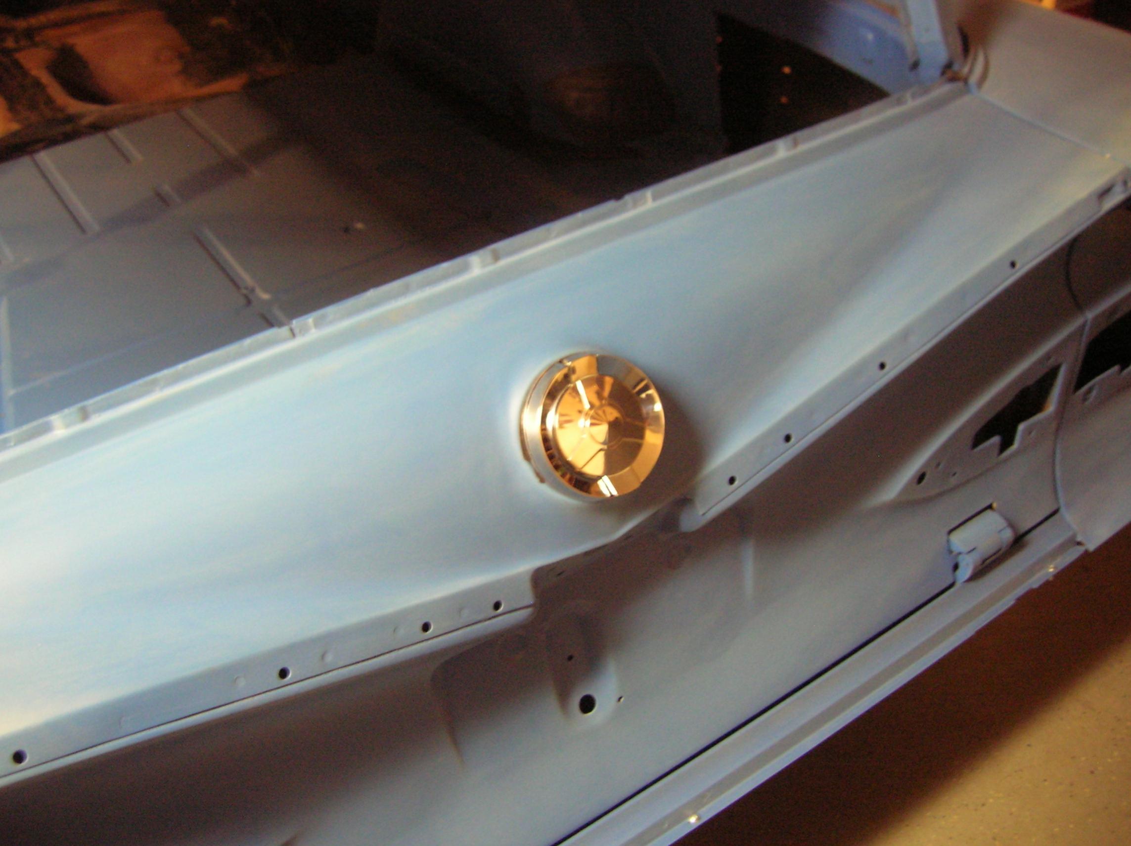

    Decided it was time to do something that did not involve sanding or filler.
    Have been picking up the parts to make up a nearly new rear crank and lock ***embly.
    Since the old one was not quite factory, it took a little to see how it should have been

    Great progress 1959 nomad, she is looking nice and solid now. I'm sure it is a challenge in MN to have anything rust free. Your rear gate crank/lock looks great! The blue epoxy looks great on there.

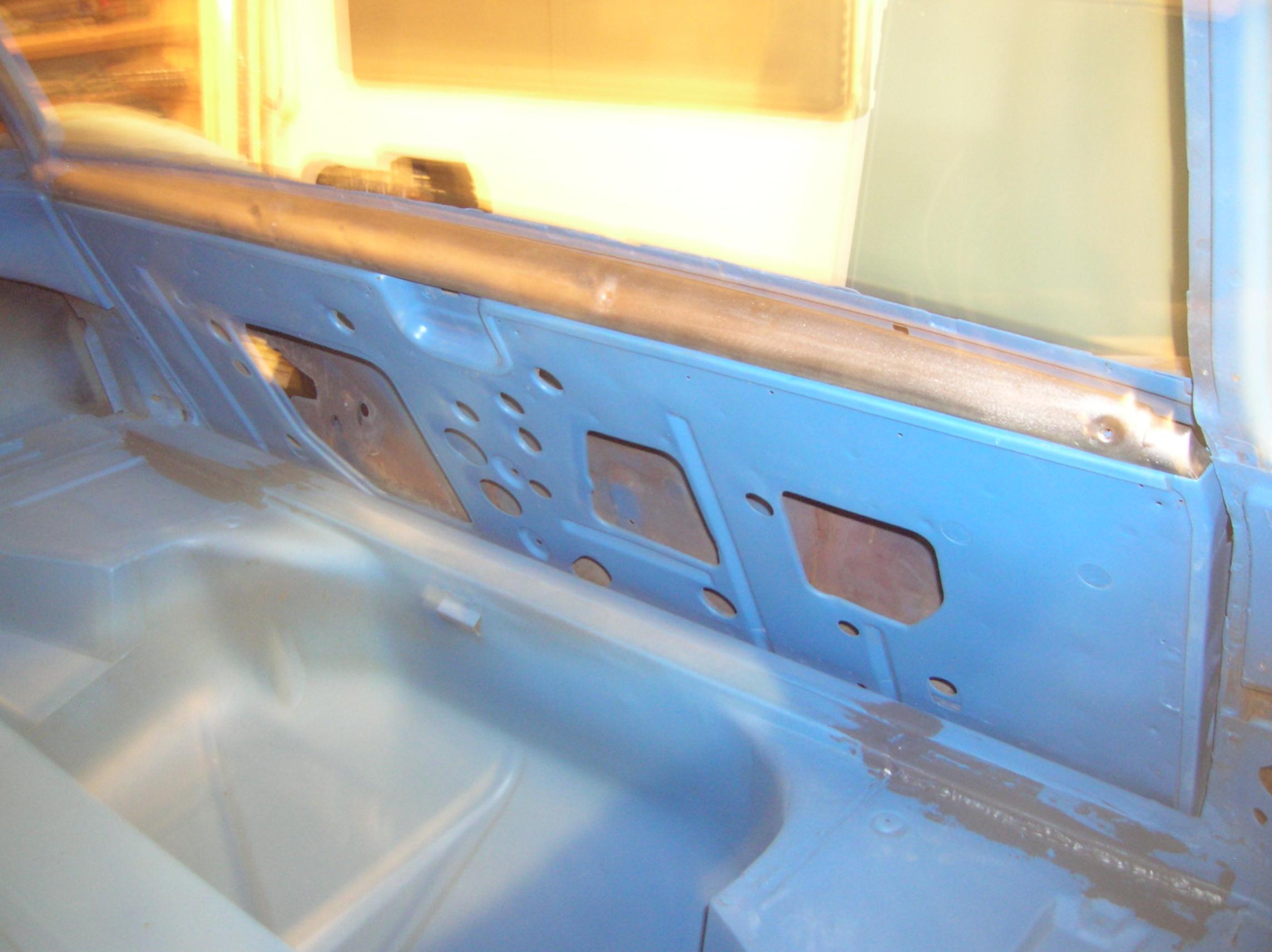

    one step forward two steps back?

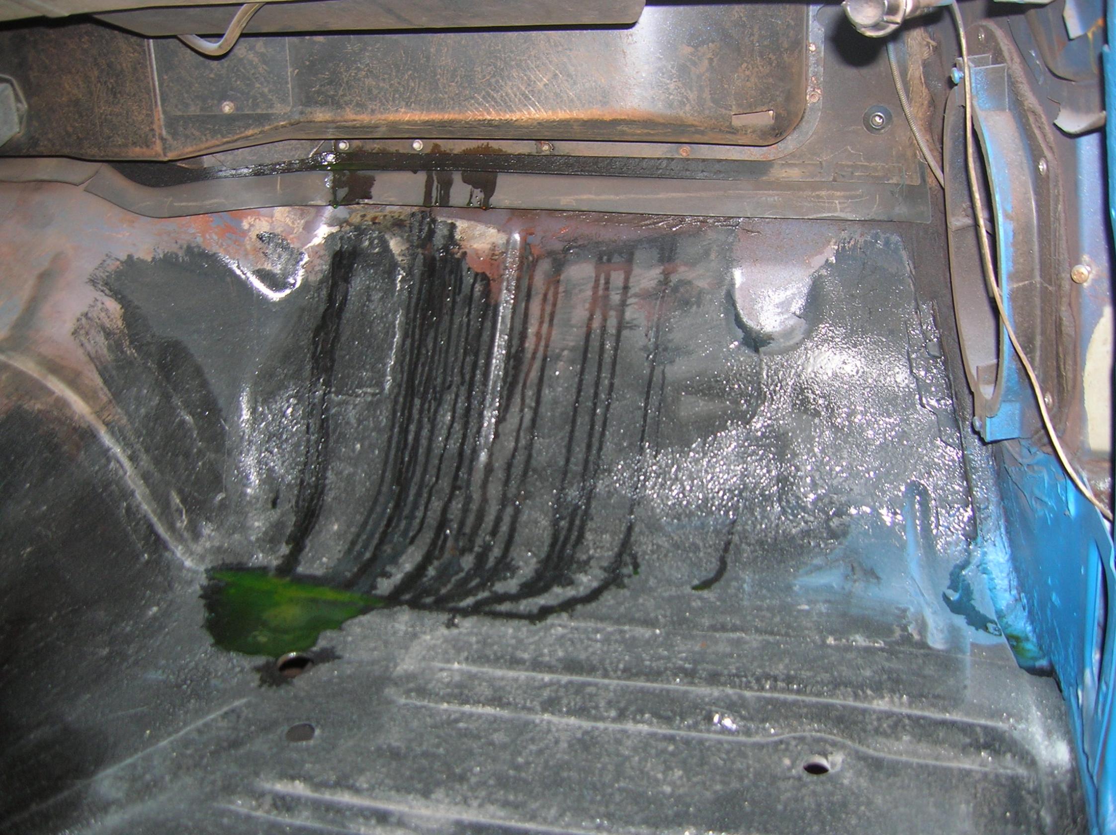

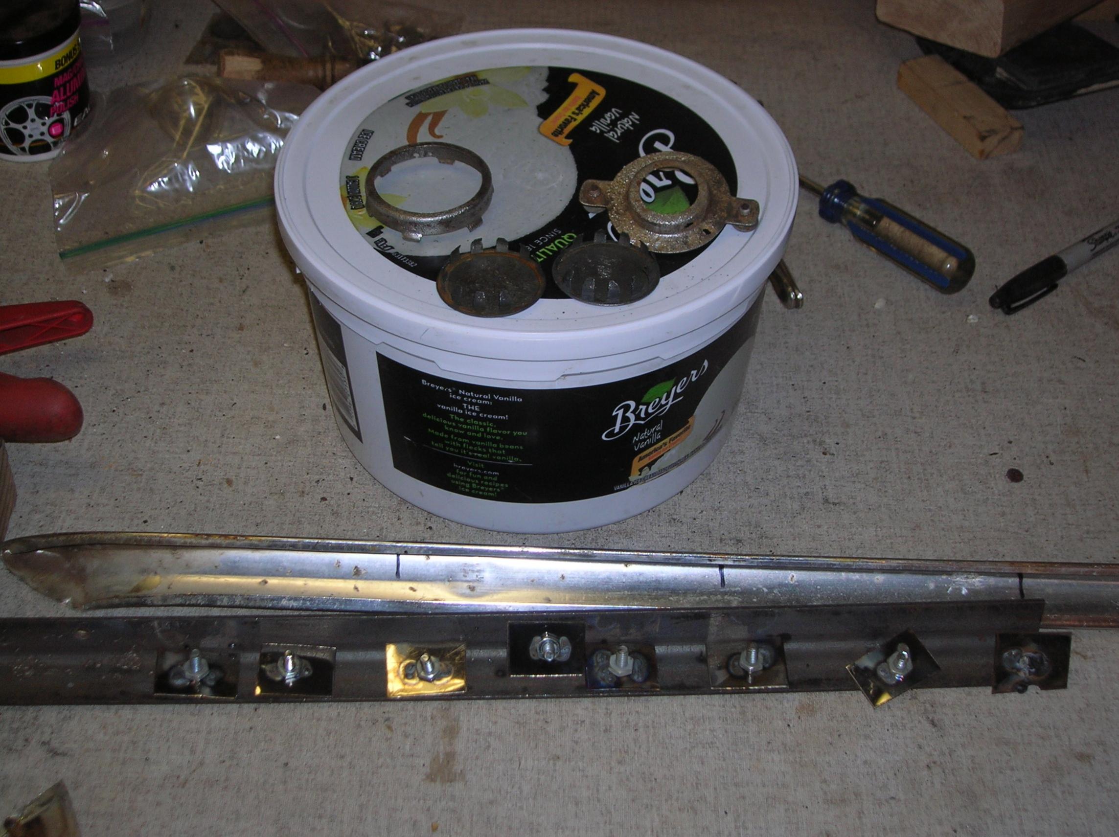

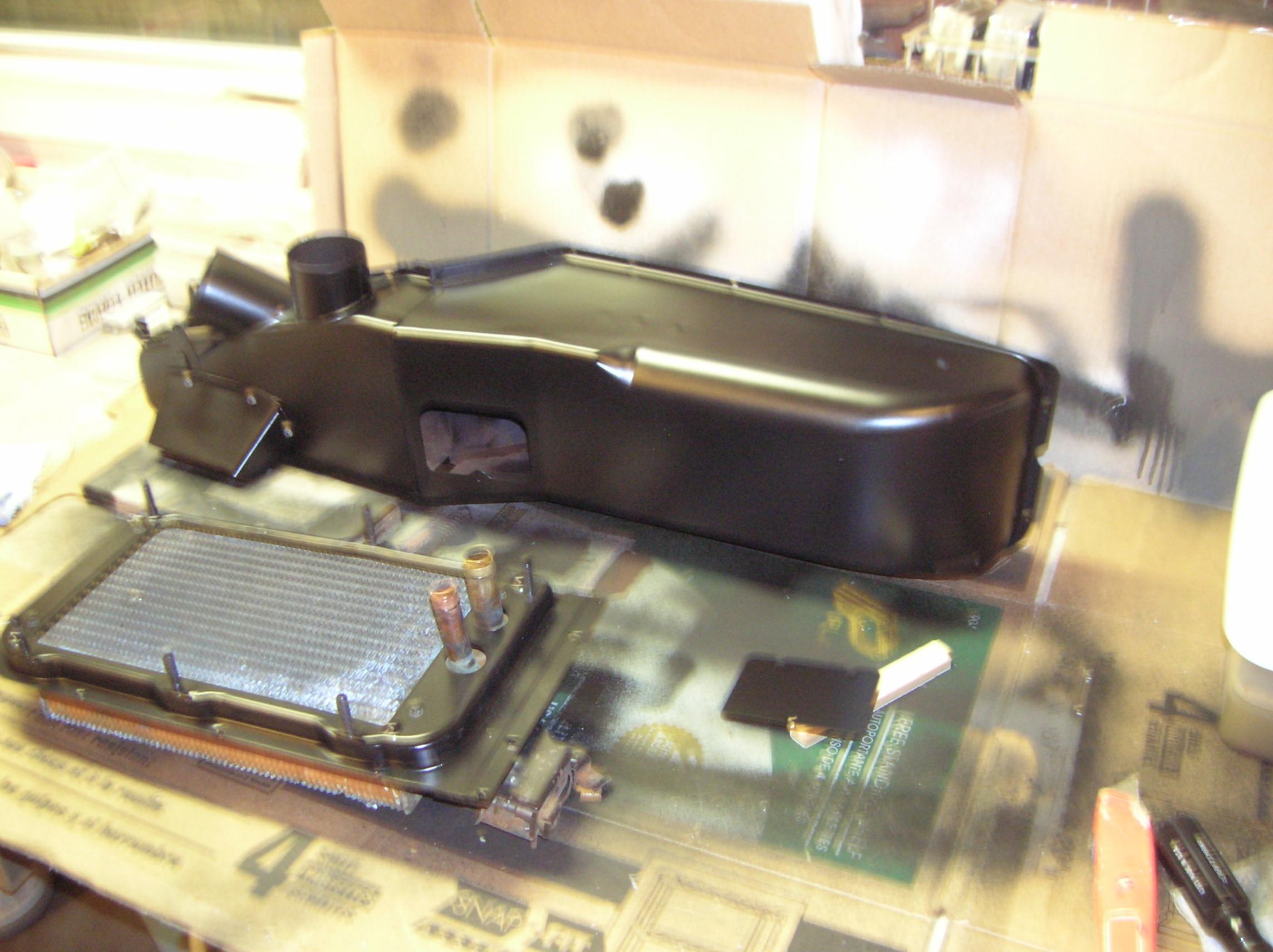

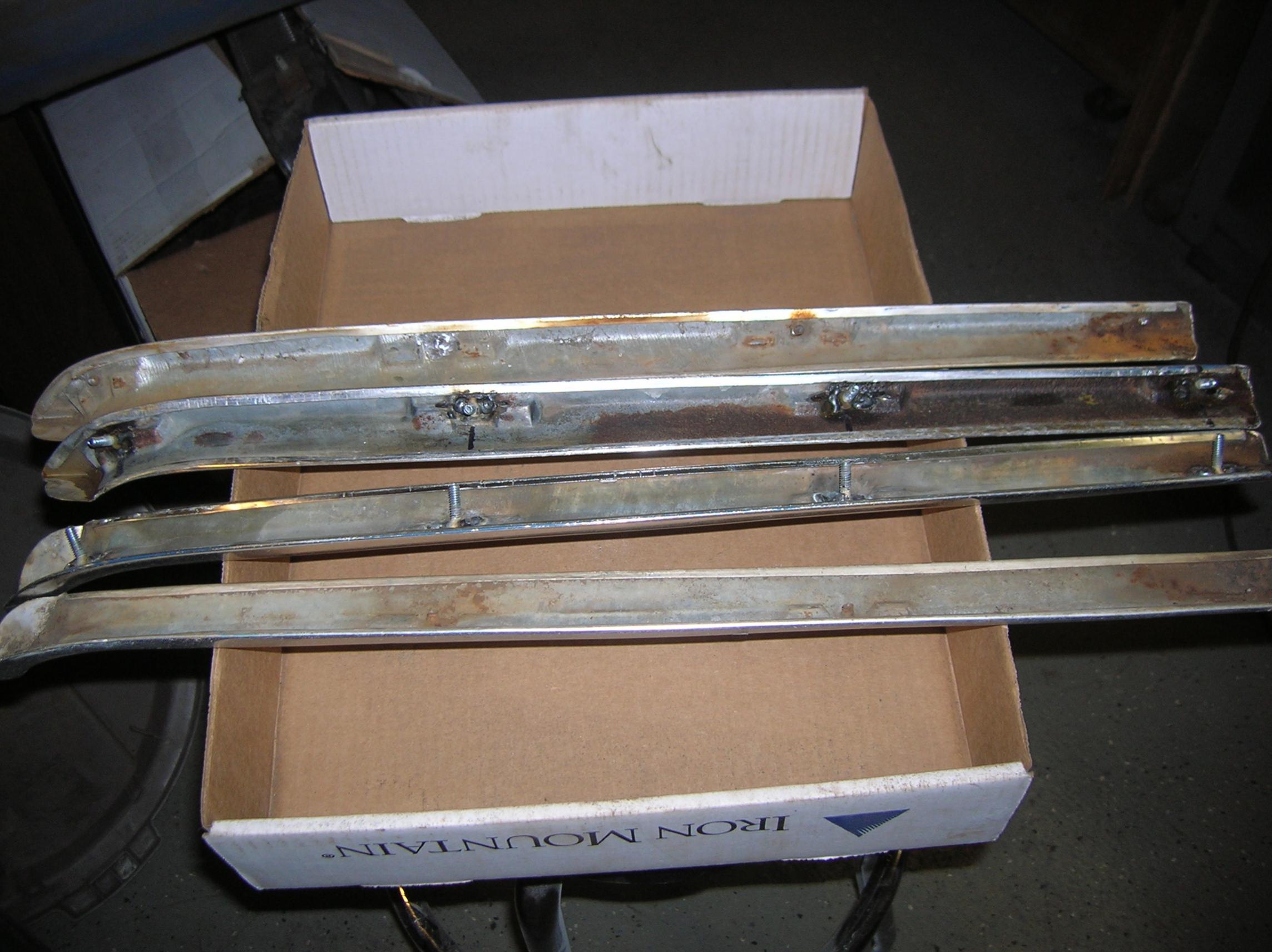

    welded some new studs on tho the hood trim "eyebrow" pieces, had 1 left on a total of 4 parts. the lower trim pieces were total rust outs so i made some new ones

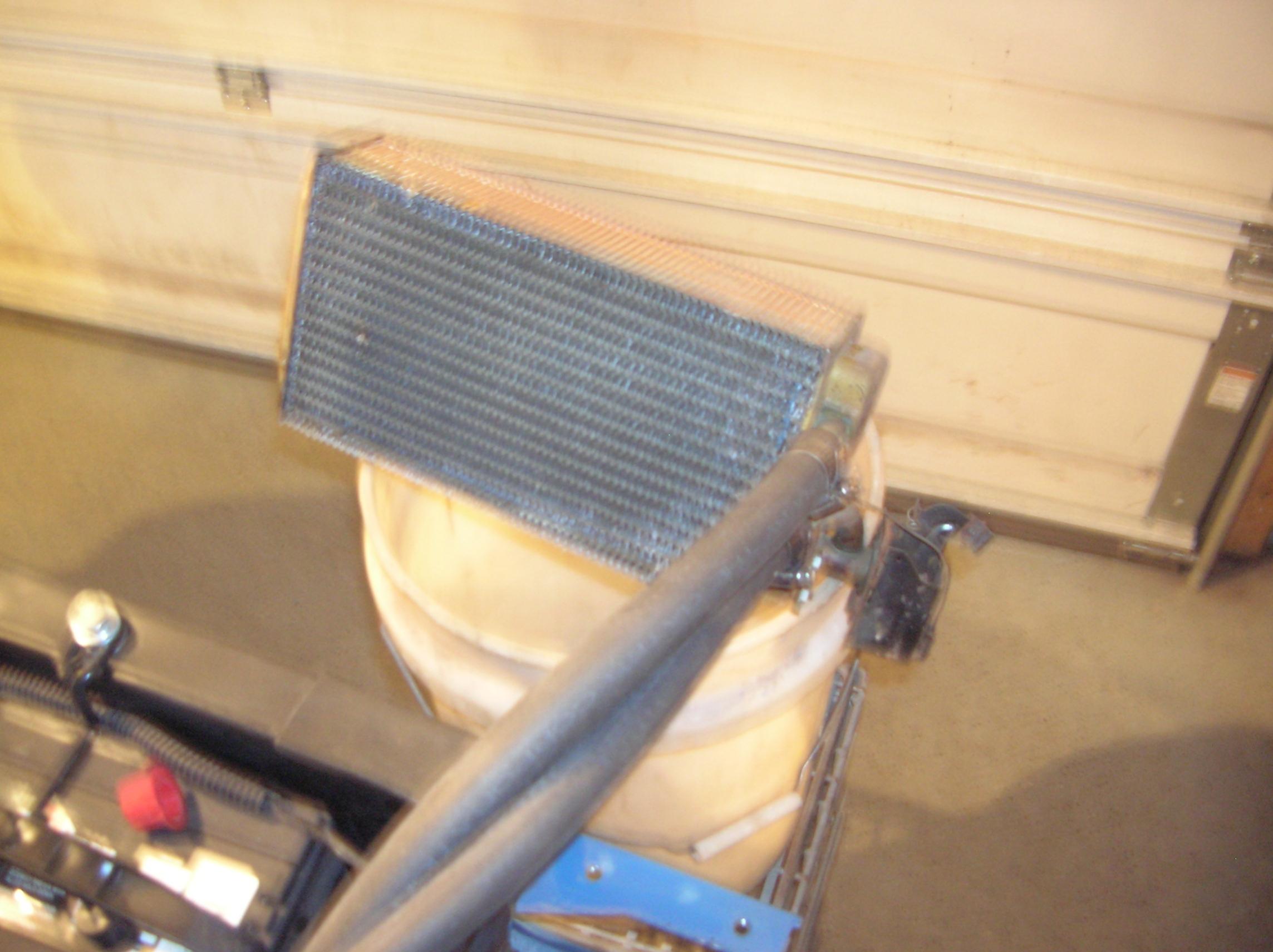

    started the car only to fine the heated core is leaking. fortunately there was nothing on the floor. pulled the right fender and the heater box to get the core out.

    Well they can be found and run $250 to $300. The good news is a new one will not be needed.
    As it turns out, either there was a loose clamp or something between the hose and the pipe. Once i saw the cost I thought it would good to see first if the "J-B Weld solution" may be in order. Once the housing and coil was pulled, the coil was set up over a bucket to see if a could leak could be found. As it turned out, it was dry as can be, so I ran the car several times over 3 days to be sure. Since the housing was out, the strip and repainting the inside housing seemed to be the only way to go.
    Here are a few pictures.

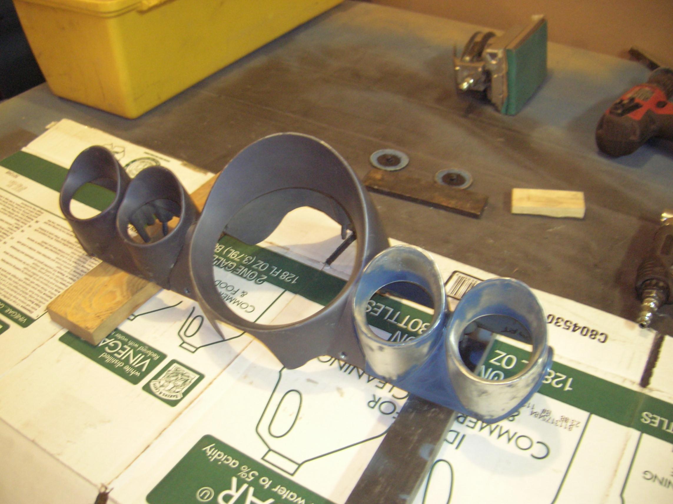

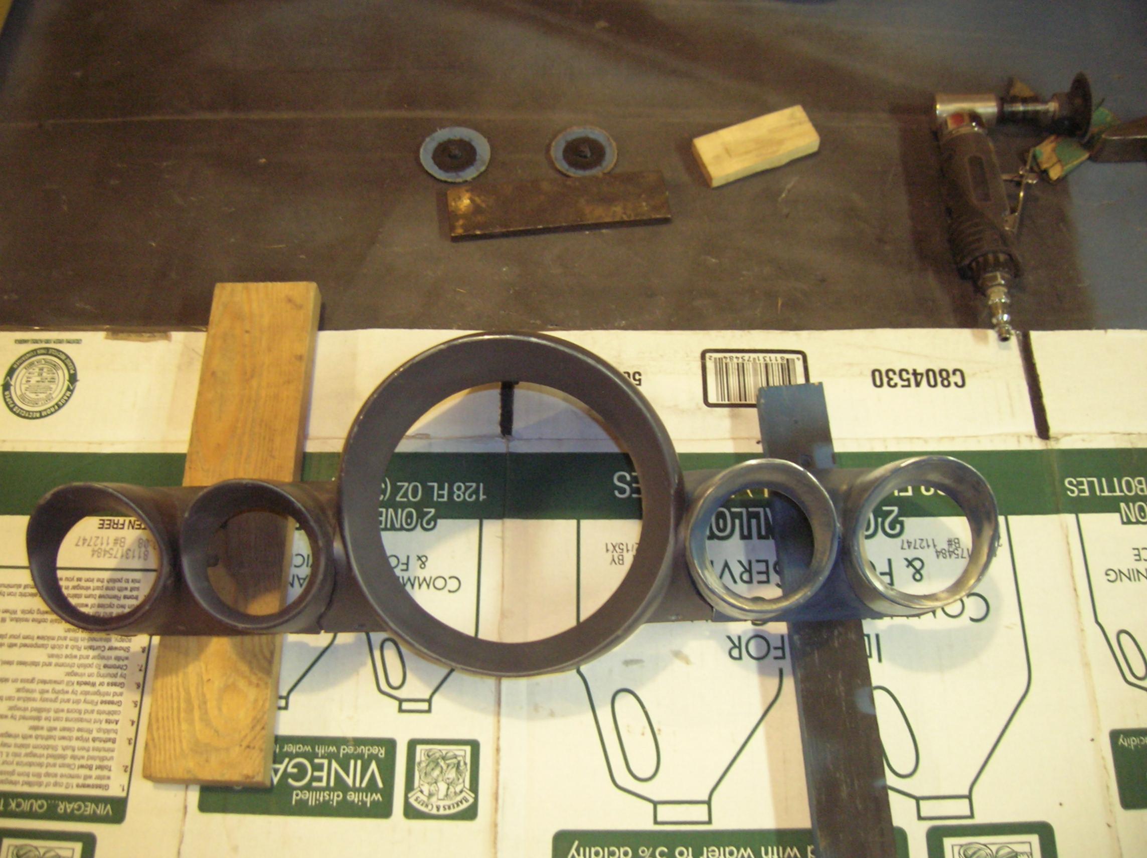

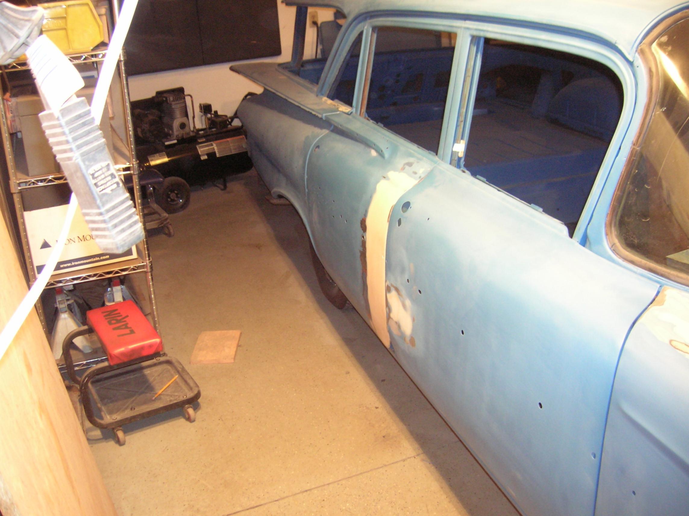

    The past week some progress was made. Had to pull the fenders because some plugs and the windshield drains were forgotten but they are all set now.
    Repaired a rust hole in the tailgate trim, worked out the most of the dents and got it ready to paint. Also started prepping a spare set of gauge pods that will get painted the same color as the roof (leaning towards Arctic White).

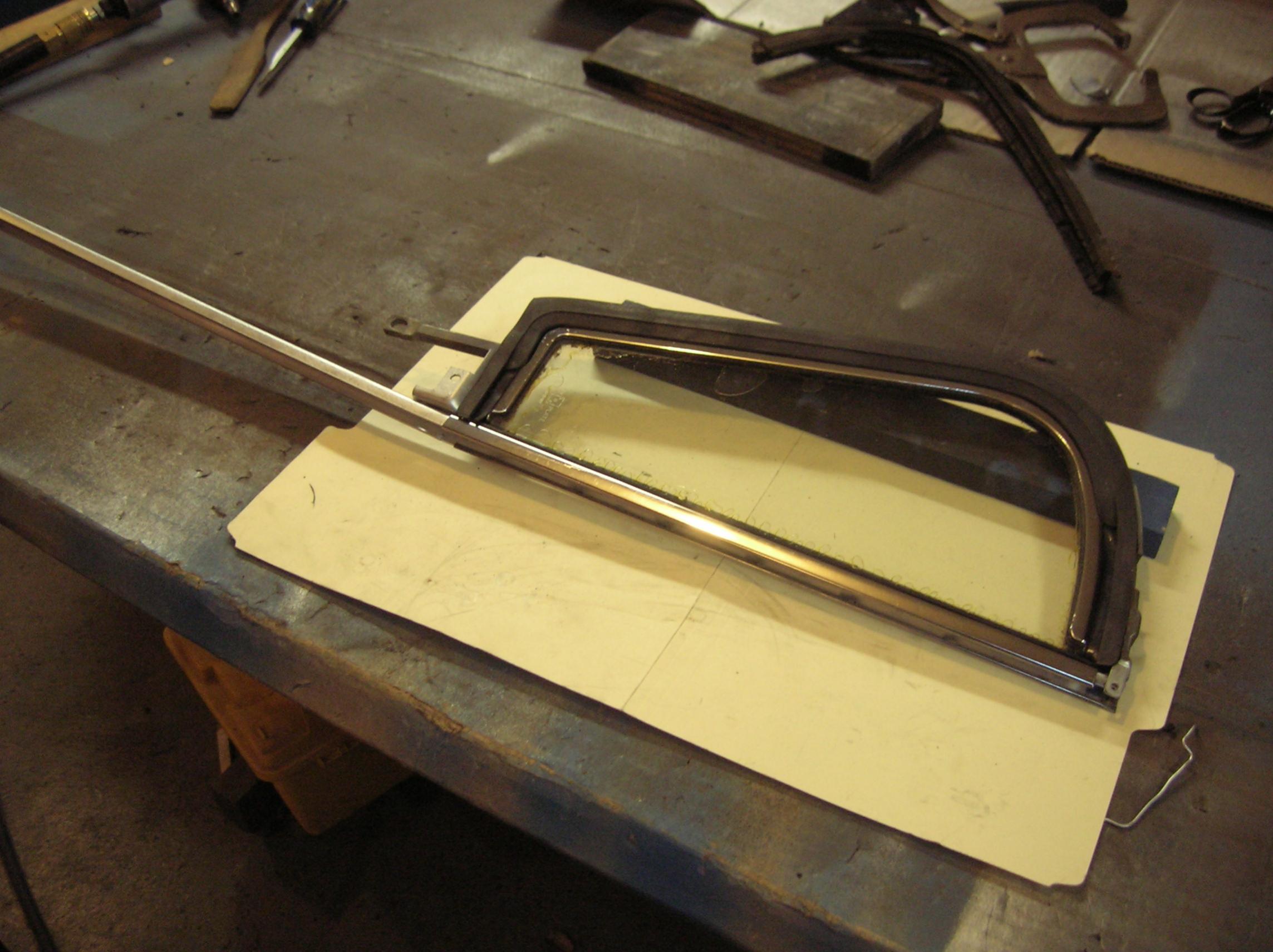

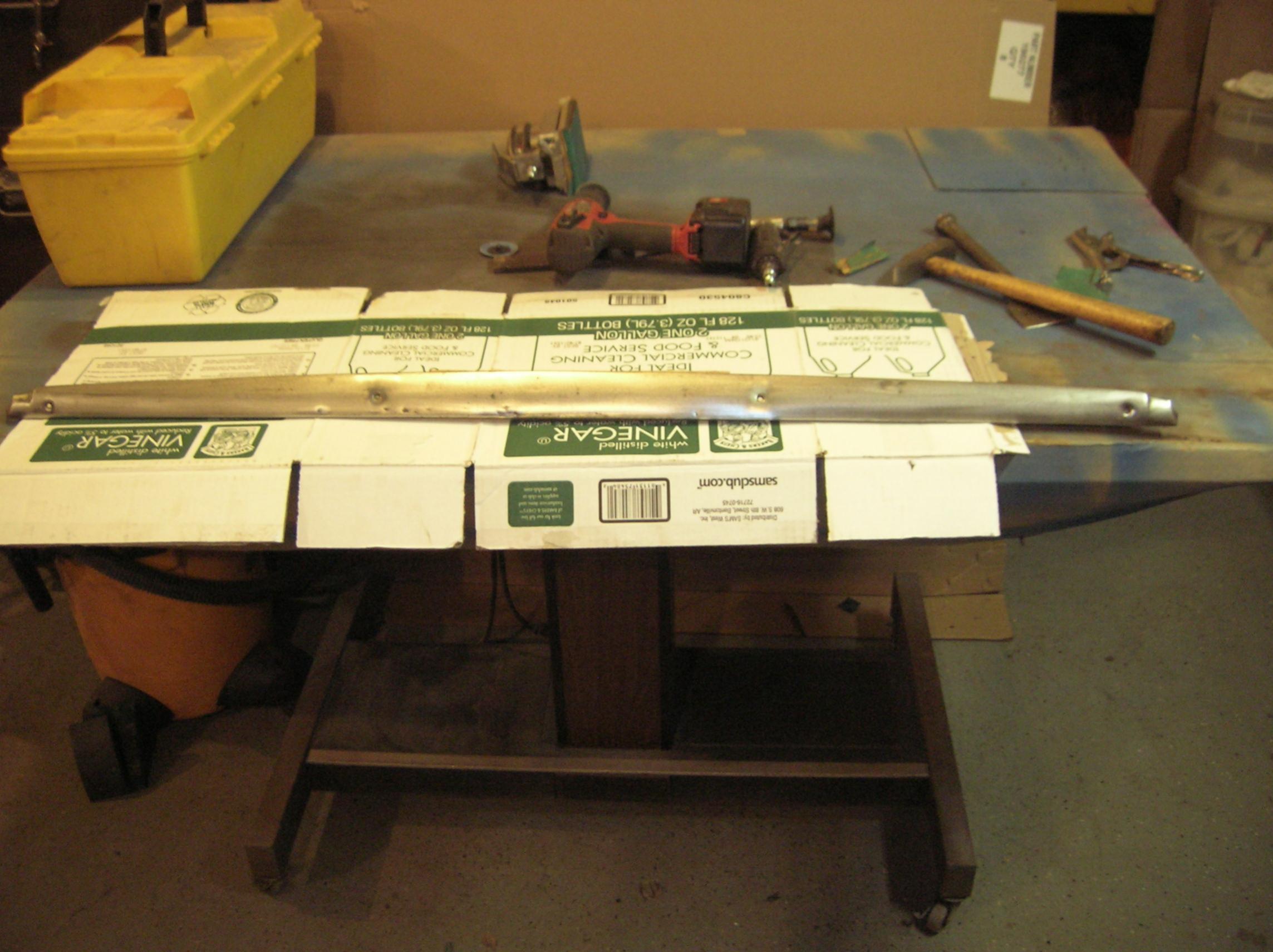

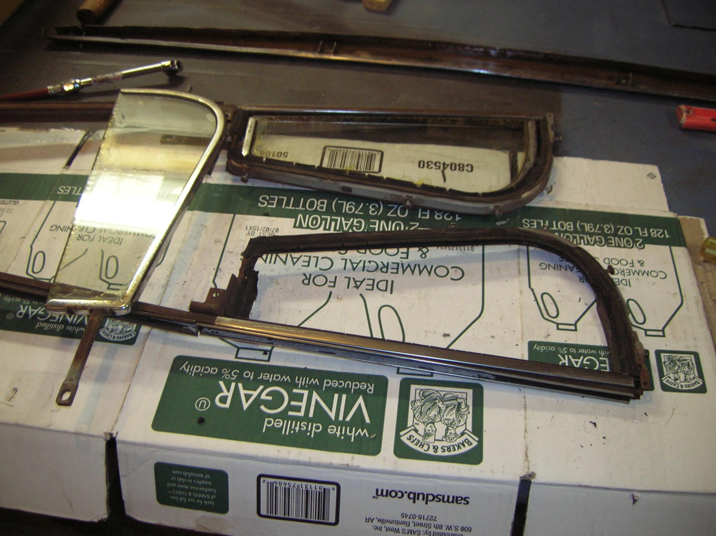

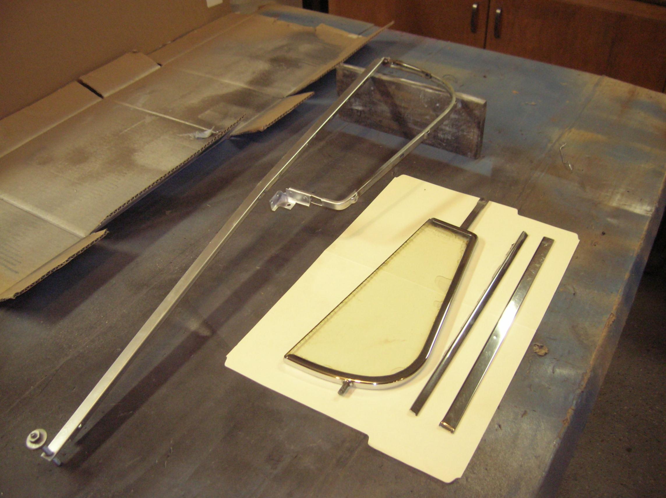

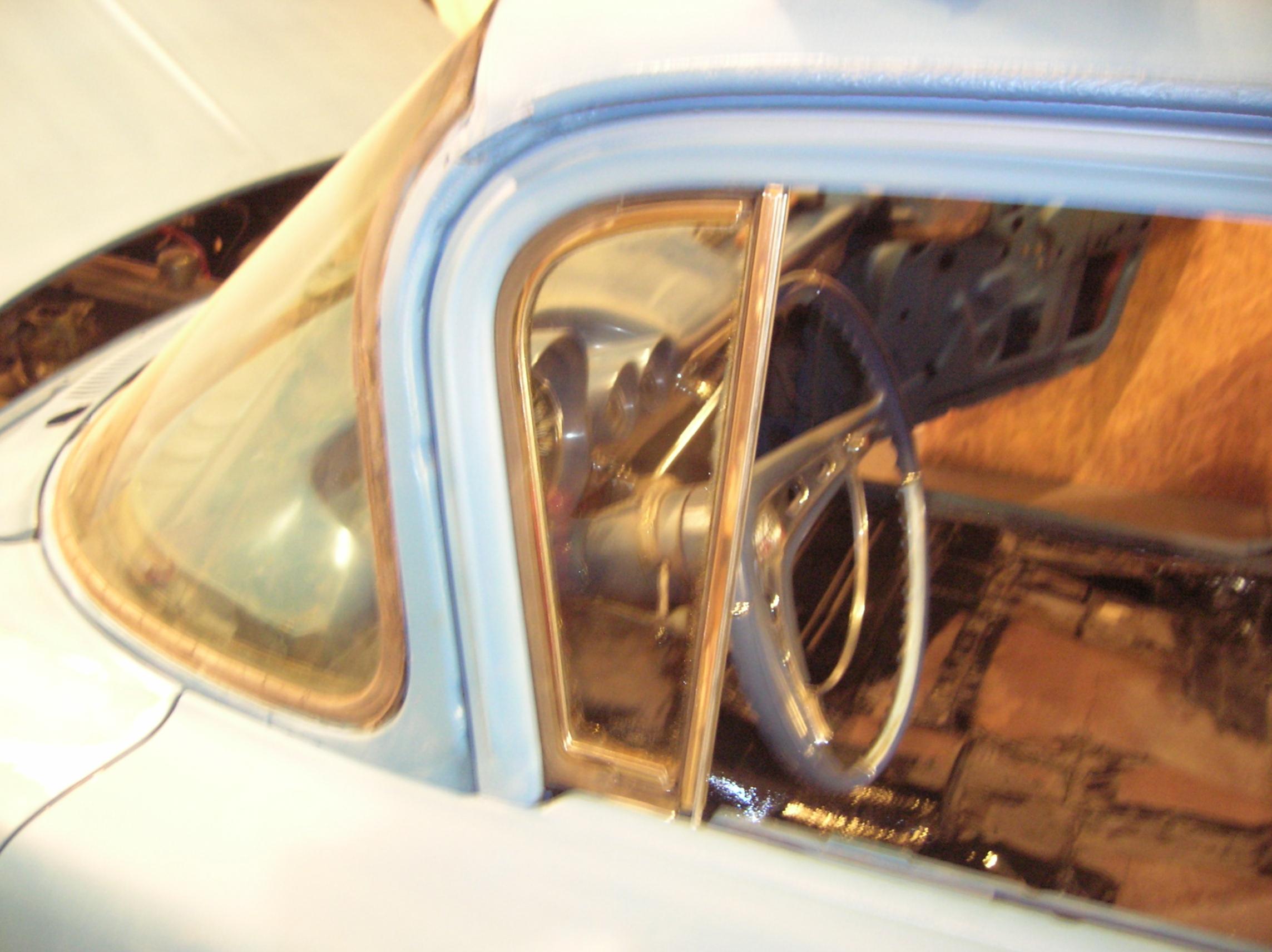

    Part of the keep it moving plan is to pick some short tasks and get them done.
    Went after the vent windows, cleaned up the rust, polished the chrome and replaced the seals. The gl*** is not too good, but it can be replaced later.

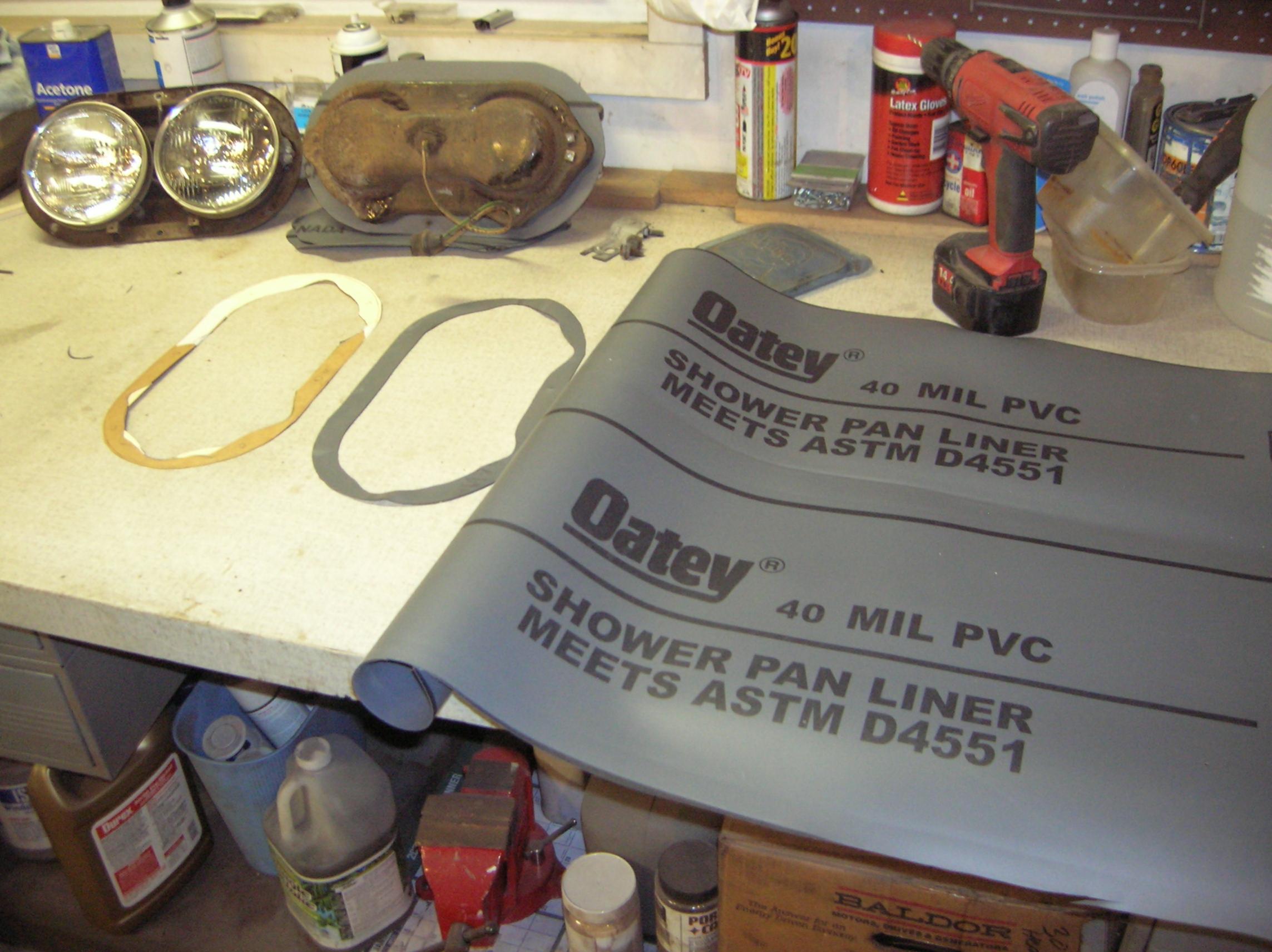

    Bruce A Lyke

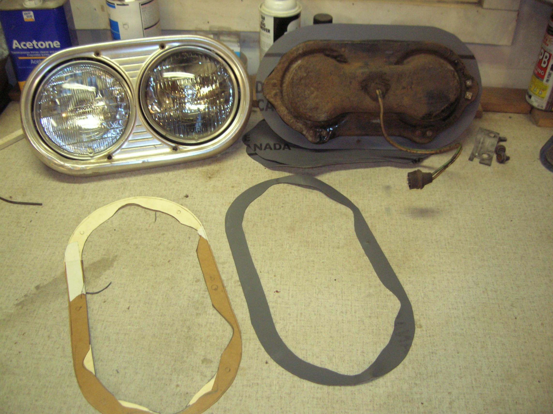

    made some headlight seals, since i could not find any. got a 2' x 5' piece for $12 and plenty of leftovers for others down the road
