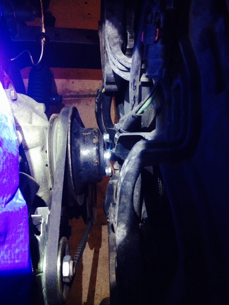

    Got the core support cleaned up, welded it and painted. Had to drill a few holes to fit the firebird radiator from my donor vehicle.
    These fans are a little too close for comfort, I need to make sure that's a short water pump, otherwise I'll probably move the fan to the front of the radiator
    Any suggestions or ideas?

    Slimmer fans? I have a 1 1/2 in deep Spal fan in my model a. If I'm not mistaken that's the shallowest fan available.

    I got some Allen bolts and removed a spacer
    So I got some room, and the rounded bolts shouldn't snag anything if they do touch.

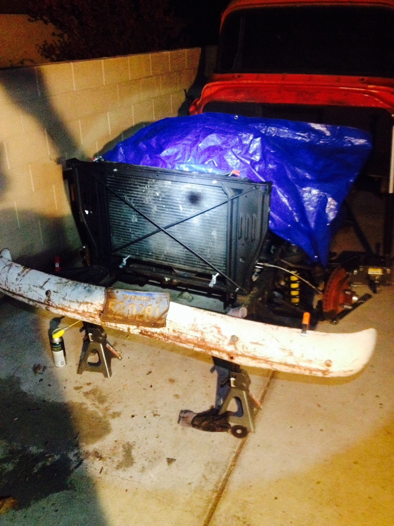

    ImageUploadedByH.A.M.B.1403133807.805451.jpg ImageUploadedByH.A.M.B.1403133843.186082.jpg
    Sorry for the ****ty pictures, just want to show elbrujo the exhaust so far.
    I plan on keeping the orange patina
    Instagram @kylemontoya

    Got it! I figure my exhaust will run outside the rails as well due to the transmission and power brake booster ***embly being so close together and I don't really want anything hanging lower than the rails except for the cross members. So I'm going to cut a notch on the frame so that I can route it through. Like you, I also planned on mounting my tanks and compressors on the inside of the rails.
