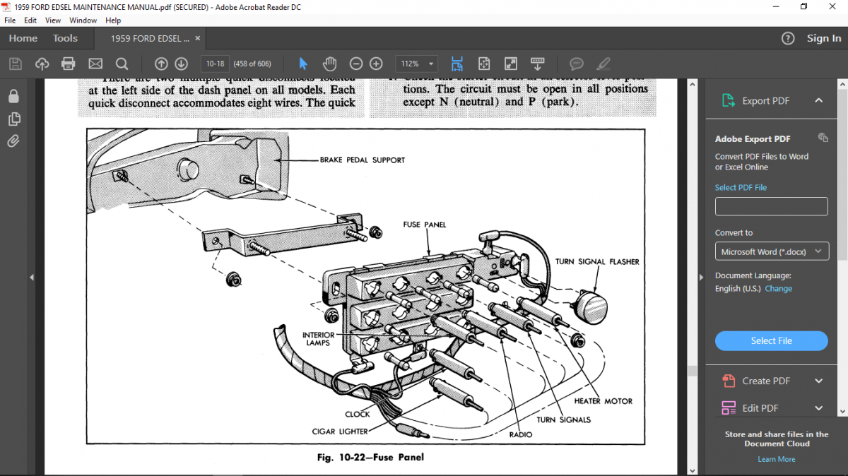

    There are 6 fuses in a panel underneath the dash on right side of the steering column. Also there are circuit breakers for the headlights in the kick panel on the driver side upload_2018-8-19_21-17-12.png

    Well now that's about the craziest lookin' fuse panel I've ever seen. :eek: Looks like something out of the back of an old Zenith black & white TV set. Guess I've lived a sheltered life... Haven't spent enough time under the dash of a '59 Edsel. :p
