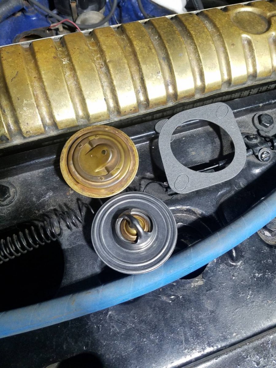

    Seemed to have been running a little hot so it got a new thermostat. Still had a quiet misfire, which I think is due to the vac***e leak we ended up finding. My wiper motor is vac***e and that seems to be the leak. 20180829_190424.jpeg

    Everything timing wise seems to be right on spec. I just put a new timing chain on it and lined up the dots perfect so I dont think it is retarded any. The thermostat did seem to solve the problem.

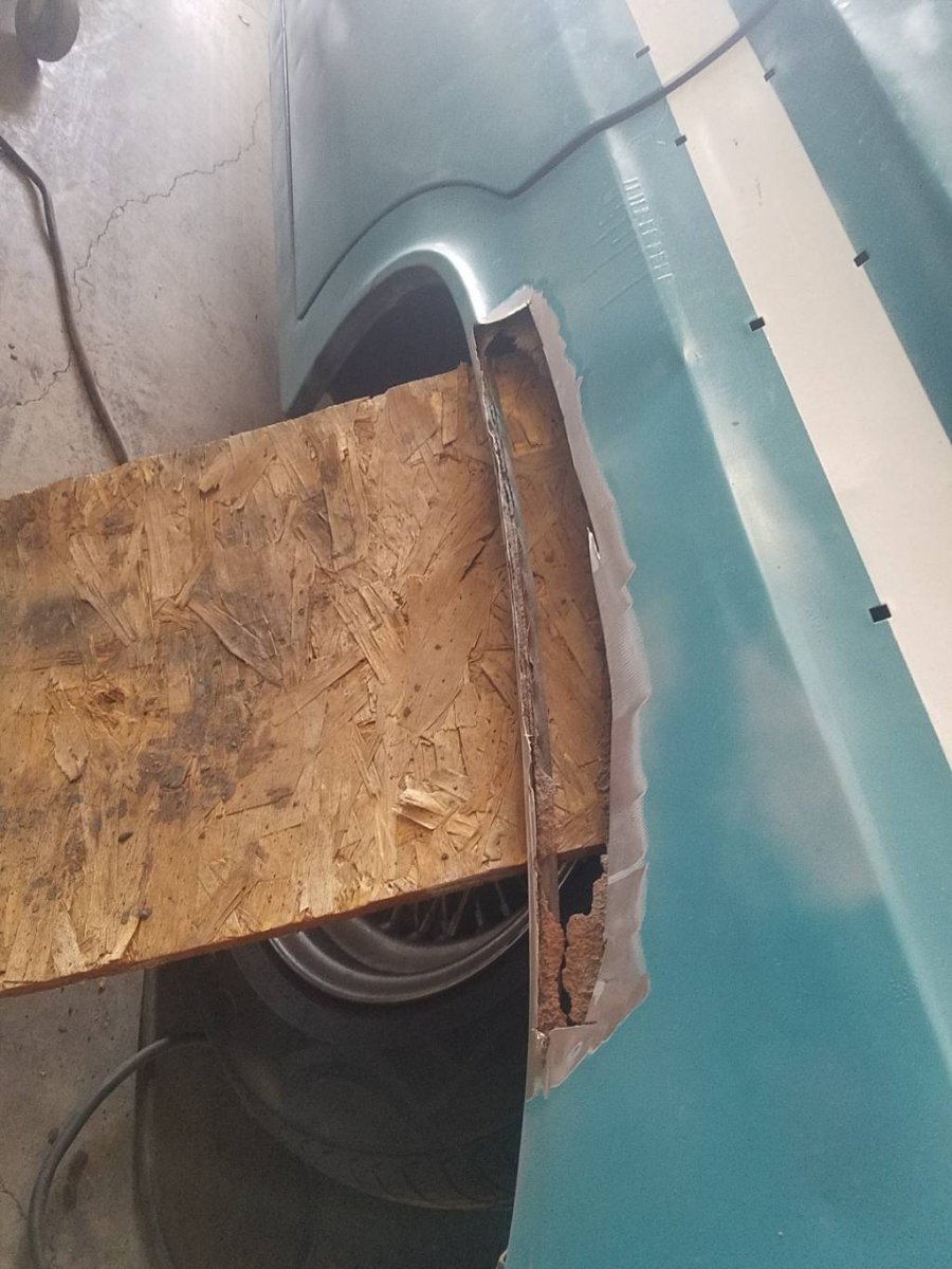

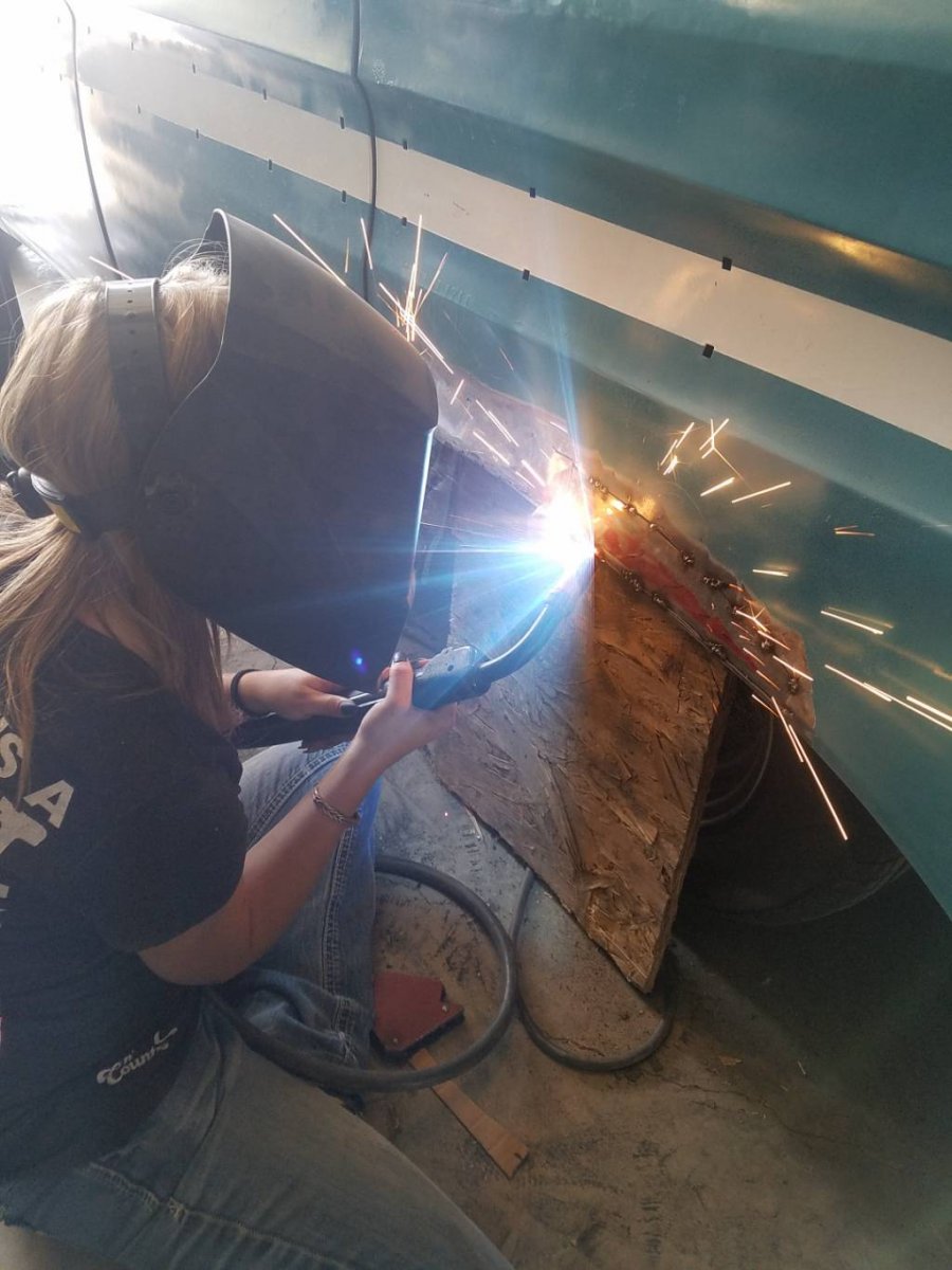

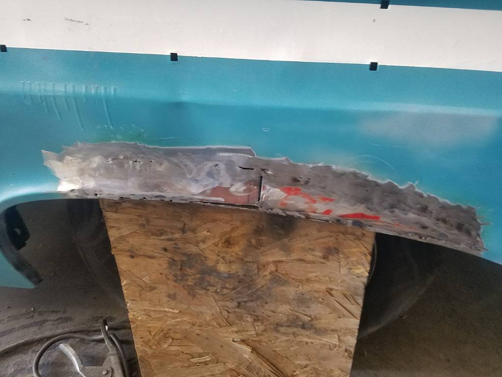

    Sooo the start of body work has begun.... as you should remember the big rusty whole on my fender. Has now turned into hours worth of tacking. But there is no rust! Will show you when done! 20180901_130852.jpeg 20180901_142924.jpeg 20180901_145345.jpeg
    ~Hotrodmnm

    Big ugly rust hole GONE!:D You're doing some nice work there and correctly. Please tell me that you also welded the hole in the wheelhouse. Pictures don't show it.
    loudbang and Hotrodmnm like this.

    I did, I couldnt get a picture of it. But I did do both sides, even did some welding from inside the trunk:) It is now painted and the skirts are back on!

    I forgot to post this but here is the finished rust spot! Absolutely no bondo! Just straight metal! 20180901_195802.jpeg
