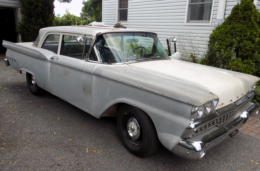

    I'm not painting it anytime soon, I wanted to get it primed so I could see all the imperfections when I do the body work. So it will be in primer a while
    ~Hotrodmnm

    Paint... highly overrated... but primer is porous to the elements so you have to deal with that. Epoxy primers hold up pretty well if the car is largely garaged.

    Instead of letting it sit in primer, shoot a sealer on it. You can get a Finish 1 sealer from your NAPA paint store, get the 2k version so its top coat safe. comes in 7 shades from white to black, has a bit of a shine to it, kinda satin. I ran my truck in it for 2 years as I worked. A gallon didn't cost too much.
