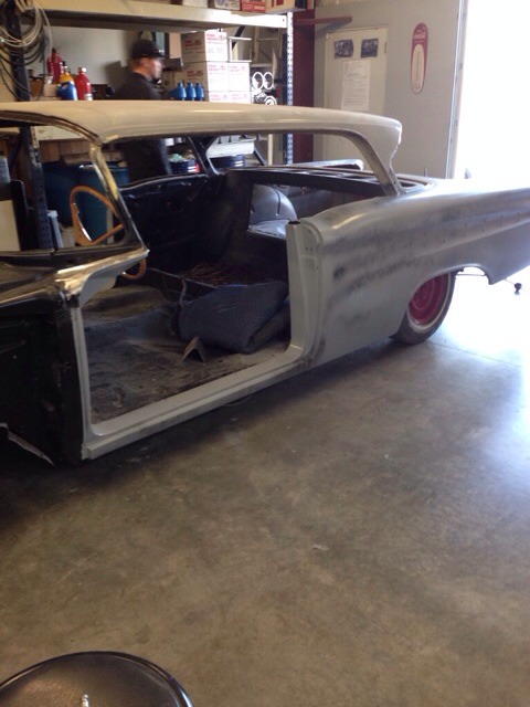

    Bottom bracket installed under lowering block, with bags.

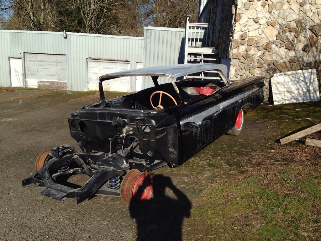

  2. Eickmann
    Joined: Oct 1, 2013
    Posts: 47
    Eickmann
    from salem
    ImageUploadedByH.A.M.B.1384742010.962590.jpg ImageUploadedByH.A.M.B.1384742030.197689.jpg
    Upper bag brackets welded in. And the air suspension is fully functioning!

    The car is set in final primer, going up to the booth to get her black dress

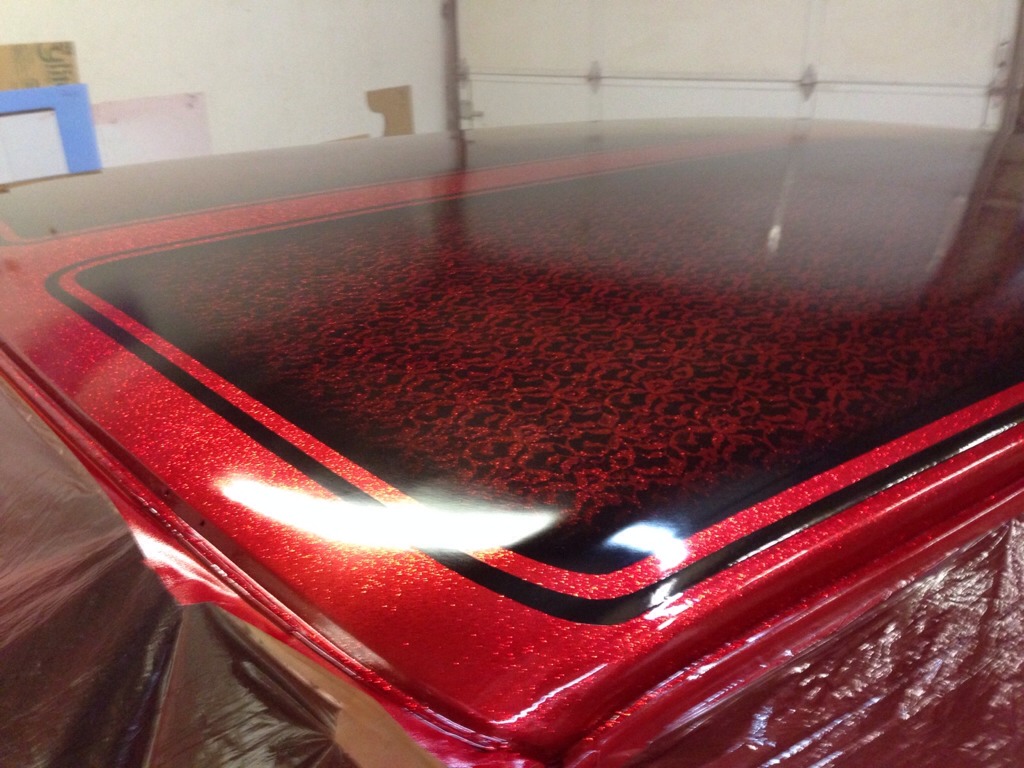

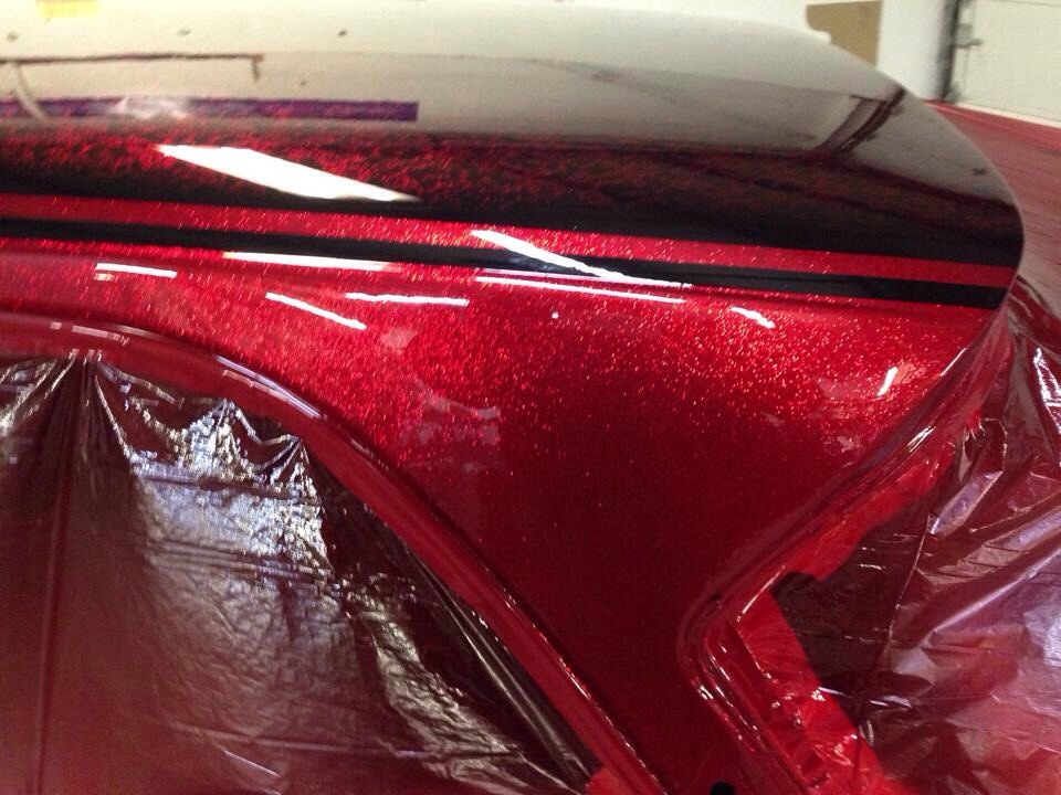

  13. Eickmann
    Joined: Oct 1, 2013
    Posts: 47
    Eickmann
    from salem
    ImageUploadedByH.A.M.B.1390797237.344892.jpg ImageUploadedByH.A.M.B.1390797244.641650.jpg ImageUploadedByH.A.M.B.1390797254.656412.jpg ImageUploadedByH.A.M.B.1390797286.297868.jpg
  14. tattoos by brandon
    Joined: Jun 28, 2011
    Posts: 542
    tattoos by brandon
    from salem ohio
    What kind of flake did u use and what color of red did u use over top it if u don't mind me asking ... we flaked my 59 Chrysler but I don't like it ...we did red flake over a red base ... but this was a first time and we didn't know what we were doing
  15. Eickmann
    Joined: Oct 1, 2013
    Posts: 47
    Eickmann
    from salem
    The kind of flake i cant remember, but its a real heavy boat flake. First a silver base goes on, then the flake was shot with clear. Then the lace goes over, and a candy smoke was sprayed. After that it was all covered in candy red

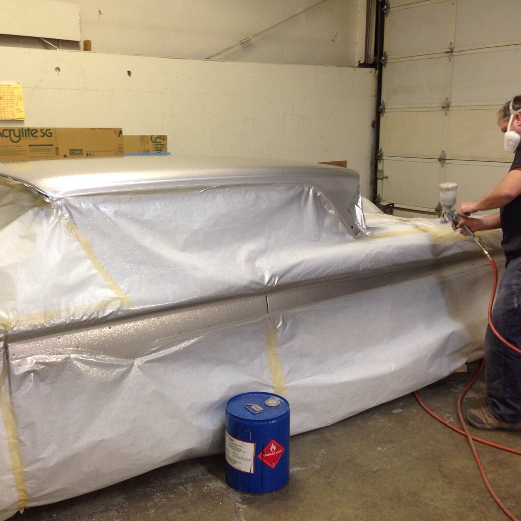

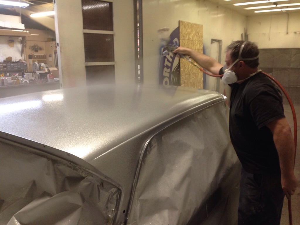

  19. afueldigger
    Joined: Aug 20, 2012
    Posts: 23
    afueldigger

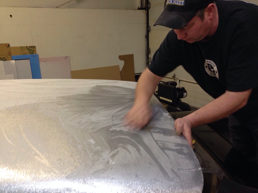

    This roof was painted by a very talented friend of ours one of the best in my opinion......Joe Miller....
    This is how it was done:
    Silver base two coats
    roth monster flake shot in inercoat clear four coats
    two coats clear
    wet sanded
    two more coats of clear
    wet sanded
    taped off panels
    streched the lace (tight)
    two light coats of black
    one coat of black with smoke candy
    hard line and fade shot with black
    two coats of clear
    wet sanded
    5 coats of candy shot in clear base
    two coats of diamond clear
    in total time worked you are looking at about 30+ hours in the roof alone.
    Very special thanks to Joe for lending his talents to this kids project.

    What grit did you wet sand with between coats?
  22. afueldigger
    Posts: 23
    afueldigger
    hello Greg
    The clear was all wet sanded with 800 paper final wet sand with be starter with 1200 then on to 2000 before it is buffed. We are going to let it all sit for about a month before it is final cut and buffed two allow for any die back which is to be expected with this much material..... it should look about a mile deep after that.......thank you im glad you like it

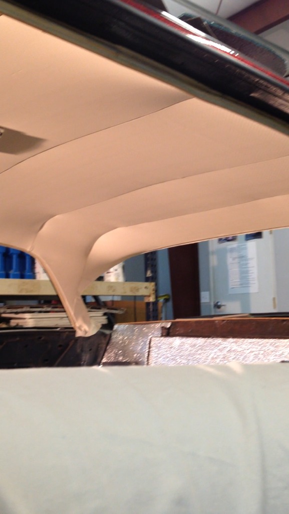

  27. Eickmann
    Joined: Oct 1, 2013
    Posts: 47
    Eickmann
    from salem
    Headliner installed ImageUploadedByH.A.M.B.1392961810.080235.jpg ImageUploadedByH.A.M.B.1392961818.447177.jpg
