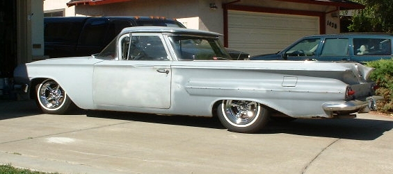

    Here's my old kind of beater 60 El Camino with your wheel and tire thoughts to help you see how they look. This one just dropped with cut springs:

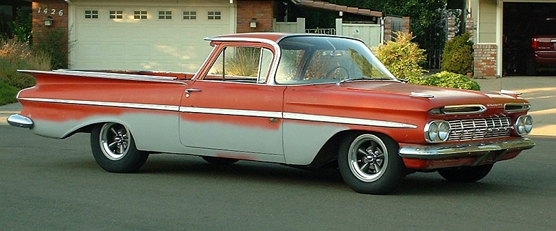

    This 60 had a 307 and T350. I also had a 59 El Camino (notice this past tense on El Caminos) that had a 350 and 700R4. Traditional SBC works great in these, although you can fit just about anything. Here's my old 59, this one had dropped spindles and lesser cut springs.

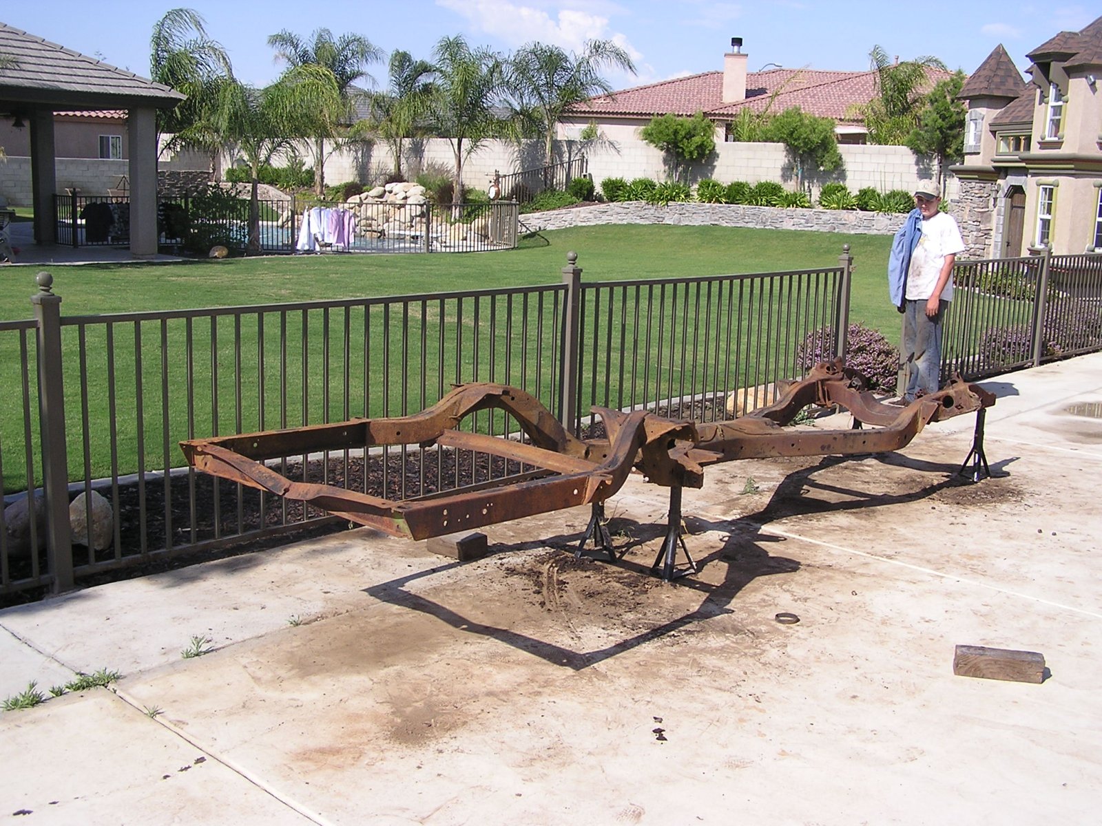

    Fun project. Grandson and I did one in the teens him. Took lots of in-progress photos so if you need any advice just ask. We ran a 305 SBC with 200R4 ******. Car had a factory posi rear end. We did everything from the ground up.
    start car 1.JPG Frame stripped.JPG IMG_5391.JPG IMG_5393 - Copy.JPG IMG_5394.JPG IMG_5398.JPG

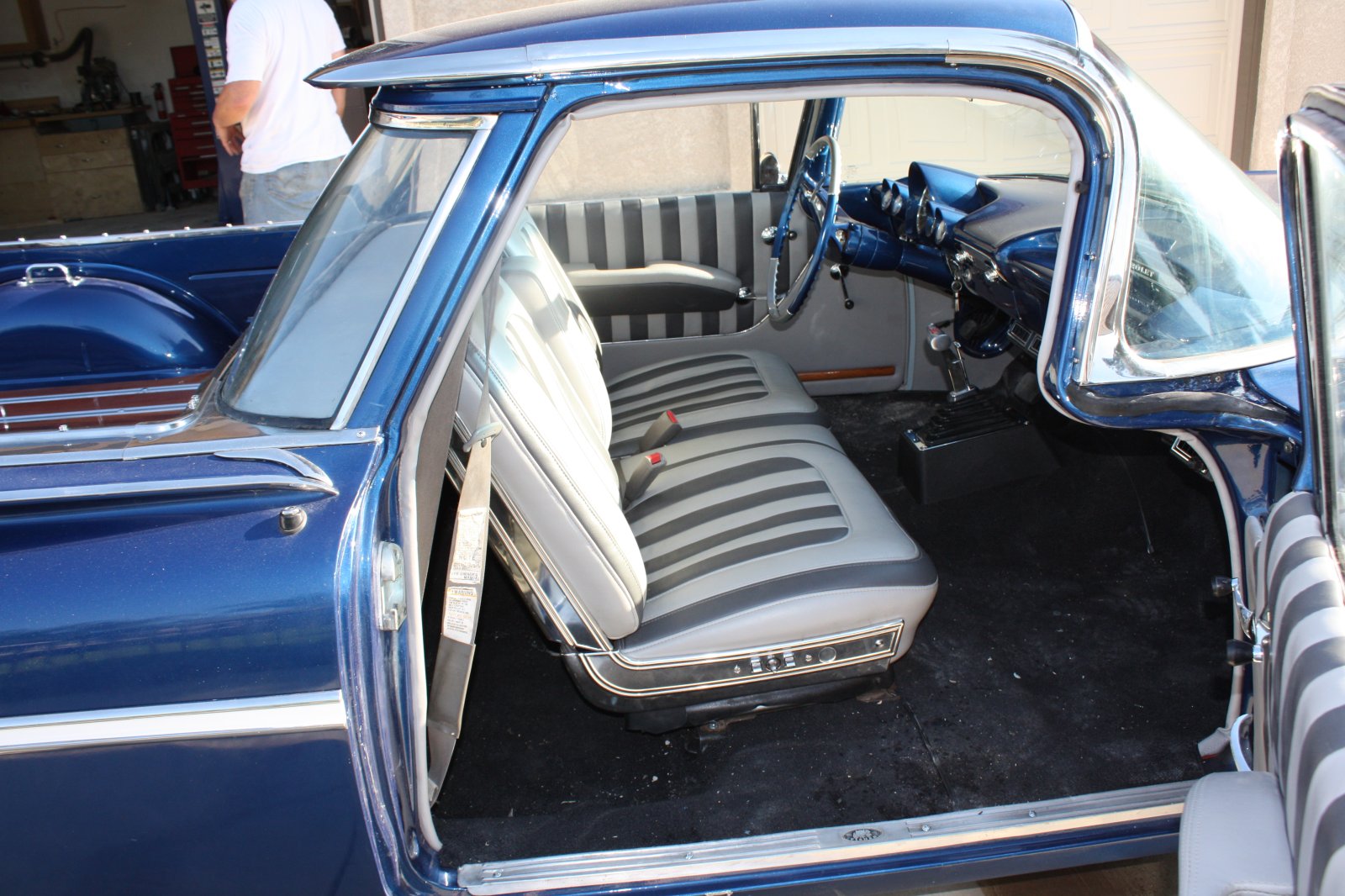

    It's as pre-2000 Cadillac power split bench. Can't remember if the center console came from that car or we adapted it from another. I seem to remember the latter.

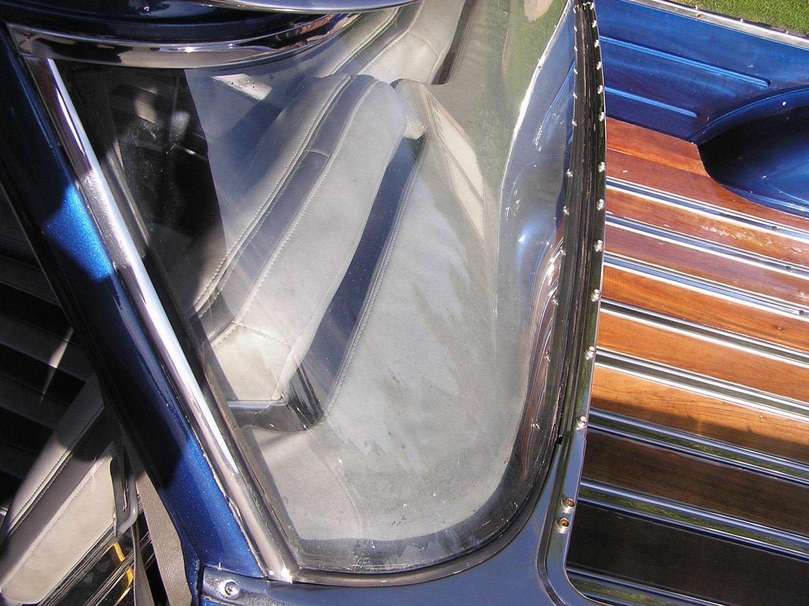

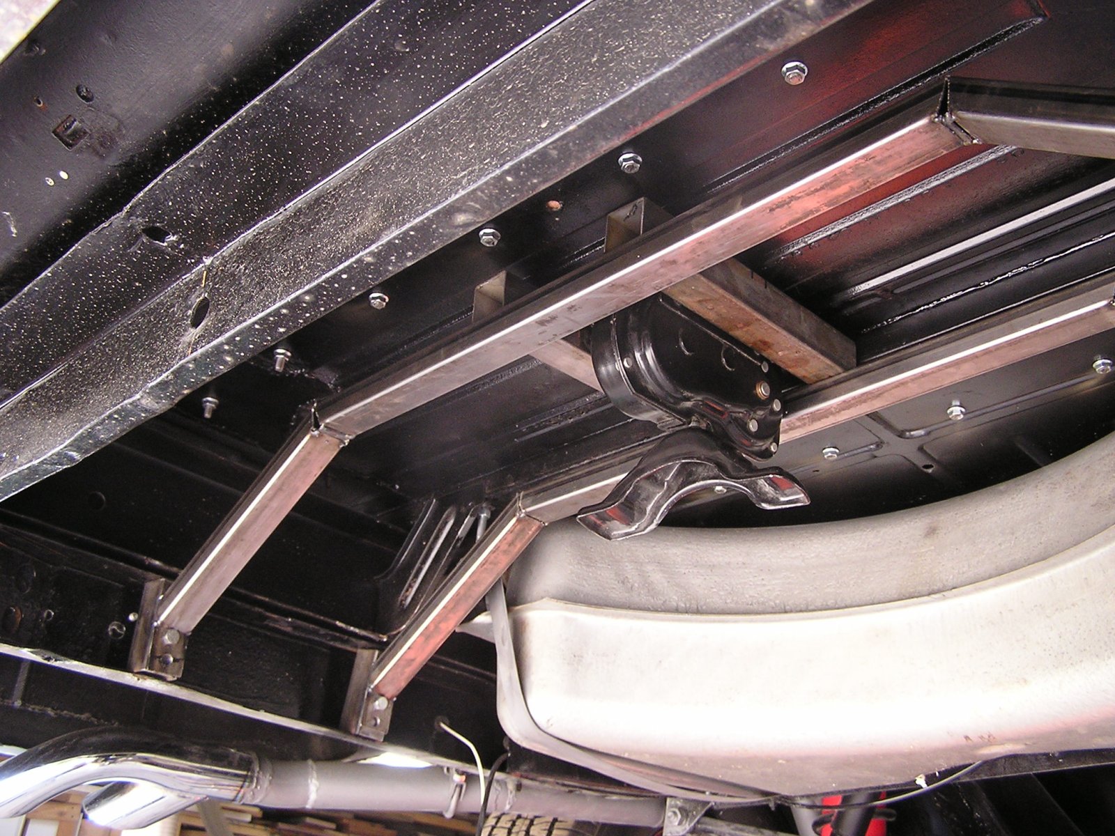

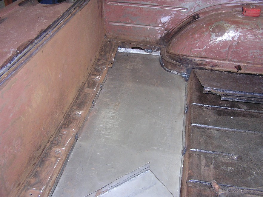

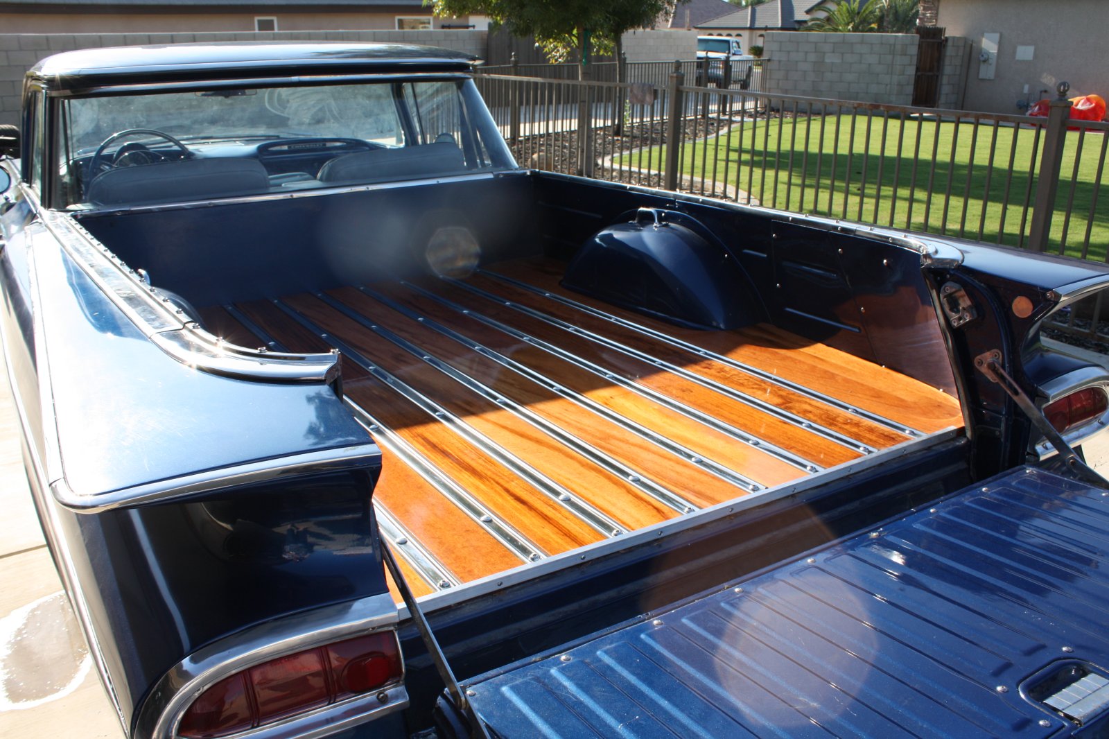

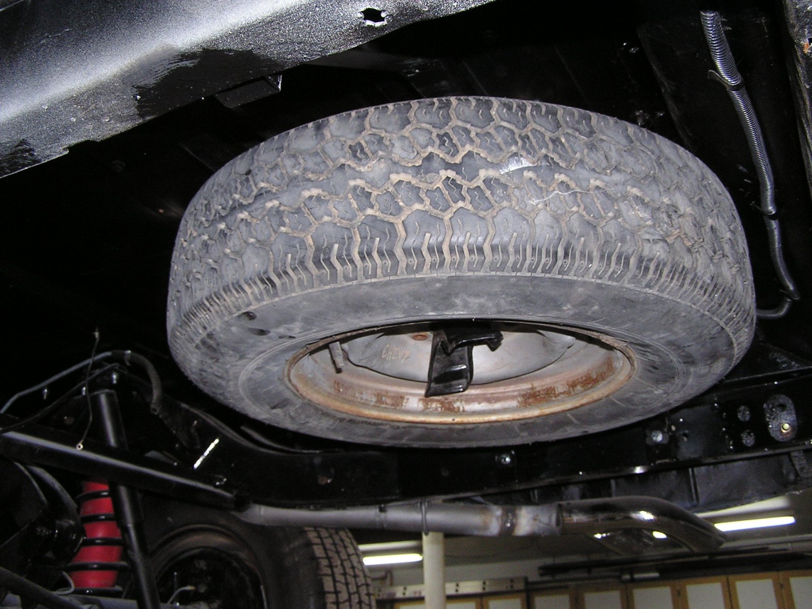

    we took the spare tire out of the cab and put it under the rear bed where it belonged. We adapted a Dodge Dakota crank hoist for the spare. We then opened the bottom of the back wall into the 'smugglers compartment' under the bed for storage. They do have a small 'luggage tray' between the seat and rear window if that is what you are referring to? We notched ours so the seats could slide a bit farther back.
    OOPS! You said behind the rear window. Are you referring to the hidden compartment beneath the bed panel? That is referred to as the 'smuggler's compartment'. It is there because to rush the truck to market to compete with the Ford Ranchero, Chevy just bolted Elky sheet metal to a station wagon platform. That space is the footwell for the 'wagon rear seat p***engers. We welded a a sheet metal roof over it and opened it into the p***enger compartment.

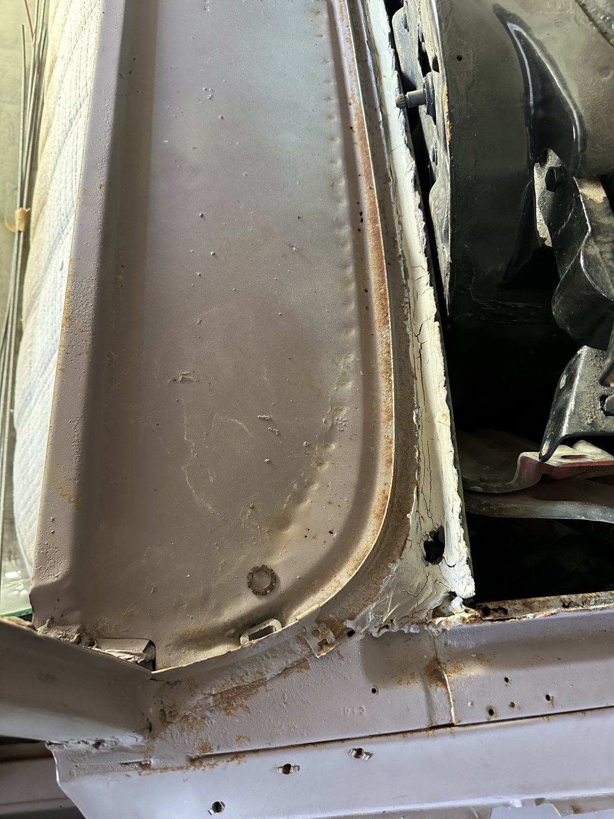

    So I took a picture of the part I was curious about how it would look originally, it looks pretty rough
  12. The spot behind the gl*** is just a trough and is under some trim.

    I appreciate the info and the picture! I was nervous seeing the bondo/filler. Looks like I should be able to just clean up whatever the previous owner did and see how it looks underneath.
  14. You can build almost anything and it will be covered by 3 pieces of trim. I believe it's to carry the water from under the gl*** and dump it into the bed, they rot quite often.
