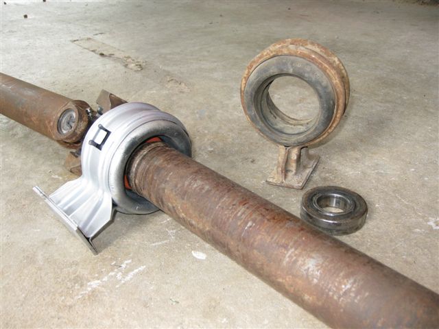

    Well it's almost time to but 59 in the garage and start waiting for the next summer. I have but about 1500 miles to Camino's odo this summer and old 348+turboglide have worked great. Not bad for the car which has not been used in last 30 years. Had to replace rear axle bearing cause of leaking seal and the drive shaft carrier bearing during the summer. And the heater core was fixed. But that was about it.

    New bearings and removing few pounds road debris...

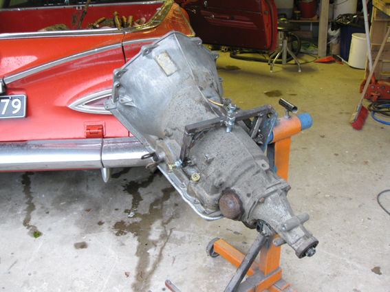

    In the fall I got project 700R4 trany and it is behind the 348 now. Had to rebuild it first and buy or fabricate all necessary parts for the swap. Original Turboglide is well-stored for future generations :)

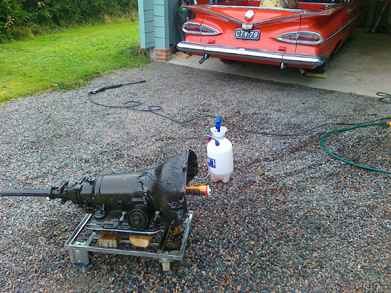

    Here is few pictures of the project 700r4. Had to make own holding fixture.
  14. El59Camino
    Joined: Jan 9, 2012
    Posts: 46
    El59Camino
    from Finland
    Cleaned and painted case gets new master kit.

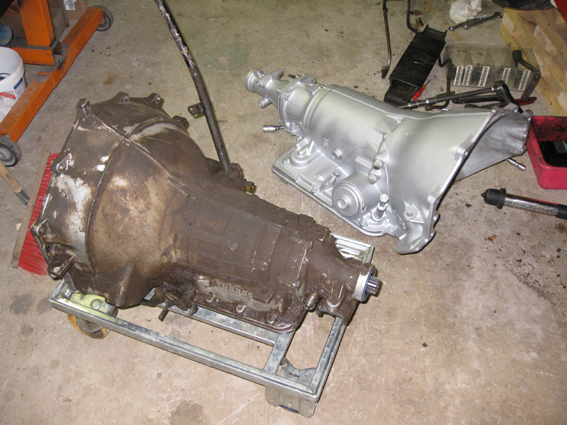

  15. El59Camino
    Joined: Jan 9, 2012
    Posts: 46
    El59Camino
    from Finland

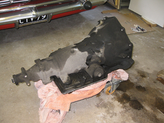

    Here is the difference between old Turboglide and 700r4. Had to shorten driveshaft 7.5 inch.

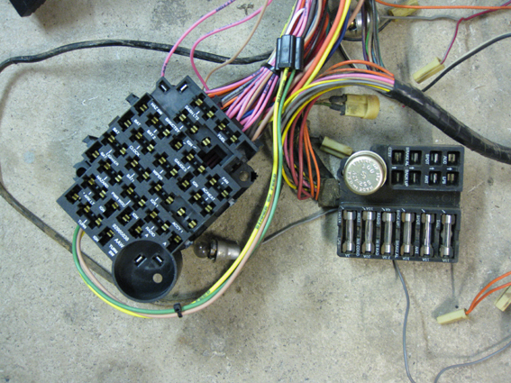

    The next project was change comblete wiring harness. Almost done already. Still need to complete under dash wiring and instal gauges back on.
