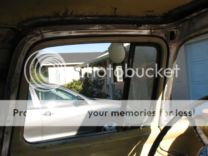

    drivers side finished
    roof finished. minus metal bumping..

    nicely done. i am a little confused about why you didn't just replace the whole roof in one piece. but it gives you good welding practice...

    They had no idea what to charge, as it wasn't in their computer catalog! :rolleyes:
    So i ended up paying around 80 bucks i think for the roof pieces..

    I wasn't thinking while i was at the wrecking yard..All i thought was to get the pieces that were toast on mine.. duhh this would have been SO much neater and smoother if i replaced the whole damn top..im kicking myself.

    Haven't had time to post lately. Got it all in a few days ago. . Stripped roof, getting ready to paint. not very good pics, but here..

    really great job! you have talent and simply putting a entire roof on wouldn't have been big enough challenge. any job involving patch panel ****s in my book but great save on the cab so far!

    Didn't quite get why the roof wasn't replaced as whole either but if I was doing it I probably would have cut just the peaces i need too and realized later I made it hard on my self!
