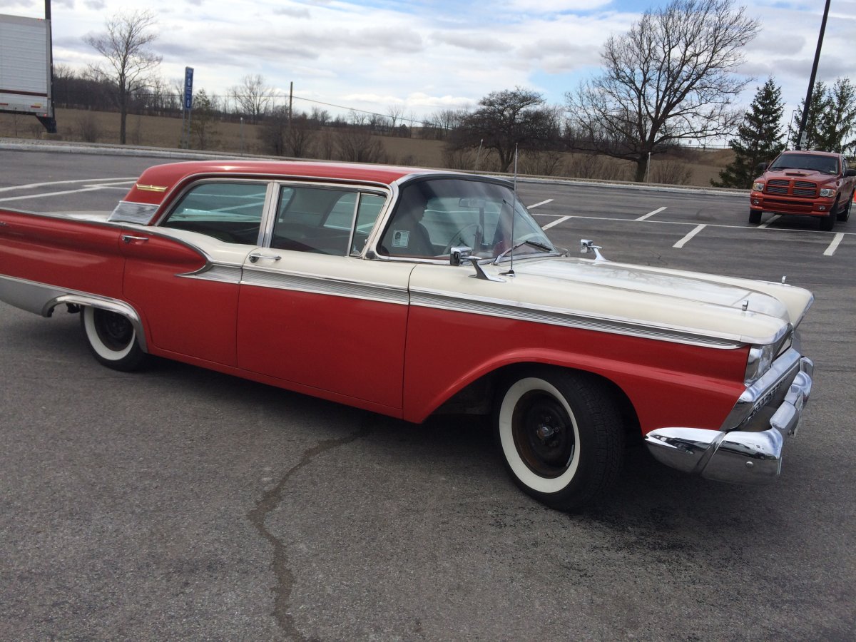

    Some pictures from the trip... IMG_0941.JPG IMG_0964.JPG IMG_0975.JPG IMG_0977.JPG

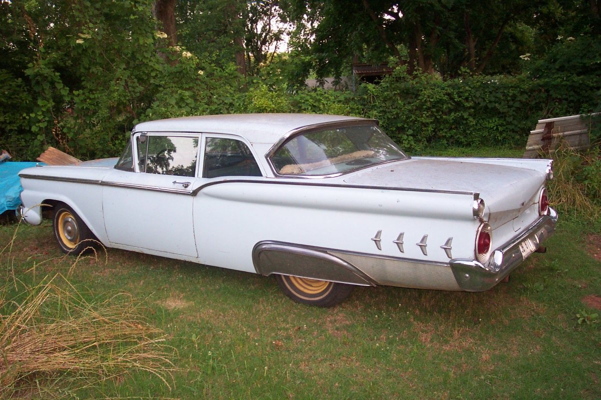

  16. Just saw this. Here's 2 pictures, not great but I can take better ones now I have a real camera.
