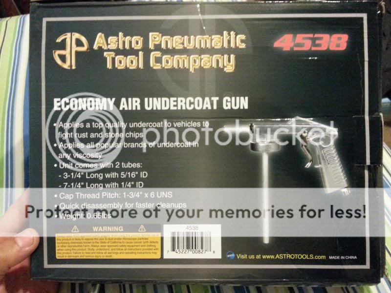

    I am hearing the best way to spray metal flake if youre not an expert is to dry spray it with one of these
    http://www.ebay.com/itm/FLAKE-BUSTE..._Automotive_Tools&hash=item5af3d13980&vxp=mtr
    or this one
    http://www.limebug.net/product/view/202/ed-roth-bazooka-flake-paint-gun
    that one calculated to dollars is 160 bucks. and theres this one too which is the cheapest at 85 bucks shipped
    it sprays it dry on wet intercoat clear, so you have more control over how much flake is in the paint and get an even coverage. and this way you wont worry about drips or runs ruining it all. a bigger version of this
    [youtube]saA15XlQfQ0[/youtube]
    so you can get one for about 160 bucks. or if you take a good look at the pictures, just get this
    http://www.ebay.com/itm/Astro-Pneum..._Automotive_Tools&hash=item4d0642b37b&vxp=mtr
    for 15 bucks. just buy a regulator to screw on the base and set the regulator at about 10psi and play with it till you get the spray you want, but its about 10psi. then just mikey mouse a jar at the bottom and youre set. I already started to prep the 59 for its repaint, will start really soon
