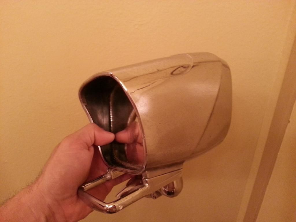

    Let me paint the scene for you, I was walking THE TOY aisle at the Pomona swapmeet looking for vintage toys before I hit the car parts aisles. I walk the second row in at the swapmeet, its all toys so everyone kinda stays out of it unless you have kids. there is a vendor that must have been his first time there he was set up with a bunch of junky parts no toys. I spot something out the corner of my eye, was like is that what what I think it is? I get closer and pick it up, had this price on it
    guy tells me "that was picked off a 50s buick, not chevy but you can have It for $100. Bring me a car battery ill wire it up youll see it work and light up"
    I pulled my wallet out quick and gave him a 100 dollar bill, and walked away to get a better look without him seeing i really wanted it. went a few spots down before i took a better look. this is what he sold me for $100 teling me its a 50s buick part
    what the ****! i never held one so im thining it was too good to be true, then i got a feeling because of the bracket its not for 59 that it might not even be a trailmaster for chevy its problably a ford spotlight since i never held one in my hand and i was like **** im out 100 bucks with a part i cant use and probly sell for half that. so i walked to the parts aisle thing i ****ed up and saw these on the floor so figured this guy would know
    i walk up to his table and had the exact same ones on his table for sale he had a pair so i asked how much for the pair he said $3900 and said they were trailmasters 58 59 correct and that's when it finally sunk in and i realized i scored =D i pulled mine out to show him and compare to his, yea i got a trailmaster and the bracket it has is for a 58 impala
    he looked at mine and said i scored big time, couldn't believe it and offered me a trade on the spot for a correct dinsmore comp*** for my 59 and $200 on top and an autronic eye sensor for my 59. i had already sent pics to my friend when i was walking and he told me to not make any trades or deals till he sees it so i held on to it. i walked out into the aisle and some guy sees it and asks what i paid i tell him $100 bucks and he says ill give you $150 for it ill make 50 bucks on top ill profit i was like o no no way come on now. i am still looking around for parts so every spot i stop to look get asked how much for the spotlight and when id tell them what i paid theyd try to talk me into letting it go saying they'll give me $200 right there on the spot, $300 on the spot i was still like **** that just cause i got it cheap doesn't mean ill let it go cheap yea right im not a ****er i let it go for that and they put it right on the table asking hundreds more for it **** that im not obamacare i don't give handouts they thought they could pull a fast one on me im not that stupid, only guy offered me a real deal and was honest and straight up was the guy selling the spotlights and offered me the dinsmore and autronic eye
    but all day im getting asked how much for it and that i got the best score in Pomona swapmeet and when i posted on facebook i got people texting me how much i want for it. i had two chrome guys look at i and got prices between 180 and 225 to rechrome so im going to have it redone. for now took it home and cleaned it up
    incase youre wondering what some people get for these and if its a good score, this is a 58 59 trailmaster spotlight that is factory correct for 58 and 59 impala dealer option. this guy was asking $4500 for a pair and i see them sell average $3500, not that they ask but that they actually sell for that much
    http://www.layitlow.com/forums/32-vehicle-parts-cl***ifieds/218060-trailmaster-spotlights-sale.html
    http://www.layitlow.com/forums/32-vehicle-parts-cl***ifieds/533098-1959-trailmaster-spotlights.html
    http://www.layitlow.com/forums/32-vehicle-parts-cl***ifieds/360101-trailmaster-spotlights-complete-3800-obo.html
    i was told by a few different guys i could have sold it in that condition easy for about $1g, more if i rechrome it
    I always leave Pomona happy, who wouldn't when you have new parts you needed and have now now you can go home and put them on. but this time I left super happy, not always do the car gods smile on us but for me, for today, they smiled on me. I am rechroming its only 200 to redo it all, i can sell it and profit or finally fly trailmasters on my 59 a single redone and ready to fly there is a guy selling them for 1600 each id just need on more id be in 1900 total for a pair of trailmasters that id be paying 3500 for them average. not sure what im doing but for the 100 bucks I paid im on top =)

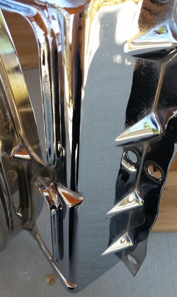

    I'll make a suggestion on your rechrome plans. You need a plater who'll work with you, have it chrome stripped and pick it up. Once back in your hands you have a tedious and somewhat boring thankless job ahead. Your 1st step will be to sand it smooth, almost block it like primer or filler, and see how many of the holes go away. Those that don't go away without digging deep grooves need to be drilled down just a little bit to get to clean diecast. Take it back to your plater and get it copper plated. Not too much, just enough, and pick it back up.
    Now that it's copper plated you can fill all the pits with solder. Look for the older "good stuff" that's at least 50/50 lead/tin. Keep the fills low and be as easy as you can with heat and flux. Now you can sand those fills flat and pretty as well and it's ready for another copper strike and final prep/plating. If it gets wadded up with excess copper it won't go back together as the parts won't fit right. I'd estimate you'll have 20+ hrs in getting it right, and yet without that work those pits will come back like a fatal attraction girlfriend. Nice score, and a perfect addition to your project.

    Great score! For a minimum investment, you have a lot of options for what to do with it. You are so lucky to have something like the Pomona Swap Meet available to you. We here on the East Coast have Carlisle, which is twice a year - April & October - and has a lot of **** like clothing, jewelry, models, cheap tools, junky parts, and some good stuff, and Hershey, which is better but only occurs once a year in October - the week after Carlisle. Luckily for me, they both are only about one and a half to two hours away from my location. Others travel much further, especially to Hershey. People come from all over the world to attend that event.

    thanks for the tips highlander, I was worried about some of the pits. but yea for 100 bucks I scored, now to find another to make a pair and find the 59 bracket for it if I decide to keep.

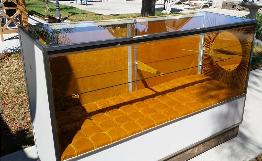

    I got a package in the mail today. you know how cars have a display piece where it says the name of the car, this will be mine im going to metal flake it and paint it same colors as the car and put "Christine" in gold leaf or flake along the side and display on the front of it at shows
    huge, over 25 pounds and 4 feet tall

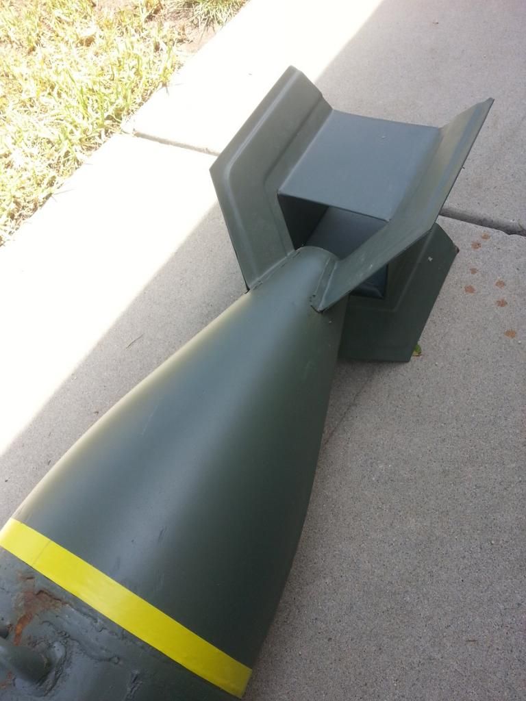

    not a repop its a WW2 100 pound practice bomb, exact to its live version
    grinding it down today im going to have some fun with this. got airbrush paint to airbrush a pinup girl on it and I already have the flake

    Excellent score with the Trailmaster spot; That's the true fun of a swap meet; sometimes you get a real bargain; the guy who sold it to you also thought he got a good sale, and he did, except that he was at the lower level of the food chain.
    I'd love to have a pair of Trailmaster spots but I don't! I do have a pair of Nu Vue spots NOS in the boxes perfect condition, but not as desirable as Trailmasters.
    Your Trailmaster looks pretty good in the photos and even with the small amount of pitting I sort of think that it would be ok to keep it original and not rechrome it because once that is done a certain amount of originality is gone.Just another way to look at it.

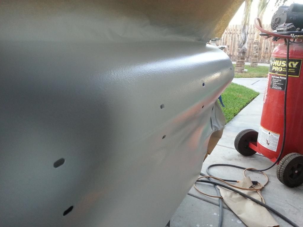

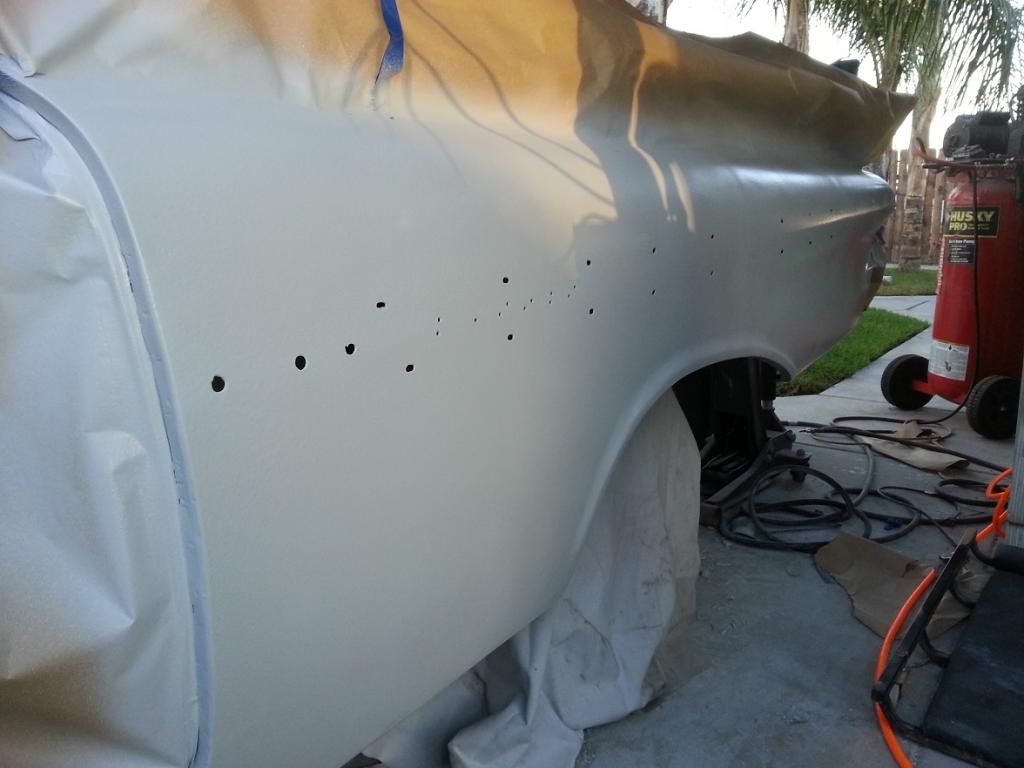

    got to work today, keep lagging cause its so damn hot but finally got one side primered and sealed
    my rockers are perfect, guy that sold me the car wasn't lying when he said all the metal was good. used as little bondo as possible, mostly skin coats. treated the metal with metal prep and shot the high build primer
    lays like mud, its a new primer im using that's 70% solids. mixes 4:1 for high build primer, 4:1:1 for regular primer and 4:1:2 for sealer. its supposedly really good, I asked the guy whats the best stuff he has and said he sells this one more than the 5 star which I thought was the best
    now ill let it sit over the weekend and Monday start the other side. hopefully by this time next week have both sides, the back, door jambs and firewall primered and ready to spray saturday

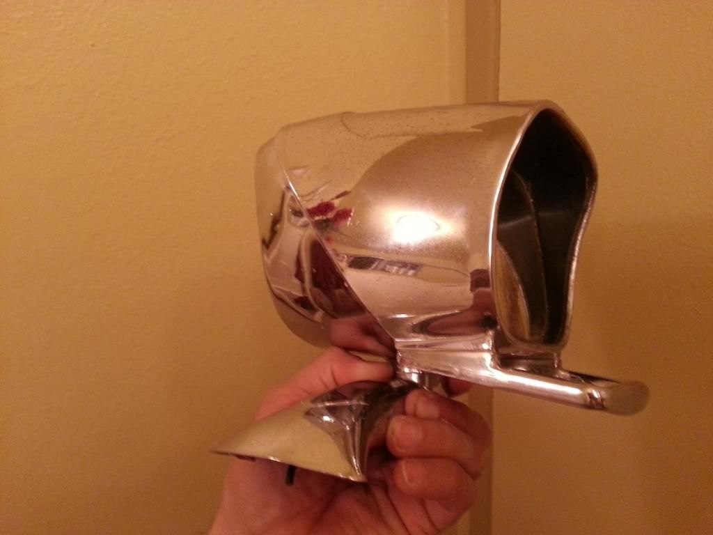

    hey john, been busy haven't worked on the car I got some things going but busted this out. I got a thing for original dealer and promotional items, accessories too. but had nowhere to display them I just had a cabinet I threw them in. so I found this on craigslist
    got it home, wasn't looking pretty
    **** that. 2 days of work here it is now. tried to take pics as best I could damn glare off the gl*** made it hard

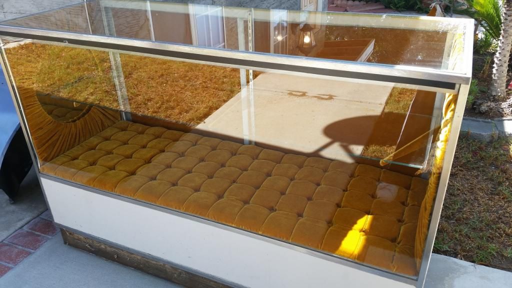

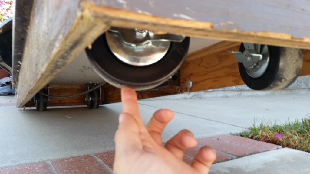

    put wheels on it I can push it around with my finger
    and has a big light to show whats inside when its dark
    rolls around just fine

    heres some more pictures, sun went down a bit so the glare off the gl*** isn't as bad
