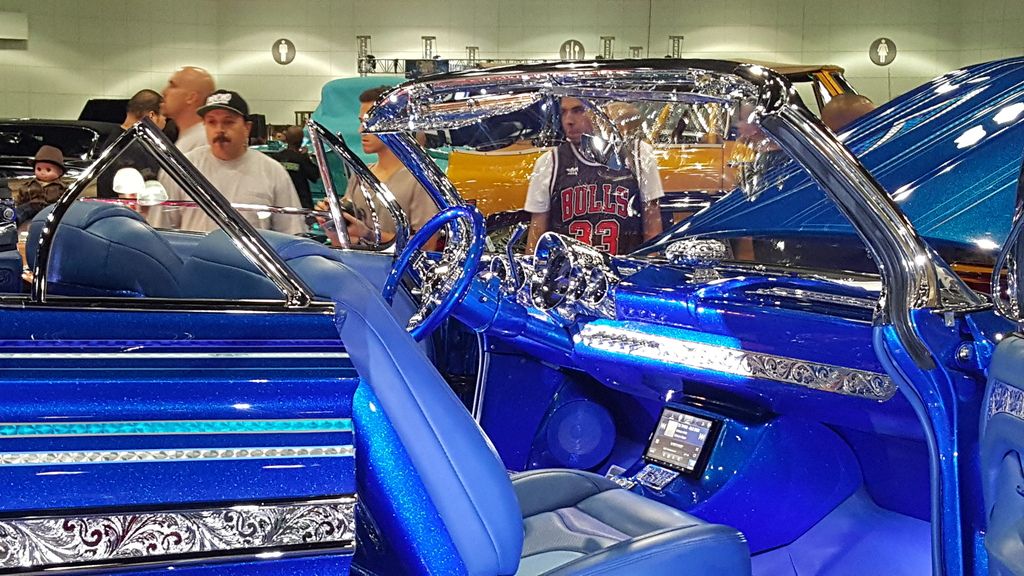

    that last picture are personal friends of mine, I go out to party with them we went to this show in LA. but now you see why I don't chose to compete, these guys would kill me.

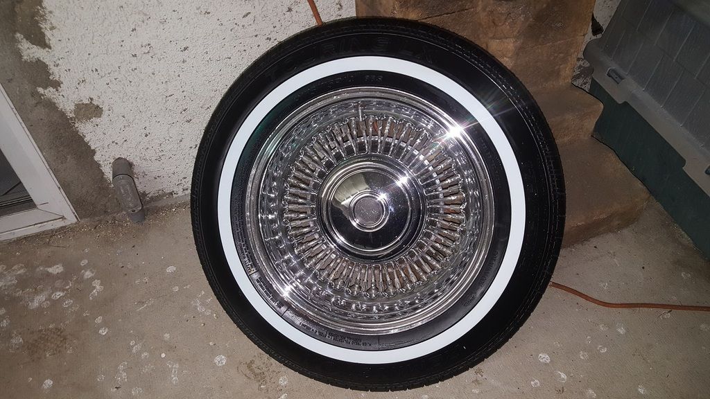

    and as for those tires, those are premium sportway 5.20s, they make them again. super small tires, they pump up just a bit more like this
    believe it or not its a very strong tire. but its what allll the top cars had. its the tires used in the 70s and 80s but back then they were 15 bucks each, now they are 650 the set of 4. before you put them on, you have to let them sit in the sun with coke cans widening them up a bit to mount the bead on the rim. once the bead is on its on pretty tight the psi rating is 50.

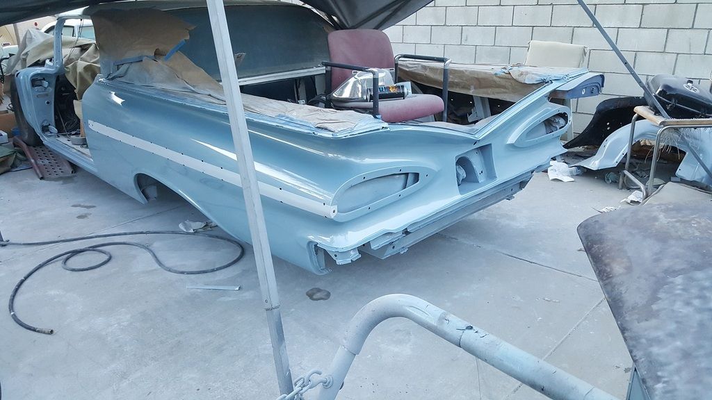

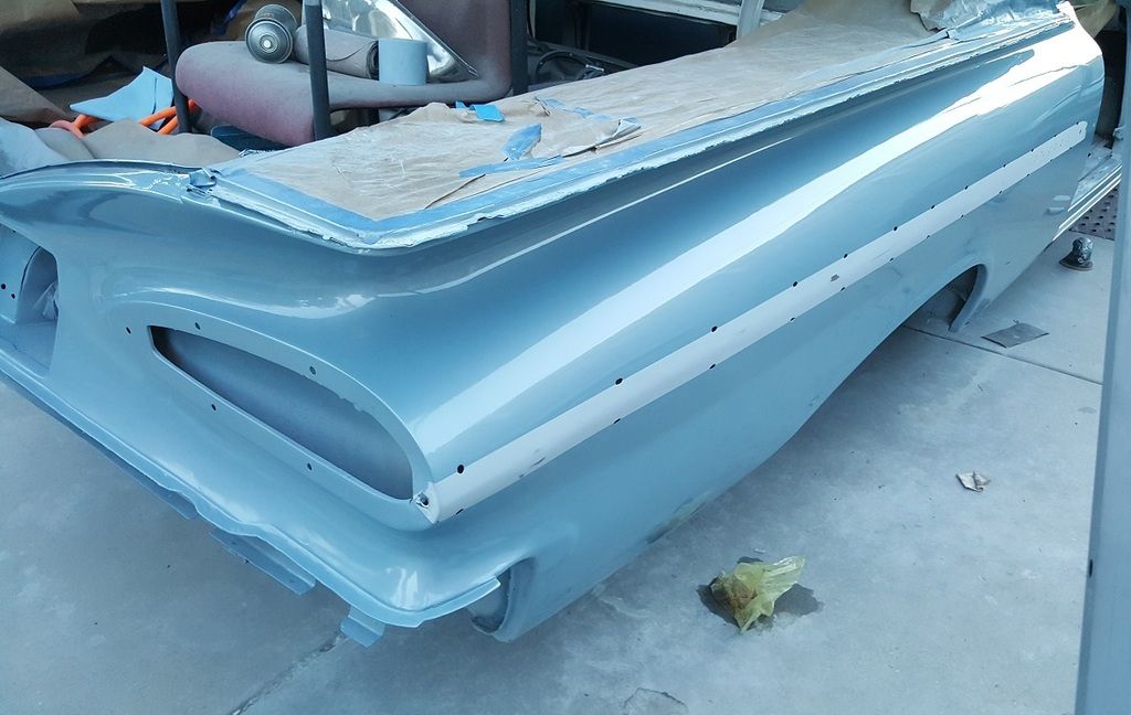

    i got set back a day, plan was to wet sand primer with 600, spray sealer, spray base coat then spray clear coat on the same day. well I started early, sprayed the sealer, **** only made me have to start over. it sprayed with alot of texture and orange peel. sealer isn't supposed to be sanded you spray it wet then an hour later spray the base coat directly on the sealer. I couldn't the orange peel and texture would have shown through the base coat even after I wet sand and buff the clear. so I had to spend the day and go back and block it flat. but its cool tho, nothing wrong with a few more mils of primer thickness

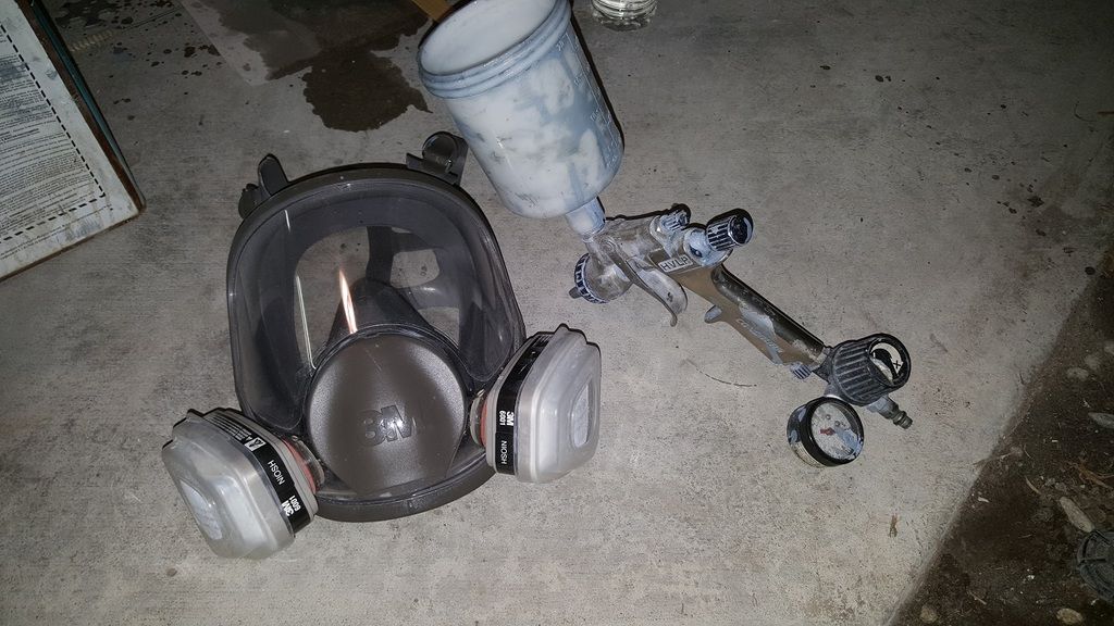

    after that, got to work. put my gun to work and busted out my mask. works good to keep the fumes from going in your lungs and out of your face but makes it hard to spray, you cant see that clear out of it.
    but ill post pics after its done. so far so good

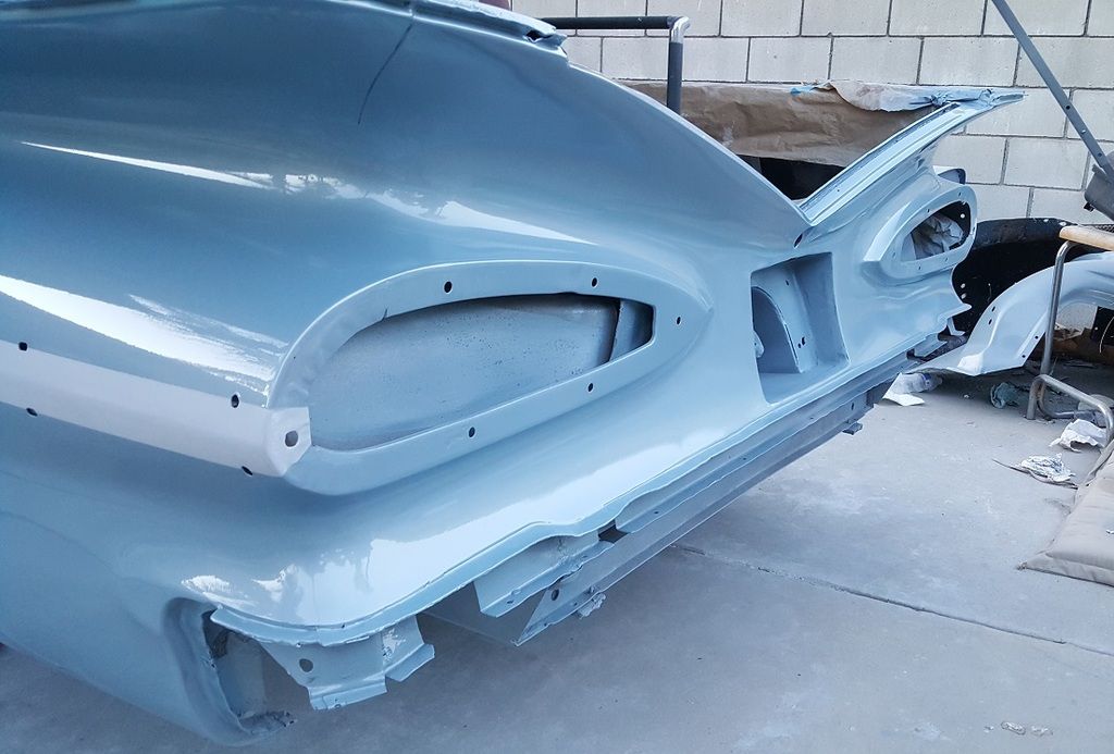

    ****. couldn't wait. here you go. still needs white metalflaked stripe on the side, busting that out tomorrow. o and this is BEFORE wet sanding and buffing, doing that Friday paint will shine like its wet

  22. loudbang
    Posts: 40,351
    Some fine work you are doing paint looks outstanding.

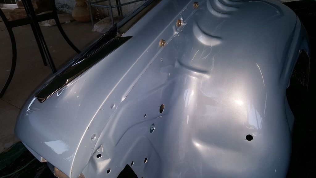

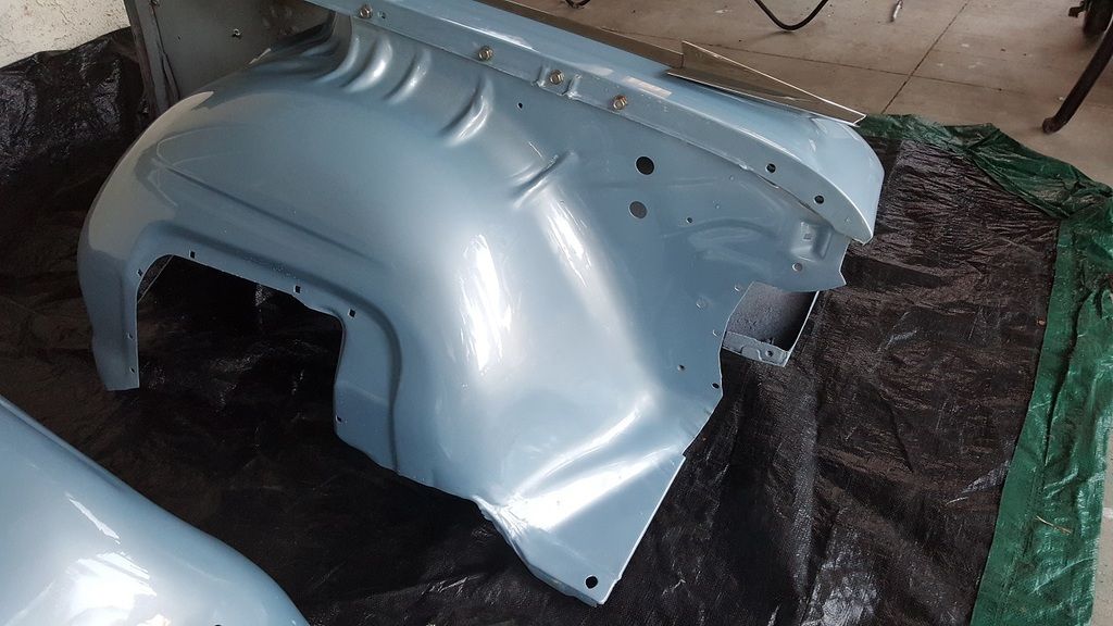

    thanks guys. I'm a beginner, first actual real job I got my practice on 2 stage from doing my fenders so I was ready for the body, well I thought I was I took that leap of faith and looks like I came out ok. people that came by said bs I done it before, but I haven't. yes I painted my 65, but didn't clear it didn't know how to shoot and cut/buff clear. yea I painted my 48, but how hard is painting flat, goes on wet, dries flat so what can go wrong? and yea I painted this one the first time, but again was scared of ruining it and starting over so I put on clear so thin you could scratch it off with your fingernail if you tried it. I got the hang of clear coat after I did my woodgrain dash and outer windows on my 48, so now was able to pull this off. but I was asked what made me come out ok on my first job. answer is simple. besides good body prepping..
    a good gun.
    a good gun can make a beginner spray like hes done it before. what makes a good gun, and is the difference from a cheap gun to a good gun is simple, atomization. that means it breaks up the paint good from fluid into very tiny droplets. the spray pattern is even from top to bottom kind of like if you blew mist or smoke on the panel so it lays down nice 100 percent even and flows even when it settles on the metal. a bad and cheap gun spits, doesnt atomize good so the spray pattern lays in chunks that is thicker where the drops fall and thin where it doesn't after it flows out. so not only does it give you horrible orange peel but has light and dark spots in the spray pattern and because its not even it causes tiger stripes in the paint job.
    with a good gun, all you really have to worry about if you get down how to run the p***es, 50/50 overlap sometimes 75 overlap, 6 inches from metal, and steady even movement is just not dripping it. you can drip a bit the clear coat, you cant drip basecoat if its metallic. and spraying metallic get down how to fog/drop coat the last coat and you even it all out. not hard trust me. a good gun makes it all easy and makes you pull the paint job off. a good gun works at 6cfm to 14cfm. the only low cfm gun i know that you can run off a 110 home compressor is the one i use the concours from eastwood it runs off 4cfm and now they have a concours pro thats 6cfm. cfm is the amount of air the gun uses to break the fluid to droplets, cubic feet per min. i see it this way, if youre paying less than 150 bucks for a gun, youre getting a cheap gun and you get what you pay for. a good gun is from 150 bucks all the way up to 700 like the iwatas. but yea, I'm very beginner but thanks. not perfect but I'm very happy with it, 100x better than the old paint job
    still waiting for the clear to dry fully. might work on my doors, they are horrible I let them sit and not rot but look ****py. o and put the inner and outer fenders together

    gallogiro
  25. loudbang
    Posts: 40,351
    Look better now than when they were brand new.

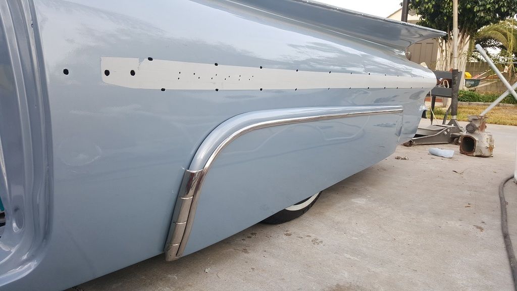

    changed out the wheels, put the tru rays on. some guys at the tire shop remembered them from older 70s 80s corvettes. but boy did it drop my car
    still needs 59 spinners and the ports and stars on the skirts, and paint the white stripe on the body to put the trim back on, but you get the idea. and o yea I finished repainting the skirts
