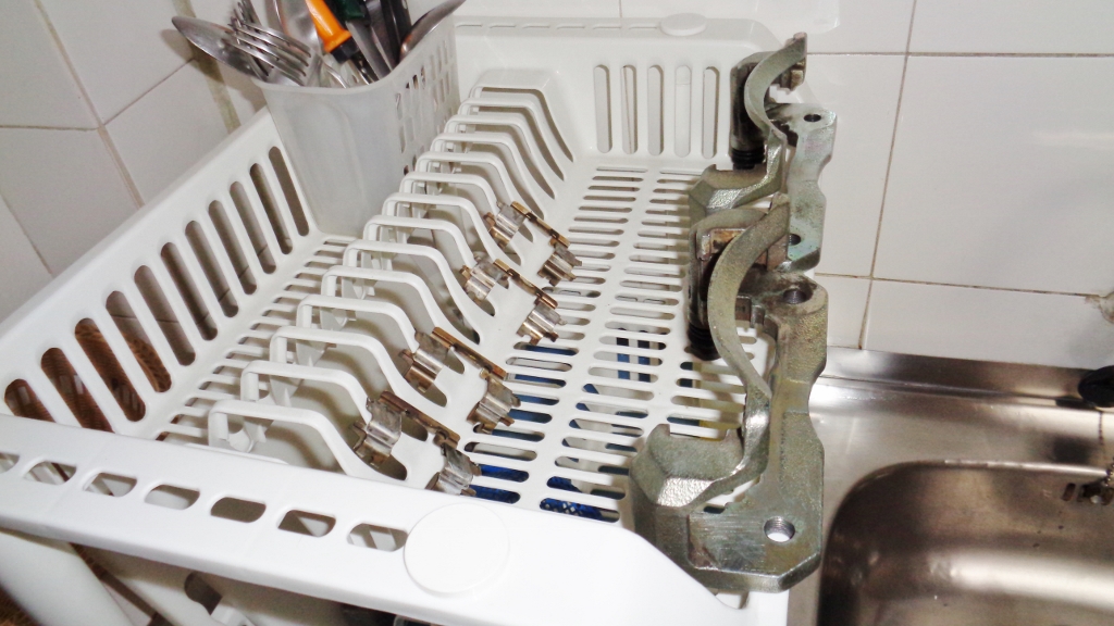

    Was washing some OT disc brake brackets and wave springs in my kitchen sink today and though of you guys. All nice and clean drying in the dish rack next to the knives and forks LOL. I can do it at my leisure now that I don't have just one permanent woman in my life once again. :rolleyes: The ones that come and go at my house don't care what is in the sink. :p

  7. THAT would get me KILLED at my house !!! but I think its cool you can do that. LOL

    A friend had an old dishwasher hooked up in his shop building, hot water and cascade dish soap does a great job on car parts. Dont recommend it in the kitchen.

    thats actually what I was thinking when I saw that pic lol steaming parts to clean them lol. I never got any issues with parts in the house as long as they didn't get in her way, she knew its a part of being with a car guy. she just questioned once why there was a tub of fast orange next to the soap and shampoo. I told her its because they haven't bottled it into a bodywash yet which I wish they would. she has yet to use any of it even though I'm sure it "exfoliates" great, I mean we look like we could be on the cover of magazines right?

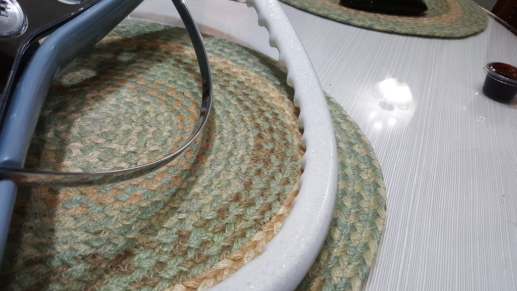

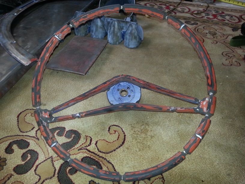

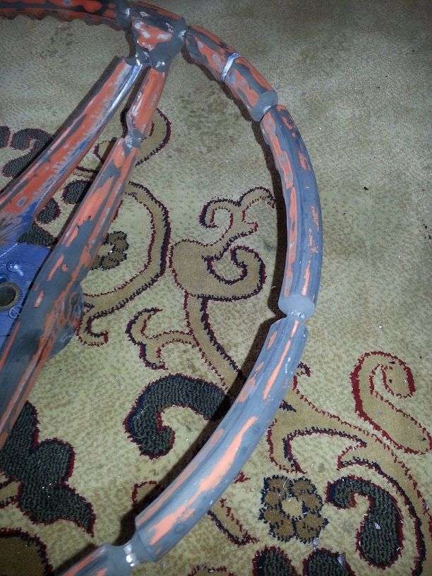

    still working on my car, a bunch of minor stuff this being one of them, I wanted to post it came out nice. before and after pics, missing chunks not just cracks I had to fill and shape with epoxy. now matches the dash and body, white metal flake matches the roof and trunk

    Great save on that steering wheel, it was pretty far gone and now it looks great. What epoxy did you use?
    1959Nomad likes this.

    thanks guys, it looks really nice in person because the pictures don't really pick up the pop on the metal flake or the sparkle of the clear. **** i think the steering wheel i going to be the nicest thing on the car =b I'm getting a better camera soon so itll take better pictures. that steering wheel was pretty much a throw away already, but besides me trying to see if I could restore it I did it more because certain things I wanted to keep together with the car and not replace and those things are the steering wheel and seats. reason is because that steering wheel is original to the car when it was made, so it spent its whole life with it meaning the history on the car goes just a bit deeper. if the original owner got in the car she would be sitting in the same seat and gripping the same steering wheel from when she first got in it to test drive it back in 1959, get what I'm saying. others wont really care or know, but I will. I'm the second owner, original owner p***ed away about 2 years ago but would have been nice when its done for her to see what her car turned out to be I'm sure she loved it since she kept It since and barely let it go. I will get in contact with her family so they can see it when its done, they live about 4 hours away in Arizona so when its done and I go to a show in Arizona ill make a stop there
    redoing the steering wheel wasn't hard but was a process. you HAVE to use epoxy and not body filler to reinforce especially if your car doesn't have power steering. from regular use the body filler will give out and crack from all the twisting and pulling when you make sharp turns. epoxy wont give out. I used regular six dollar jb weld epoxy putty that comes in a tube, had it left over from when I resurfaced the shaft on my 48 yoke that had knicks. I used the general purpose one not the plumbing or the waterproof one. used a metal file to do a lot of the shaving/sanding and the tight corners and curves 120 to 150 did it but was mostly used as a base to reinforce and fill the gaps but being that its putty I came pretty close. mix a bit and do a crack/gap at a time if you rush doing more than one at a time youll have limited time for each and will harden before you can mold it just right. being reinforced then you can fill the low spots with body filler its fine to use then trust me now the steering wheel gaps/cracks are solid. shape it into the crack or chunk missing and try to sculpt and mold it. if you go alittle high youll have to sand flat, if you go low then you can use a bit of body filler. you will be able to feel with your hand by sliding it across the wheel and curves when you got it just right. when you have it all even then seal or primer and spray. generally vintage steering wheels are some kind of hard rubber encasing a metal ring so you have to be sure you lay a good amount of primer or seal good, I can imagine rubber bleeding through to the paint if the reducer in the basecoat hits it kind of like when the rubber bleeds through whitewall paint on tires. takes patience but isn't hard, I did it while I was in my living room watching the simpsons

    oh, and use a popsicle stick or tounge depressor to help. the flat part of the stick will help mold the flat parts and the round top will help with the round corners and finger grooves. tap into shape don't drag. low spots will be fine you can fill them with body filler. you don't have to get the finger grooves perfect, you cant tell if they are perfect or off a bit you cant see them unless you stick your head behind the steering wheel. focus more on the flat parts going on to the ring and the groove along the face of the wheel ring
