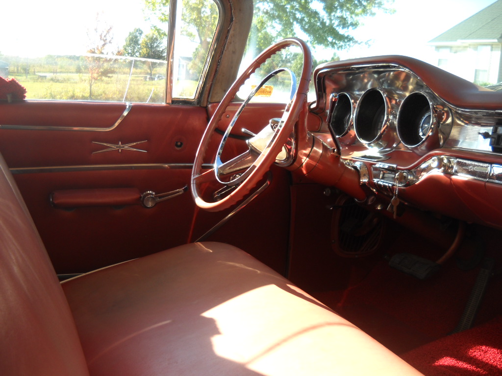

    I was sick a couple of days last week and got a little behind but I'm back on track I think. Got all the floor sections welded in, ground down, and seam sealed. Hit em with a little etch primer and the some rust encapsulator over te other decent areas. Got the molded carpet in today. The molded areas for the rear wells were not wide enough. Made it a mess but I got it sorted out enough for a driver. Sill guards tomorrow and then probably some door panel work.
    Also looking for soem seat covers if anyone is holding some. ;)

    Looking good! What did you buff it with? How did you clean the dash ?
  23. BurqueBulli
    Joined: Jun 11, 2009
    Posts: 292
    BurqueBulli
    Thanks! Buffed it with wool pad and 3m compound. Once I'm done I'll go over it with 3m machine polish on a foam pad. The dash I just rubbed out by hand with the compound. I'll probably end up painting it.

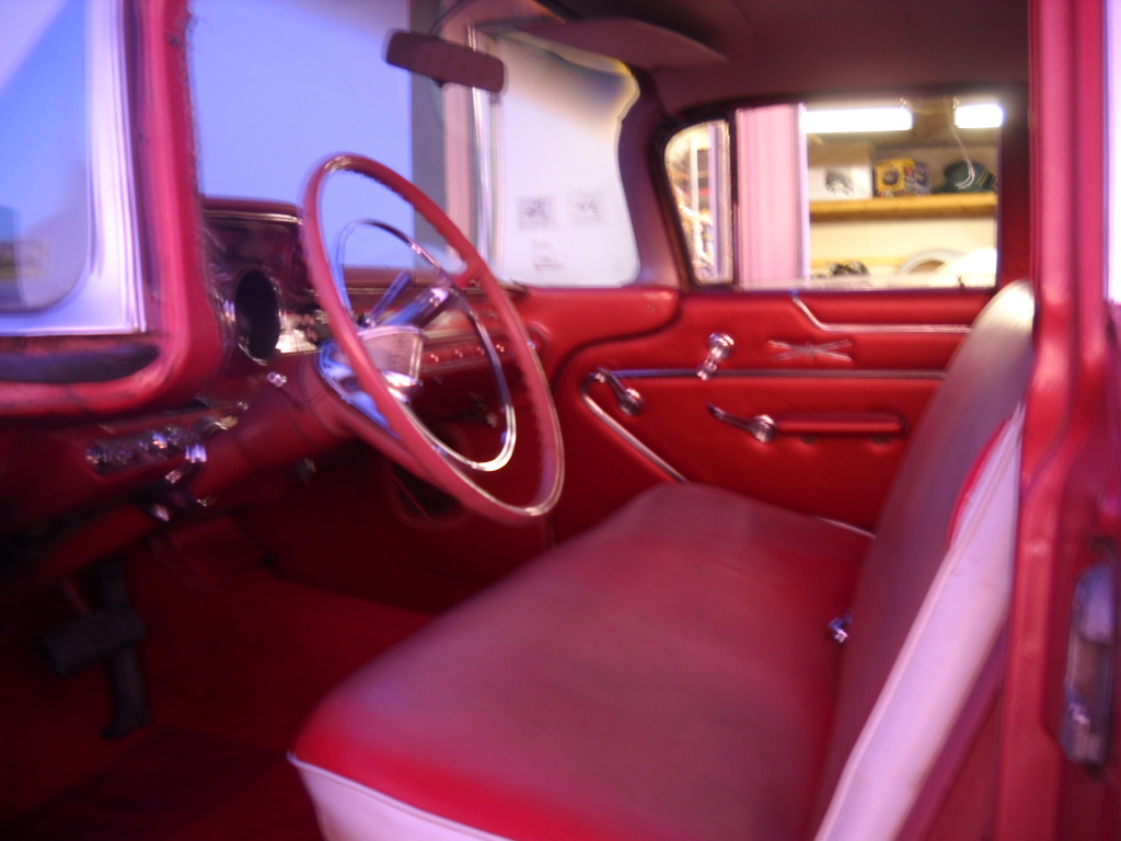

    Door panels are warped an the material is dried out an torn up. Time for new. Couldn't get an exact match but it blends well enough. Hey - it's just a driver! :)

    All four doors done as well as both b pillar upper and lower pieces, kick panles, and c pillar fill panels. I really wish I knew how to make seat covers. Hey - did I mention I'm looking for a set of seat covers????? ;););)
    The shop is a wreck!
