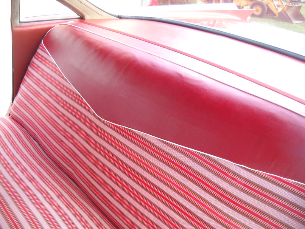

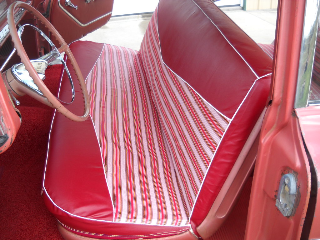

    Seat covers are on! They're period correct anyway and do make it look a little cleaner than the worn out og materials. A little time in the sun and then I'll use the heat gun to tighten them up.
