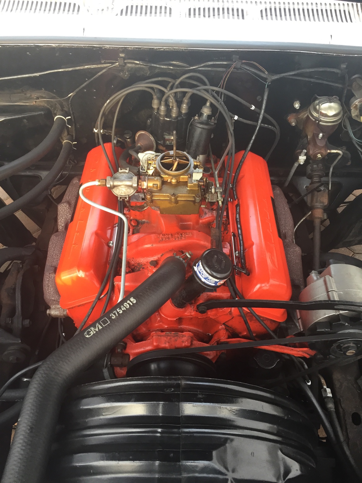

  1. Looking into what I can to to get some more performance out of my stock 283. It's the 195 horsepower/ 285lb/ft model, all original except for a dual exhaust with a Rochester 2GV carb. Just curious to see what can be done to wake it up a little bit but I still want to either keep a stock look or a period correct hot rod look. Any ideas or help is appreciated and links to parts would be great! Thanks![​IMG] [​IMG]
  2. Well I can tell by the pics that it already has the power pack heads, so the simplest way is a cam shaft and 4 bbl. Looks for a stock or close to stock high performance cam shaft and a single 4 on a dual plane intake. That won't make it a "high performance" engine but it should give you a pleasant bump in performance without going into a complete teardown and build.

    +1 on Beaner's recommendation - you're probably around 9:1 compression - maybe an "097" solid cam or a "L79" cam (or a modern profile of the same) pick an older 4 bbl intake like a c4b or similar so you retain the front oil fill and a List 1850 Holley or 500-600 cfm AFB/Edelbrock - make sure your ignition system is in good shape and curved properly too. Rear end gears can also greatly improve performance - it appears this car has a PG trans too - how about a turbo 350 or 700r4? ........I know you asked specifically about engine mods, but if it were me, I would make sure my current combo was running as good as it could and would concentrate on the gearing (Final drive and tranny) first.

    Totally agree with the Beaner on this..
    That will wake it up nicely..and not a lot of $$$
    Lots of threads on here about this...
    I love the little 283's....
    I went a bit further and went with a .60 overbore, 305 HO heads, L79 Corvette Cam (350hp) Edelbrock Dual Plane manifold with a 500 cfm Edelbrock carb, Corvette 2 1/2" Rams Horns with full 2 1/2" exhaust, electronic ignition..and a few other things.
    With my four speed manual trans it is a very pleasant and spunky little small block to drive..
    I have a Saginaw with a 3:11 first gear, and a 3:73 rear end.
    Note I only use a 500 cfm carb...you do NOT need a big carb..
    Good luck and keep us in the loop.. :)

    Think about a modern dual pattern cam nothing to wild with an automatic. I have had good luck with .435-.460 lift low 260's duration. Makes good torque and that's what you need. X2 on small carb, dual plane intake.
    If it is a powerglide it is not going to jerk your hat off from a start unless you change rear gears.

    Realistically, the Beaner's got it covered. Add a little cam, a little carb, duals, fresh tune, you'll be smilin'. Key word being 'a little'. Real easy to over cam/carb these mighty mouses, stock compression considered. If you can swallow the mileage difference, a steeper rear gear as DDDenny suggests, will really wake it up.

    I might suggest as a few others have suggested, a mild hydrallic cam, a SMALL 4bbl carb (500 CFM) an alum. intake manifold and a good tune up with a electronic ignition up grade & coil (use stock GM distributor housing) maybe a slightly better rear end gear say no more than 3:70's and you will actually feel difference. I would not suggest porting and polishing the heads, you MAY improve the performance but not enough for all the effort. and like you said you have never done it before

    Same engine with a cast iron 4 barrel manifold and either a Rochester 4GC or a Carter WCFB had 220/230 HP on who you believe. The heads by that time on the 2 barrel cars were the single triangle over the raised rectangle indicating they were the 4 barrel heads of the 57-up heads. I had that combo in a 53 Chev with a 30-30 Duntov and it was a lot of fun with a 4 speed and 3.55 gears.
    With a Rochester fuel injection is was 250 HP and got phoenominal fuel milage. This combo was the Corvette base FI engine. I did this combo in a 65 Chevelle with 3.08's and a powerglide. My wife drove it for 6 yrs that way. 23-25 mpg on the road and 18 in town. Good luck.
