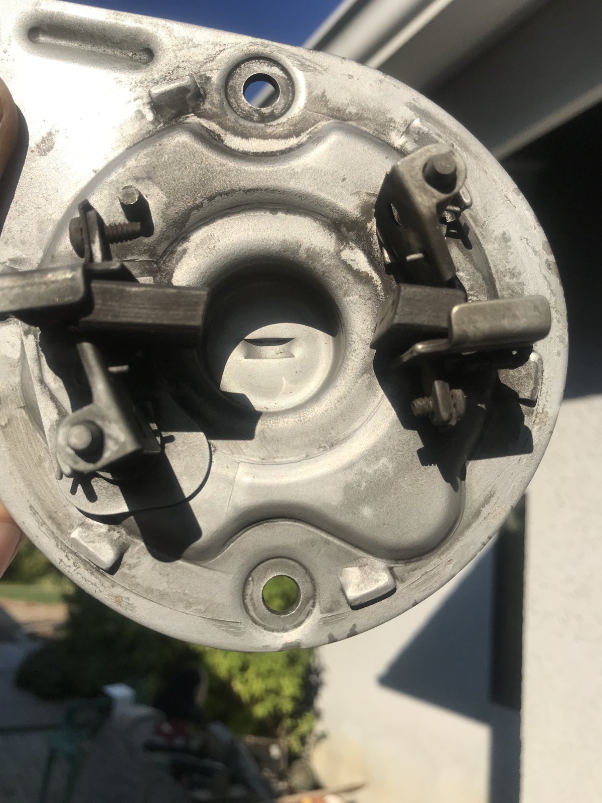

    Folks!!! Thank You so much for your help! Everyone has been very kind! Kultulz, are you referring to the FAS-10139-B number cast into the front housing? If there’s a number stamped into the main body to which the field coils are attached, I won’t find it, because I powered coated it 17 years ago when I last rebuilt it. I know it’s a standard 12V, 30A generator manufactured in late 1962 ( Sept-Dec) but no later than April of 1963. The brushes in it now are two wire, but the brush attached to the Armature post is worn out, in contrast to the brush grounded to the backing plate, which has only minimal wear. The commutator isn’t scored, but it would benefit from resurfacing to maximize contact with the new brushes. I’ll try to send a photo of the backing plate containing the brushes with this reply. AGAIN, THANK YOU everyone!!!! 2C1C3A84-692F-476A-BDB8-250237ADEB98.jpeg

    Folks: This will be my last entry on this thread, I promise! Do any generator experts have thoughts on why one brush is only 20% worn C22640C8-EBA6-41AB-AD98-6037E8D28F88.jpeg C22640C8-EBA6-41AB-AD98-6037E8D28F88.jpeg compared to the correct NOS Motorcraft brushes, versus 51% for the other? Here’s another photo of the wear difference. The bearings are like new, and the commutator has no ridges on it; the latter should have affected the wear on both brushes similarly. Thanks!

    Different spring pressures could be the simple answer.
    I know that in some cases the polarity of the current in a circuit will affect the contacts differently in a switch due to current flow. Another instance could be the capacitance in the circuit, which does affect which side of a set of points will erode, vs the other side of the points having built-up deposits. Maybe one of these could be a more "scientific" reason, but I'd lean towards different spring pressures being the cause.
    gimpyshotrods likes this.

    Ebbspeed:
    Interesting comments about polarity and capacitance! I had my ***essment of spring tension tested by a mechanic friend who agreed that the springs seemed very similar. We also scratched the brush material to ***ess hardness, and they seemed very similar. Regardless, I bought new springs and NOS Motorcraft brushes, so we shall see how it wears in the future! Thanks to all!!!
