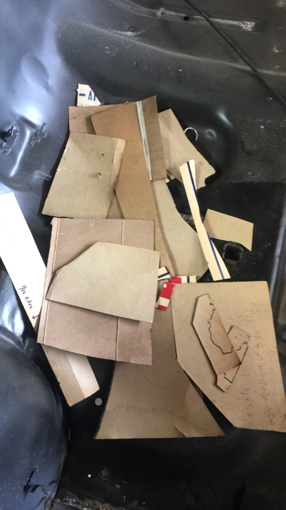

  2. Back at it today.
    I've been saving every template I made so far. Maybe I can sell it on eBay when I'm done. I'll call it
    "1960 chrysler weld-by-numbers restoration kit" LOL.

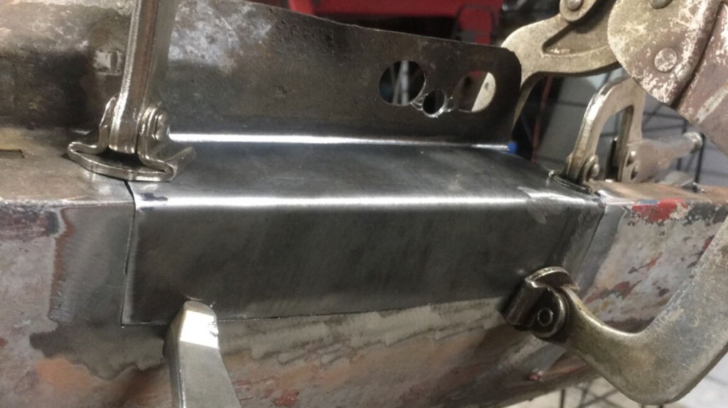

  5. I took it really easy. Ran a few small beads at really low amperage. Virtually no warpage. Slapped it out a little bit. I'm really satisfied with this patch

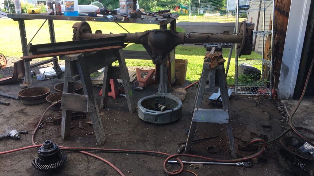

  7. Took a break from the fenders to dis***emble the rear.
    The posi rear has 2.70's in it. The open diff has 2.94's. Good for going 120mph. But I think we're going to swap in a set of 3.55s.

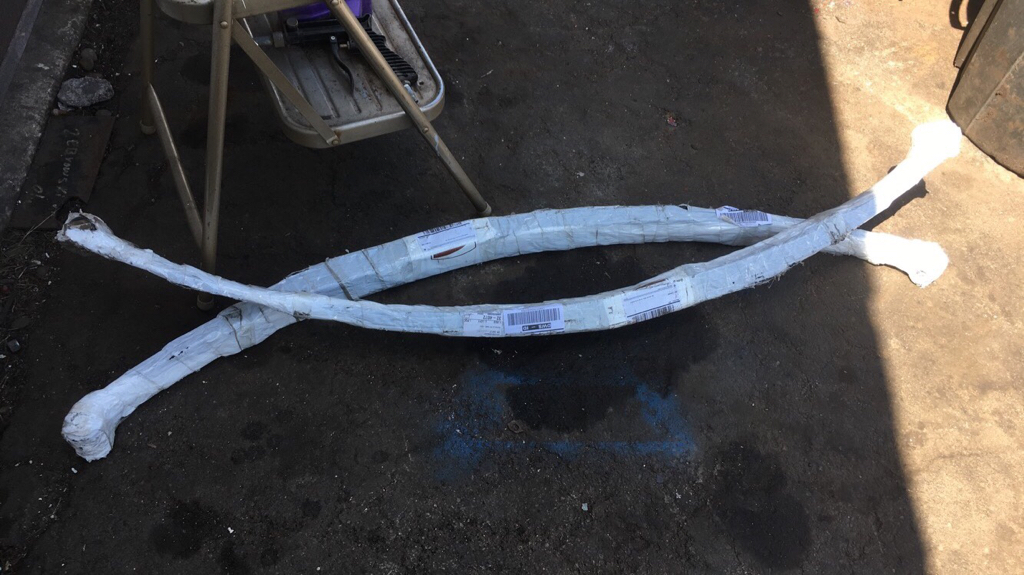

    The springs came today too.
    Squablow and chriseakin like this.

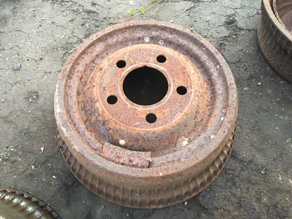

  24. More vinegar action. That's about 24 hours.
    These shots are from electrolysis.

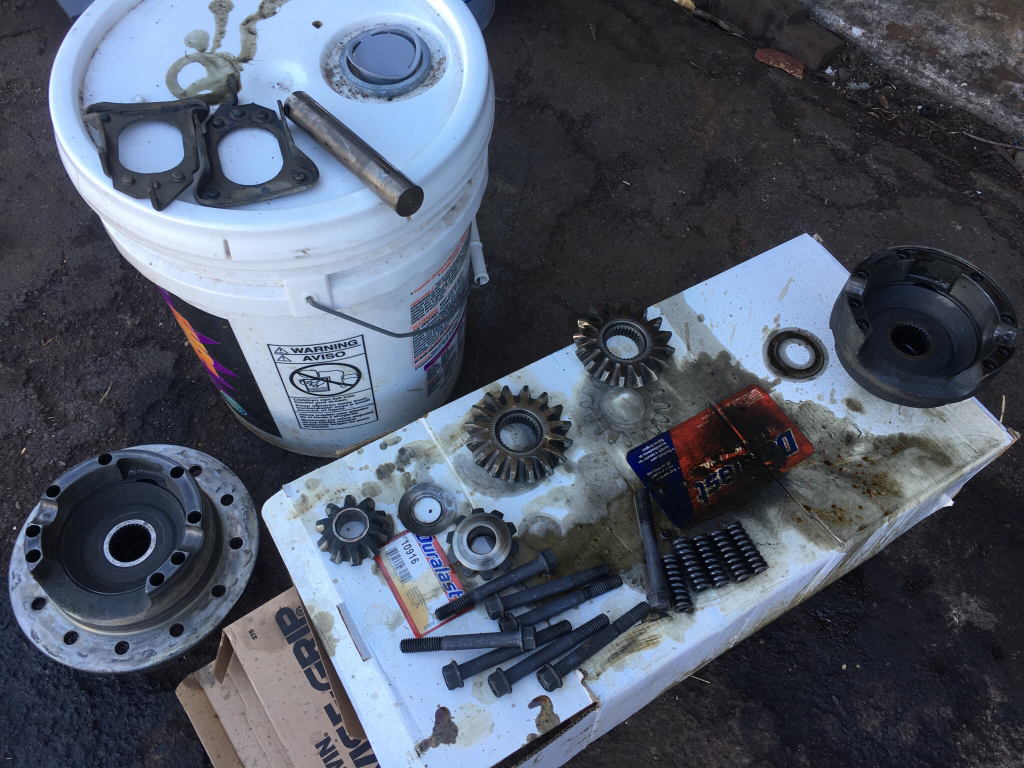

  25. "Sure-grip" dis***embled and cleaned.
    Some wear on the teeth. I'm going to run it. I think it will be fine for how much driving we will be doing.
    Anyone ever take one apart? There's no clutches. I can't really tell what to look for as far as wear to make sure it will surely-grip.
  26. Ah haa! There's the magic. Now it looks like the pictures on the interwebs.
    Duellym likes this.
  27. Past few days have been crazy hot. Finally sat down tonight for a little while and started making the part that goes above the headlights.
  28. The overall consensus on servicing the sure grip is that it's non-serviceable. However I found a few guys who have very successfully did a little machine work to refresh them. Basically I have to put some plastigauge or something under the cone to make sure it's not bottoming out before the cone can engage.
    The one guy who has done a lot of them said he's taken up to
    .100" off of the cones. But it might only need 20 or 30. Depending on wear
