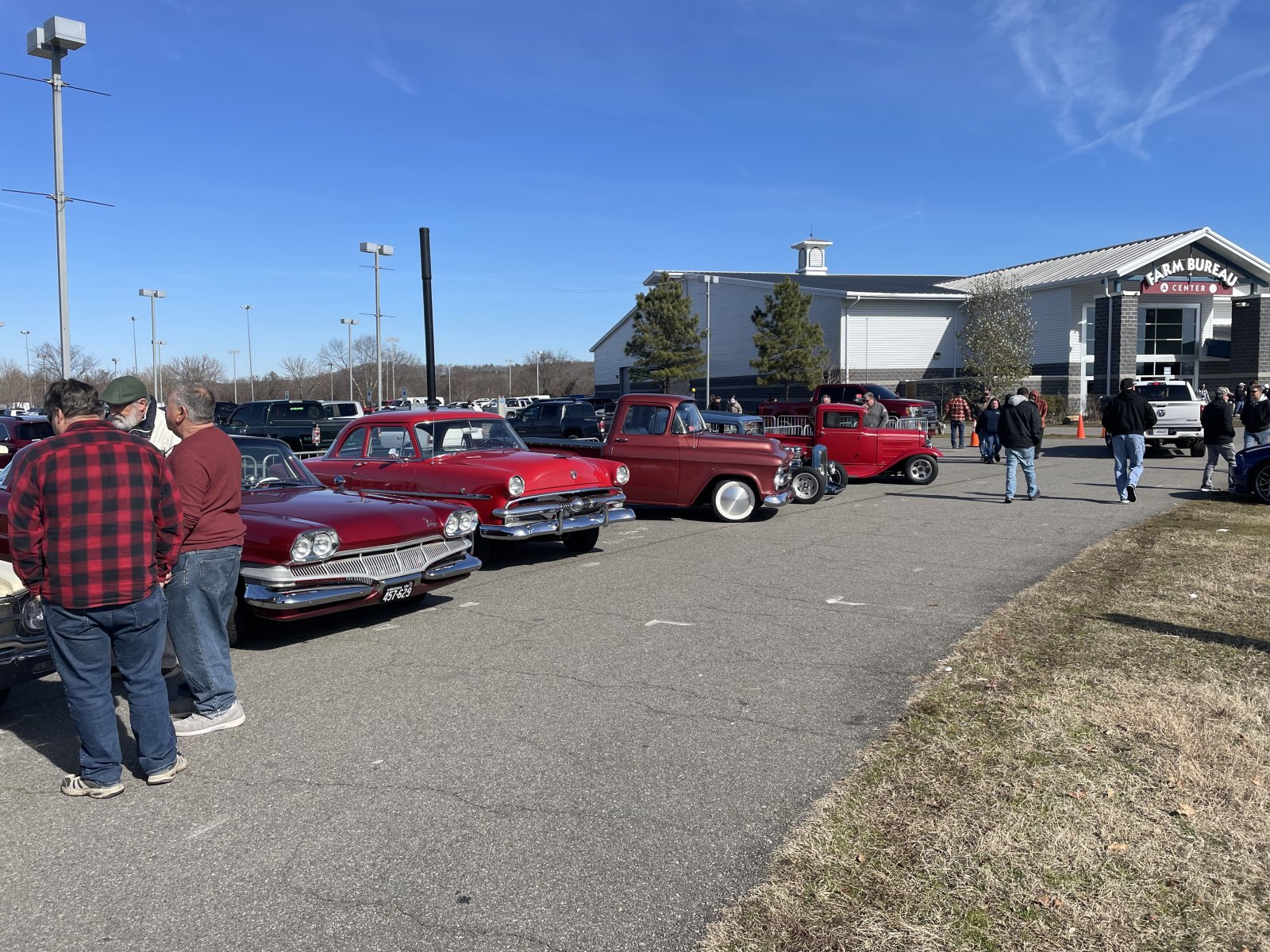

    All good things going on here! There’s a big indoor car show close to here every February. I jumped in on an open invite from The Heaps CC to have breakfast and cruise up to the show. They even arranged preferred parking for us outside the show. I’ve never tried to meet a deadline with this car, but I busted my *** the past 2 weeks sorting out the clutch linkage and working through more of my wiring mishaps.
    Hard work and determination finally paid off and I actually made the breakfast, albeit a bit late ( sorry fellas). My dad rode up with me and we had an awesome time. People seemed to get a kick out of the car, which is cool. I was too busy having fun to take more pics, but here’s one parked up with the group.
    Thanks again to The Heaps for having me and my old man along for the fun!

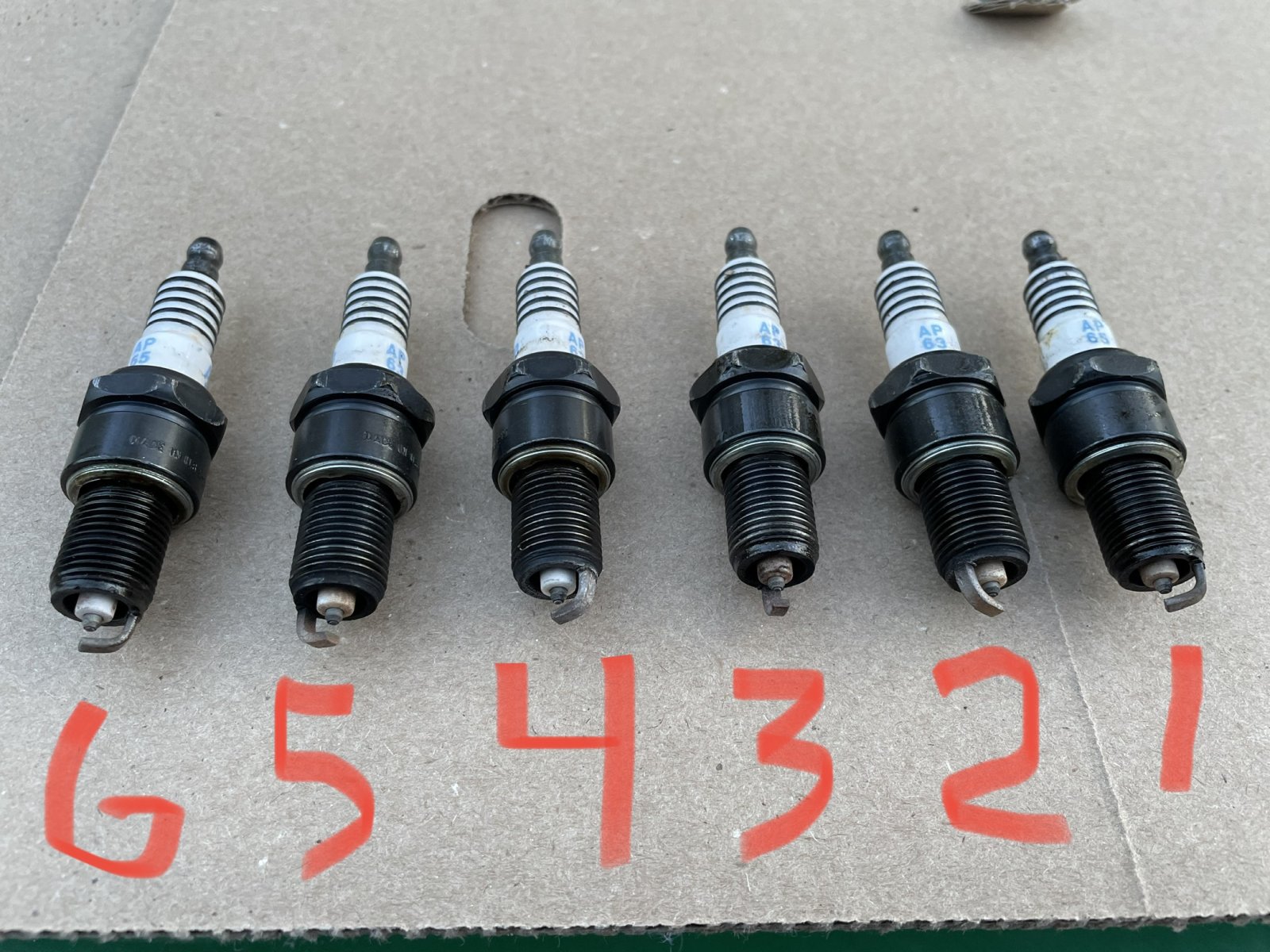

    As it goes with this car, I was fighting with an oil leak, even the day of the show. It wasn’t terrible, but definitely not just a drip. When I got home I pulled the plugs to check out the mixture thus far. Not too bad except check out 3&6. ACD0F160-2C35-4E9F-AC4A-3D228C9D8FBD.jpeg
    #3 has a good bit of oil on it because it was barely past finger-tight. That allowed oil to shoot all out past the spark plug tube. What did I learn here? Always torque slant6 spark plugs to 30 ft lbs so the tubes will properly seal. #6 wasn’t firing at all. Turned out the plug wire wouldn’t clip on no matter what I did. No biggie, made up a new wire today. I guess from here on out it’s just more tuning, tweaking, and test drives. There are other plans for this car in the future, but no need to make changes at this point. If I do any cool trips or find cool photo ops I’ll be back with updates. Thanks everybody for all the kind words and encouragement over the past couple years! I really appreciate it! Seeya round
    Tommy
