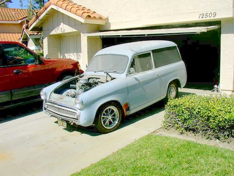

    I was lucky enough to find an absolute rust free example ( with the exception of the L/Frt lower fender) to start my project. Not eactly sure how the outer fender rusted without any trace of rust behind it?? Yes, the pan is the same as the Sunbeam Tiger, and to drop in the SBF all you need are Tiger mounts (available repro) and figure out another steering arrangement. I just opted to go with a custom Mustang II unit designed for a Tiger. Conversion to a sedan delivery was done with 16ga. plasma cut inserts that are mig-ed from the rear, and the outer seams leaded.
