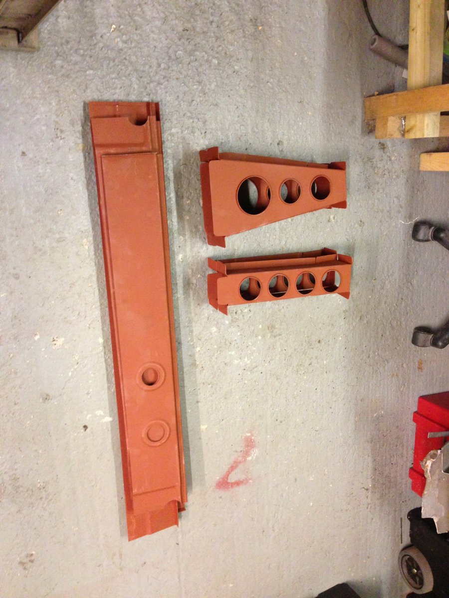

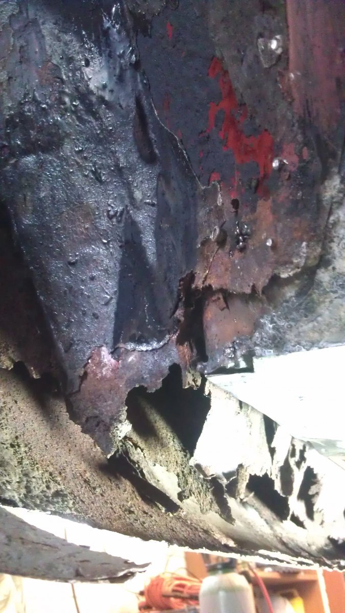

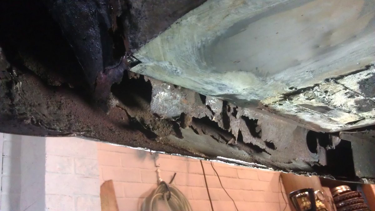

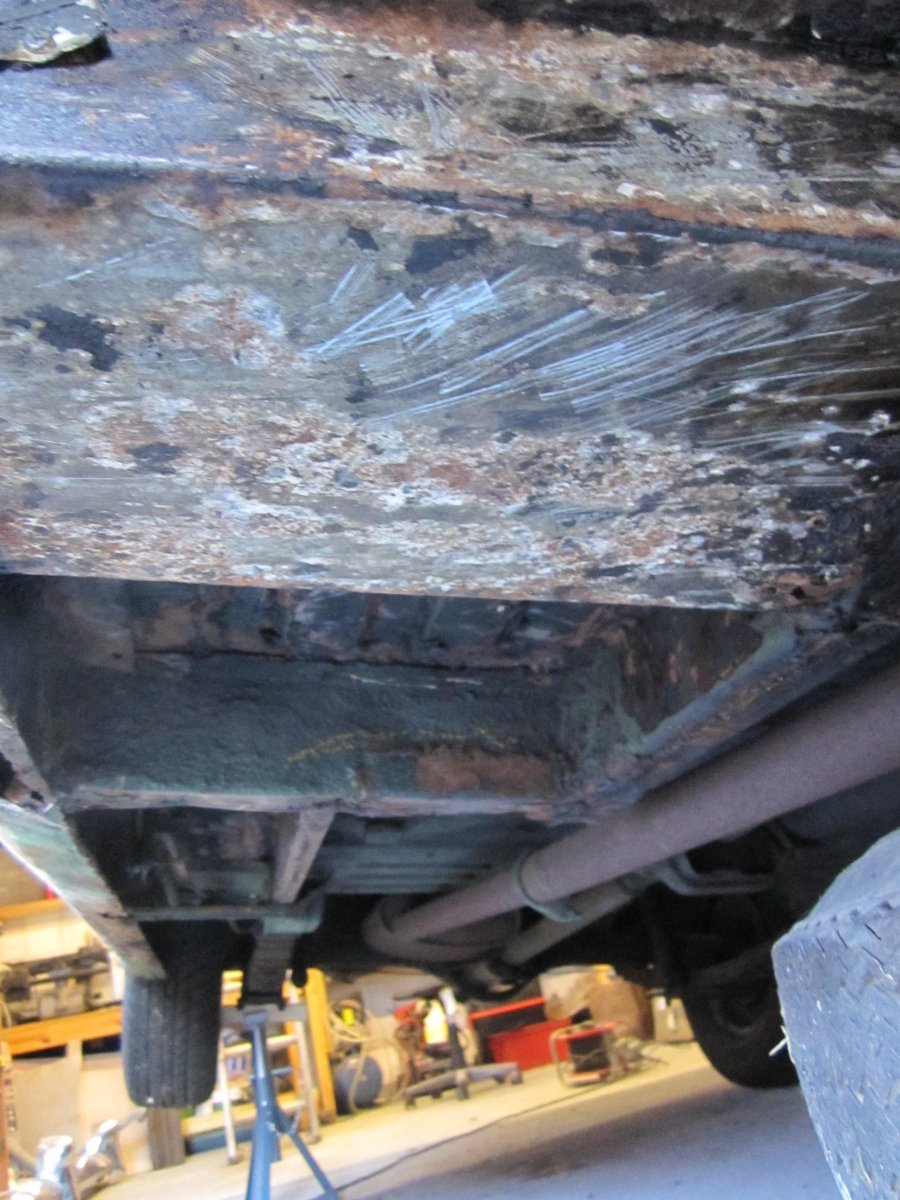

    So, after finding all this lurking behind the hastily repaired inner sills, I decided I needed some help...
    As I've mentioned before - there aren't that repo panels available for these cars, but you can get outer sills and about the time I was contemplating doing this work, I found out about a PVHCC (Post Vintage Humber Car Club - catchy name huh?!) member who had just started remanufacturing inner sill kits with all new crossmembers... I managed to get the first set produced as far as I know
    The kit came with everything I needed (for this job at least) - Inner sill panels (2 parts per side) intermediate sill panels - (2 parts per side) and 4 crossmembers (2 per side). So, armed with everything I needed to replace, I started cutting out the grot!

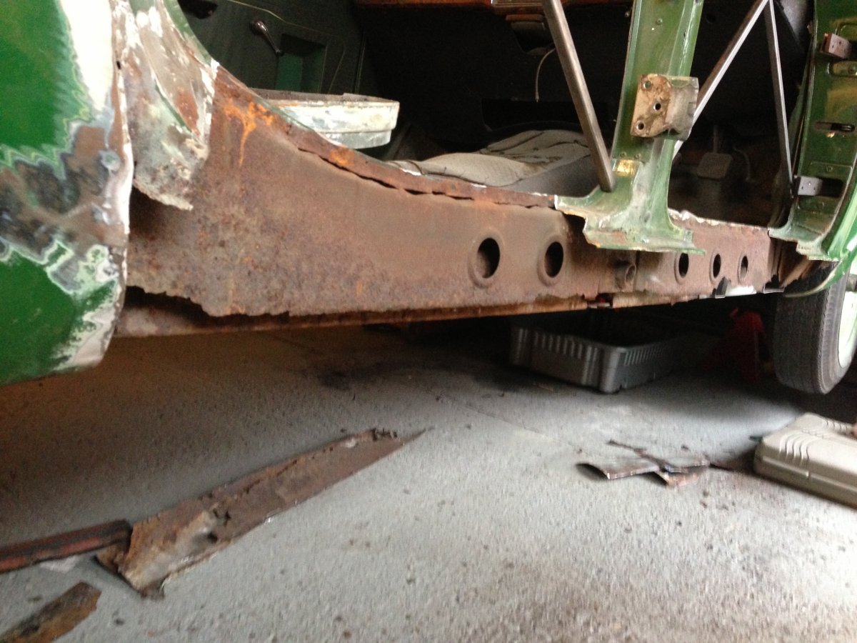

    IMG_3820.JPG Once the outer sill was cut off - I could see what I was playing with... Looks like someone had attacked the rear of the intermediate sill with a hammer and chisel.
    IMG_0067.jpg Before cutting anything out, I made sure to brace the door apertures - Not sure if this actually did anything, but it made getting in and out of the car more entertaining while working on it! IMG_0082.jpg
    After trying to line everything up with the floor in the way, I decided to cut it out for better access...
    IMG_0113.jpg IMG_0115.jpg Much better access with that floor out of the way

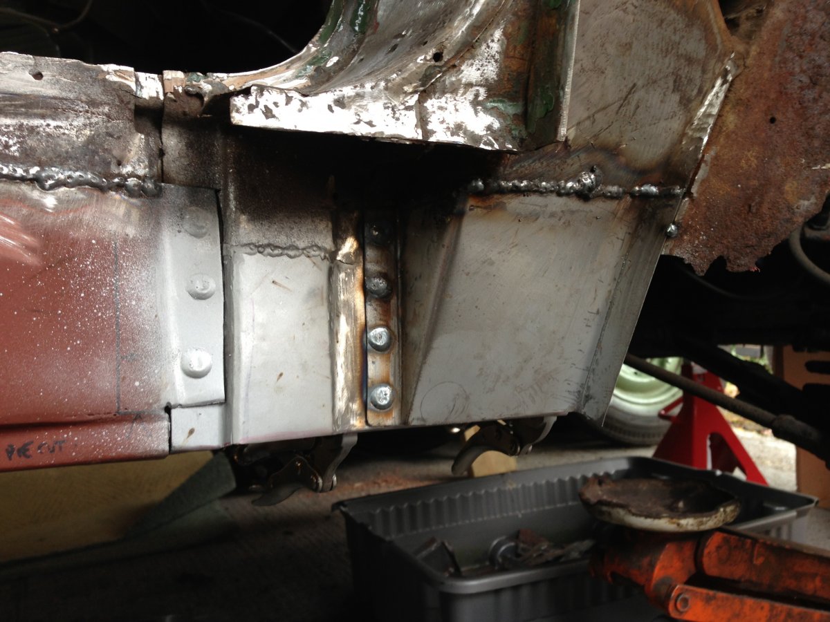

    IMG_0218.jpg IMG_0222.jpg Skipping ahead a little bit - I moved onto the intermediate sill panel. The flanges at the bottom fold together in such a way that they create a narrow box section. I don't know how this thing didn't fold in half without that arrangement in place.
    IMG_0224.jpg IMG_0228.jpg I'm deliberately ignoring the front inner wheel arch at the moment... They weren't mentioned on the MOT, so they can wait for now... The PVHCC has reproduction wheel arch panels, but I'll leave those for now...
    IMG_0226.jpg IMG_0230.jpg IMG_0233.jpg IMG_0241.jpg IMG_0261.jpg Certainly not the prettiest welds in the world - but I kept burning through, so I was at least getting decent penetration
    Rear half all welded into place - the rear was a breeze compared to the front, where I had to fabricate up all the little closing bits and pieces around the bottom of the A-pillar.

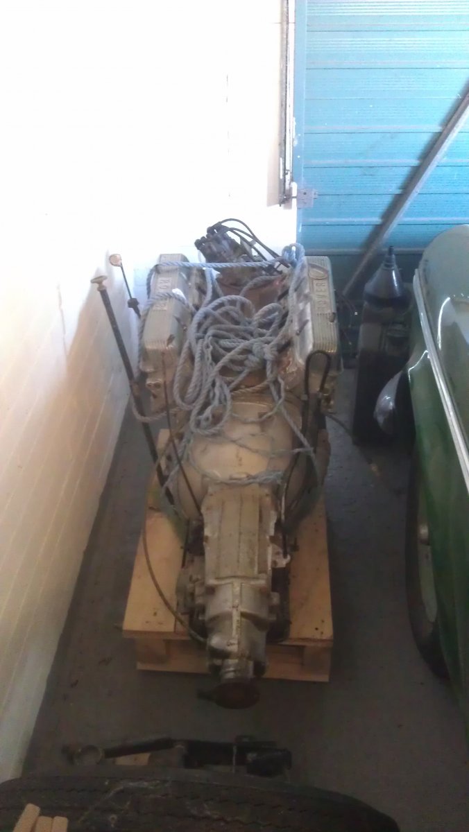

    Oh yeah, and somewhere along the line, this happened...
    Its a 3.5 litre Rover from a P6. Apparently this means it got a desirable short nosed water pump. Also came with an Edlebrock manifold, modified to fit a 38 D/Gas carb (I think they put these on Ford Es*** V6's) The gearbox is a Borg Warner BW35 or 65 from the same car - but they can be found under a load of other British cars of the era too, so it should be easier to get parts for than the Humber.
    I've not decided when (or if) to put this in, but my thinking is that at worst, it'll be a great thing to learn to build an engine on. A refresh at least. Until then, it can sit there looking pretty.
    It does mean that I've got to start looking into things like rear axles (apparently Volvo 240's are the same width - and some had disc brakes too - but these are quickly becoming cl***ics in their own right and fetch good money still)
    Brakes are another thing I've been thinking about. I think reconditioning the system (drums all around) will be fine for the stock engine, but if I put the V8 in, I'd like discs on the front at least...
    Decisions decisions...

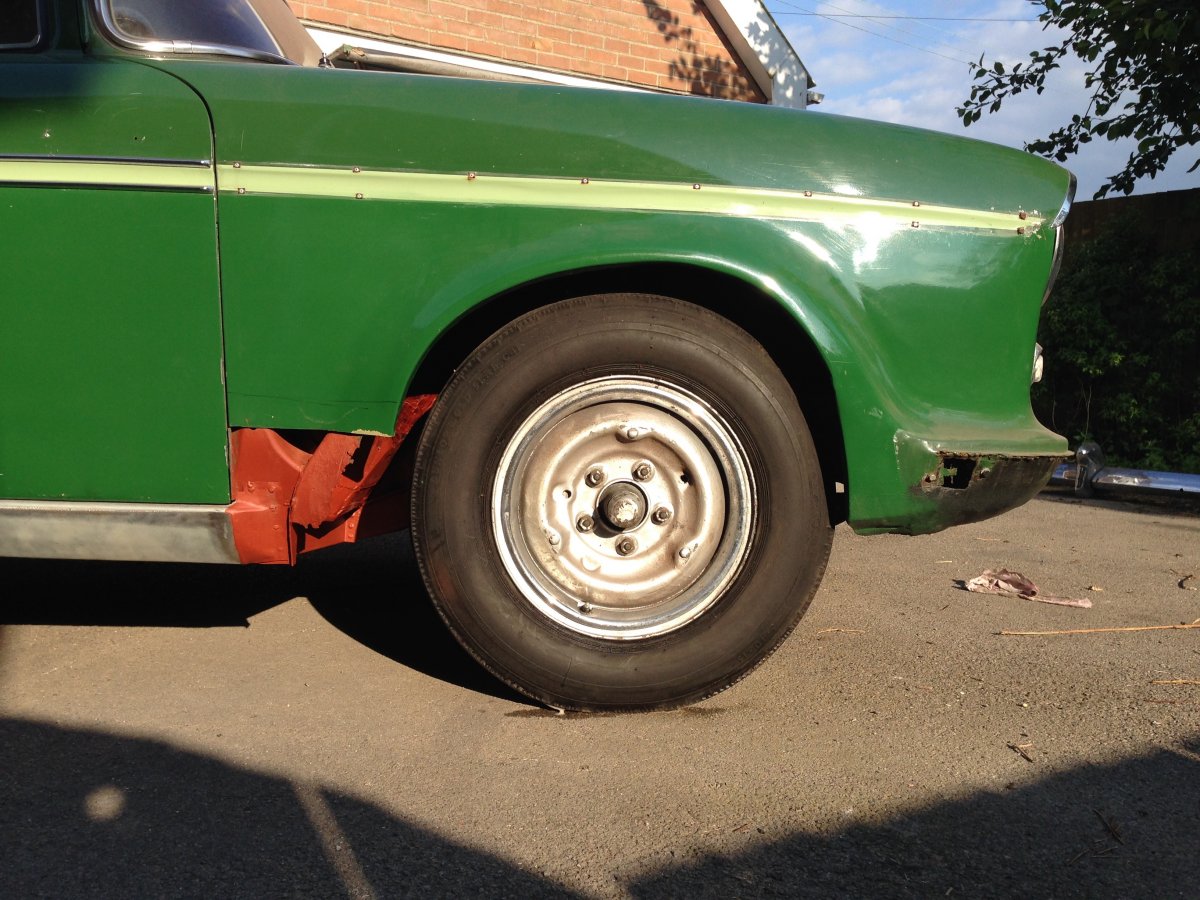

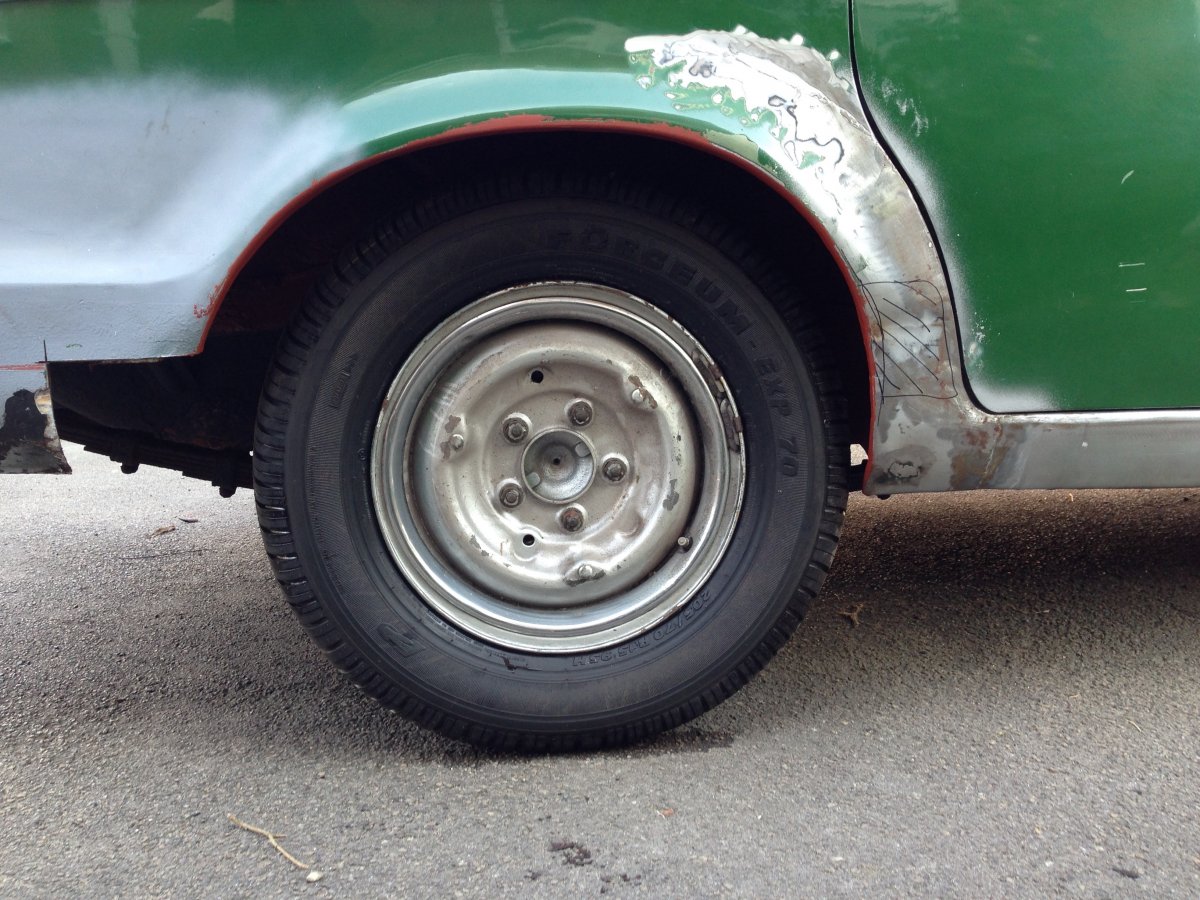

    IMG_1819 (2).jpg IMG_1820 (2).jpg So, these rear arch panels aren't original, and I don't know what they're off, so I've got to decide on whether to replace them, or make-do and mend... At the moment, I like the idea of grafting some VW camper rear arches so it looks more like a 55' Chevy...
    IMG_1838 (2).jpg Front fender needs some attention - but I thought I'd do both sides together at the same time... Time will tell if that turns out to be a good idea.
    IMG_1837 (2).jpg Looks surprisingly straight here...

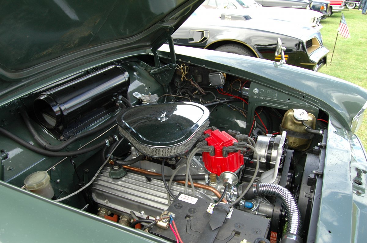

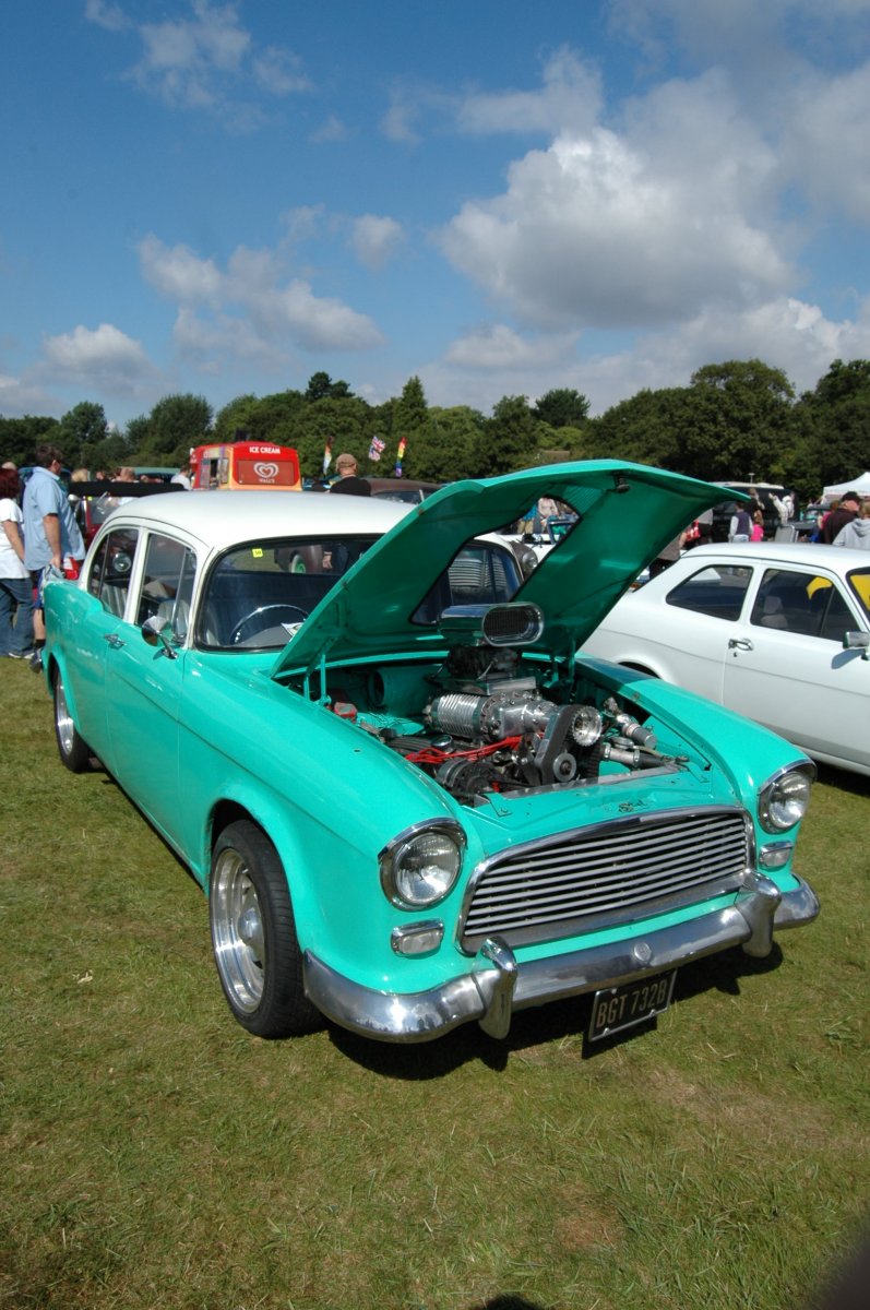

    There's a couple over here with American V8's that I know of: (This disgustingly clean one's got a 302) I think the fords go in easier due to the distributor being at the front - makes firewall clearance easier.
    Not sure what this has in it, but I'm guessing because the dizzy's at the front that its another ford...

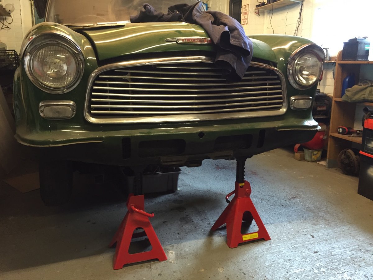

    Had five minutes in the garage this afternoon... Priority number one was to do this...

    If I could make a suggestion,Place your jack stands under the suspension to avoid body flex.A lot of your frame support is rusted and the body will flex and cause a big problem later when you try to aline the doors etc.Just my 2 cents

    Your front arches don't look original either btw.
    Did a quick photoshop with chrome reverse rims and www tyres and adjusted the arches a touch. Lower on the back (but no lower than this please - and if you add skirts, it looks ridiculously slab sided!) and the front arches with the lips slimmed right down and better fitted to the tyre.[​IMG]

    James D, love what you've done with the first 'shop! You've somehow taken the awkwardness out of the hawk shape, without changing it much at all... If only my metalwork skills were up to the task!
    The plan at the moment is to replace the arches with reproduction panels (which I can get through the PVHCC club) once it's back on the road... Not sure if that's the best plan, but I kinda need to get some use out of it to boost the mojo!
