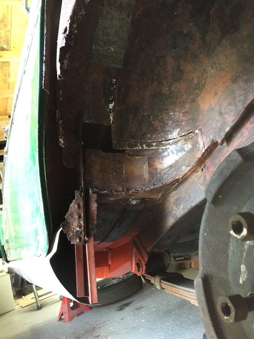

    IMG_4636.JPG IMG_4638 2.JPG Well, I've been away from the garage for a few weeks, but I've managed to dedicate some time on the car...
    I started to repair one of the rear wheel-tubs and got to a point where there was just so much rust behind the outer arch that I couldn't ignore it... I also had to make some sort of quick win to get my mojo back, so I've bought a pair of the few panels that are being reproduced for these...
    So now I've got to bite the bullet and cut up to the middle of the trim line and graft these in - after repairing the frilly mess that is the outer edge of the wheel-tub.
    Anyone got any advice on this sort of repair?
    Thanks in advance!
    Matt

    Hi Matt , great job you are doing there keep at it, I purchased a Frost kit when doing the body on my truck now I lead all my repairs.
    When doing the wheel arch repair purchase a panel joggler and step the rear quarter panel inwards then plug weld the repair panel
    By stepping the joint you will avoid warping and any moisture that might run down the inside of the panel wont seep into the joint
    Hope this helps
    Dave

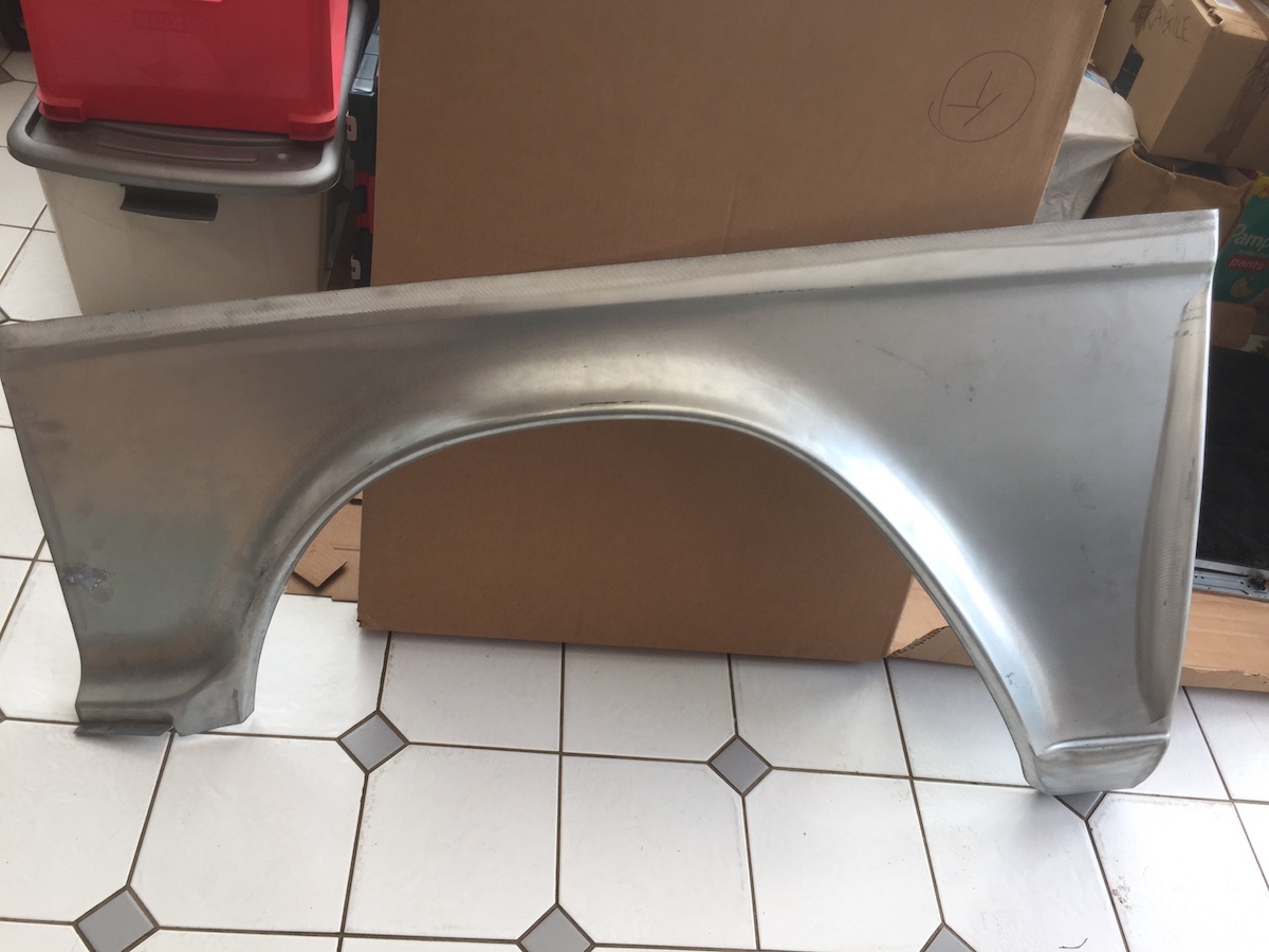

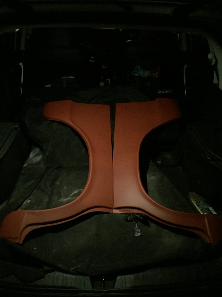

    I've not got much more of an update other than to show the recently acquired rear arch repair section taped on in roughly the right position
    Looks like its going to sit a lot higher than the previous wheelarch, which leaves me with a problem. Its just going to look too damn high! I was thinking I need to cut up the repair panel to lower the arch - leaving the door aperture, sill (rocker) and behind the arch in place so it lines up... Any advice on how best to tackle this job?
    When taking a rare look at the car from a distance, I really wasn't happy with the way the front arches looked either
    - so I bit the bullet and bought a pair of these
    Which will be going on as soon a time allows... They're really nice, thick panels. Made by a reputable company here too - so hopefully they won't require too much work.
    Thanks for all the kind words by the way!
    Matt

    On the rear wheel well patch - I would make 2-3 mounting holes you could line up with the trim holes, so you could take it on and off during fitting and it would go back the same each time. Then I'd patch the patch, off the car (much easier to do this on the workbench), adding metal between the wheel arch and the upper part of the patch. When you're happy with it, then put it on the car.
    Cut carefully - into 3+ pieces I think - to retain the areas that match the good panels on the car.

    You could always lower the arches a shade, as per my photoshop. You have nice new metal to work with now.
    I know it's not a cheap option, but would it be worth buying a second set of rear arches to make inner arches out of?

    Your Photoshop is what I'm aiming for James D... Nice and subtle changes... Trouble is, I can't work out how to cut n' shut the rear of that panel... The curve is right where I need to cut...
    I don't think I can afford another set of rear arches - I think I'll be replacing most of what I've got anyway, so I'll have to make-do. Or I was thinking of trailer mudguards for the inners...

    Hi all, long time - no updates...
    Well, garage time has been scarce lately - but I've finally got enough together to put some sort of an update up here...
    I've cut the rear arch away only to find more nasty surprises - but I think I've got a plan, more on that later...
    When I cut away the arch to roughly the same size as the replacement panel, I found that the outer half of the wheel tub was wobbling all over the place... It seems it was rusted along its entire length, and wasn't actually attached to the fender.
    (The pic above is looking directly up into the wheel tub. The right hand side is the arch panel, and just to the left of that, you can see where its more or less rusted through the whole radius of the panel)
    (Wheel tub outer half removed)
    So, here's the plan... Rather than trying to create a replacement for the inner arch, (which I'm sure with enough time and guidance, I could knock up) I thought I might simply join the inner part of the wheel tub directly to the new arch panel. Sort of 'tubbing it' but outwards, rather than inwards. Can anyone see any problems that I can't? I've borrowed a friend's shrinker/stretcher to allow me to put a flange on the outside edge - will see how that goes... Any ideas?
    Oh, and while grinding back the paint to give me an idea of where I'd need to cut to get the panel to fit - I unearthed about a 1/4" of filler, over a 1/4" lead, over a bunch of dents that look like they've been sorta' pulled out - great! I'm thinking this might cause me some problems when it comes to attaching the wheel-tub repair section as it falls square in the middle of this cluster of dents (at the peak of the tub)... Might have to cut yet more fender away to make some progress...

    Welding the rear inner wheelhouse directly to the quarter panel is going to cause a shadow in the bodywork from flexing later. That's why the factory brought the wheel arch all the way down to the seam of the wheel opening originally, to avoid that attaching point.
    What you might try is, if you can make a flange on the inner section that will reach the new quarter panel, add a big flat sheetmetal piece that goes all the way down to the wheel opening, so you can attach it at the opening and not in the center of the panel. Basically you made a new, boxy inner wheel arch instead of the stamped, more rounded one.
    Does that make sense? I'm having a hard time explaining what's in my head.
