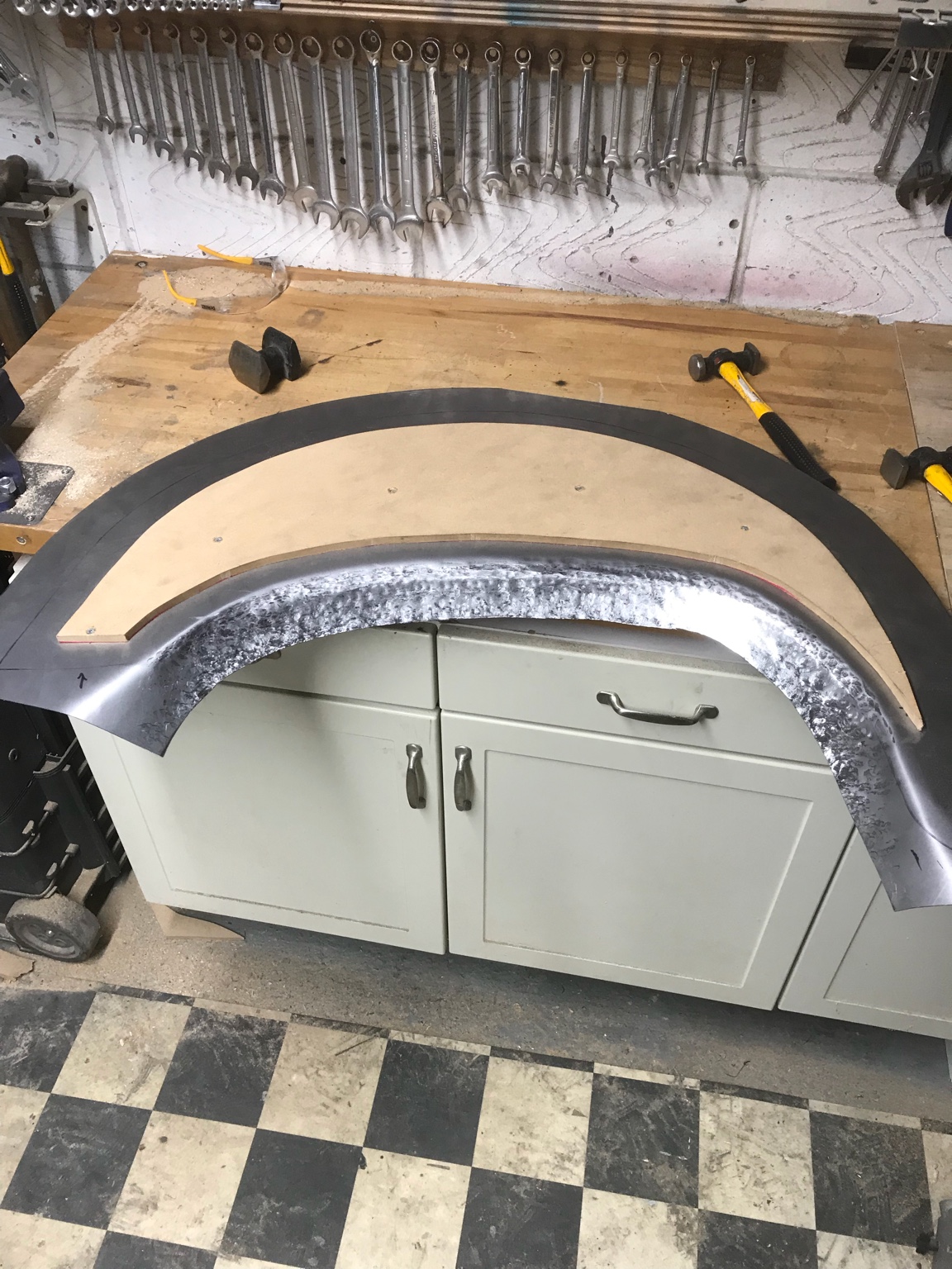

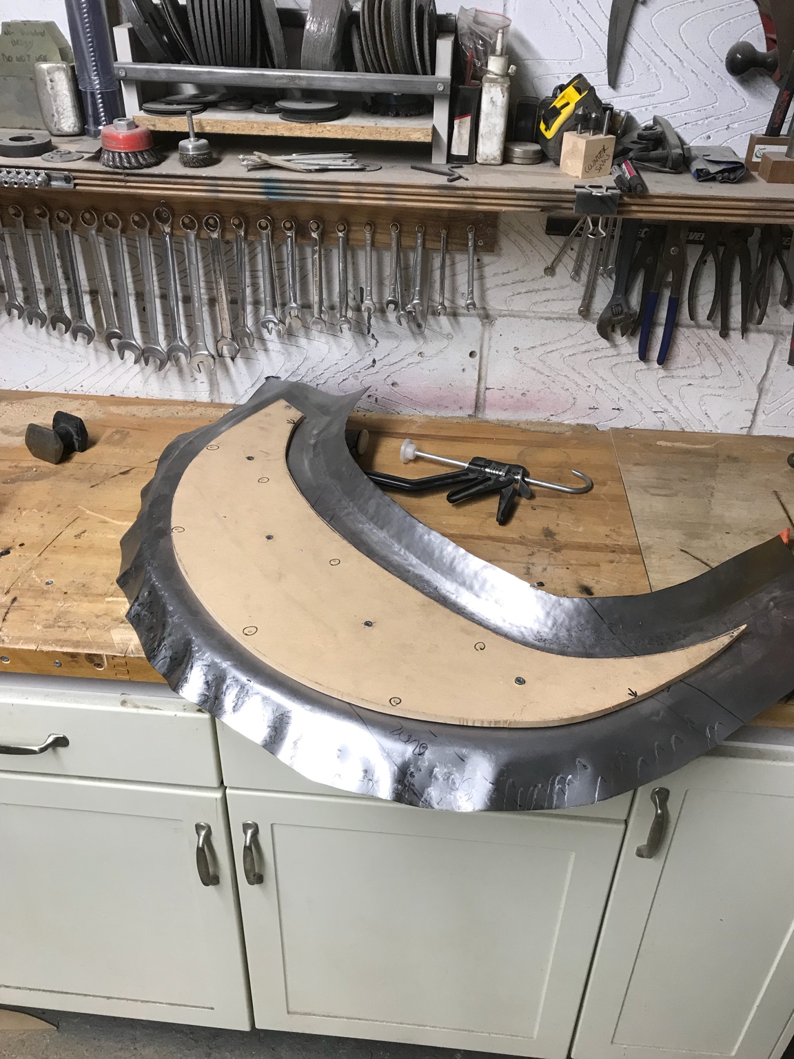

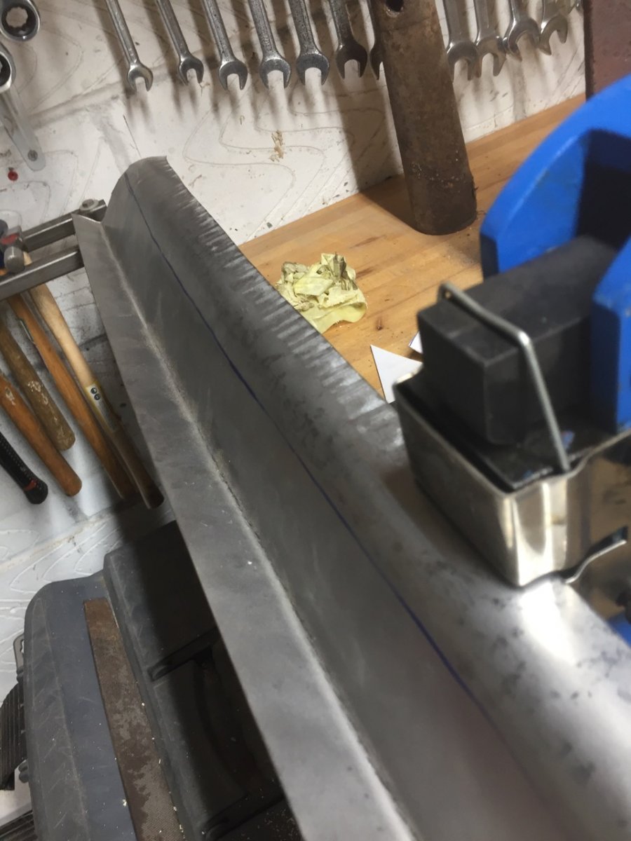

    So, I've spent a lot of time scratching my head... Drinking tea... Scratching my head some more... Then I thought, screw it, and got cracking... I decided to make the half wheel-tub out of 2 pieces; a 'wall' that meets the wheel arch repair panel, and a thin strip that forms the radius, which I'd weld to the existing flange.
    Tried to make a cardboard template of the 'wall', but it just wasn't working out.
    Ignore the sketch on the card - that was the template for the dropped axle for my lad's tot-rod wagon (in my profile pic)

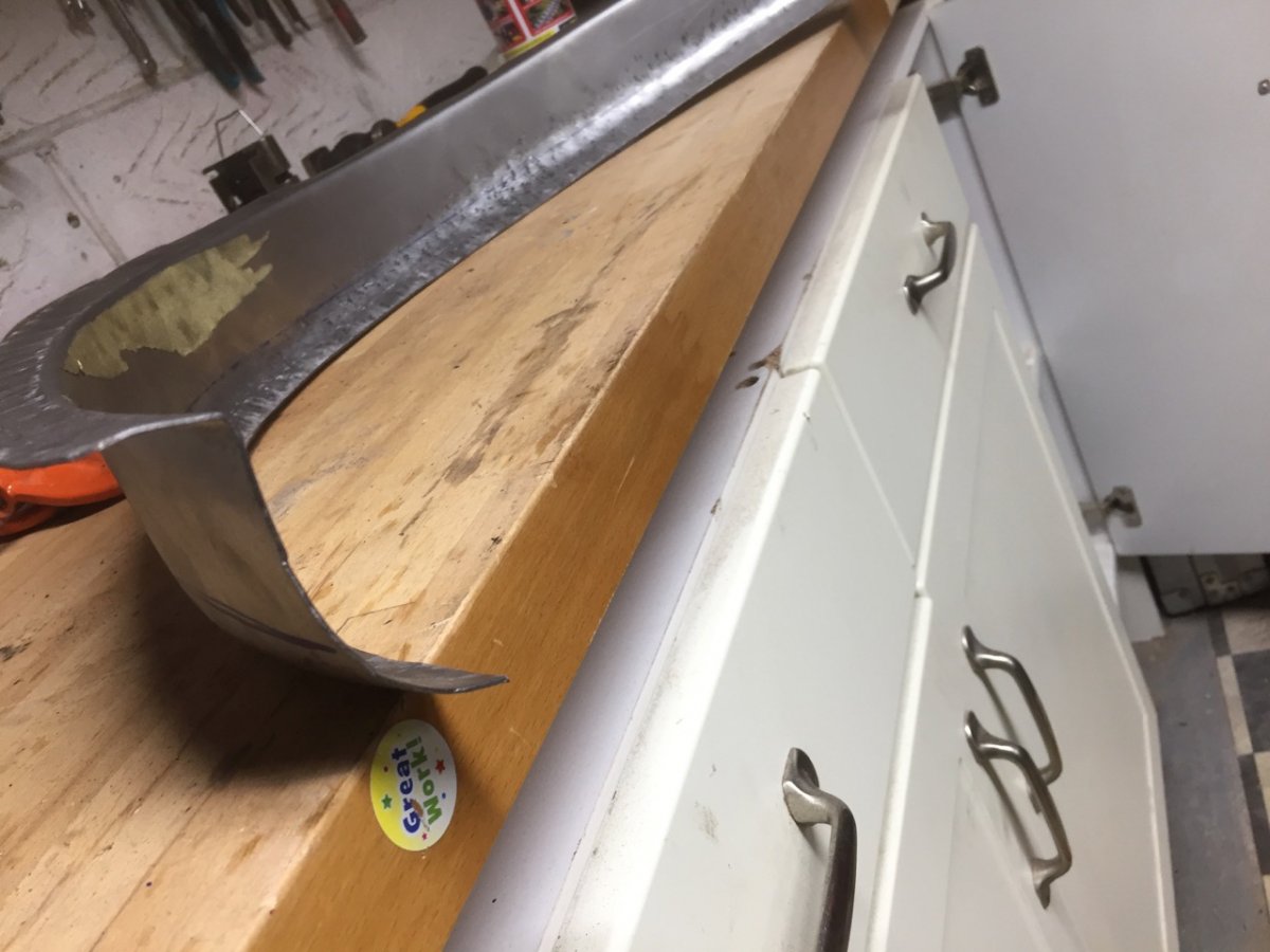

    As I said, that wasn't working out - so I thought if I tackled it from the other side (the radius, part) I could shrink/stretch a strip of metal to match the radius of the existing wheel-tub flange, then use that as a template to make the 'wall' from.
    So I started by bending a 90 degree flange in the metal by hammering it over an offcut of kitchen worktop. Then I hammered a much softer radius along the opposite edge in my wooden stump. No special tools so far, just a ball pein hammer with a high crown. Then, off to the shrinker/stretcher I've borrowed from a friend.
    I started by shrinking what would be the inside of the curve a little, then stretched the flange side. I'd never really used this tool before, so it took a little bit of learning to work out the feel of what I was doing. I did however quickly find out that if you over-stretch an area (which I did a few times as can be seen in the next few pics) you can always un-do it by hitting that same area with the shrinker jaws.
    The curve starting to take shape. I needed to catch up with the stretching at this point
    Here, you can see where I'd over stretched the flange side, and created a bit of a peak to the radius. Some careful work with the shrinker on the flange-side, and some stretching on the inside of the curve helped to even this out a little.
    I was also worried about losing the nice, soft curve on the opposite side to the flange, but going back over it with the hammer kept it in shape
    A little test-fit at the end of the night, and I'm pleased to report that I think it's gonna work! My only problem is working out how to weld to what's left of the existing flange. Access is going to be tough for clean up of the metal for plug welding, so I might have to cut the existing flange off and re-create that. But I'm more confident now than before, so if that's what it takes, that's what it takes.
    Fit is pretty good along the length (sorry for the **** photos, it was getting late)
    Anyway, thanks for watching... Itching to get back on it again later this week...

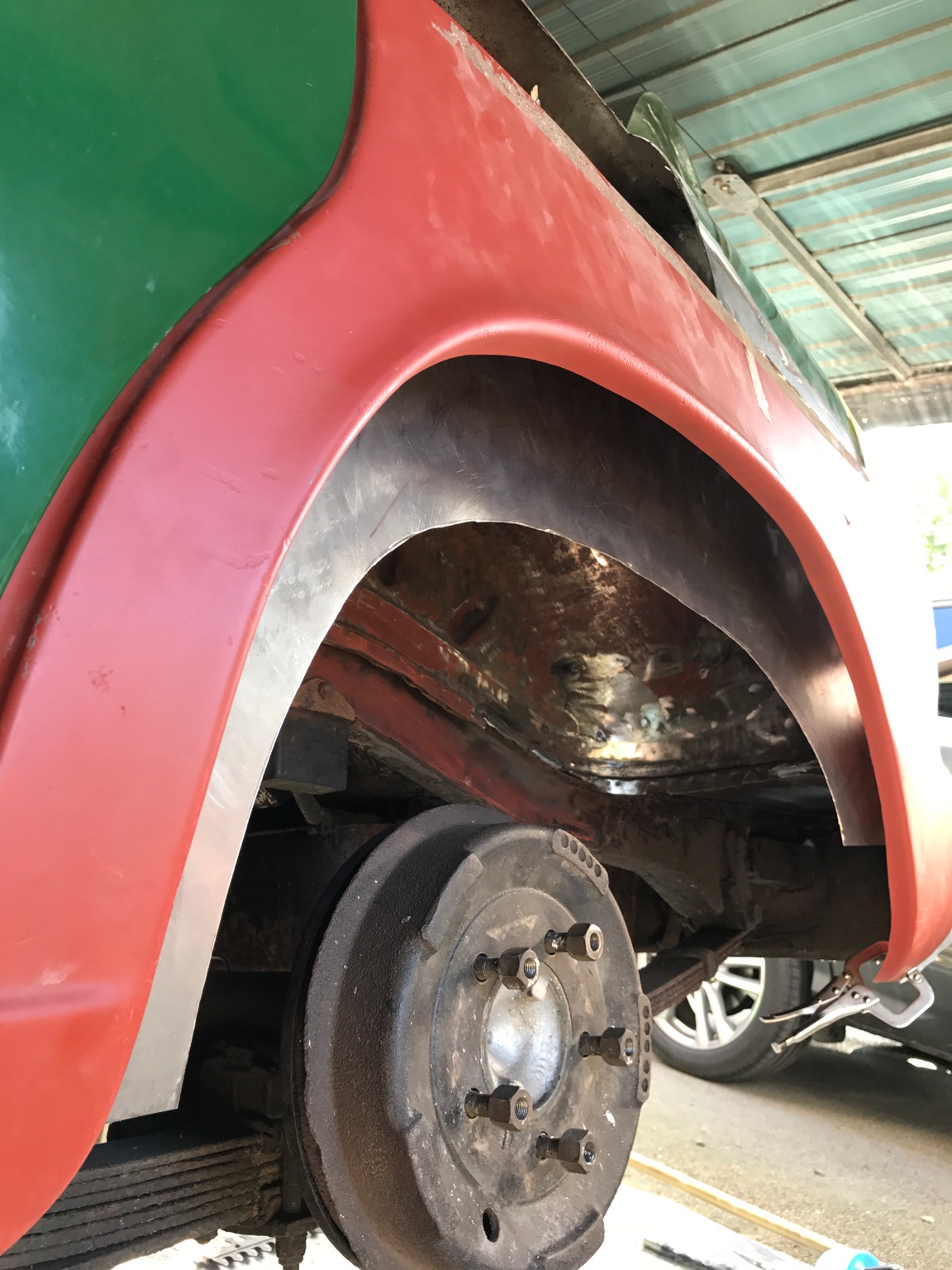

    Managed to grab a couple of hours on this tonight...
    Decided to remove the flange from the existing half of the wheeltub as it was just too rusty to weld anything to...

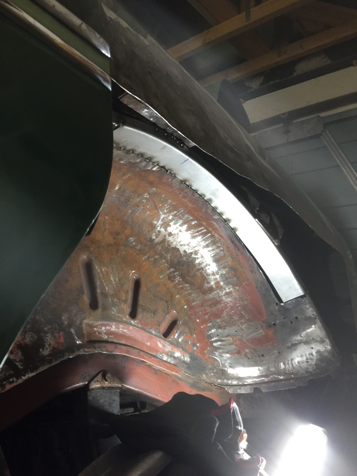

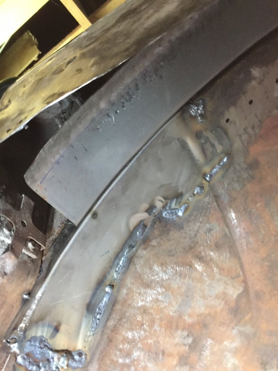

    Really small update on the ol' girl...
    Melted off some more of the lead from the dented rear quarter - just to see what's what...

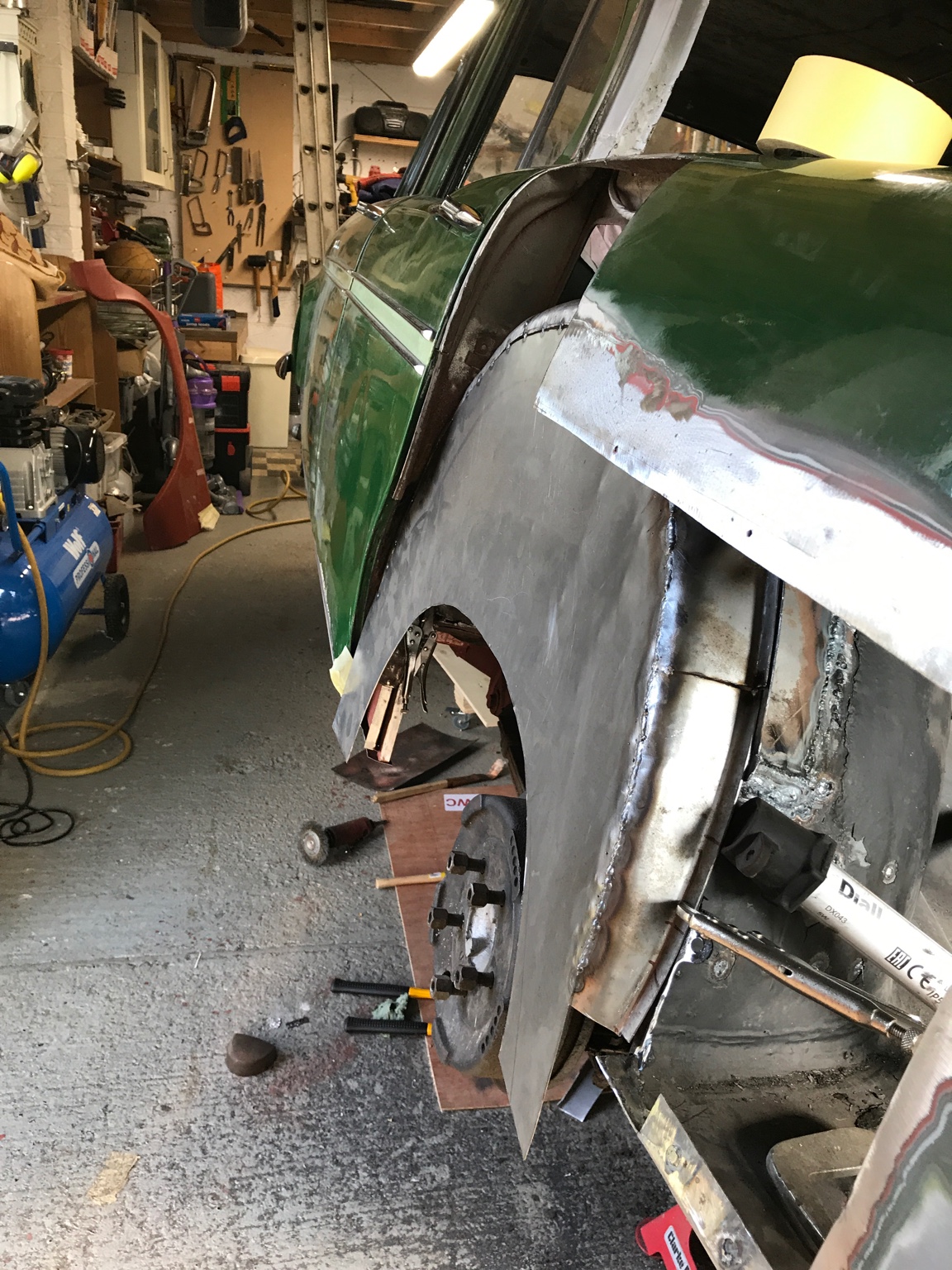

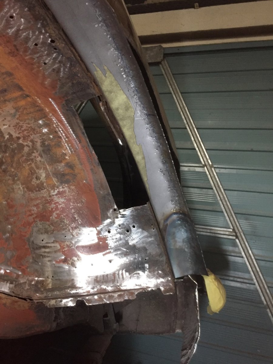

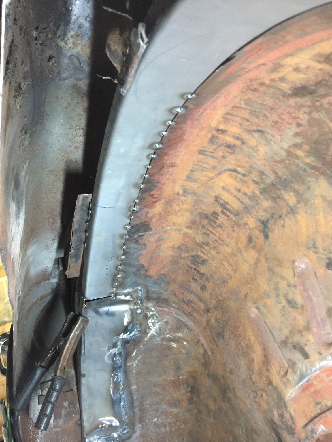

    IMG_0282.jpg Also managed to 'proper-weld' in the first half of the tub repair... Upgraded my welder just before tackling this, so it took a lot more time and a lot of blow-through's (not to mention a few choice words!) to finish.
    I didn't plan on it, but I think the easiest thing to do here is going to be to cut this section out and weld the new repair section to a fresh, straight bit of steel... I'm going to have to add a fair amount of filler/lead to this part anyway, just to match the profile of the rest of it, so it should be alright...
    Here you can see the nice new straight flange to weld the other half of the wheel tub to, as well as the extent of the dent.

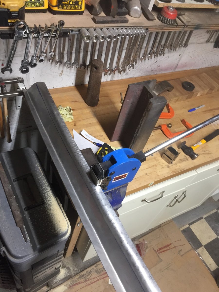

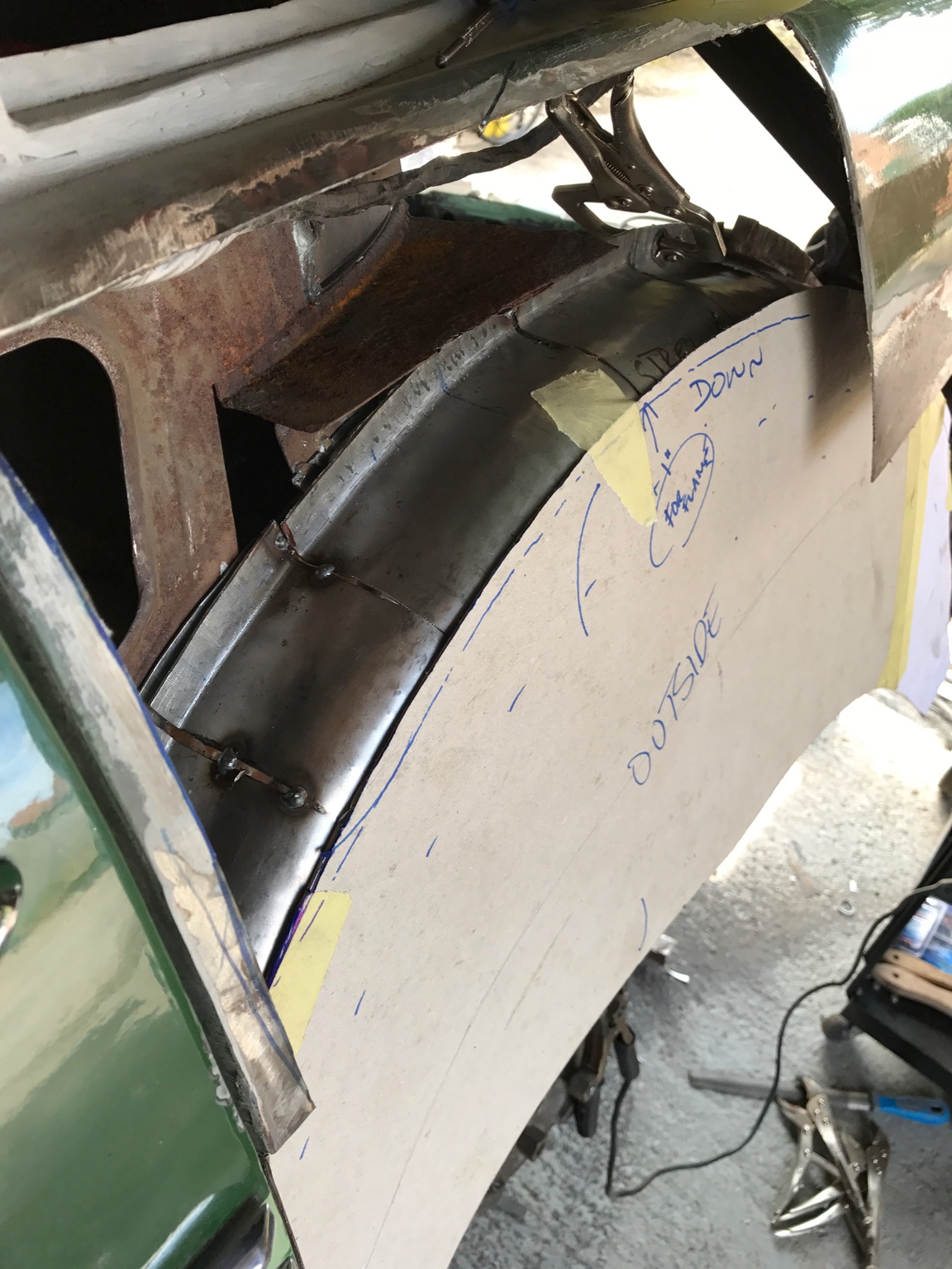

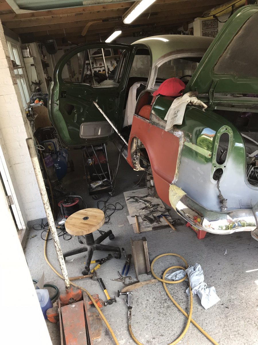

    Took a day away from the computer today to play on the Humber... kind of a therapy I guess...
    Nice to be working in the daylight with the doors all open
    My shop dawg... looking all mean!
    Cardboard template to get a rough idea of the size of the outer 'return' panel
    [​IMG][​IMG]
    The same thing in steel
    I now have to work out the best way of forming that return panel out to meet the lip of the wheel arch repair panel. Starting to wish I had an English wheel for this job! But a stump and mallet will have to do I guess.
    Hopefully more to come soon!
    Thanks for watching,
    Matt

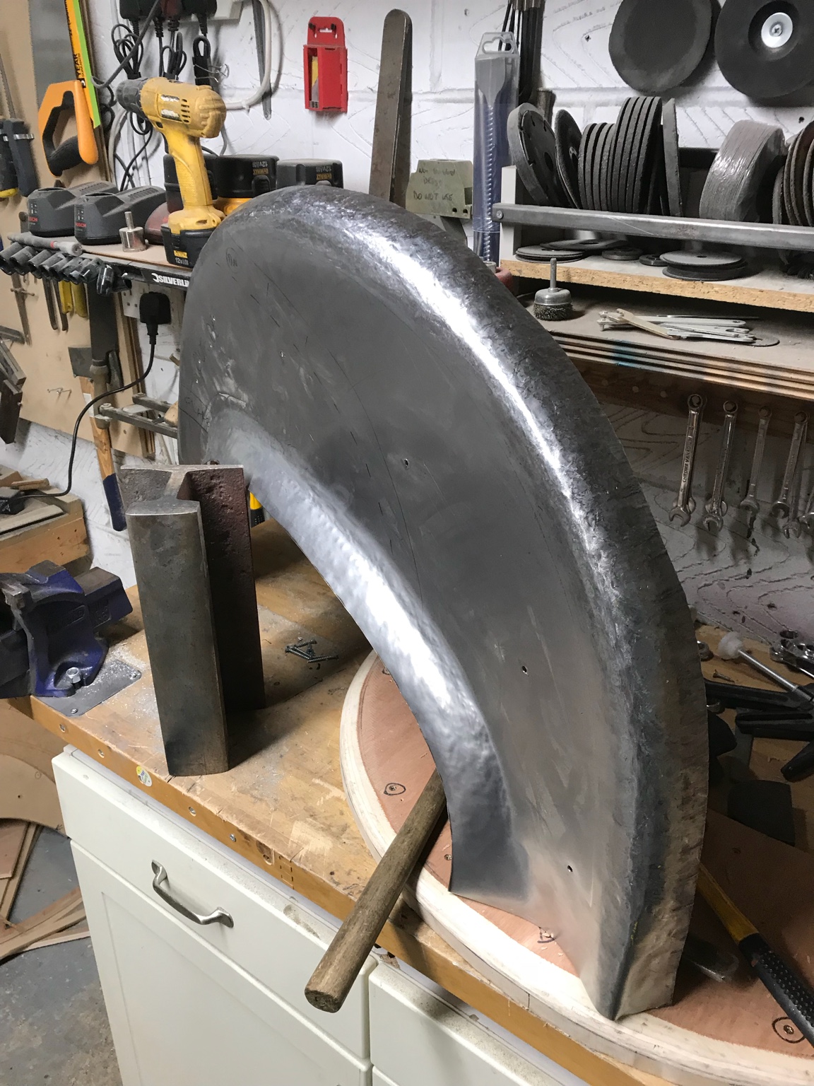

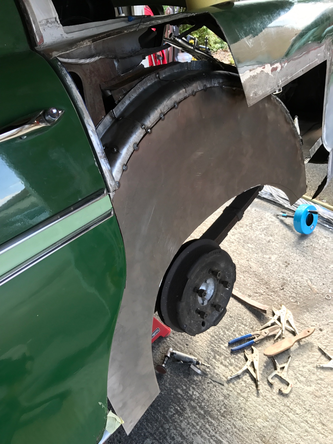

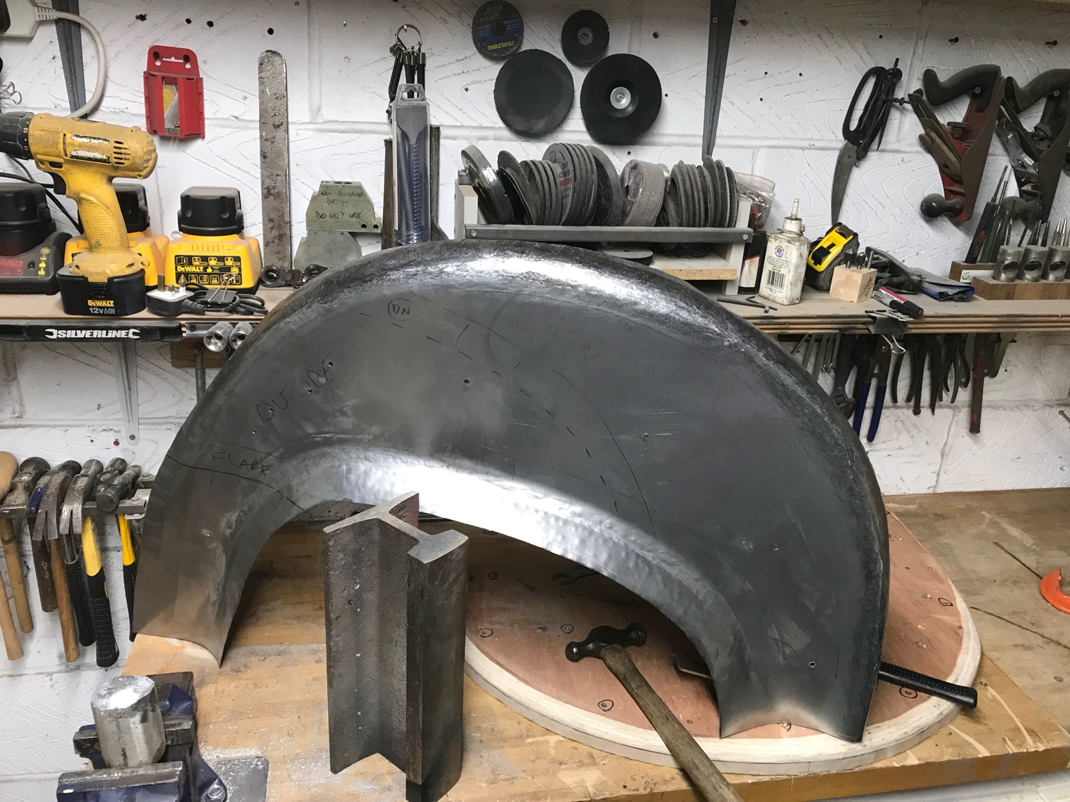

    So, I’ve just picked this back up again after focussing on another OT project for a while...
    That last piece I had been working on failed... once I tried to hammer out the return, the whole thing warped to the point that it wasn’t going to fit, so I started from scratch.
    I’m not finished yet, but this piece is already looking better, and I can still cut it about if I need to get a better fit.
    Here’s some pics from today’s progress...[​IMG]

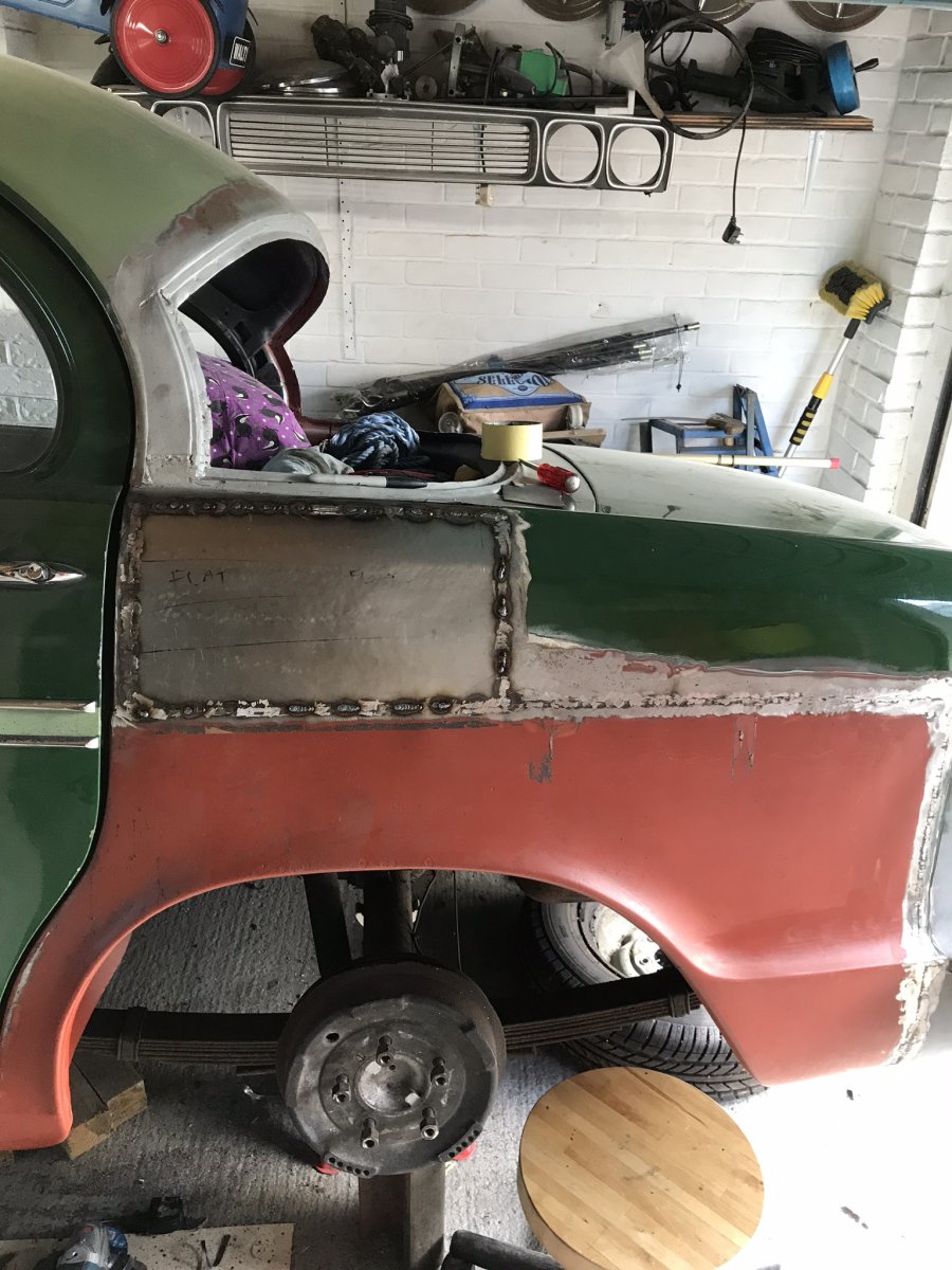

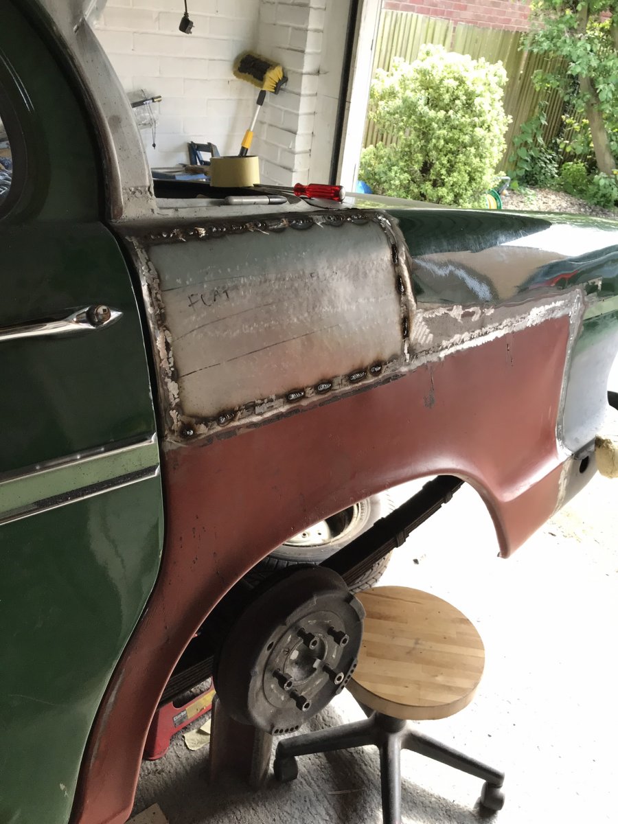

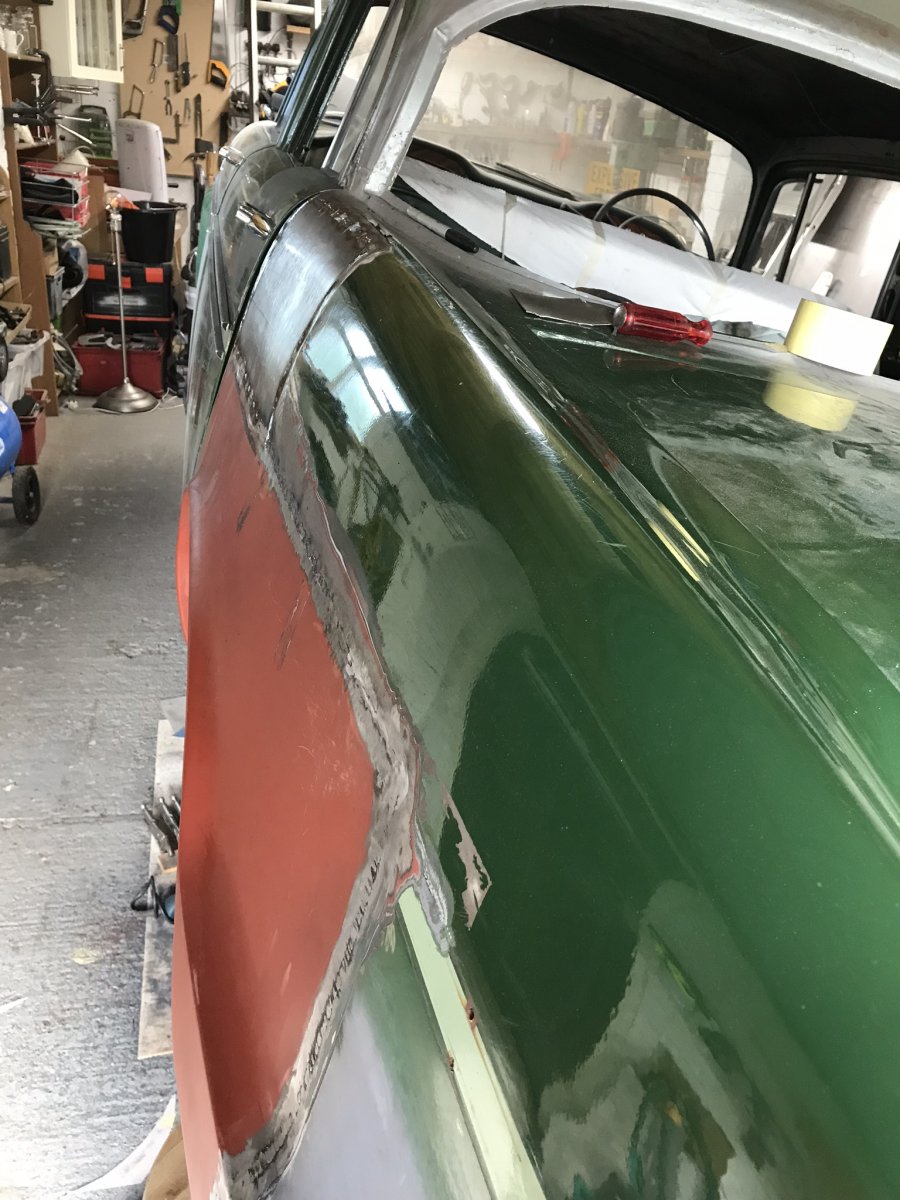

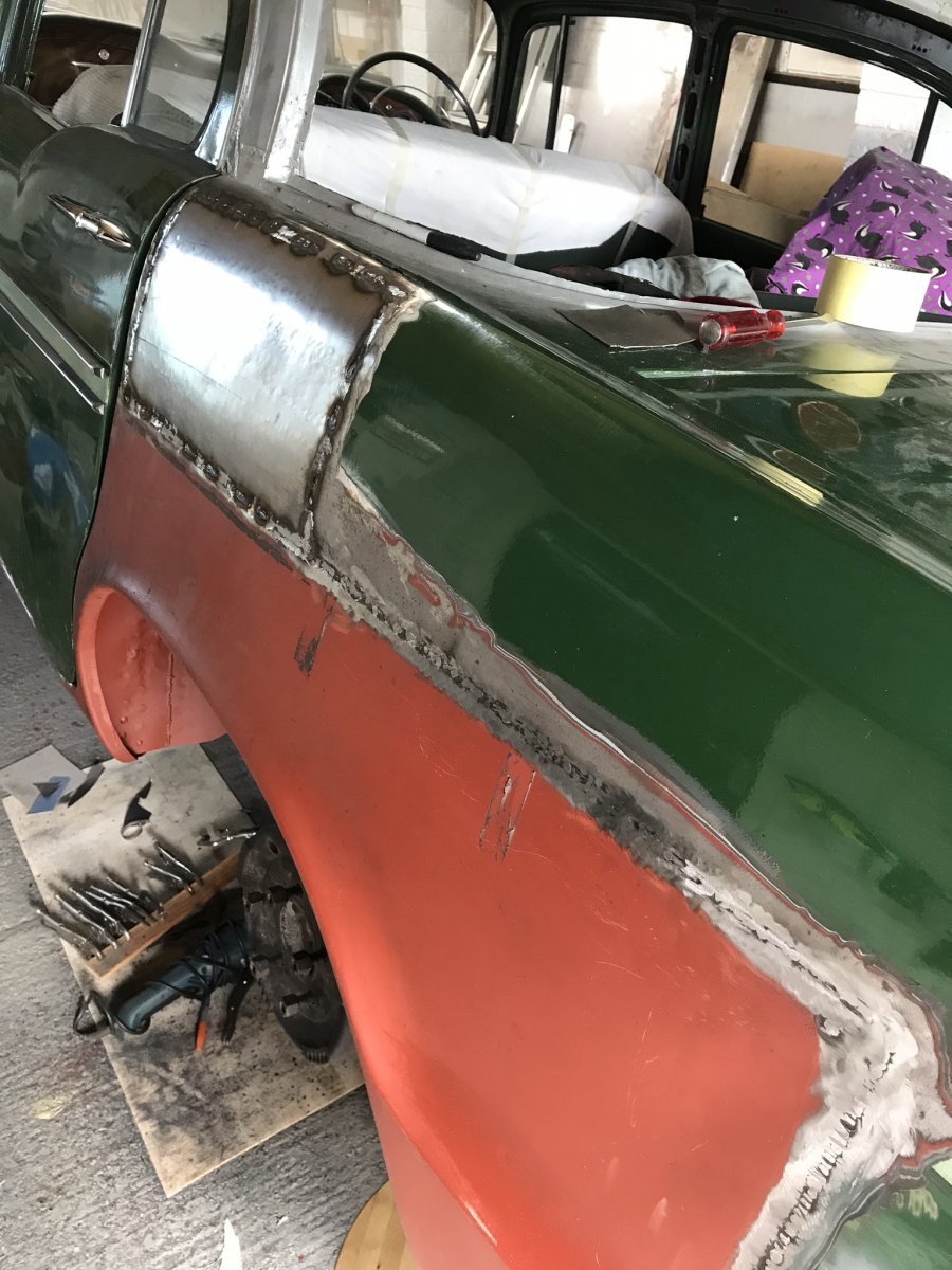

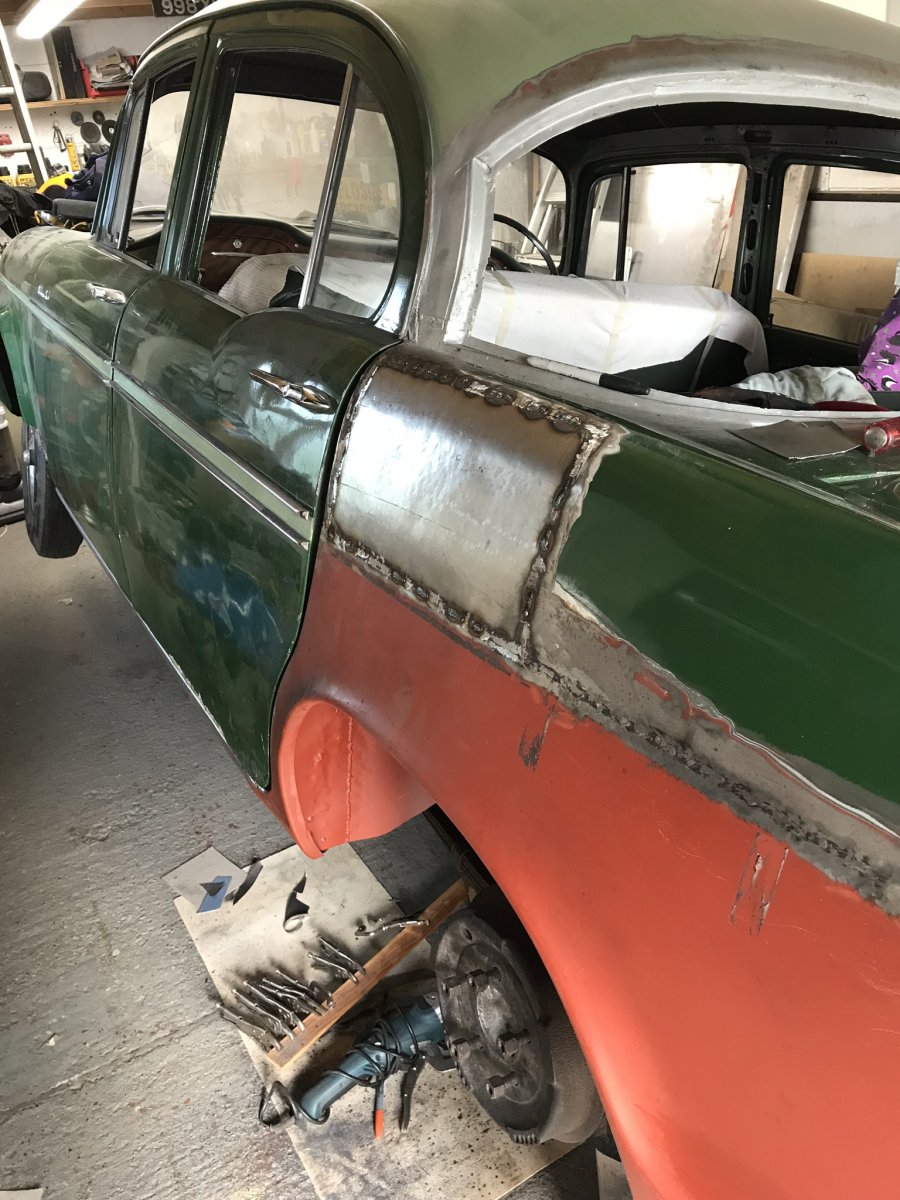

    Hey! Its been a while!
    As usual with these things, life has got in the way a little bit... But I've still been picking away at the ol' girl when time allows it. In fact, I took a couple of days off last week to get back at it!

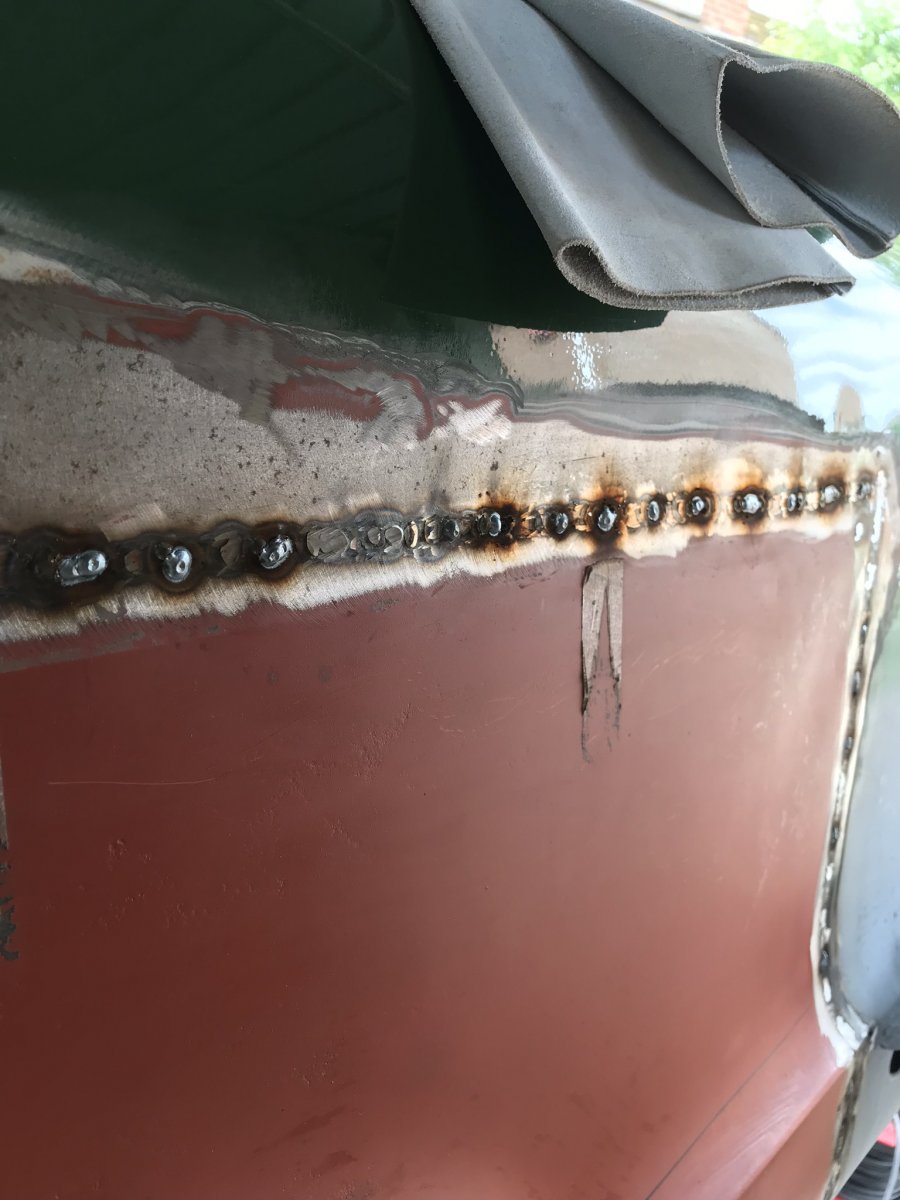

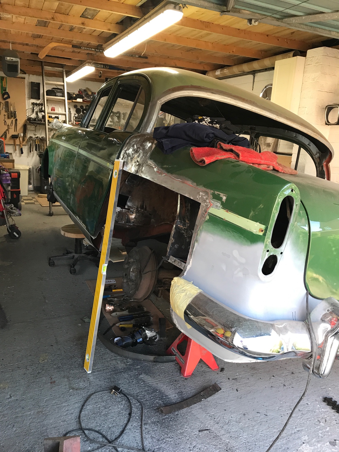

    I've managed to weld in the inner tub-half that I'd fabri-cobbled together, as well as the outer wing (fender) panel...
    So I'd umm'd and ahh'd (not to mention researching on here as best I could) about whether to ****-weld the panel in, or 'joggle' the edges and plug weld it... Well, I decided to go the whole-hog and ****-weld it in. I used the technique I've seen on here (by MP&C on the 55 Chevy 210 Wagon) where you tack weld every couple of inches or so. Grind those flat and planish the welds. then repeat while overlapping the previous tacks... Although my work is no-where as clean as MP&C's - I got much less distortion than I was expecting. I was always going to have to use some filler on this car, but I'm happy that I'll be using less than I've pulled out of it at least.
    And my little shop foreman for the weekend!
    Next job is to seam-seal around all the welds underneath and add a little lead to the top-side. Then onto the front corner!
    What would people recommend for stone-chipping the wheel tub? I'm thinking about either a soft, rust-inhibiting wax or something more permanent like truck-bed liner (lizard-skin, I think its called over here). Any thoughts?
    Thanks in advance!
    M

    Doing great.
    My only suggestion would be to do rounded corners on the patches if you can...helps minimise distortion.
    matt-miles likes this.

    Thanks, man! Now you mention it, that makes a lot of sense! Will do that in future...
    Looking at the patch panel a couple of days later - there is a little more distortion than I'd first thought, but I can lead it to bring it out a little. It's way better than the **** I cut out of it in any case!
