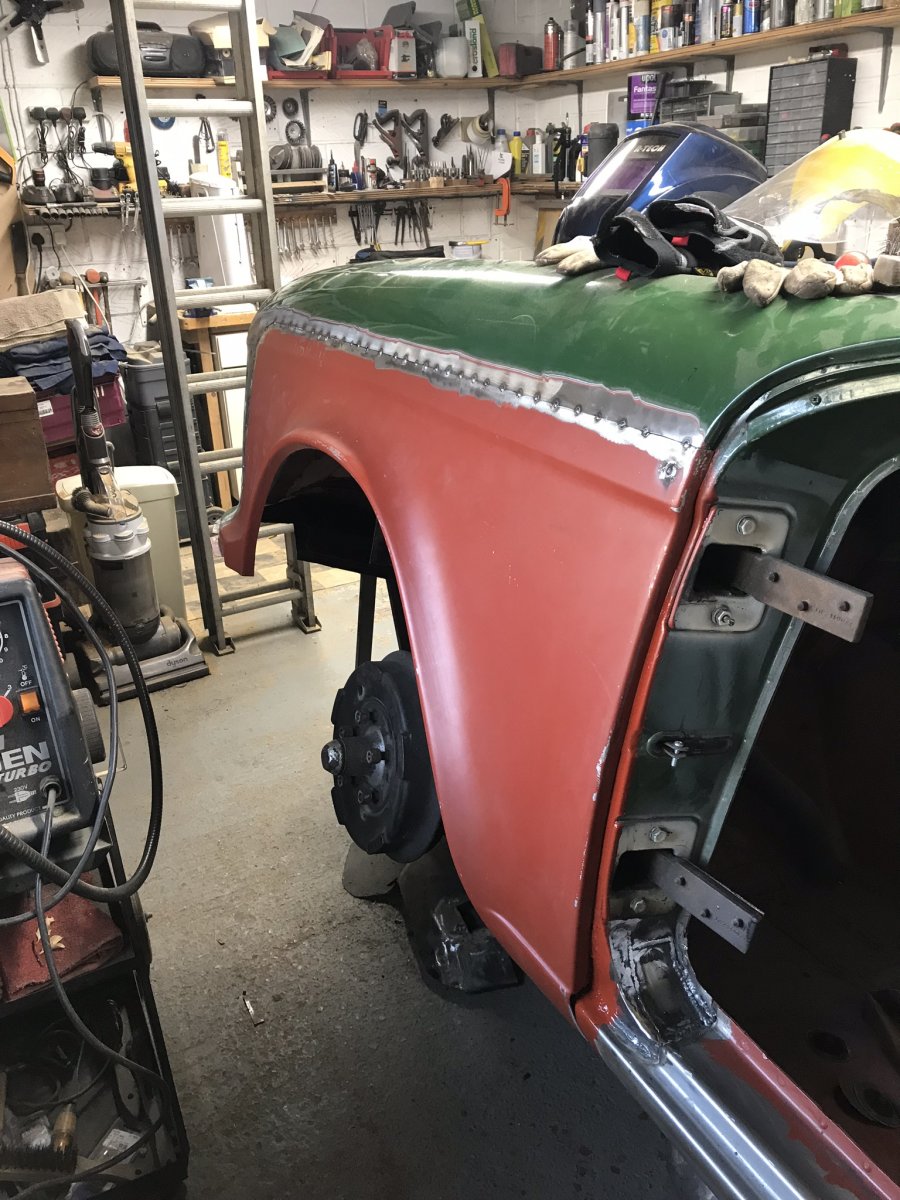

    So, I've managed to get the rear fender done, (more or less - still needs the final skim of filler and tweaking to get it spot-on, but I'm calling it good enough to move on...)

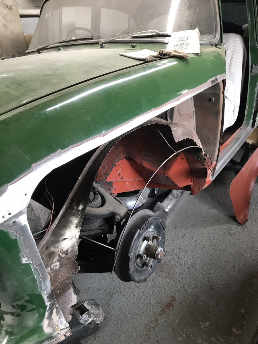

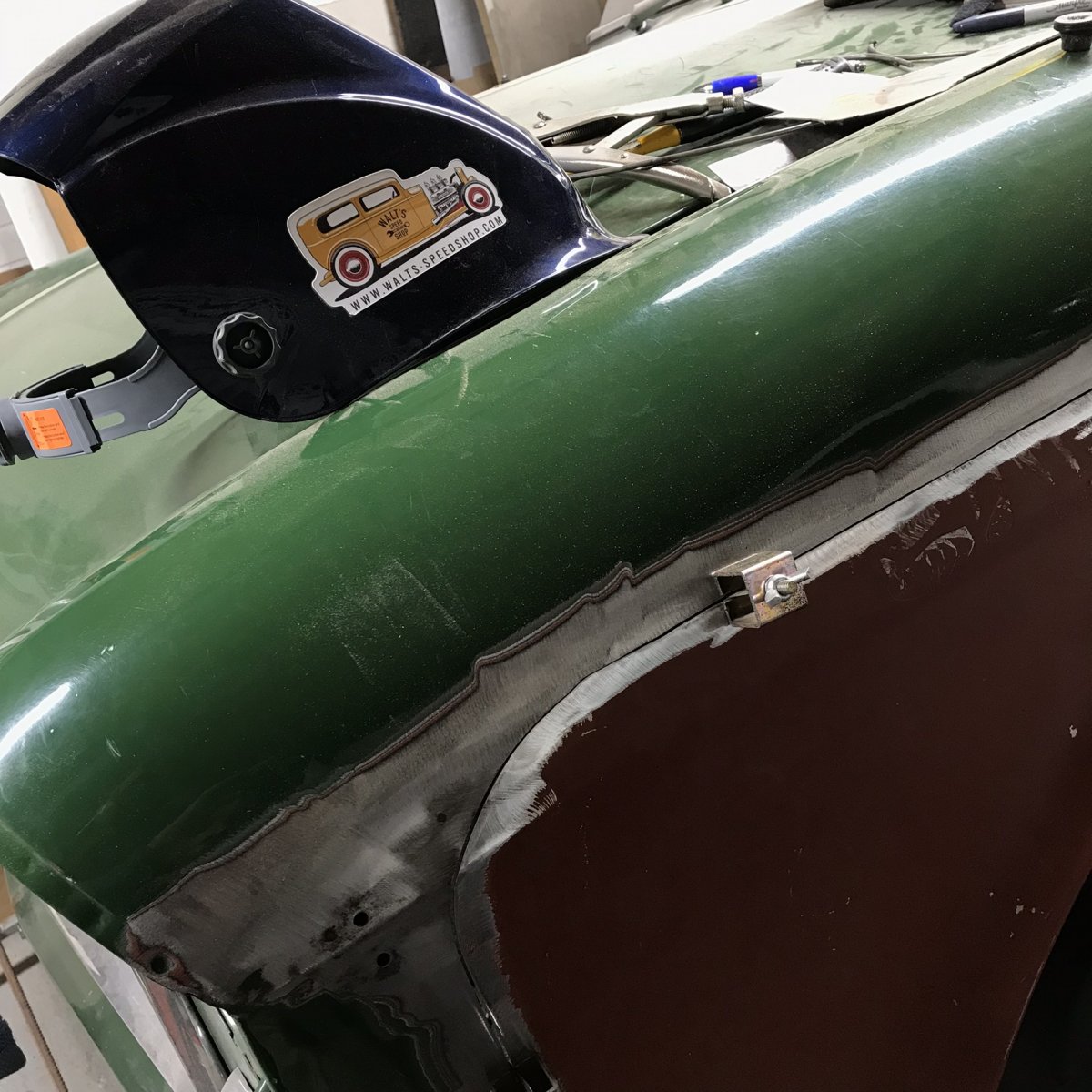

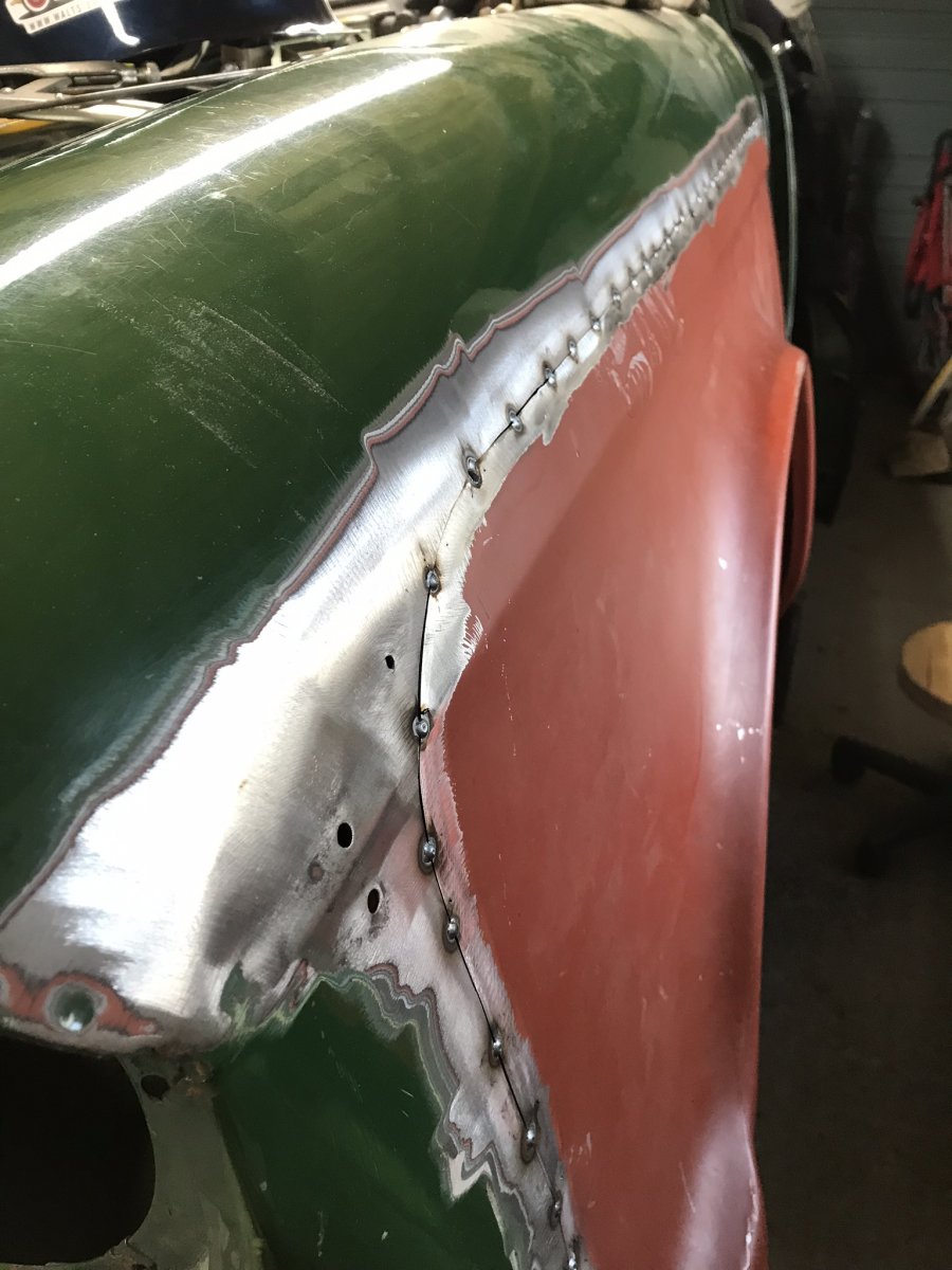

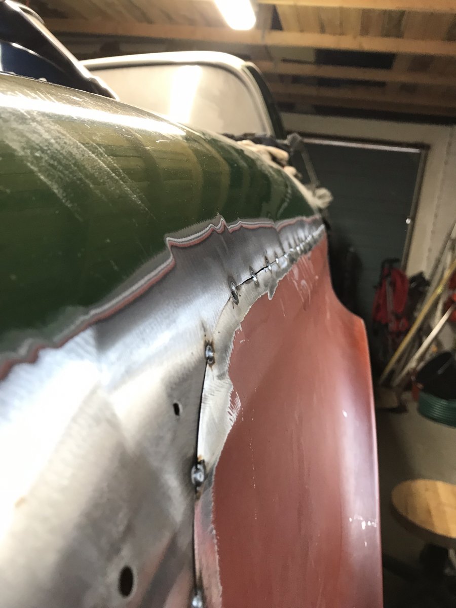

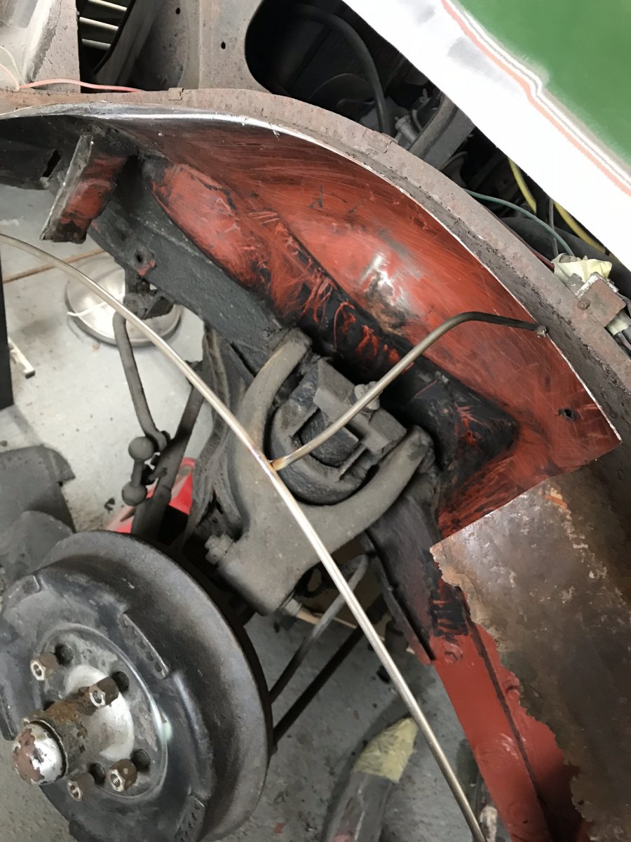

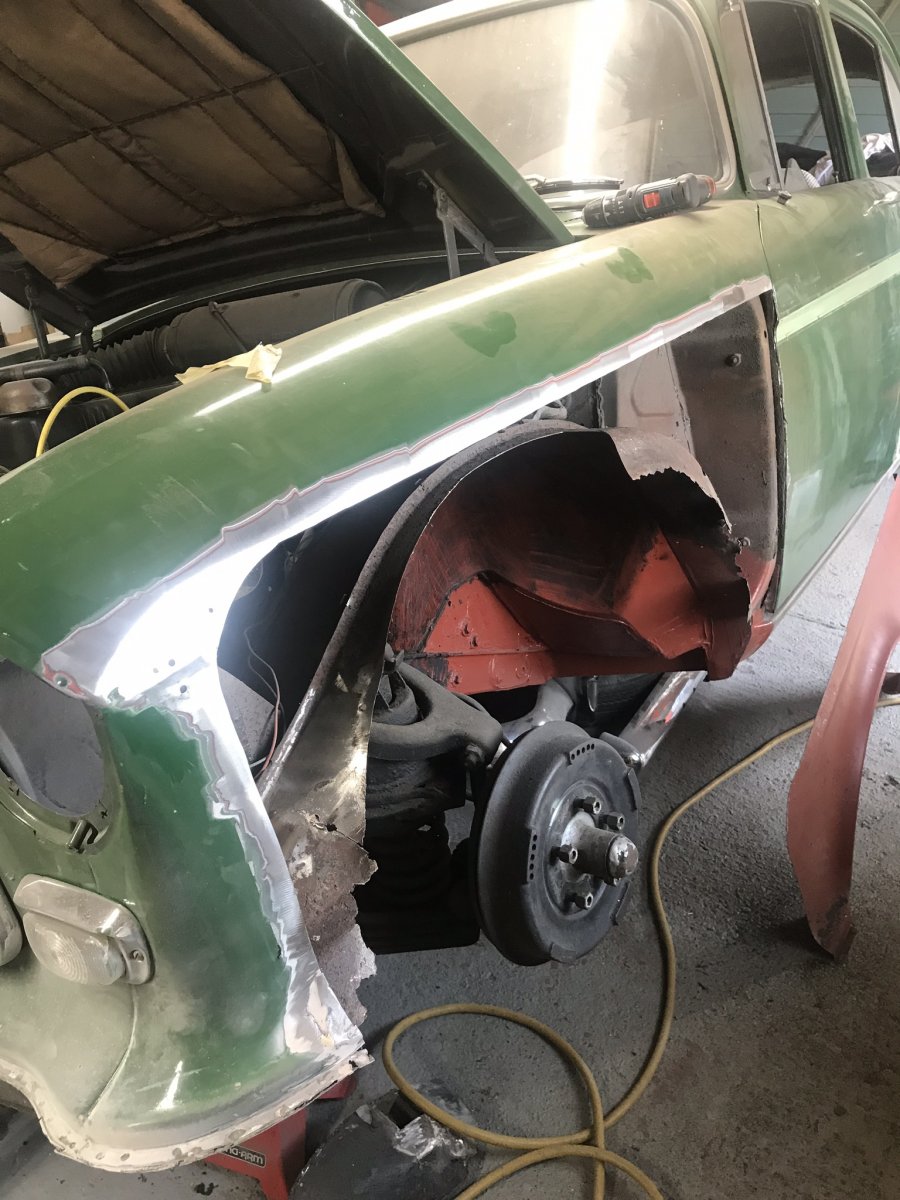

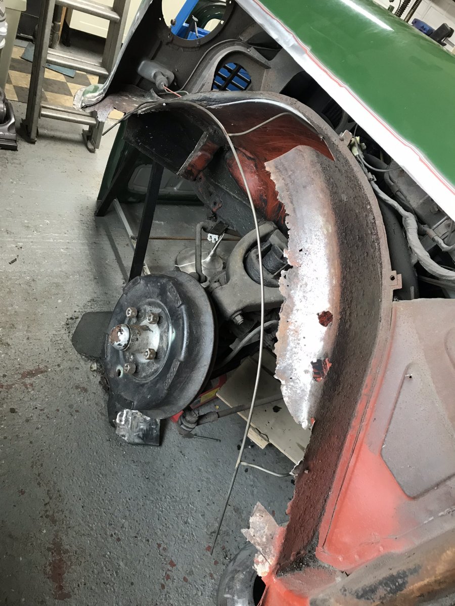

    front fender was next... And as expected, it was a mess! Whomever 'repaired' it last just stuck a new outer panel on (from what, I still don't know) and simply silicone caulked it to the wheeltub. With all that **** cut out, I was left scratching my head with this...
    I took the advice given on here this time, and cut the old outer panel off, leaving the corners rounded to avoid warpage.

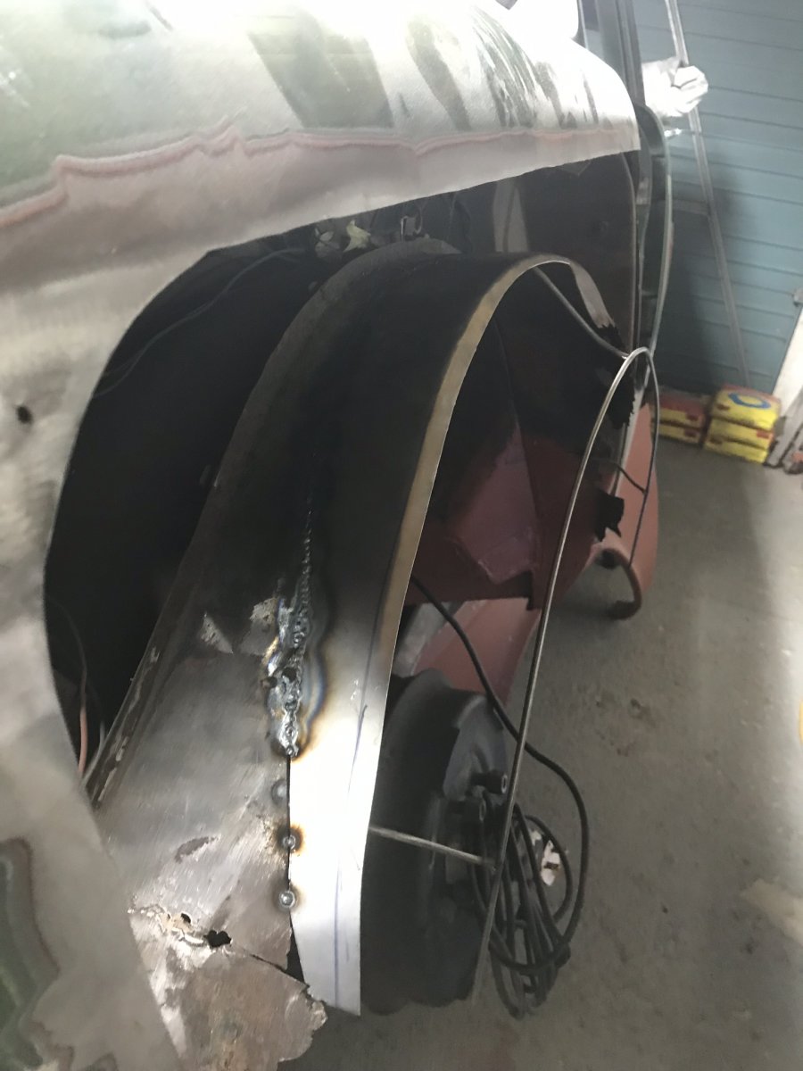

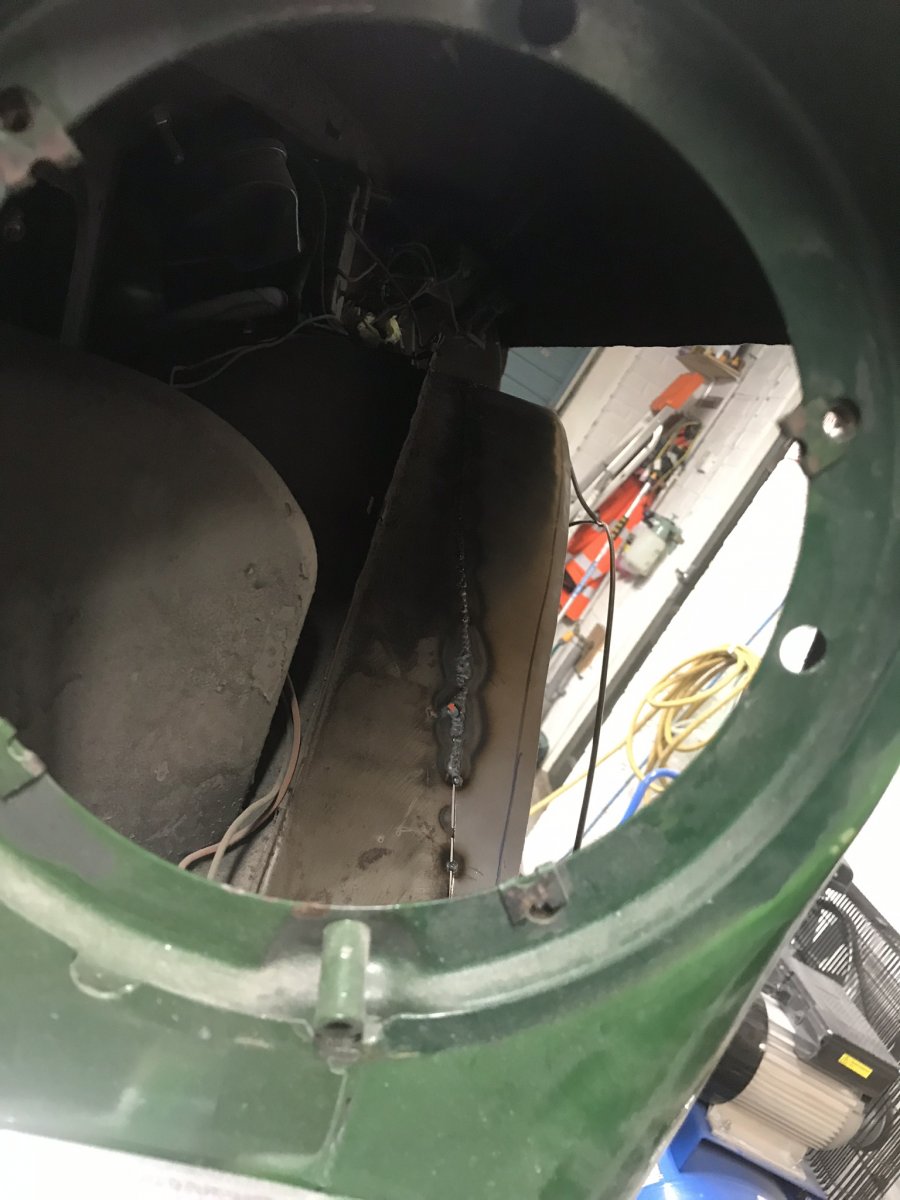

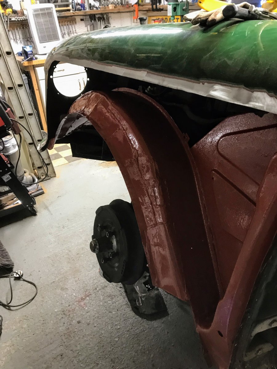

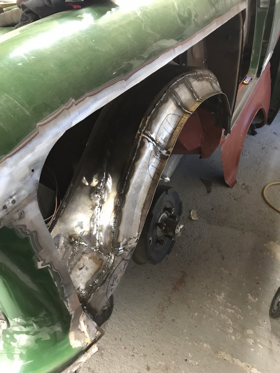

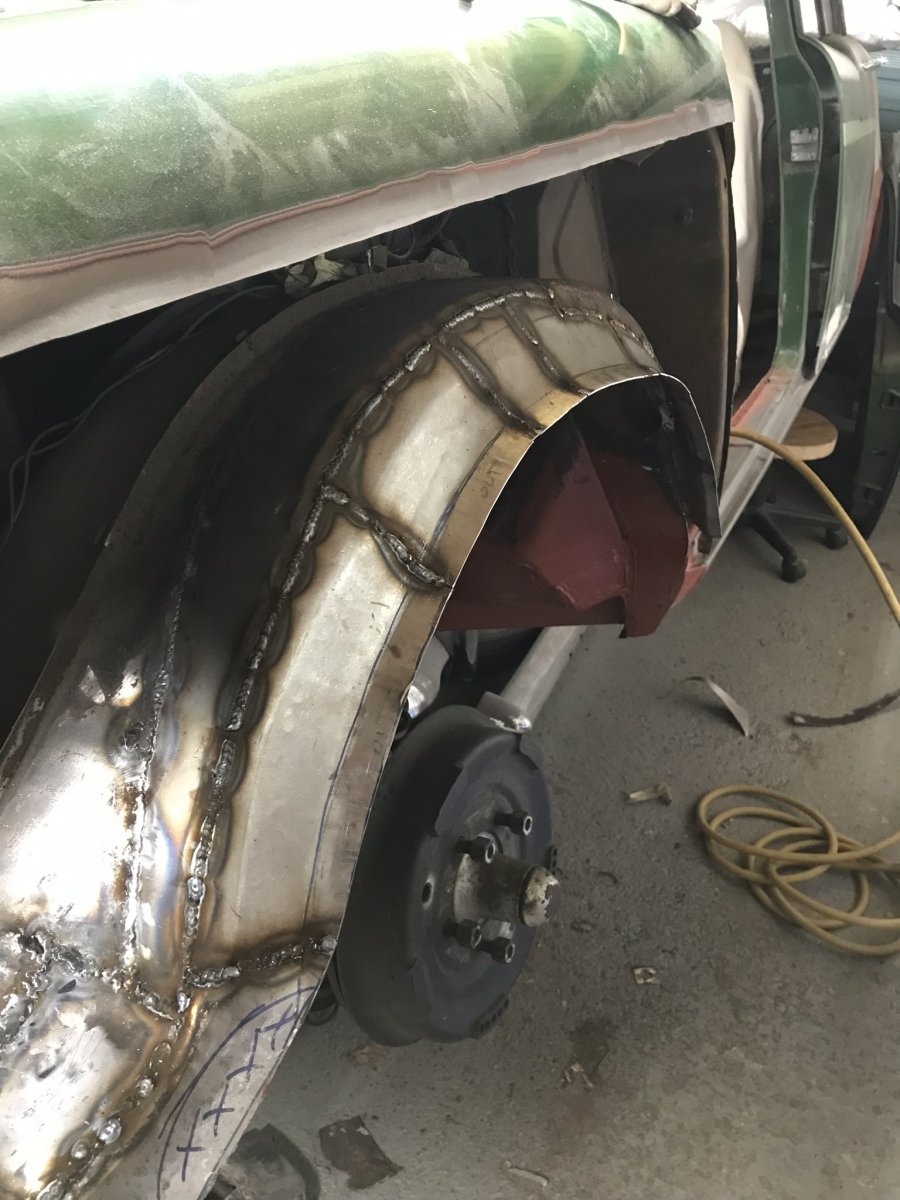

    I wanted to try a different approach with this wheeltub, so I used some 1/8th" steel wire to 'trace' where the wheeltub meets the fender panel (wing). That would give me something to work towards when building the metal out.
    Then I started to build up the wheeltub in manageable sections.
    IMG_6905.JPEG IMG_6906.JPEG IMG_6904.JPEG IMG_7092.JPEG IMG_7105.JPEG IMG_7108.JPEG
    It sure ain't pretty - but it's solid, and with a coat of Raptor, it should be good enough for me to never have to deal with it again!

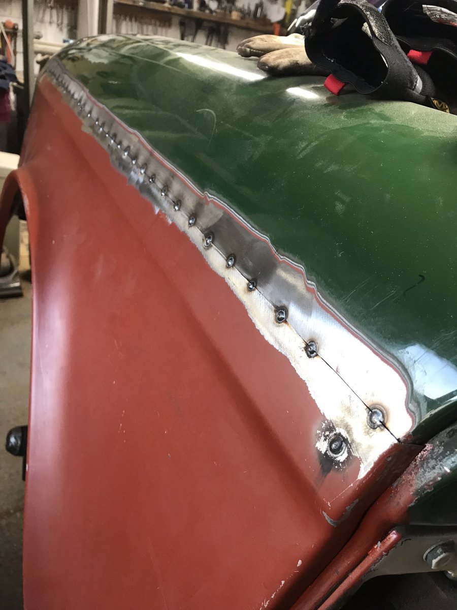

    Then, I fit, trimmed, bent, fit, trimmed, bent... and so on... Until I could weld the fender panel on. I've got to say, the rounded corner meant there was far less distortion in that area, and overall, I think I was a little more comfortable with controlling the heat.
    IMG_7121.JPEG IMG_7127.JPEG IMG_7138.JPEG IMG_7139.JPEG IMG_7141.JPEG IMG_7142.JPEG IMG_7173.JPEG
    Now, it isn't perfect, but dammit it looks like a car again!

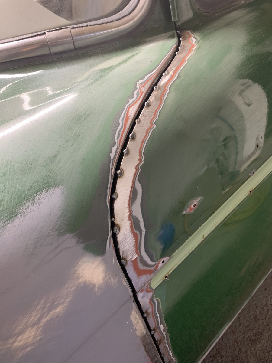

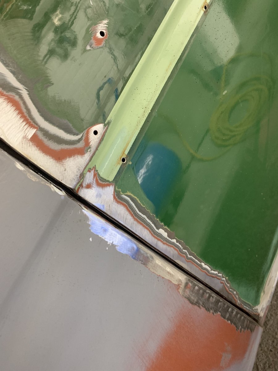

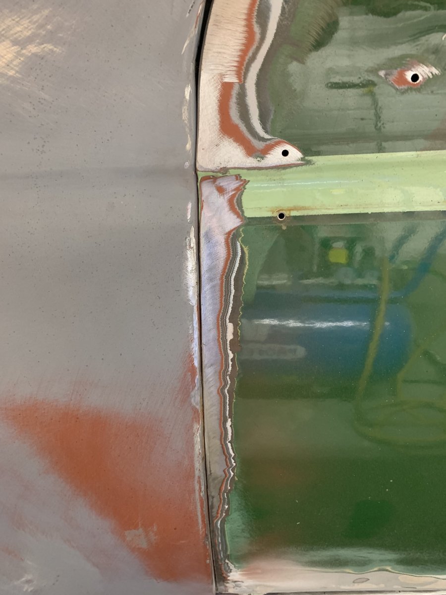

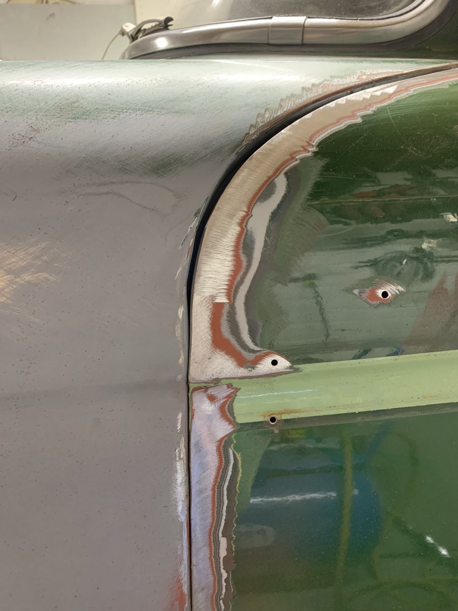

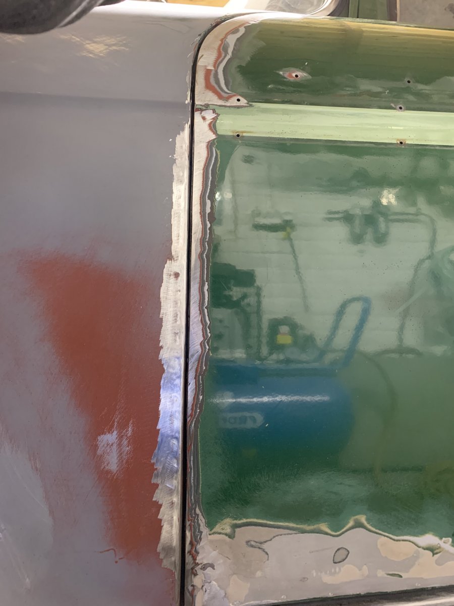

    When I say it's not perfect, I mean that when I was re-hanging the doors, I found they were tight along the leading edge where they had previously fitted. and tight against the leading edge of the rear door... So something has shifted somewhere along the lines, probably due to my keen-ness to get good penetration in my welds and lack of patience at this point - but we're not talking much, so after asking some advice locally, and searching The HAMB (obviously!) I got them as good as I could, and then attacked the offending edges with a grinder and welder until I had even gaps again.
    Tight gaps:
    Ground away:
    And welded to keep everything together before pulling the door off to properly weld...
    Apart from that, I've had to replace some of the inner and outer door bottoms, both front and back. I used a similar approach with these as I had little to no reference points left once all the filler and rust was gone. I simply 'drew' the shape I needed to work towards with 1/8th" wire, and filled in, back to fresh metal. Again, not the prettiest, and barely worthy of being on here - but much better than it was before I started on it.

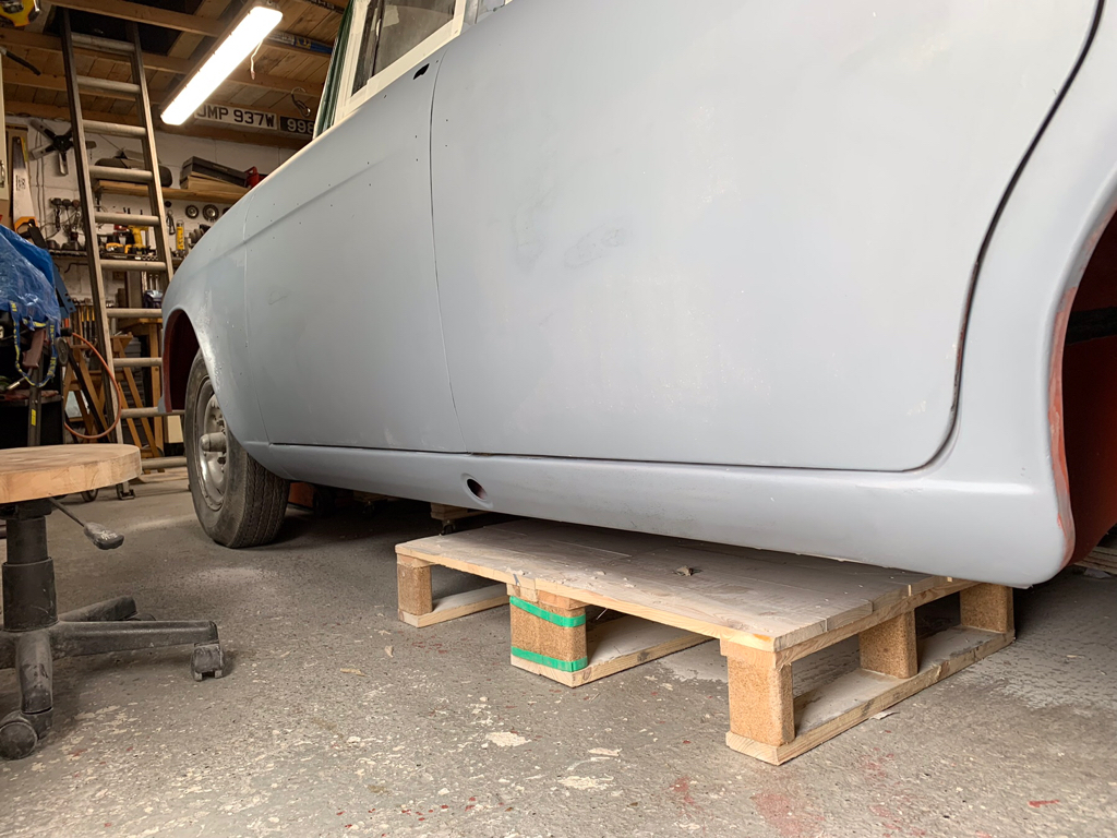

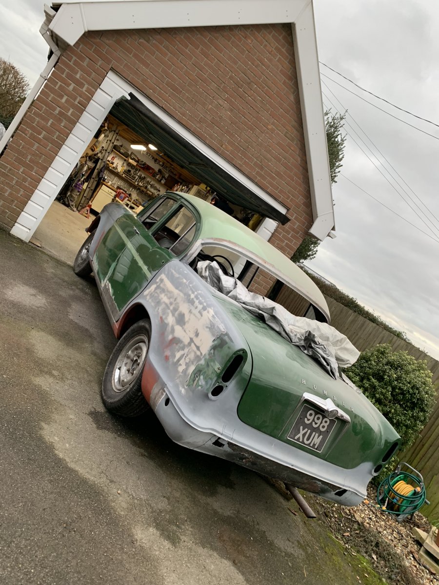

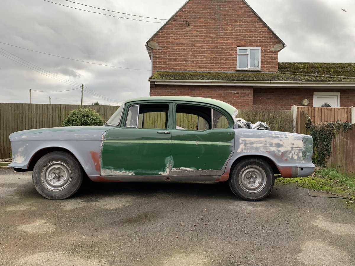

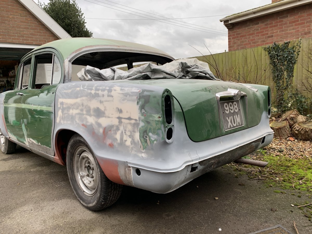

    After all that, I thought it worth it out to get a better view from a distance. It gets awfully intimate working in a single-car garage, I've learnt!
    So, here's where we are today (bar some work on the door bottoms)...
    IMG_0480.JPEG IMG_0481.JPEG IMG_0483.JPEG IMG_0487.JPEG IMG_0488.JPEG IMG_0496.JPEG
    Nearly ready to attack the other side... At least I'll have a better idea of what I'm doing this time around!

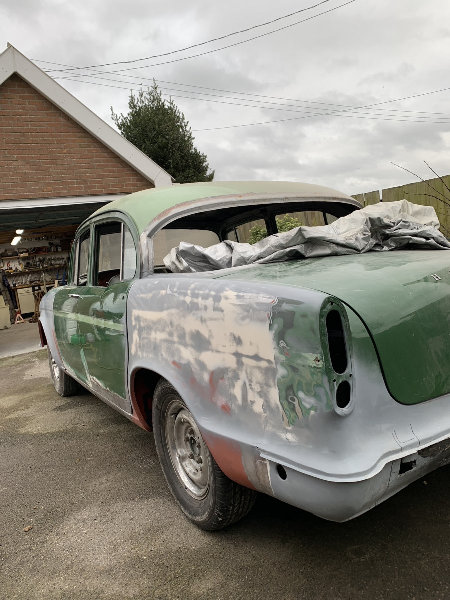

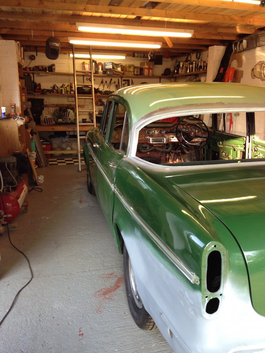

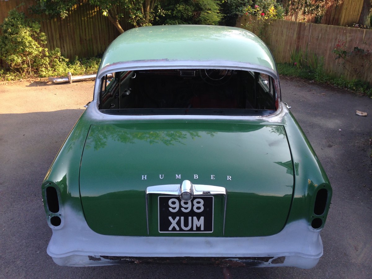

    Here’s a couple more progress pics... Not much to show, just a lot of filling and sanding, but it’s all progress I guess!

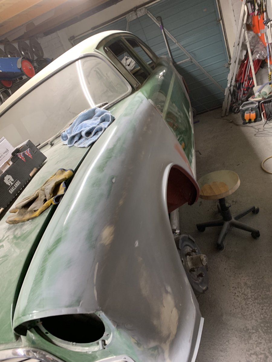

  21. matt-miles
    Joined: Aug 31, 2012
    Posts: 103
    matt-miles

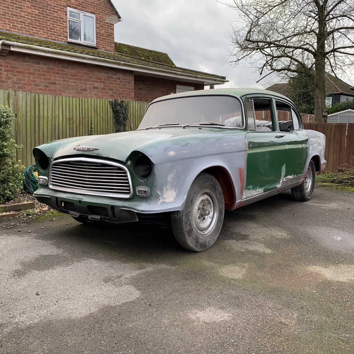

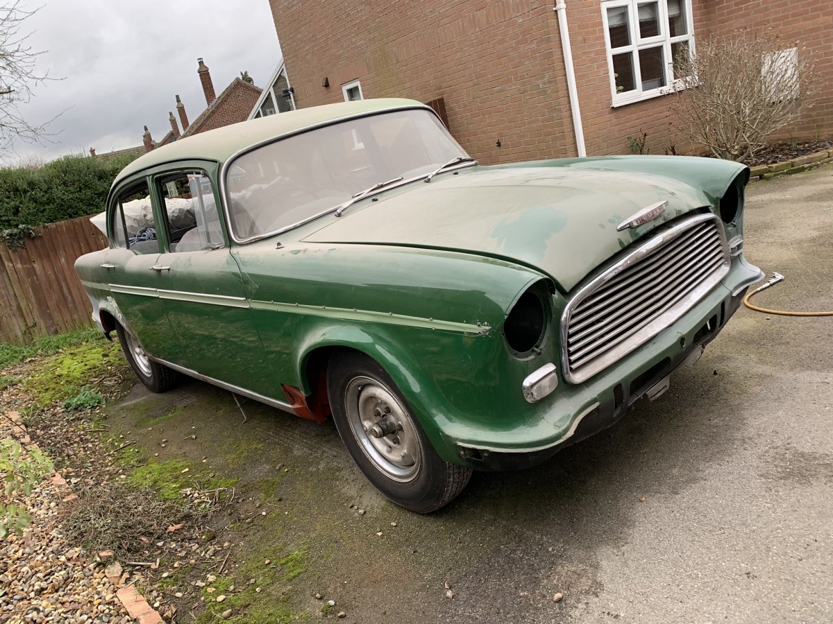

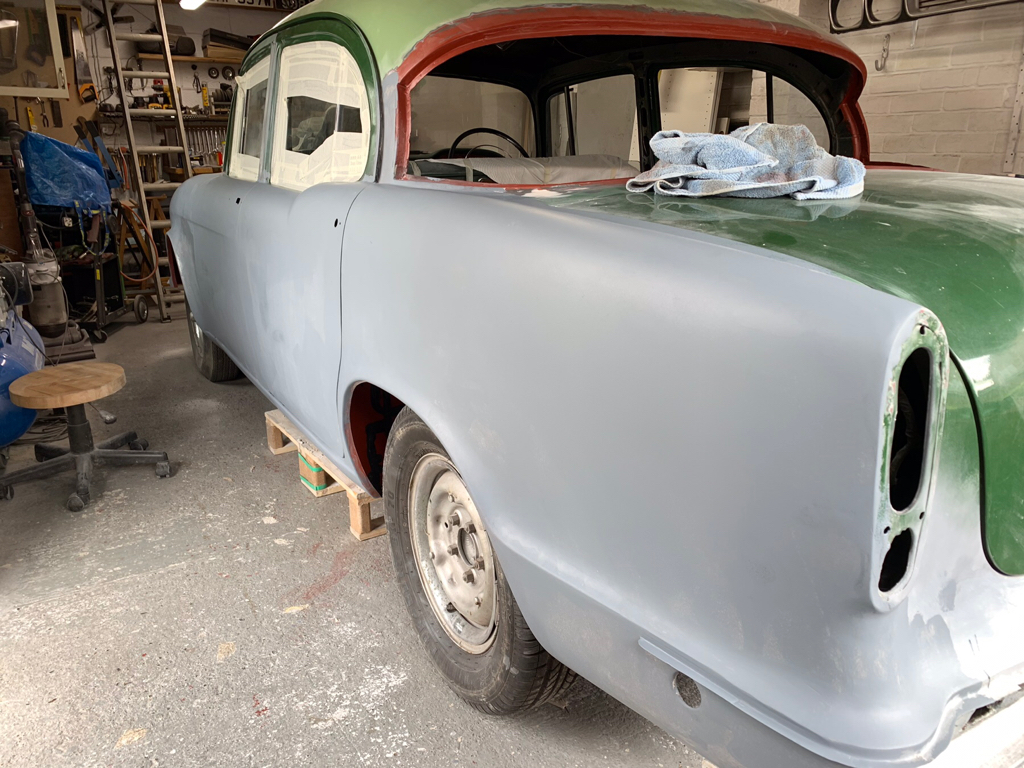

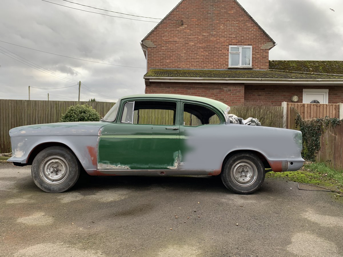

    So, I finally got to a point where I could ***es the overall shape by putting a single colour on.
    I quickly rolled on some grey filler primer, just to get a better look.
    Pretty pleased with the results...
    So I rolled out out with the help of a friend so I can tackle the other side.
    Once I’ve got both sides more or less the shape I’m after, I’ll put some epoxy primer on to seal everything while I work on the rest, unless anyone thinks that’s a terrible idea?
    Thanks again for all the encouragement fellas!

    Epoxy primer as a sealant is a good idea while you're working on the rest of the car, it'll keep contaminants out of the body filler and also moisture off of bare metal. The bodywork looks good.
    matt-miles likes this.
