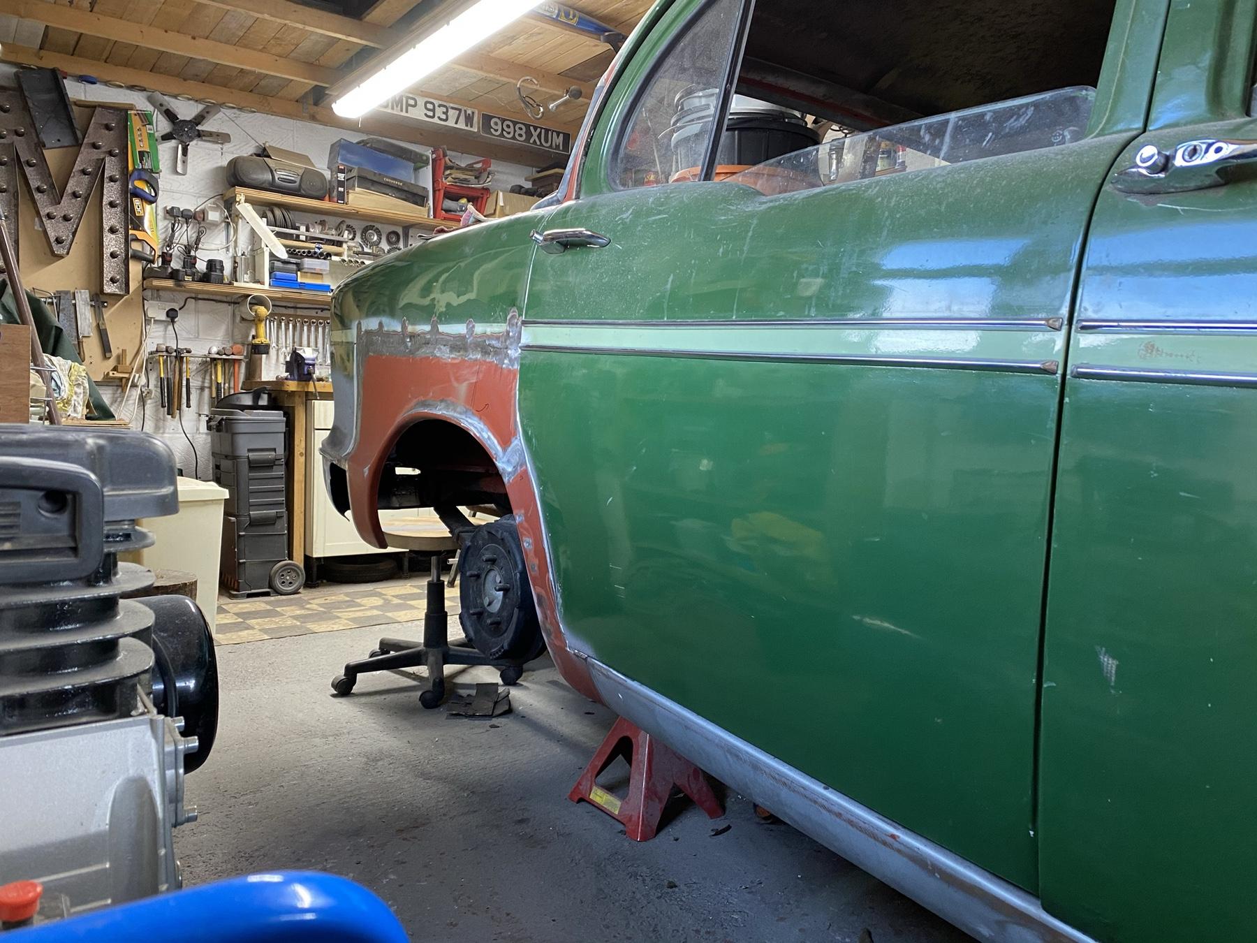

    Well, to say the last year and a half have thrown a spanner in the works with regards to progress on this old pile would be an understatement!
    The ramping-up of the day job, home-schooling and a general change of lifestyle have all taken priority over ‘playing’ in the garage. I am grateful that I can just put this to the back of my mind when required.
    But with the latest lock-down here in the UK, I’ve decided to get back into this as a means of therapy. I’ve spent another few hours at it today, and I realised how important this hobby is for mental health.
    Anyway, on with some progress pics...
    Nothing much to see except that I’ve had to make a relief cut in this rear fender panel as it seems to be a little miss-shapen.
    The good news is that this wheel tub is much better in terms of rust, so it shouldn’t take as long to get put back together compared with the other side. I’ve just got to remember how to do all this stuff again!

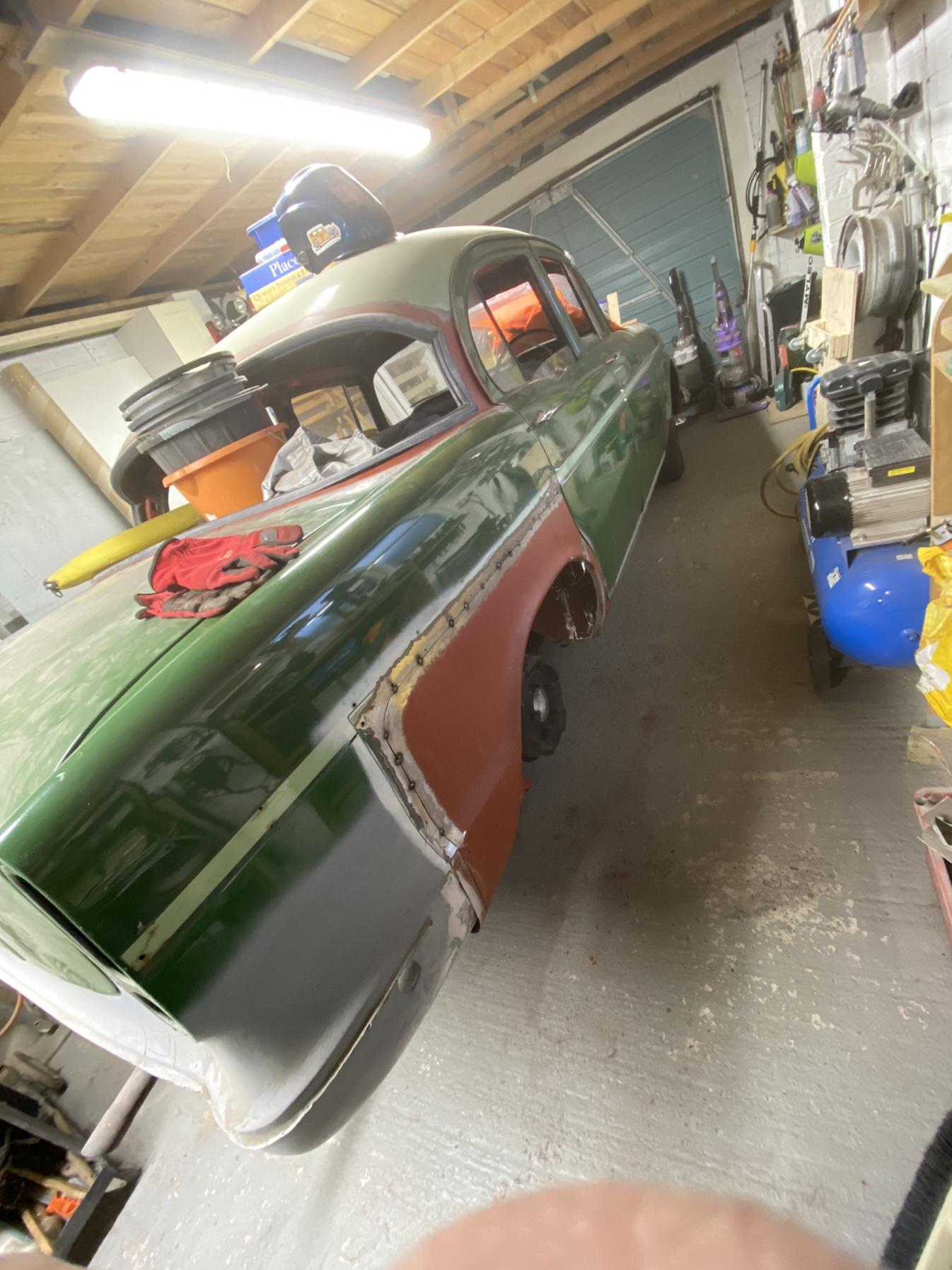

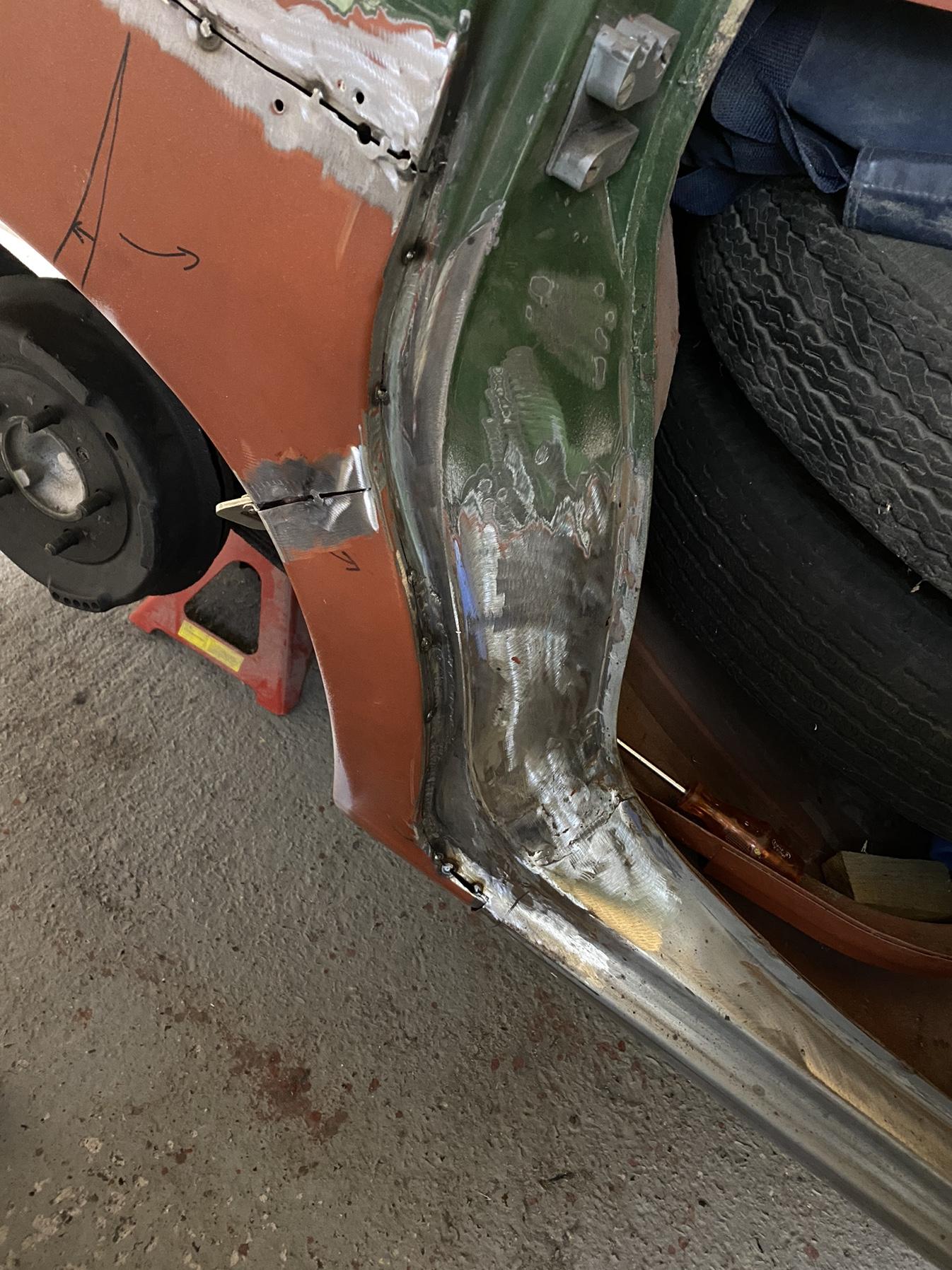

    Managed to get a little time on this at the weekend... Feels like I’ve got some momentum going again!
    This side was so much easier to tackle because the wheeltub wasn’t nearly as far gone as the other corners.
    Anyway, not much to see, but progress is progress...
    As much as I’d love to Two-door it, I also just want to get it on the road... but never say never... [emoji57]

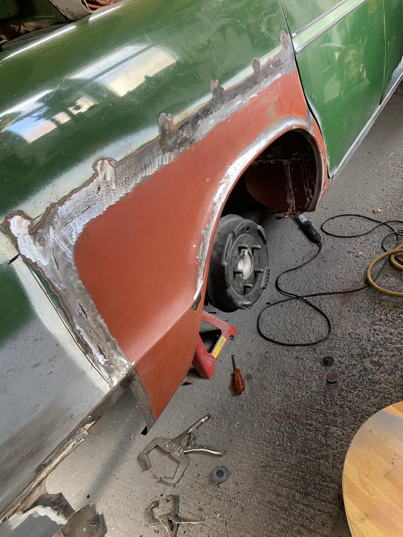

    Finally got this panel welded in... There’s a little warpage where I can’t get to the back of the panel due to the wheel tub, but I’m not afraid of a little filler...
    Peeps, tr_rodder, 41 GMC K-18 and 9 others like this.

    Some more progress today... I managed to get a little fibregl*** on the welds to the rear quarter panel. Seems weird putting what I used to consider only good for ‘bodging up’ or hiding damage. But I guess if it stops the finish from cracking, then it’s worth doing.
    The panel’s still not as straight as I’d have liked, as I’ve not taken a bit of a hiatus from playing with cars over the past few months, but there seems to be few high spots, so at least I’ve got that going for me.
    Oh yeah, I also made this little patch panel up which required a flanged hole for the bumper bolt... this was a good evenings work, but quite pleased with the result.
