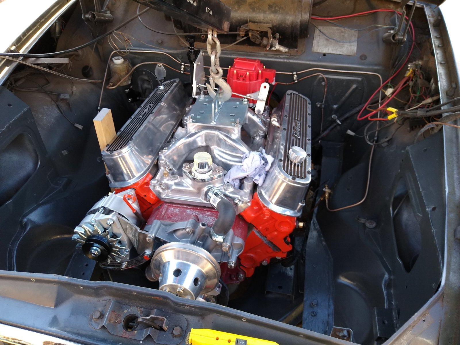

    I have a Hawk, it did have a Rover 215 in it but it's gained a bit now.
    Chrysler 318 with Comp cam, ported heads, KB pistons, airgap manifold and there's a 600 Holley to go on. It's connected to a 904 with uprated clutches and bands and a Transgo kit.

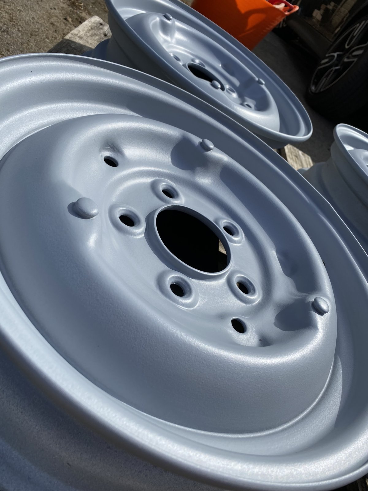

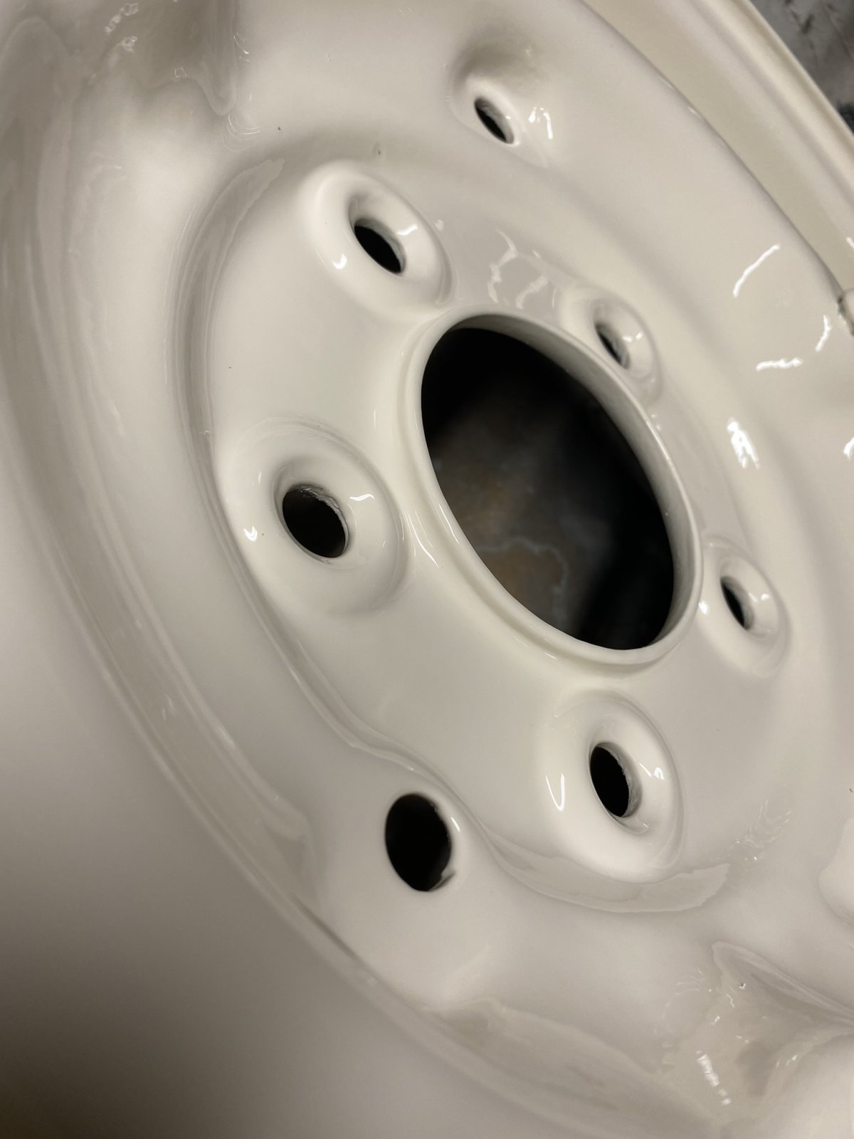

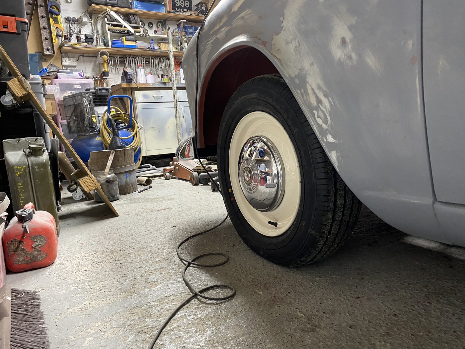

    So, after sanding own the wheels, re-epoxying them and then re-painting them, I'm calling them done... for now...
    Now, they're still not 100% - and there are a couple of fish-eyes still, but I'm doing this in my garage, where everything else happens, so I guess its as good as I can expect. Still, all they've cost me is time and paint - I've so far resisted a trip to the powder coaters - and I'm proud of that!

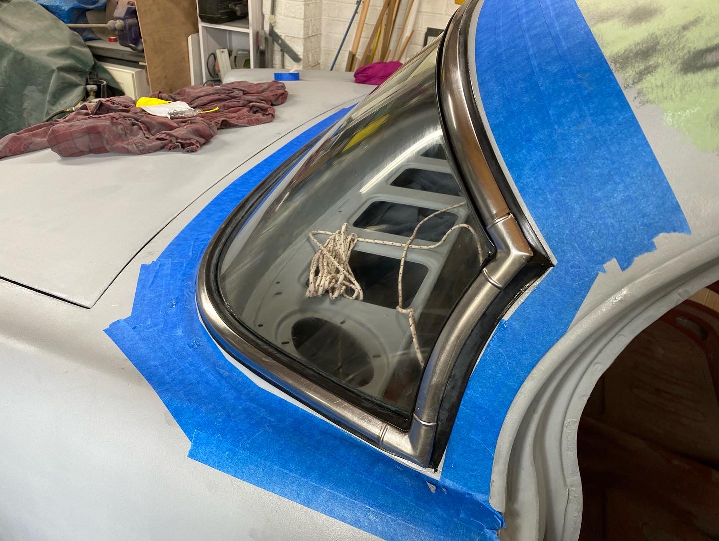

    I've probably said this about every little job on the car - but this was the worst! Fitting that stainless trim to the rubber on the gl*** before fitting to the car was a ball-ache! I know a lot of cars use a system whereby the stainless trim locks everything in place once its installed in the aperture - but this setup requires that everything gets pre-fitted, and then it more or less falls into the hole. I spent hours sweating over that piece of gl***... But its in! For the first time in about 10 years!
    It feels a little backwards putting the screen back in before a topcoat of paint - but I'm at a point now where I just want to get it back on the road - even if its in epoxy primer for the time-being. I can either pull it out to paint it, or the rubber lays in such a way that it looks like I can lift it and pack something underneath to get some paint in there if need be. Anyway - Milestone unlocked! It has a rear screen!

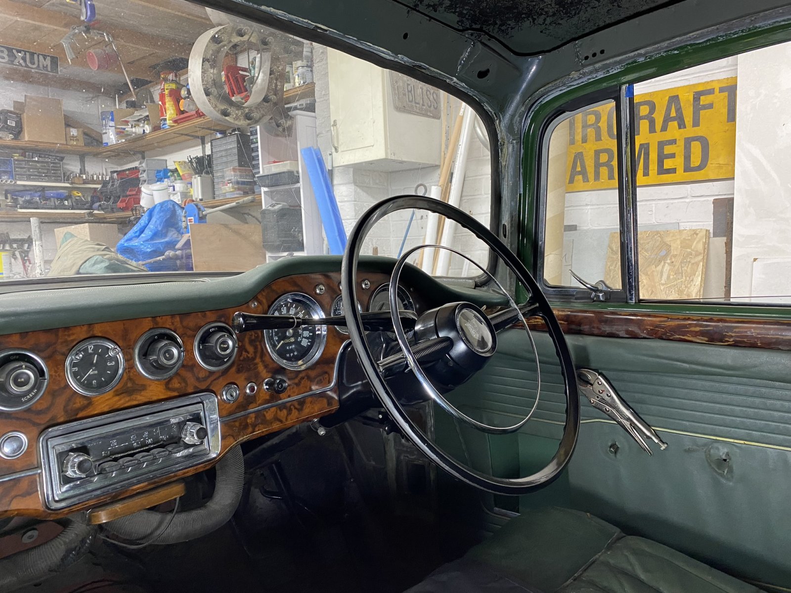

    Gave the steering wheel and dash a freshen and tighten-up...

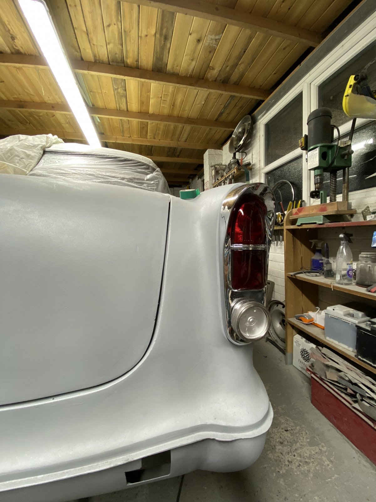

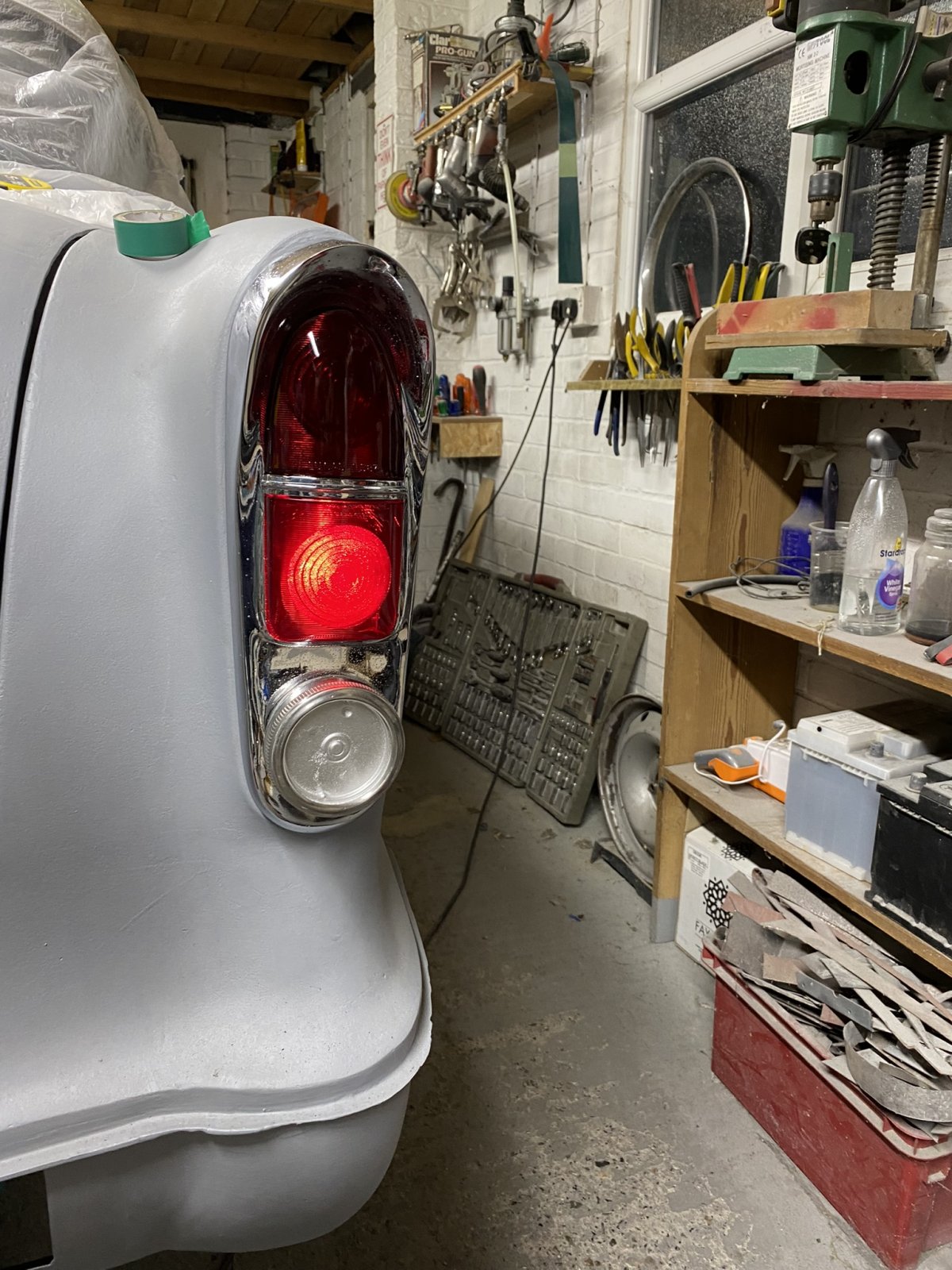

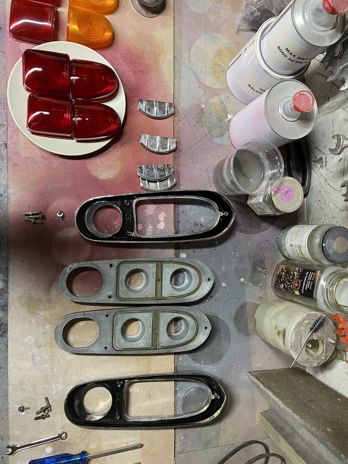

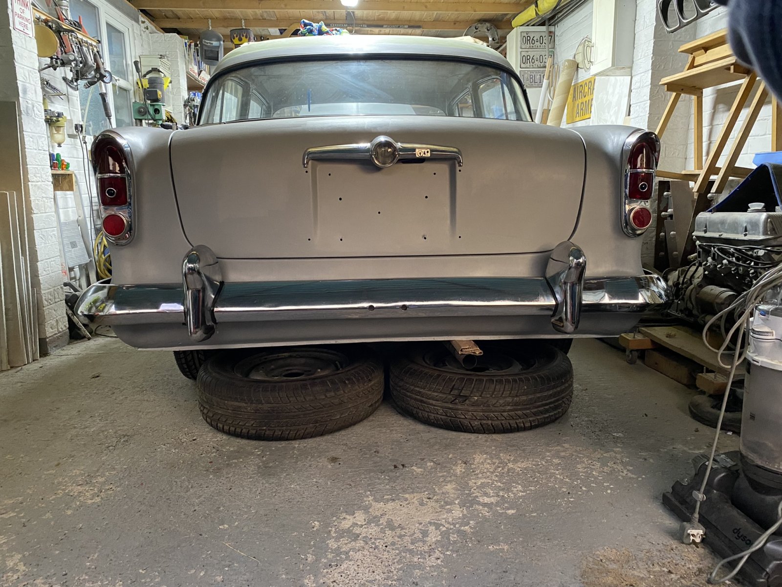

    And as resurrecting the electrics wasn't as bad as I was expecting, I've been messing about with the taillight lenses in a bid to clean up the rear end. All the cl***ics over here seem to have amber and red taillights, but apparently, because this is pre-65' I can get away with red alone... So that's what I did... It's a really small touch, but I think it cleans up the look of the rear end nicely.
    IMG_2676.JPEG The chrome is a little pitted, but it cleaned up nicely. And I've got some reflectors coming for the 'petrol filler'.
    I know this is kind of a dry-run and when it comes to painting, I'll be pulling all this off again, which seems a little counterintuitive, but its nice to work around all the little bits for a change... Its starting to feel like a car again.
    Now the question is... to blue-dot or not to blue-dot...

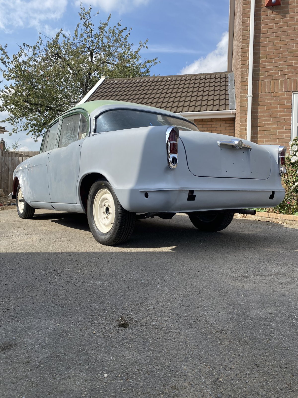

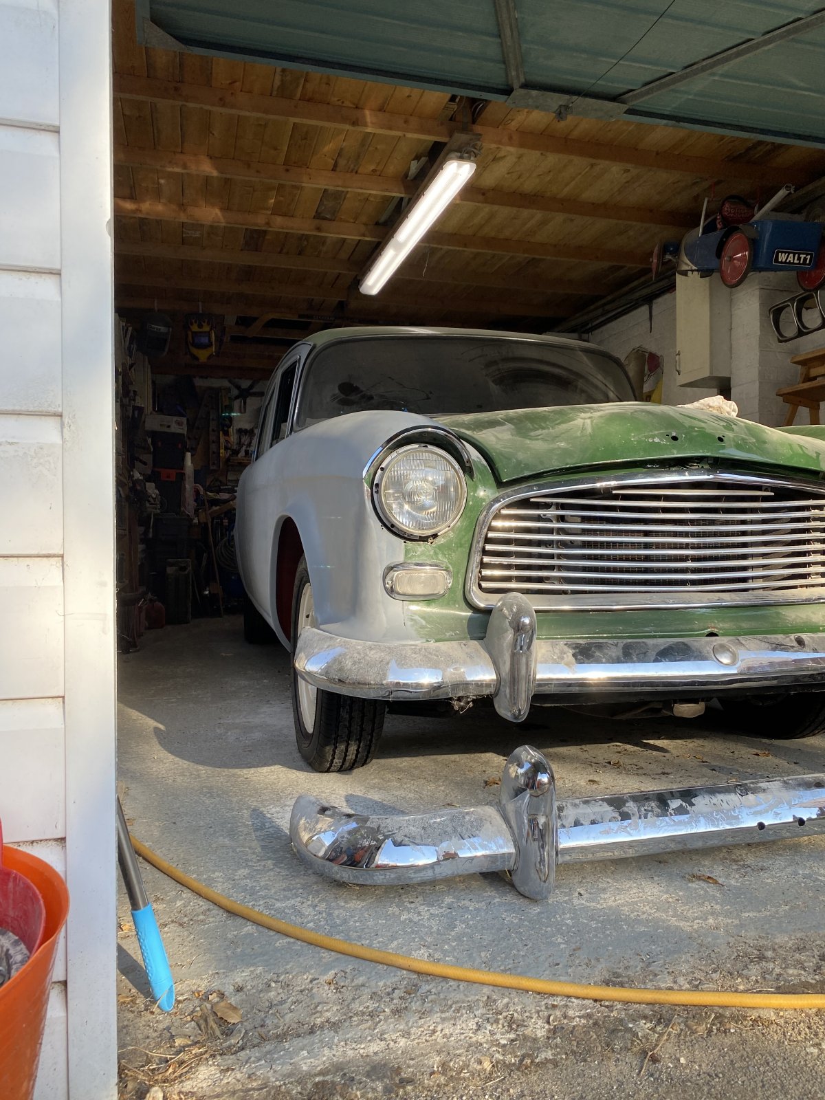

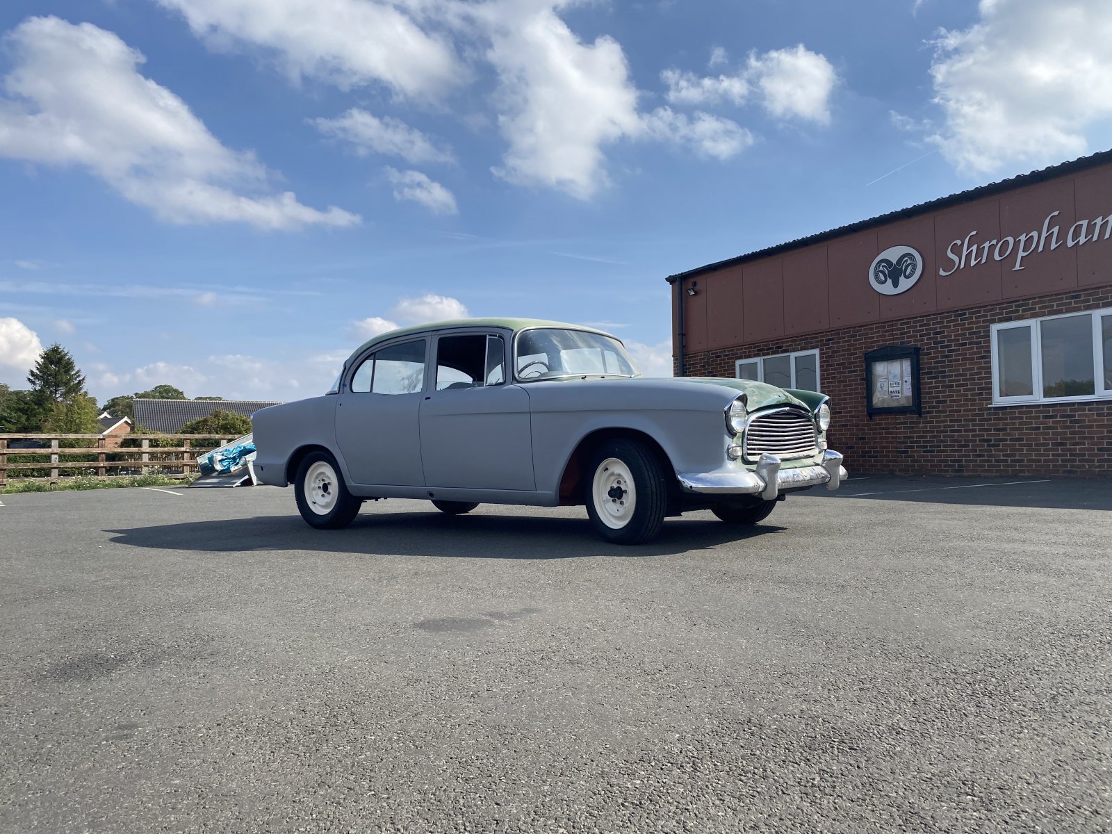

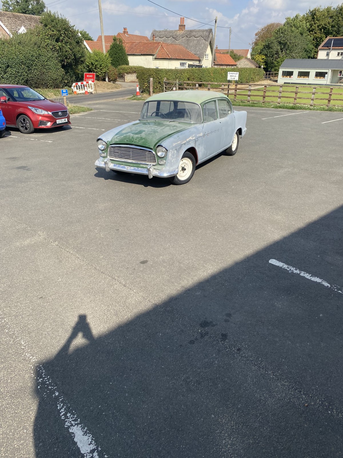

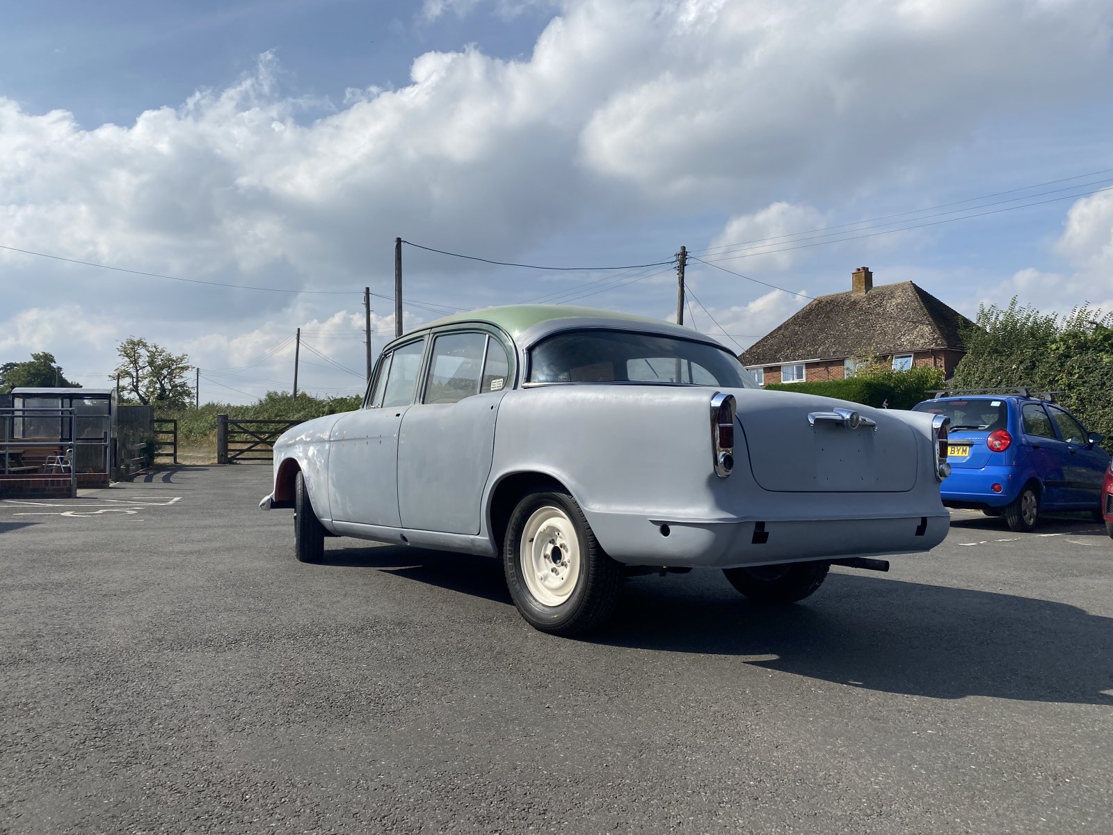

    A little more progress today… Made it off the driveway for the first time in 10 or so years!!
    The rear axle is really noisy, so I didn’t venture far, and it looks like I’ll be replacing the oil and checking the hub bearings pretty soon.
    loads of little bits to work through… trim holes to weld up… decisions to make, but I’m a happy dude right now! Feels like a car again!

    I like the all-red tail light lenses, and I feel like that makes it custom-enough without adding blue dots, which I'm personally not a fan of. I've seen body shop guys push a piece of small diameter rope into the outside lip of a rear window gasket when painting, it's just enough to hold the lip up so paint goes behind the edge of the lip, then when the paint is dry you pull the little rope/string out and the gasket lays over the top of the paint line and it looks just like it was painted with the window out.
    Looks like it's coming together real nice. It's gotta feel good to see it all in one piece, solid and straight again, after starting with a real bog-monster.

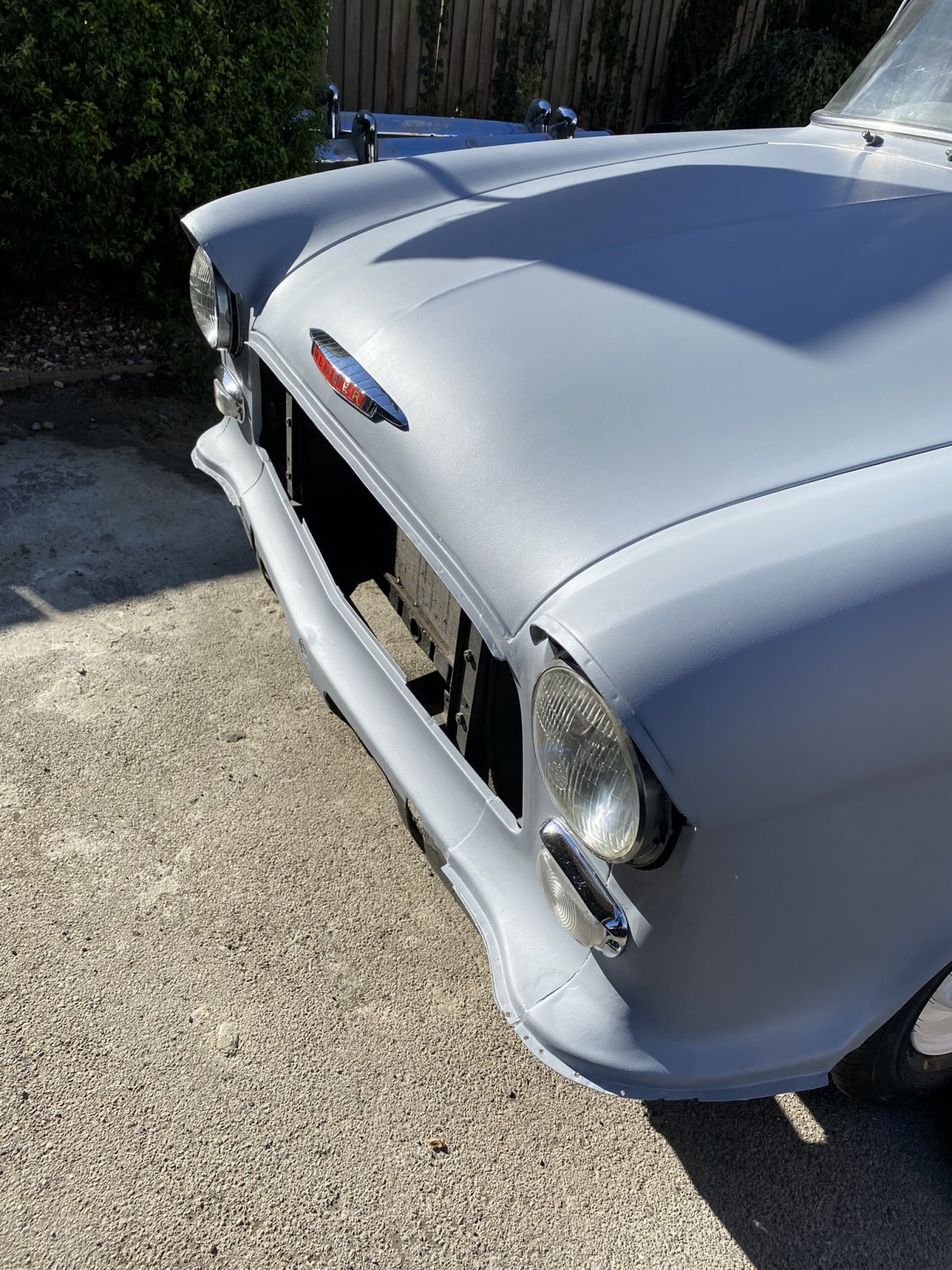

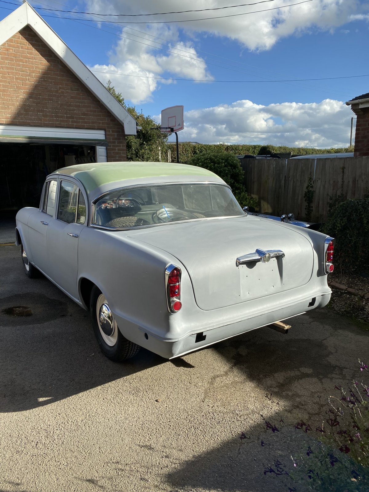

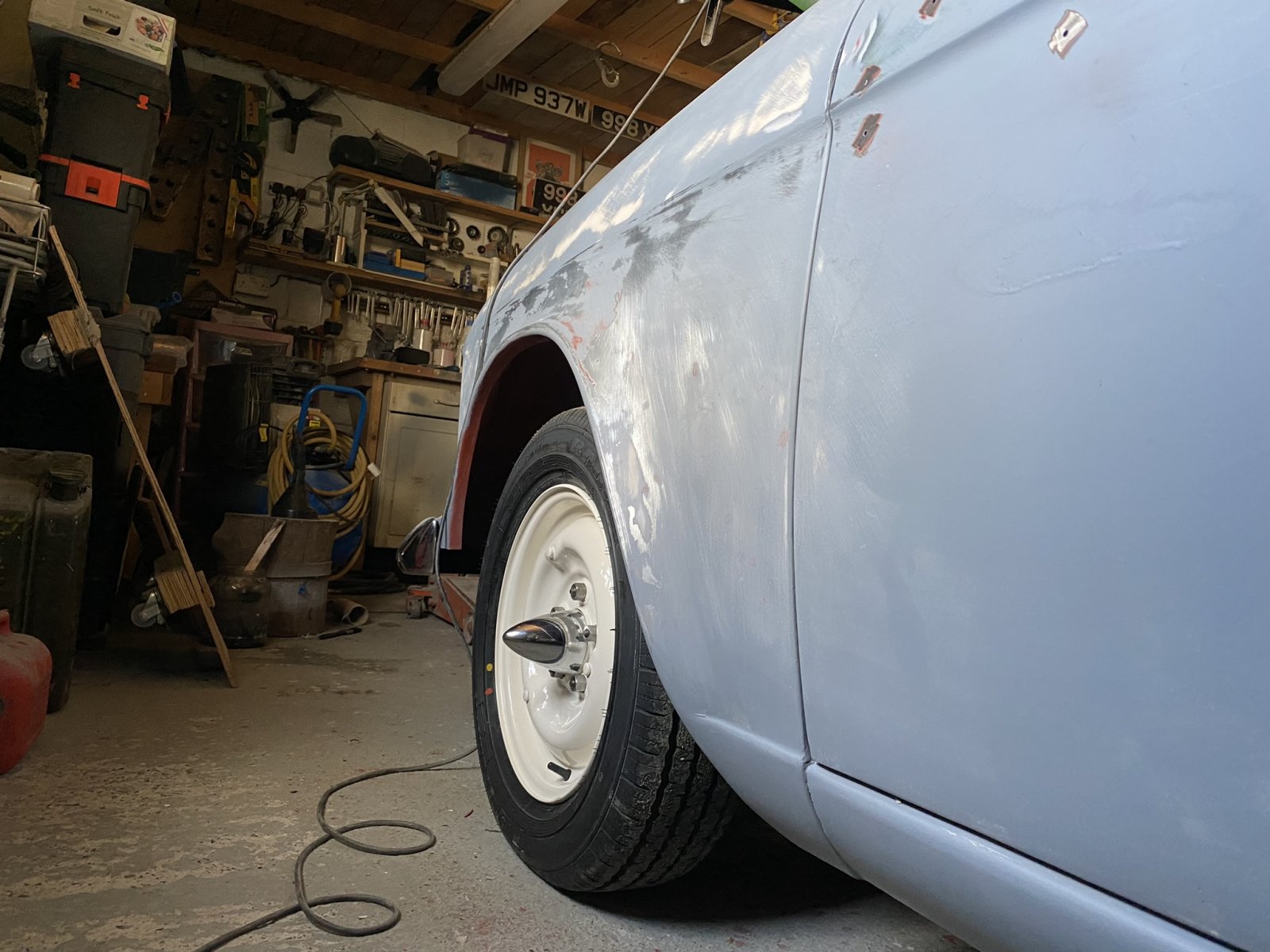

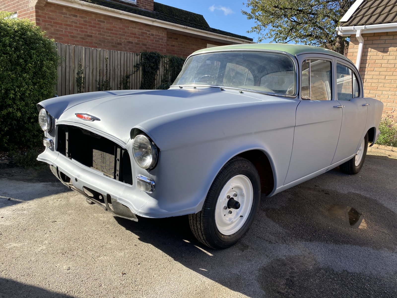

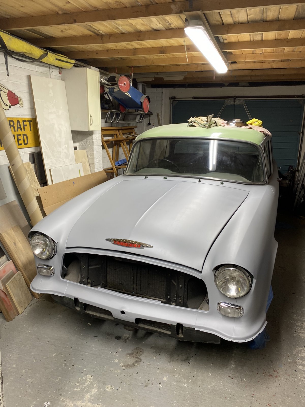

    Thought I'd better put some more progress pics up...
    - I've painted the body (except the roof) in Epoxy Primer to seal it from the elements while I play with the rest. Its a bit leathery in texture (I rolled it on) but sands pretty well still, so I think I'll be okay to filler prime overtop when the time comes...

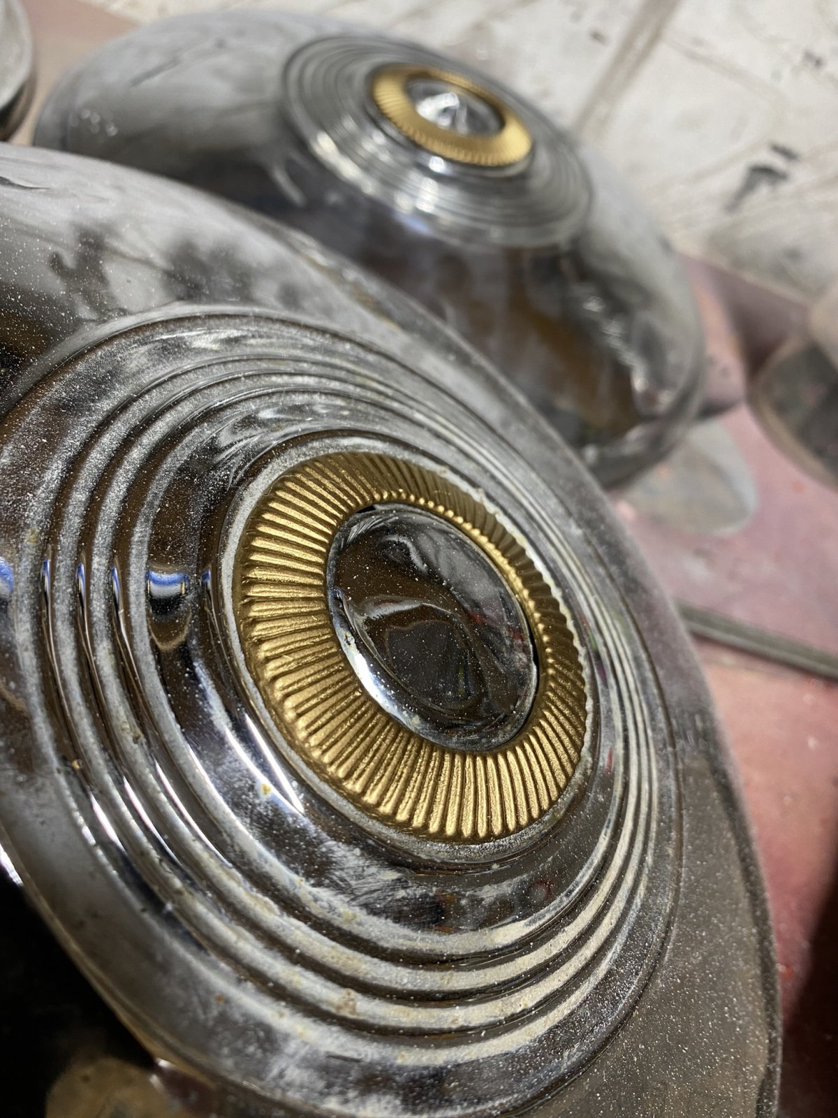

    - Played around with some chrome bullets as center caps, but I've decided I prefer the stock hubcaps.

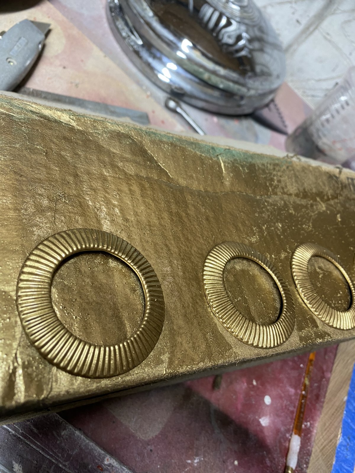

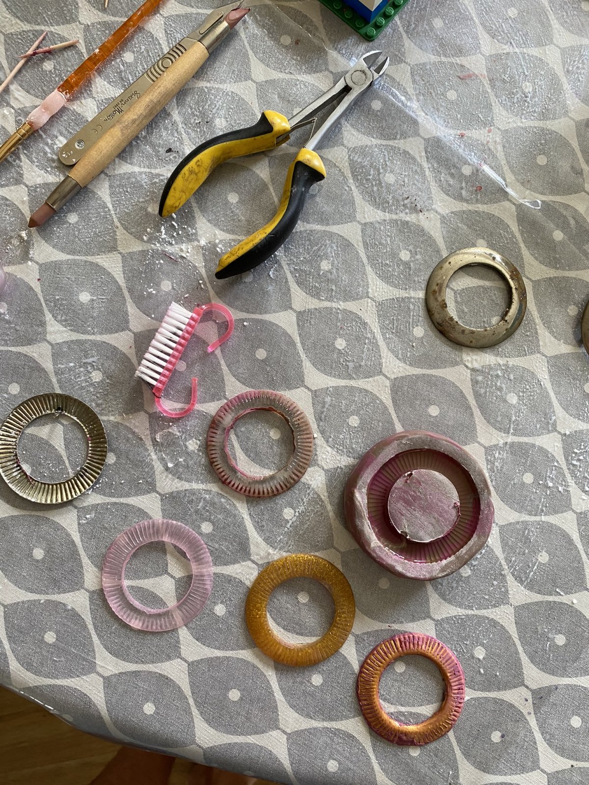

    - Made some decent center rings for said hubcaps using my son's UV resin kit
    - I've carried on putting it all back together to make sure I've got all the bits still.
    I'm slowly building up the courage to paint it - but for the time being, I'm still working towards getting it back to 'rolling resto' stage. Its got all new fluids, greased nips, and the interior is coming back together.
    Oh, the blue dots are staying for the time being Squablow - Just getting it outta my system ;-)
