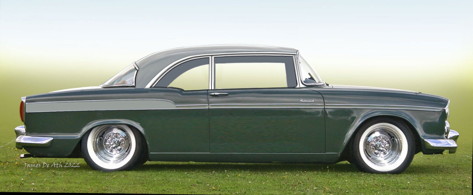

    Ooooh - this is stunning James! Something to aspire to, for sure!
    But now my car looks all squat, dumpy and tall! (and probably a couple more of the 7 dwarfs too, if I could remember them!)

    A man with your welding skills could knock that out in a weekend, I feel sure.

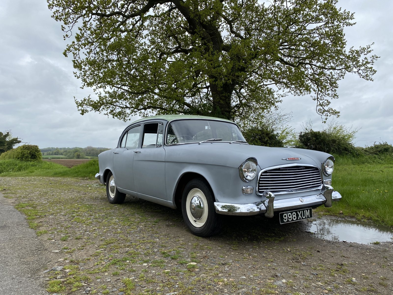

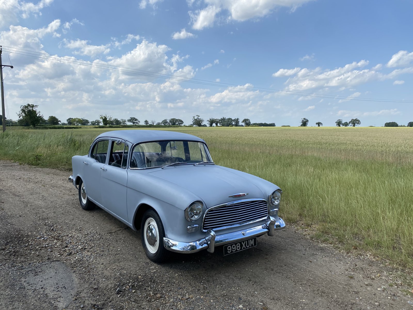

    So, it’s been a while!

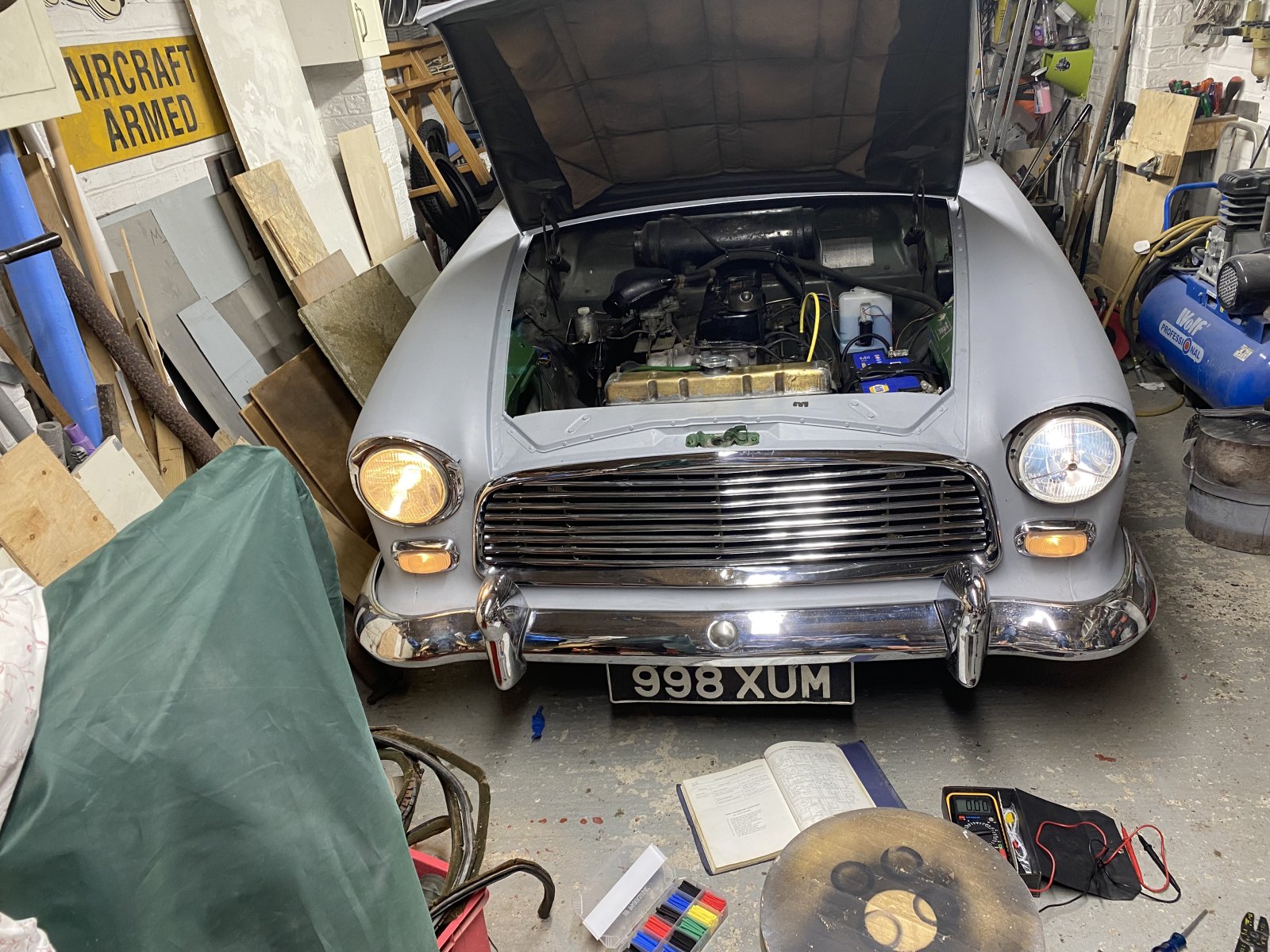

    But I’ve been making slow progress on this in the background. In fact, today I finally got over to my local mechanic for a health check - ready for the show season! We are good to go!
    I’ve given the carb a light freshen up, sorted out a couple of welding jobs, sorted the timing and gave the ol’ girl a new pair of peepers.
    she’s still not running quite right, with a hesitation /hunting when cruising at part throttle… so any ideas on that would be gratefully received!

    Your hesitation and "hunting" at cruise is likely a lean issue. I don't recognize your carb, was expecting a pair of SU's. Make sure your main circuit and accelerator circuits are clear, and that the float is set to the proper level. When all else fails and parts are not available, I have used a tiny set of drills designed for cleaning oxyacetylene torches to add a touch of fuel.

    4 Pedals - Its a Zenith WIA-2 carb - a version of them were pretty common on land rovers and some other british cars sold on these shores at the time.
    'Lean' sounds like a real possibility - there is a tiny amount of play in the throttle shaft - which I guess is leaking in air, and I've not checked the float level - but I'll do that next!

    I would look for a vacuum leak.

    id say vacuum leak.if there is a leak on the throttle shaft itl never run right.id try a replacement weber carb,not the racing item stock replacement.i put one one a scirocco way back.made more power ran faultless and did 10 plus mpg.also fitted the correct plugs it was a new car.
    try turning out the mixture screw out 1/8 turn.looking good

    Thanks Jon, I seem to have sorted it by pulling everything apart and putting it back together again. It’s still coughs a little on overrun, but the issues I was having before seem to have been resolved.
    I might just price up a replacement, though - appreciate the lead on Southern Carbs.

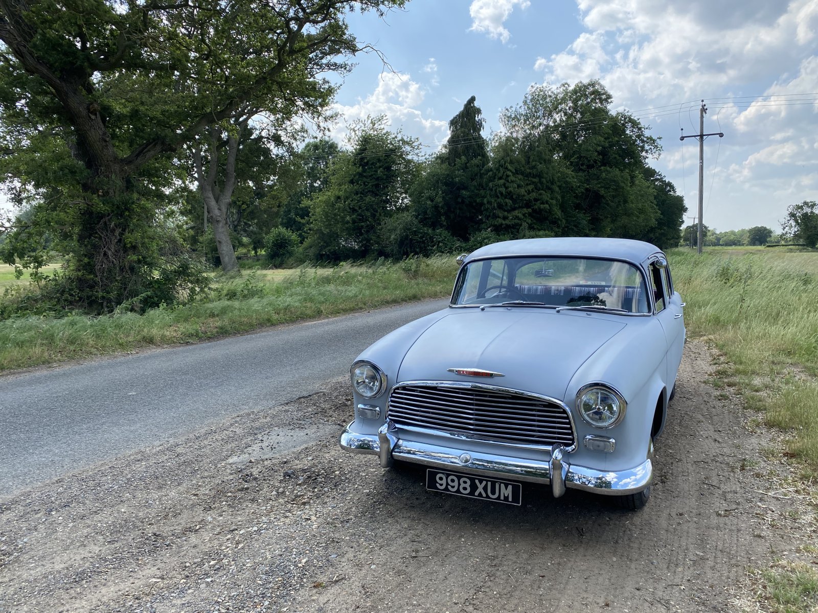

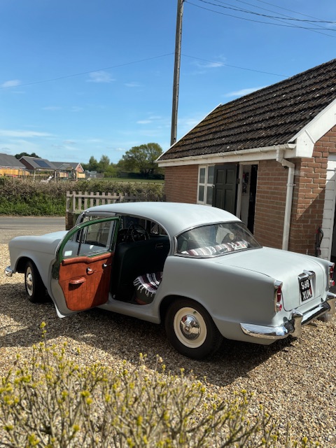

    So I’ve been getting the ol’ girl out and about as much as I can to build up some confidence. Since the last update I’ve added a few bits and pieces including seatbelts, some gauges and a bunch of Amazon sound deadening. I’ve also painted the roof in epoxy primer, so I’ve got a blank canvas to play with…
    We have good days and bad days, but I’m enjoying getting re-acquainted with driving a column-change manual again. It’s very rewarding when you string a few good changes together out on the country lanes!

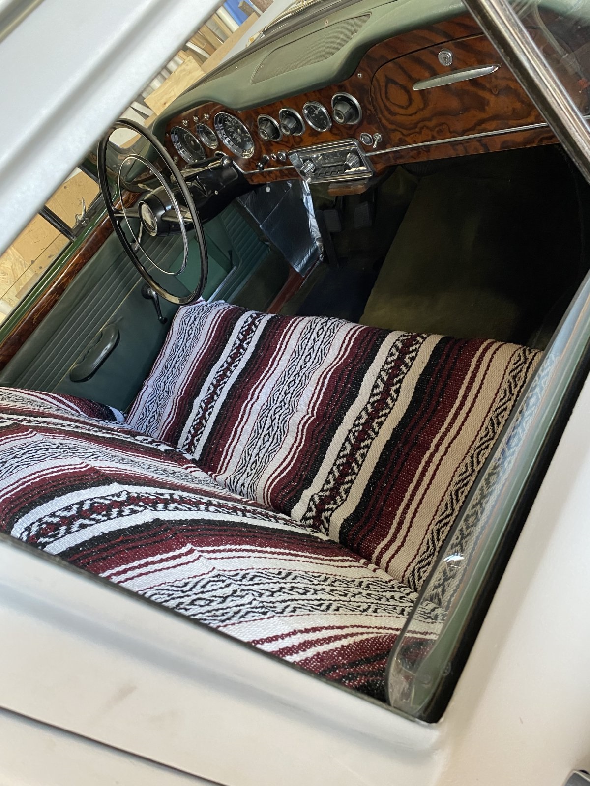

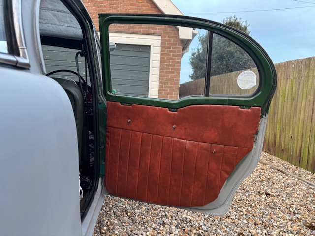

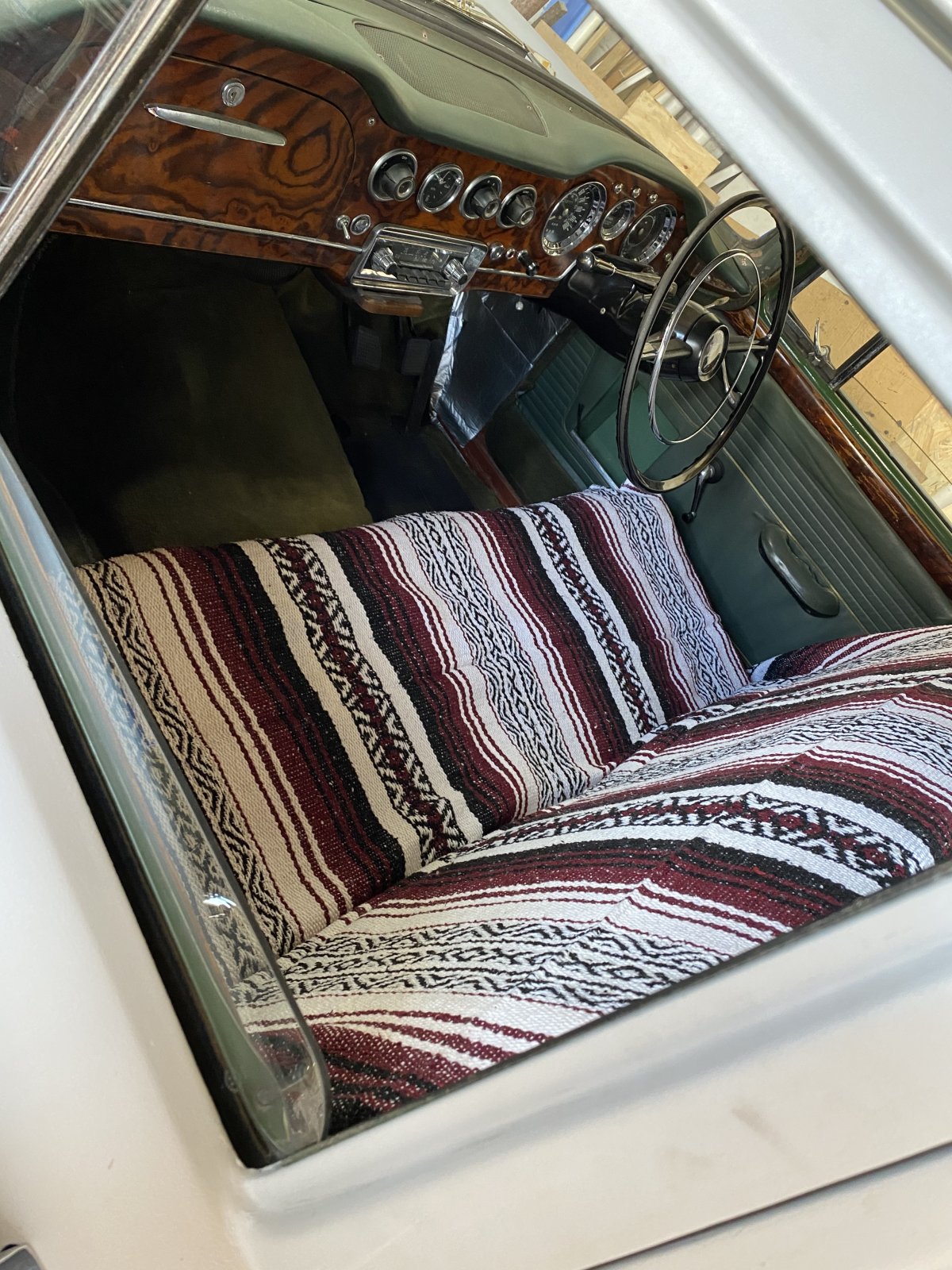

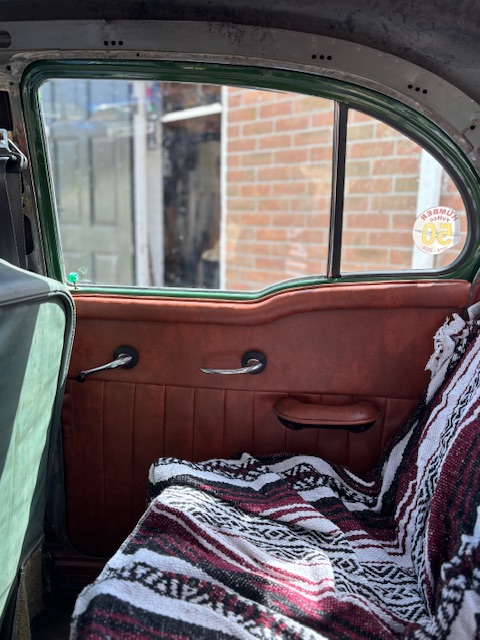

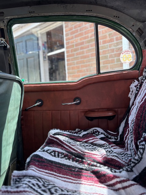

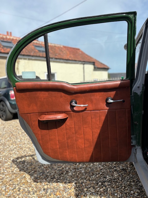

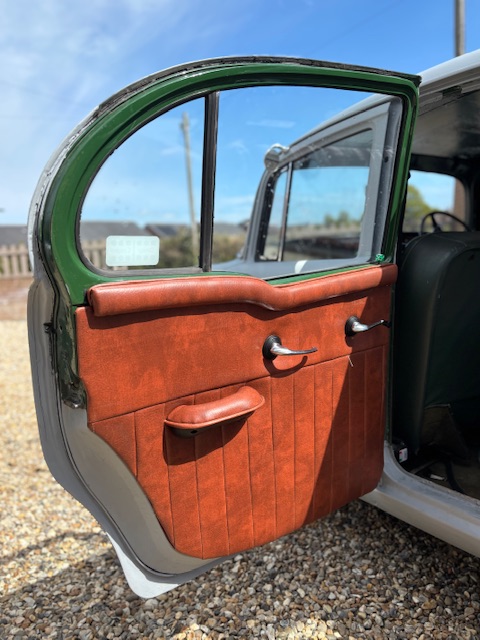

    Been having a play with the interior…
    not great, but a good start, I think…
    IMG_4331.jpeg IMG_4330.jpeg IMG_4328.jpeg IMG_4327.jpeg IMG_4326.jpeg IMG_4325.jpeg IMG_4324.jpeg IMG_4323.jpeg IMG_4322.jpeg IMG_4271.jpeg IMG_4258.jpeg IMG_4257.jpeg IMG_4254.jpeg

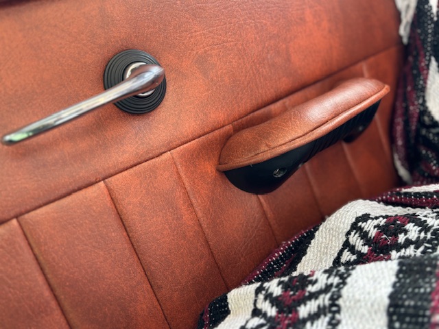

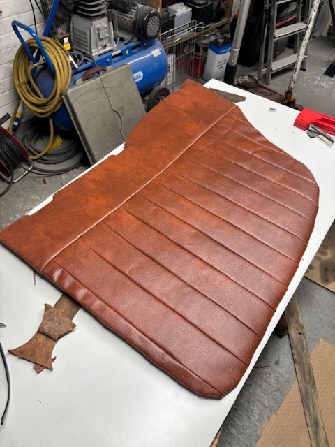

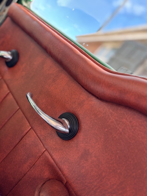

    matt-miles
    Hey! Its been a while, but I've still been tinkering when time allows...

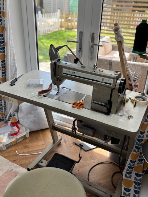

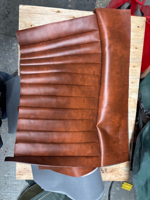

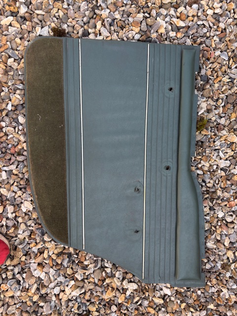

    Still progressing with the interior - I went ahead and bought some proper automotive vinyl, and used the original craft store stuff as a pattern... I've been using grey tweed as an accent colour to give a little interest here and there. Its a pain in the *** to sew, though - as it stretches all over the place, and acts completely different to the vinyl.
    Its a little bunched up in places - but I think with some sun, and a little heat - we can stretch it out... Still treating this a practice lap...
    Read centre-console came out quite nice if I do say so myself... Not perfect by any means - but it'll do for now! Tweed on one side, vinyl on the other...
